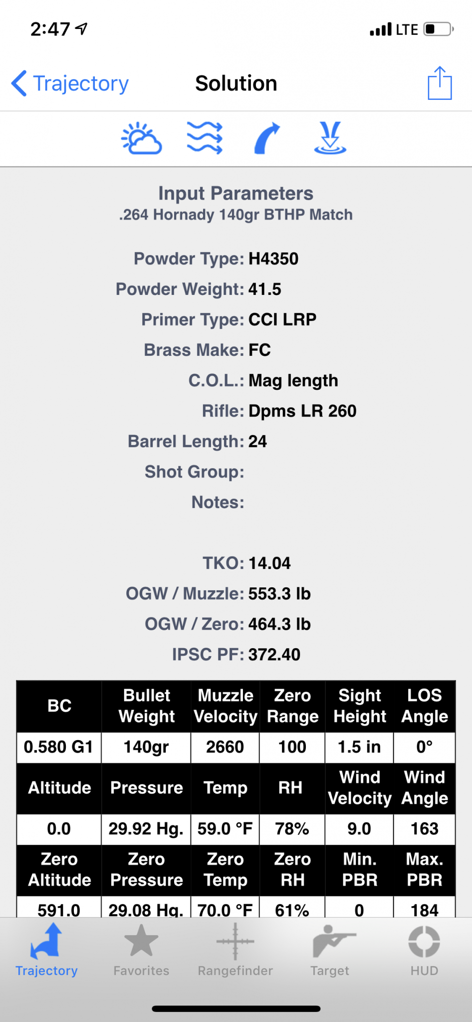

I use ballistic AE for all my rifles and most of the time it’s withen at least 1-2 moa at the most except with my .260 it is always extremely off like 5-10moa off.
I have used the calculator for first round hits at 1k using 223 and first round hits out to 850 shooting 6.5grendel/308/7-08ai etc.

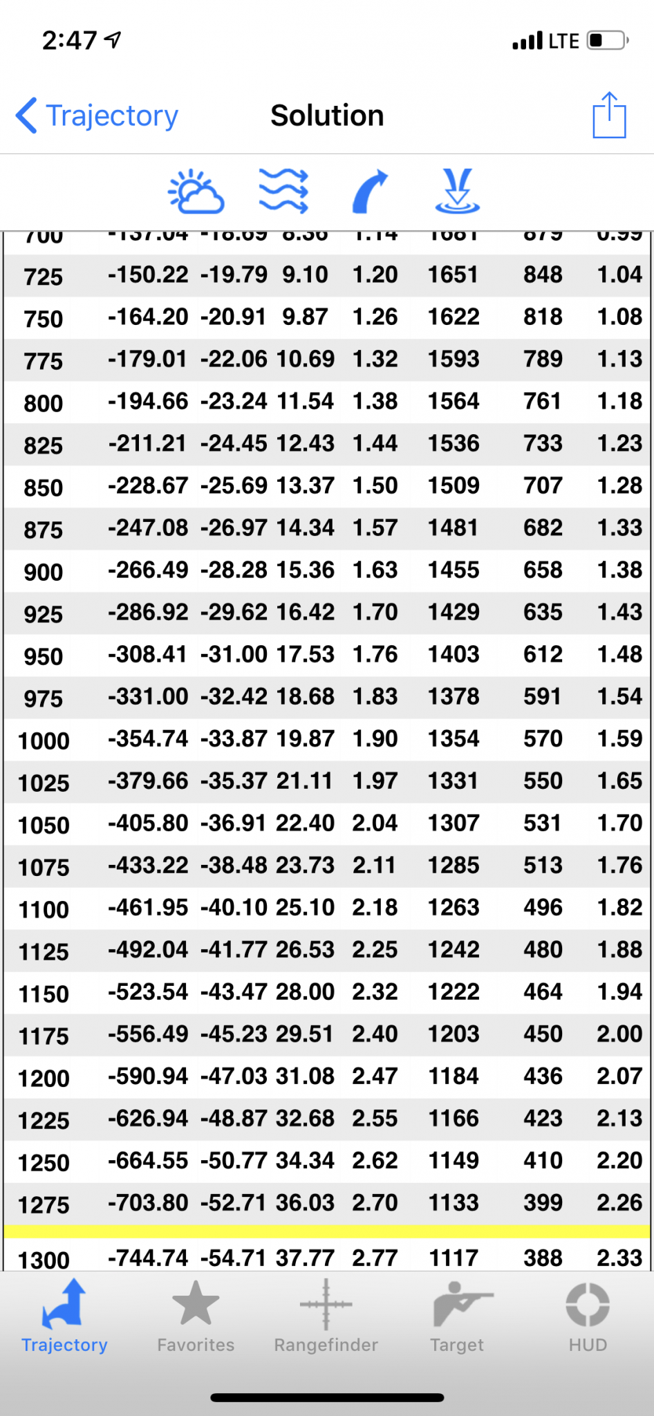

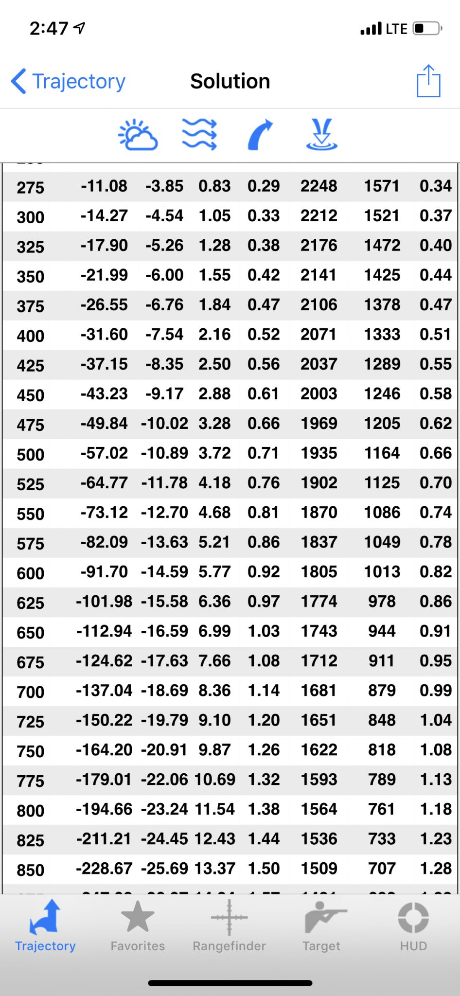

This weekend I was shooting out to 1k using both my 223 and 260 and had good calls using the 223. But the call it gave for my 260 was around 33moa when true drop was 27.25 moa@1k 2 back to back hits on 1 gallon milk jugs.

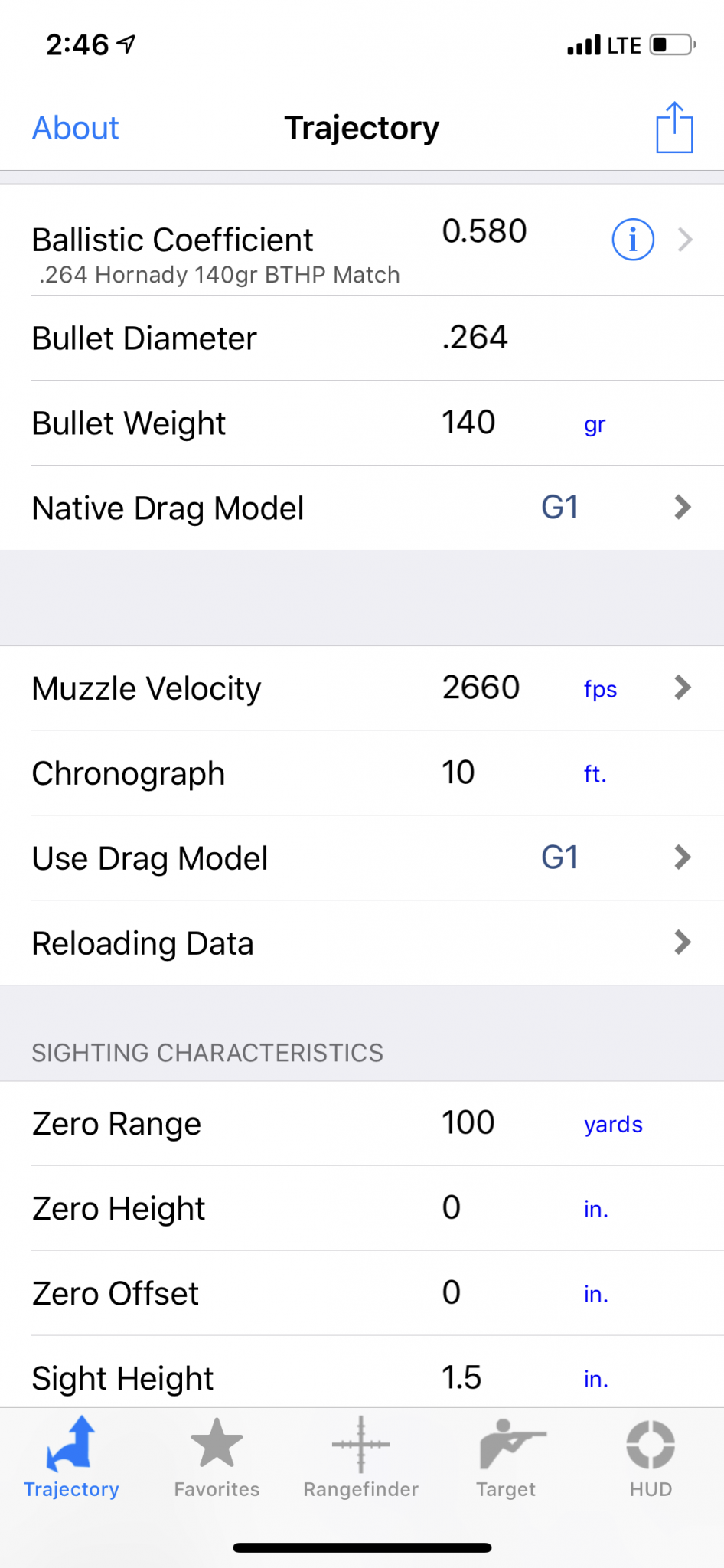

So what’s up with that? I’ve chronographed my load@10ft for a velocity of 2660.
The specs of the load/rifle:
Dpms Lr 260 24” 1:8.5
Load: 140gr hornady BTHP
41.5gr h4350
243win brass
CCI lrp
When I true my velocity using ballistic AE it gives me a MV of almost 3000fps which I know is wrong. Can anyone make since of this?

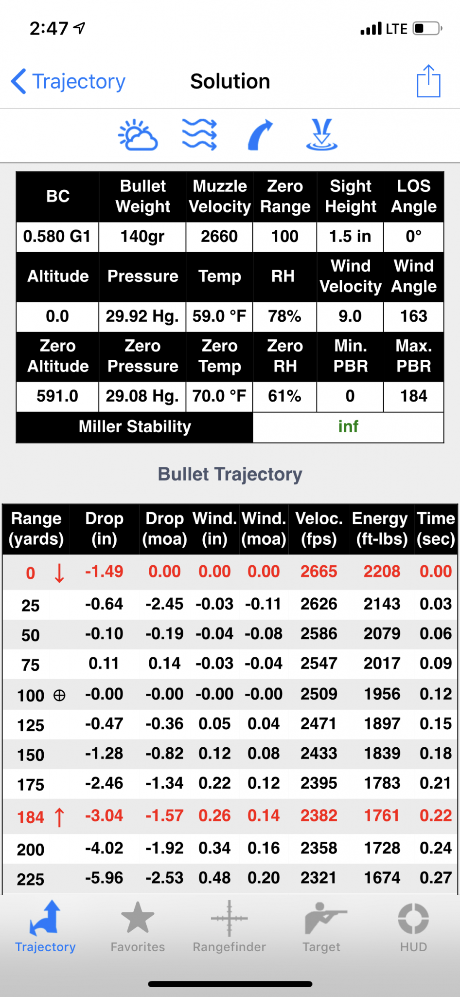

altitude and pressure are quite a bit different and may make an impact. I'd check those and rerun
Those are the numbers it pulls up when I push the locate button.
Correct me if I’m wrong but if it was the altitude and pressure wouldn’t the dope for all my rifles be off?
basically your software is saying you zeroed the gun at 591' then you went to sealevel. And you're asking it how much to hold when firing at sea level. I highly doubt you're at 0' altitude unless youre on a boat or at the beach... Input the correct altitude and pressure where you are actually shooting after you zero the gun at 100 yards so that the zero altitude and the current altitude match.
When I updated it changed by 1 minute at 1k my real world dope was only 27.25.
