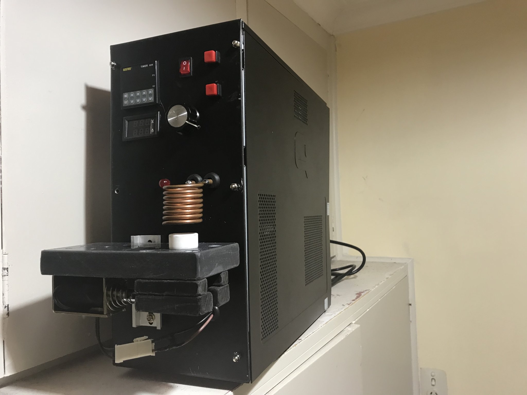

I made one based on the build on Accurate Shooters Forum too. Works great and is quick and easy to setup.

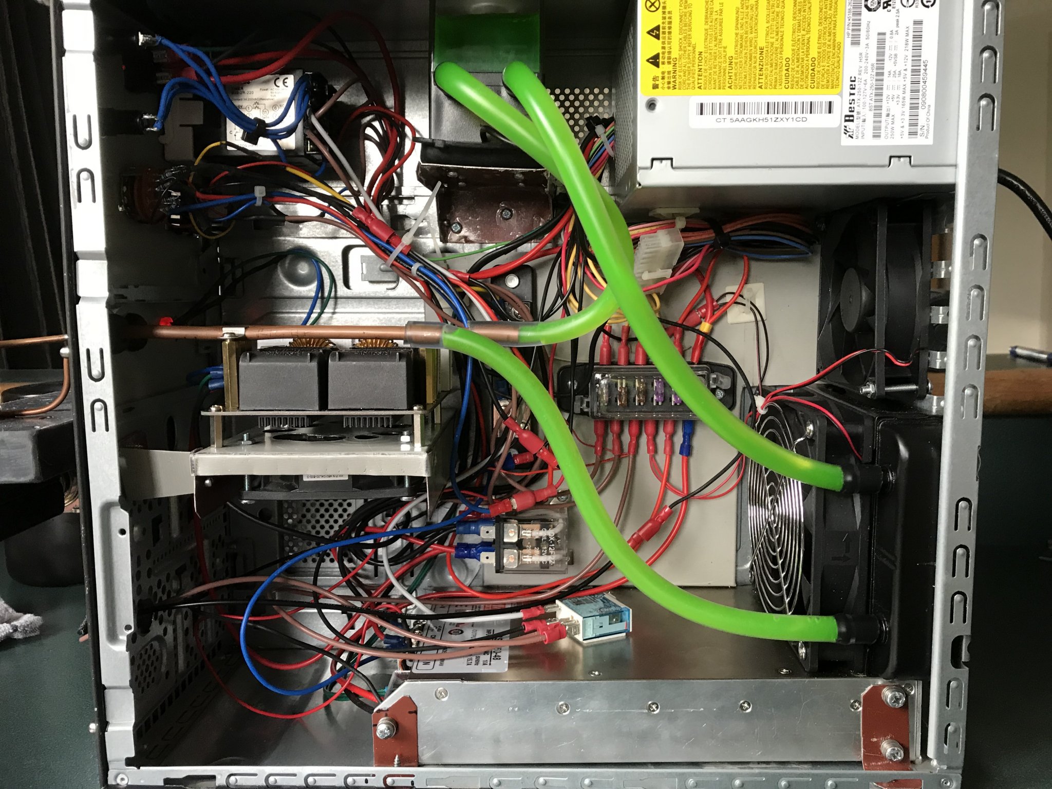

I build mine into an old computer case and used the case power supply for the both 5 & 12vdc supply.

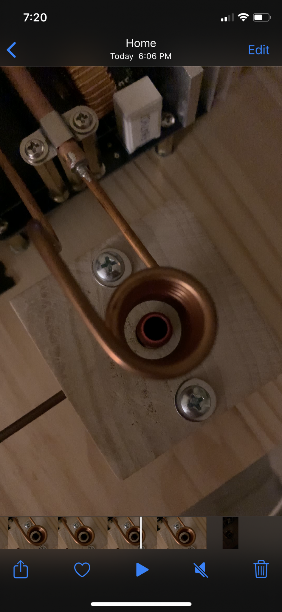

The white bits are Teflon bushes used to centre different size cases in the coil and with a big lead in taper I just drop them in the top of the coil and they fall in and centre nicely.
Nice! Out of curiosity how long does it take to get a 223 neck/shoulder up to annealing temp with that size coil? I'm assuming the 12V supply is driving the induction board. If so, how many amps are you drawing?
Thanks!
Tim
Hey Tim. A 223 takes about 3.2 seconds. 6.5CM about 6.2 seconds. Current is around 11-12amps at 48vdc. I’m using a meanwell 750watt 48v supply. It’s the silver box right at the bottom of the bottom pic. Definitely the dearest part in the build. The rotary switch changes the amp output but so far I have it cranked up to the max.

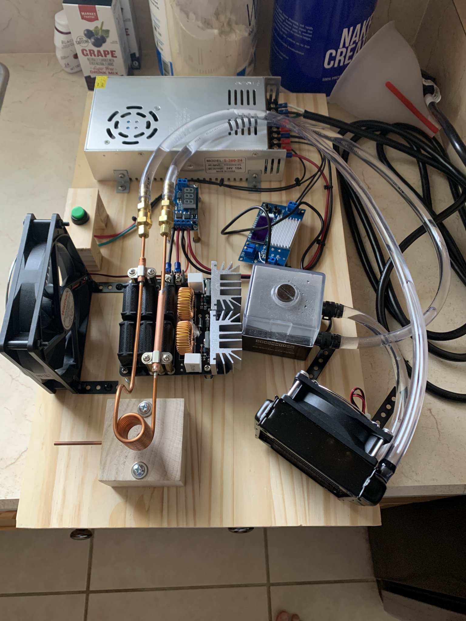

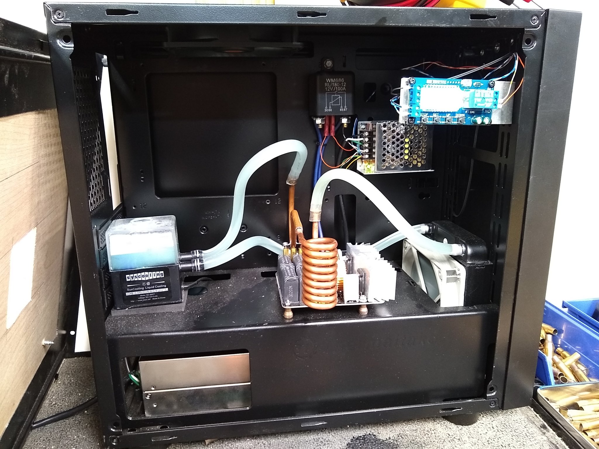

I will post pictures once I have everything bolted down but I have the 1/8” water cooled version up and running. The pump/reservoir, heat exchanger/80 mm fan, and DC to DC board were all obtained from Amazon. I had to get the 1/8” fittings from McMaster but they arrived in a day.
The small ID of the 1/8” tube does not allow for great flow rate but it is performing very very well even without the heat exchanger fan running.
I ran a 30 second cycle (no fan) and the coil was maybe a few degrees above ambient. Had I done that with the 8 AWG version it would be way too hot to touch. I could feel the return line warming up as it ran. My board is a bit busy now but that’s ok. It’s functioning flawlessly. Once I get everything locked down I’ll change the water to distilled and toss in a dash of water wetter.
Tim

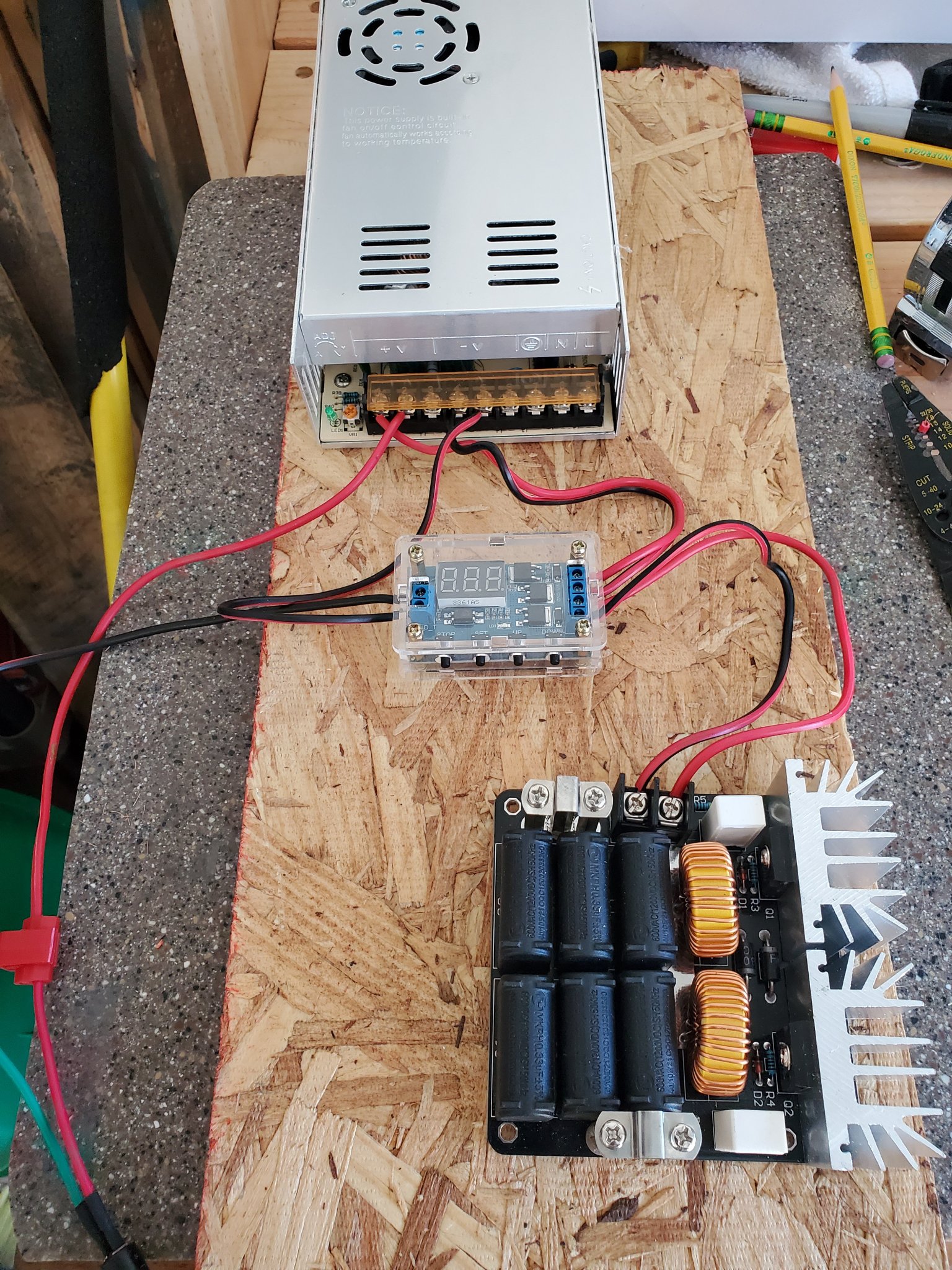

Wish I had seen this thread a few weeks ago.....just built an annealer identical to the one below. Now I have to wrap my head around NOT building an Induction Annealer
DAMN!!!

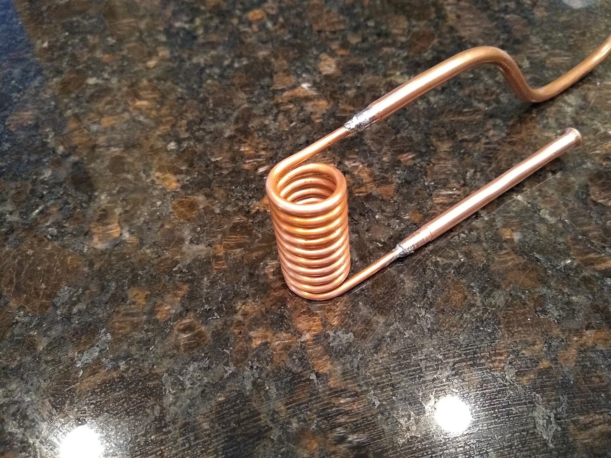

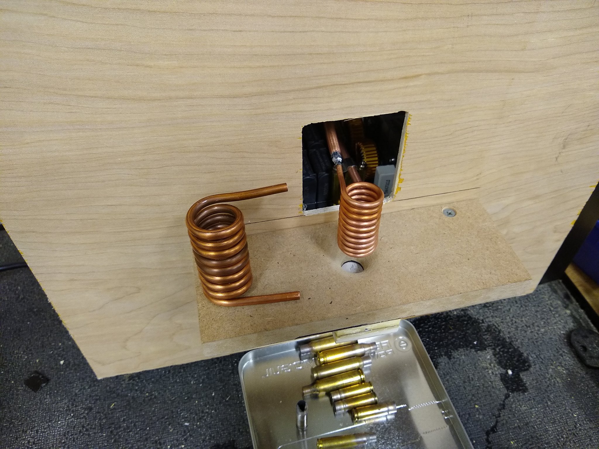

I finally had some time to play with a new coil and fired it up. Unfortunately the power supply I have is not up to the task being 48v. The current draw is simply too high and causes it to trip running anything larger than .223. I did try adjusting the pot down and it allows me to reach 38.75v but I am still pulling over 12.5A and tripping. Switching frequency measures 131khz on my fluke. It has LC 09 brass cherry red in 2.5s and will melt RP .300 BLK in under 4s, so the potential for very rapid heat rise is there if I add a second power supply and run it in parallel. I built a second coil from 3/16 and will try it as well before changing the power supply.

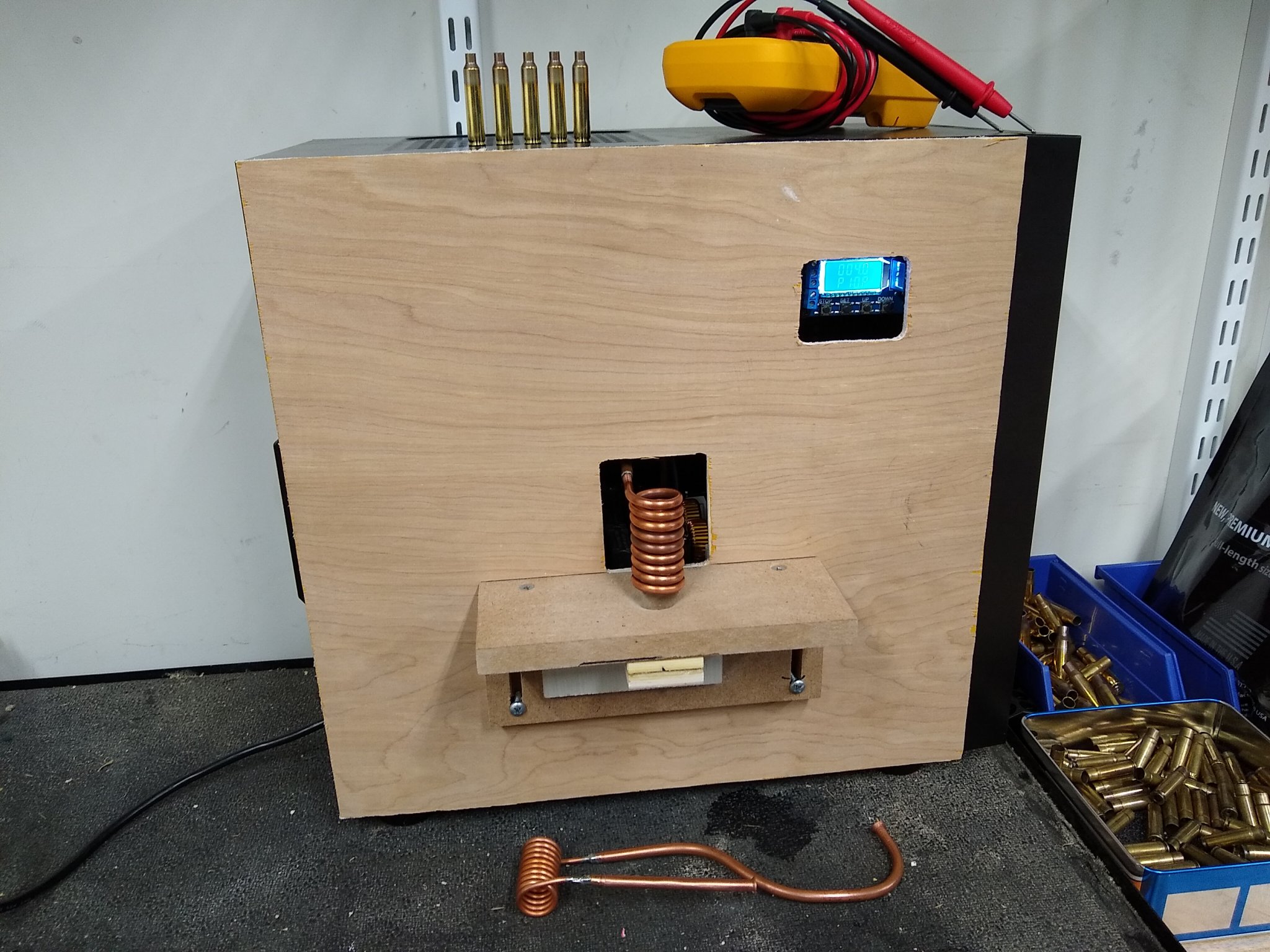

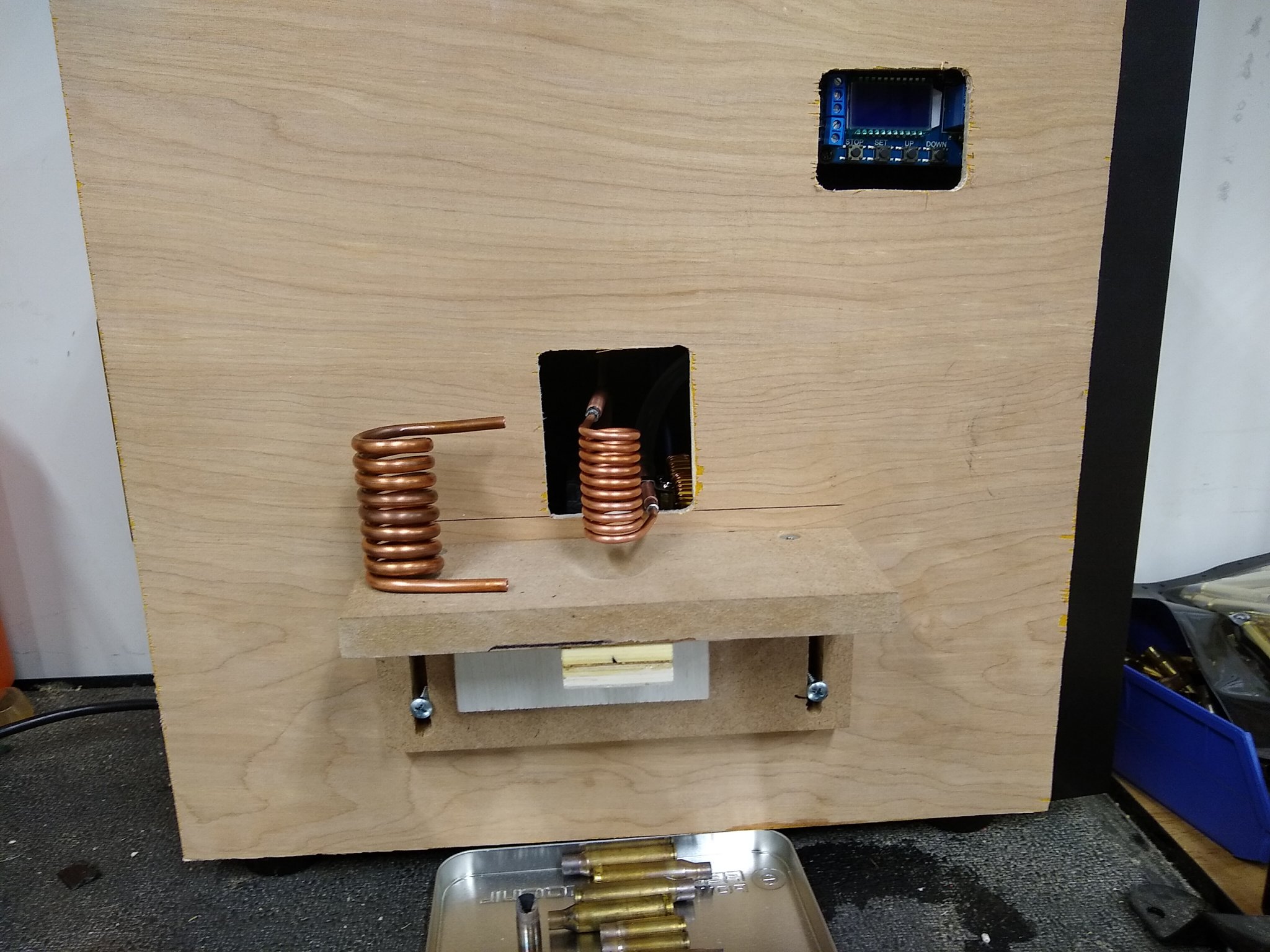

Is everyone just using different inserts to hold the case in the coil and on top of the trap door? I have mine up and running great, the only thing I have left to do is figure out the trap door.
On mine I just drilled the center of the wooden block for the specific caliber. If I need a new caliber I’ll just drill a new block appropriately.
I thought about doing that, I was just trying to figure out how to do that without having to reset the height on the solenoid for each case length also.
I gave the 3/16" x .75" id coil a test and with the 48v supply running at 39v it is not tripping with .308 and .260 Lapua brass. 204 Ruger brass and .223 is also working well. Now that is is working with my 12.5a current limit I can try raising the voltage and tempilaq testing to get each case dialed in and logged.

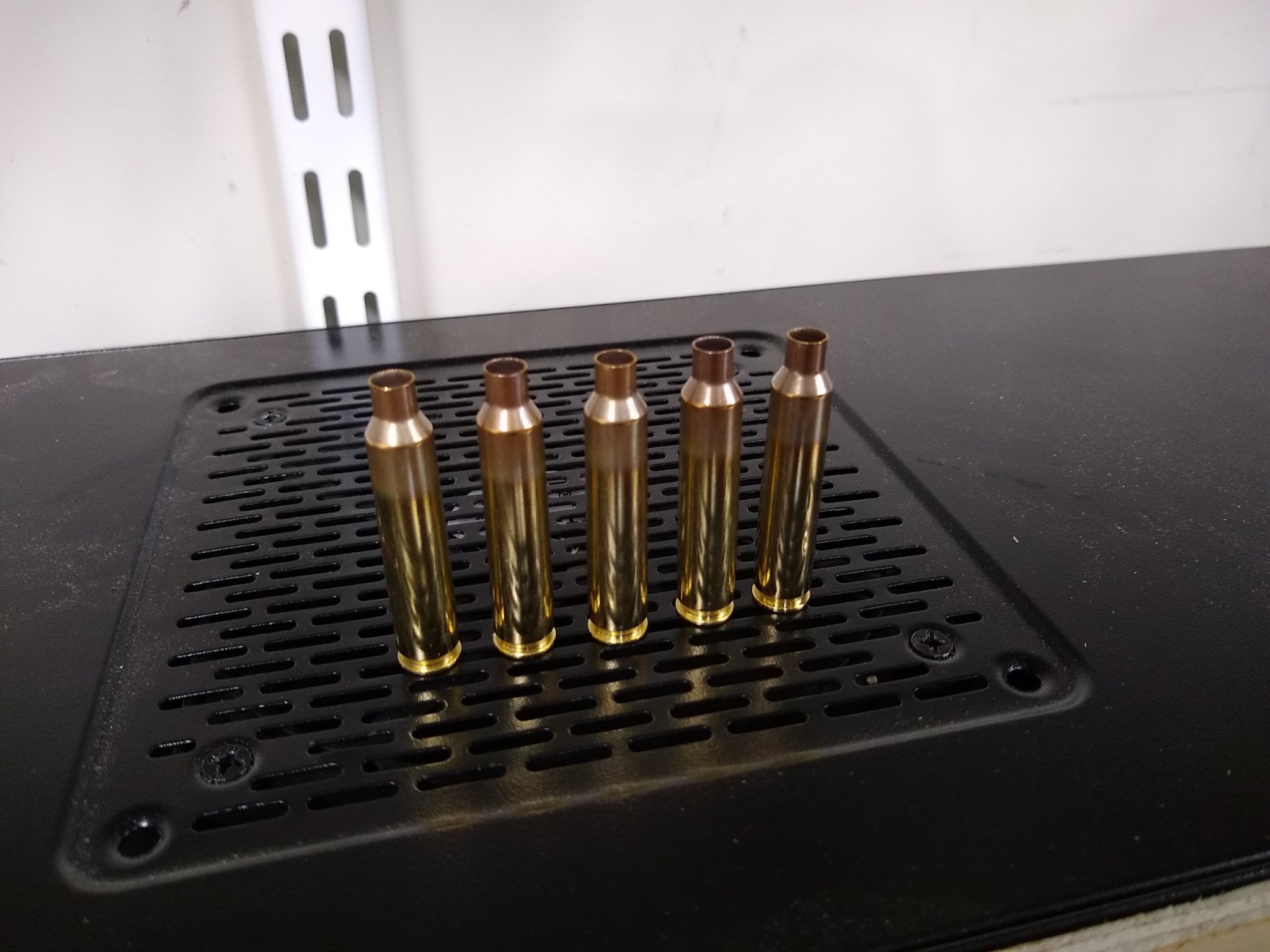

I ran some new brass I fired today and checked with the pin gauge. Literally 0.1 seconds made the difference between under annealed and just right on the tension/drag of the pin compared to a new piece of sized brass.
This is peak glow. The entire glow phase is about 0.4 seconds.
