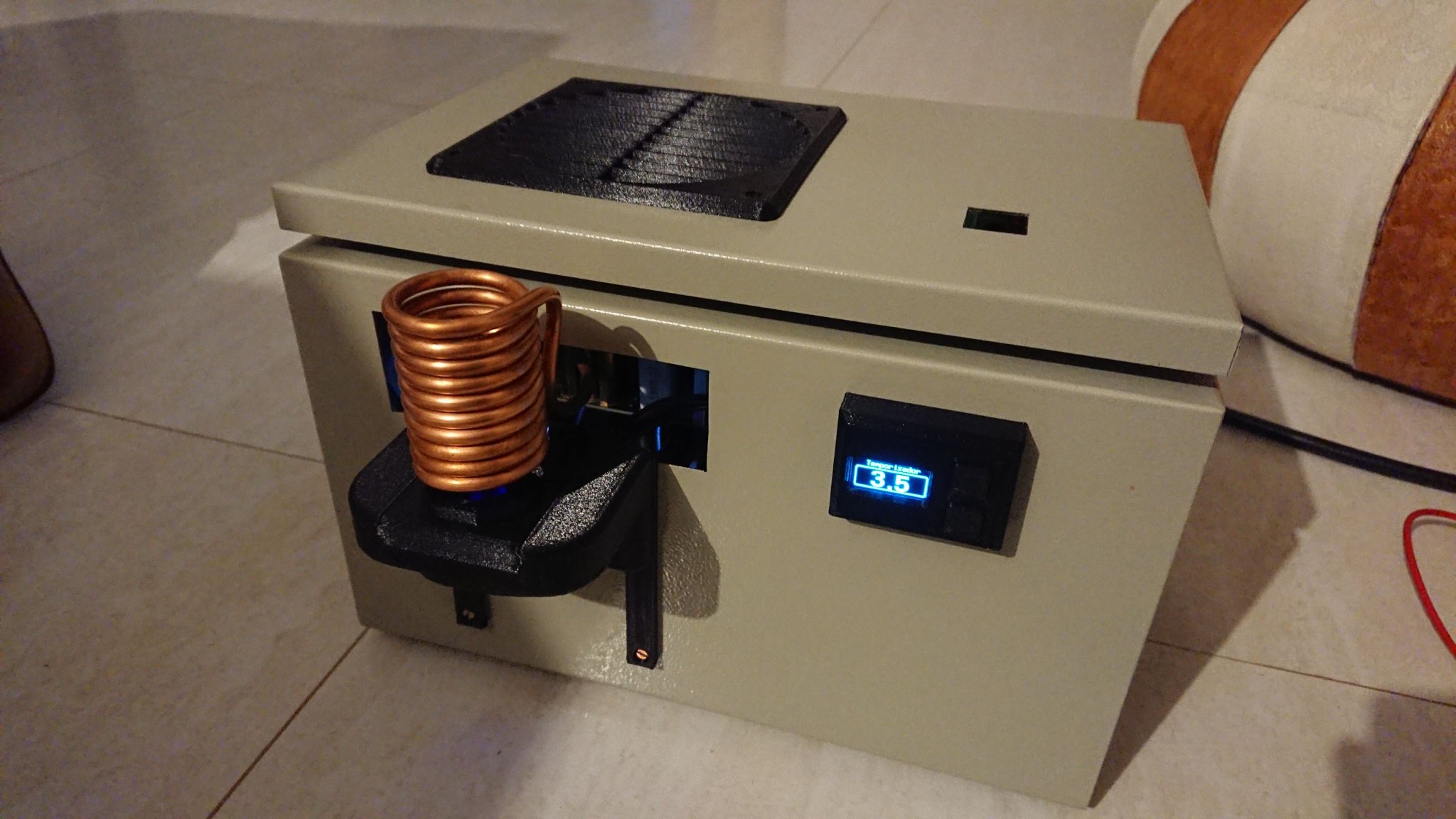

I've been building one based on this thread out of my old computer tower.
I ran into an issue when my water reservoir leaked, otherwise it would be pretty close to ready to anneal.
Here's what I've done so far on it. Once I figure out a new reservoir, hopefully I'll be able to hook it up and test it out on some brass.

Good luck with the reservoir, looks like it's coming together nicely though. Why did you go with that particular power supply supply? Seems like its specs are 24V-17A-400W? I was thinking of upgrading from my 48V-12.5A-600W supply to a 48V-15.7A-750W one.
I have the same 48v 12.5a supply and this board would benefit greatly having the additional current available.
Thanks! Actually in the hospital now after a new baby, so hopefully I'll get some time when we get home while momma and baby are resting to put the reservoir together!
I was just trying to imitate what @TSloper did. The power supply he linked wasn't available when I ordered, so I went with the next size up that I could find. I also don't remember perfectly without looking it up again, but it seems that some of the components (timer?) were only rated up to 36v.
I know there was some discussion about those bigger power supplies in this thread. The impression I got was that if I kept the diameter smaller, I didn't need as big of a power supply. I could be way off on saying that. It's been probably about 10 years since I messed around with inductance calculations, so I'm fuzzy on the math. Instead, I'm just trying to imitate and adjust.

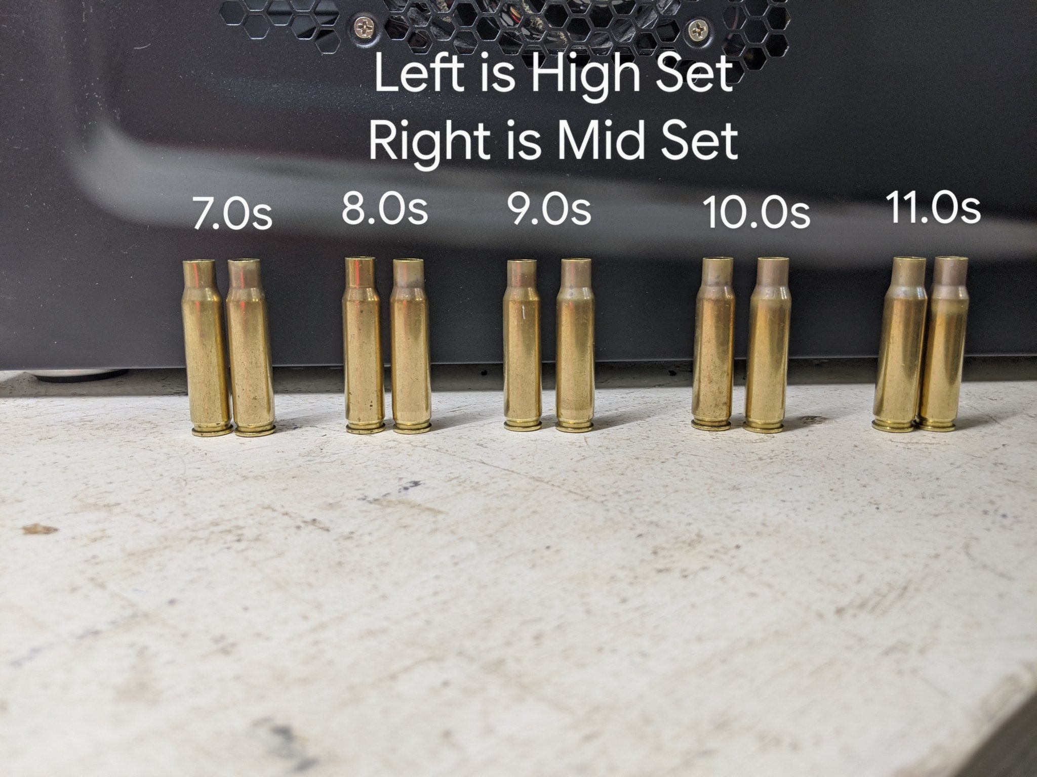

It appears that the height of the brass within the induction coil is important.
This is 308 brass at various times and two different heights.
The high set holds the brass higher within the coil causing it to have more brass within the coil.
The mid set has the top of the brass just above the middle of the coil which reduces the amount of brass in the coil.
This is appearing to concentrate the power to the neck and not put as much heat into the body.
I run my brass about half way into the coil. Shove too much in and it draws excess current heating the body like you are finding.
The further you insert it, the more current it is also going to draw.

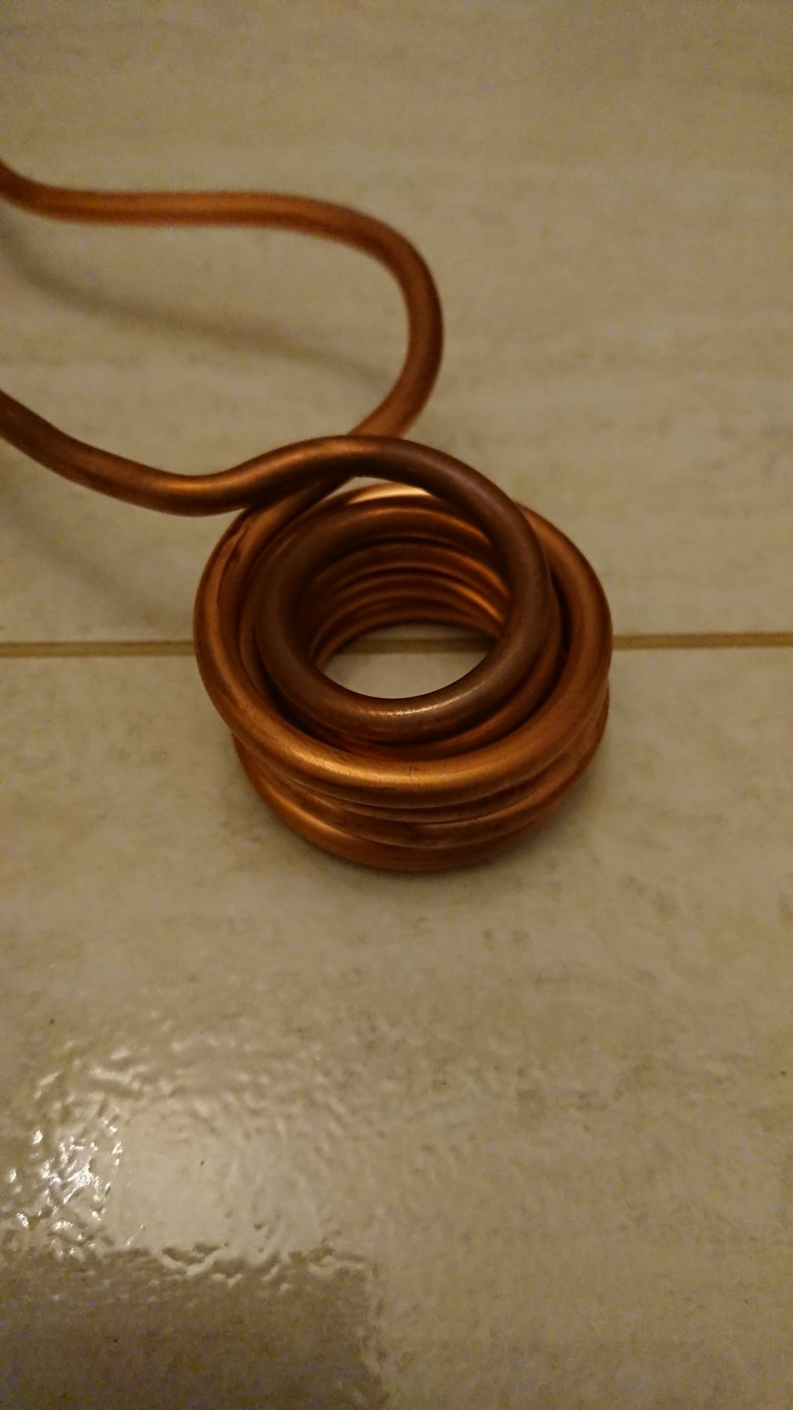

Testing with no brass is between 18 / 19A. If I just run twice, the coil starts to heat then the current starts to increase too. As heating increases, current increase too.
My power supply is fix. No way to adjust it! And it has a protection circuit, that deacrease a little the voltage (automaticaly)in order to limit the current at its maximum (20A). But if works too high, it will blow the protection fuse.
I'm thinking to develop a doble layer coil, trying to increase its inductance and keep the lenght short. My actual coil has 9 turns of 3/16... it is very long!
My project was very well designed! Including with my own control circuit and many parts many in 3D printer. Also, the "release door" for the cases I made it with a servo motor, instead of a solenoid. Works very smooth and precisely, with some sensor to detect the presence of the brass at the tray.
*** I just tested now another coil I had tested with the 24V supply. It was the best setup till now, with my 48V supply, but still give me over current (20A) but not it's making smoke with only 3.5 seconds. I'll do another doble layer coil, with 1 and with 2 more turns and see how it works. At least, with 3/16 tube, this coil keeps with smaller lenght.
* Please don't consider this coil the best made, hahaha.... was one of my first made, so not that good as the last units
That sounds like a very high current for no load. Are any of the coils touching each other? There should be some clearance the whole way.
Your coil also looks larger, my coil from 3/16 is 0.75" / 19mm inside diameter. I'm not an engineer so I don't know how the diameter relates to idle current draw, but the smaller coil I have draws much higher current when using the same brass
I saw the same. Smaller coils, increases current. So in my project, which has high current with no load, always give me over current as soon as I put a single mm of brass at the coil center.
I just post my other tested coil. Double layer, 4 + 4 turns. By the way, none of my coils have shorted any ring (touching). I made my own tools at 3D printer to made perfect coils and with the same pitch and the same rounded axial body. So, about problem with this, the chance is zero, hehehe!
I'll try to make another double layer coil, with one more turn. This last test gave me almost lower than 20A, but still going over. With no load, now I got 15A. Which is good! Almost there!
Are your current directions the same or counter in your double coil?
I made the same question to myself when I was reading about double coils. As far as you don't change the TURN DIRECTION, you can go up and down while turning. Like radio coils, with too much turns, it's impossible to turn just to one way (up or down), but turns always to the same turn direction (axial meaning).
I don't know how to explain, hehehe, but that's it. It works!

Today I did another double coil, now, 5 + 5, ID 30, and guess what: I did it work at 9A with no load and 12A with a 308 brass. Now, I will try to setup a better one, to make it work at 16A, as I have a 20A supply, and decrease the time for the 308 anealling.
Excellent. How long is it taking with the 30mm ID 2X coil? It should be able to have some very nice speed I think once you get it in the "sweet spot".

Unfortunately I had to stop the tests. My supply had some burnt smell, even no problem while runing. I called my supplier, who did that special power supply for me (mine has 48V 20A and 12V 5A at the same power supply, in order to run the zvs and my other parts of control). I stopped the tests at 7.5 seconds, almost anealled 308 brass (almost glow red) but still I see that might need some more ms or seconds to setup and reach the proper anealling (I don't have access to temperature painting here like many others do, so I am running it by now just checking the small red glow target).
With the new setup I'll try after I receive the new power supply, I'll decrease 1 or 2 turns (maybe inner turn or outer turn) testing the current aiming to 16A with 308 brass at half coil height position. That might be perfect setup. Hope to give some good news soon! :)
Another thing to mention that I nearly forgot...
While testing I noticed that the metal computer case where the coil passed through was becoming warm, so that is why you'll note my case panel is cut out with most everything being replaced with plywood and MDF. It is probably a small effect, but I imagine there is a small additional power draw from the coil being quite close to other metals.
I have a window close to the coil exit. I did it thinking about that problem of possible magnetic field concentration at this metal face. A window of 1" far from the coil part that goes thru the plate should be fine (actually I made it bigger thinking to pass the whole pcb thru the windows but I changed my mind and now I just have a bigger window that I suppose to be good enough, and also, my coil is 1" far from the plate face.
