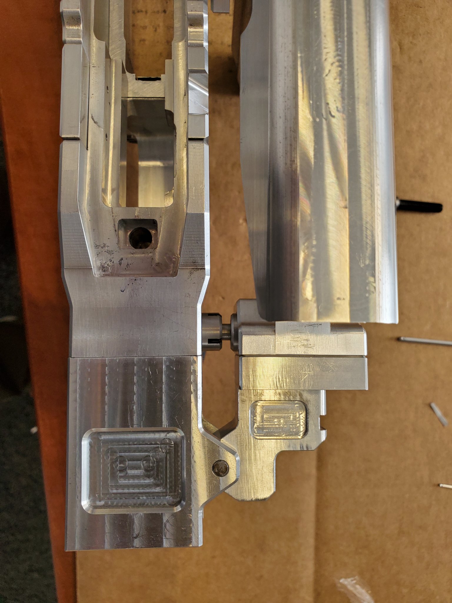

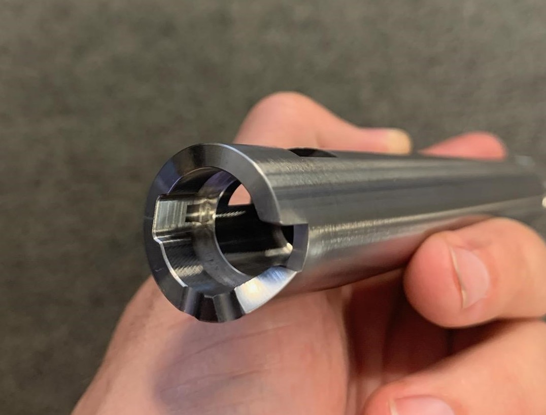

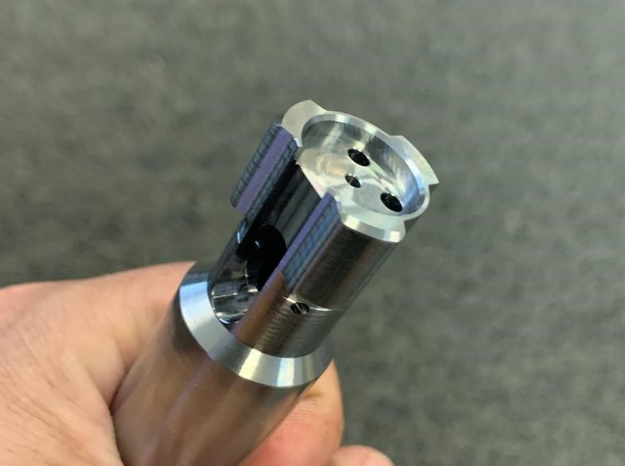

Hi,
I shall introduce you to the pain in my ass Aermet 100 bolt, lol...
Production models will definitely be RAM EDM internally as this shit is unique in properties to say the least..
One more operation and it will be complete!!
View attachment 7478105View attachment 7478106
Sincerely,
Theis
Just out of curiosity, what is the machine time on that bolt? Pretty awesome to see things start coming together. 🎉❤️
Hi,
Whewwww, would have to go through and add all the different operations up to give you a total time but it will not be a realistic production time because we did not want to screw up the alloy or any of the tooling on our inaugural utilization of the alloy so things were done as slow as possible yet still cut.
Just the 6mm tool bit used where the internal stepped down in the bolt body from 12mm to the 6mm was $300 and good for a single use due to the tolerance we want in that from bolt to bolt...THAT is why the production bolts will have that hole and step down done via RAM EDM.
Sincerely,
Theis

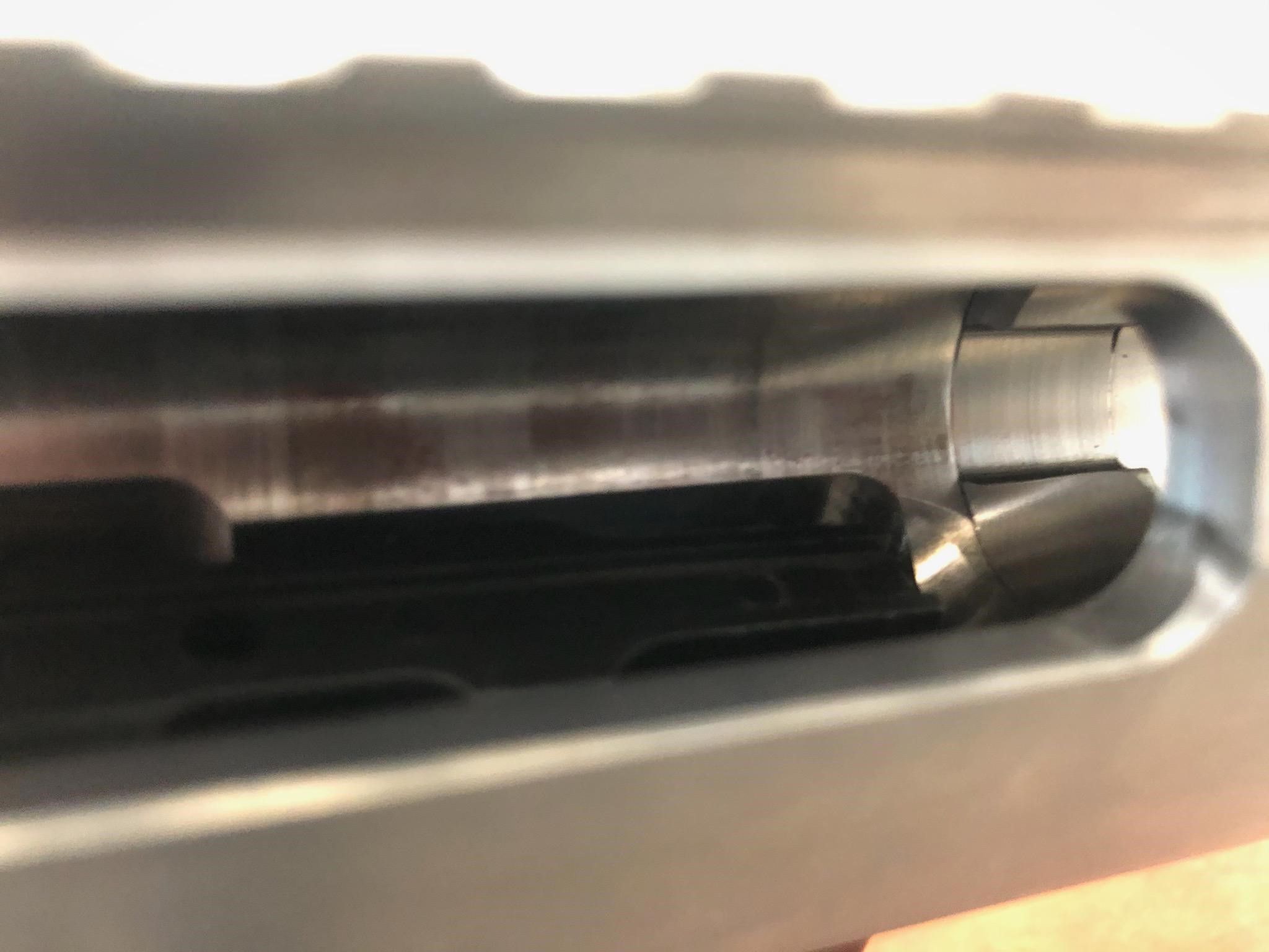

Hi,

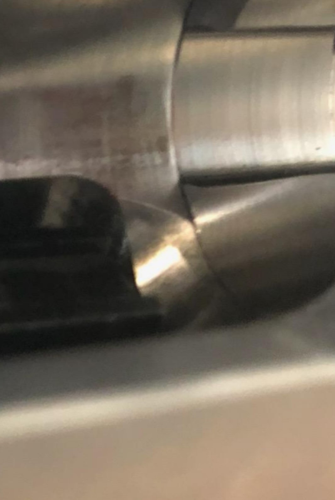

Today's update while I grab dimensional screenshots for updates later this week.
The receiver feed ramp transitions to the breech cylinder feed ramp very nicely!!

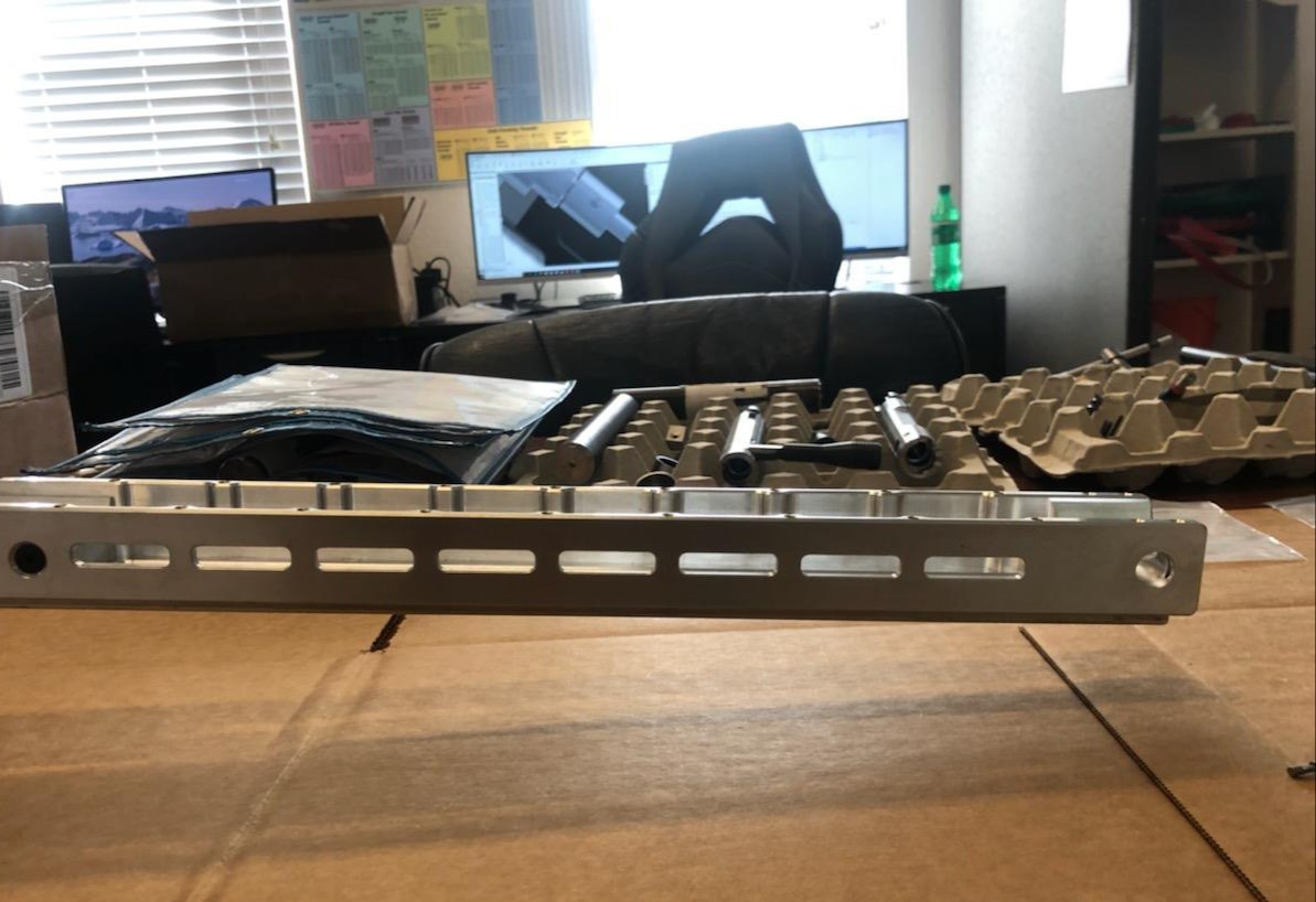

The magazine sits pretty nicely too :)

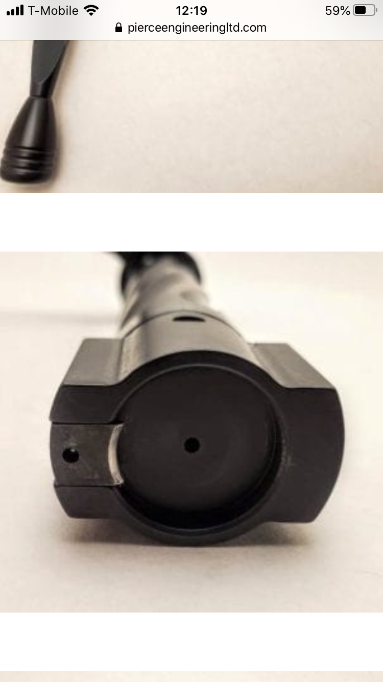

Any plans to make the bolt without any ejector plugs or holes? I’m a fan of manual extraction like how Pierce Engineering offers that option.
Hi,
Absolutely not. No need to since anyone that wants to manual eject over the plunger ejectors can just take the plungers out. But as far as us producing a bolt without them..no.

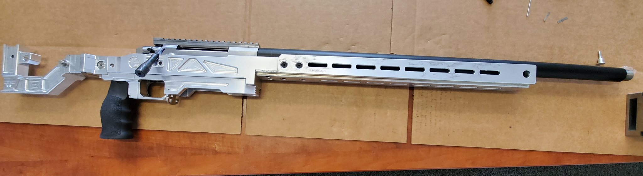

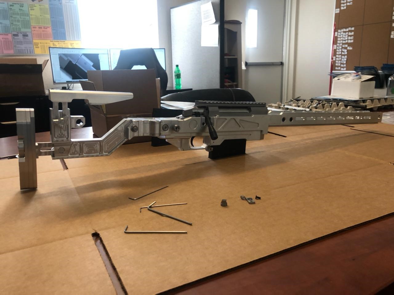

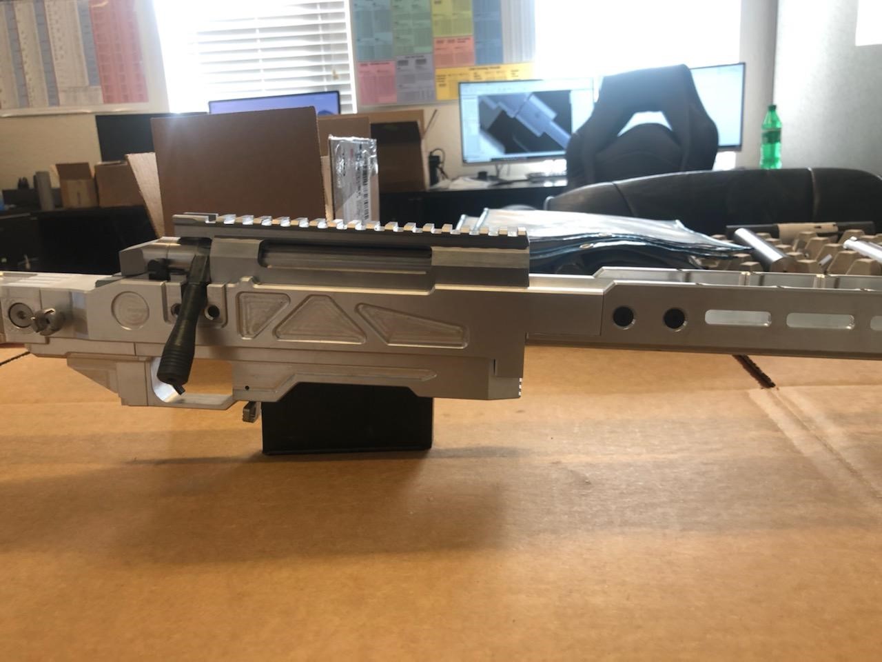

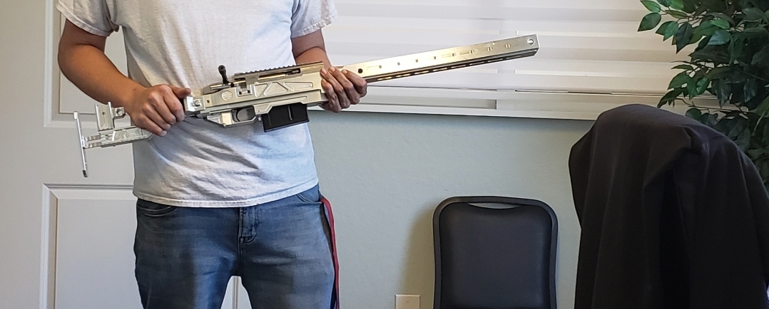

Happy Thanksgiving Update Everyone,
I will put up the dimensional screenshots between tomorrow and Friday.
So until then this is where she is staying for the weekend.
Sincerely,
Theis

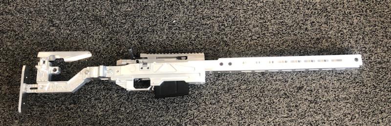

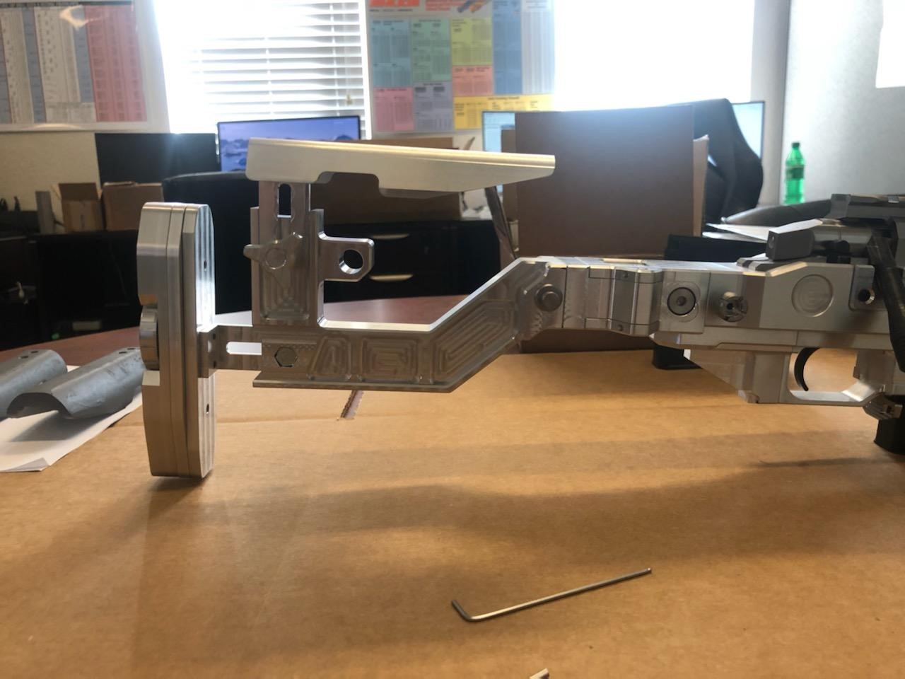

View attachment 7482471View attachment 7482472View attachment 7482473View attachment 7482474
Sincerely,
Theis
Imma beat the hell out of it
Reactions: AMGtuned
What would it take to add some level of "switch barrel" feature to this receiver design? My Terminus Zeus action returns to zero so well it really surprised me. Wondered if something similar could be an option, or something like what AI does? This thing s looking really cool. Love the idea of an expensive rifle that allows easy caliber change!
Hi,
Current design is focusing on higher operating pressures rather than "in the field" switch barrel capabilities.
Our tolerances from receiver to receiver are going to be held tight enough that we will have prefits available.
We are making the system capable for the consumer to switch barrels at home or from vehicle with a few tools.
The barrels will have wrench flats on them.
Finishing up design on a magazine adaptor that is used in a normal vise to hold the rifle while consumers remove barrel.
We will have an independent shooter testing the rifle you see in the progress pictures and one of his testing will be testing the barrel torque indicator line system.
Sincerely,
Theis

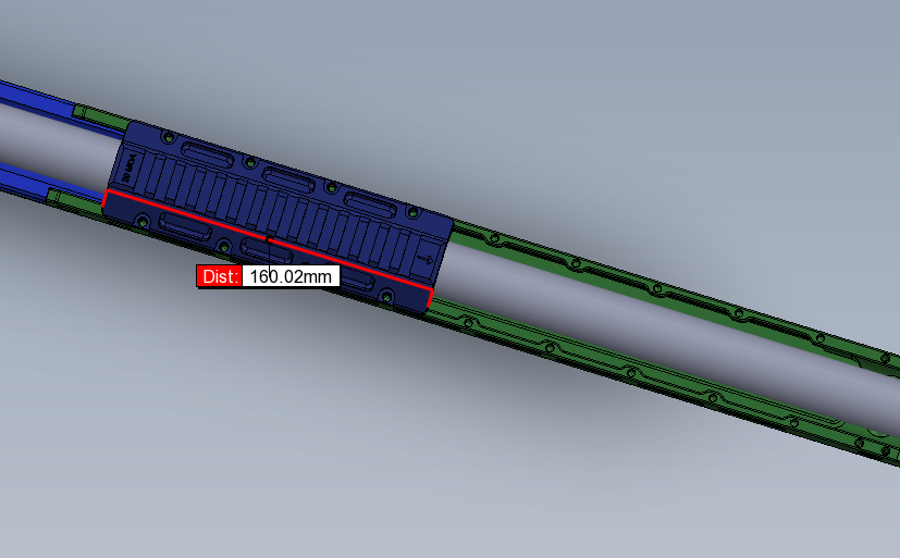

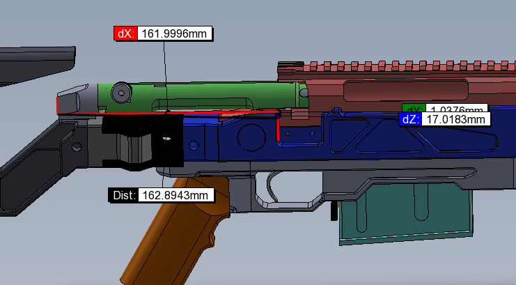

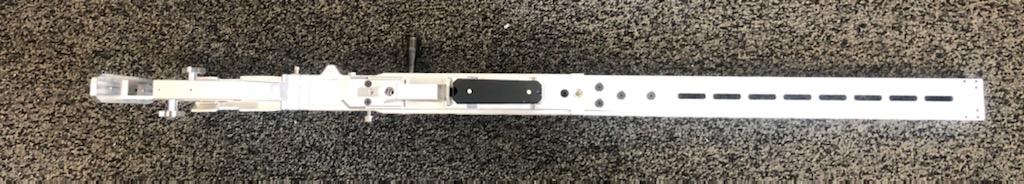

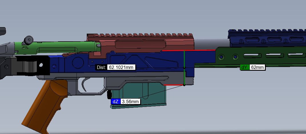

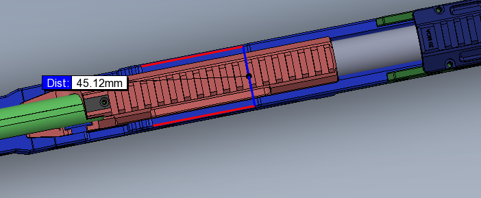

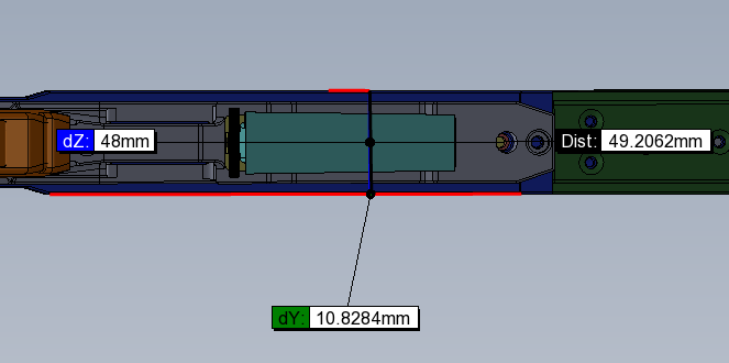

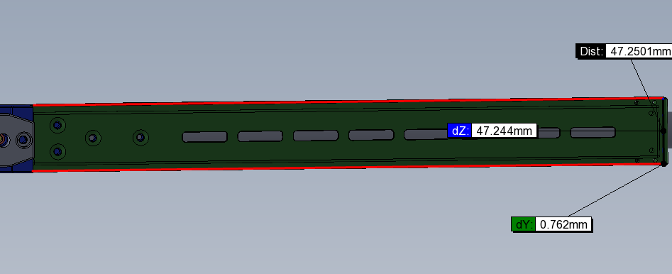

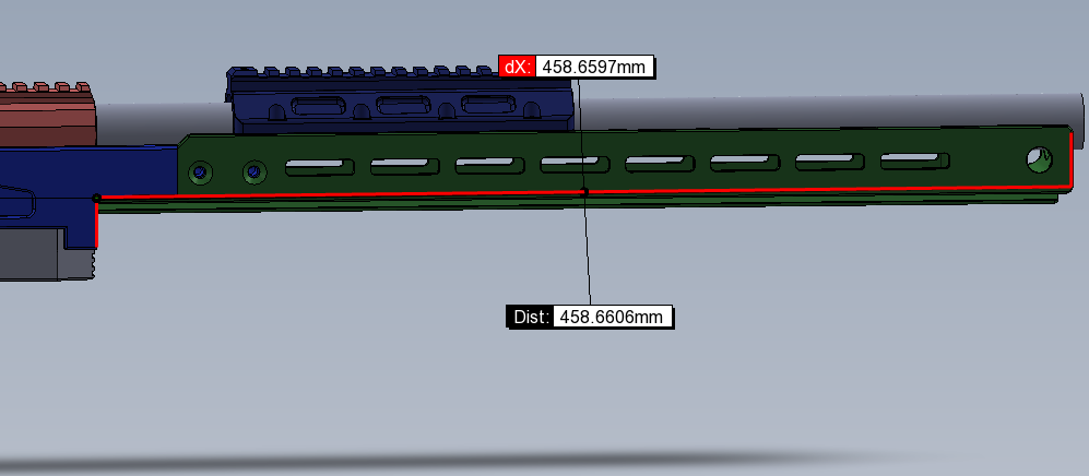

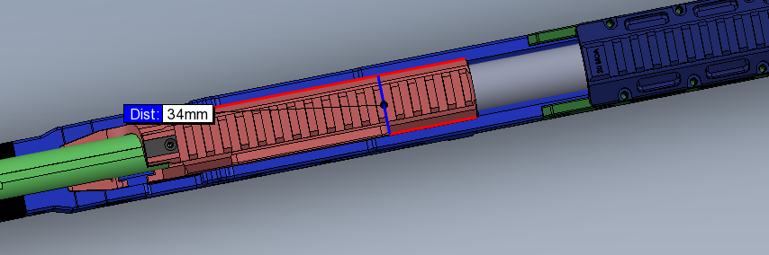

And now for some dimensional screenshots.

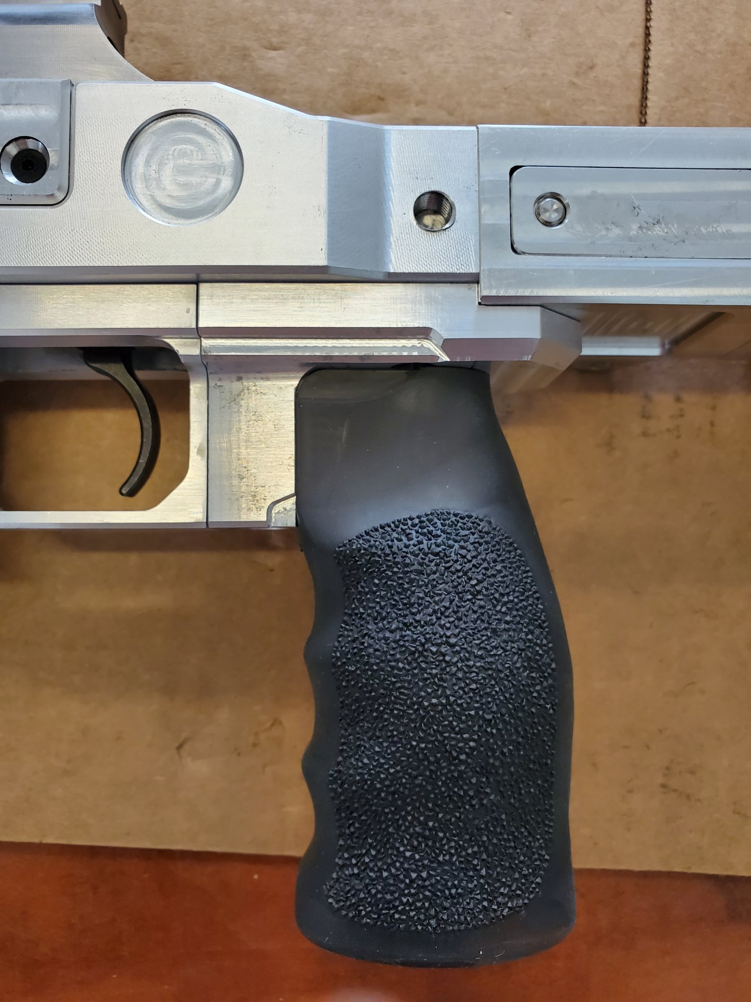

Your stock might flow nicely with one of these (option attachement) by another member
I've shot with a MPA chassis for several years and have liked it as well as any chassis I have shot. That said, something
I've noticed is that I always felt that my rear bag was either to tall or to short for a consistent squeeze/elevation hold.
I went to work trying to come up with a solution. After a few versions this is the answer to this question:
Elevation adjustment is easily achieved on the clock and consistency is enhanced with a more light/relaxed squeeze.
I've been using it on my Vudoo/MPA and 6 Creed/MPA for several months.

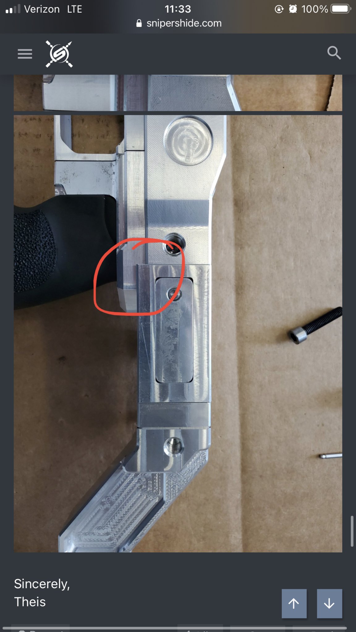

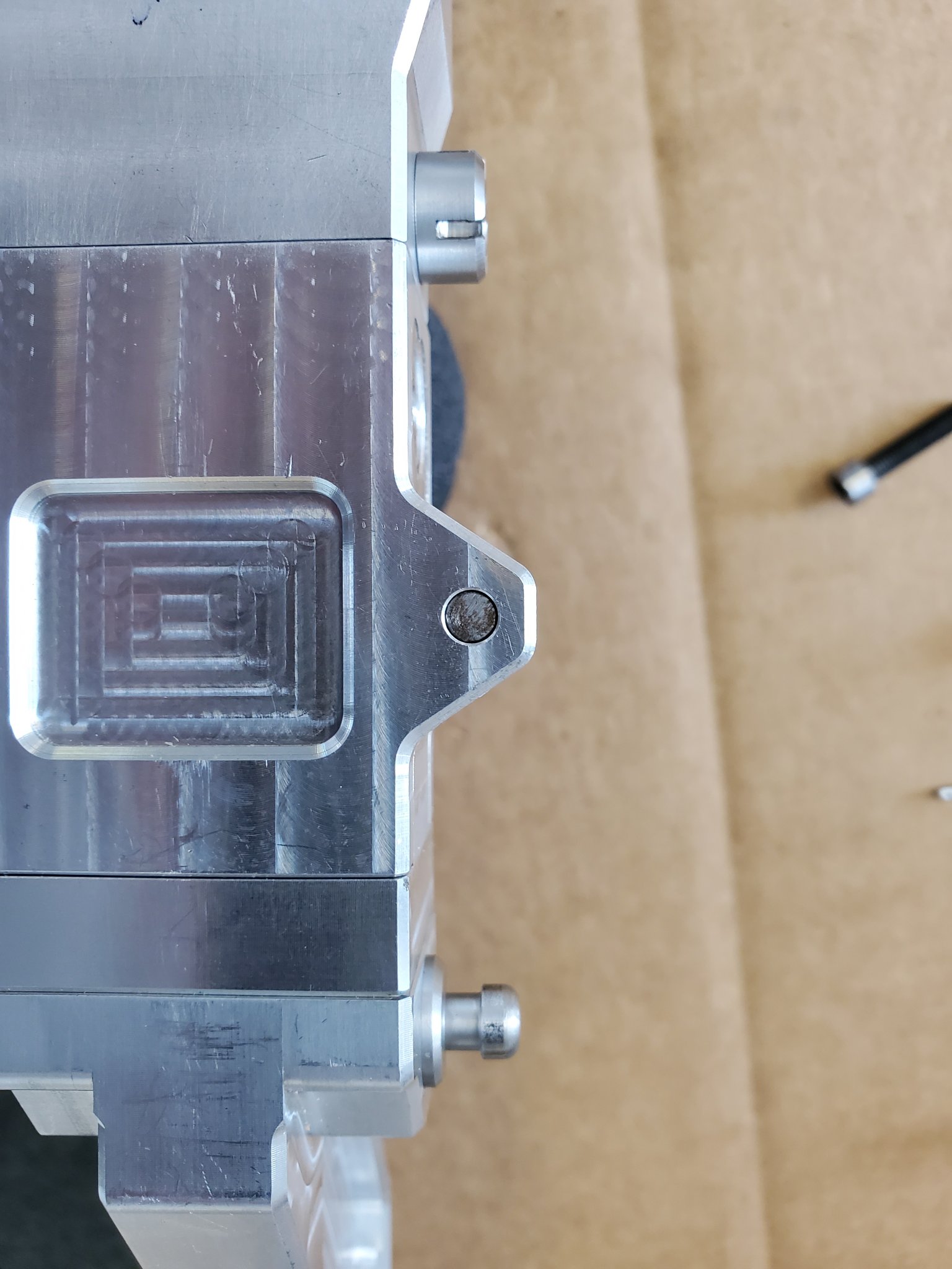

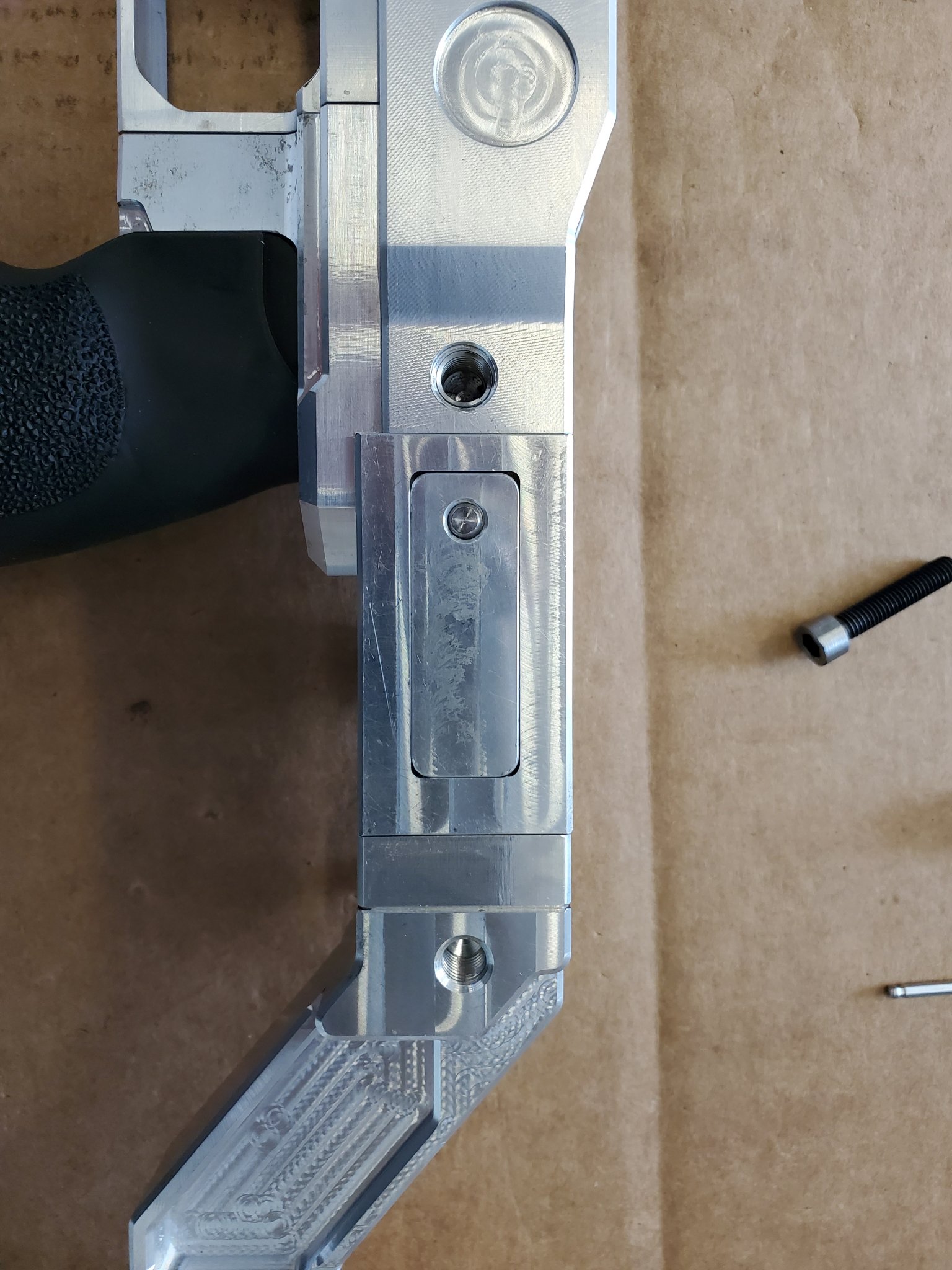

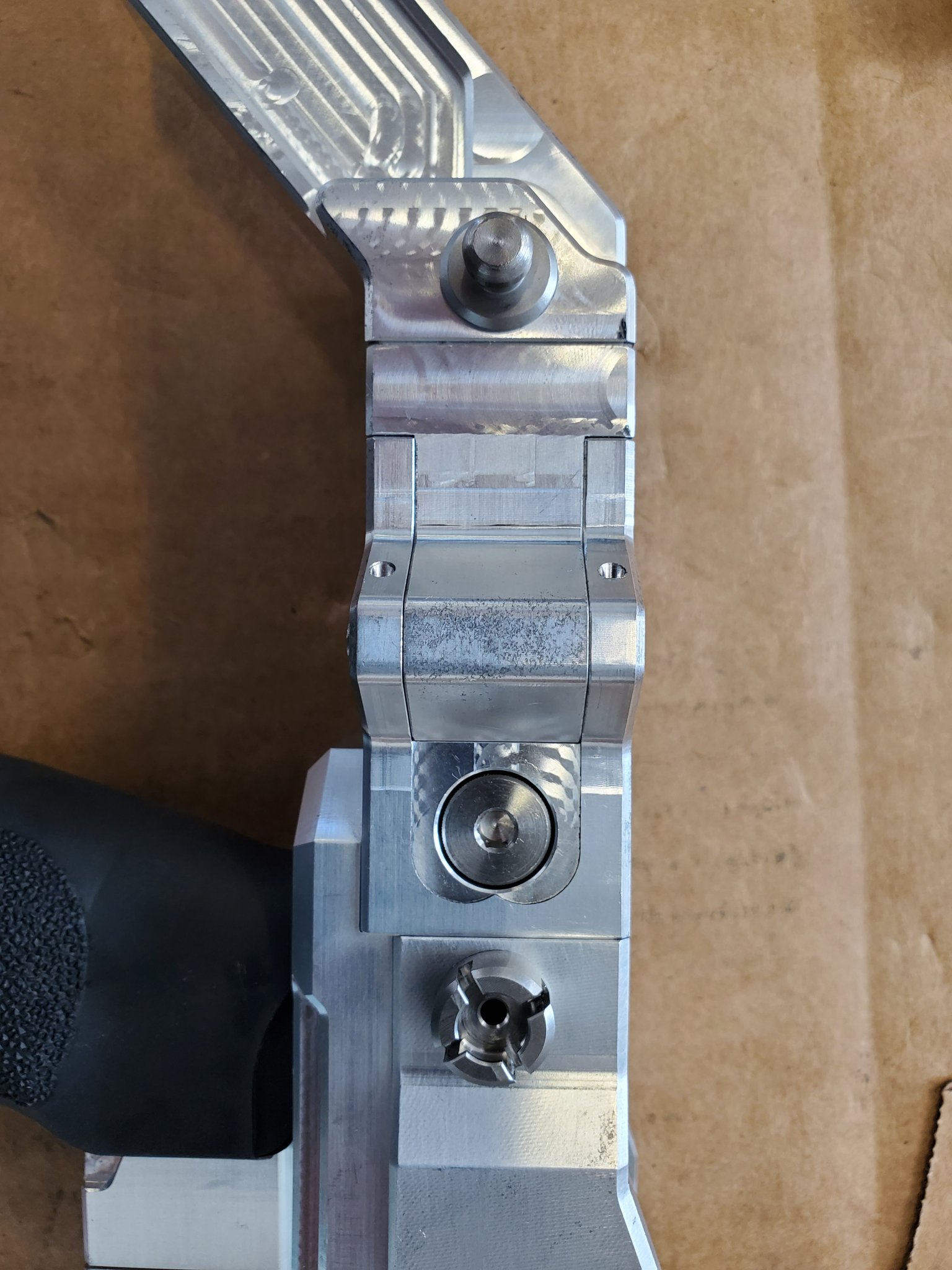

Anything that can be done about this corner? It looks like it could be annoyingly stabby at the most irksome times. Also it pains my visual design sense worse than the misaligned lines between the KRG chassis blocks and forends...
Potential thought: where the chassis bumps out just above this as shown, have the chassis blend down towards that line.
