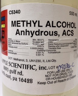

This is what I used on expensive coated camera lenses, it’s an old bottle and this stuff will kill you if care is not exercised during its use.

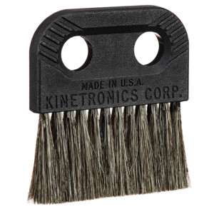

I forgot to mention the Kinetronics anti-static brush which I don't think you can go wrong with; just keep your paws off the bristles (oil residue), vac it occasionally, wash w/mild soap and distilled water every "blue moon"/never is preferable.
Always keep these brushes in their little jewel cases when not in use instead of loose. They of course come in various sizes.
