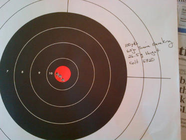

How about your trigger???? I changed mine to a Geissele SSA-E and what a difference. On sand bags with the SSA-E you should be able to hold on a 30 caliber hole in your target every time you squeeze off a shot. They aren't cheep $230, but worth every penny.
I have a Colt M4 LE6920 and my buddy has a 6720 which is a 5.56 and has a very skinny barrel compared to mine would shoot 2" groups at 100 yds. After he put in a SSA-E this is a common target with his reloads.
I haven't shot mine with the new trigger yet, but I'm sure it will make a big difference.
