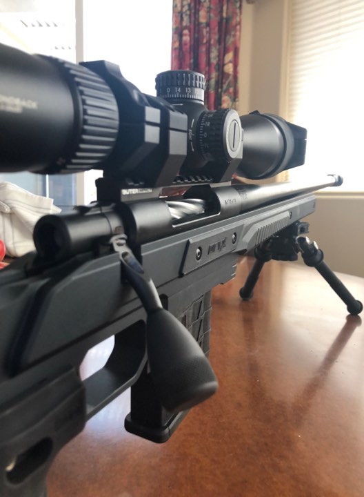

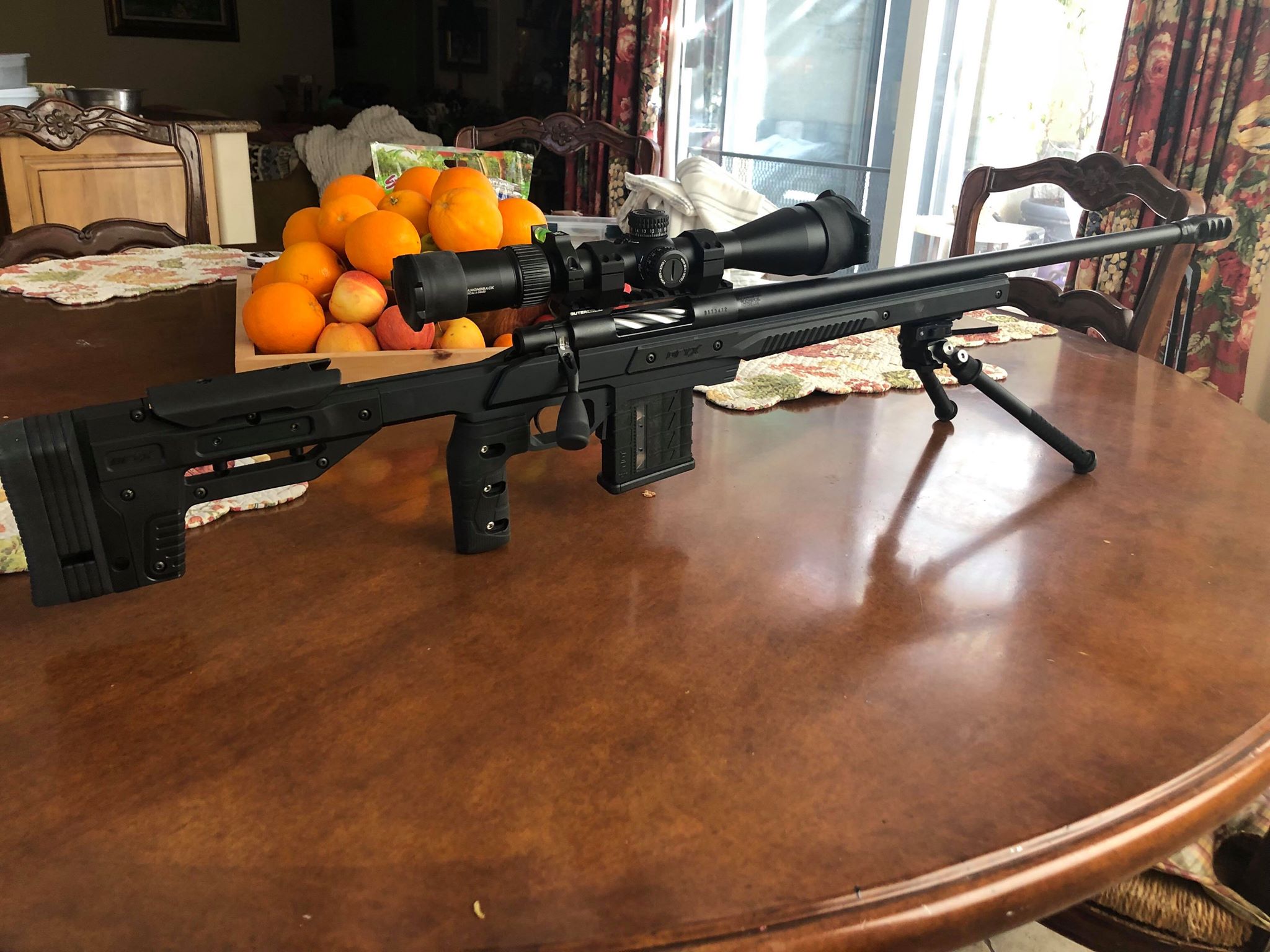

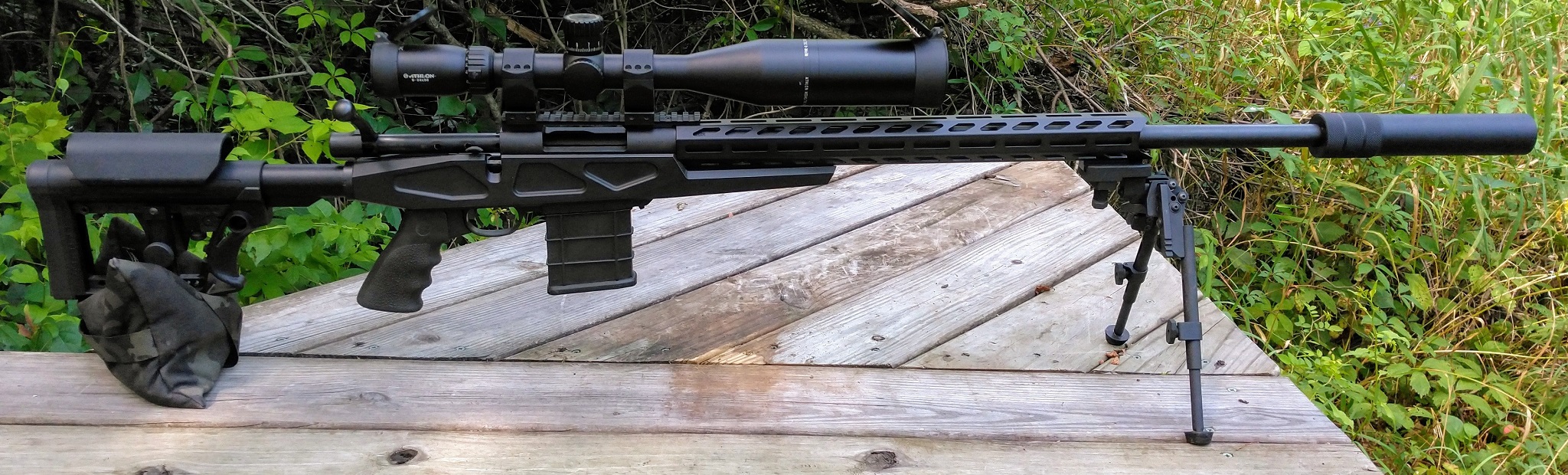

I just finished an Oryx build on my 24" Howa 1500 SA, i am devasted to find my 24" did not come with a threaded handle for 5/16-24 bolt knobs. My brother who built his 6mm 1500 SA has a threaded bolt handle. Besides sending mine out to a gunsmith or getting a clamp on style knob, is there a way to replace the bolt handle itself?
Thanks, will post pics soon
Can't help on telling you how to replace the bolt handle.
But would you mind sharing with us where yo ur brother got his and where you got yours from? I'm considering a build pretty soon and if I end up getting another howa to build off, I'd probably prefer to have the threaded bolt as an option.
I ordered mine from Brownells, as they have some sales running still but mine was during the holidays, so a 6.5mm 24" heavy barreled action was about 499$ and i bought the MDT Oryx chassis 399$. I love it ill post some pictures up here in a moment. But if i could go back i would contact brownells for them to give me options on ones with the threaded bolt handle, at this point it looks like ill have to send it off to a gunsmith to have it done.

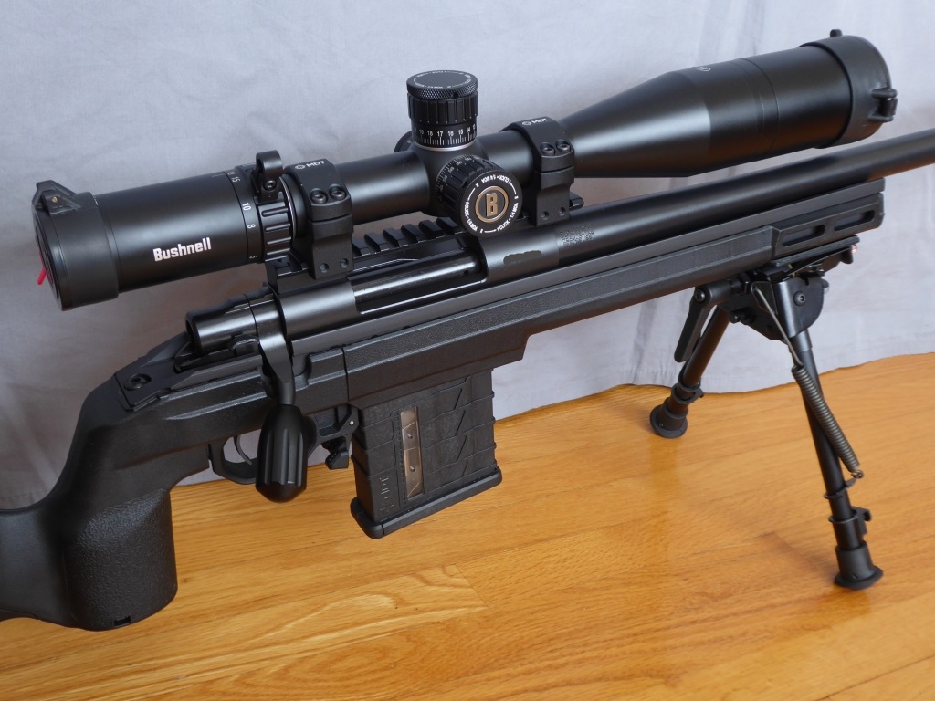

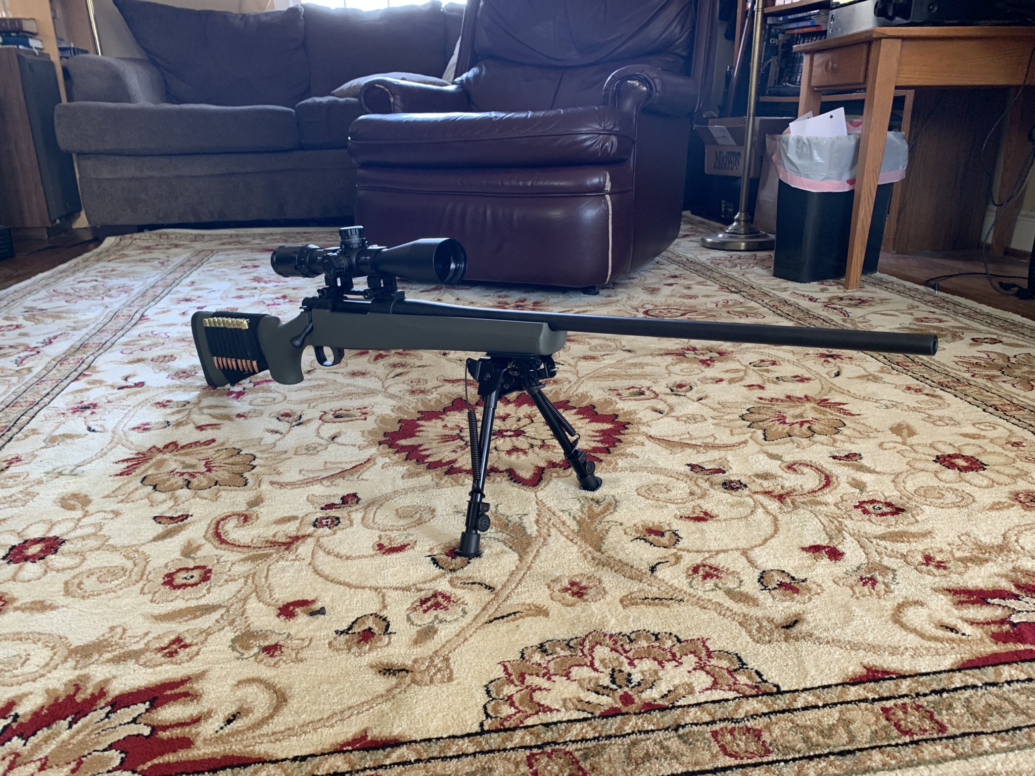

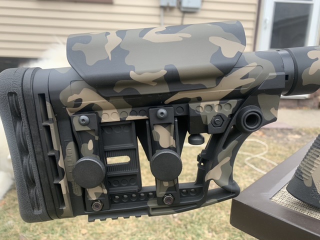

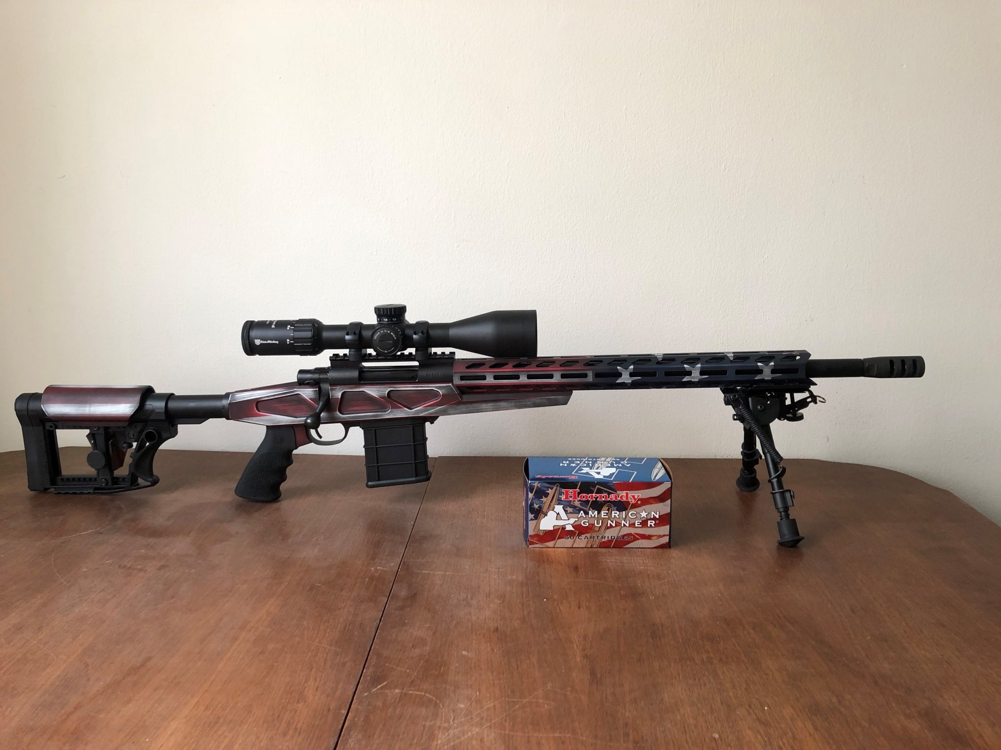

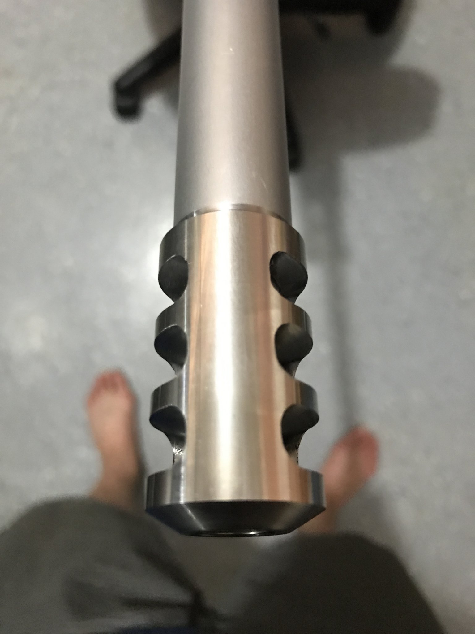

Have gotten around to getting my 1500 into a KRG Bravo and have a custom muzzle break installed. Will become my NATO class PSR Rifle in .308. Developing a load with 175gn Berger OTMs

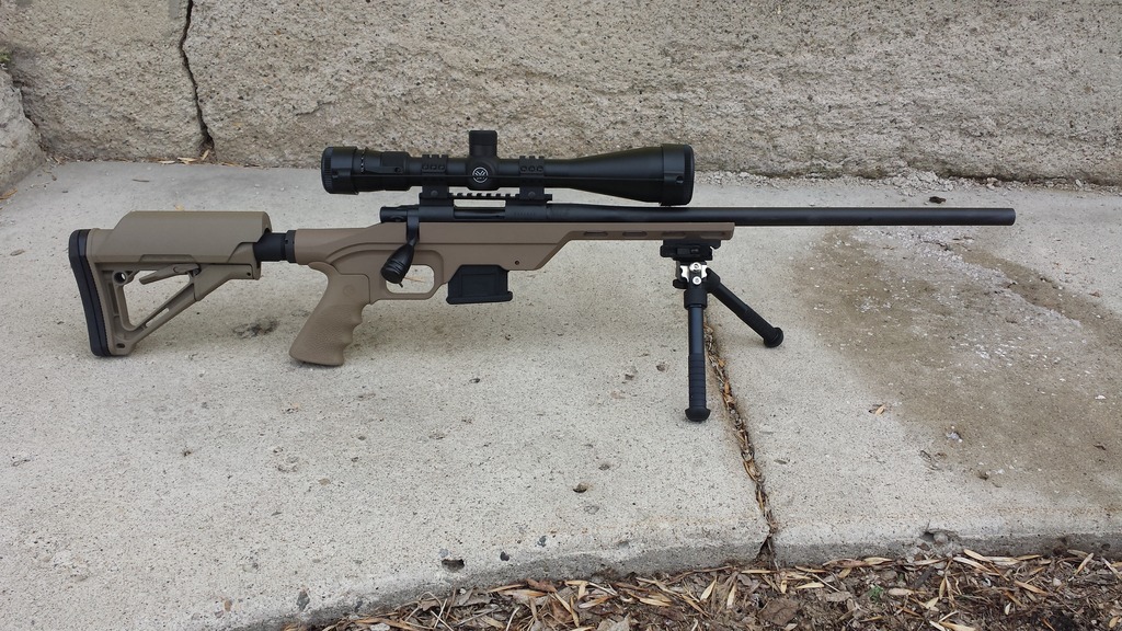

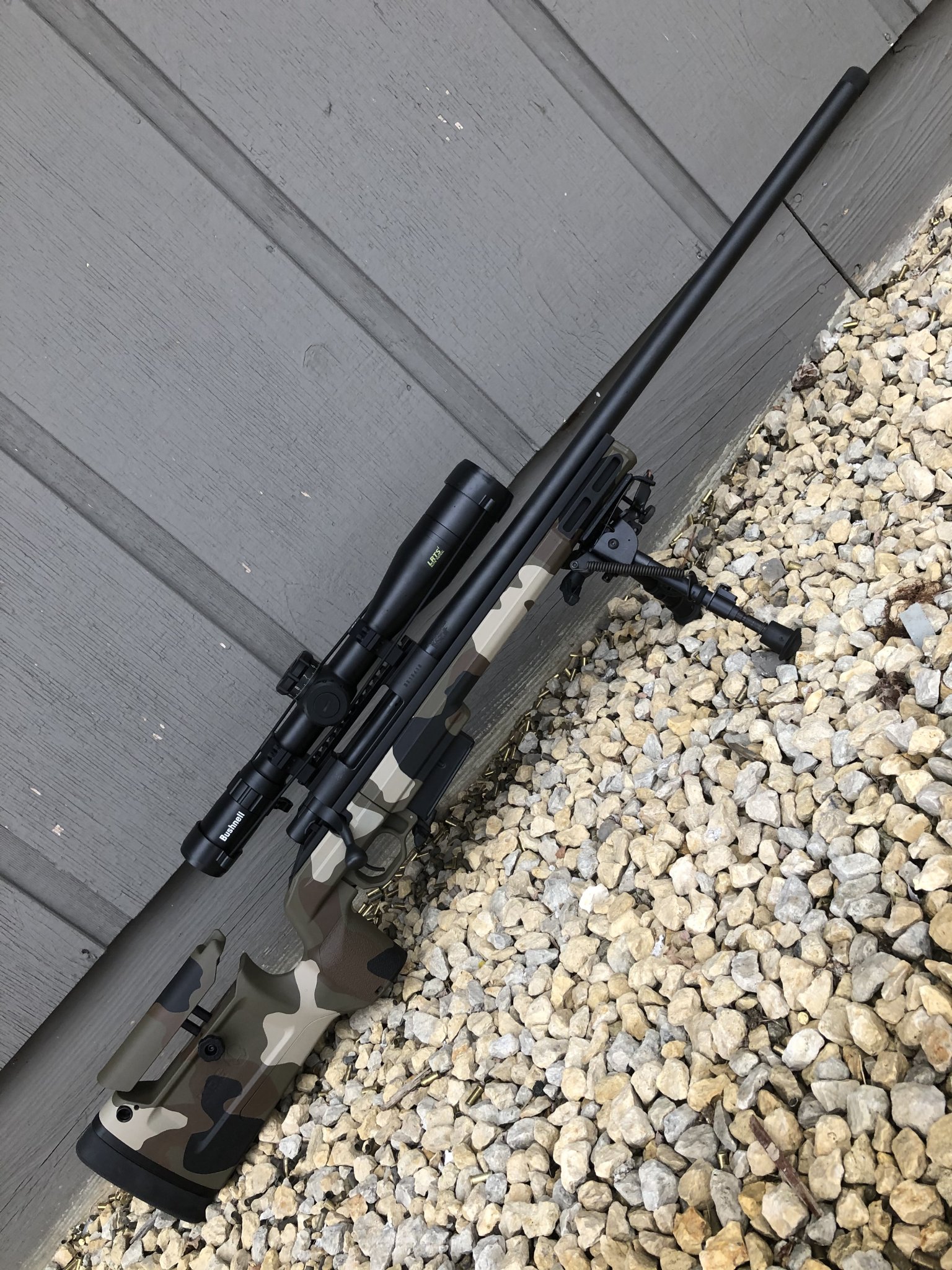

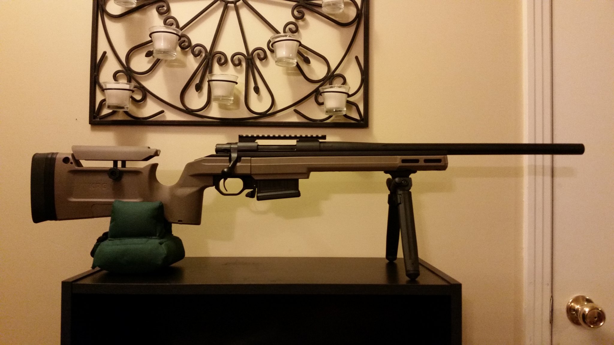

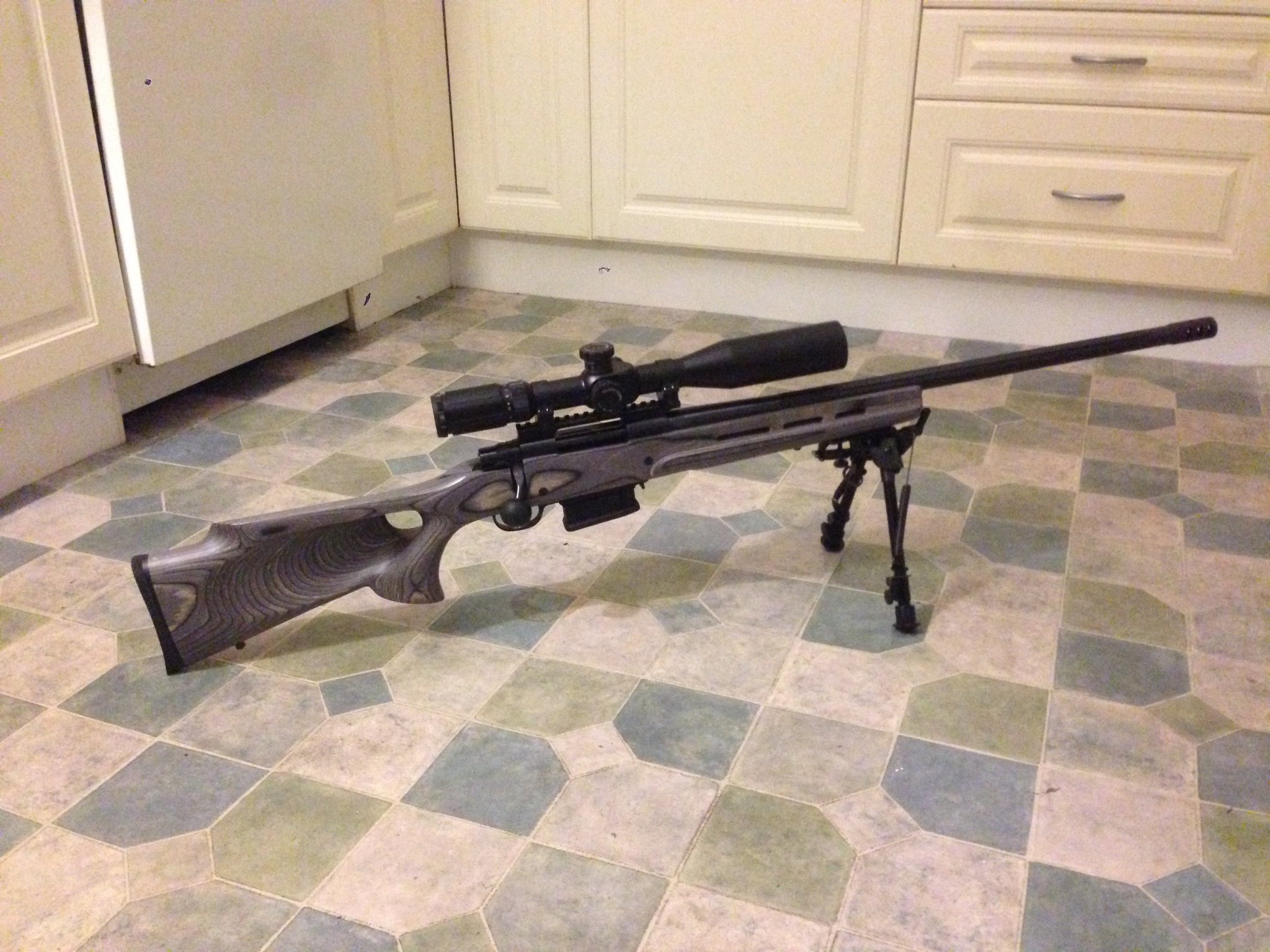

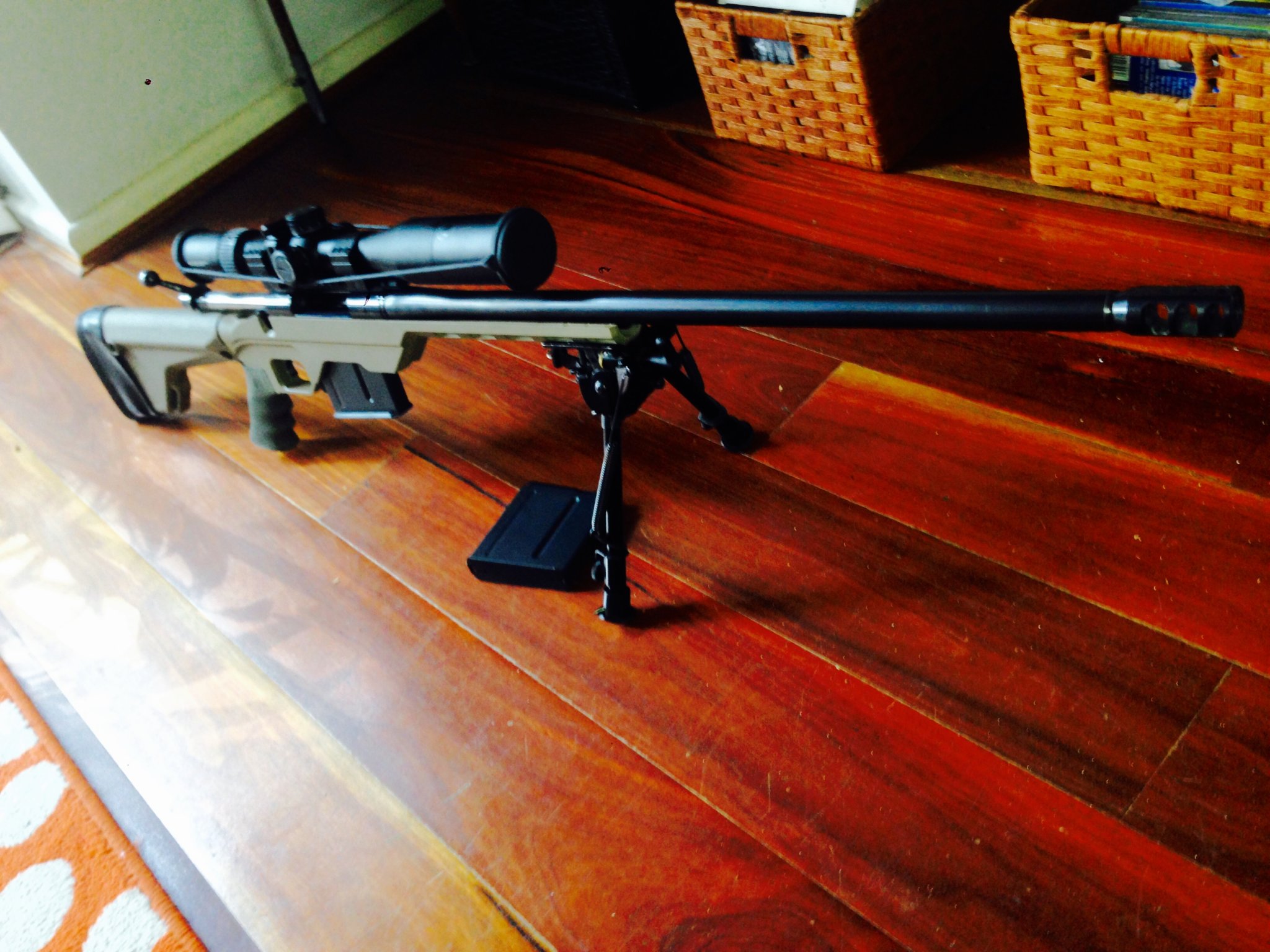

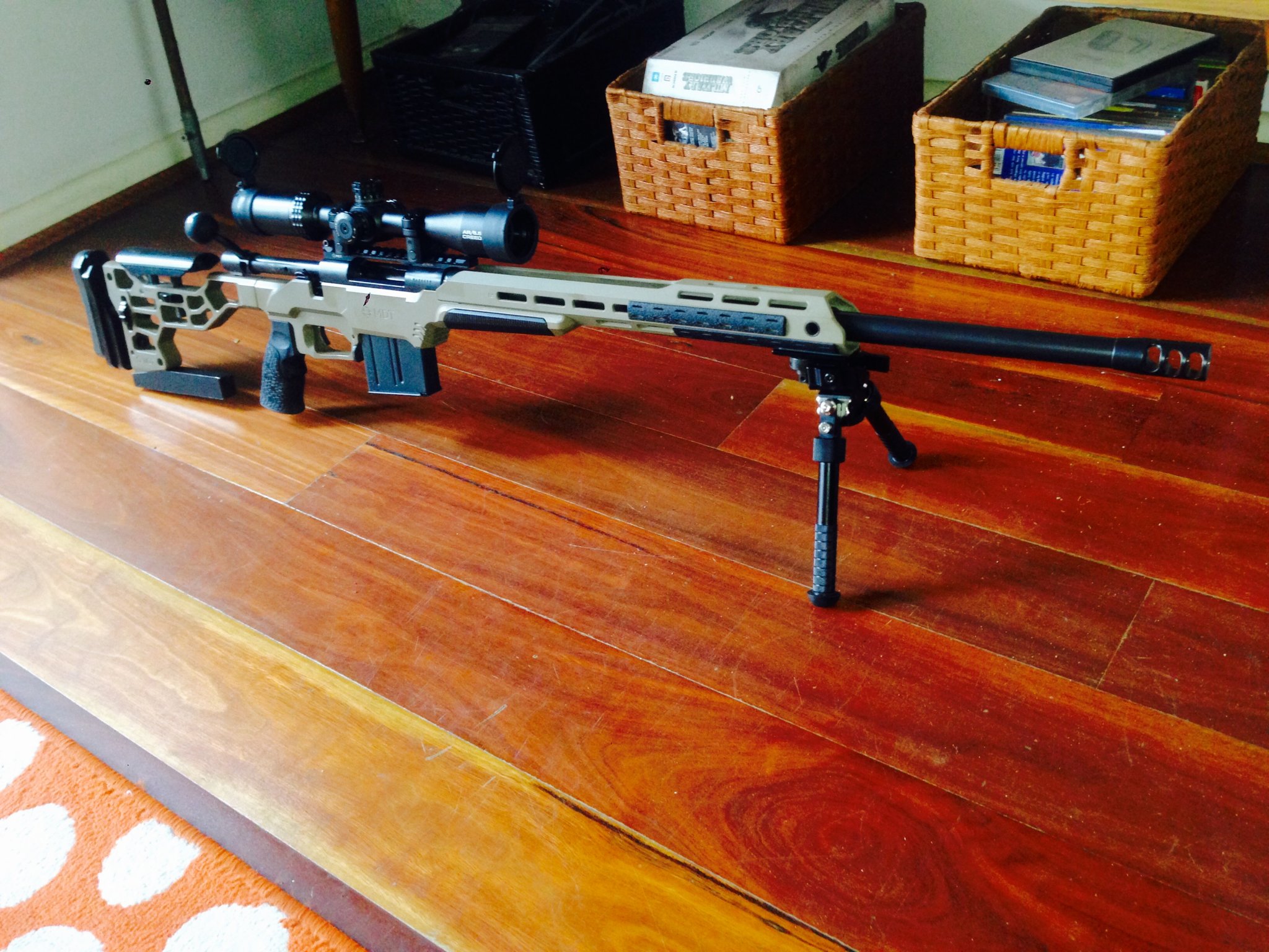

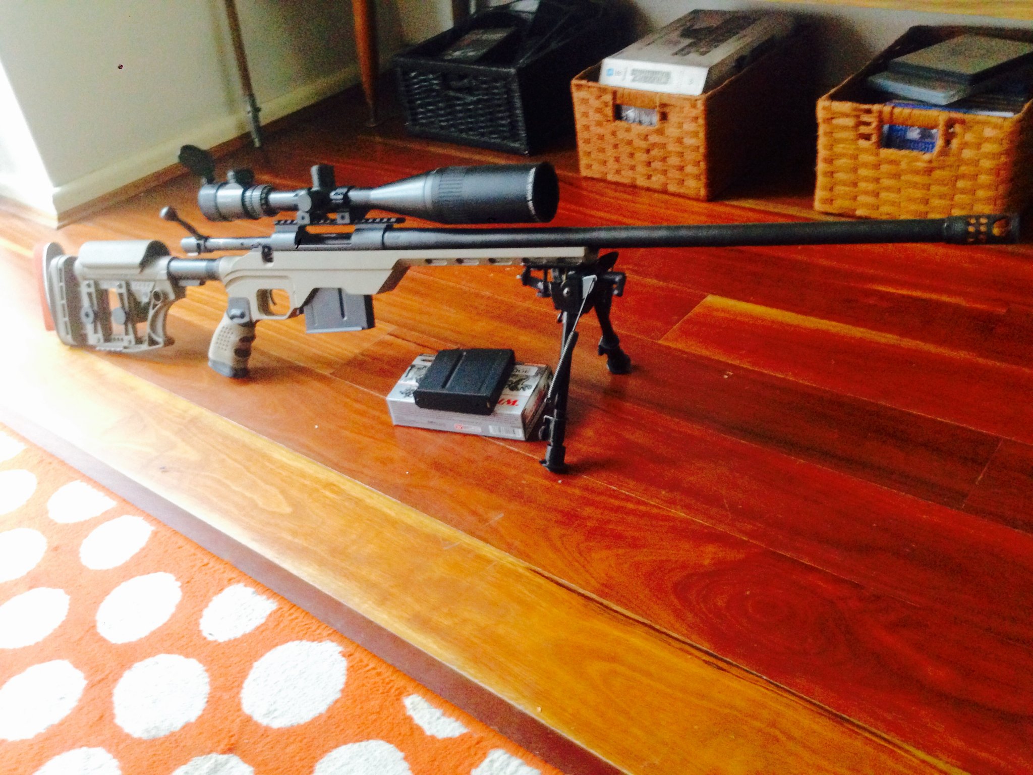

Here's three Howas and a Remington. I don't have a lot of money for the number of guns I want and all of my builds come in at under $1000 USD Rem 700 30-06 in MDT LSS-XL chassis and Magpul stock with Hogue grip and Vortex DBT 4-16x scope, Howa 1500 6.5CM in MDT ESS chassis and stock with a Bushnell AR 6.5CM 4.5-18x, Howa 1500 .300WM with a Vector Optics Martel 4-16X56 ( and miscellaneous parts) total cost of this build only $670 USD incl. bipod and scope, and Howa 1500 .223 in a Boyd's TH stock with BSA tactical 4-14X.
Reactions: delinquent pleb

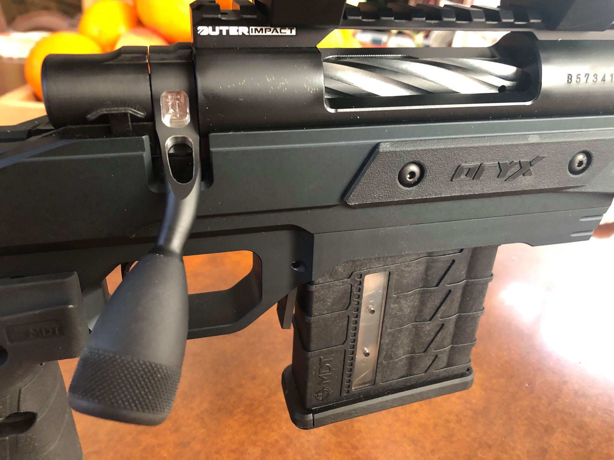

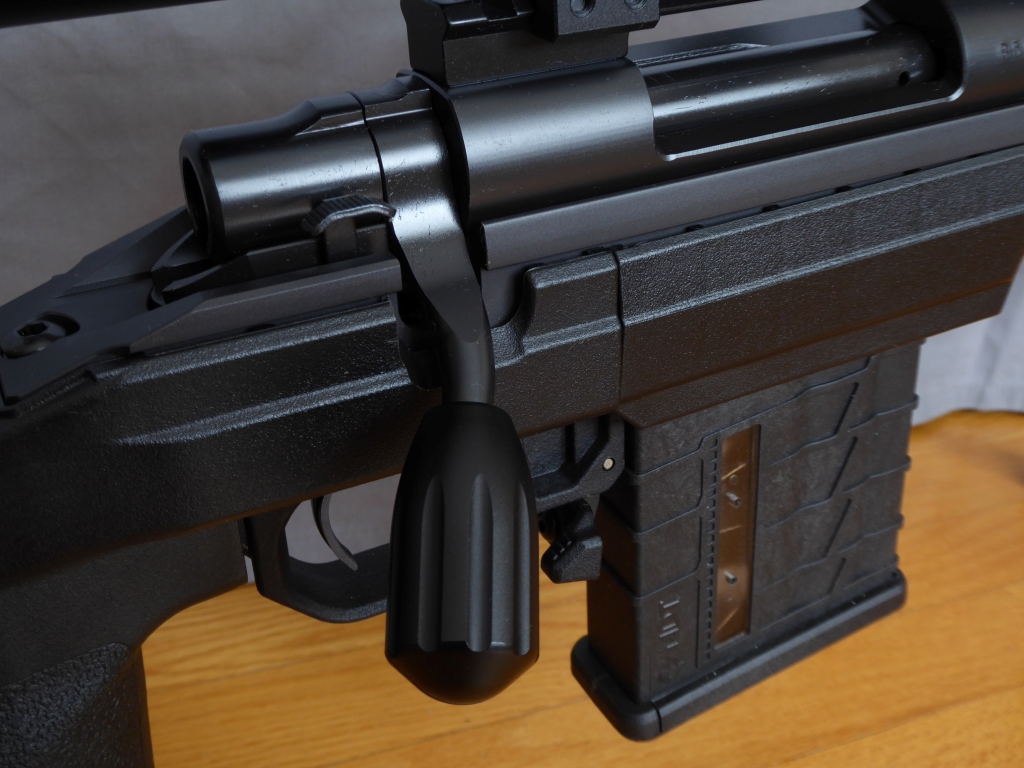

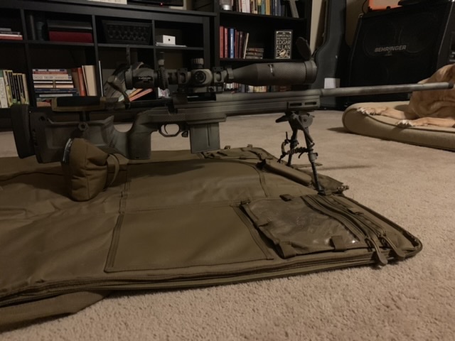

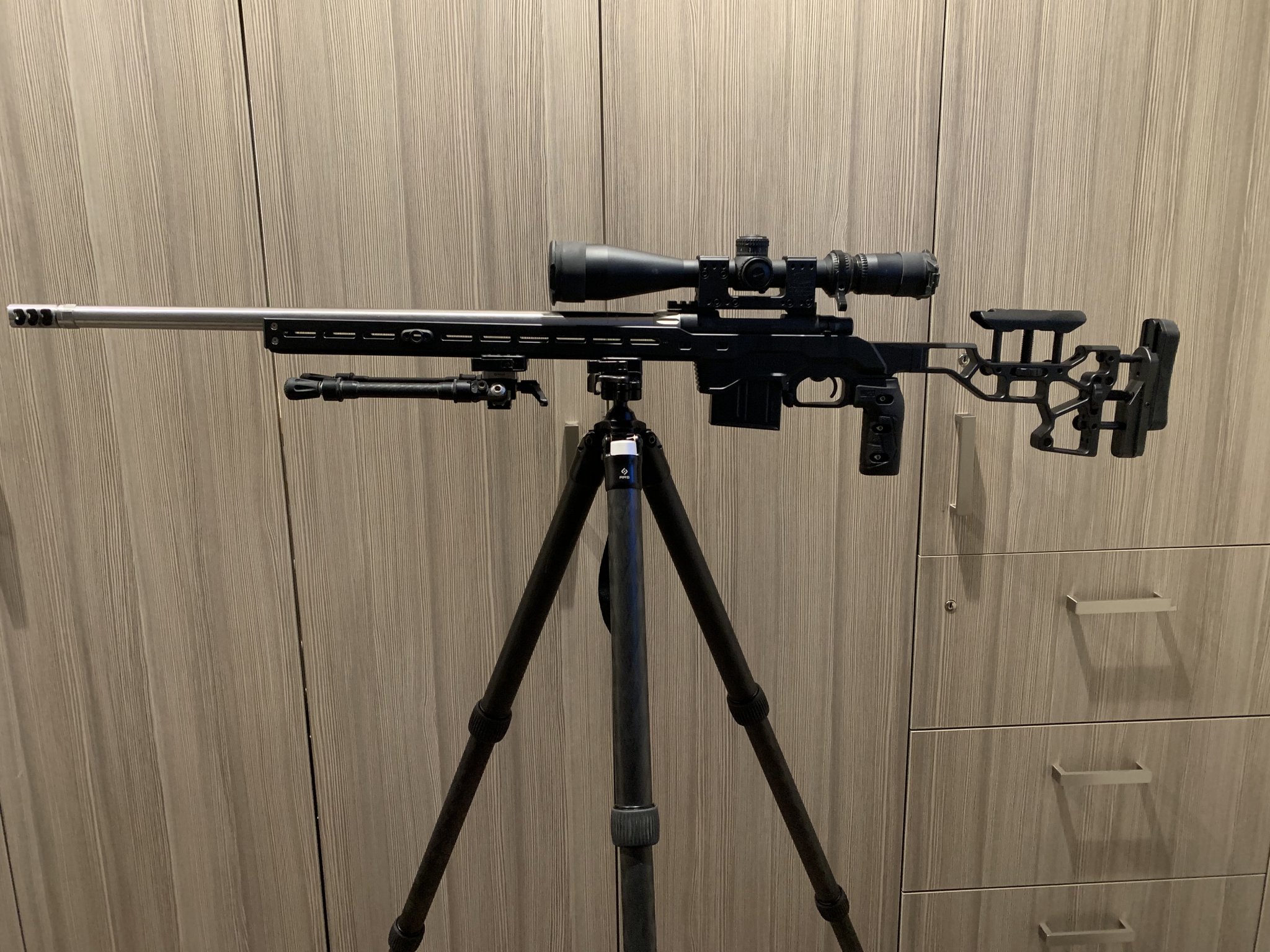

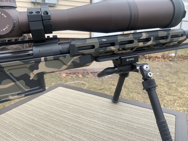

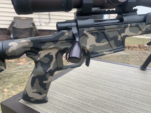

Finally got my bolt back from Kampfeld Customs, awesome work! Highly recommend, cant wait to go out and shoot it!
Build
Howa 1500 SA 6.5 CM 24 Heavy
Oryx Chassis
Oryx Stock Spacers
Ultradyne Pegasus Tanker
Vortex Diamondback tactical
Vortex Scope Rings
Atlas BT47 LW17
Outerimpact 20 MOA picatinny rail
MDT Vertical Grip
MDT Hybrid Poly/Metal Magazine
Bolt
Kampfeld Custom Fluting
Kampfeld Custom Tactical Knurled Bolt Knob
Kampfeld Custom Bolt Handle Skeletonizing
Will be shooting it this weekend, still debating on a Timney trigger and if i want to upgrade to the Viper PST Gen2 or some nicer glass in general.
Cheers

This is correct, i had purchased a Howa 1500 SA 6.5 24" and it had no threaded bolt knob. I sent mine out to Kampfeld Customs for bolt fluting, handle skeletonizing and the threaded bolt knob upgrade. Side note, my brothers indeed came with a threaded bolt knob but i noticed the only difference between mine and his was he has a Howa 1500 SA 6MM 26" inch barrel. I am under the impression if i had went with a 26" barrel i maybe would have got a threaded bolt knob. But i am not sure...
The summary of this post is, i had looked far and wide for a bolt handle but apparently it is almost impossible for a Howa, i tried the clamp on bolt knobs but i could not find that good of a fit. (They always had small play or the orings supplied were to large). So i just sent mine out for gunsmithing and i am glad i did =)

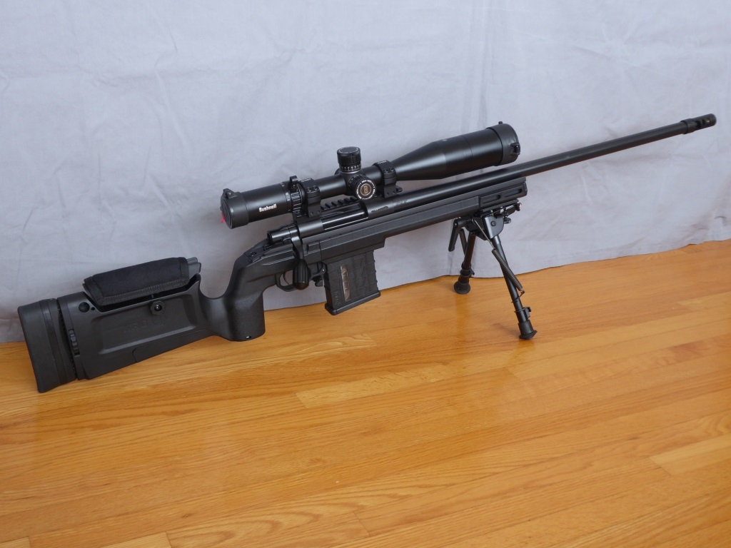

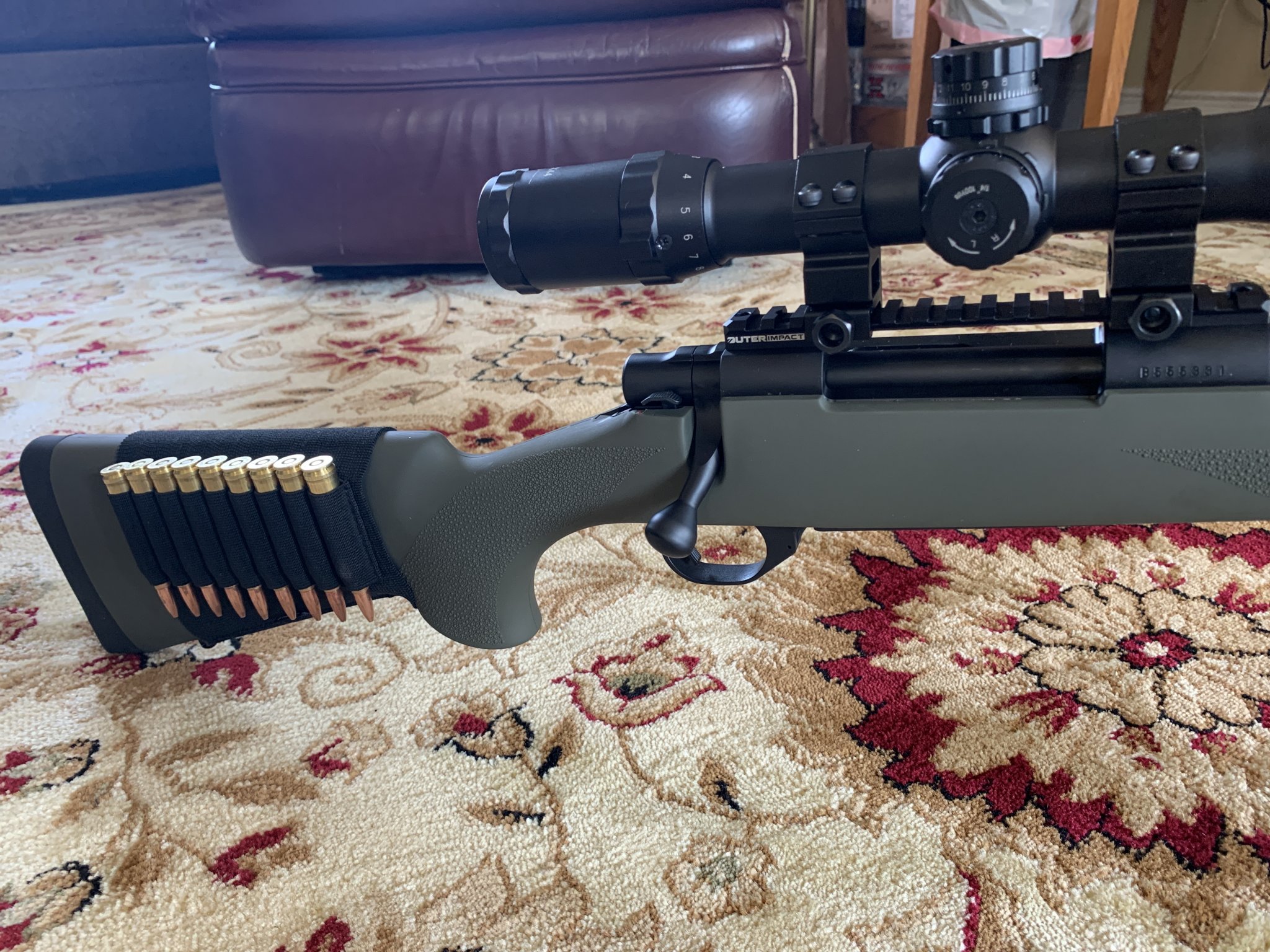

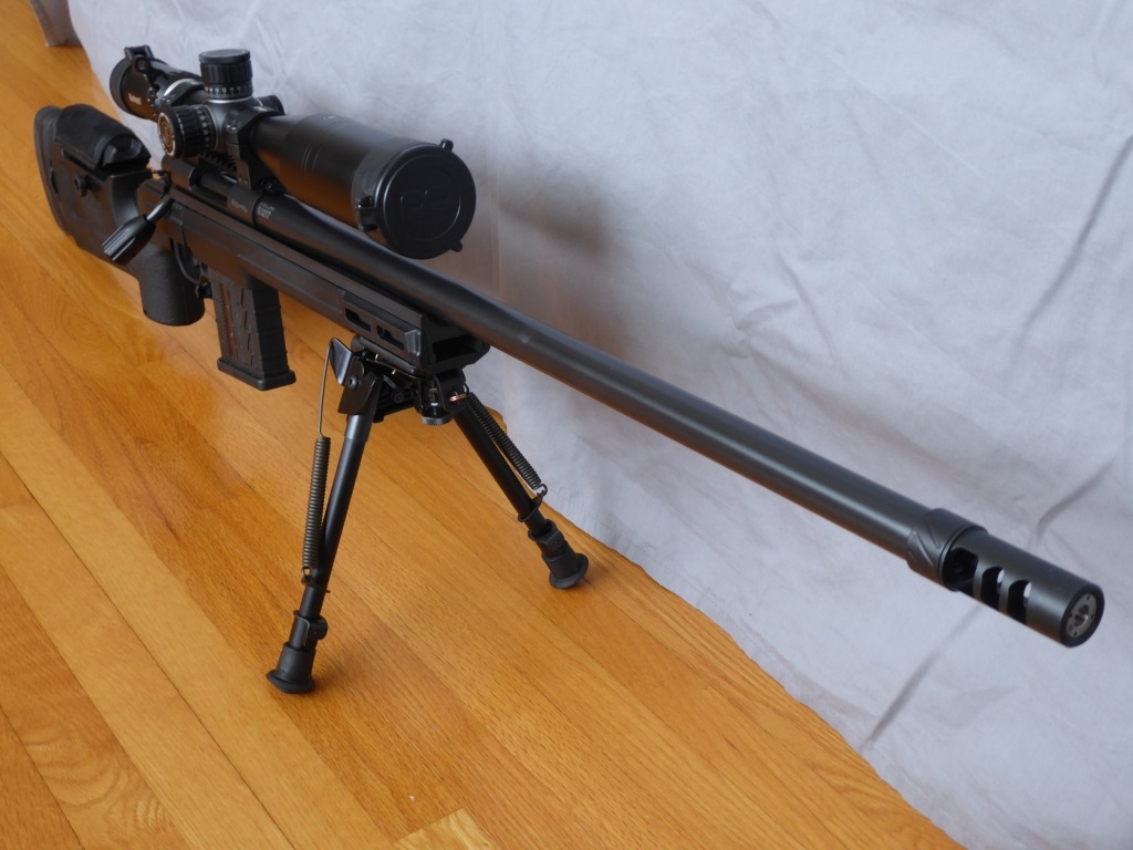

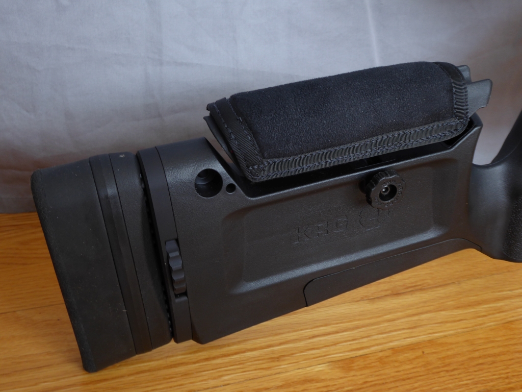

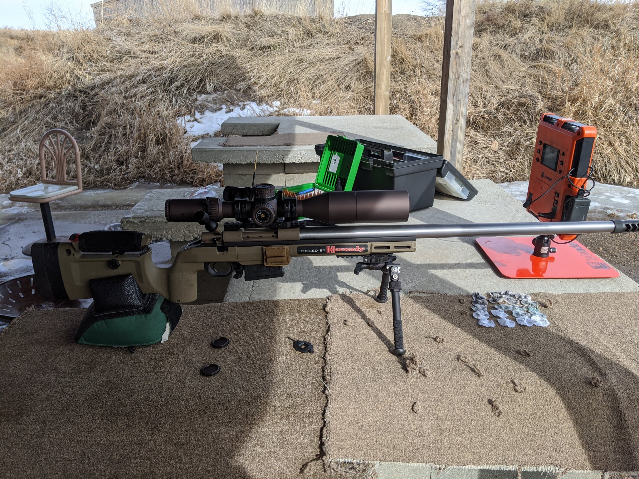

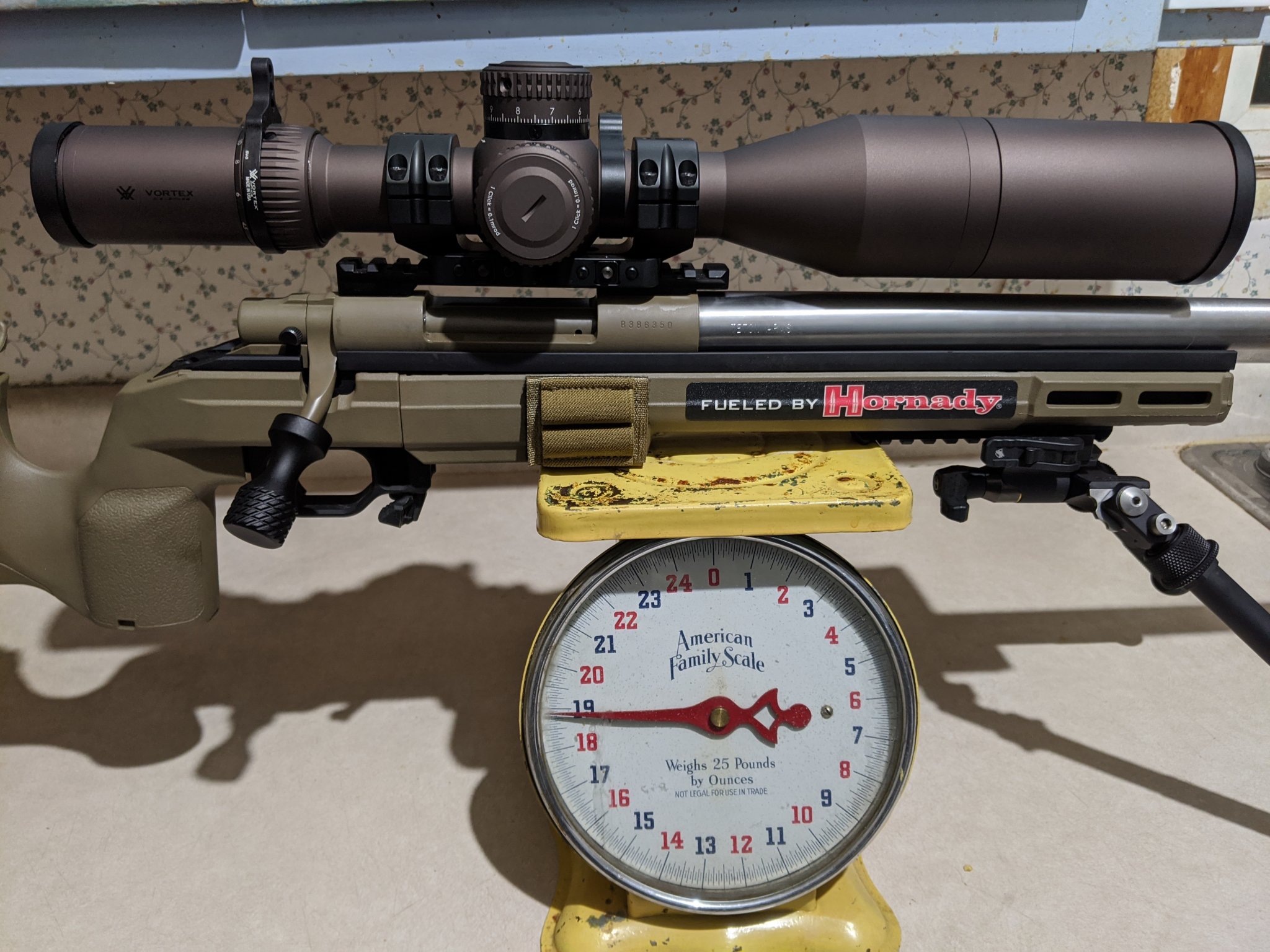

Here's mine from yesterday doing break in. Krieger 8 twist 6.5 creedmoor, vortex razor he gen 2, KRG bravo heavy, area419 brake, Timney trigger. Weighs in at 19 lbs.
Reactions: stello1001
How’d you get the weight up? I’ve got a 26” heavy barreled action, the 419 brake, the Razor G2, a Warne bipod, and am planning on putting it all in a Bravo chassis this spring...but I’m at like 12lbs now, which means ~15lbs all in. Where are your additional 4lbs coming from? What’s a “bravo heavy”?
I’m trying to up the weight for stability from the bench btw. I’ll never carry this thing far in the field or anything, just a range toy.
Reactions: BigdaddyWSM

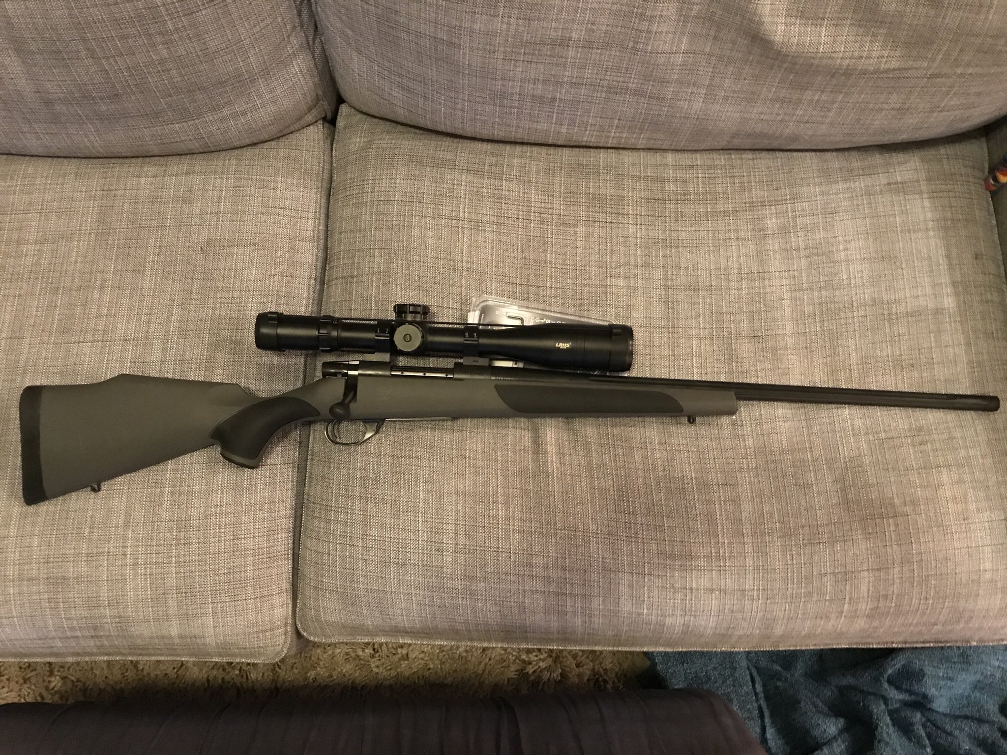

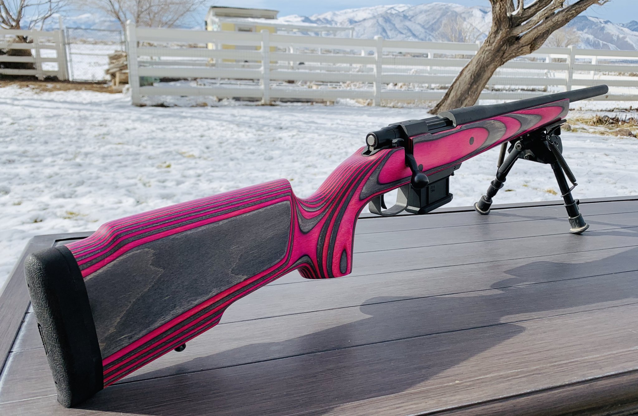

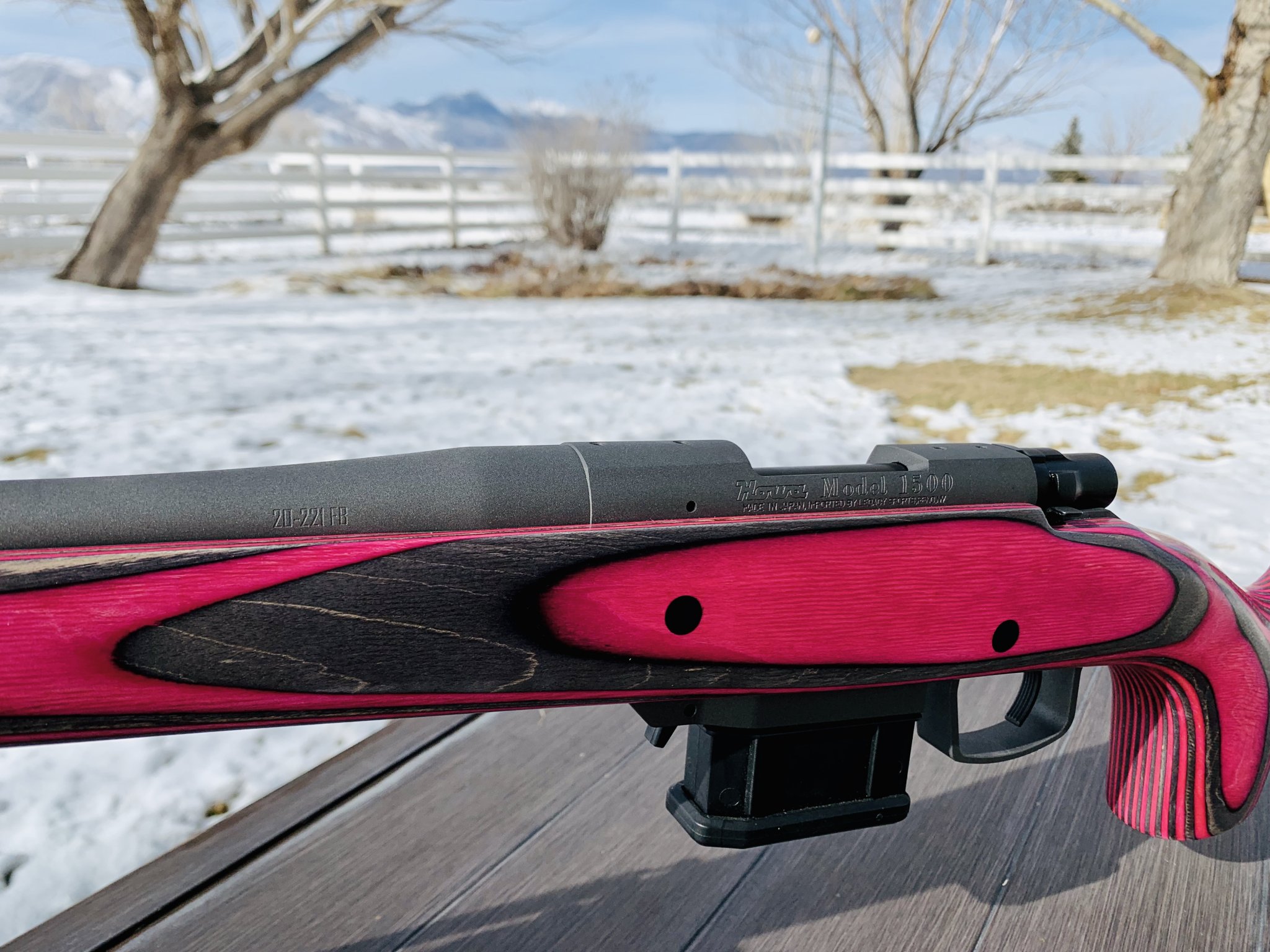

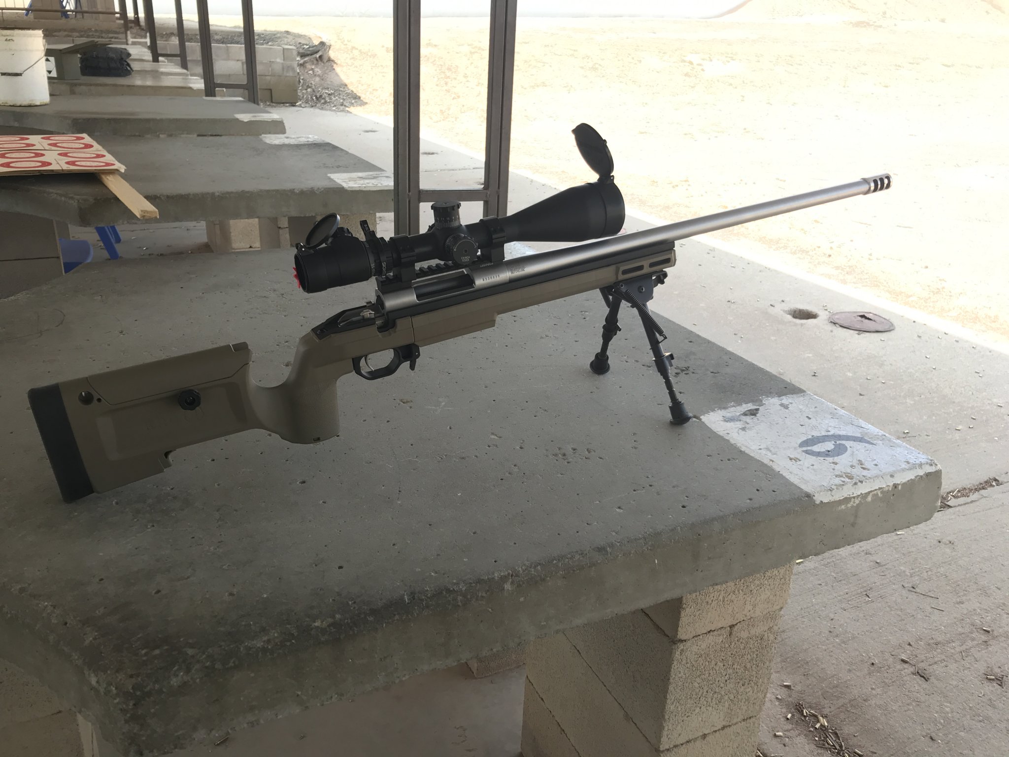

Finally getting this guy out to the range for the first time:
Weatherby Vanguard — aka Howa 1500 — in 6.5CM. This one has a fluted and threaded barrel and was just $440 at Kentucky Gun Co last December. I love tuning the HACT triggers but for a long range hunting/field rifle this one was already dialed in perfectly (if anything it’s a little light).
Topped it with the Bushy LRHS in Talley lightweight rings. I’ll break her in today, get some groups and report back. This is my 2nd Howa 1500 after my ultralight Mini in 6.5 Grendel. The third is the barreled action long range toy Ive been piecing together for a year and still need to throw in a chassis.
buttstock, handgrip, lead shot + foam.
Do you mind if I ask for some more info on these builds? How the heck did you do them for so cheap! Currently pricing out a 6.5 cm or 6.5 prc with either a krg bravo or mdt chassis. Just the BA and chassis puts me at 1k just wondering how ya did it. Thanks
Hi there, I managed to do it so cheaply because I bought all the component parts over time and on sale or secondhand, with already attached mods like 20 MOA rails and muzzle brakes to nearly new rifles. The MDT chassis were all purchased new in the Black Friday sale along with Mags x10 for a fraction of the price normally. I also am not afraid to buy stuff like accessories and butts, buffer tubes etc. from China and eBay. Some of the optics are not top drawer and many might poo poo me for not spending a lot on them but they are all really nice and functional and I don't care what others think so long as it works for me. Likewise rather than spending a load on a tactical bolt handle and gunsmithing to fit it I put on Hornady bolt balls for $10 USD which are fantastic in function and look like the old school Swedish CG63 and CG80 style. Taking your time with an end in mind and searching for what you need for the build and capitalising on people throwing money into something they never use or got bored of etc. is a great way to save on the build. For example my .300 WM build had everything else ready to go as soon as the right rifle came up secondhand for the right price then I literally threw it all together in a morning and had it it ready to shoot by the afternoon. It's great fun when they are completed. Also sometimes there is stuff on the rifle you use that is superfluous to your build so I sell my bits and pieces and recoup some money that way. Also I have a lot of rifles so I have some spare accessories lying around usually and can utilise as many of those that are appropriate. Today I've just started my mini PRS build based on a CZ455 Varmint that I bought new for $410 USD. I already had the MDT chassis (bought in Black Fri sale before finding the rifle) and buffer tube and stock and bolt ball and M-lock rail with pushbutton sling attachment and Leupold CZ rimfire steel rings that I got as part of deal for some other 26mm rings recently (essentially free) and I'm transferring the Vector Optics scope currently on my .300WM Howa to it as it is a great scope and 1" tube but 80MOA of internal elevation adjustment. I have an Atlas replica bipod which works really well and had a Magpul grip that came as part of a deal on a stock for my 30-06 Rem MDT build (also essentially cost me nothing). So I guess what I do is I formulate exactly what I want to build down to the fine details, then do a lot of scanning and researching and scouring sales etc. and collecting sometimes secondhand sometimes NOS or bought used once parts over time and then when I have everything I put it all together and hey presto an awesome rifle for not too much money.
