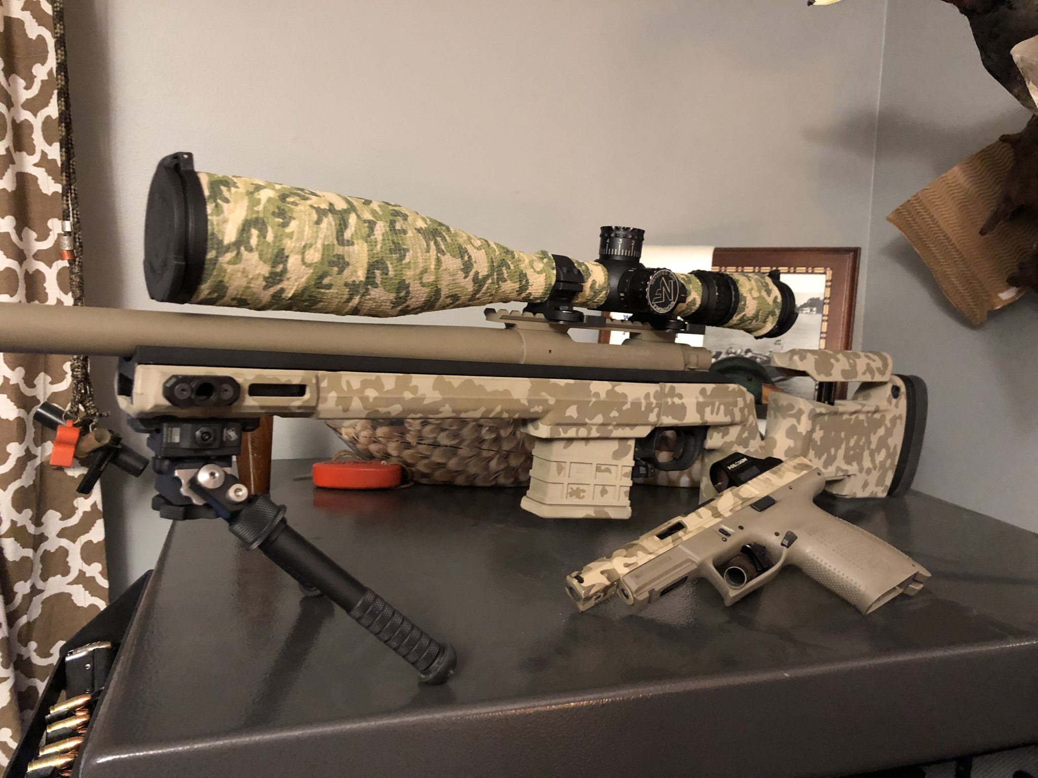

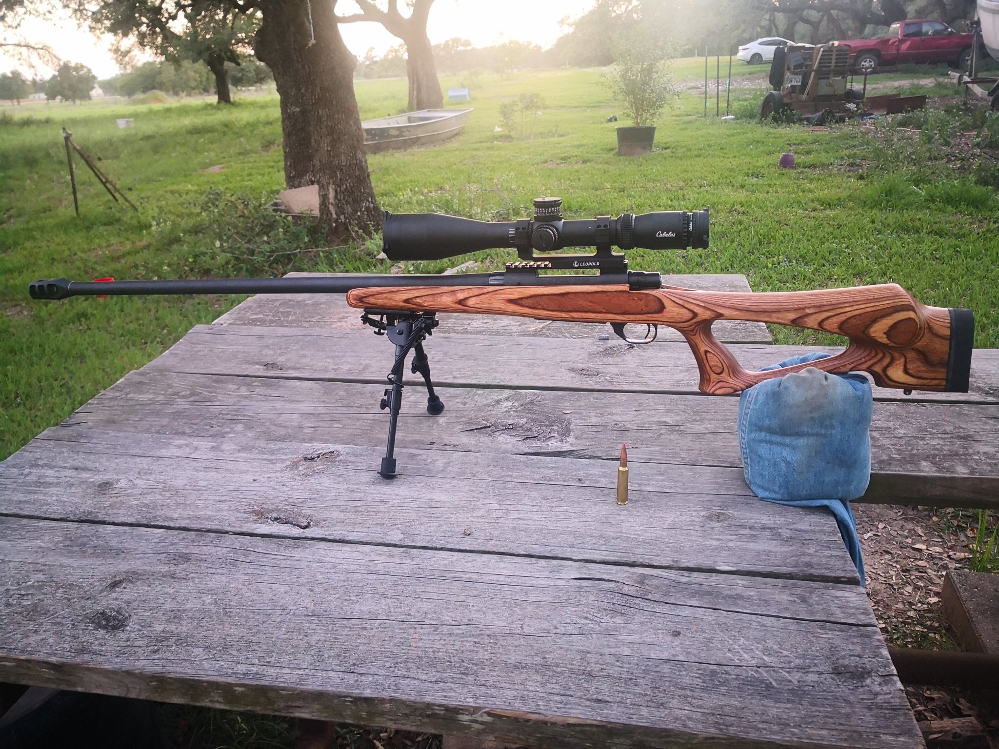

Howa long action

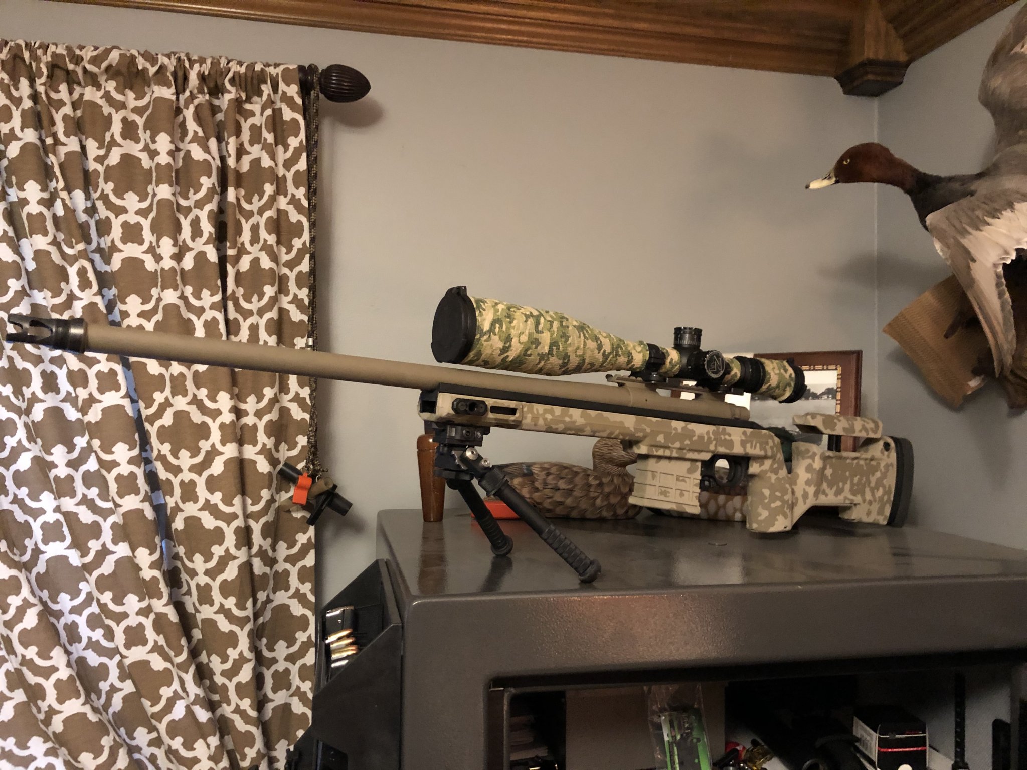

Mcgowen 28" Remington sendero contour
33 nosler
Precision armament brake
Cabela's Cx-Pro 5-25 FFP
Refinished howa stock and barrel channel opened up

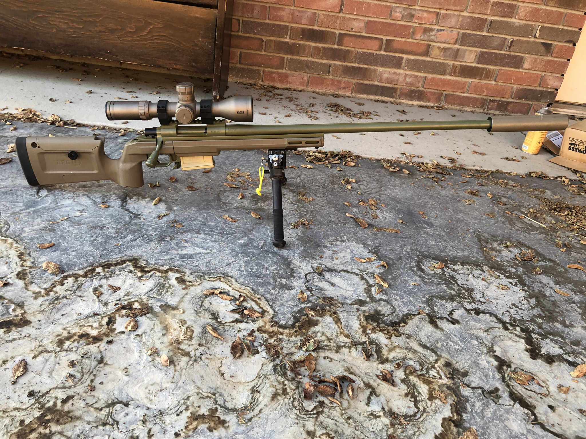

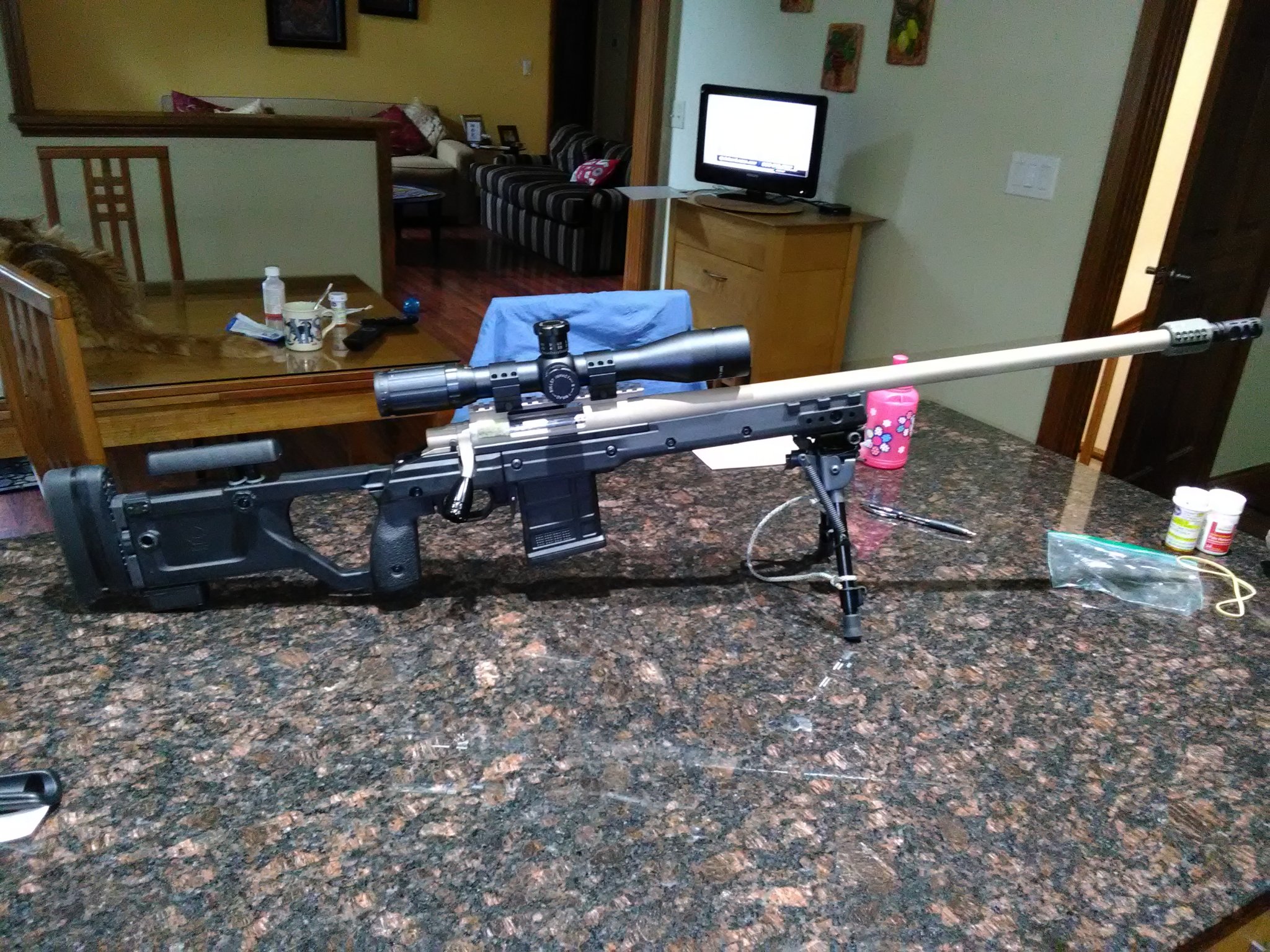

I got a before and after for you
Before
  • 1500 308 Win, 24" #6 contour OEM barrel
  • Desert tan Duracoat
  • Timney trigger
  • KRG 180-Xray chassis
  • EGW 20 MOA base
  • SWFA 3-15X42, Burris low rings
  • Chicom Harris knockoff
  • Witt Machine clamp on 5/8-24 adapter
  • VG6 Gamma 762 brake
After
  • 1500 308 Win, #6 contour OEM barrel cut to 17" and threaded 5/8-24
  • OD Green Cerakote
  • Timney trigger
  • EGW 20 MOA base
  • Steiner P4Xi 4-16X56, PRI high rings
  • Atlas V8

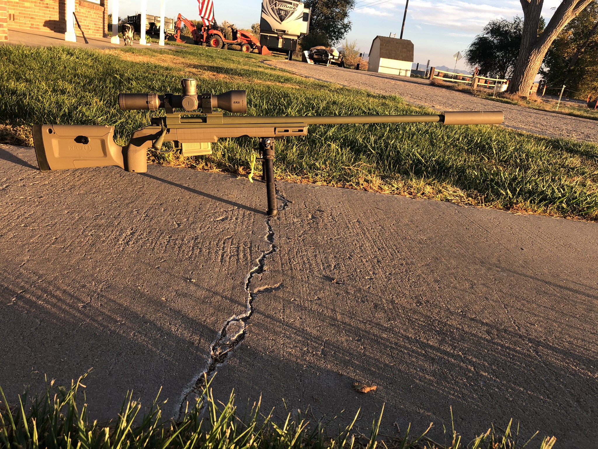

@stello1001
Before
  • Timney trigger
  • EGW 20 MOA base
After
  • OD Green Cerakote
  • Timney trigger
  • EGW 20 MOA base
  • Atlas V8

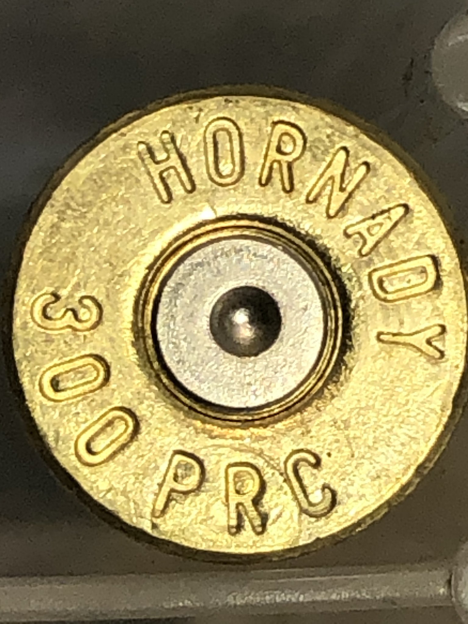

Hi all. I recently purchased one of the Howa 1500 Lightning rifles in 300 PRC from Buds Gun Shop. I shot it for the first time yesterday and had some ejector marks. BF81E2CB-2538-4CA5-A0DA-73788D3A4580.jpeg
My load (virgin Hornady brass, GM215M primers, 74.5 grs RL26, 225 ELD-M) didn’t seems like it was high pressure; easy bolt lift, no excessive case expansion, no primer cratering or flowing, cases easily re-chamber. The velocity was also lower then expected than a excessively loaded round, 2717 FPS.
When I looked at the ejector I noticed that the end is rounded. When it’s compressed with a round loaded in the chamber it looks like there would a be a small circle of the brass that is not supported during firing.
Is this a normal mark you all see on your fired brass or do you all think it’s a pressure or rifle problem. Thanks for your input.

Hi all. I recently purchased one of the Howa 1500 Lightning rifles in 300 PRC from Buds Gun Shop. I shot it for the first time yesterday and had some ejector marks. View attachment 7431020
Mike
I looks good to me, I wouldnt worry about it, especially with a Howa. They are pretty overbuilt just judging by the action weight.
Thanks for responding. The ring is indented into the case, and as close as I can measure is the same diameter as the ejector hole on the bolt face. I think I must have a slightly raised edge from the machining of the bolt.

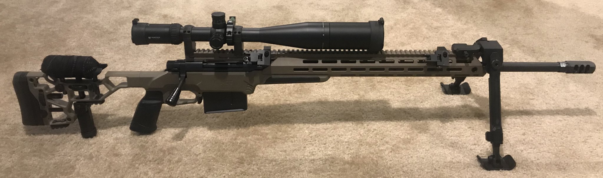

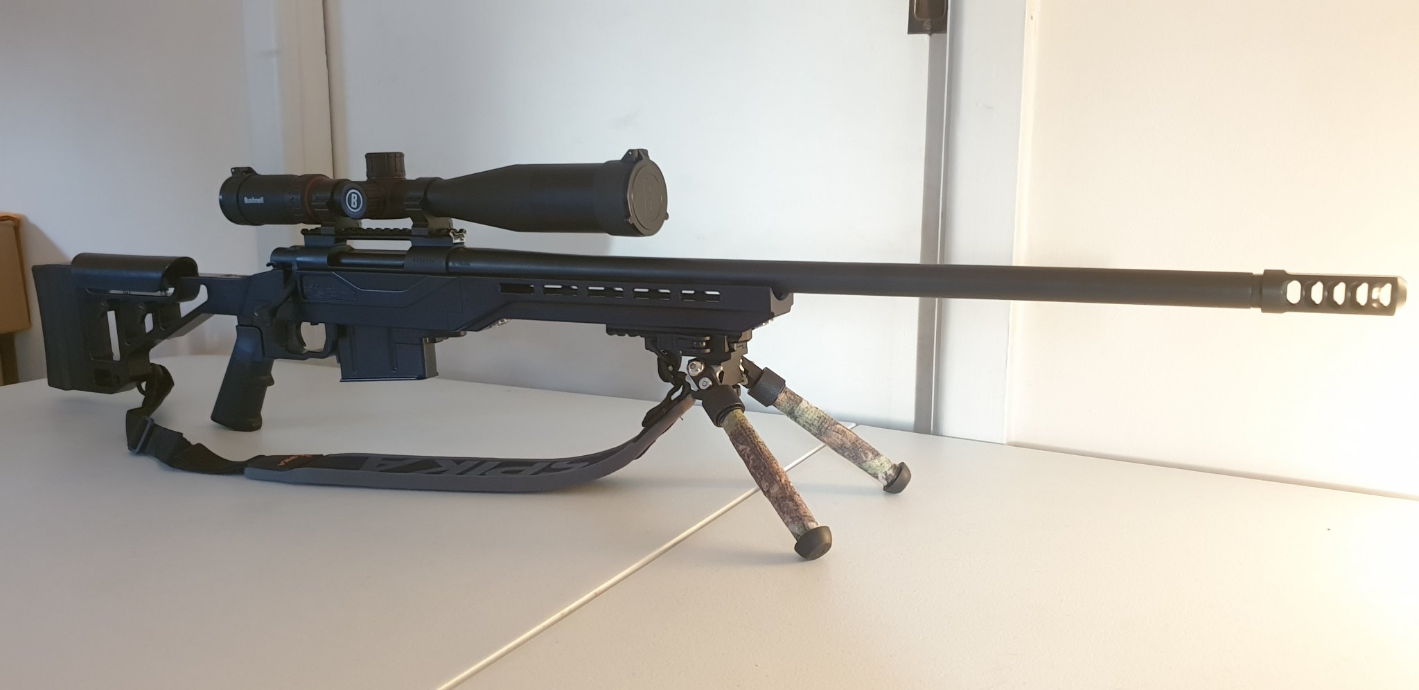

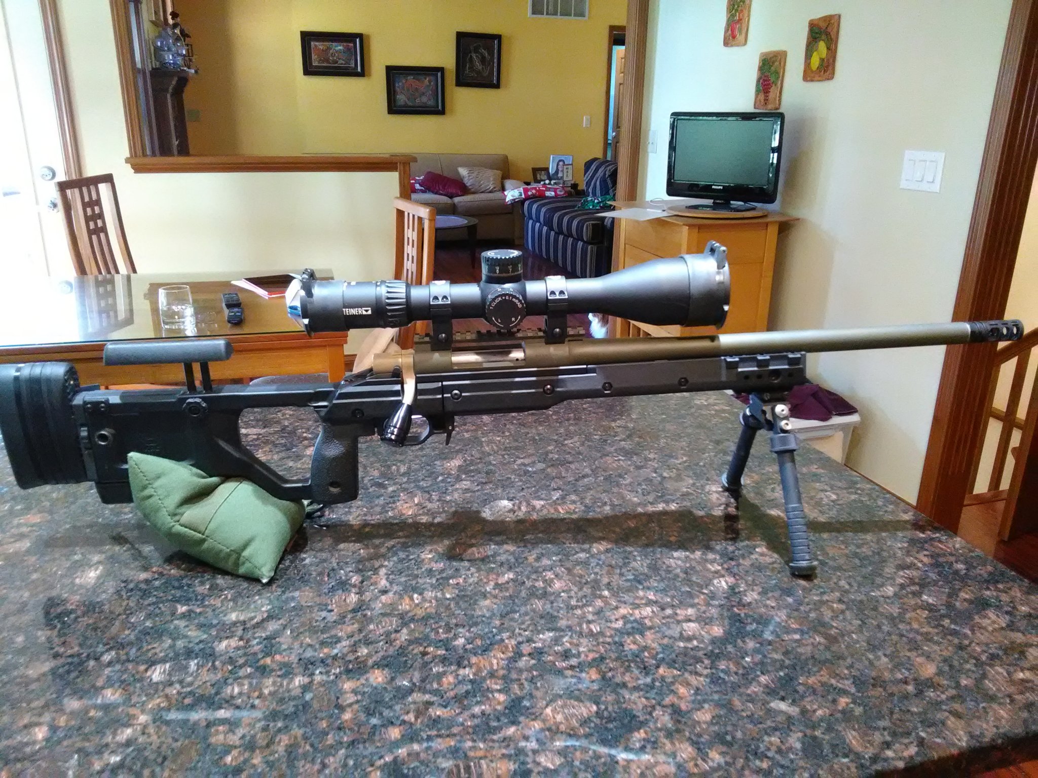

Howa 6mm Creedmoor 26" semi-heavy barreled action (1/2x28 thread)
KRG Bravo
EGW HD 20MOA rail
Gunbloke 1.0 Benchrest spring (~1lb pull)
Precision Armament shoulderless 1/2x28 - 5/8x24 thread adapter
VG6 Gamma 762 brake
eBay 1/2x28 jam nut
Harris BRMS w/ KMW Pod-Loc
Snyder Precision butt-stock weights/spacers x3 (~14" LOP)
KRG T-slot internal forend weight
MDT M-Lok weights
Arken SH4 Gen II 6-24x50 w/ Arken throw lever
Seekins Precision rings low .92"
Vortex Lo-Pro anti-cant level
Area419 Remington bolt knob
Punching well above it's weight for ~$1500 all-in, speaking of weight: sitting at ~18lbs...

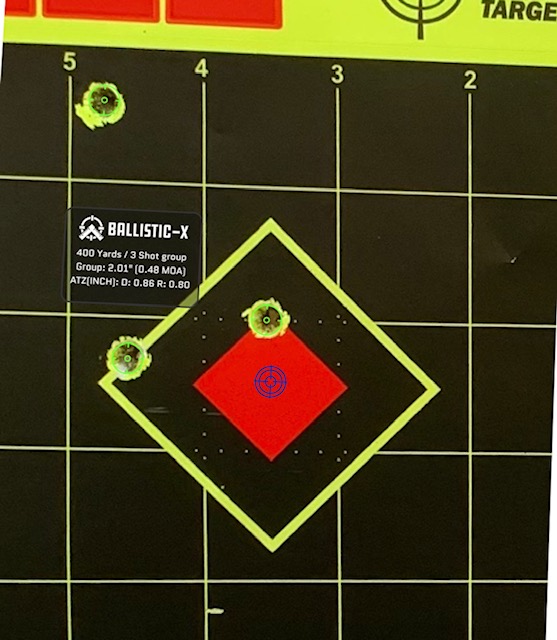

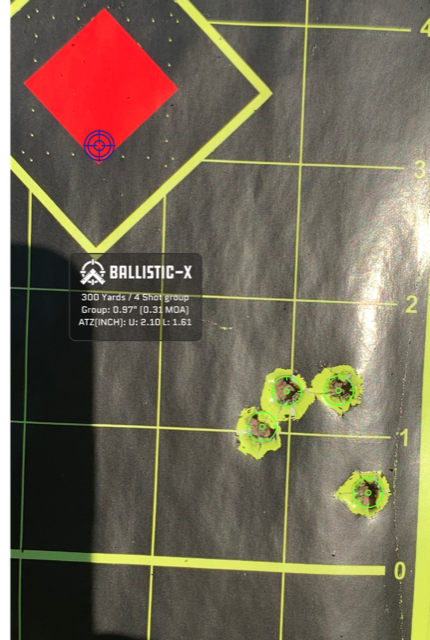

Bullet-jump testing with my powder-puff practice load (only running @2860fps, things tighten up with speed @~3100fps) :
Ballistic-X-Export-2020-10-13 22:13:04.657587.PNG
Ballistic-X-Export-2020-11-09 18:00:18.109987.JPG

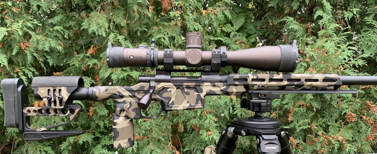

Howa KRG Bravo, 26" barrel 6.5cm. Warne 1 piece scope mount, Burris lugged steel scope base, SJC brake, versapod bipod on a Vertebrae spigot, and od green cerakote on the stock from Fosnaugh Customs.

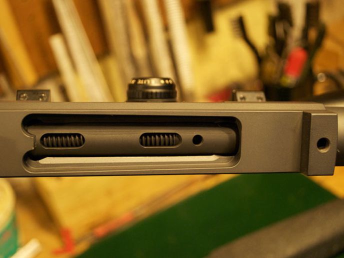

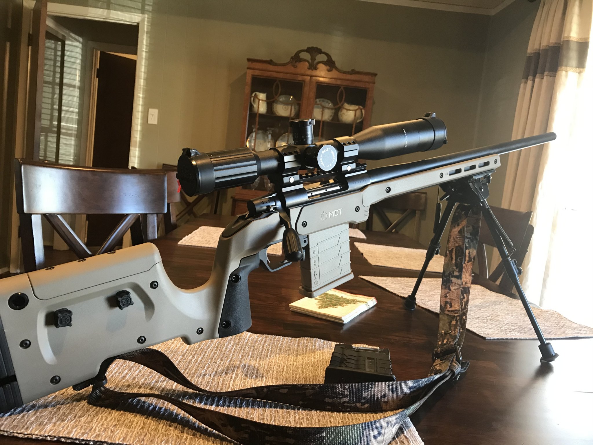

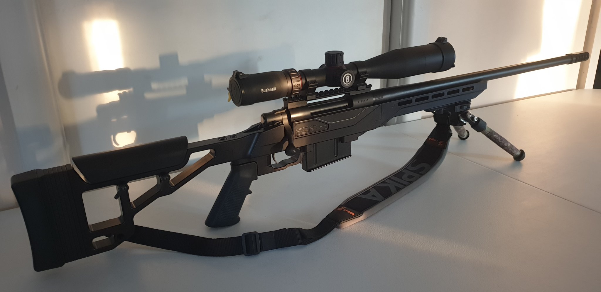

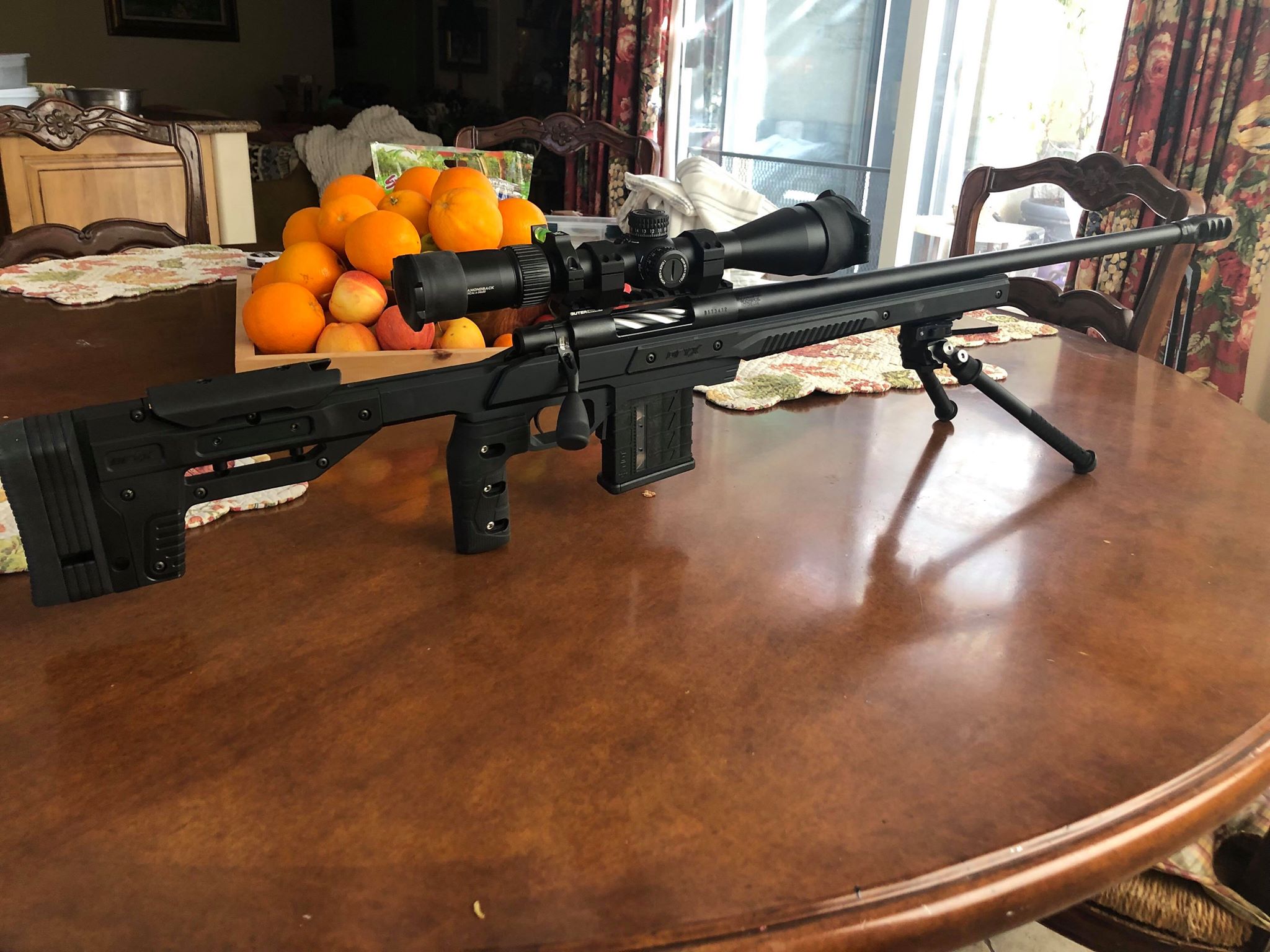

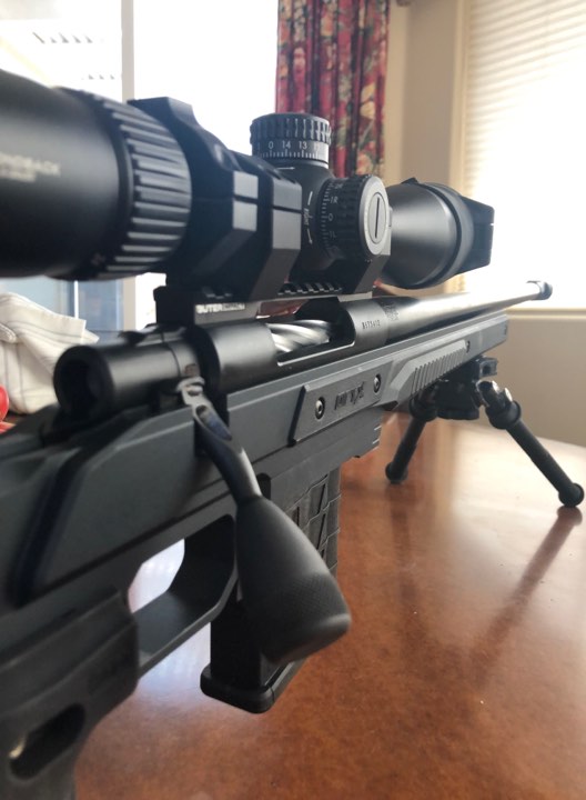

Finally got my bolt back from Kampfeld Customs, awesome work! Highly recommend, cant wait to go out and shoot it!
Build
Howa 1500 SA 6.5 CM 24 Heavy
Oryx Chassis
Oryx Stock Spacers
Ultradyne Pegasus Tanker
Vortex Diamondback tactical
Vortex Scope Rings
Atlas BT47 LW17
Outerimpact 20 MOA picatinny rail
MDT Vertical Grip
MDT Hybrid Poly/Metal Magazine

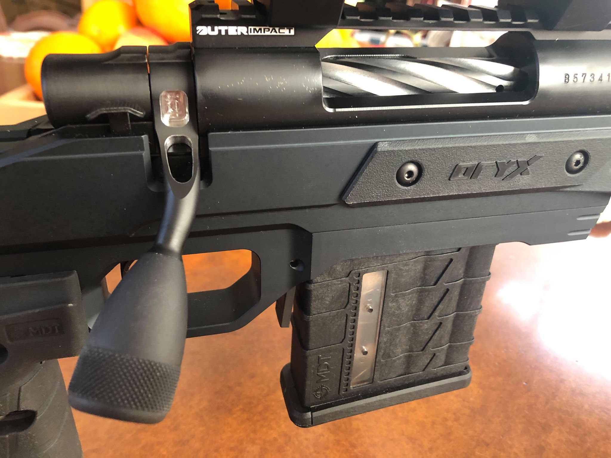

Bolt
Kampfeld Custom Fluting
Kampfeld Custom Tactical Knurled Bolt Knob
Kampfeld Custom Bolt Handle Skeletonizing
Will be shooting it this weekend, still debating on a Timney trigger and if i want to upgrade to the Viper PST Gen2 or some nicer glass in general.
CheersView attachment 7246336View attachment 7246337View attachment 7246338

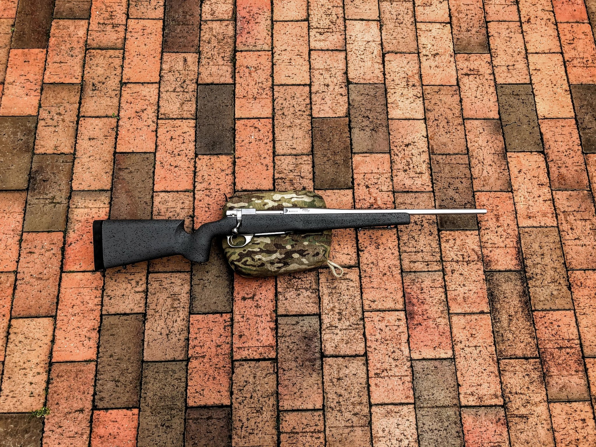

I am finally getting around to building my 20” .308 heavy barreled action i picked up for dirt cheap from brownells 3 years ago.
its not exactly what i am looking for but there is somebody on Calguns selling a brand new Manners T2A for a decent price. If you want a Manners without the wait it could be a solid option.

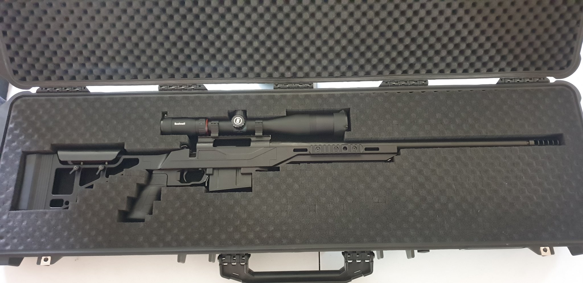

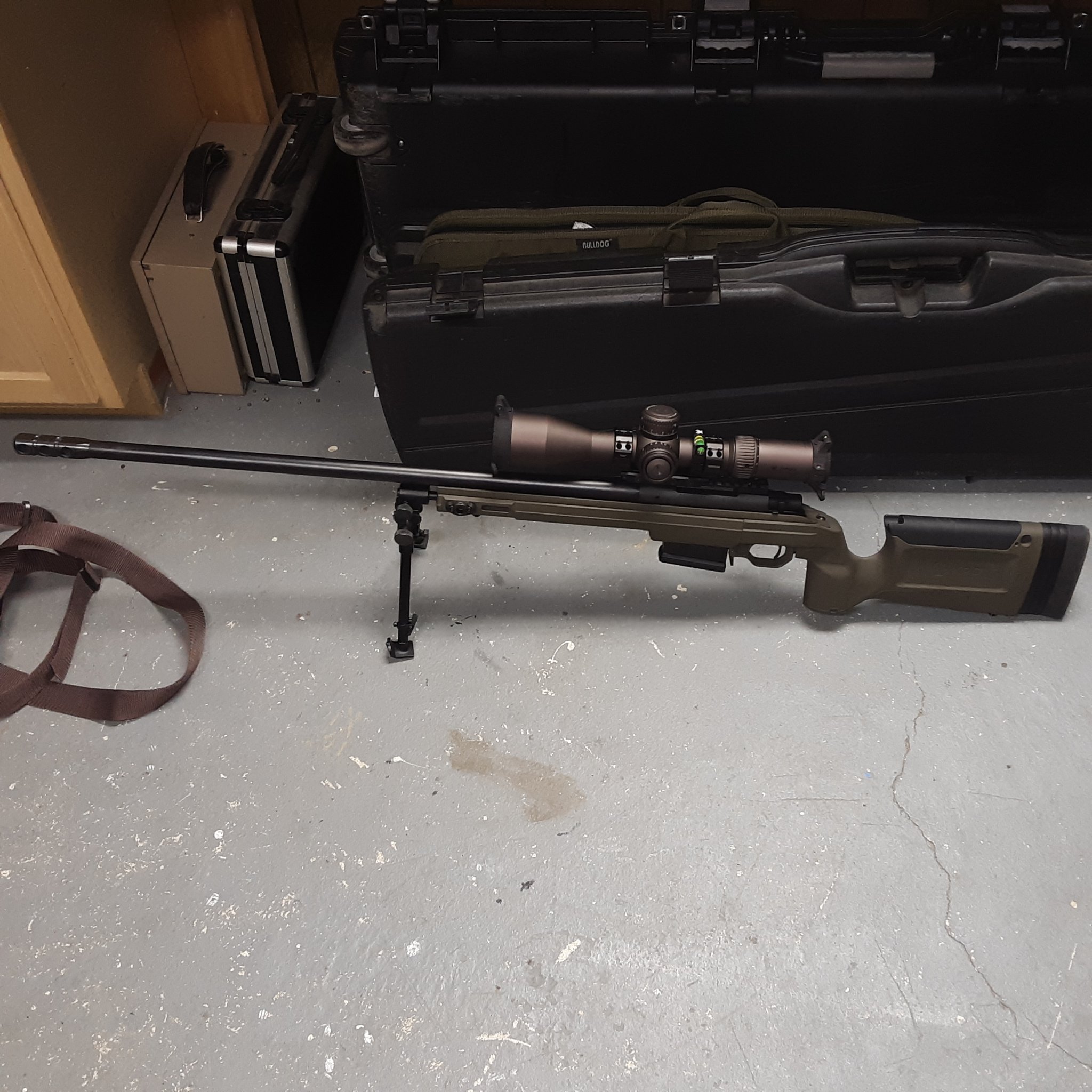

Decided to get back into bolt guns a few months ago after being out for quite a while, but wanted to keep it in a budget.
Found a decent deal on a slightly used rifle, swapped the original Hogue stock for a used B&C ebay find, and bought a Vortex 6-18x44 Strike Eagle on closeout.
I've only tried Federal 168 GMM and some Australian Outback 168 that was on sale at Global. So far, the A/O definitely outshoots the Federal.
Took my boys out and let them give it a try...both of em's first time on a bolt gun.
Glad that stock has a shooter in it. I put some work in to that thing. Small world that I just saw this.

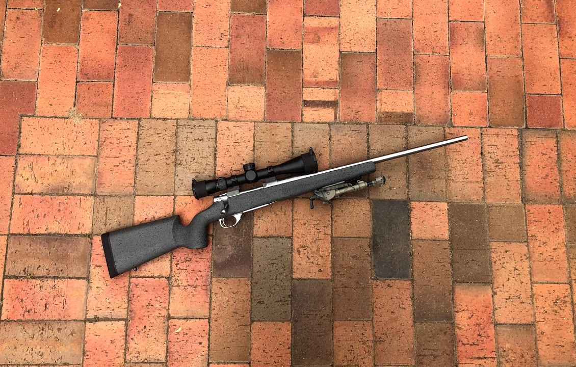

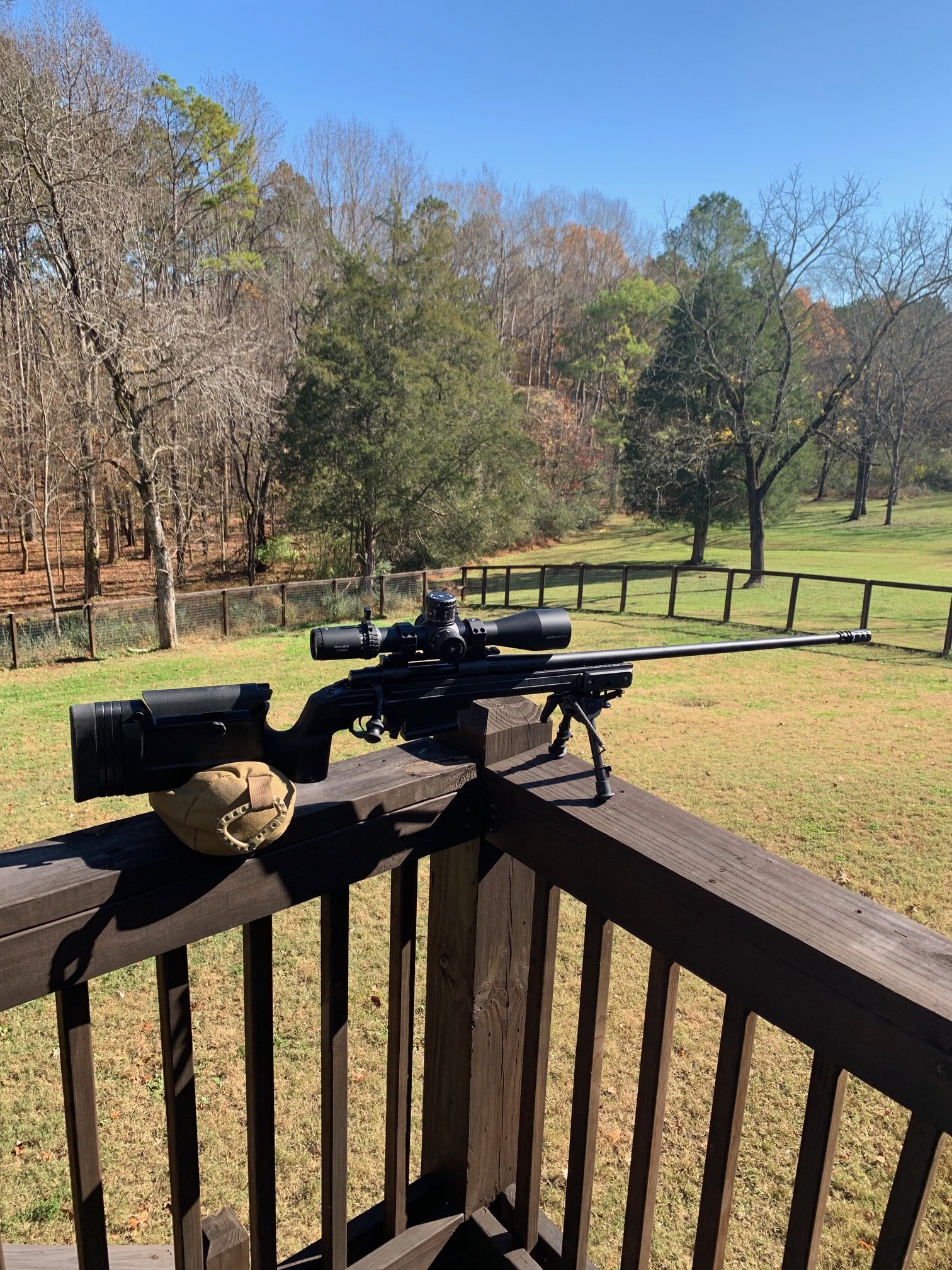

Here is mine. Weatherby vanguard HB in 308 win.
SWFA SS fixed 10x scope with sunshade. Vortex 30mm low rings. Nightforce 20 MOA base.
MDT XRS chassis, MDT AICS polymer mag. Legacy sports tactical bolt knob. Cheapo bipod that’s been on a ton of my rifles over the years, same with the cheapo sling.
The rifle was an absolute bughole shooter before the chassis. I have not been able to shoot it since transplanting it out of the god awful plastic stock it came with, but I’m fairly confident it’s going to be good.
I had seen a question about the SWFA glass in the thread, my experience with this scope is that it has very good optical quality, the mechanics are solid, the clicks on the turrets are well defined and positive. This one has the side focus knob, I like that a lot too. All in all a great scope for the money, I have had some that cost twice-three times the price that were not as good.
So far this one is really liking 155gr TMKs over 41.4gr of XBR. They get out of the barrel quickly but group well at 100-200. I’ve shot it out to 800 with 100% hits on steel, never shot for group at that range though. It would probably be decent though.
