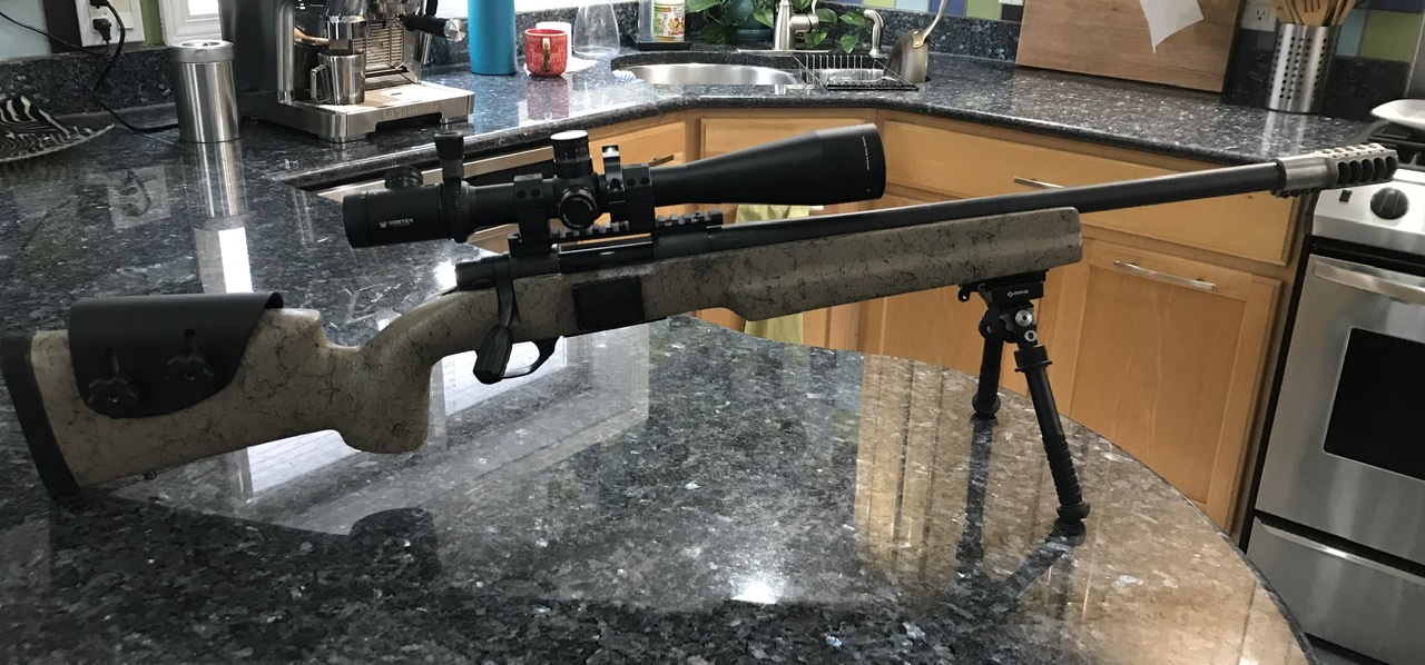

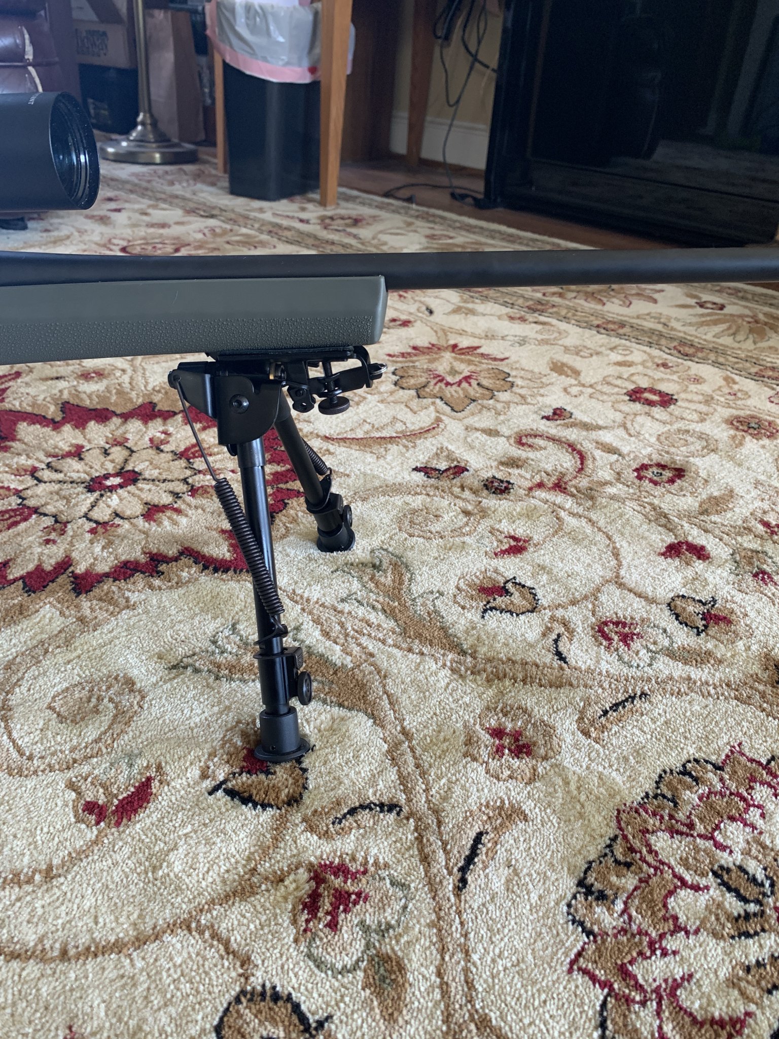

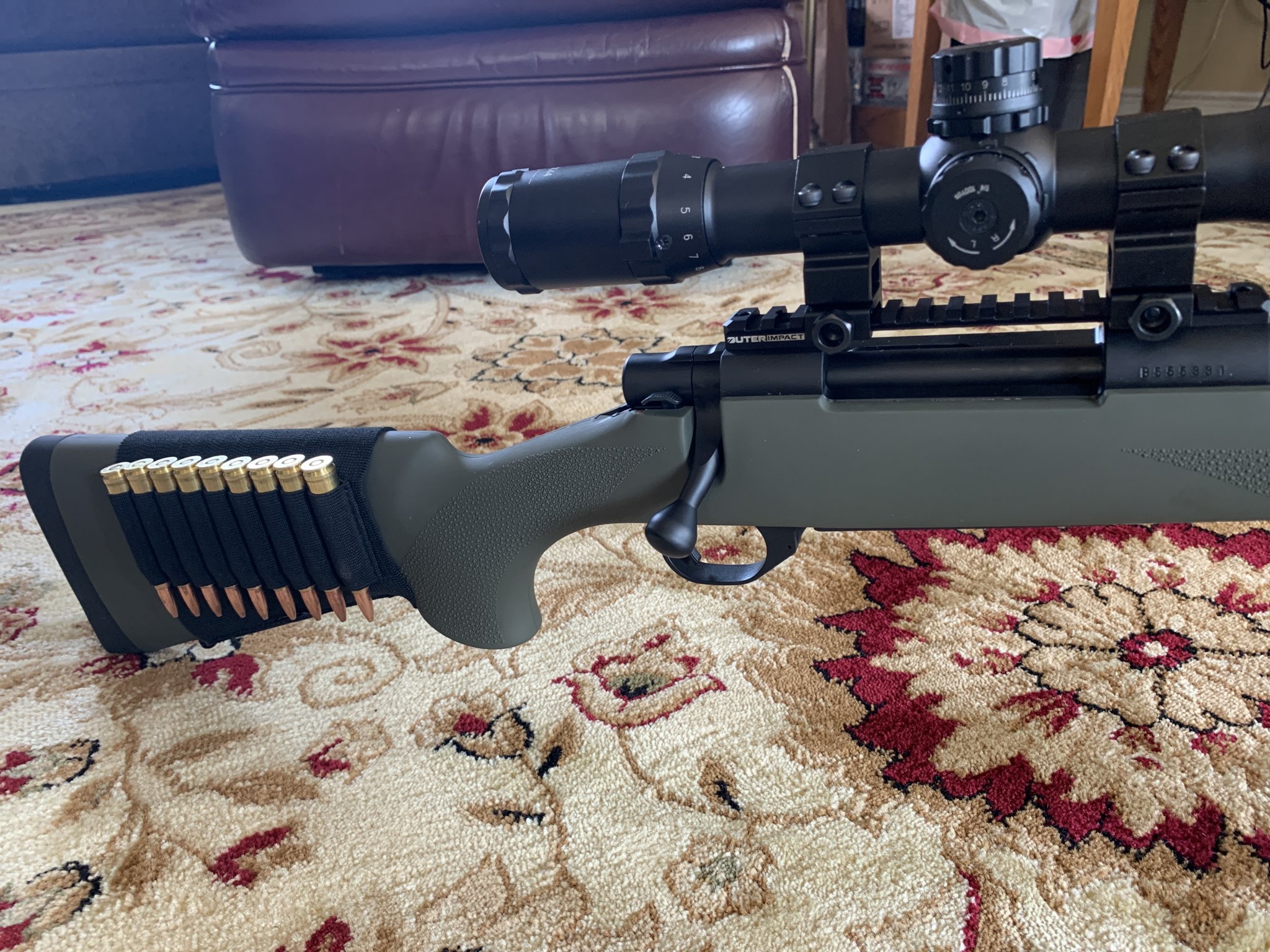

I think your bipod is on backwards and your scope is mounted so high I'm surprised you don't have a high cheek rest on it? Lucky getting one in 7mm RM with a heavy barrel. Is it 26"? I had to go for a .300 WM instead and is 24". Its great but was really wanting a 7mm. Happy shooting.
I think his bipod is mounted right but boy can that scope get any higher haha...
Reactions: Shankin
Bipod is on right and I was raised with high scope mounts. These aren’t actually as high as they look they’re only 1.5”

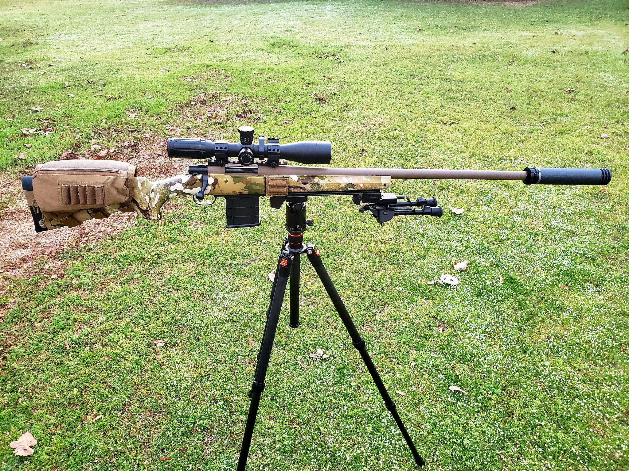

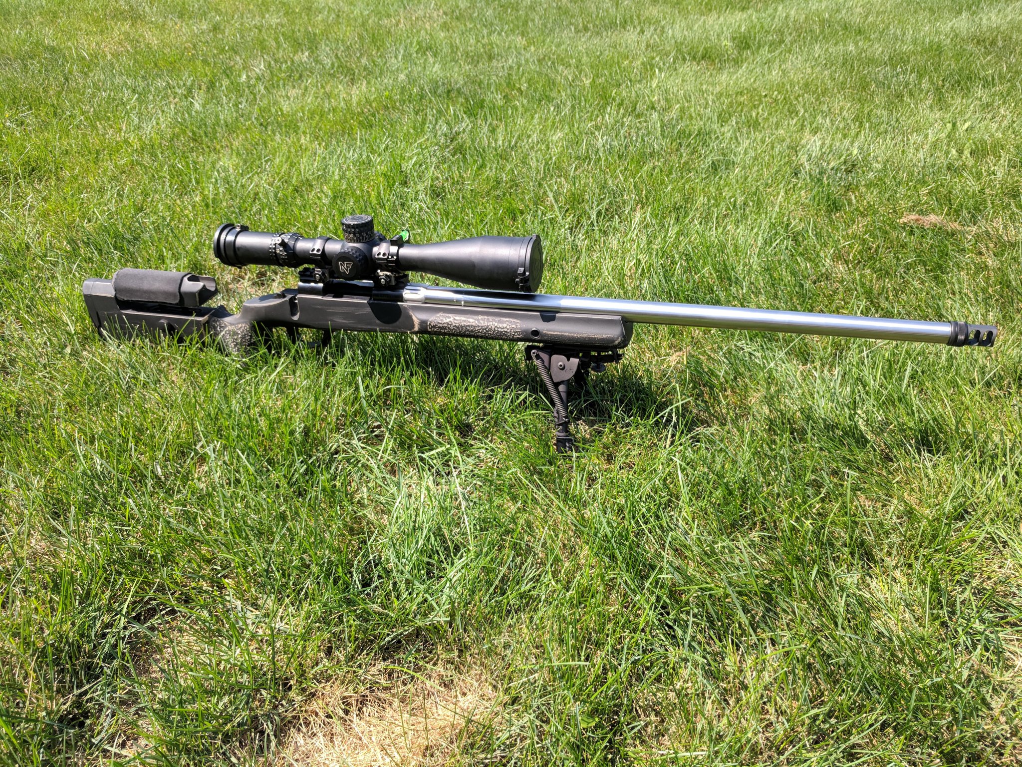

Multicam hogue model in 6.5 Creedmoor.
Additions:
Triad cheek pad over some high density foam, with double sided velcro to hold it all in place. I use the stock pack to hold my data book, a Fix-It Sticks "replaceable version" set, a Fix-It Sticks torque indicator, and a small eyedropper bottle of CLP. I *think* I can squeeze a boresnake in there, but I'm not sure....as-is it makes a great field maintenance kit for hunting / range shooting. For matches I'll probably swap it with just a simple no-pouch cheek pad.
Area 419 10" arca rail and barricade block.
SWFA SS 3-15X42 sitting on an EGW 20 moa rail.

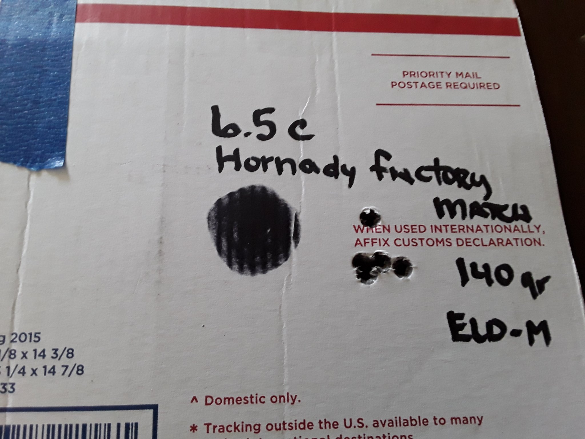

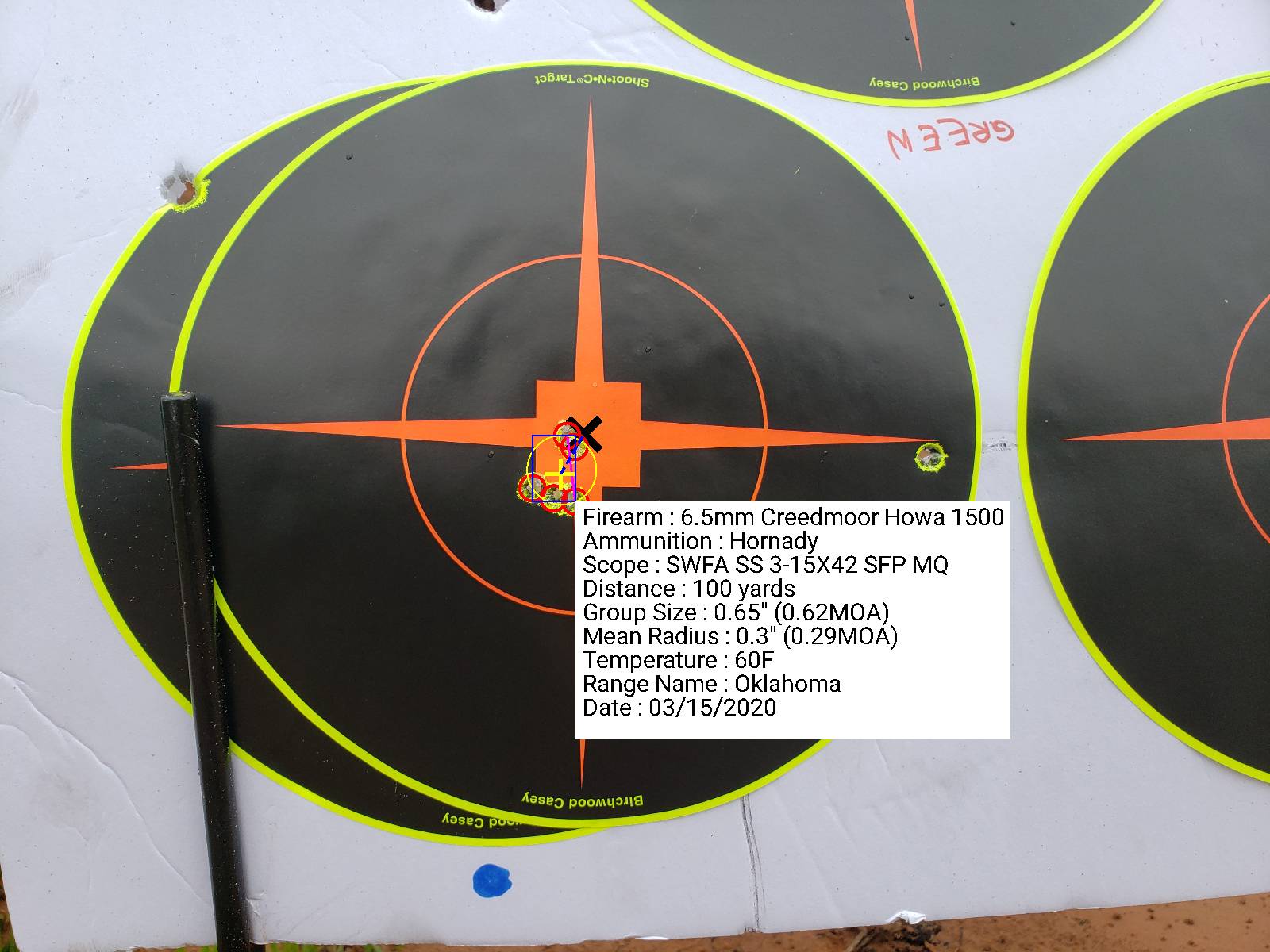

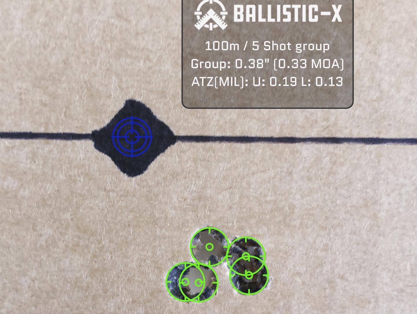

I just ran the first box of ammo through it last weekend. This was the final 5 rounds of factory Hornady 147 ELD after sight in with the can. Definitely shows promise:

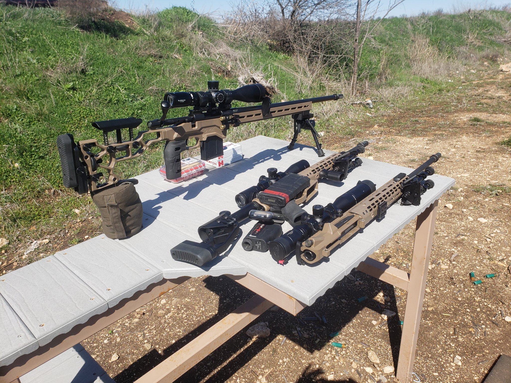

Aaaaand my other Howa (on the bag):

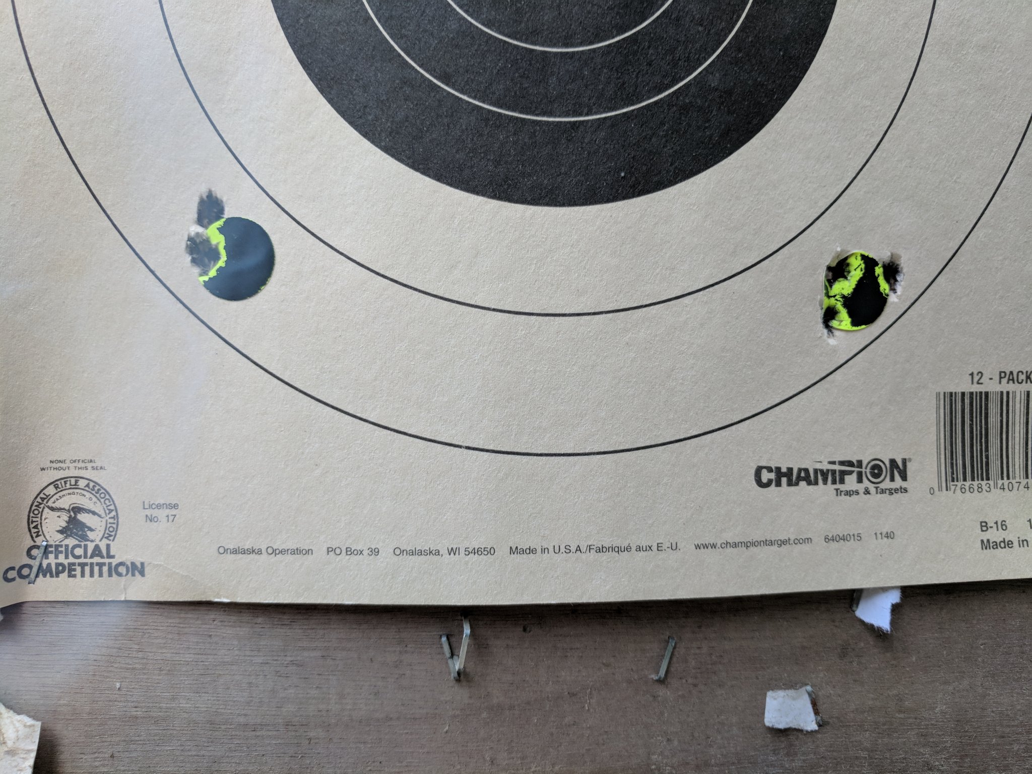

6mm Creedmoor barreled action from Brownells. Picked up the MDT ACC chassis on sale last November. It's wearing an Athlon Midas Tac 6-24x50, and the HACT trigger has been replaced with an 8 oz Jard.. I need to get some lower rings... but so far this has made repeated hits at 1400 at Triple C.

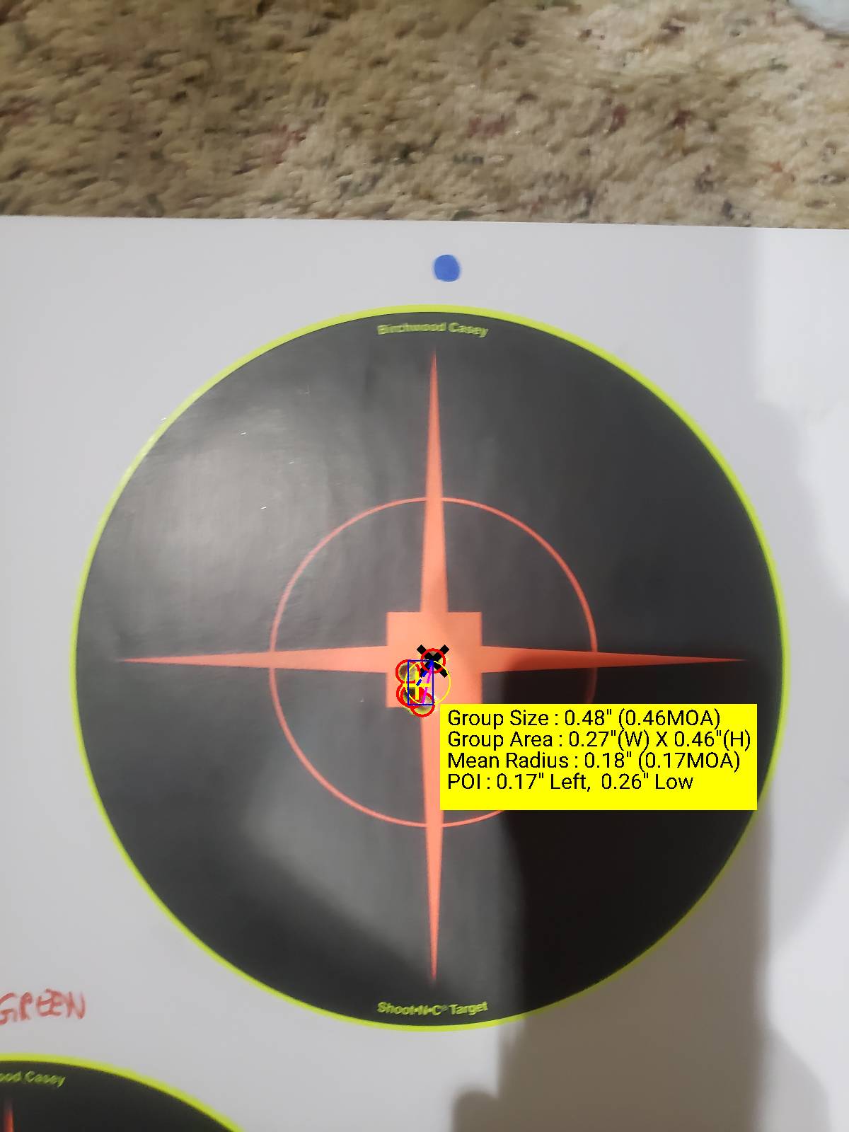

It also shot this group a few months ago, while testing some Berger 109 loads from C4:
Yep my bad on the Bipod, don't know what my eyes were telling me there. Your rail is quite high and combined with high rings it puts the scope right up there. With some of my rails/bases I only need low rings or Mediums at most. Shooting a Magnum without a decent cheek weld can't be much fun?

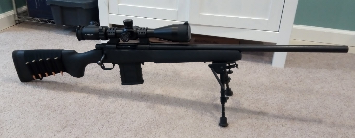

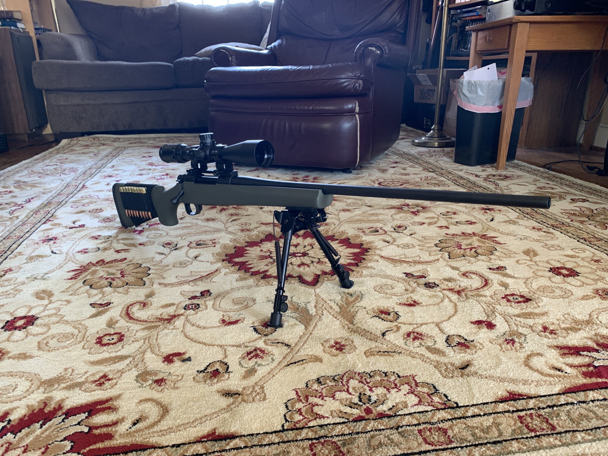

Got a new one folks.
Howa 1500 chambered in 7mm Rem Mag
Equipped with a Bipod, a 3-12x44 Scope, a Hogue Overmold Stock, and a Field and Stream Ammo Holder & Wrap, here’s my Deer, Elk, and Long Range rifle.
View attachment 7272798View attachment 7272799View attachment 7272800
As well as this I also grew up with instead of looking through my right eye with my right cheek rested on the comb, I looked through my left eye with my right cheek on the comb, because it felt the most comfortable with the high mounts, and I can shoot with my off eye open, because that's what my dad taught me to do. It sounds a little wonky but it's comfortable and my eye relief is perfect with the way i shoot.

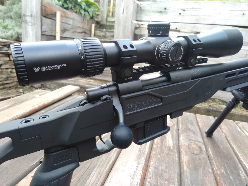

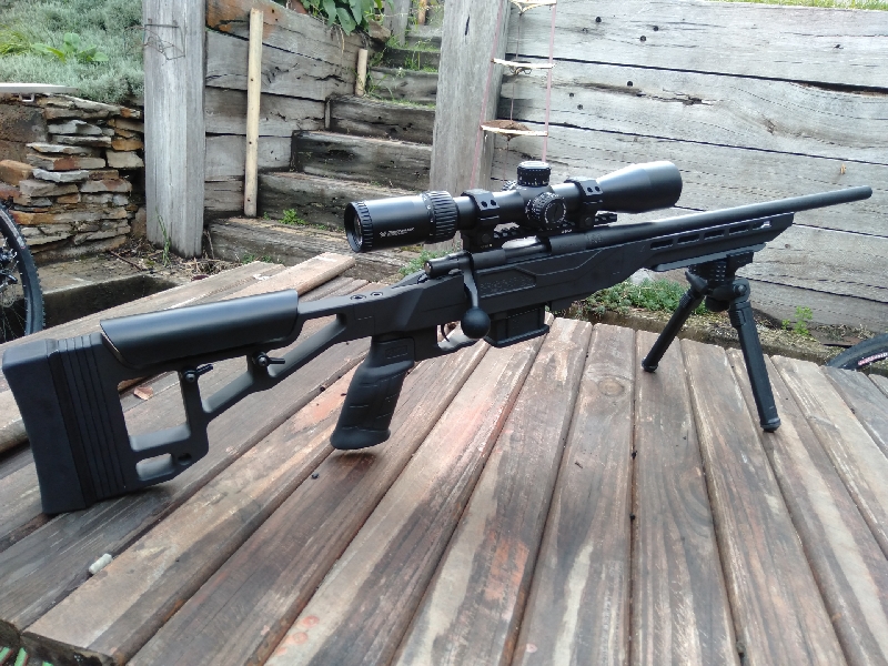

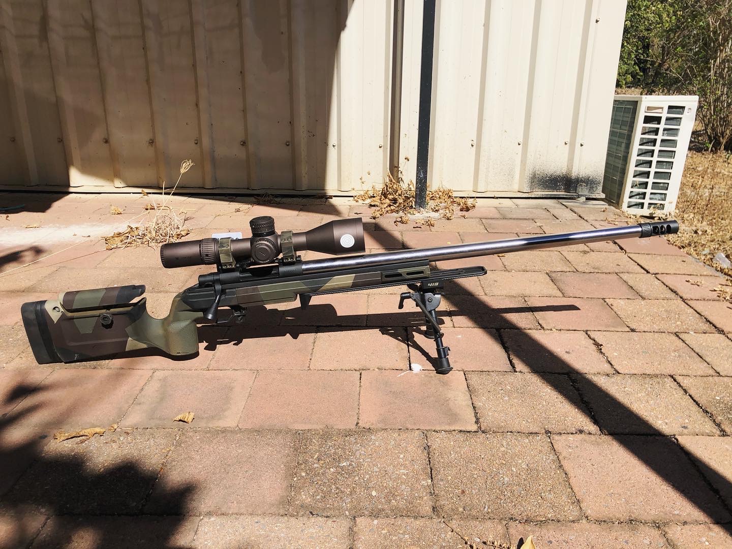

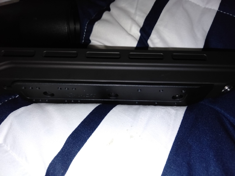

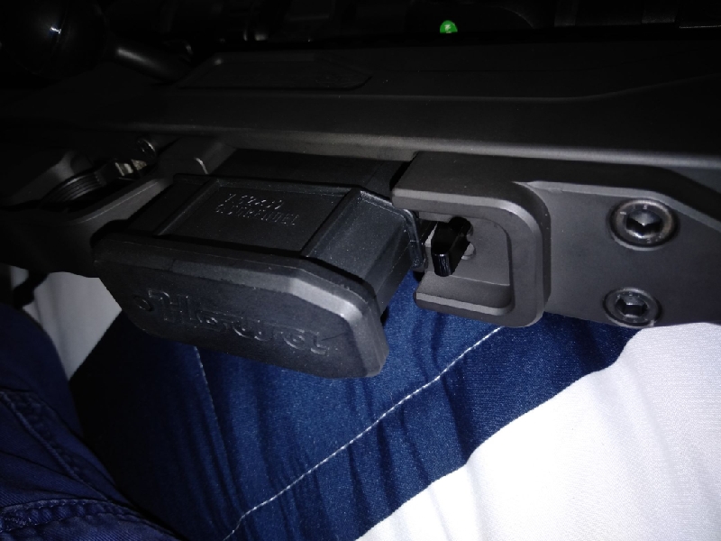

Got my Mini Action in 6.5 Grendel into my new chassis today. It is the Southern Cross Small Arms TSP-X. Feels very solid and went together easy as you like.
I also attached an MDT Arca Swiss 7" rail on the fore end. Just waiting on another set of rings so I can put my Diamondback Tactical scope on and swap this one back to the 204.

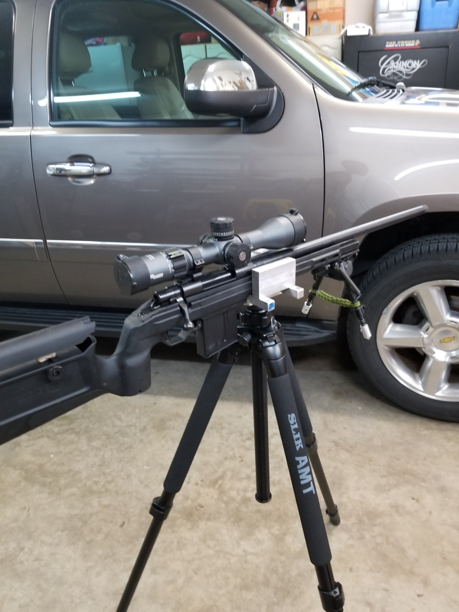

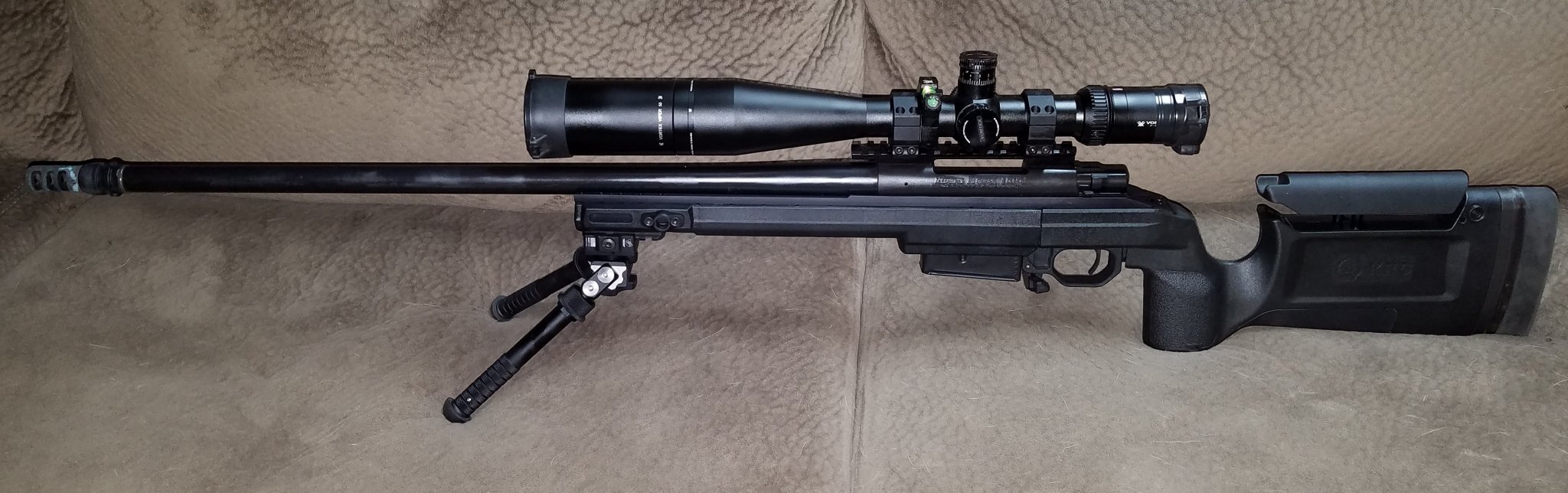

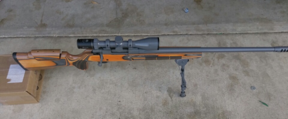

Ready to Zero! Finally got my first ELR rifle put together after scrounging hand-me-down parts and online sales. Was my hunting rifle for over 25 yrs.
Components: Weatherby Vanguard (Howa) 24" 7mm Rem Mag; original dual adj trigger; MDT chassis; Ergo grip; Magpul bipod; Luth-AR MBA3 stock; Vortex Strike Eagle 4-24x50 on 20 MOA rail; muzzle brake from Witt Machine.

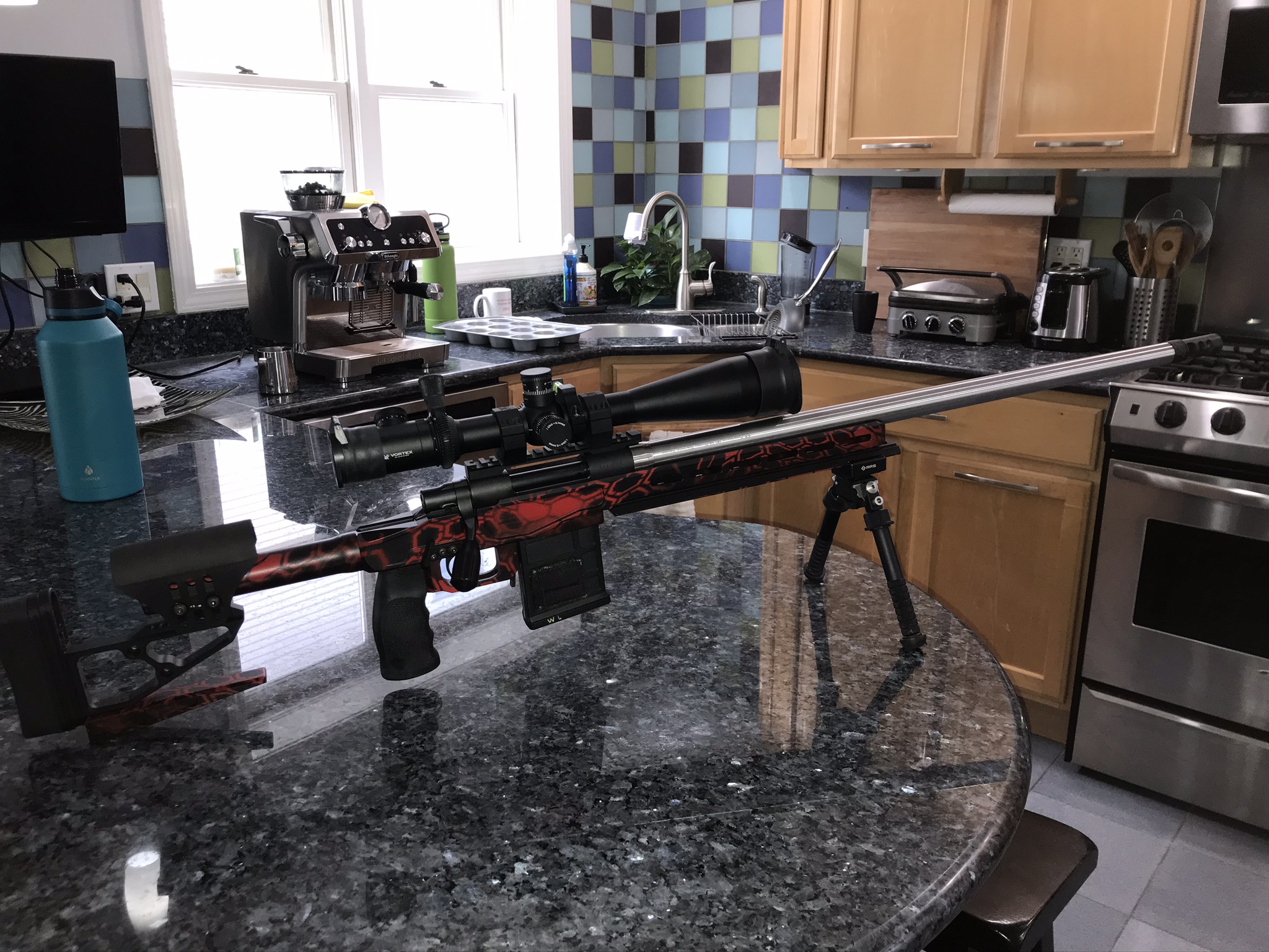

Here’s my current setup:
Howa 1500 .308 20” barreled action
Witt machine clamp-on brake
Bell & Carlson medalist 2 with
Matthew’s fabrication cheek riser
Viper PST 6-24x50
Talley 20 moa railView attachment 7196745

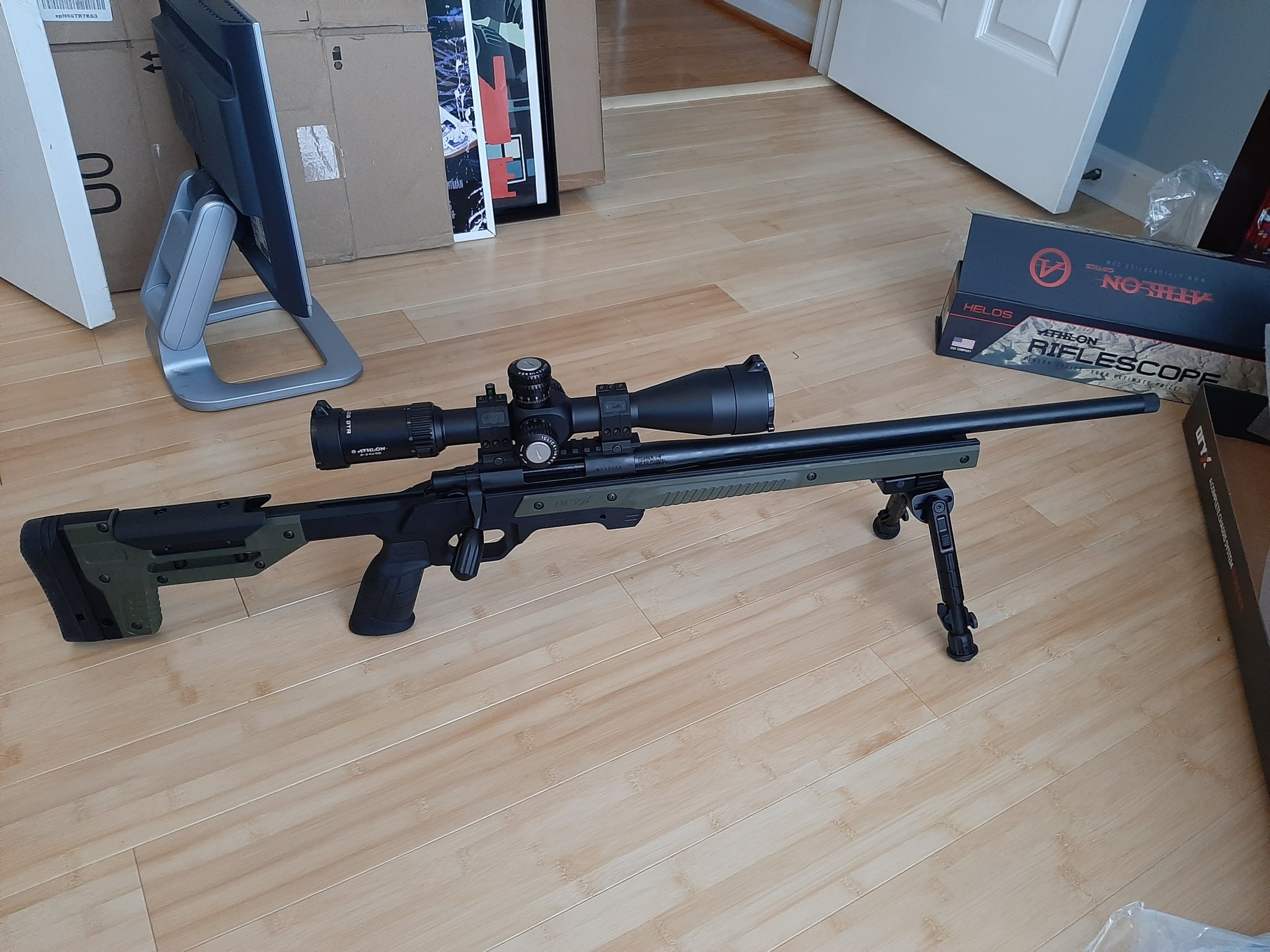

Here she is now in 6.5 creedmoor
26” McGowan prefit
XLR Element chassis
Insite heathen brake
Homemade. It's for sale, comes with a chassis.
I already order the chassis ot arrived this morning

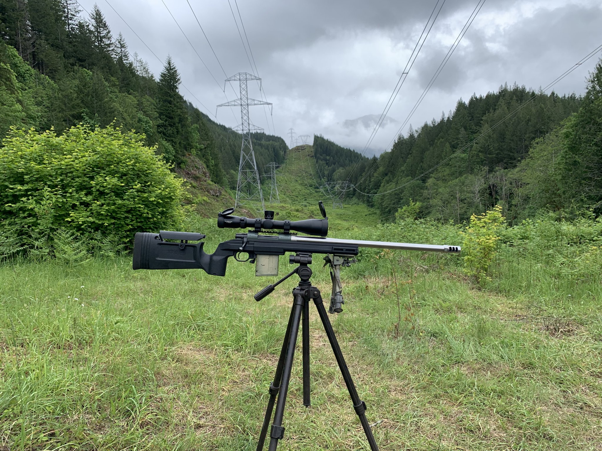

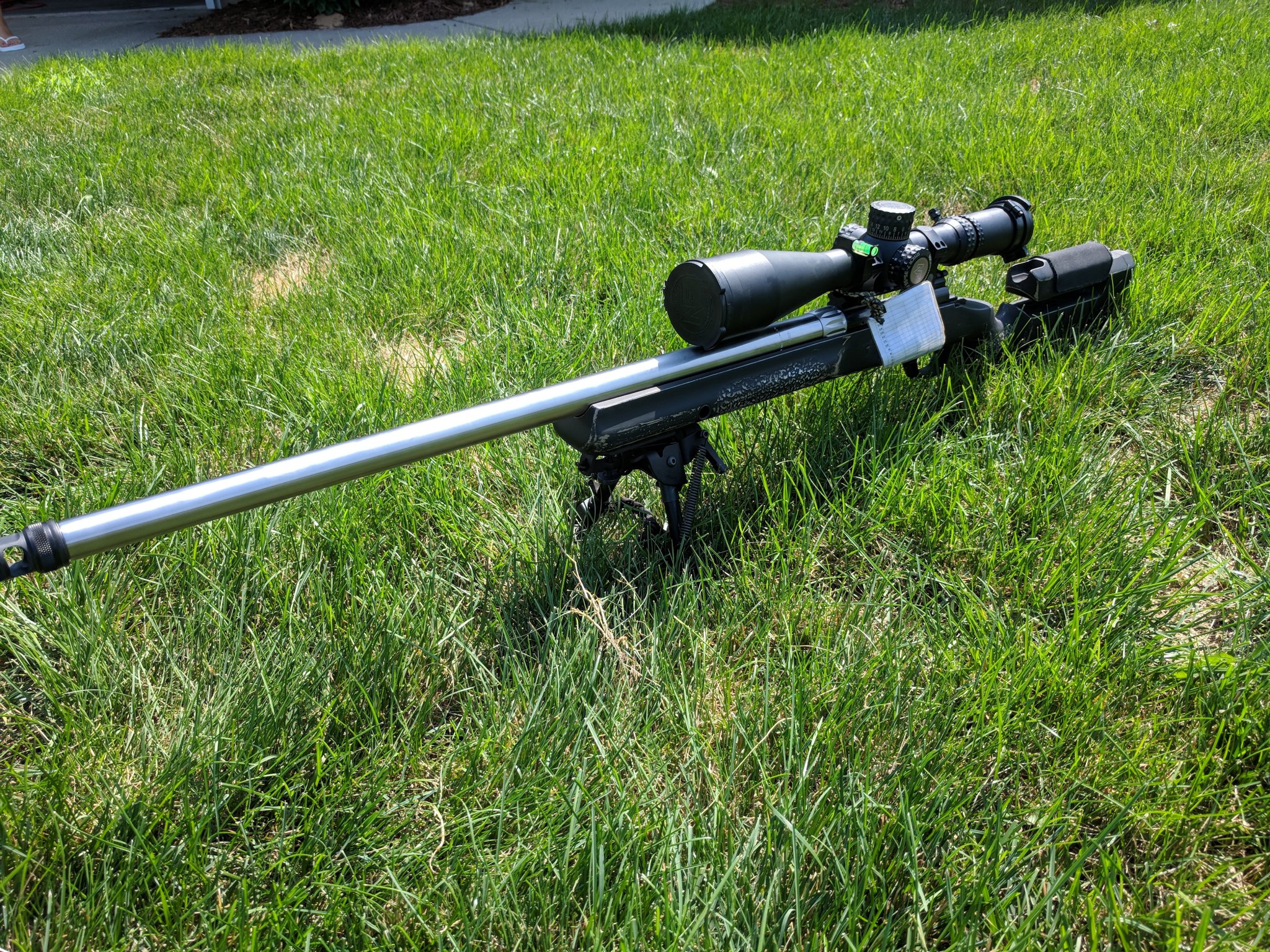

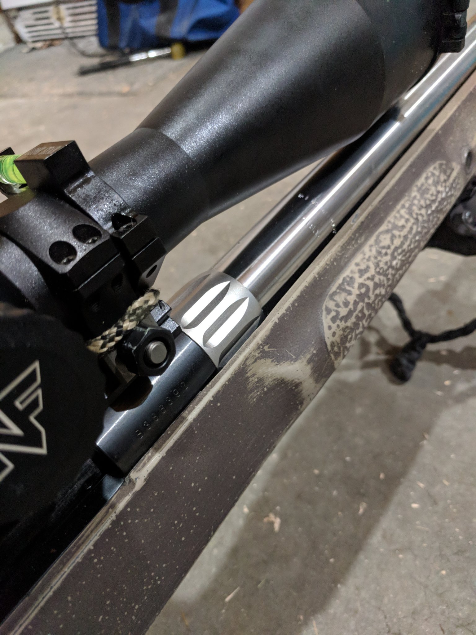

Howa 1500
Criterion Barrel 6.5CM 1:8T 26"
ThunderBeast CB Brake (for Ultra 9 can)
Bighorn Barrel nut system,
Manners T4A Stock,
Timney Trigger (forget which model),
DBM from Manners,
NightForce ATACR 7-35x plus NF Rings
EGW 20MOA Rail

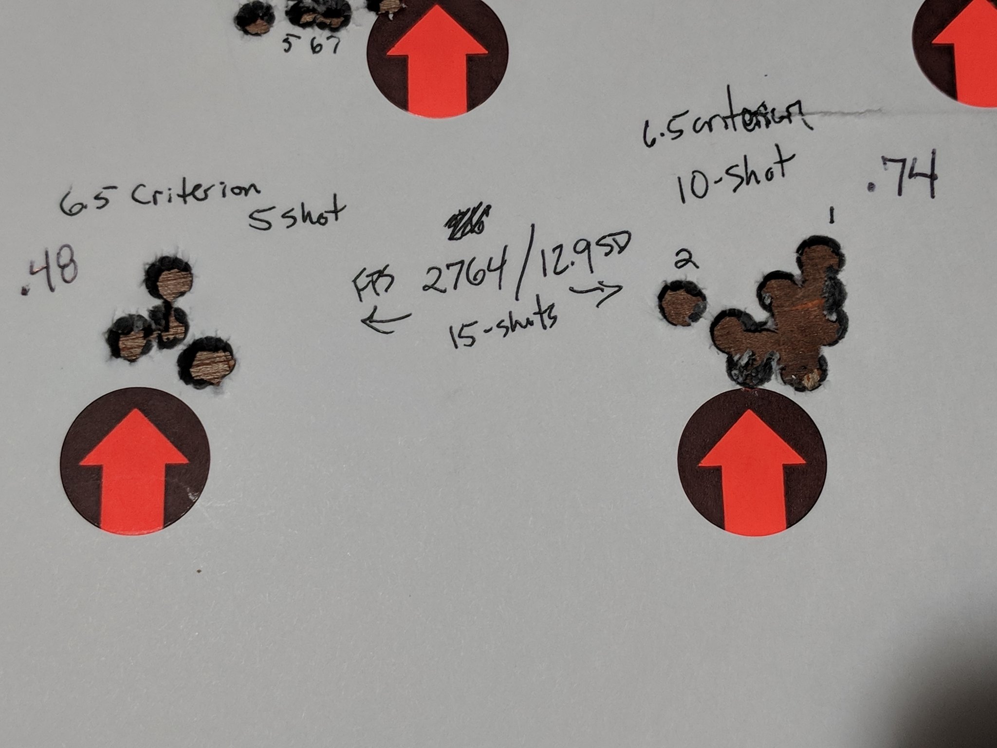

Action is 3 years old and just rebarreled this season with new prefit from Criterion. Great system! The load below is a factory ammo clone that I use for practice. Holds .5moa or just under nearly every outing. The 10 shot group CB and second shot are know to be at 1 and 10 consistently with this load.
Bottom picture Berger VLD hunts shoot about .1-.2 better than the ELD 140s shown.
Picture above: 3 shot zero test Berger VLD Hunt and on right is 3shot 140ELDM. Berger's are used for matches and they hold .3-.4 over 5 shots and sub .5-.6 for 10shots.
How difficult was it to remove that barrel? Any tips?
These barrels are quite hard to remove. If you have a barrel vide and an action wrench it can be a bit rough.
I made some clamps at my shop. Even with these it was a pain. In a bit of frustration I smacked the wrench with a mallet and things loosened up.
Has anyone tried a law tactical folder on the HCR chassis? I’m curious if it would work. That would be a slick setup for my 18.5” barrel
Save a little money and just get the SB Tactical folding adapter.
Get a SOLID barrel vise and action wrench for the Howa. It should spin off with a bit of elbow grease. I ended up clamping action in vice and using a pipe wrench and cheater to break mine free.
Yours may come off easier or harder. But once off, it was great to use the barrel nut to re-barrel with a criterion using tools I had plus a new go gauge.

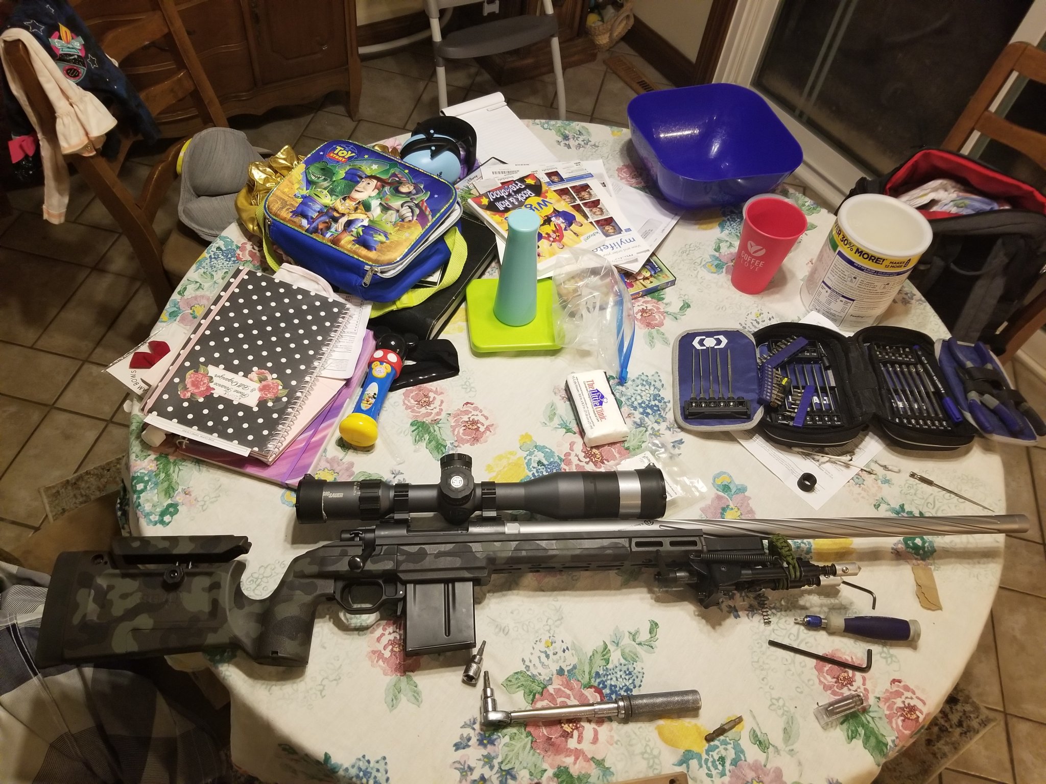

Ended up giving my Howa 6.5 Creed a birthday. Went to the smith for a bit of work:
-turned down firing pin and bush bolt face
-oversized bolt knob
-oversized scope rail screws
-IBI 6mm 7.5T M24 barrel in 6BR
-microslick cerakote bolt body
Turned out way better than I expected and it’s a hammer with 108ELDs. Will be my PRS match rifle until my Defiance Ruckus arrives.

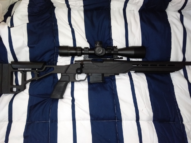

My budget build:
- .308 short action
- 24" heavy barrel
- Bell and Carlson tactical stock
- Athlon Argos BTR 6 - 24 x 50 scope with Weaver rings (purchased used from a Hide member)
- Detachable magazine conversion kit (also used from a Hide member)
- Extra bipod from the back of the safe
Barreled action and stock were both purchased on sale, so the overall build was ridiculously inexpensive. Shoots really well with 168gr hand-loads.
