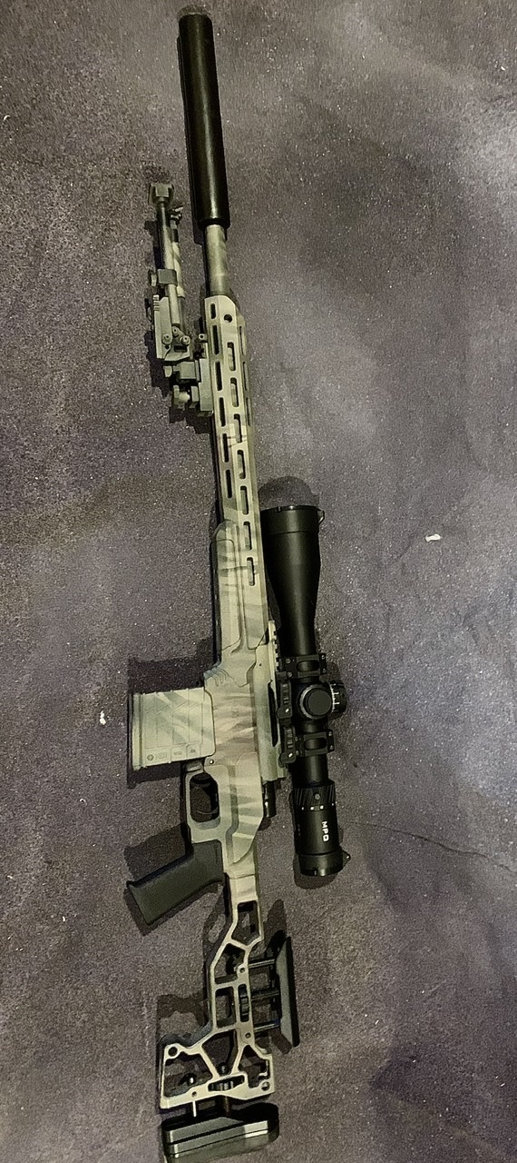

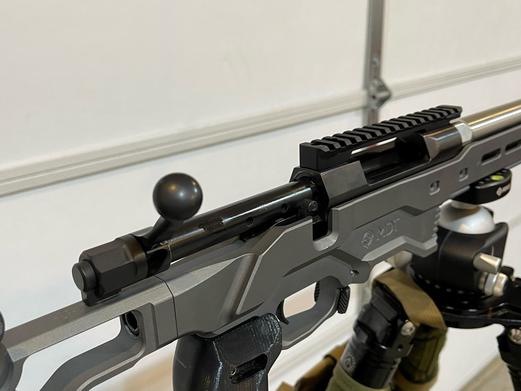

Heavy threaded barrel with an SRT Shadow XL can, ESS chassis with GG&G bipod, AMD QR on an MDT 20 rail with the Brownells 5-25 MPO.

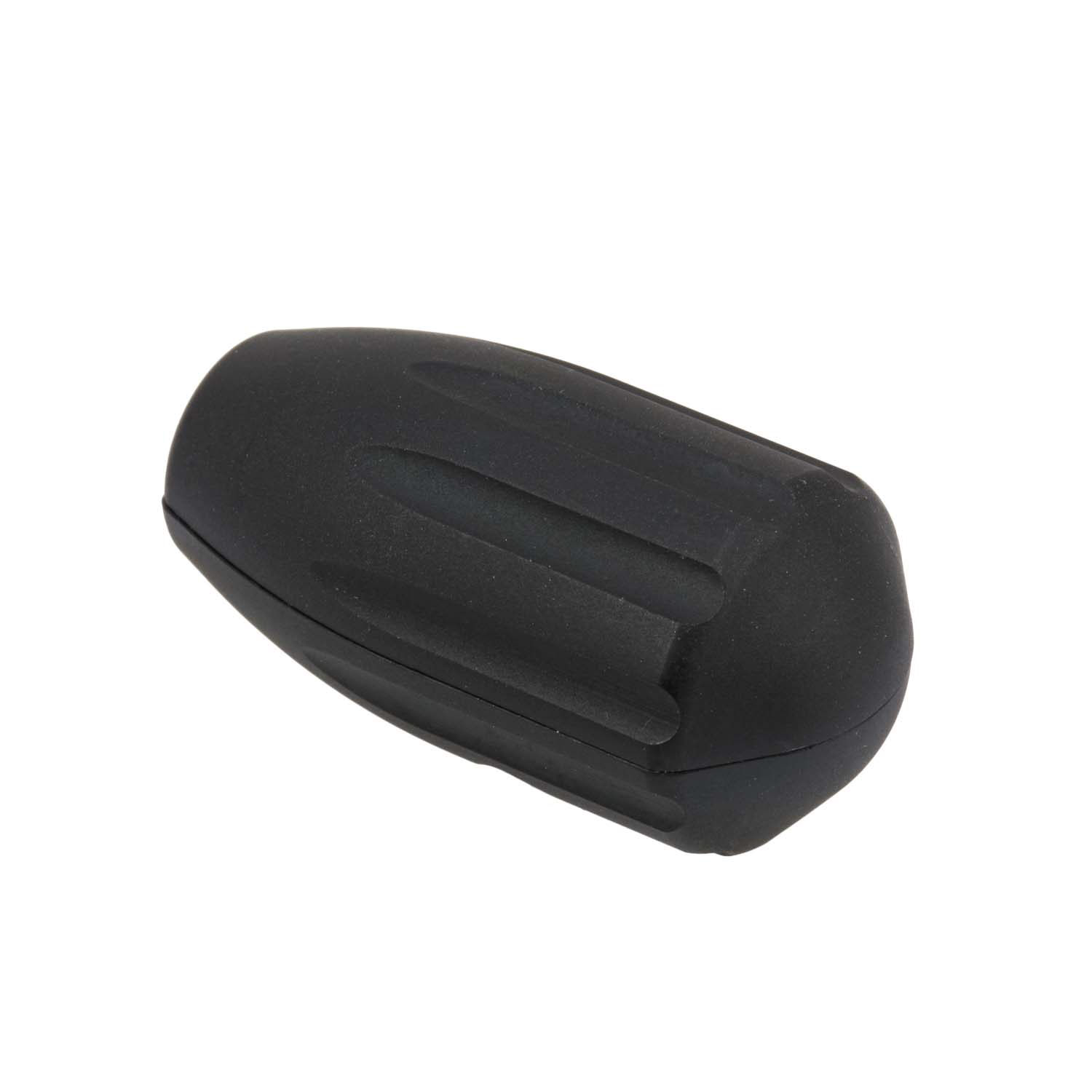

@BurnOut Who did the bolt knob? I finally have a mini in .223 coming my way. The bolt knob is one of the first things I want to get done.
AD Custom Arms does Howa knobs and The Polished Knob does as well.
I have a Howa mini that the Polished Knob did for me - all is well. I have also had knobs done by LRI and AD Custom Arms. All experiences were positive and all quality work.

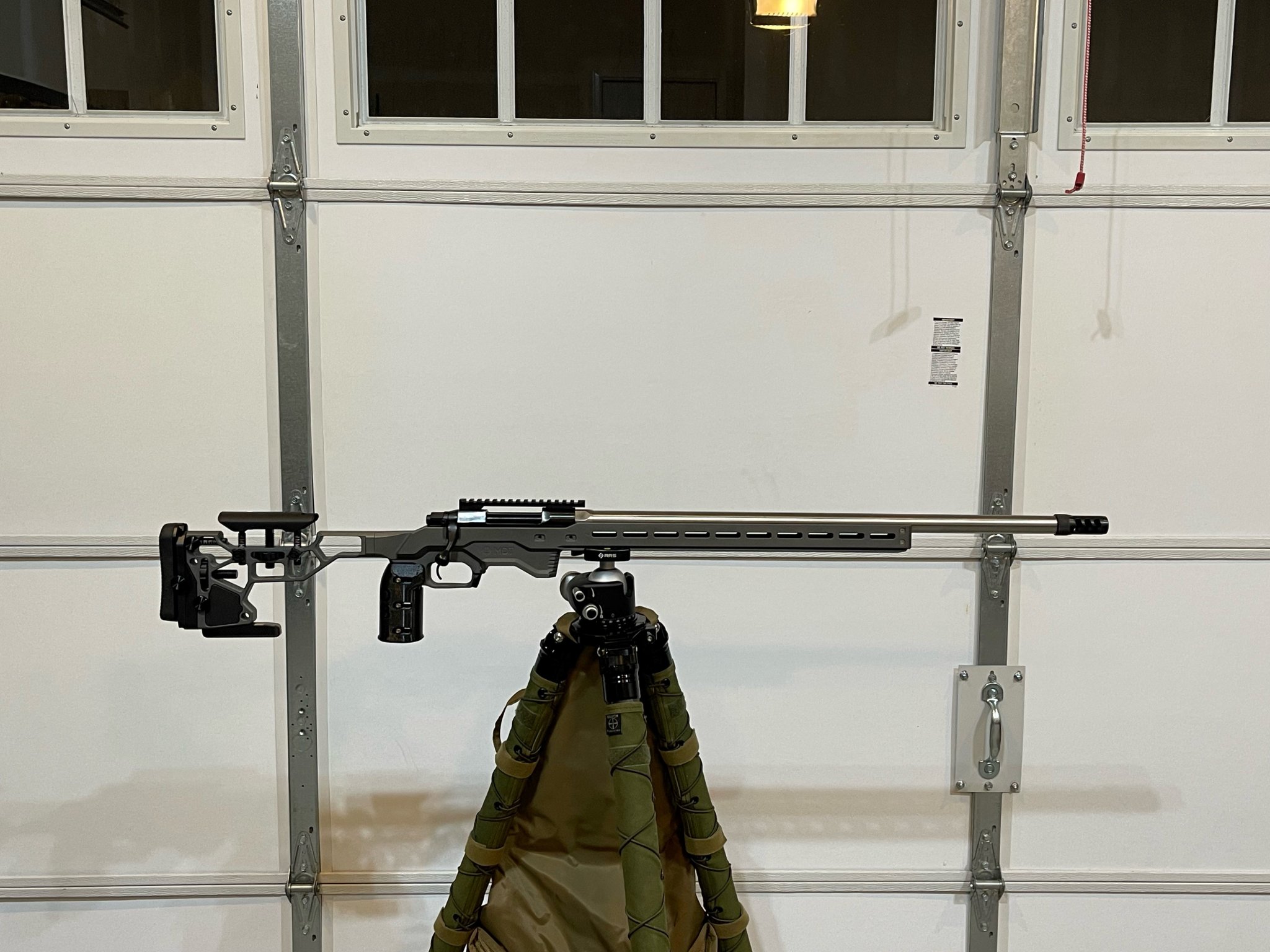

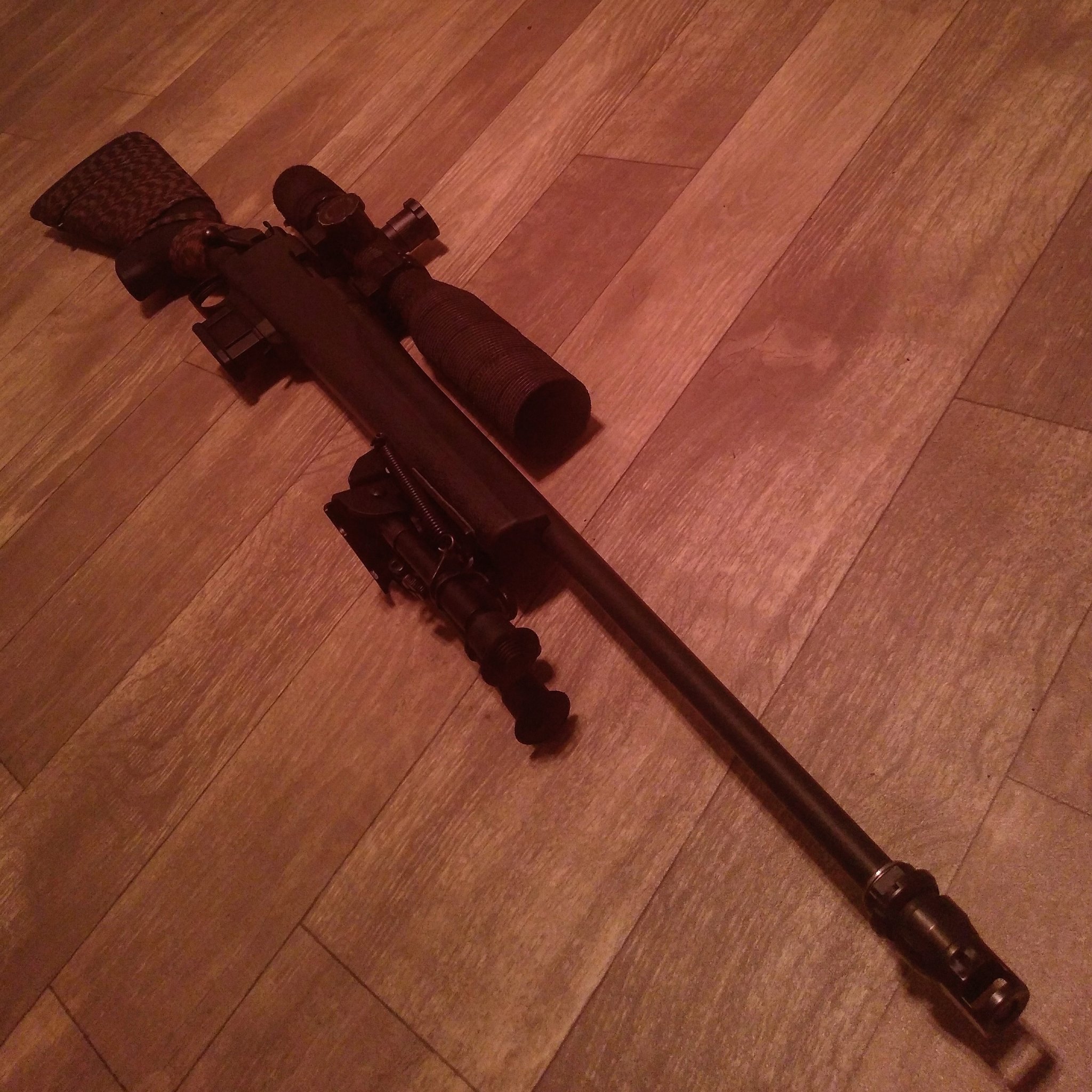

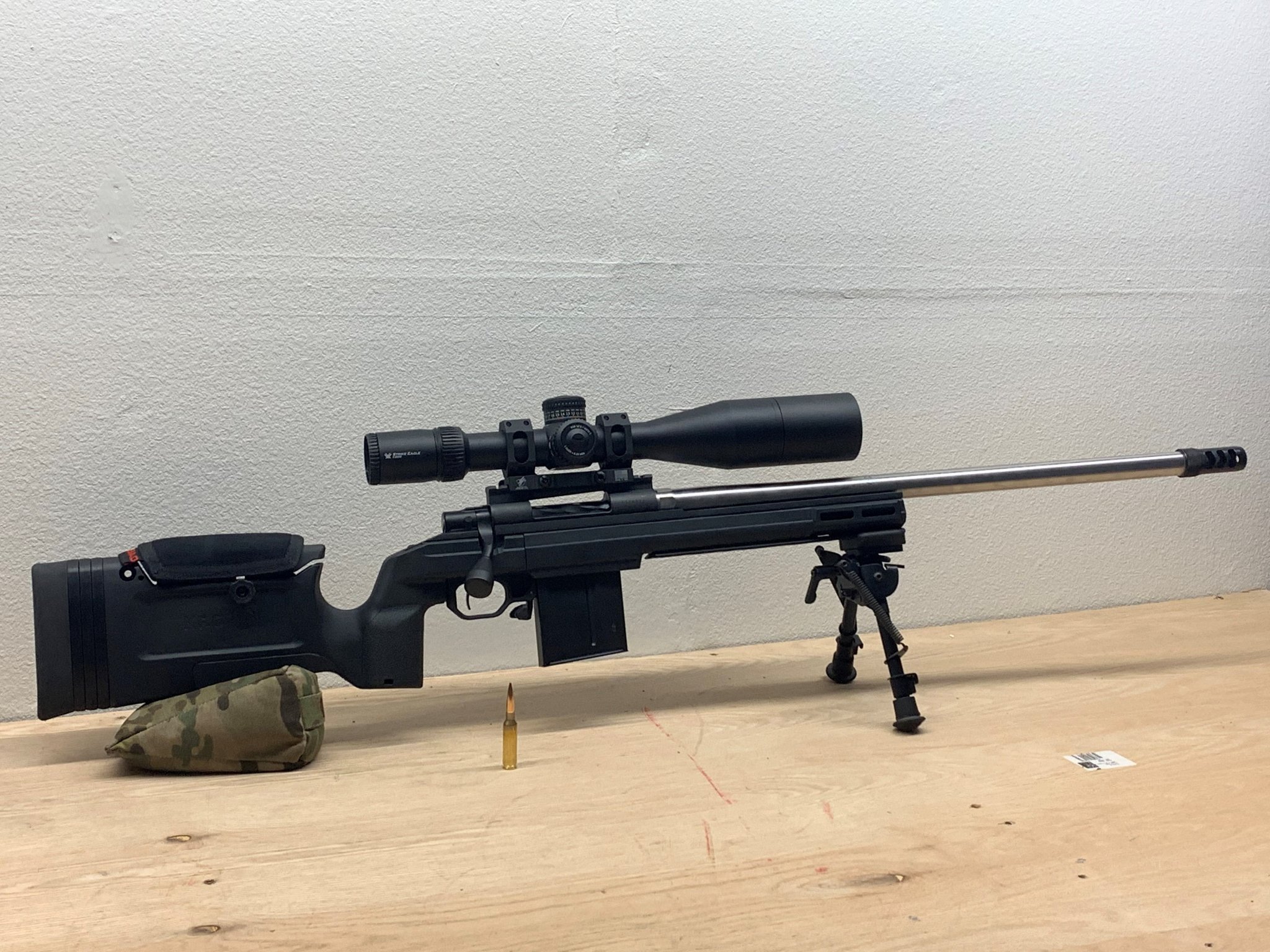

Here is mine.
Howa 1500
Preferred Heavy Palma Howage Barrel 1/8 twist
KRG Bravo with arca rail
wiebad pad
harris bipod
ken farrell base
American defence mount
Vortex Strike eagle 5-25
jard trigger
Area 419 3 port

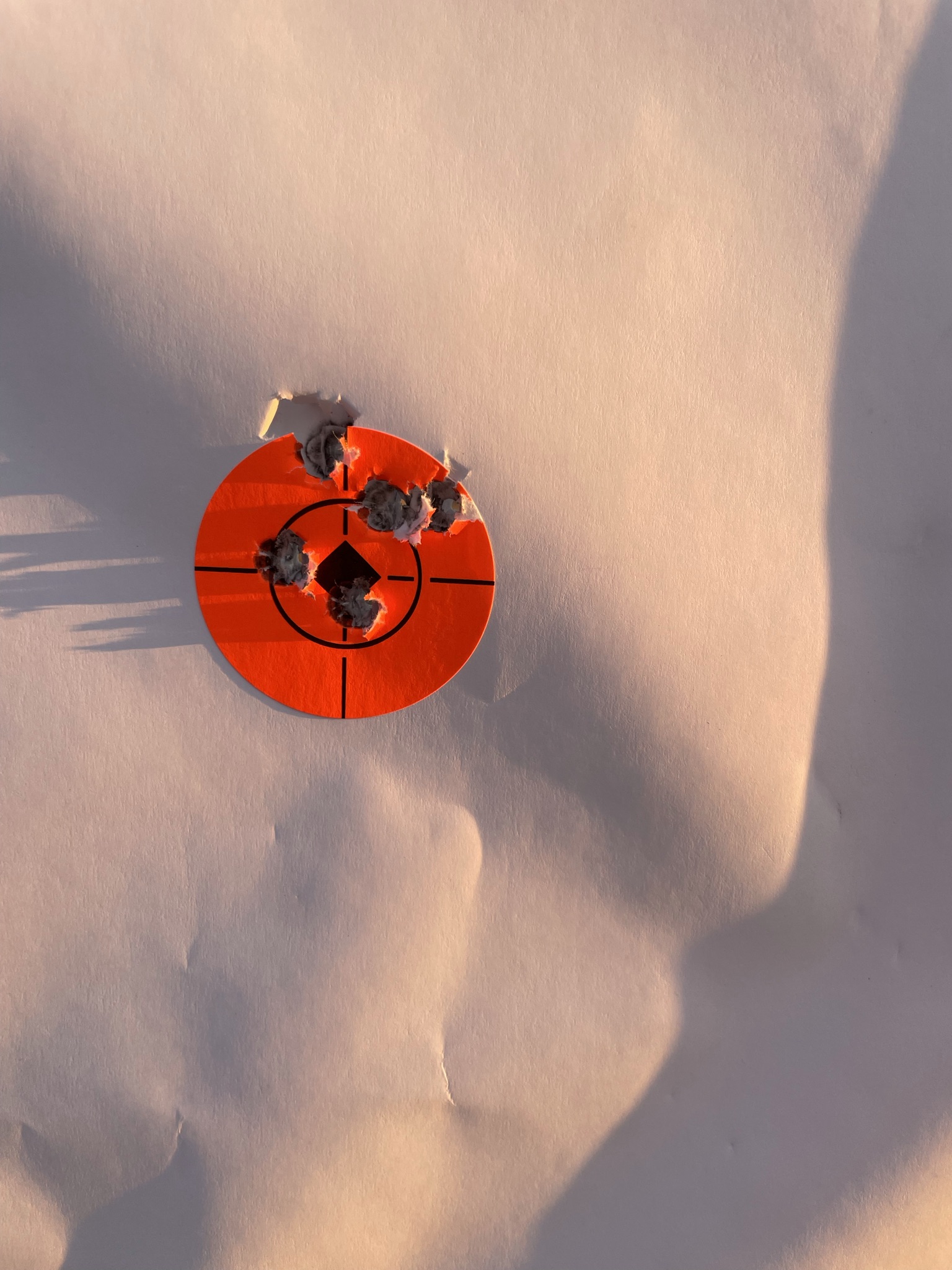

I thought the HACT trigger with Gunbloke Benchrest kit was good (and it is with an ~1lb pull), but the Jard is amazing!
I just got my Jard trigger last week and have only put a 100rds down range with it... but hot damn! I ordered the 6-8oz version, and it has delivered as promised, mine is somewhere between 8-6oz (light enough where my Wheeler trigger-pull measuring tool can't measure it) and is every bit as good as any Trigger Tech Diamond I've felt... Yeah, I will kind of miss the second-stage goodness, but getting used to the single-stage Jard is overall well worth the trade off.
The other day I was hammering an IPSC at 1000yrds off of a wobbly barricade, making impacts I had no business making (and that I couldn't make any near as consistently before with my old trigger). If you dig the Howa, and are looking for a trigger that's comparable to what the 700-clone guys get to run, the Jard is worth a hard look IMO.
(FYI/FWIW the Jard lightened up bolt-lift on cocking a little bit too, in case anyone is wondering...)

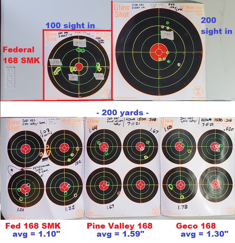

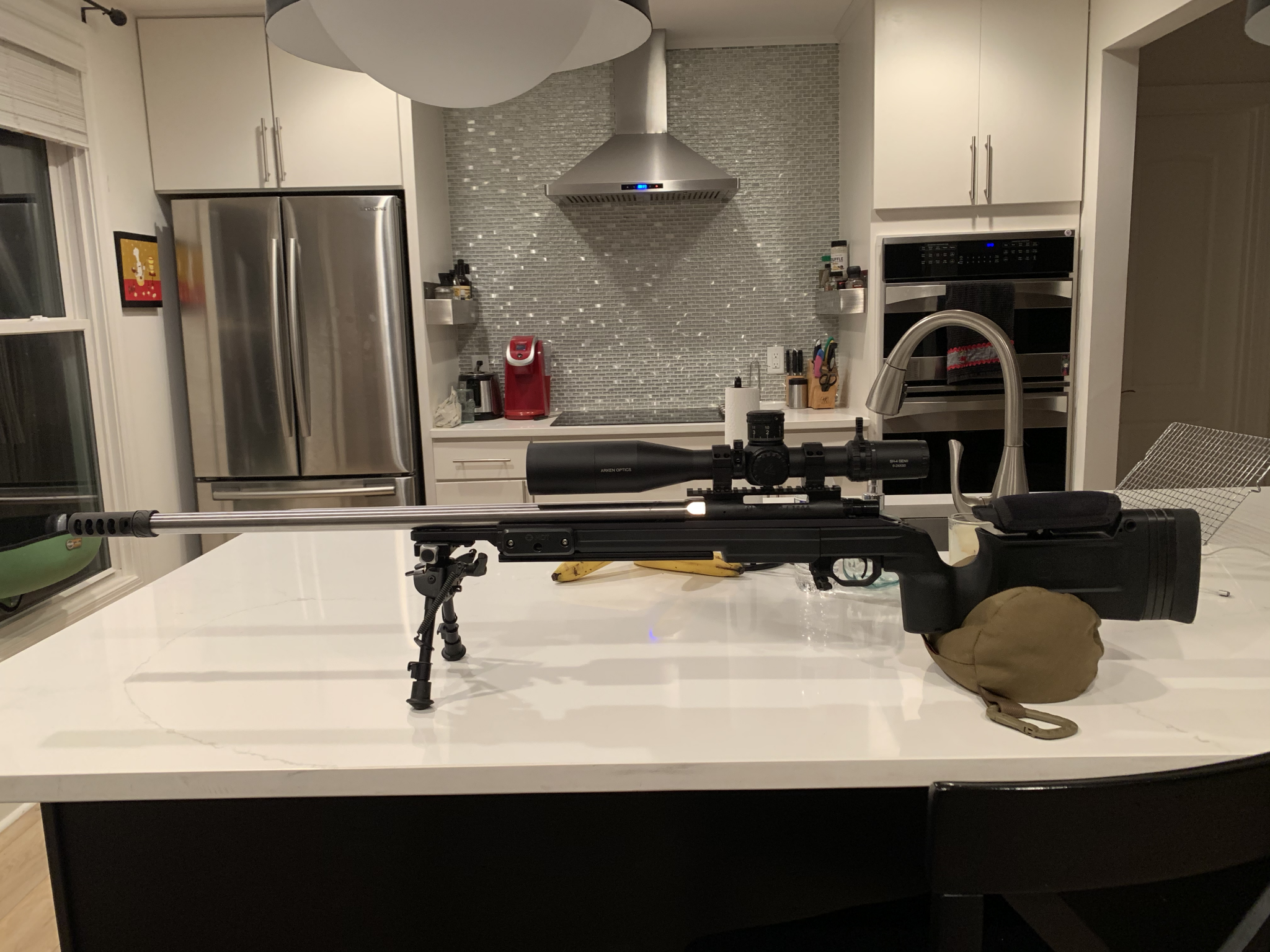

Recently joined new member here. 10 years on another gun forum, but life has pushed me towards precision and long range, so here I am.

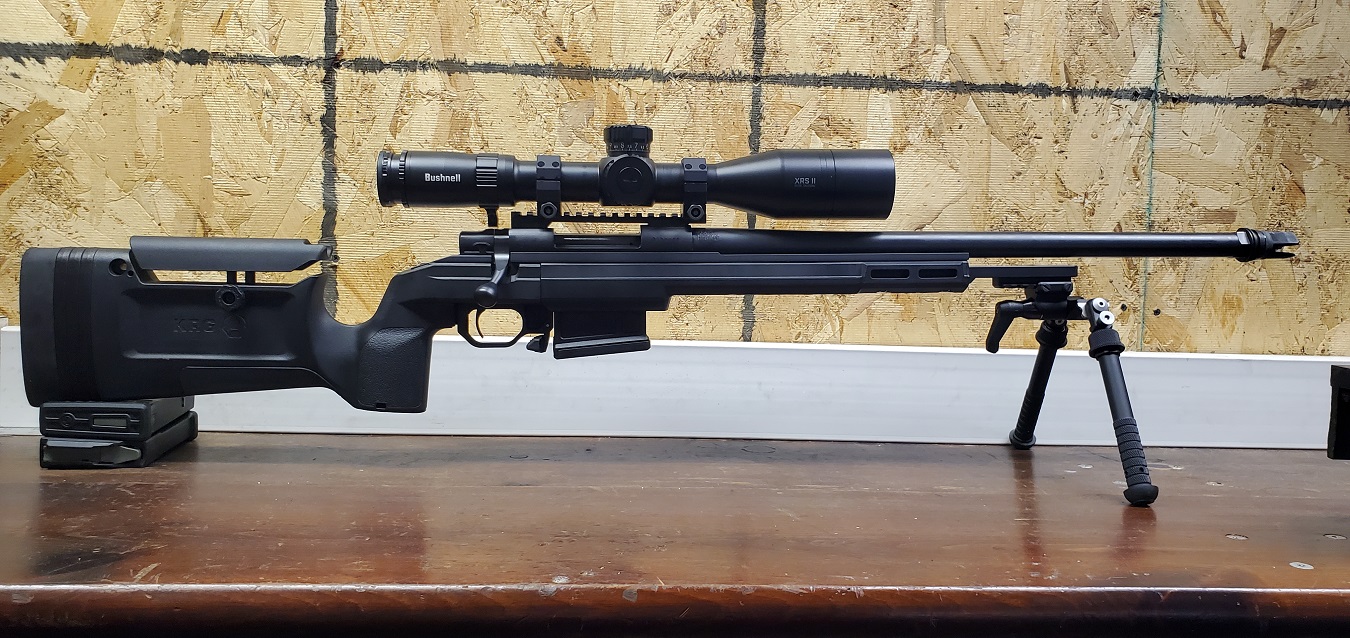

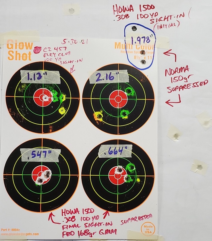

I also recently picked up a used Howa 1500 in .308, sitting in a KRG Bravo chassis. I really like the factory 2-stage trigger on this one and LOVE the Bravo. I added my suppressor mount and put together some initial groups at 100 yards that I'm quite pleased with using my can (Sig SRD762TI-QD). This rifle cost me half what I was gonna spend on a Bergara, so I really can't complain at all. I've always been pleased with a factory rifle that shoots 1 moa using factory ammo.
The scope is a Bushnell XRSII 4.5-30x50 with a H59 reticle in EGW rings on a 20moa rail. The KRG minimalist spigot and Atlas bipod were added by me also. The previous owner barely got past the break in period with the barrel, so I'm hopeful group size will improve. My plan is to get dope on the rifle to 300 at my local range and then head an hour north and shoot to 1000 this year. Never done that before.
Enough talk, picture time. :)

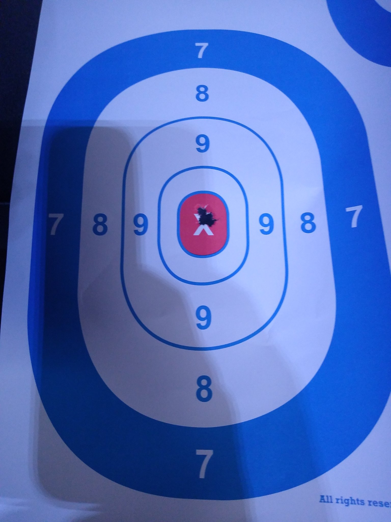

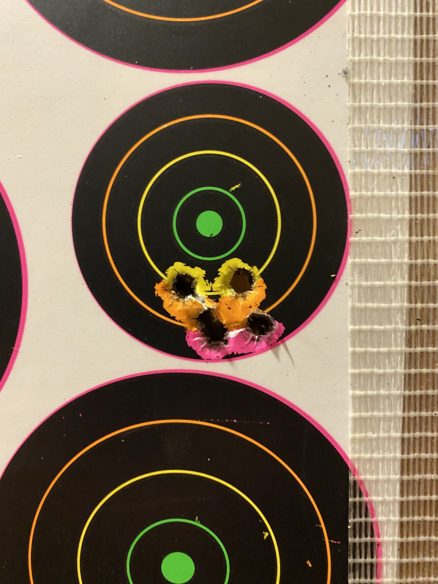

(fair warning, I like to post pictures of targets, good or bad)

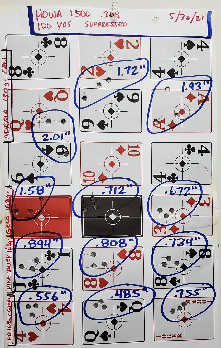

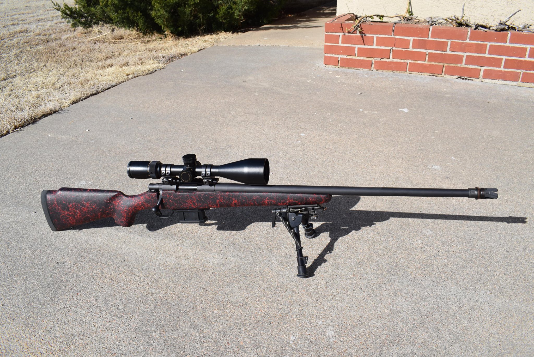

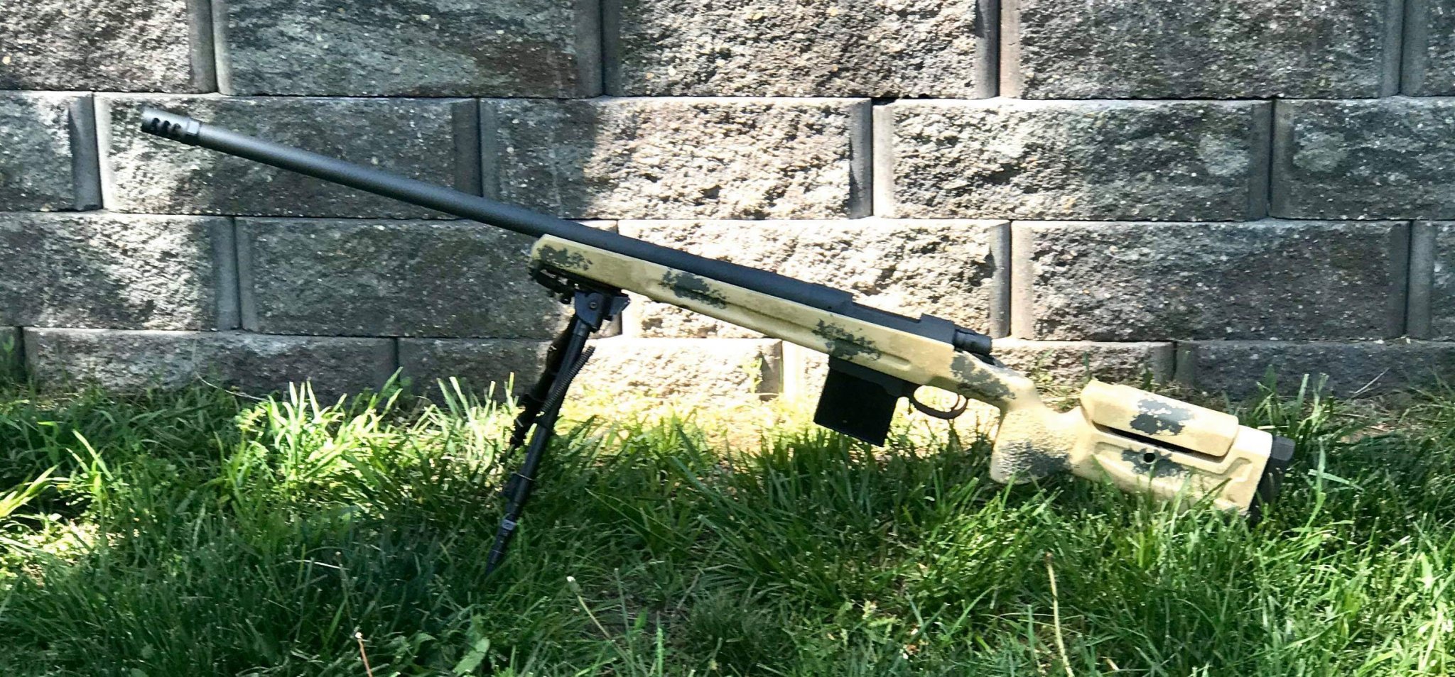

My budget build:
- .308 short action
- 24" heavy barrel
- Bell and Carlson tactical stock
- Athlon Argos BTR 6 - 24 x 50 scope with Weaver rings (purchased used from a Hide member)
- Detachable magazine conversion kit (also used from a Hide member)
- Extra bipod from the back of the safe
Barreled action and stock were both purchased on sale, so the overall build was ridiculously inexpensive. Shoots really well with 168gr hand-loads.

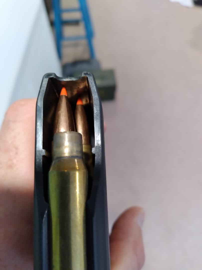

I have a similar setup built off a Brownells sale barreled action. What seating depth do you find it likes that fits in those legacy sports mags?
Reactions: 1500varmint
I have a weatherby vanguard 300winmag action that will live in an MDT LSS-XL. It's the 26 inch sporter barrel, I had a compact brake fitted, so we will see how that goes. 40MOA rail, 4.5-27 power 50mm objective scopes will have a little bit of wiggle room for 100 yard zero and should allow holdover for a mile. Vertical grip and a few spare magazines. I'm curious to see how far out I can seat the heavy projectiles, factory rounds leave a lot of space in the magazines.
The seating on my 2 most common handloads are 2.800, and 2.815 and both cycle without issue.
With that said, I just took a look and there doesn't appear to be a whole lot of extra room in the mag, so anyting longer might be an issue.

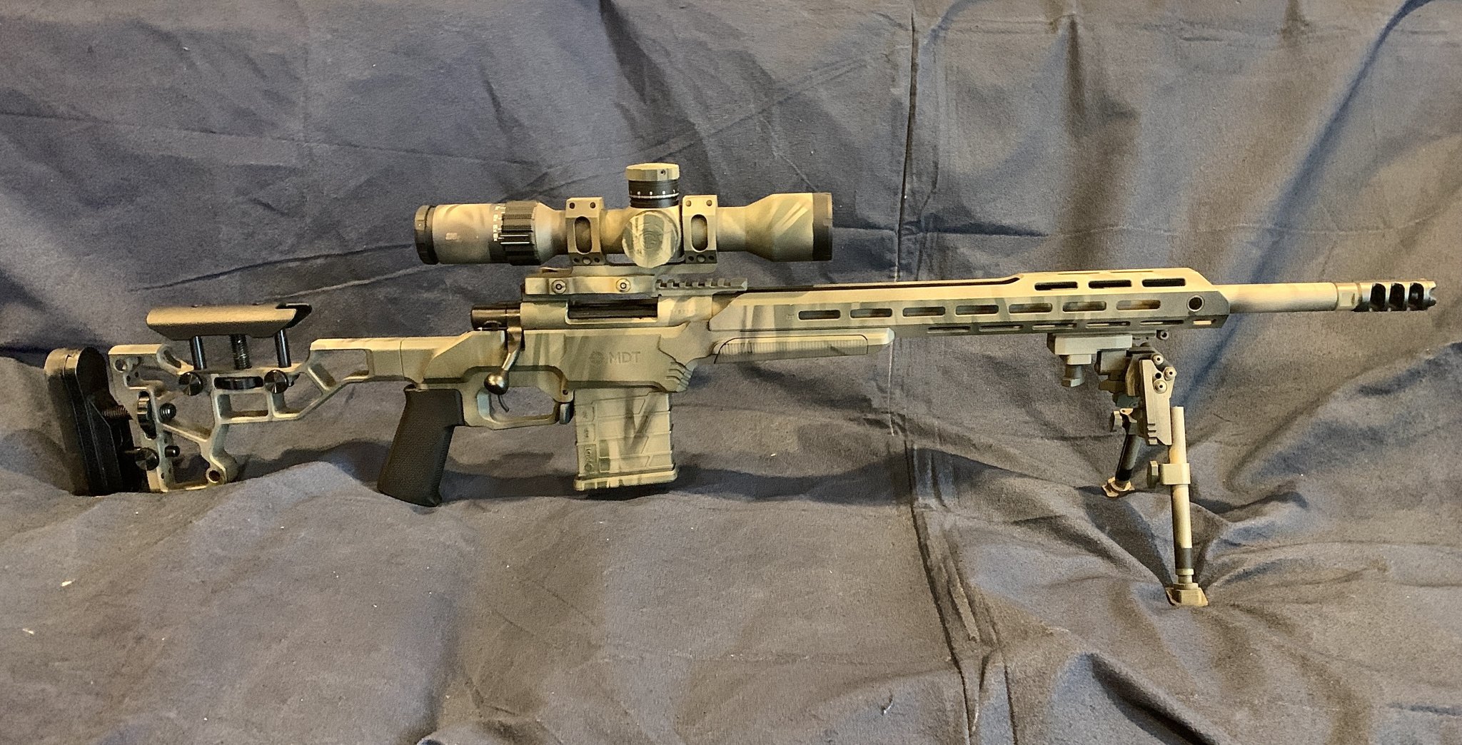

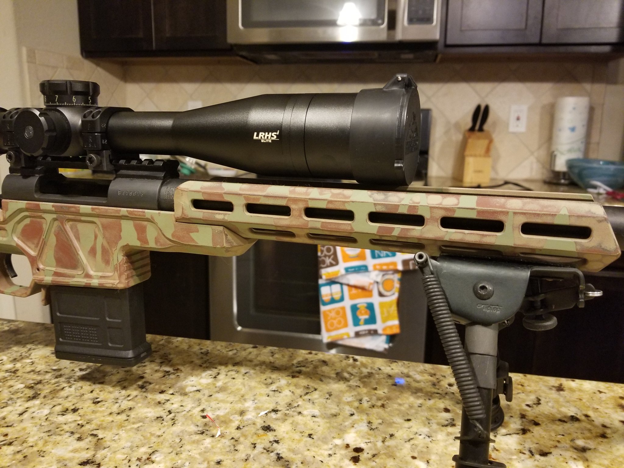

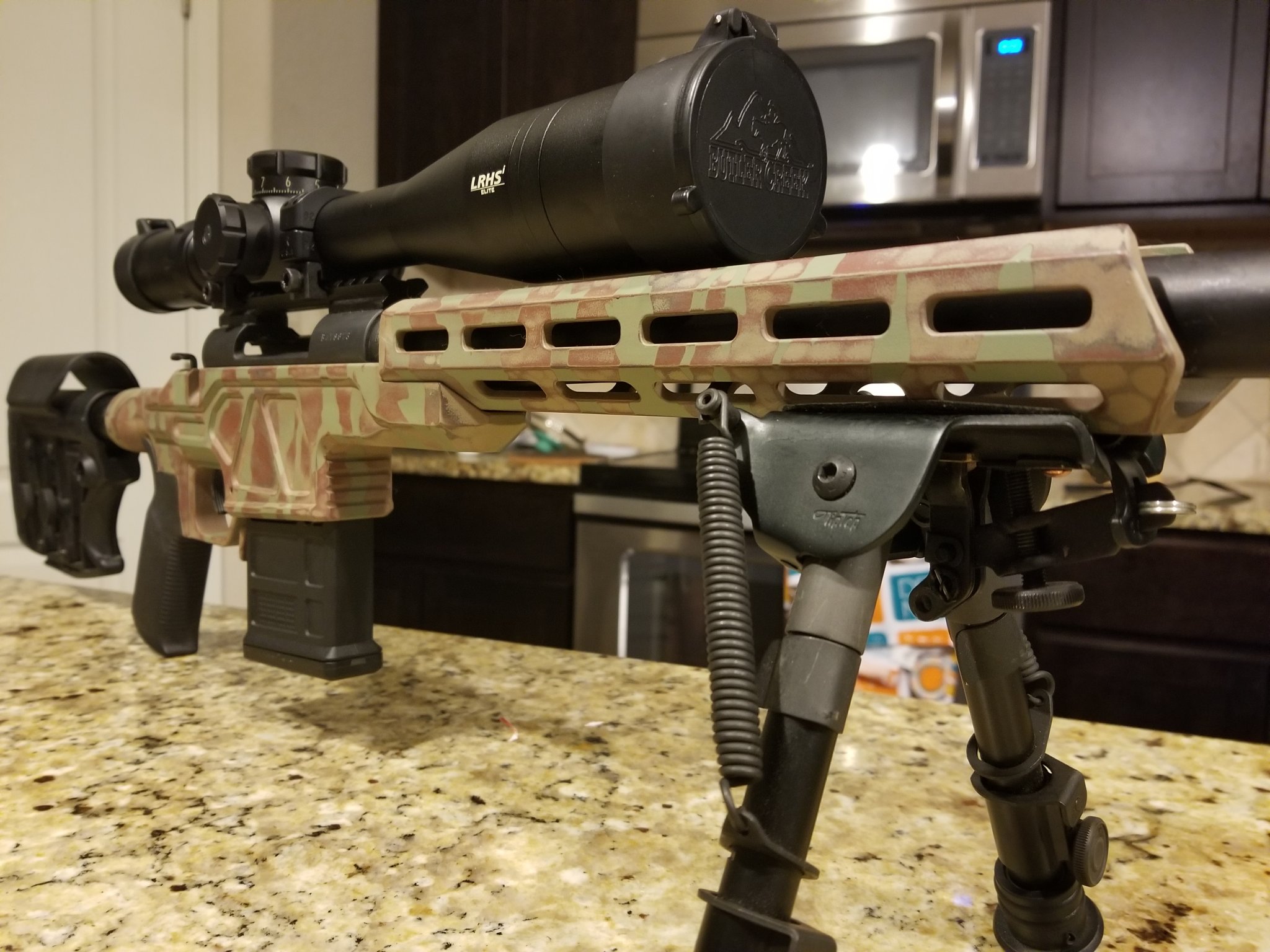

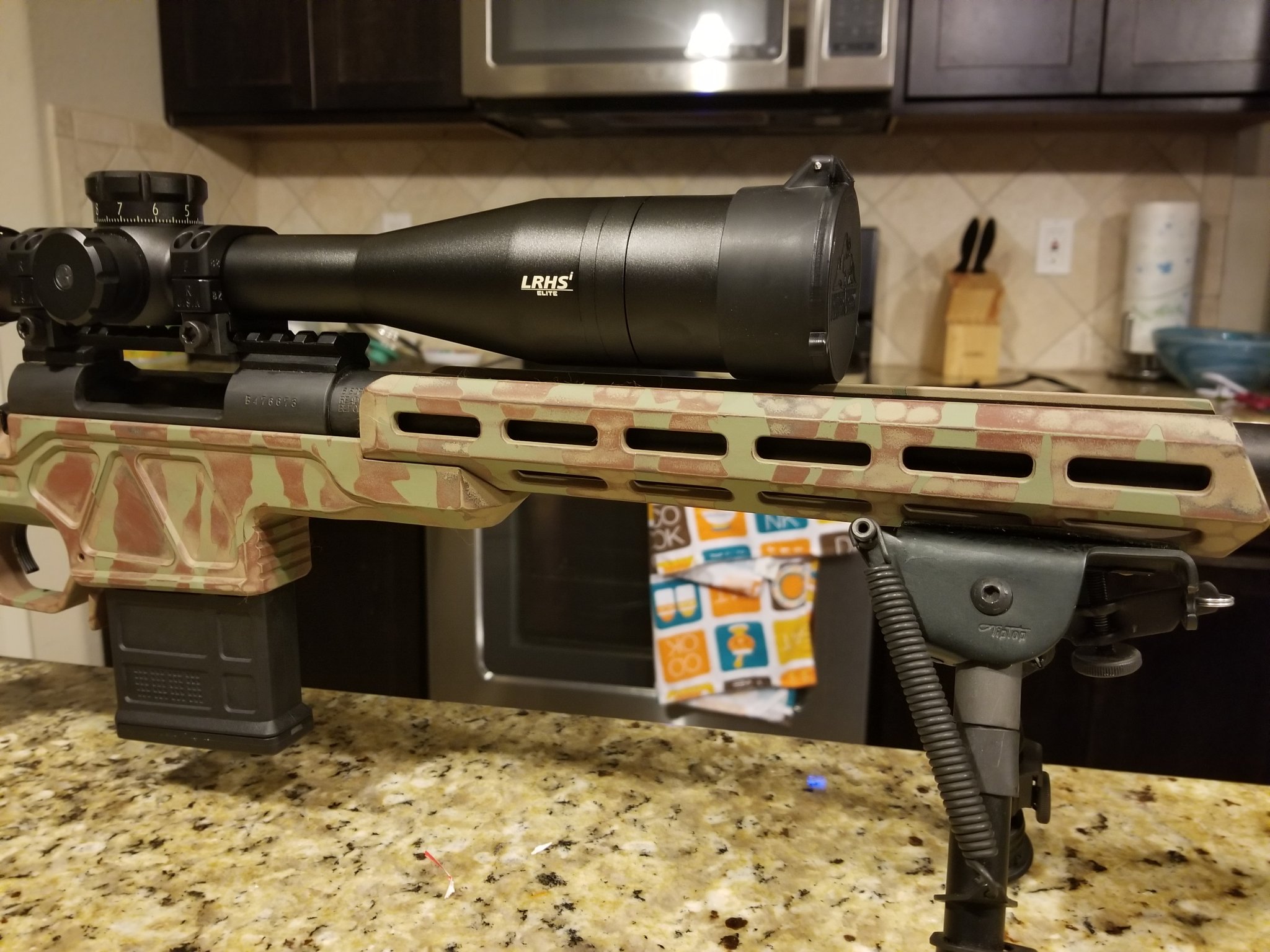

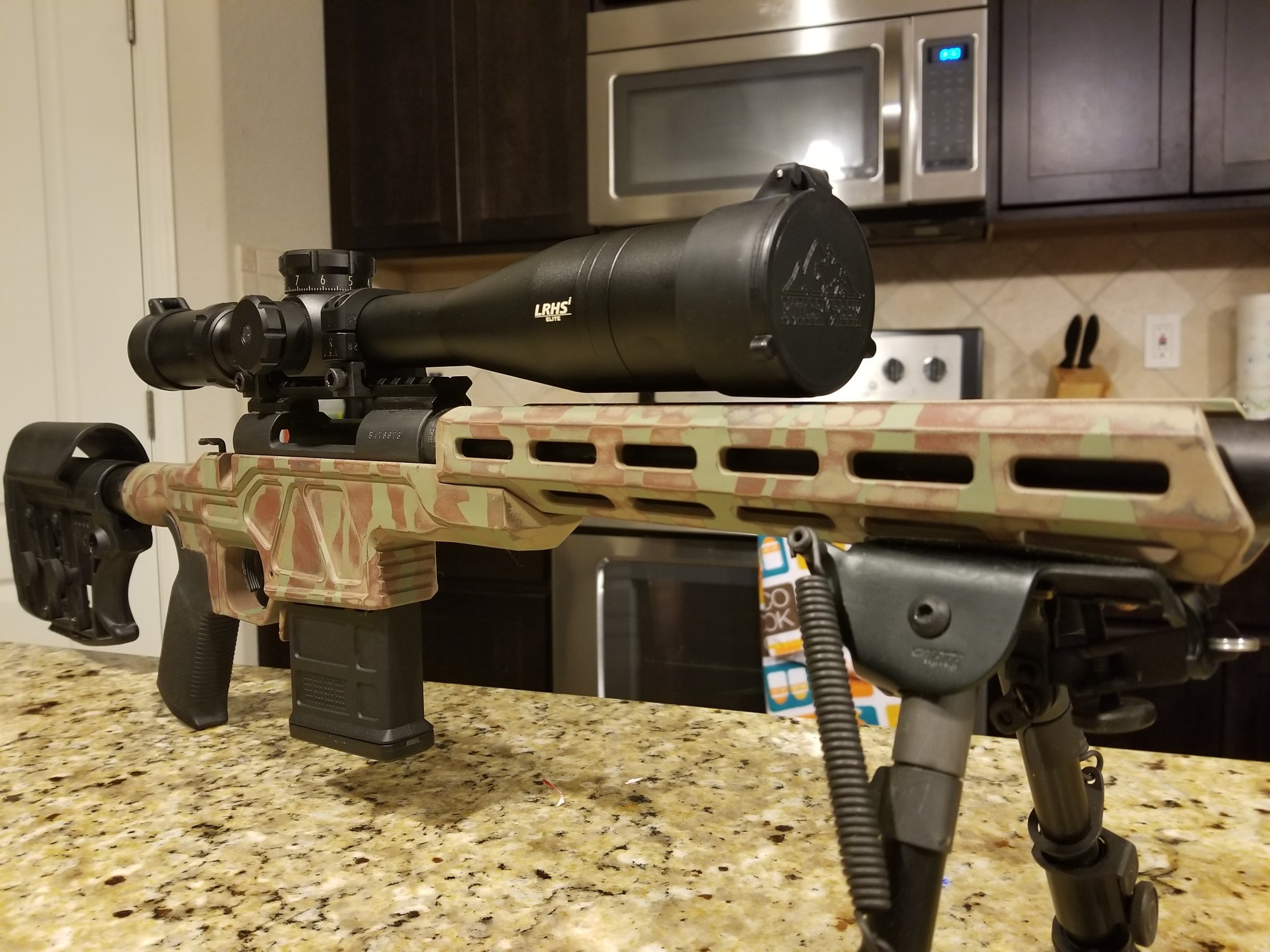

You've prolly repainted the rifle by now, I thought it worth mentioning that, although you might not have liked the colour scheme, IMHO, that camo is the most effective I think I've ever seen in breaking up the outline of the rifle.
Those two colours applied in that way are so effective at confusing the eye.
If you were to lay that rifle in the scrub & forget where you left it, you'd have a hard time finding it again.
You may not have liked the paint job but, it was damn effective.

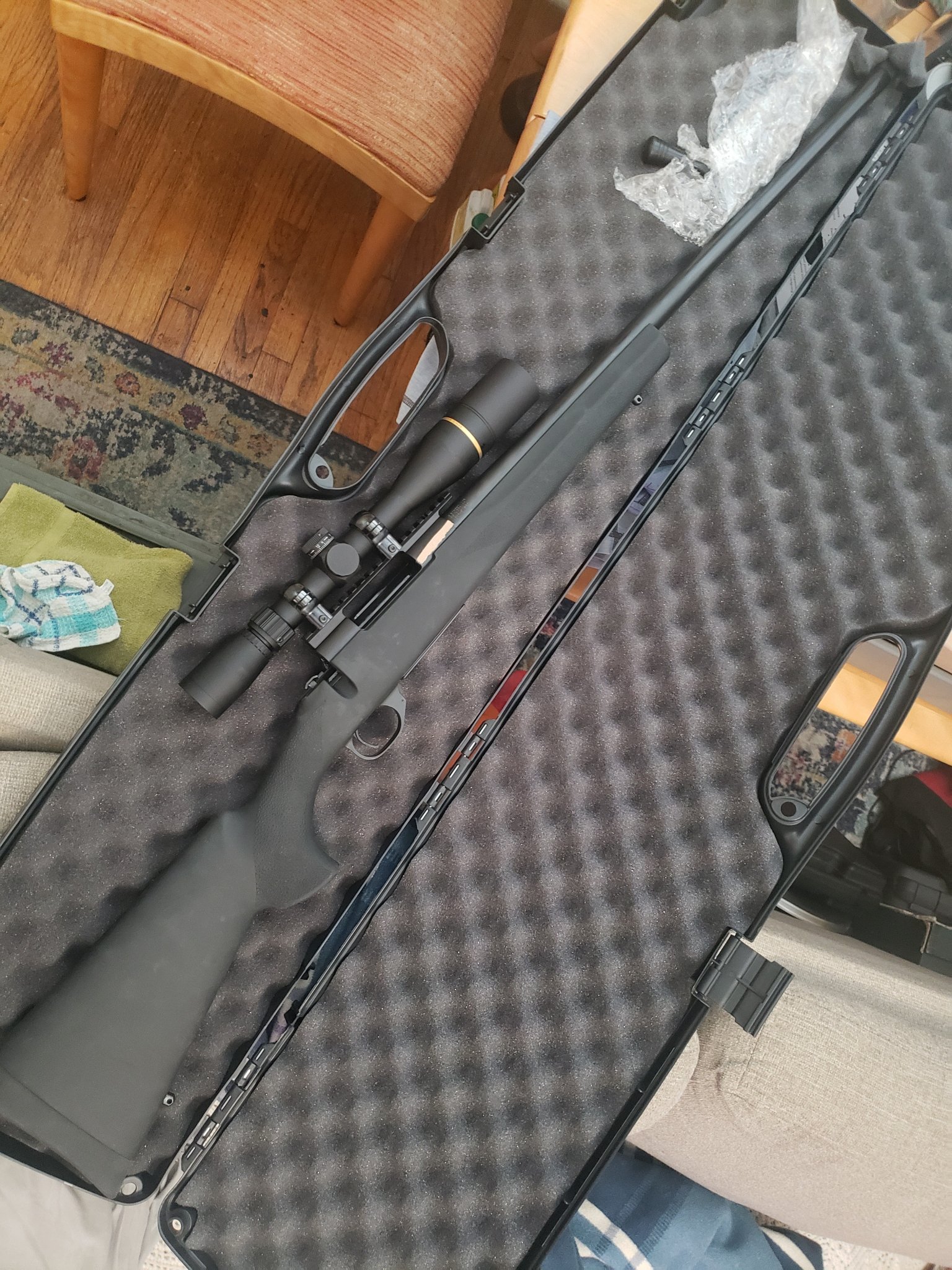

Going to hopefully pick up the Howa American Flag Chassis sometime this week.
Not a fan of the Flag being plastered on things to sell them, but looks like a solid rifle and me and my son can start shooting within a week.
Can always upgrade the scope and bipod later.
The KRG is pretty heavy for a hunting rifle. The B&C composite with alloy bedding block are much lighter. Unless you’re switching from two stage to single stage trigger the HACT triggers when lightened with a spring kit are as good as a Timney IMO. I’ve lightened four, easy to do and can see how on YouTube. I also own Timneys, Jewel, Triggertech, etc. and unless your trying to tune it down really, really light there’s absolutely no advantage and a hunting trigger probably shouldn’t be that light anyway?!

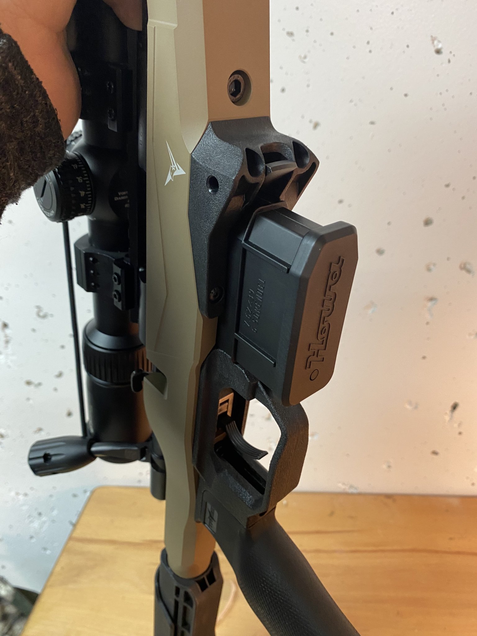

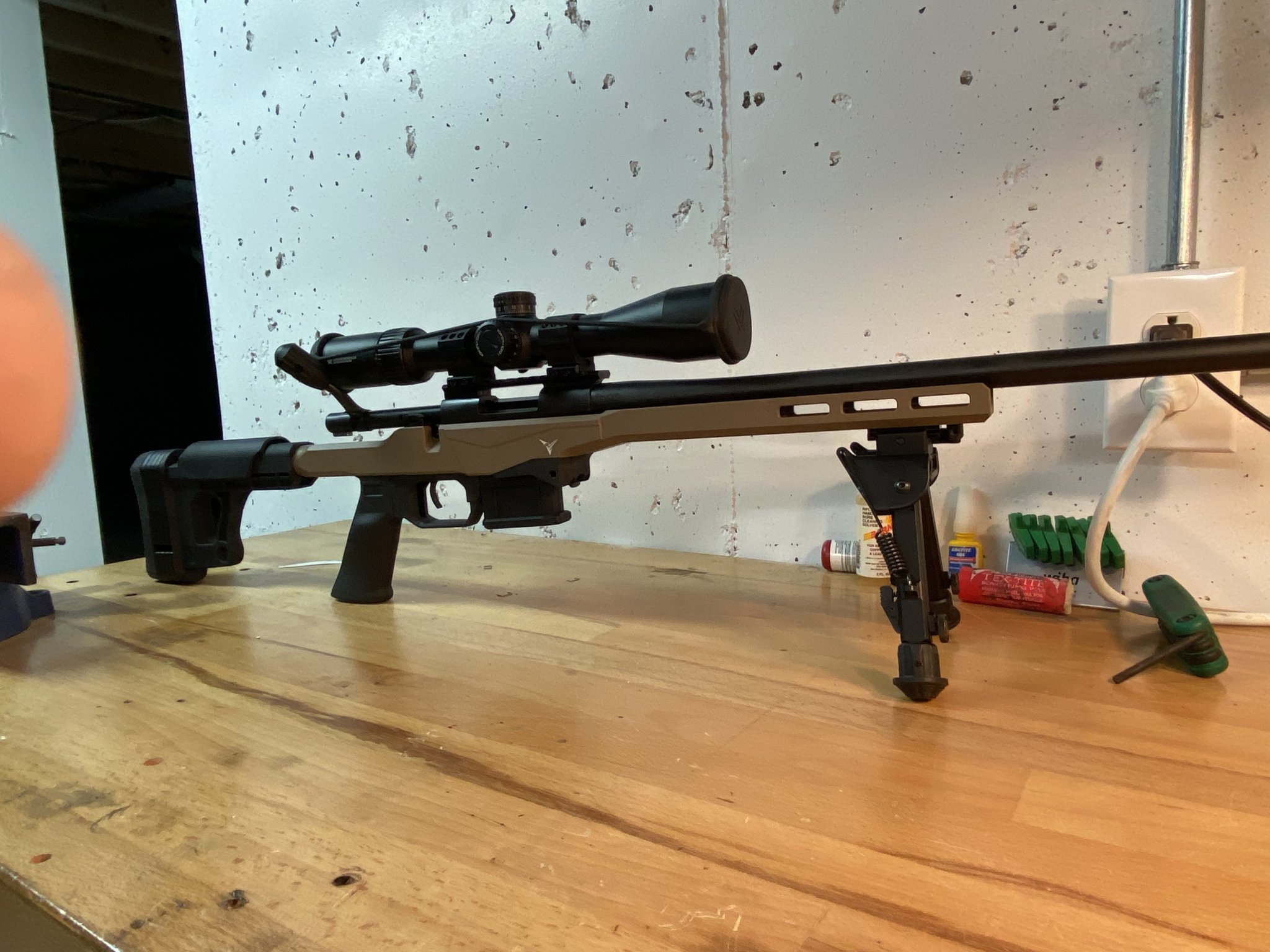

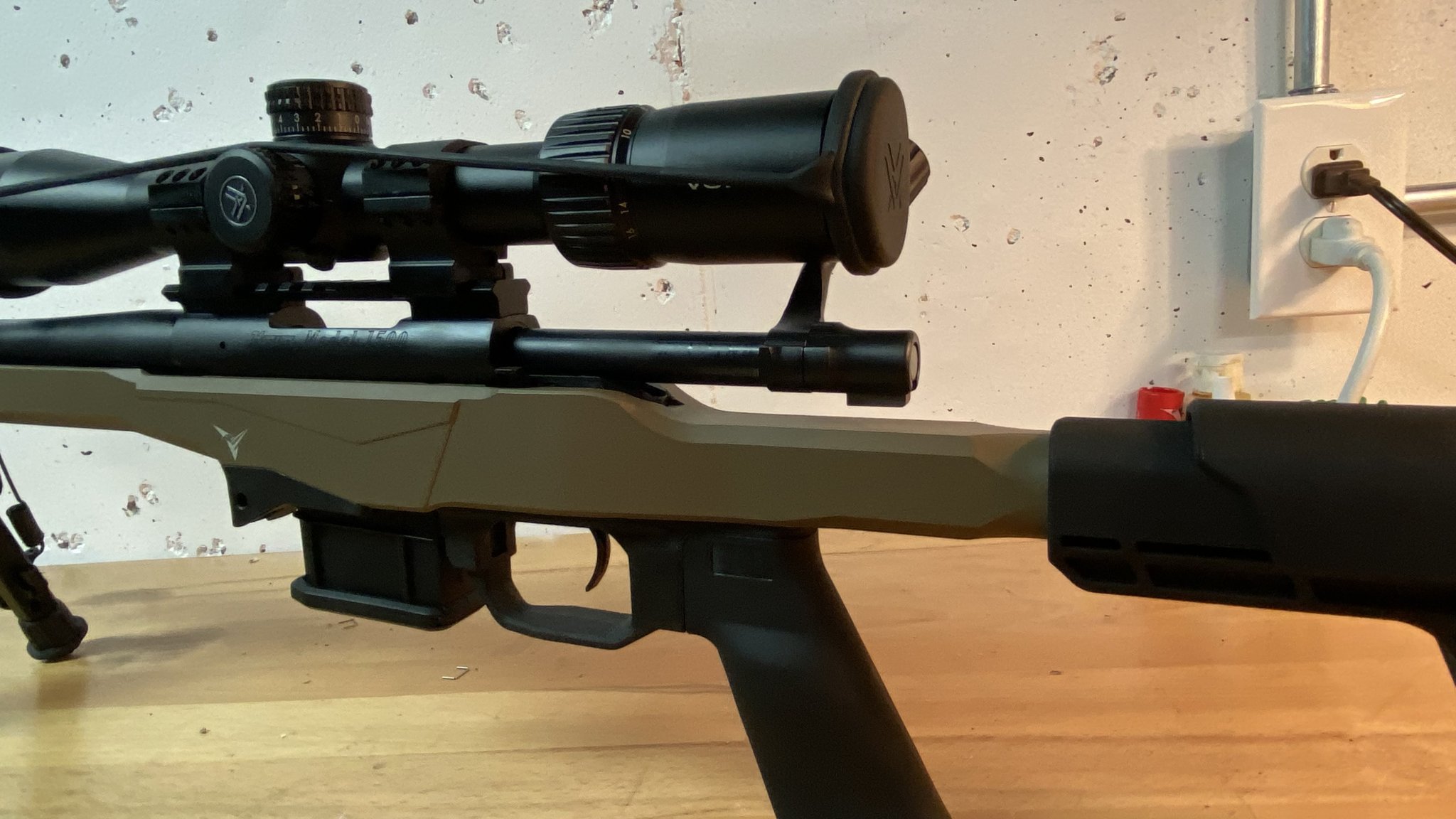

Here is my new Howa bulld. Howa mini action in 6.5 Grendel with a Trybe defense chassis and Vortex scope. Factory barrel is a shooter for sure. Groups are at 100 yards.

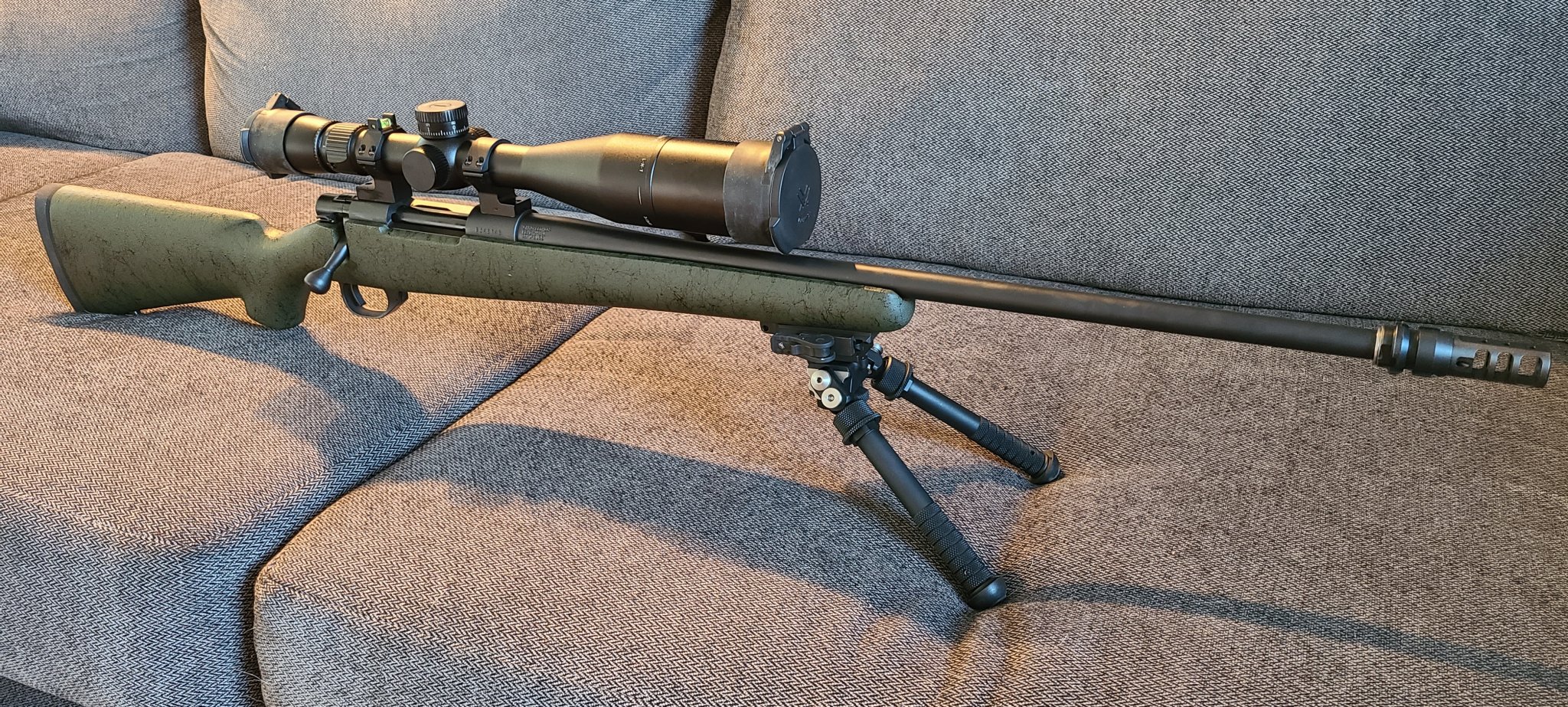

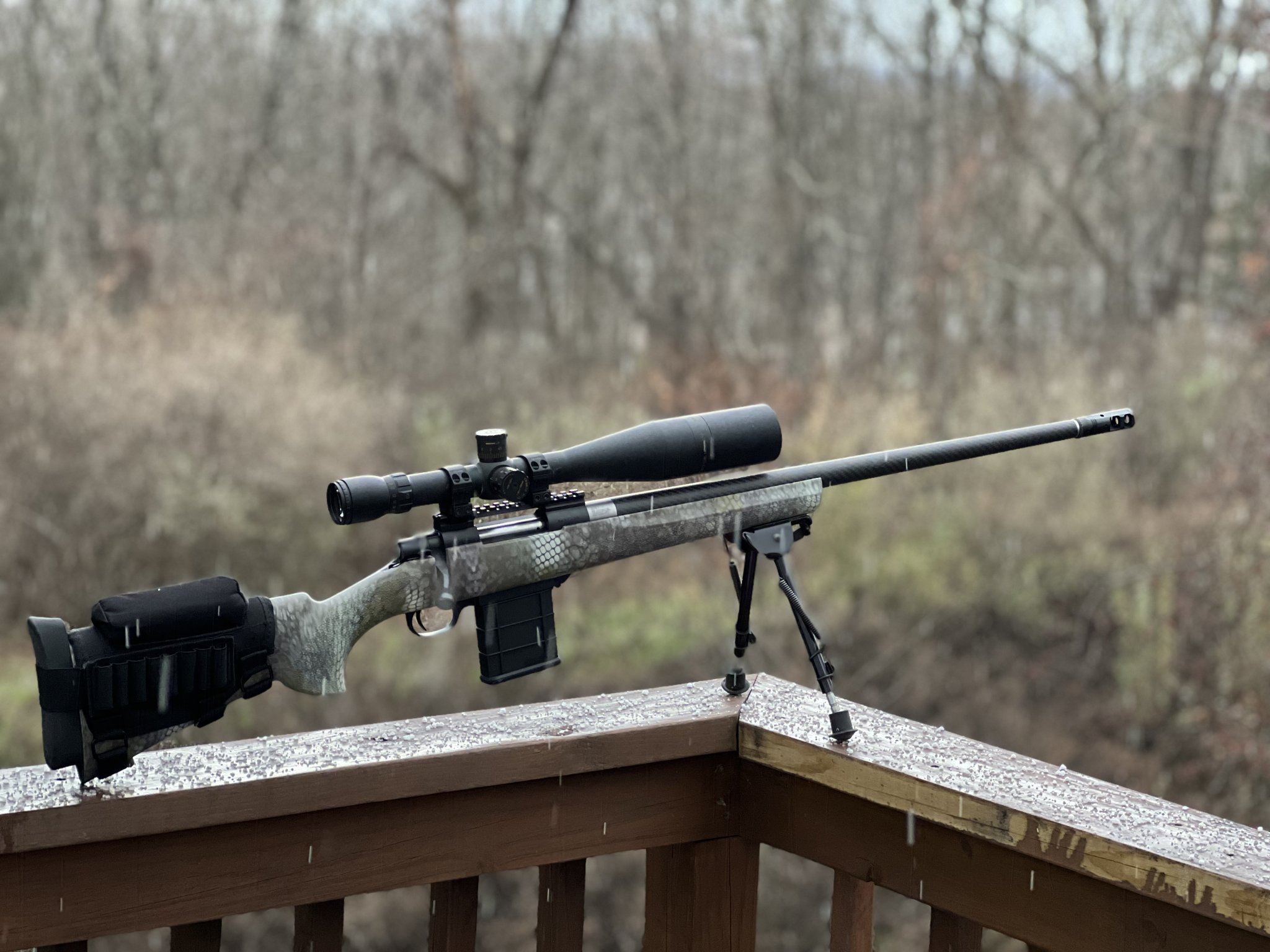

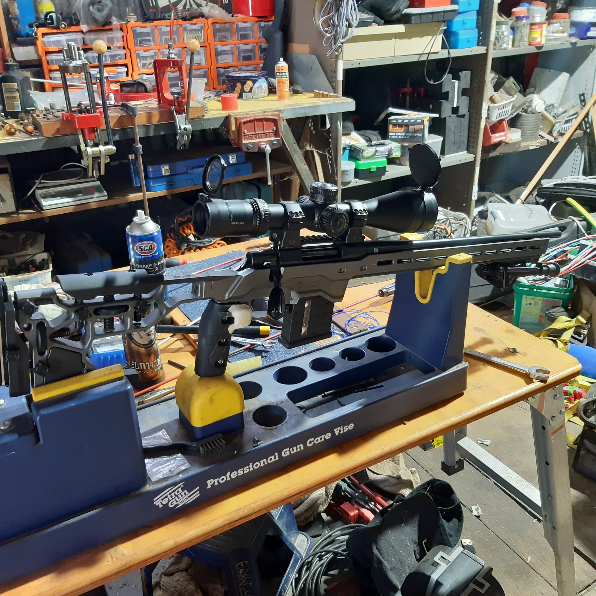

Here's a pic of my rifle as of today. The barrel is the standard Howa unit & won't be there for much longer.
Beginning of Feb she gets a new 308 1.125 Straight Taper 26".

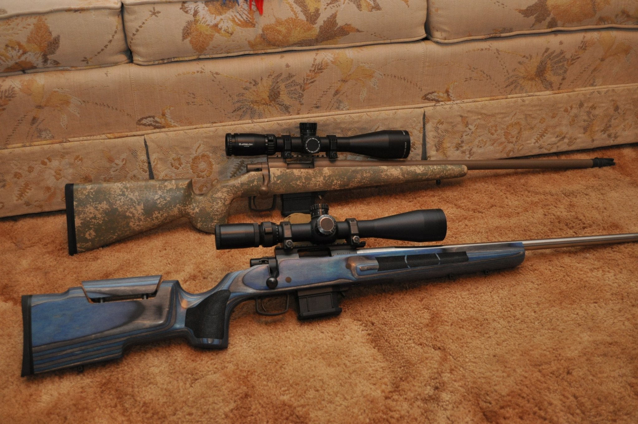

I'm trying to put together a 6.5 grendel on a mini action. The ammo availability right now and bottom metal situation are the biggest downfalls so far.
Both DIP & Jefferson Outdoors make aluminum replacements for the plastic-not-so-fantastic factory DBMs. Jefferson also developed a BDL-style hinged floorplate for the Howa Mini, but after a quick look at their website, it appears that they've had serious enough supply chain issues to shut down production temporarily. Jefferson also has a DBM that uses CZ527 magazines, but again, the supply chain issues have forced them to suspend production for the time being. Since CZ discontinued the 527 action this past year, it's anyone's guess as to how long spare 527 magazines will be available.
I've used DIP & Jefferson DBMs on my Mini customs, and have had good results out of both, even though I'm still limited to using the rather flimsy & grossly overpriced plastic mags. Never had any issue with these mags, just not impressed with how thin-walled they are. I've re-barreled five Mini actions to this point, with Bartlein & Krieger bbl's chambered for 20 Tactical, 223AI, 22 Grendel, 6RAT, and 6.5 Grendel. I've got a reamer for the 22 Grinch, and will be using it to punch out the 22 Grendel bbl as soon as PTG gets the resize reamer to me so I can make myself a die set for it. I originally wanted to use Sako Vixen actions for rifles in these chamberings, but that's more or less a pipedream, with the cost of buying a used Sako rifles as the source of actions. And besides, I'm not crazy about tearing a Sako rifle apart just to get the action. The Mini is a substantial action, plenty strong enough for these chamberings, and the HACT 2-stage trigger can easily be modified to get the trigger break down to well under 2lbs. McMillan made me a Game Scout stock for the 6RAT rifle, which I like very much. Tom Manners had committed to building me an EH1 or EH1A for the Mini several years ago, but demands for his stocks (and likely feeding issues with the Howa mags) convinced him to reconsider. Wade Dunn at Bell & Carlson worked to come up with molds for a M40-style and sporter stocks that I like - had two of the M40 stocks on the 22 & 6.5 Grendel rifles before trying a sporter stock on the 223AI, and I now prefer the sporter stock for it's slim & trim lines. Boyds Stocks also makes laminated stocks for the Mini - I have one of their Pro-varmint models with adjustable cheekpiece on the 20 Tactical - but laminated stocks are a fair bit heavier than either B&C or McMillan stocks, especially with the addition of the adjustable cheekpiece. 1st photo shows the McMillan Game Scout 6RAT & Boyds Pro-varmint 20 Tactical. 2nd photo is the 223AI in the B&C sporter.
