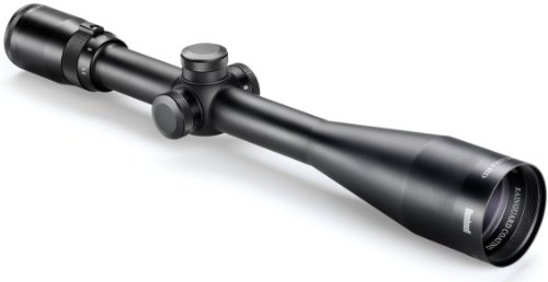

First, please spare me with the "just junk it and buy a good one" as I will be purchasing a Vortex Viper along with an SWFA within the next few months.
Here is my conundrum, tonight, I thought I could unscrew a "nubbin" on my variable magnifaction adjustment. I assumed it was screwed onto the magnifaction ring, but it infact was a screw that the factory used to fill the scope with nitrogen or argon, or whatever it is Bushy puts in this scope. It had an oring on it, and soon as I cracked it loose I heard a quick "phfooosh" of releasing pressure from within the scope.
For reference, here is the scope and the nubbin I'm referring to is on the mag ring. The reason I wanted to remove it was because on rare occassion I have ran my knuckles across it and it shreds the shit out of my skin! Blood everywhere! I should have just filed it down....damn't. SWFA has a quick finger adjust that is removeable, I guess I thought this was removeable the same way. Click the pic and you'll see what I tried to remove.
So, what's the best way to refill this thing with nitrogen? Or am I out of luck.
Thanks!

I don't think you can do anything. There is a special method to gas sealing that I don't think you can create in a "garage environment". Bh-ltr is correct send it in and don't explain anything. Dollars to donuts they send you a similar replacement. About six years ago I sent in a scope that I had dropped to Burris. They said it was clearly my fault the scope was damaged but they also wanted me to remain a customer they ended up giving me 60% off any of their scopes. I bought a much much nicer scope than I normally could. I ended up selling the scope a couple years later and the profits alone from my investment netted me a very nice Nikon monarch 4-16x42 mildot scope. Hope this helps bro I've been in your shoes and it sucks.

If you tell them you simply turned the screw, they will not have to molest your scope farther to examine it.
Tell em. Best policy. They will charge it up.

    One way or another, it needs to go back to the factory.
    Whatever story you tell them (or not) is up to you.

    I use Dust-Off Nitrogen can to re-fill the Bubba scopes I have found over the years. While the scope was not taken down to a couple of Torr's of Vacuum, it does work and stops fogging. For a cheap, quick fix, it's worth the effort.

    Dust off is usually difluoroethane or trifluoroethane. Although, I could see if you turned the can upside down, and put liquid inside the scope, then tighten the screw. When it flashed to a gas, it would take up more volume and create a slight over pressure.
    Do not do it on a fancy scope, send it in and let bushnell take care of it. They are a great company.

    We use it at work for very expensive lens cleaning. It's been around for many years. It is Water-Pumped Nitrogen in a can. I use the straw tube and tilt the can a little, The gas is not a liquid of course,but a few second slow burst will displace most of the room air with nitrogen. It works for me. I'll see if i can get the product code.

    I have an SWFA 16x on the way! This thread was a how do I do this myself, in house, at home without mfgr support. Somewhere along the line the obvious advice of sending it back to mfgr came up which is great advice! Now the advice has become centered around integrity and honesty or lack thereof. This is all fine and well, but like I had originally asked before thread derailment ensues:
    How do I personally go about purging my own scope? Thanks.

    Actually, if the scope was pressurized, and you let it out, especially without taking the screw all the way out, the scope is still filled with nitrogen. It is just no longer pressurized.
    Plange
    This is correct. Just because nitrogen came out doesn't mean any moisture got in- that's the reason we put inert gas into the scope to begin with, we put the scope in a vacuum to remove any air then refill with an inert gas to prevent the moisture in the air causing the scope to fog up. If it was me and you need the scope, just button it back up and you will be fine until you get your new one then send it back to get refilled.
    There is a way to refill at home but you must have access to medical grade nitrogen- usually can be found at most welding supply houses. Unscrew the ocular adjustment all the way out, remove screw and fill with nitrogen at a VERY slow rate. To much pressure will blow grease and contamination on your lenses. Very low pressure for a few minutes (5-8) then put screw back in and tighten down ocular and you have just pressurized your scope with nitrogen.
    In order for this to work well you need to be in a low humidity environment.
    Do I recommend this? Not really but you asked so I answered- it is better than having regular air in the scope.
    If you have any more questions let me know.

    Plange, Pinecone, thanks for the replies.
    I had the gun setting on a table, scope argon "filler hole" screw pointed towards ceiling. I completely removed the screw had it out just a few seconds as I quickly rescrewed it and the attached oring back in instantly because it occurred to me what I had done. Argon, being heavier than outside air, should have stayed in it for the most part eh? This isnt something I'm losing sleep over. Inquiring minds like myself like to know. Thanks!

    You can fill it with nitrogen, but not sure about sealing it.
    I remember seeing an article years ago about Leupold. The way they filled the scopes was to assemble them in a box filled with nitrogen. Nitrogen is a bit heavier than air, so if you fill an open topped box with nitrogen, then submerge the scope and parts, you end up with nitrogen filled.

    If you fill an open top container with nitrogen, it does not immediately leave the box.
    Nitrogen is dry, air has water vapor, and water vapor is a LOT less dense that nitrogen.

    Basic physics:
    o Nitrogen is slightly less dense than air, therefore it is lighter and does not "sink".
    o In order to hear a "phfooosh" (term op used), it is pressurized > 1 ATM, therefore you will not "DIY", unless you have a chamber. Furthermore, the optic is probably evacuated in a chamber with a vacuum pump, but this is only a SWAG.
    Send the thing back to Bushnell and let the pros do it.
