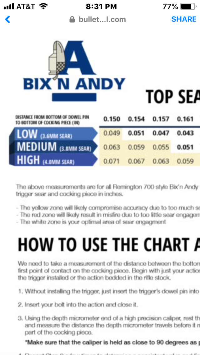

What did they end up saying about the B&A trigger sear? 3.6mm? I’m about to go this direction too but haven’t reached out yet.
O hanger and the standard sear is what he said. He said he contacted a few people and that is what they are using. He also told me to call otm and that they set up more impacts with that trigger than anyone else he knew of. I called them and they told me the same thing,0 hanger and 3.8 mm dear. On the bix n Andy site they have a video on measuring for top sear. When mine gets back from Lri I will measure for top sear. I was mostly concerned about what trigger hanger they recommended.

Yeah I’ve seen the video. I measured mine and according to their chart it says mine will need a 3.6mm which is their low sear. Mine measures about 0.158”. I guess the standard/medium would work but seems like the low would be more appropriate. Let me know what yours measures when you get it back. I’d assume they’re pretty close just because Impacts are held to such tight specs.
Yeah I’ve seen the video. I measured mine and according to their chart it says mine will need a 3.6mm which is their low sear. Mine measures about 0.158”. I guess the standard/medium would work but seems like the low would be more appropriate. Let me know what yours measures when you get it back. I’d assume they’re pretty close just because Impacts are held to such tight specs. View attachment 7080317

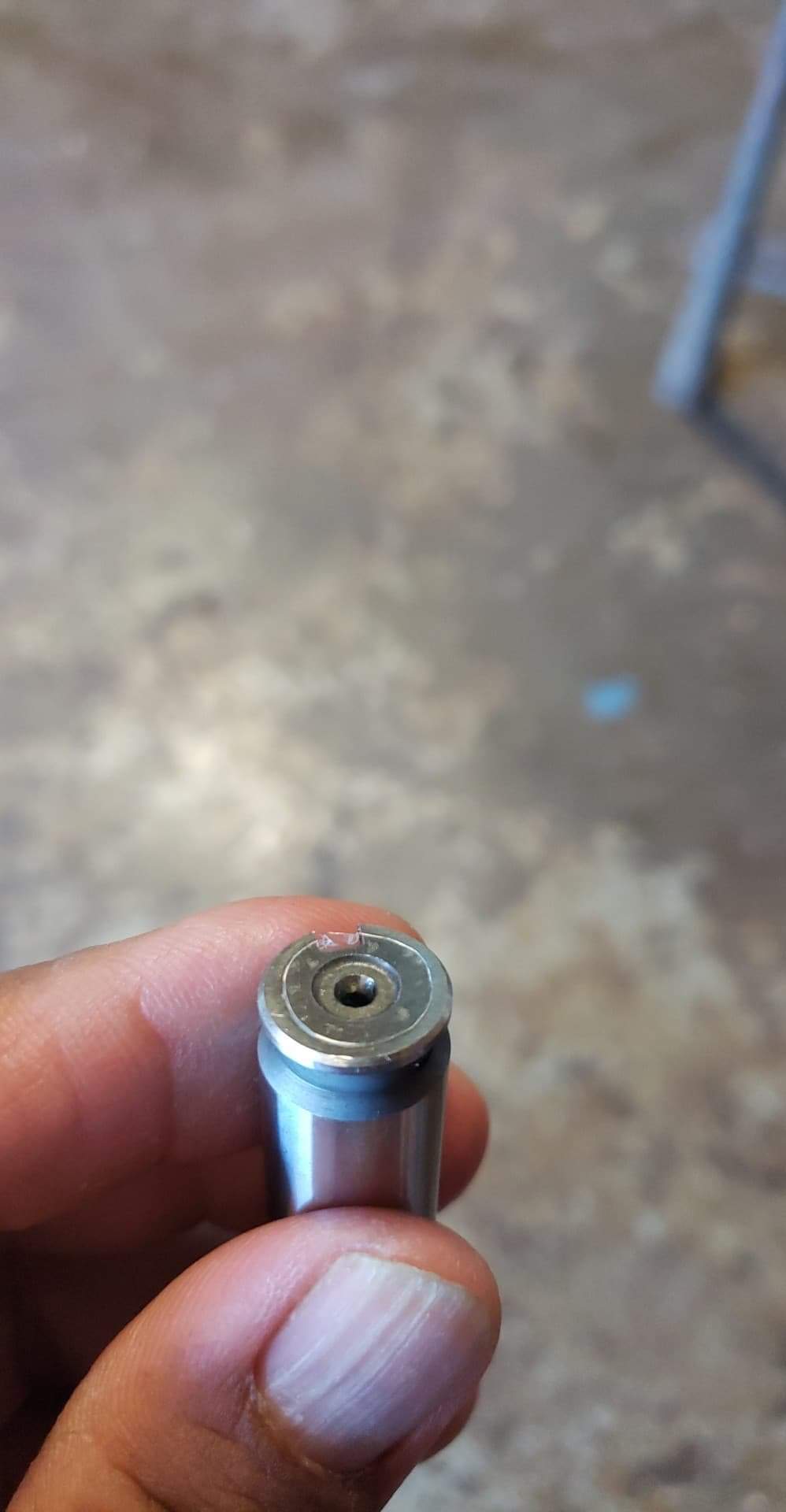

So finally got the gauges in torqued the barrel to 85ft/lbs closes on a go. But also closes on a no go. Should i increase the torque to 100ft/lbs?
Add a piece of scotch tape to the No-Go and see if it closes on that. If it does, you should send the barrel back with your action to have it properly headspaced.
Gotcha will try. I torqued to 100ft/lbs and it still closed.

Gotcha gonna sound stupid here, but should i be wrapping the entire no go? Or just the near the case web? Maybe i'm doing this wrong.
One strip at the back of the case. Like just the very bottom of the no go gauge where the primer would be. Do not wrap around the case.

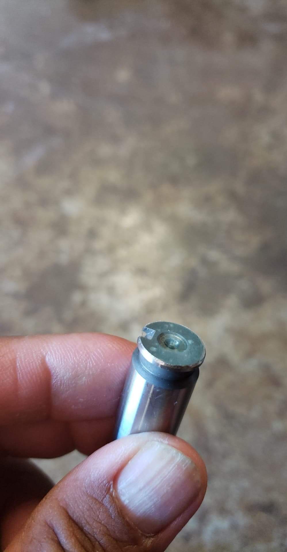

Update
Starts the cam over with a piece of scotch tape but wont close. So am i GTG i guess?

Update
It’s prob safe but the head spacing is more than I would like. I like to see it close on one piece of tape on a go gauge but not on two. It will definitely not close at all or even cam over on a no-go by itself.
This is one piece of tape starts the cam over but wont close on a no go. It closes completely on a no go without tape.

Man I think it’s up to you on what you want to do. It’s probably fine but the head spacing is pretty darn generous. If/when you get a new barrel you may have to resize that brass way back down to get it to chamber if the head spacing is tighter. Not a big deal just something to keep in mind.
