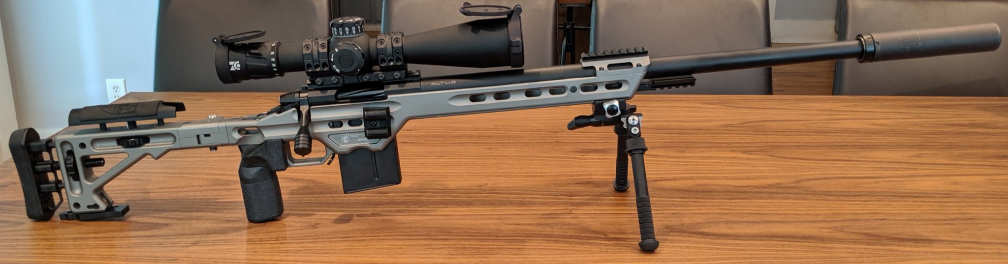

I have mine put together, got the ZCO 5-27 in yesterday. It's shooting quite well, I'm averaging .39" CTC 5-shot groups (shot 4 of them today after sighting in) with 147gr factory Hornady ELD-M, and this is only my second box of ammunition. I'm sure I'll get more accuracy out of it with reloads and once I get more familiar with the feel of the rifle.
MPA Competition (folder)
Impact 737r
TriggerTech Diamond
MullerWorks barrel chambered by Altus (M24/40 24" in 6.5mm Creedmoor)
ZCO 5-27 in Spuhr 6601 (~40MOA total with the Impact's 20MOA rail + 6mil from the Spuhr)
AADMOUNT scope caps
Atlas CAL v2
SiCo Saker762 w/ Area419 adapter + Hellfire mount (TBAC Ultra 7 in jail)
Accurate binder-less magazines
19.6lbs without magazine - definitely not a hunting rifle!
Impact 737r
TriggerTech Diamond
AADMOUNT scope caps
Atlas CAL v2
Have you measured a group without the Saker attached? Just curious.
No. I can if you'd like, but I'm not sure it'd make any difference. I've never had factory ammunition shoot much better than that in any rifle I've owned. The smallest 5-shot group was 0.3275" CTC, and keep in mind, this rifle has 53 rounds downrange, and I shot the groups with only a magazine swap in-between each set of two, effectively a ten shot group, just on two different POA so I could measure them independently as I was sighting in at the same time. It also wasn't slow-fire, this was 5 rounds with at most 5 seconds inbetween, enough time for the scope to settle and me to take a breath and hold halfway.
I'll be out at my 1760yd range later and shoot some groups on steel at distances that matter, 100yds isn't really my area of interest.
I'll slap on the Hellfire brake next time I'm at the range and give it a go, but I suspect it'll just be a POI shift. What are your thoughts? I'm curious what you're thinking.
