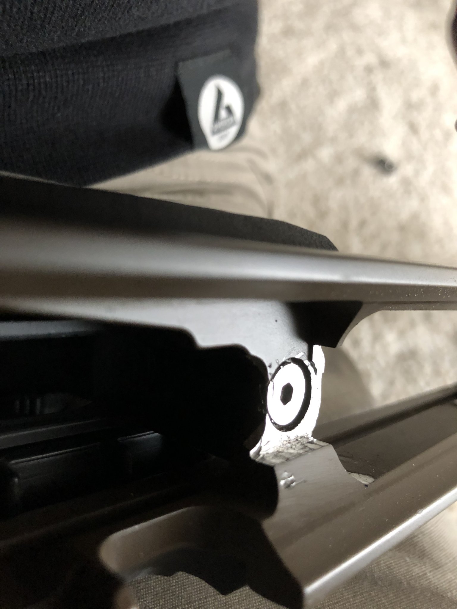

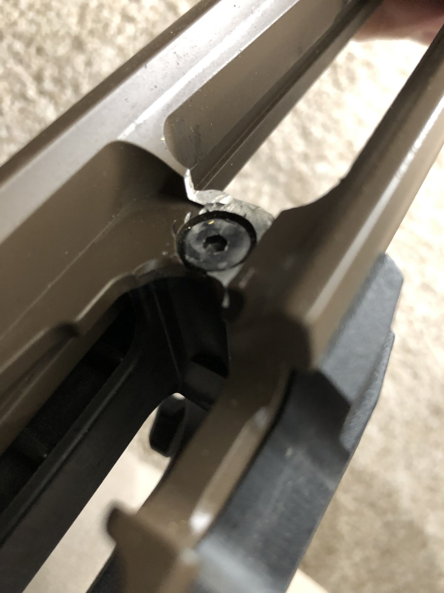

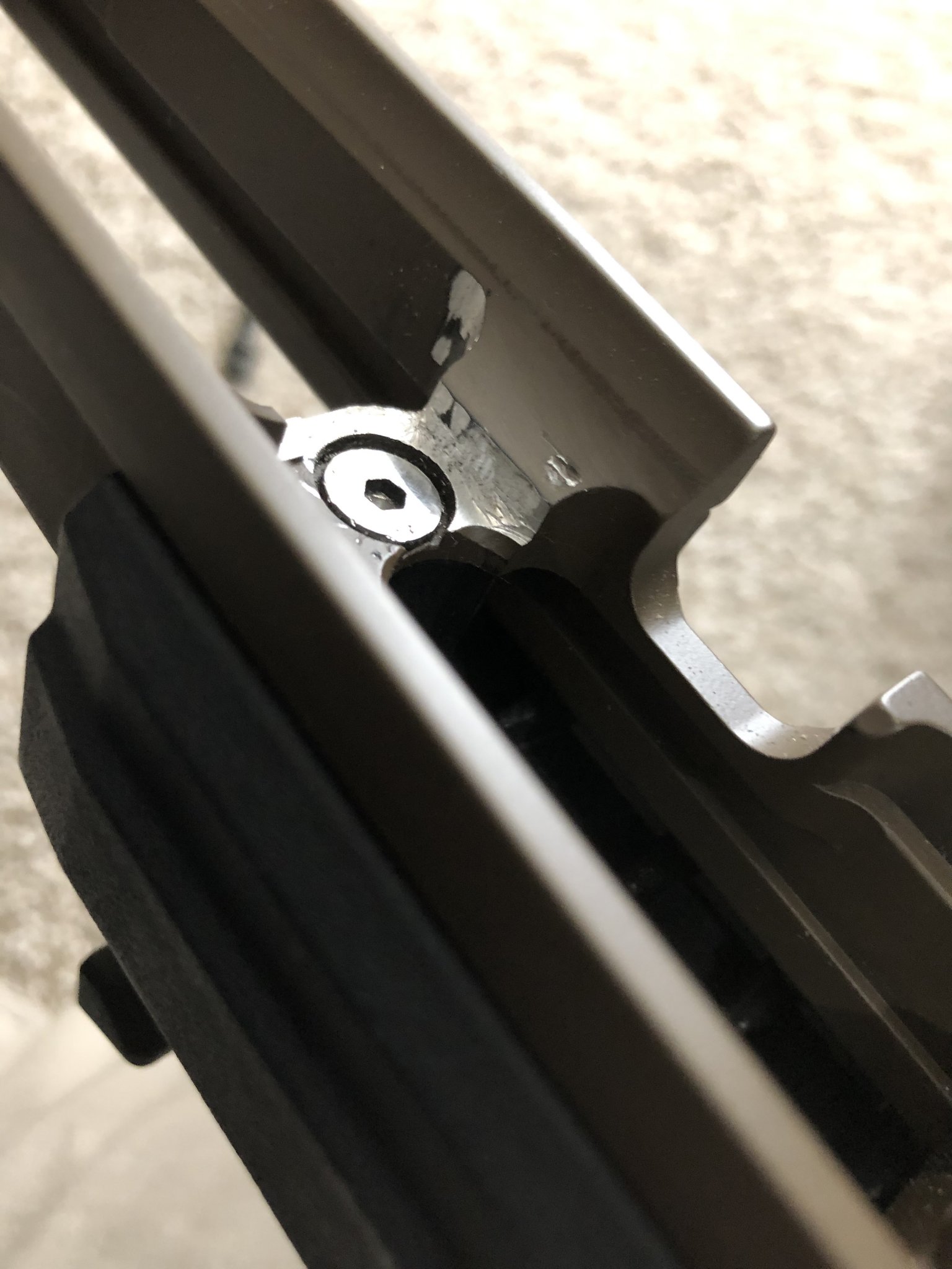

@Renomd I’d love to see a pic if you get a chance.
See attached images, I bought lo profile bolts too and they only sold them in packs of 25 so if any one seriously is going to mill their backbone and wants one then let me know. I tried to show from the side just how much material I needed to remove and how deep. I don’t have proper tools.... I used a wood router and a wood cutting bit from harbor freight (yes I know it’s not proper or the safest but I don’t have accessss to machines and I don’t want to spend $1k on tools) and it tore this aluminum backbone a new asshole as u can see.

That looks pretty good considering the tools you were using. Thanks for the pics. They do a good job of showing depth.

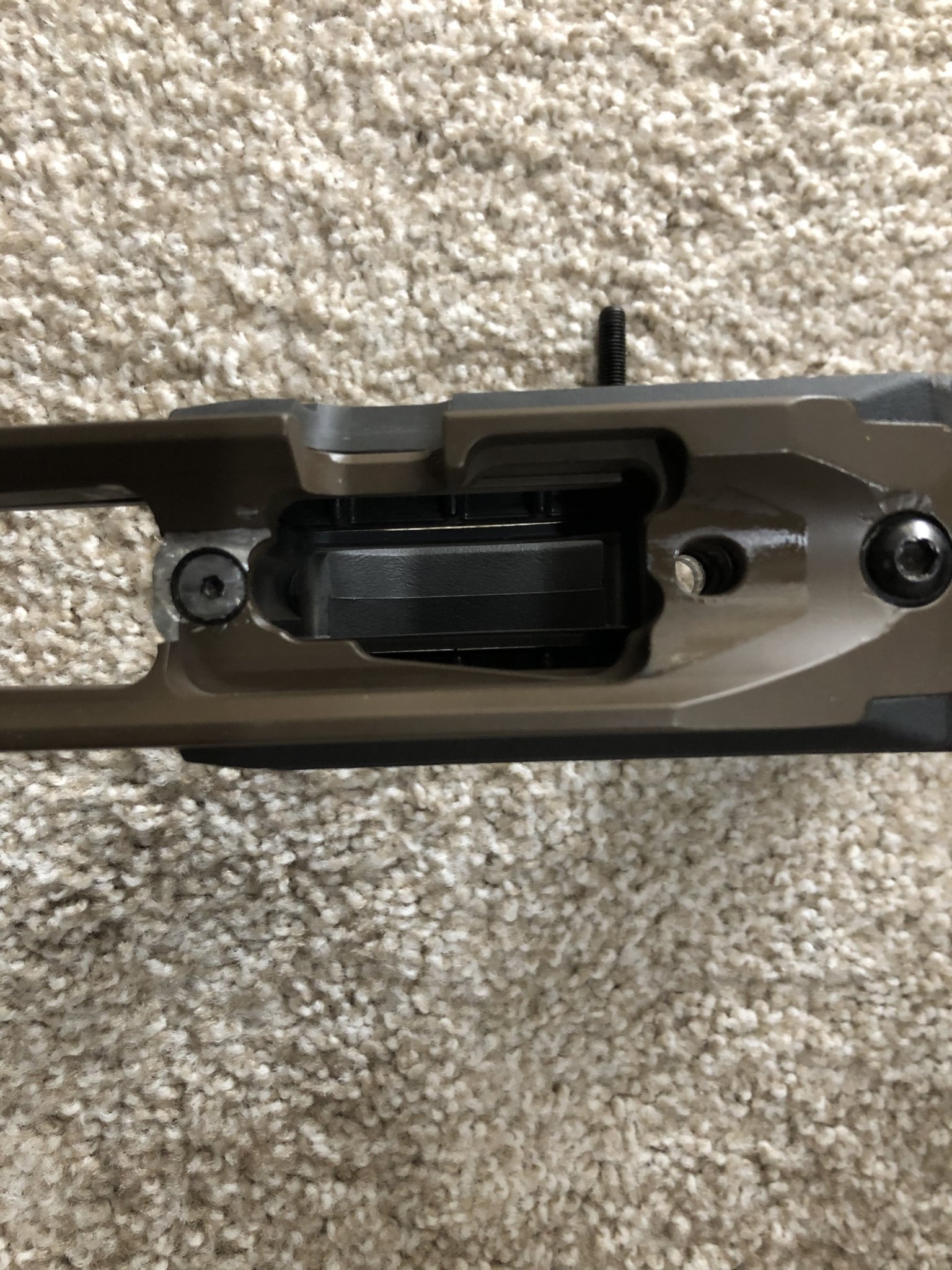

I'm looking at picking up an Impact and wanted to put it in a Whiskey 3 also, so thank you for the pictures. If you have a chance would you also post up a pick of the trigger hanger screw setup? I have yet to see it up close.
