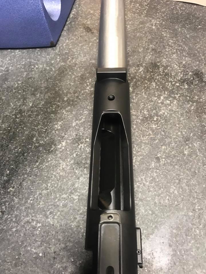

Just DROS ed my action. Fondling it at the FFL was fun. Very clean action and slippery bolt. Very happy I went with them. Now to get a barrel ordered. Already spoke with TScustoms about a Benchmark. Waiting on him to return from his hunting trip.

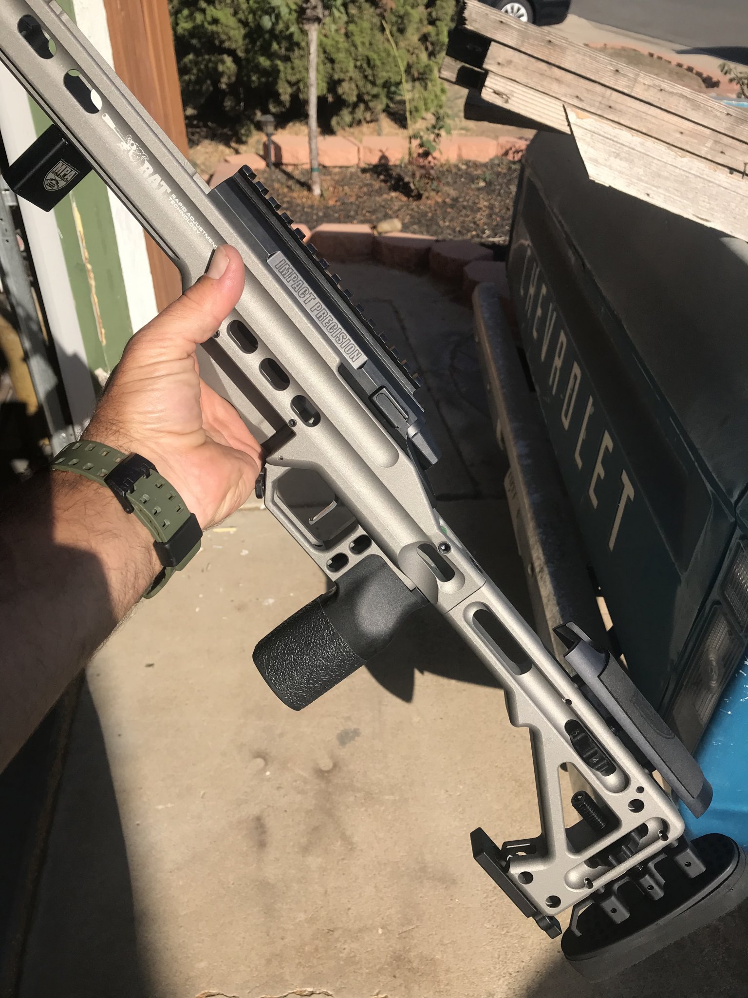

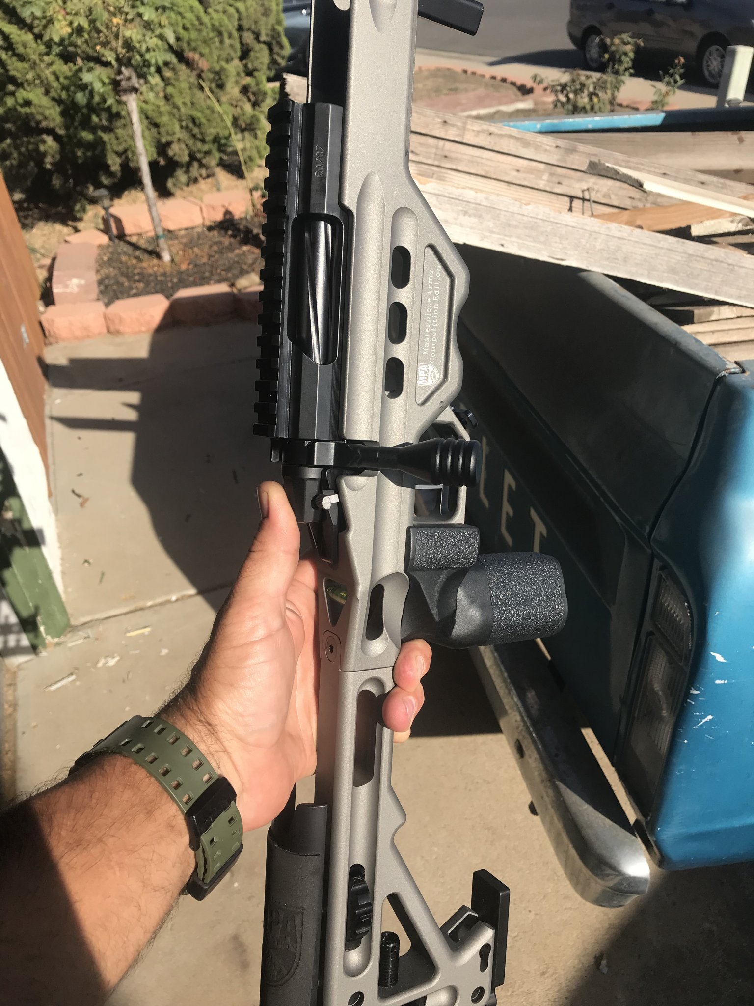

Picked my action up today. Now waiting on a barrel. TT special trigger. MPA comp chassis and have a Area 419 hellfire.
