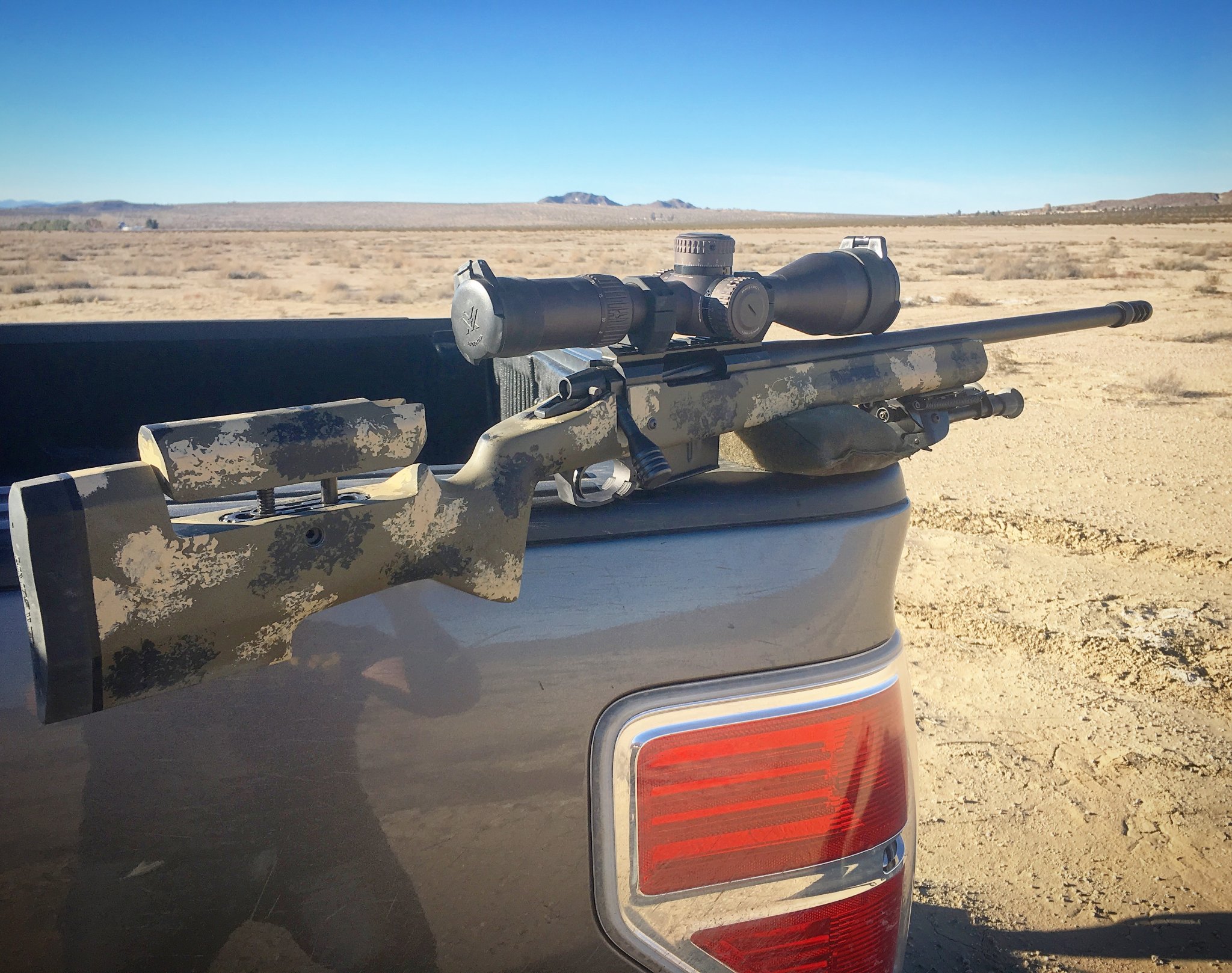

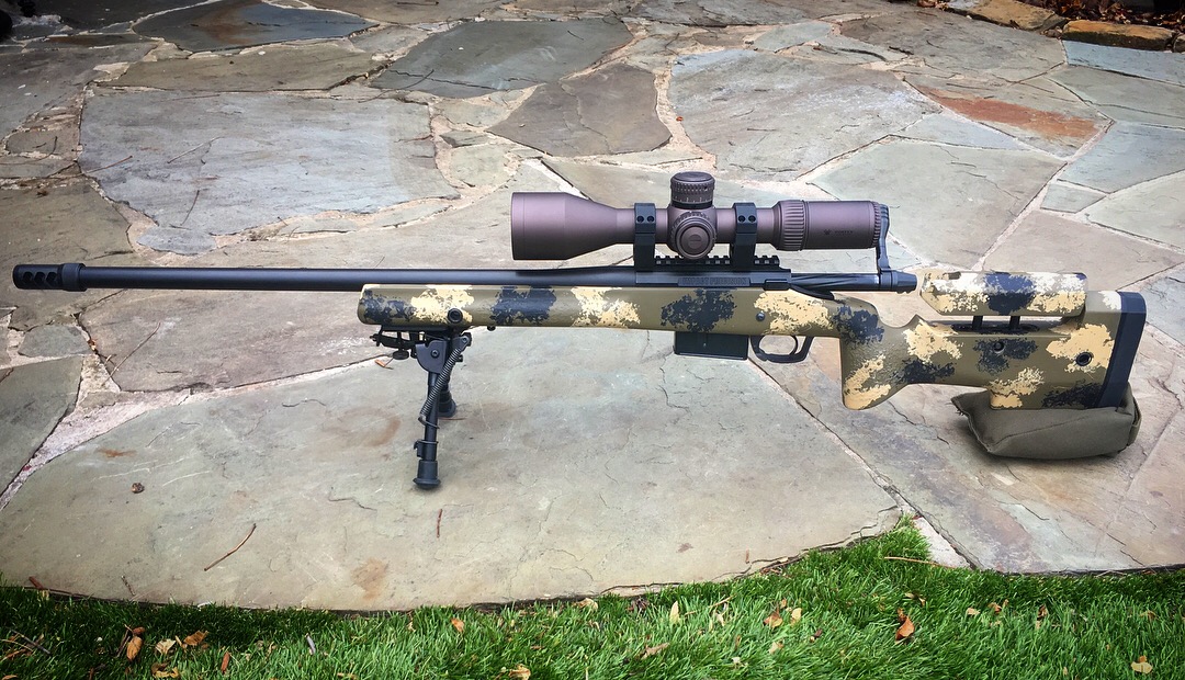

After reading a few pages of this thread, and some advice from my local club guys, I decided to build my own rifle on an Impact737R custom. I decided to do this over buying a trued 700, or any of the other fine actions making their rounds on the NRL scene. I will say, I'm happy I decided to go this route. The gun is finally done, after waiting on a muzzle device it's finally assembled and ready for the range.
I'm relatively new to long range, so I went with 6.5 Creed, a reportedly easy caliber to get started with. It also encompassed sharable projectiles with my current shooting love, my Grendel. Also, it is reviewed as forgiving and easy to gather components for to develop good loads for. I've got an ample supply of PRIME on hand now, and H4350 and Norma 130GTs. I should be at a good starting line.
I bit hard, and decided to go whole hog instead of piece-meal and the investment shows it. It's probably not anything some of you would consider top of the line, but it's mine, and I know there's no other like it. This tbh, was the biggest draw for going full custom rather than the route of a factory rifle in a chassis, which I thought hard about. The Tikka and Bergara were both options I looked hard at.
I love the action. I can't review it from the standpoint of the veteran competitor, and I have nothing to compare it to other than the Surgeon and the Defiant actions I've had the privilege to be allowed to shoot, and the old Rem 700 30-06 experience gained with my dad; Also, his Interarms .270 (Mouser based action/Weatherby barrel?) as well. The Impact isn't really a fair comparison to the Interarms or the Rem700, but I've gotta say, these things are smooth. Mine feeds like butter, and I've only put 40 rounds of Prime down range so far.
It definitely feeds smoother than the Surgeon did, and feels smoother than I recall the Defiance - which IMHO is saying a ton; I was in the market for a Defiance - if they hadn't been OOS everywhere and on back order, I probably would never have kept looking at the time and gone with Impact. I'm glad my impatience caused it to work out this way. This is shamelessly preaching to the choir, I know - but I think I'm better off.
I couldn't tell you how it's better, that's not my intention here. I'm just posting to say thanks to all of you who have reviewed these actions, who have commented how much you are impressed by them, who have given the nudge to try it. Thanks!

As I aquired parts, the final list became:
Impact 737R
Bartlein Heavy Palma 6.5 1 in 8 chambered in Creedmoor, cut to 24" and threaded 5/8x24 - Bartlein offered a special to our club which I jumped on
LaRue Tranquillo brake for Bolt action (No rear shoulder) - allowing my Tranquillo 7.62's use
Grayboe Ridgeback stock
Mesa Precision DBM and Accurate mags (Area 419 4 round extenders in hand if I ever need/want them)
Atlas BT-10NC and LaRue LT271 mount
Leupold Mark5 HD 5-25 H59 and Mark 4 rings
Gamechanger bag - this thing just works.
Prime 6.5 AMMO

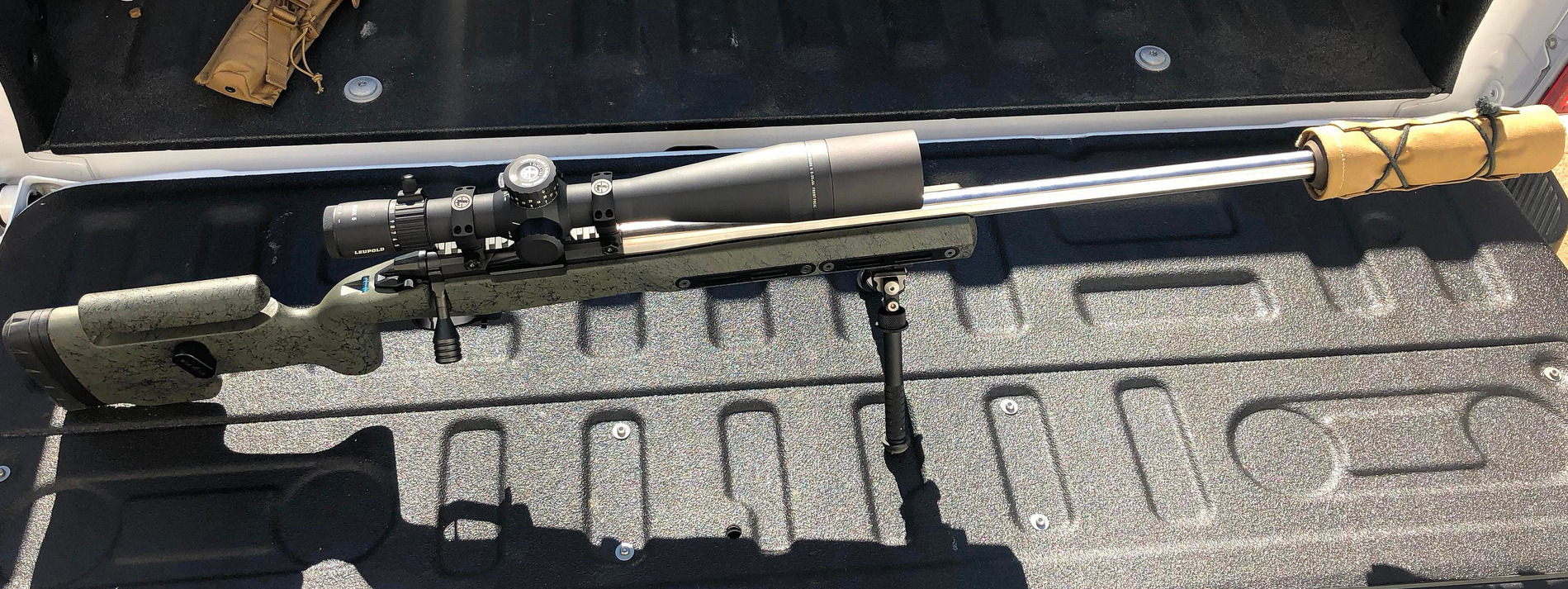

Wade stuteville put this one together for me. An absolute work of art.
New precision boi
-impact precision action
-24" bartlein sendero contour 6.5 creedmoor
-Manners T4A in molded GAP camo with mini-chassis
-TriggerTech Diamond pro-curve trigger
-Area 419 hellfire muzzlebrake
-Seekins 34mm rings
-Vortex Razor Gen II 4.5-27
New precision boi
-Seekins 34mm rings
That dude is slick! Thanks for sharing!

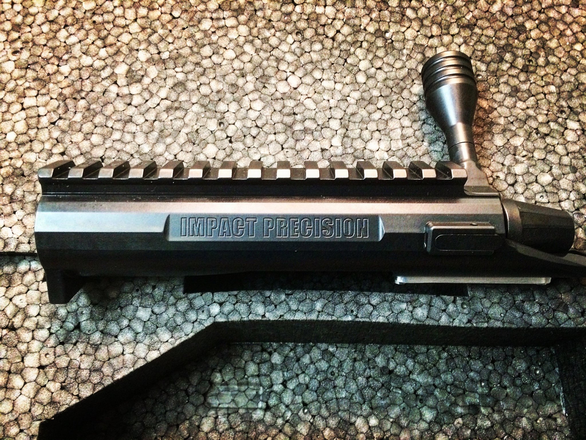

I don’t think it’s normal but it can happen to any action just a matter of cleaning it and making sure it’s well lubed. I can post a pic of mine when i get back it hasn’t been fired still new just cycled a bit.
Some actions are certainly more prone to it then others, some are even designed to prevent any galling issues.
Regardless, this is a good reminder to always make sure an action is lubed as you state. I hope Impact takes care of you, as I'm sure they will.
Reactions: 5RWill
Gentlemen, after posting the pictures I received and email reply from impact and they told me that all is well and it's perfectly normal. Seeing as this is my first custom action, I was erring on the side of caution and asking if this was normal. No harm intended, the action is smooth as butter and I'll be purchasing another very soon!
I got home and looked at mine, around 450 rounds and 1000+ dry fire cycles, both lugs on mine have matching marks. Not concerned with mine at all as I never noticed it until now.
