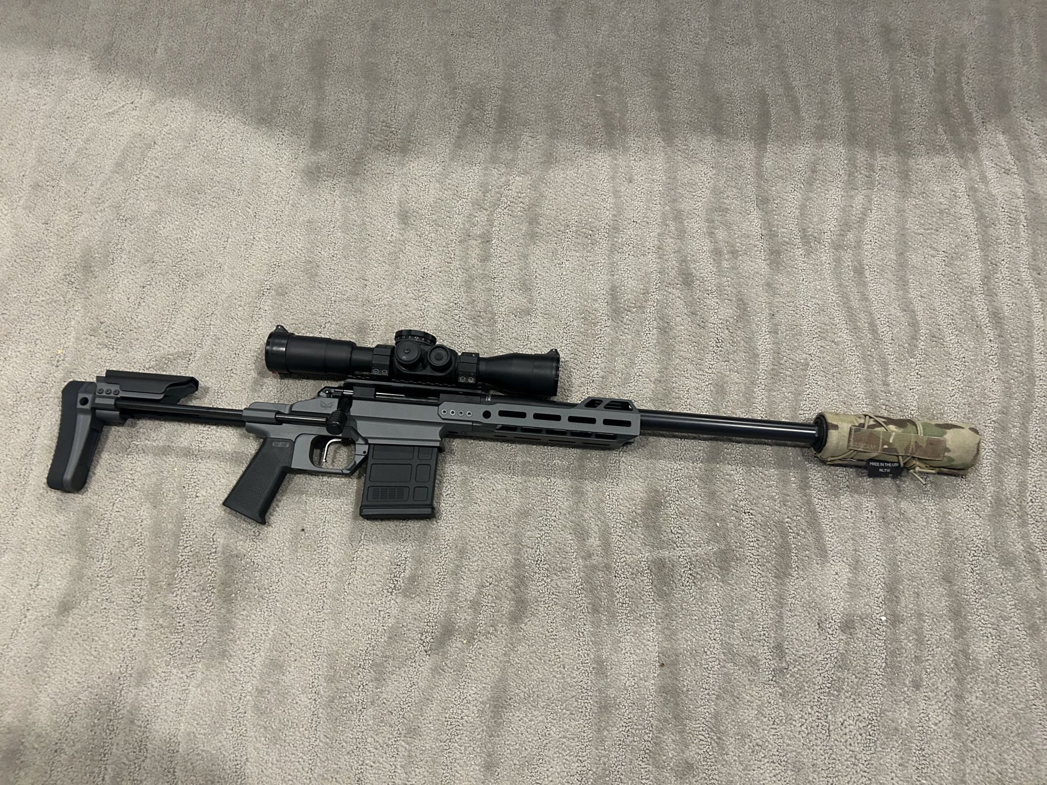

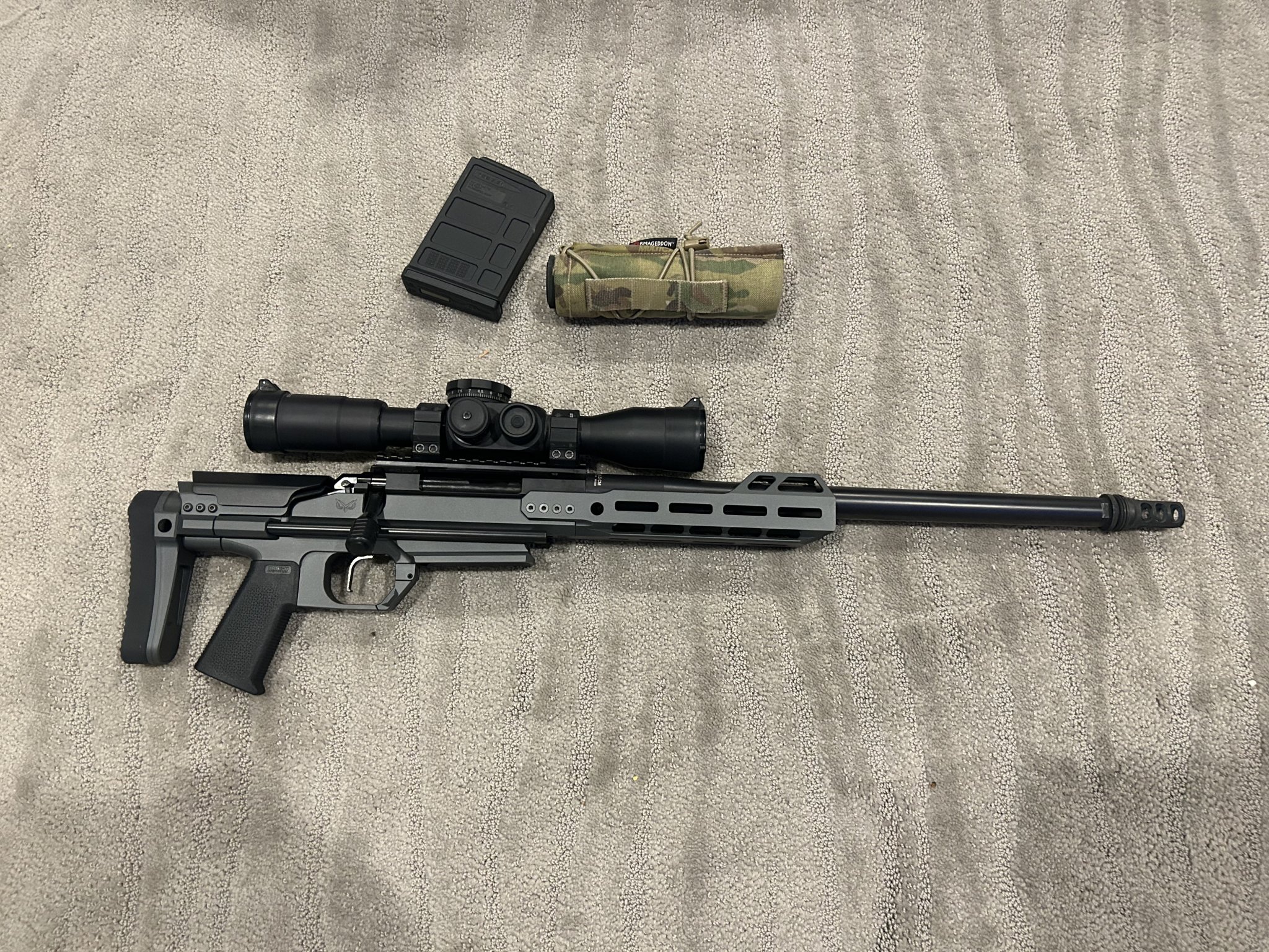

I bought a Solus barreled action and took it to my smith to cut down to 16” so I can put it in a screech owl chassis and have a little truck gun that’s not $5k.
It’s a discount rifle action with some cool features for the price. All else equal, I’d buy a Curtis or Bighorn action (or other expensive actions) over the Solus every time, but for half the price, it definitely has a place.
