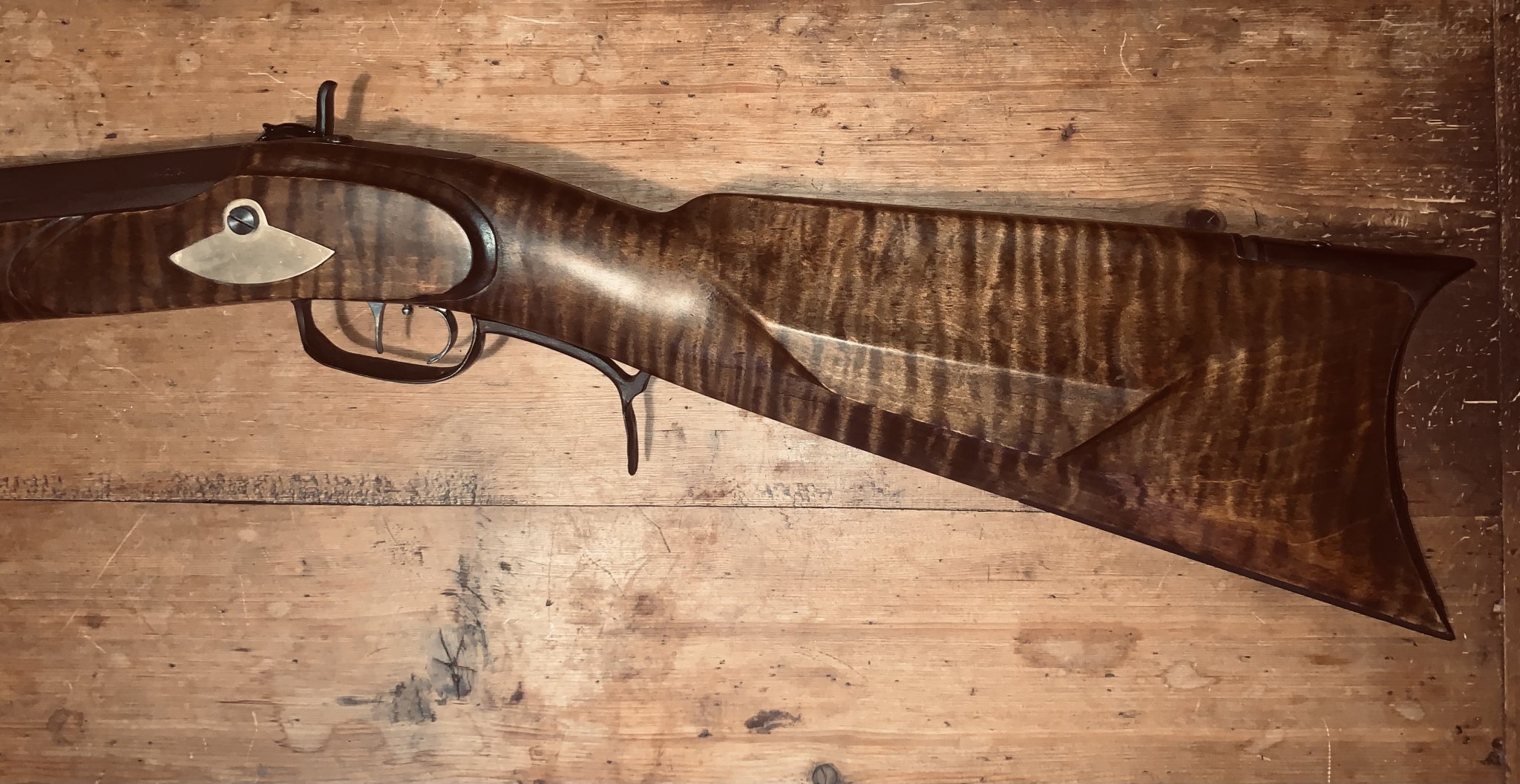

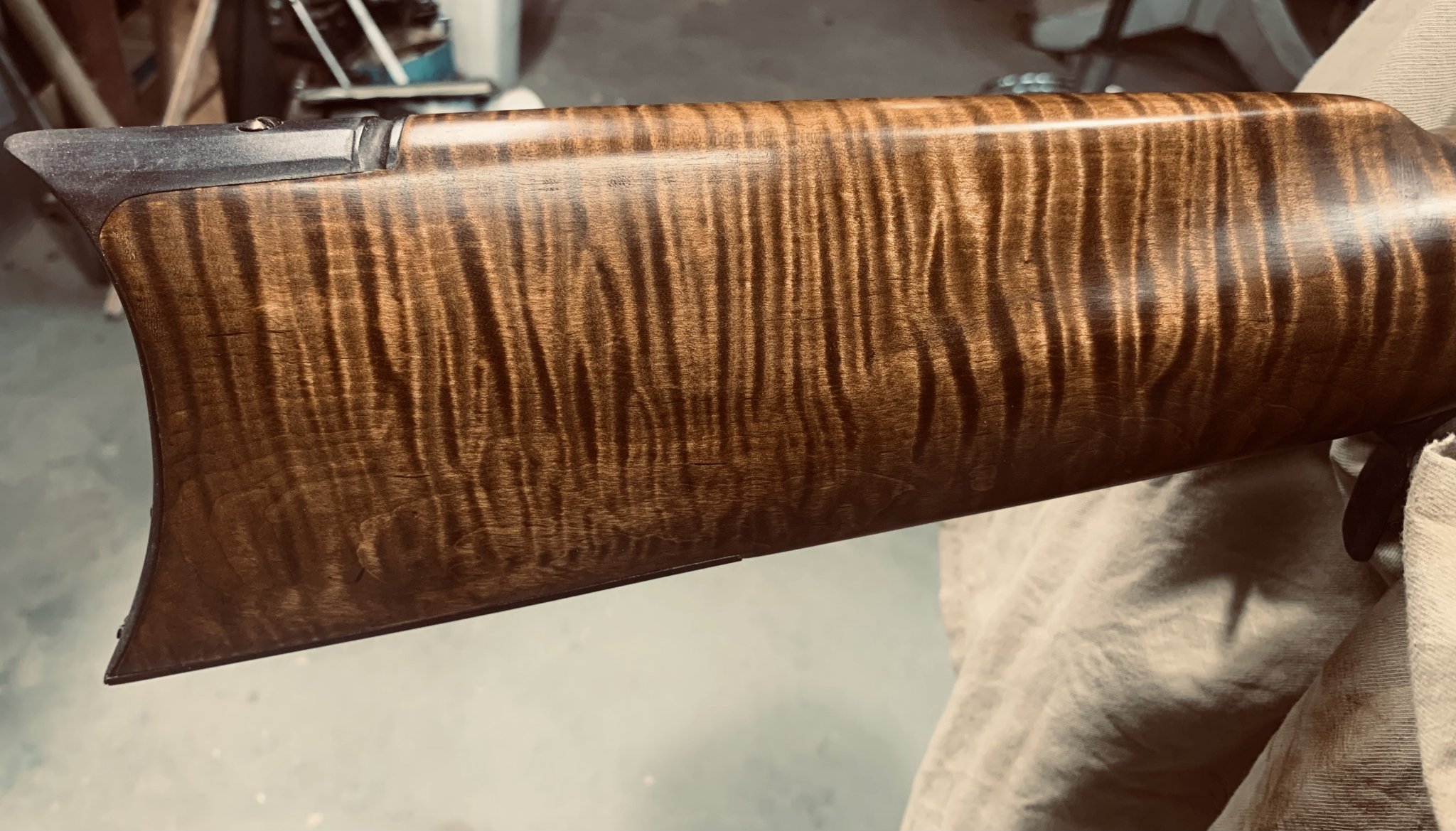

So I don't even know where to begin on this rifle... first, been driving since 4am... and in the worst place in the world.. Boston, Cape Cod, I95, Worcester... god I hate traffic and people right about now. But home safe.
More thoughts on rifle tomorrow, but it is beyond spectacular. I am not sure if I can do a video of the wood, but it is so deep and multi-dimensional... it's on fire when you see it. And, yes, it was done with Aqua Velva or whatever that stuff is. I didn't have a lot of time with Ed today, but he showed me how its done. So cool!

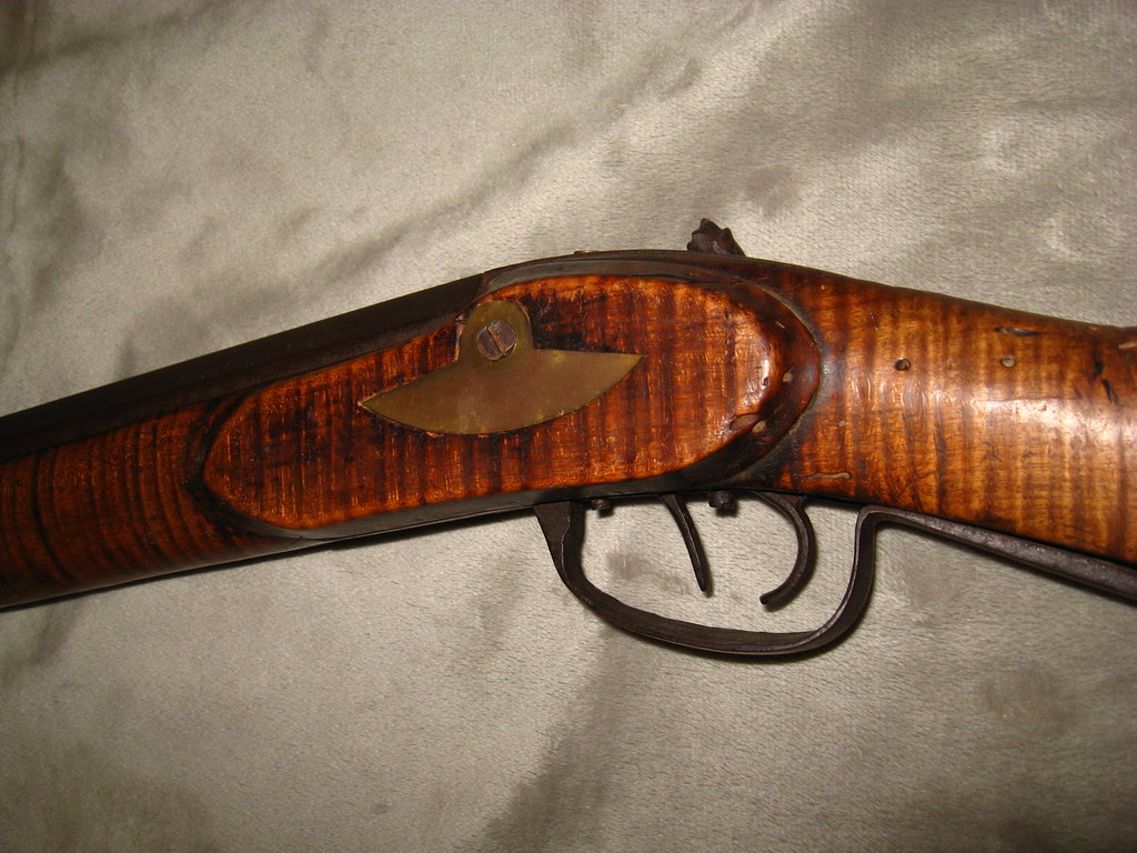

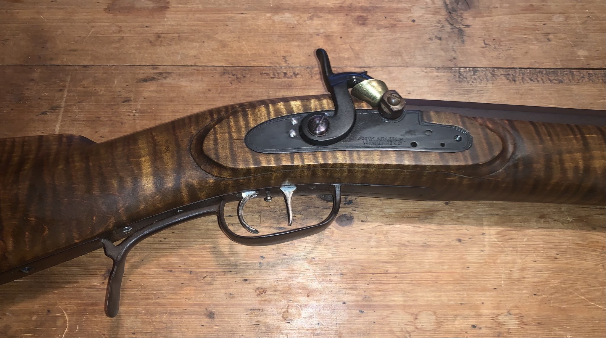

Very faithful replica... cheekpiece is just right. Lock with extra holes from converted flintlock.
While it all looks very plain in rust brown and cast iron fittings, little details just pop out everywhere... Lines that you see for the first time. The long toe plate that is actually screwed to the buttplate for strength. And that maple...

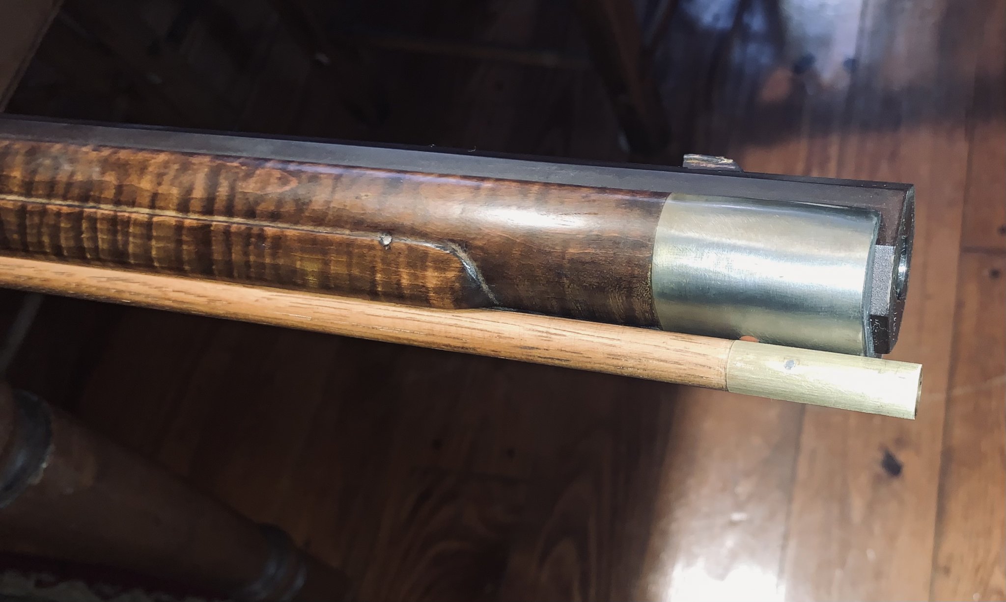

The nosecap is missing from the original and family lore said it was German Silver. Ed thinks it may have been pewter. Or iron. But we did this one in German silver.

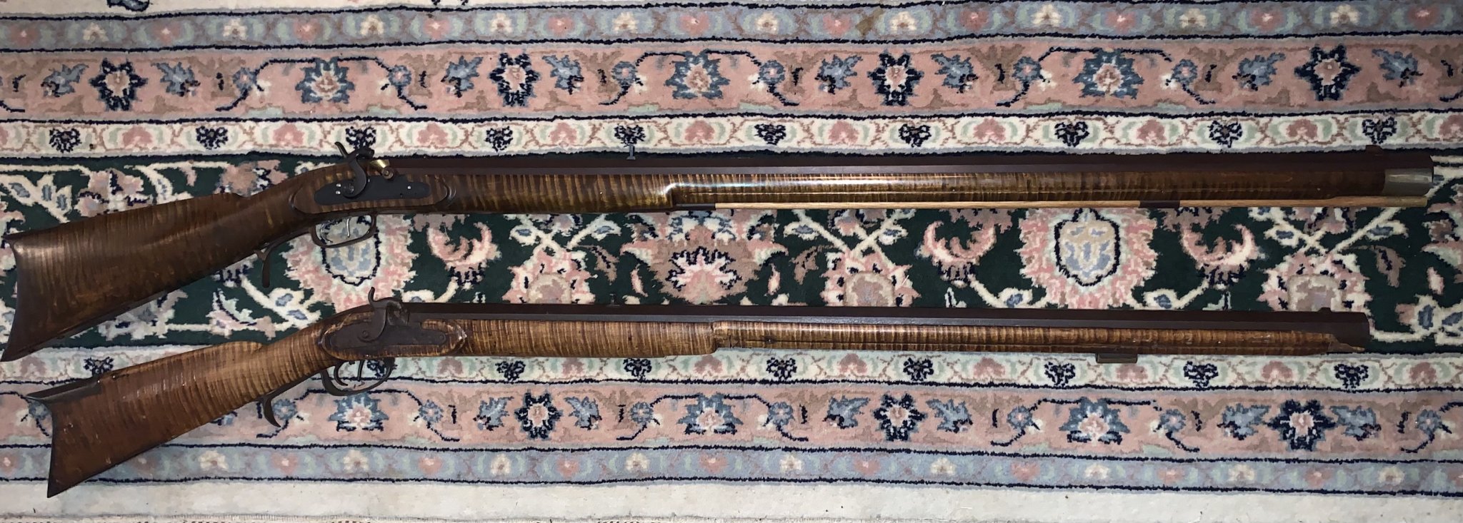

I have a great little Italian .32 squirrel rifle that I used for Primitive biathlon. While everyone else was running around with .54 Hawkens, me and my little peashooter could always make the steel ping. You only had to hit it... you didn't have to uproot it.
All was well and good until I snapped off my wood ramrod on a reload and put it through my hand. That smarted.
New ramrod is brass... painted to look like wood ;-)
Those little .32's are cheap, accurate and fun to shoot. Buy one!

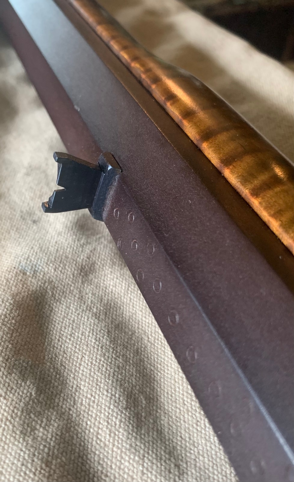

Rear sight... is a 'modern' rear sight until we can get a round/load/etc. dialed in.
From the pictures of the original, the rear and front sight were both VERY low. But theoretically with a big .50 long range rifle, one would virtually want a ladder sight. The 'temporary' compromise was to put on a tall rear and a modern front to dial in a load. Then make a new set of 'fixed' sights that give us the zero we want.
There is a lot of apocrypha on the Interwebs about folks saying 'no way could Hinson have made those shots... his cave was too far from the river to make those shots... it's all made up... blah blah blah.'
The reality (and this is referenced in Kenney's book) his shots were 300 - 600 yards and either static or very slow moving targets. He did not shoot from his 'grotto' high up on the banks... no sniper would shoot from their campsite or base. They move to a hide close to their target and withdraw to their living area. And 300 - 600 yards is not an unreasonable distance for a supported rifle with the right bullet and load. Whitworths were shooting a lot further than that.
Family lore and research indicates that Hinson made one shot 'across the Cumberland' which at the time would have been about 1000 yards. This was not the norm, however. Supposedly, a set of three interlocking rings stamped on the rifle was to 'record' his long shot. But I don't know if this is family lore or documented. I suspect the former. Not that the shot is impossible. It is certainly not impossible!
The sights on the original (see below) were much shorter. So my belief at this point is that Hinson was using holdovers and understood how much his bullet would drop. He was reputed to be an expert shot. And as he was planning his 'revenge' for a while. I suspect he did a lot of shooting to figure out how much holdover he needed at longer ranges. He was also shooting down-hill at the river most of the time. So would have had to understand how to compensate for that.
Anyway... the Mk 1 sights are for dialing in. Then we'll start putting together a plan for a final set of sights.

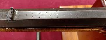

FYI, here are sights on the original. Front sight very low German silver blade. Rear buckhorn.
Note the punches Hinson used to record his targets.
There was never a ladder sight on the original or any evidence of any sight other than this fixed one. He must have been using a holdover!

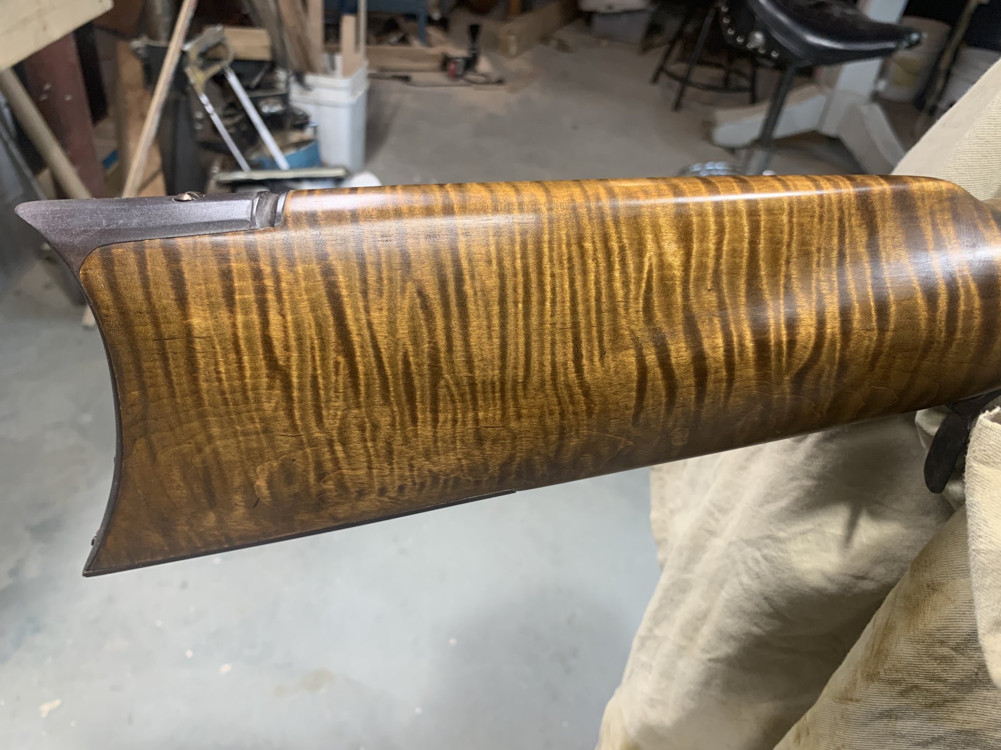

Last, note that the original also had a spectacular piece of wood... The furniture may have been plain, but the original rifle was done to a very high standard.

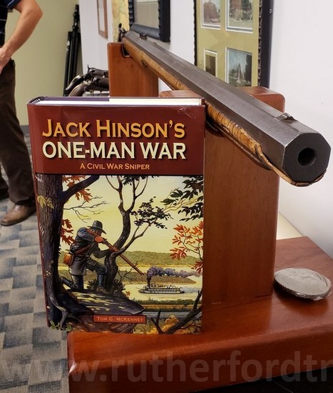

I am at the part of the book where Jack Hinson has picked off the officers on the boats passing by Hurricane Creek. It's kind of difficult to tell by the map in the book but what was the range from his firing point to the boat's location in Towhead chute?
I tried to locate the spot on Googlemaps but no luck.
The one part of the book that the author writes about loading a minie ball with a patch is curious. Was he referring to a paper-jacketed minie ball?
That was not unheard of as the Pritchard round is basically a paper-jacketed round. On the other hand, could he be referring to a conical bullet with a flat base that had the crossed strips of paper for a jacket? Or a bullet with a wrapped paper jacket?
The author also says the Jack loaded 100 grains of powder in the barrel. Unless he had a special mold which would cast a minie ball with thick skirts, he stood a chance of blowing the skirt out and ruining the accuracy.
On the other hand, if he used a flat based conical with crossed strips of paper he could use a heavy charge of powder.
Based on what I am reading, I still have doubts that he used a minie ball. I still think it was a flat based conical bullet.

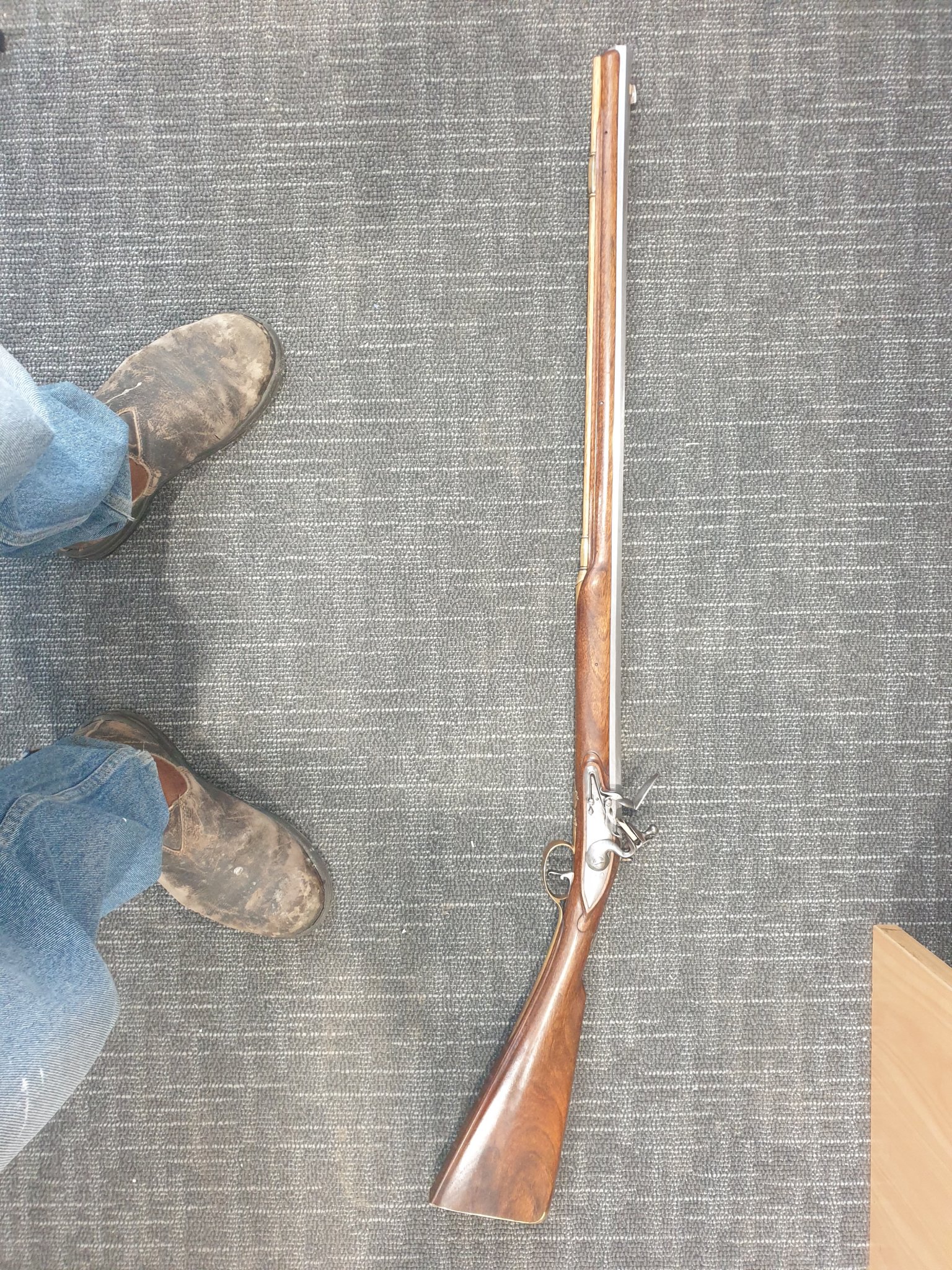

@lowlight checking out the Hinson replica after Precision Rifle Expo.
In this case, the rifle really IS that big!

We worked off photos and a handful of dimensions.... we got it 'almost' dead nuts. Design wise, we captured everything.
It's about 2" bigger. But considering we had rough dimensions and nothing but Internet Photos to work from... yeah, happy!

The likeness is amazing.
You did very well not criticizing.
if your intent is to shoot it it would have made sense to "modern size" it as Im guessing your average CSA member with a custom build would build to what today would equal Cricket dimensions.
PS - Im thinking the photo is also showing some "optical illusion" and the difference is exagerated in picture.

Hinson was 5'7"... not short by the standards of the day. I'm 5'11". Holding the original... it was 'fine' size-wise.
He was also exactly my age when he started his campaign. And running up and down those cliffs was hard work. I mean hard work. With a 30 pound rifle and a small pack. Captain Jack was one tough hombre.
And you are correct that there is some illusion in the picture that makes the replica look a little bigger. But not much. It's a bit bigger.
