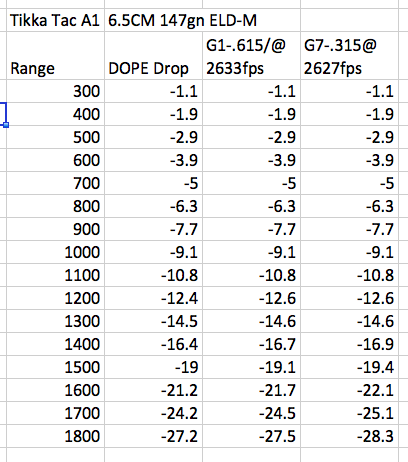

First off, thanks for a quick reply. And in the same breath, sorry I’ve taken so long to reply. Been gone with work.
”First, did you link the Sportsman with the Kestrel Ballistic App to upgrade the firmware and then build the profile in the app and transfer it to the Kestrel?”
I did when I read this. Something I noticed was that the G7 BC the app pulls up (.315) is way different than Hornady’s advertised BC of .351. I was using Hornady’s number. I later switched to the G1 BC of .615. So far, this BC with a modified MV of 2633 FPS has come closest to my dope.
After speaking to another buddy he indicated that my numbers are pretty close. I think I was expecting to be able to get an exact match. That said, I’m not entirely confident in the longer range dope so I’m not too worried at this point. We were not able to see where on the steel we were hitting, just flashers.
Thoughts on what you see in these numbers? Looking to learn.
Thanks
I found .315 a lot closer than Hornandy’s numbers with the 147’s out to 1500.
The BC I used to to true up at 1791 yards was .308.

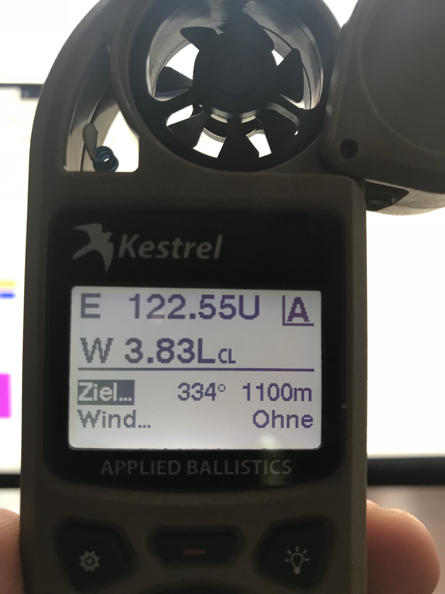

What does that CL behind the windage number stand for?
Sometimes it appears behind the elevation number as well.
clicks are in both mil and moa so you can use either depending on the scope you have, mil or moa. Do you really want to count each click or use the whole number value in mil or moa. Most mil scopes are 10 clicks per mil and most moa are 4 clicks per moa. If you have a hold of 7 mil do you just want to turn the turret to #7 or count 70 clicks?
Reactions: Steel+Killer
Units, always units, regardless of the unit using. Clicks are arbitrary.
Well, you have to click all the numbers anyway and it is not about counting clicks.
In my opinion it is more how about you think of it I guess.
I see the numbers as tenth and for me it is not 15.7, it is 157.
But I get your argument and will think over that if I want to change.

Watching one of the kestrel love Zoom videos, learned that double clicking the light button takes you to the wind reading screen no matter where you are, double clicking again takes you back to where you were.
I didn't know this, huge value for me. I have been leaving my wind 1 at 0 to negate AJ, and wind 2 at 6mph which is the mph for my rifle. I don't capture wind speeds for dope but used to menu click into weather mode the see live wind to calibrate what i feel and see vs measured.
Great time saver.
Reactions: chrismartin
Interesting. double pressing my light button takes me to the compass. To be more accurate, it toggle between Ballistic and Weather mode.
Reactions: seansmd
While in weather mode toggle through the screens until you get to wind. Then double click back to AB. Next time you double click back to weather it will display wind.
Reactions: seansmd
Exactly, this is the menu I stay in so that is what it toggles from. @ScottDWallace is correct, toggles weather and ballistic wherever you are in each.
