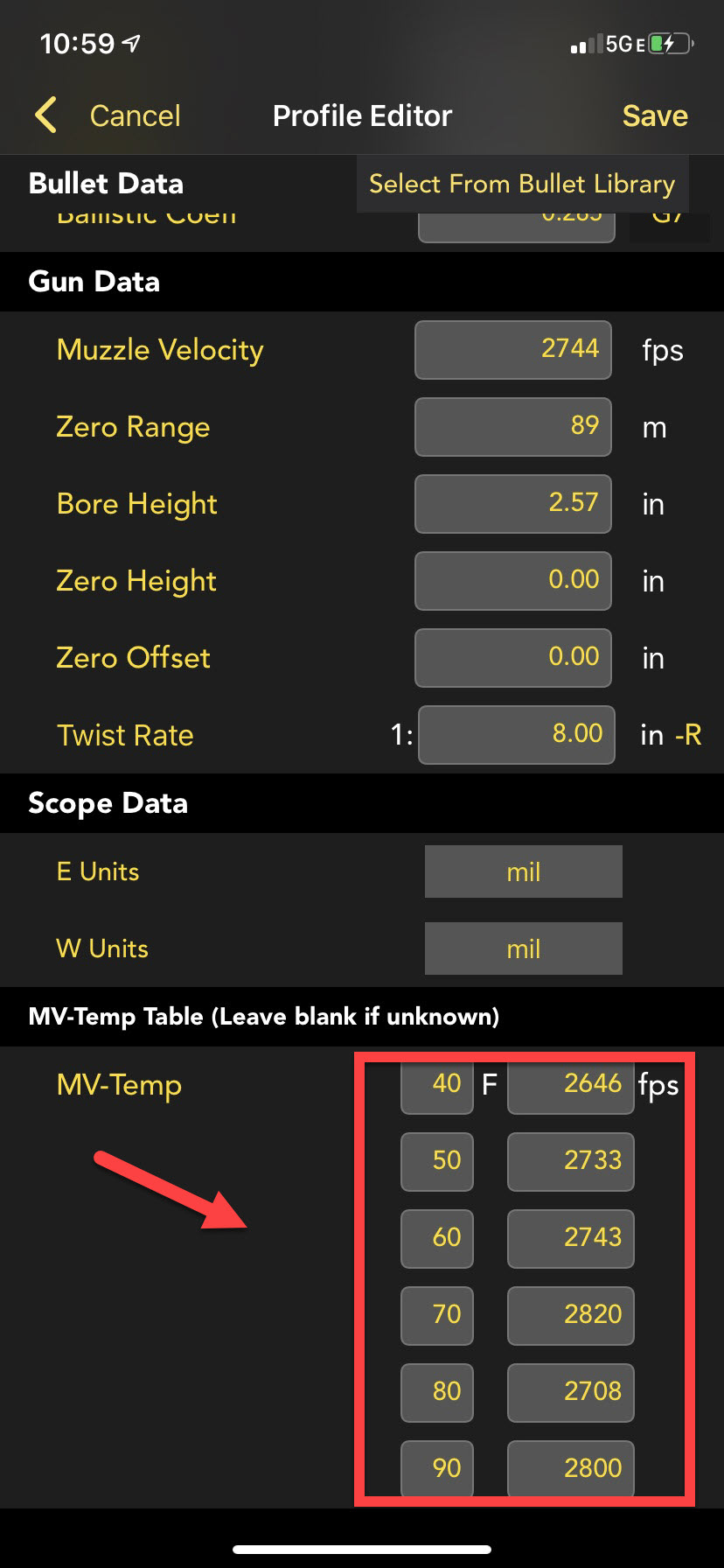

I have a few Kestrel questions. I have the 5700 Elite;
  1. Gun profiles; If you choose from the bullet library, does that override the manual information? or vise versa? What takes priority?
  2. I'm shooting 136g Lapua Scenar-L's. The manufacturer's website states the G7 BC is .274 but if I use the Kestrel library it changes it to G7 .285. Who do I trust?
  3. Gun Data> Muzzle Velocity>I enter my MV (2,744 @60F). Save. I view MV-Temp table and the Kestrel added it to the chart but as 70F. I zero all the fields and add 60F then save. I check the MV-Temp table and the degrees are not sequiturs? See the attached image, for example, the 90f temp has a slower MV than the 70f MV. Etc...
What am I doing wrong?

You can pick a profile and adjust its BC as long as it’s not their CDM selections.
Try your BC, if it works it works.
I just populate the the MV-temp in the kestrel itself with a high and low.
So your saying one doesn't override the other?
How do you know if your BC "works"?
I would start by trusting the AB G7, and then go through the process shared here multiple times to true your data. 500-600 yards true the MV, then validate dope out to trans and adjust BC if needed.
And how about the non sequitur MV-Temp table?

Another temp table question....
I finalized my load today and have the MV for this morning's conditions. Should I put that one data point in the Temp Table or leave the table blank and only enter MV in the Gun Data section?
You can input the data but do not use the table until you have at least 3 entries.

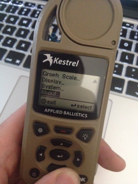

  5. Finally have some time to kill during the lockdown? With this new update we’ve added the old school Snake game to play. Found under the About menu. Just try to master the Sensei level, good luck!

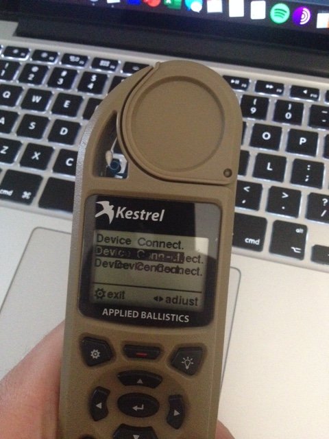

I updated my Kestrel 5700 Elite and
- lost every gun profile
- If I go to: menu -> bluetooth -> Privacy Pin I show a overlaps inscription "Device Connect" (x5)
- in settings mode many description has "..." sign, every should have it?
Can you send a picture of this? That is something I haven't heard before.
