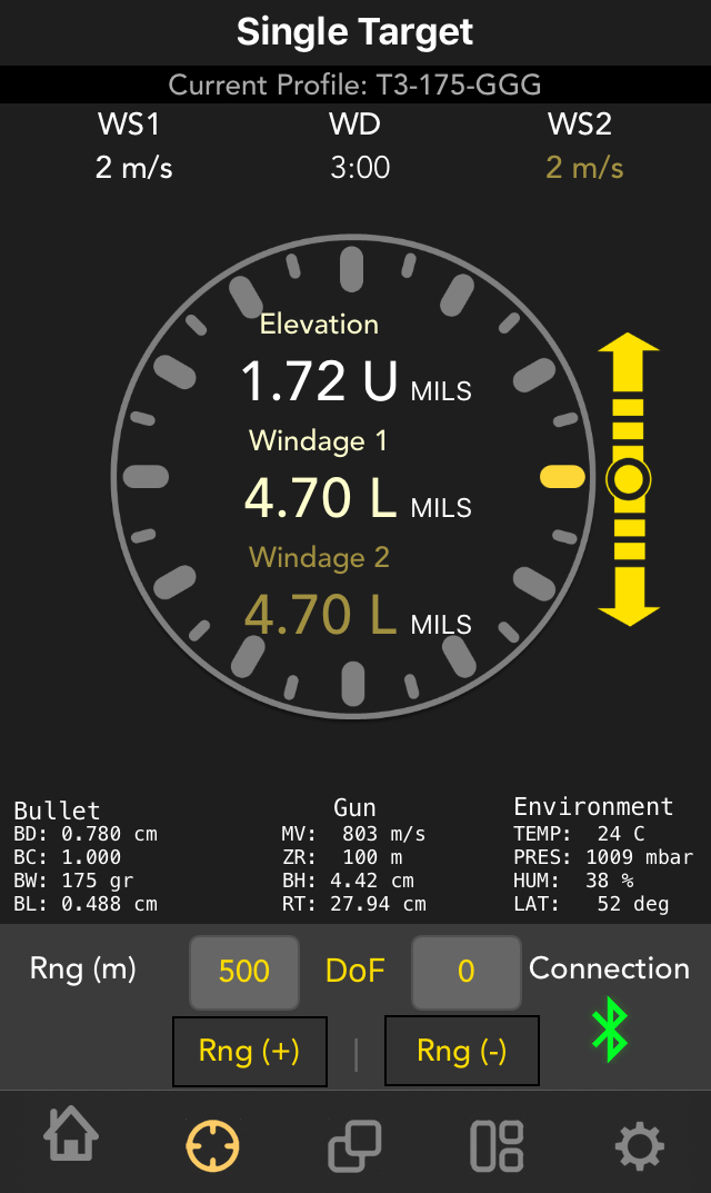

I have a problem with my Kestrel 5700 Elite. It suddenly stop giving me true calc.. Factory reset helps only for moment till I change something ex: wind or rifle... look below - 308 win, 2632 fps, 546yd, wind 3 o'clock 4,5mph. Does somebody has solution for it?
It looks like your bullet length is off, that would be a pretty short bullet. Make sure you have the latest app and fw and recreate your profile using the bullet library, send it to the Kestrel and see if you get a better number.
I have latest fw and app version I’ll try with bullet length but what caused this problem?
There has been some posts that the AB library is/was not accurate and your profile may have been made with bad data and redoing it in the app and resending to the Kestrel may fix it.
I use it over 2 years.. it happend suddenly and I don’t know why, where is a bug? May be new update crash it..
Hard to tell why, best to just redo profile and see if that fixes it. If not then spend the time looking into it.
IMHO I found a bug. The Kestrel Link App doesn't auto calculate properly bullet length in metric system on Imperial works ok... In metric I must manually add true value. Before latest update everything works ok.
How did you manually change the bullet length, you had a custom curve and length is locked in those?
In Kestrel Link Ballistics - go to settings turn off BL auto calculate then u show new place with bullet length u can manually enter.
If u use custom drag u show bullet length but u cant't change this value if u made manually gun set up u can enter everything manually.
Kestrel could unlock to change bullet length during custom drag use. Unless custom drag use constant bc and bullet length, but I don't know is that true.. It's know that is bug in kestrel link app, previous version hasn't it.
Kestrel LiNK Ballistics for iOS had a bug with auto calculating bullet length for custom curves in version 224. This should be corrected with the latest version, 235. However the bug will still exist in profiles created and saved with that previous version (even with using the new app version). If you recreate the profile with the new version, the bullet length should be correct and you should not see any issues.

I am new to the kestrel 5700 with AB. I have turned SD off and set my Lat to zero to turn Cor off.
My question is there anyway to adjust AJ value? It looks like every 6mph in wind1 adds a .10th. On my range out to 1100 yards with a 12mph wind1 from 3 o'clock. It's adding 0.20. In testing that is too much. For me it more like a .10th. Any future firmware updates that will allow us to adjust how much AJ it is giving us?
I am running my gun an a G7 bc if that matters.
To turn of AJ, set wind 1 to zero, and just use wind 2
no, like the other effects they are over emphasized only able to zero them out, sorry.
