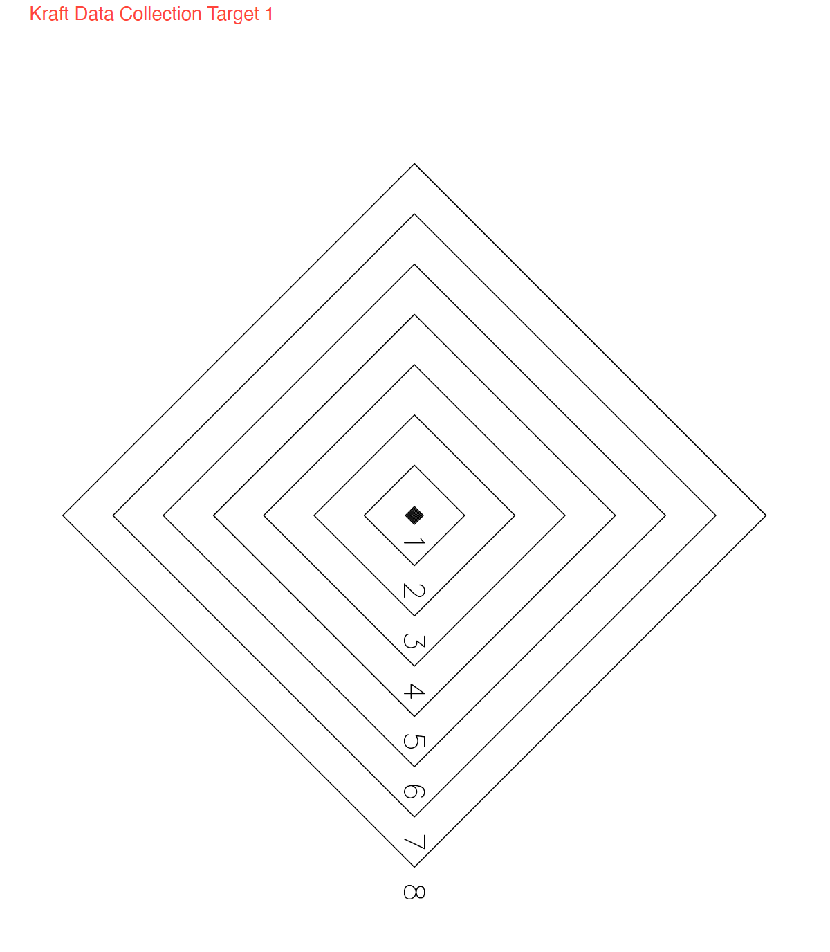

    Sniper's Hide and Chris Way of Kraft are partnering up to collect some data from Shooters.
    Chris is a very data-driven shooter, he is a competitive shooter and loves to analyze data. He Krafted a precision rifle course of fire designed to be shot at 100 yards and collect data from multiple positions.
    To get into the background, Chris is training for Assassins Way and has competed in several national level precision rifle events. You can follow his YT Channel or Instagram Account. For further background, you can listen to Chris on the Precision Rifle Podcast.
    The idea of this target is to shoot multiple positions, this is meant to be dynamic, to replicate positions one might find in the field or in competition.
    We are looking at the basic position, all supported.
    • Standing
    • Kneeling
    • Sitting
    • Prone
    Supported Positions
    We want a minimum of 3 shots per position, and make it realistic. Don't build a better position because you are not on the clock. We want you to engage these positions clean and free, on-demand. In other words, don't use a bench with additional support, we want this to be as organic as possible.
    Use the calibrated target below, we don't need comment on the paper, but details will help. We are strictly collecting data to compare across a wide range of shooters. We want just want you to post a picture of your group, If you want to discuss that is no problem at all, the more discussion the better. But the reality is Chris simply needs the image of the shot group.
    I would recommend a tripod, but a barricade is an easy way to accomplish this drill.
    If you want to include caliber and rifle information that is no problem at all. We are really just looking at the group.
    Download the target, go out to 100 yards and shoot the positions, Then post your image here or email to Chris at the address on the PDF.
    You shoot the same target for each position, we are looking at the overall total group size based on the changes in position

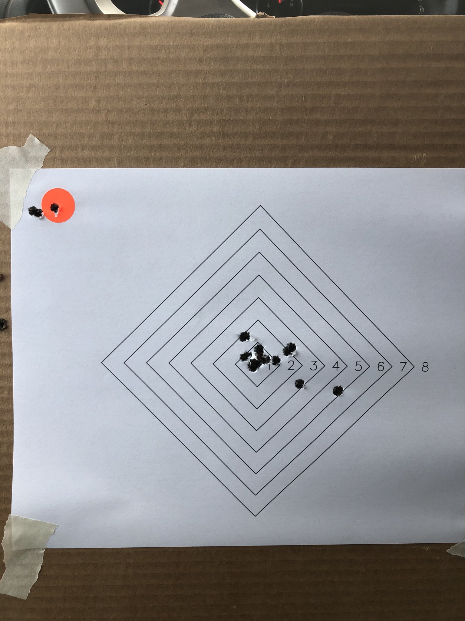

    On the 22lr target I had the wrong bullet profile for dope. Adjusted and then shot the last 11 rds
    Thank you! Man.. think of all those little things that we disregard as not important like bullet profile.. zero.. and then consider if that happened in various scenarios. I think that’s A. Totally normal and I do it all the time B. A learning experience that there’s more to shooting than simply loading ammunition and making noises!
    @ChrisWay what are the dimensions of the target...or how important is printing it at exactly the right size?
    I noticed my printer cut off some of the text at the bottom. I’m not sure if it scaled the target. The diamond I have is 7 inches, point to point, and about .353” between lines...or .5” between points on the horizontal. Sound right?
    The diamond score boxes are 1 MOA per section. so point to point there should be half inch space. I do think that the scale matters for data to be collected and put into the number cruncher but if its off by a small amount it can still be revealing. I also think that for your own personal analysis none of that really matters unless you're looking for a specific set of data. plenty of insights can come from looking at your shots on a variety of shapes and target sizes. This project though needs a uniform consistent standard. I think that since most shooters understand the MOA discussion on target sizes its a great standard to bridge all disciplines of shooting.
    Use the PDF it will scale properly with your printer.
    I believe the are diamonds in 1 inch increments, is this correct, my 7 box measured exactly 7" not 7x1.047?

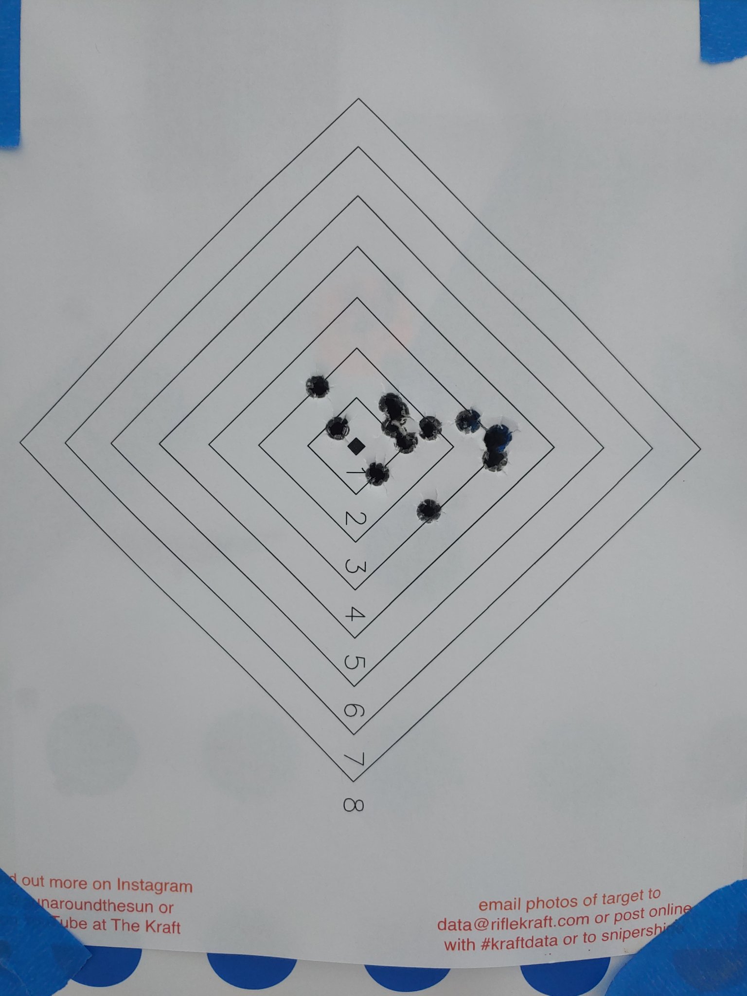

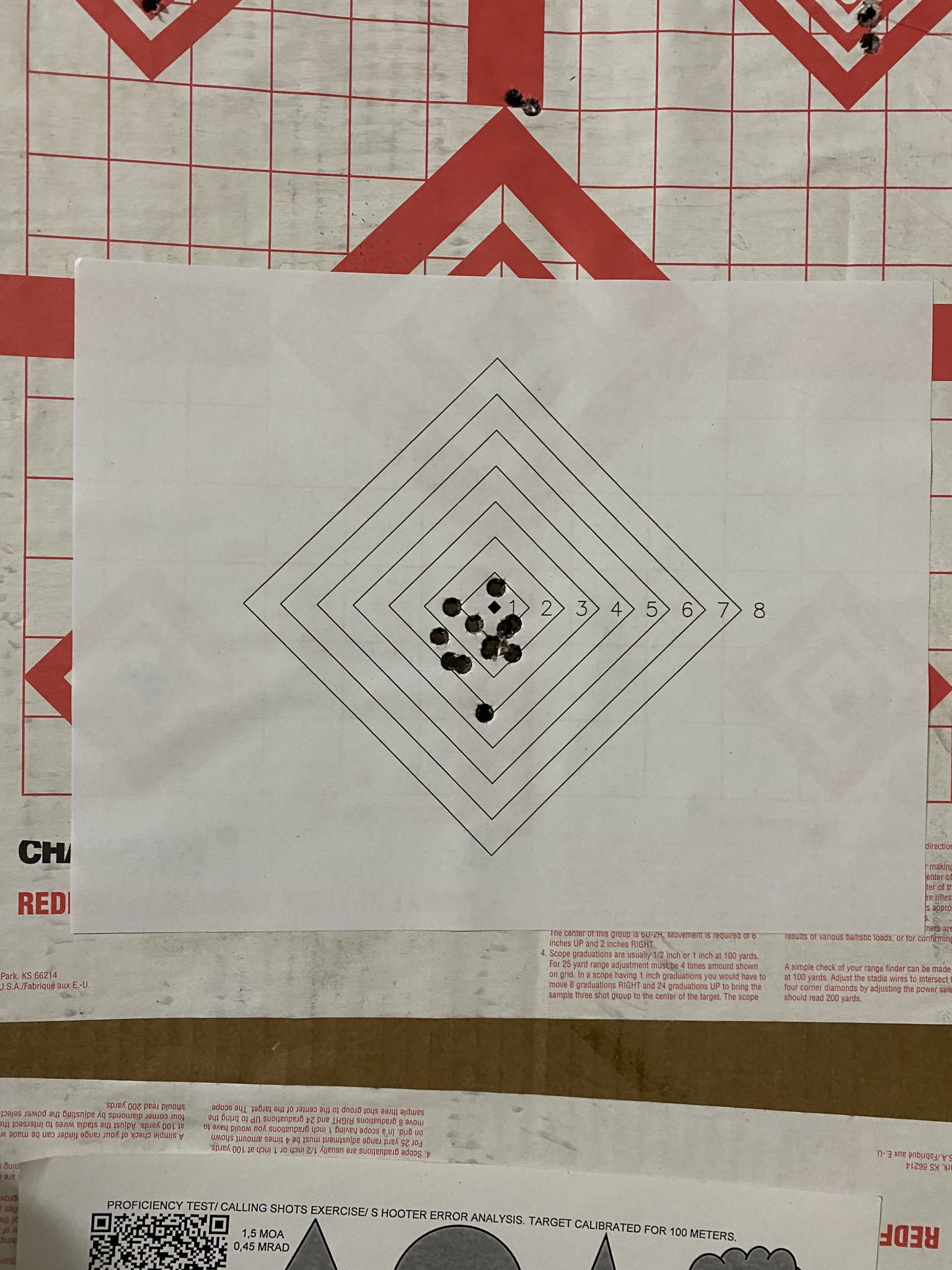

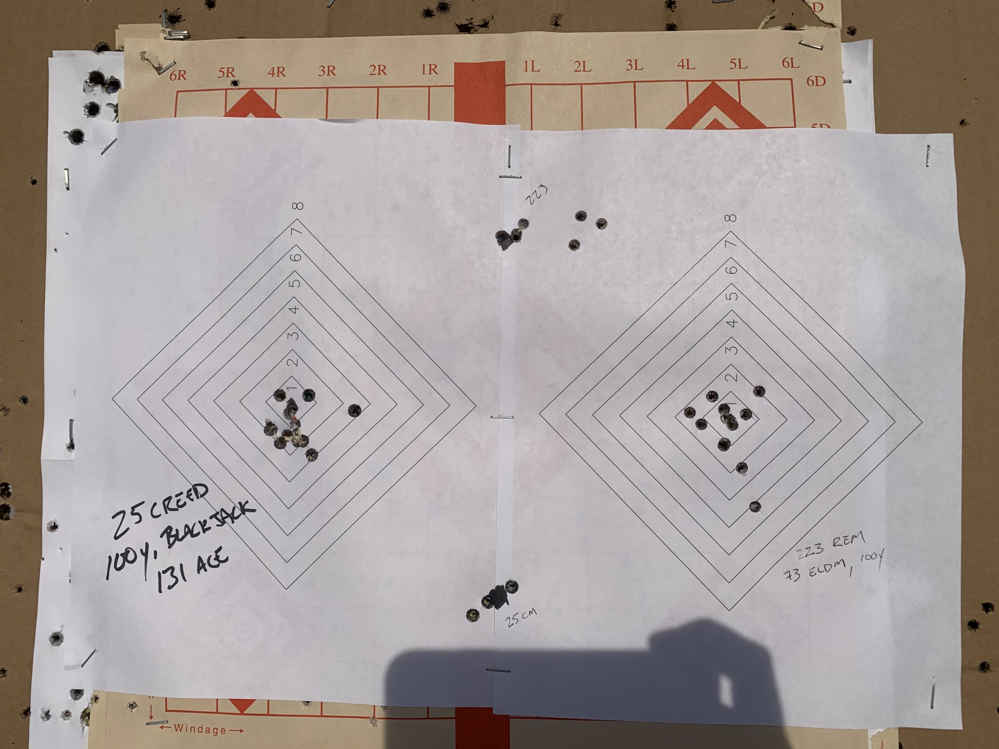

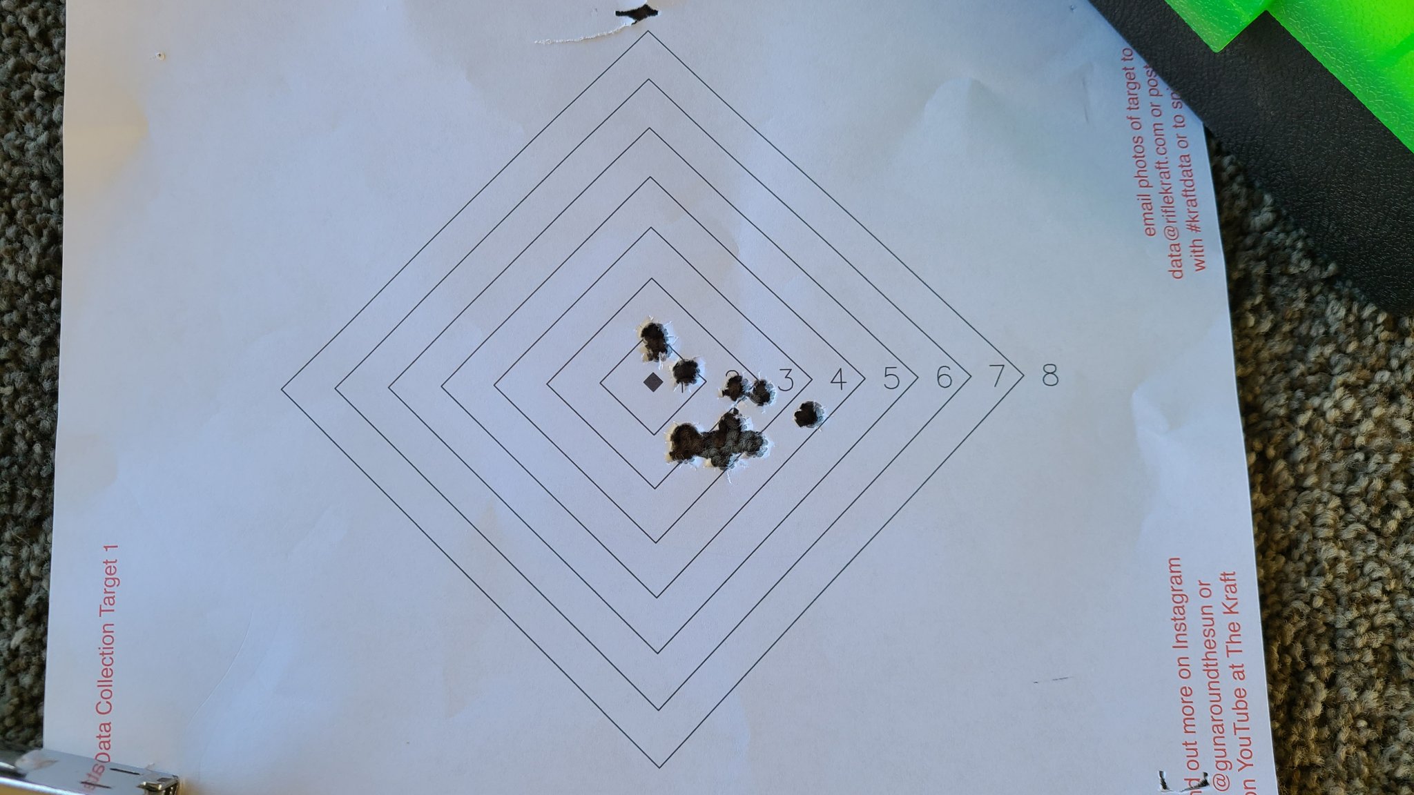

    I ran the Kraft data challenge today with two different Rifles. My 25Creedmoor and my 223rem trainer. I used a mini GC hybrid for all positions and that was the only bag or support used.
    What I found was that sitting was the most difficult position for me. I used a folding chair for the 25 which was too low to get a good sitting so I was sorry if laid out on the side of my hip. so I tried the tripod with a plate on top with the 223 which I found was worse even though I was a little higher up and could get both cheeks on the ground and support elbows on my knees.
    I did a baseline prone group with both guns and will need to look at working up a more accurate load for the 25 as it was stringing in prone while the 223 put everything into a single ragged hole after shifting the zero due to different ammo having been used previously.
    I took my time and didn't rush shots so the next time I go out I'll try it with a time stressor.
    I want to find something better to shoot from for sitting. Might have to take the multi level barricade instead of the tank trap.
    What I found most revealing was that my groups centered a bit low with both Rifles. That would indicate that though my rifle is set properly while prone, somewhere in positional I am pushing low. Thinking back on many of the last matches, I find I am low on Target from anything not super stable. More investigation is warranted.

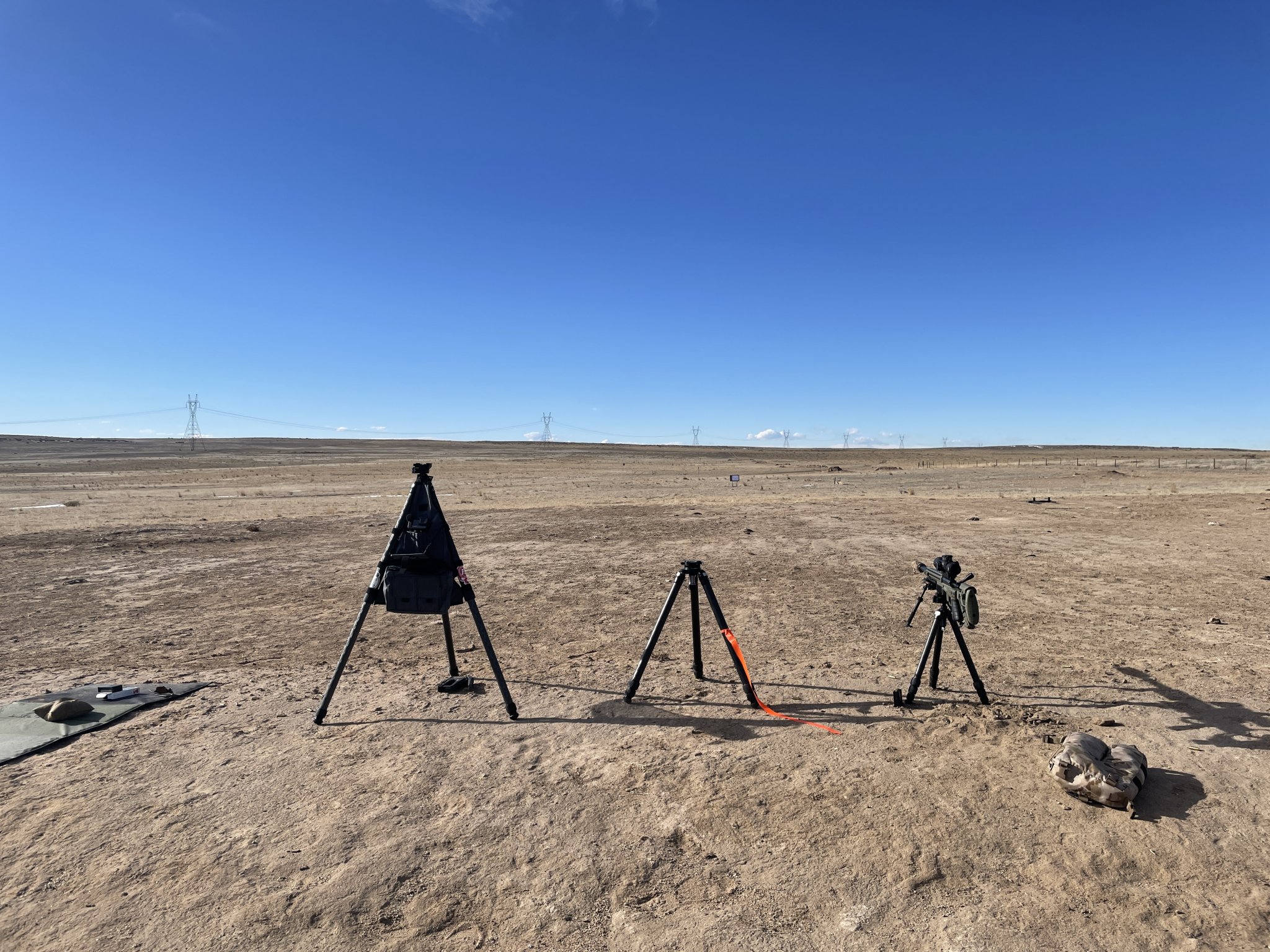

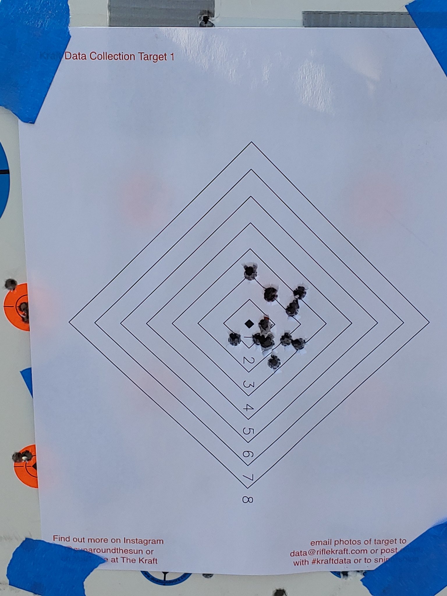

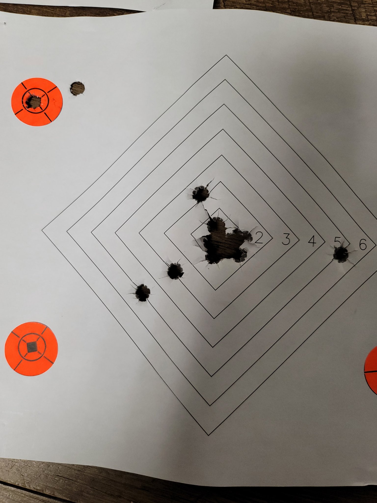

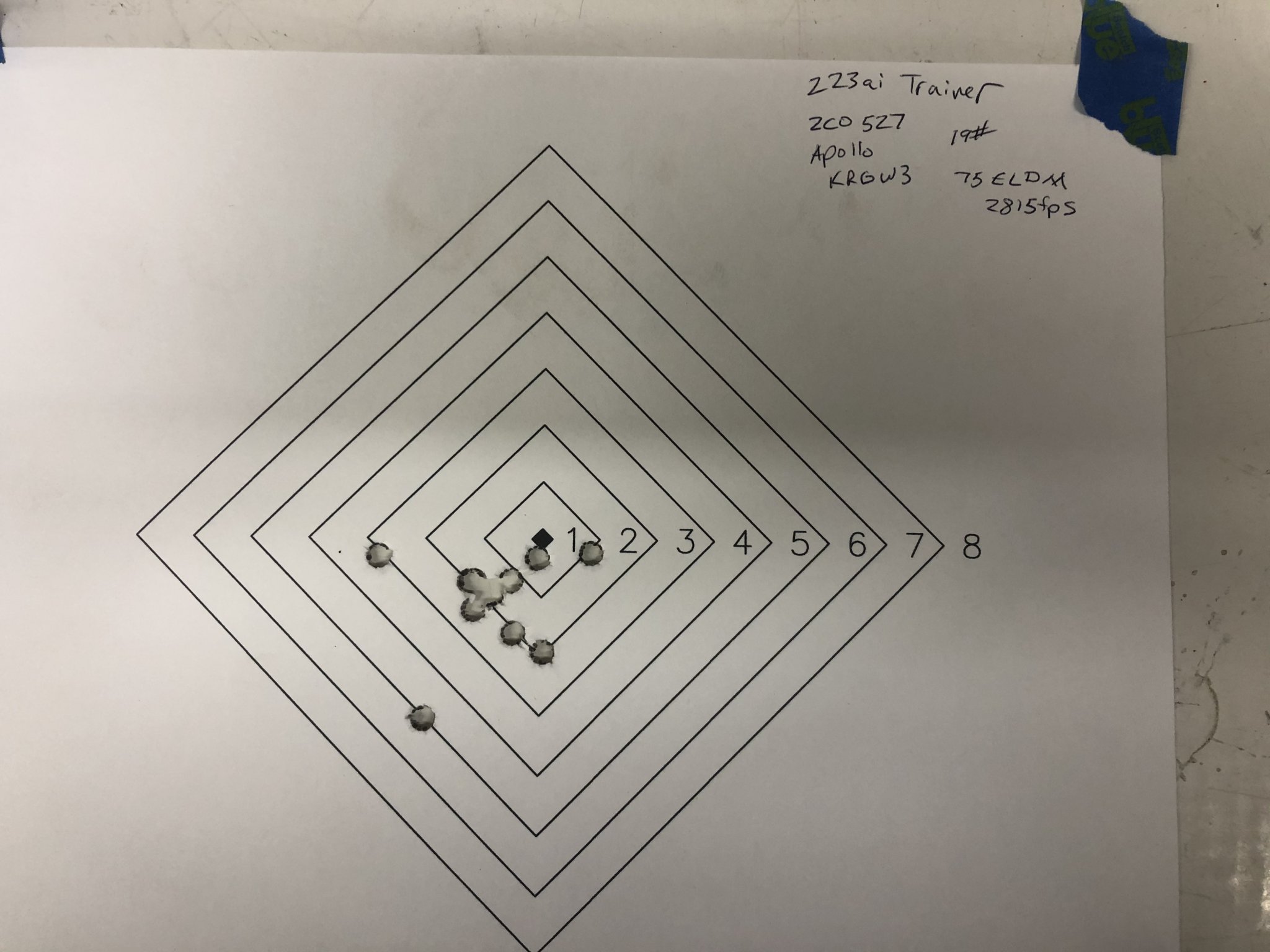

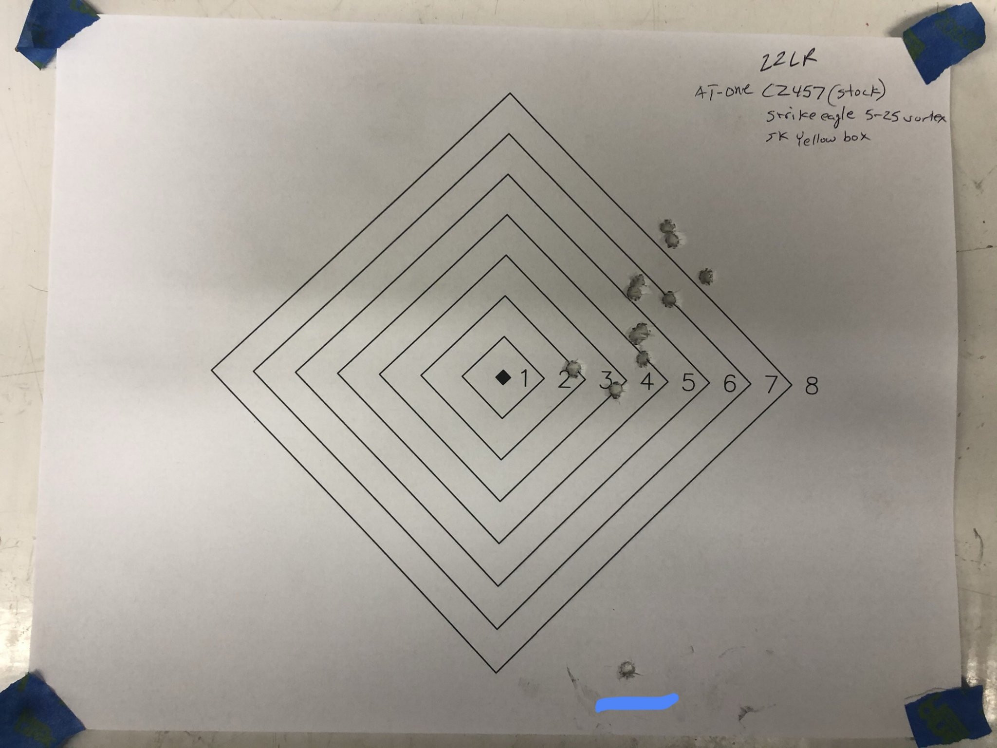

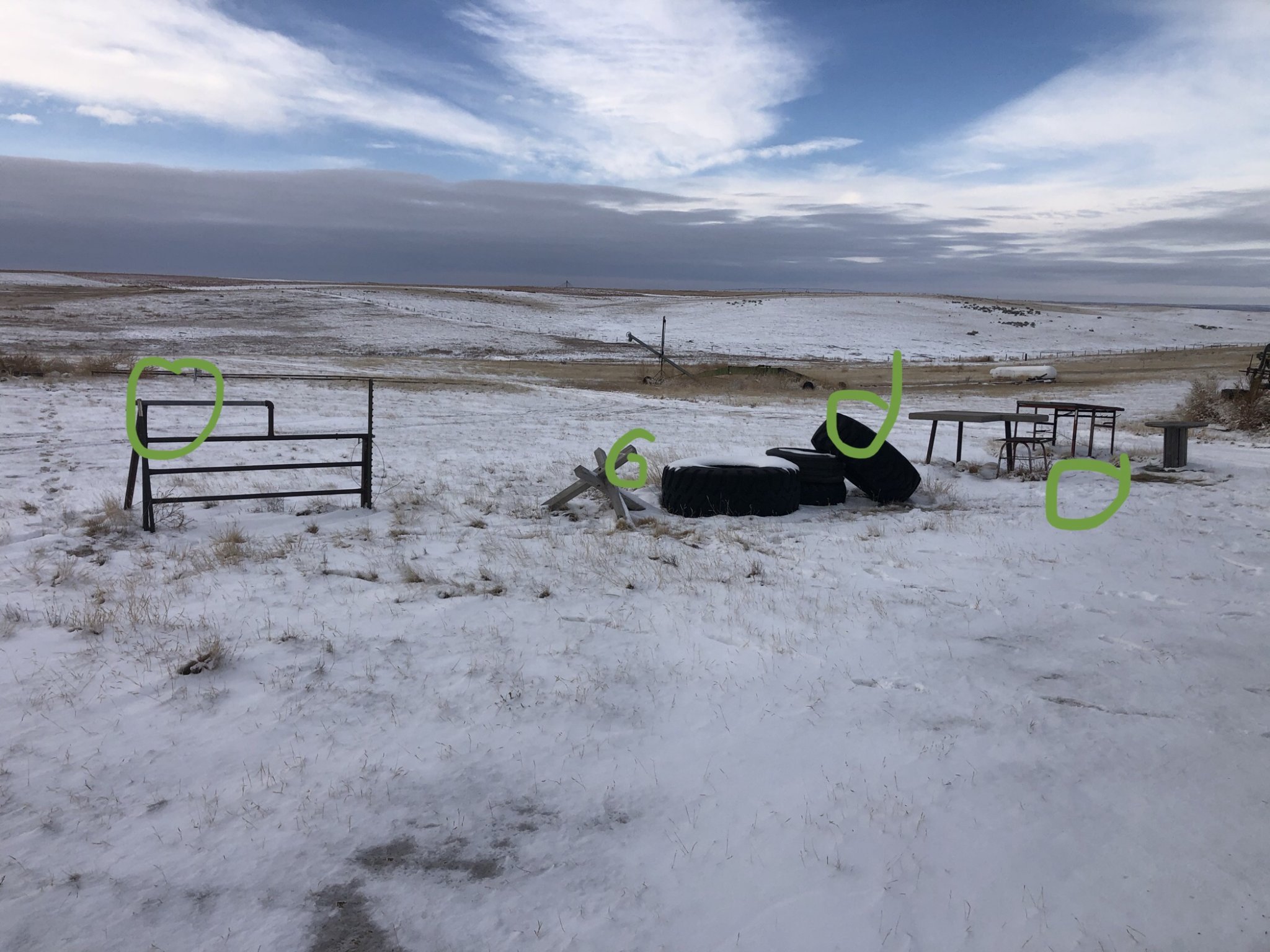

    And again no time factor, build position and shoot, move, rinse, and repeat through 4 positions, and repeat 3 times?
    Shot standing off the top of gate, low kneeling off the tip of tank trap post, high kneeling off tire, and prone. Didn’t want to sit in the snow 🥶

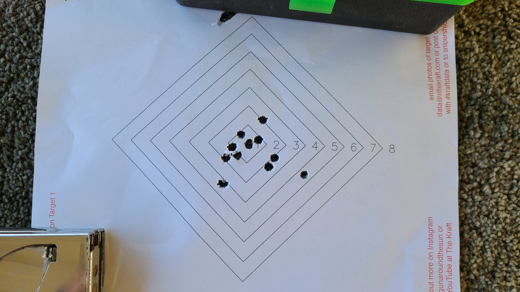

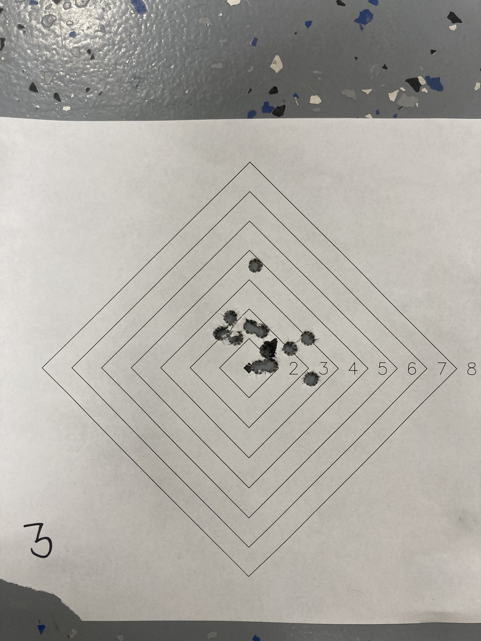

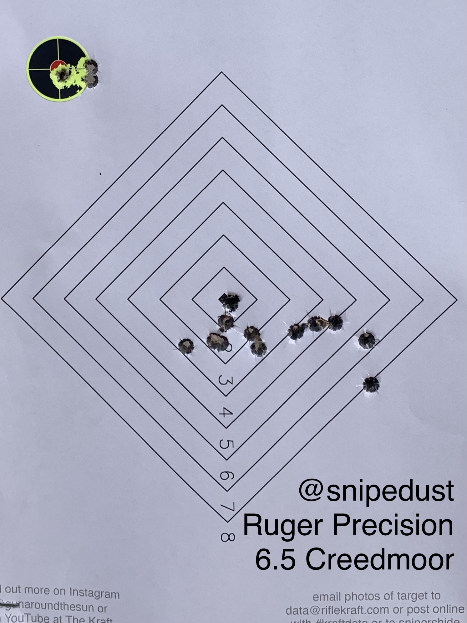

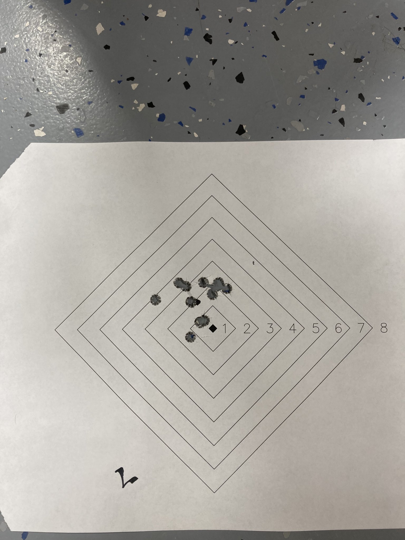

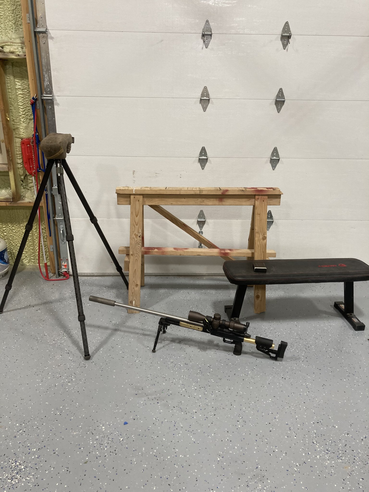

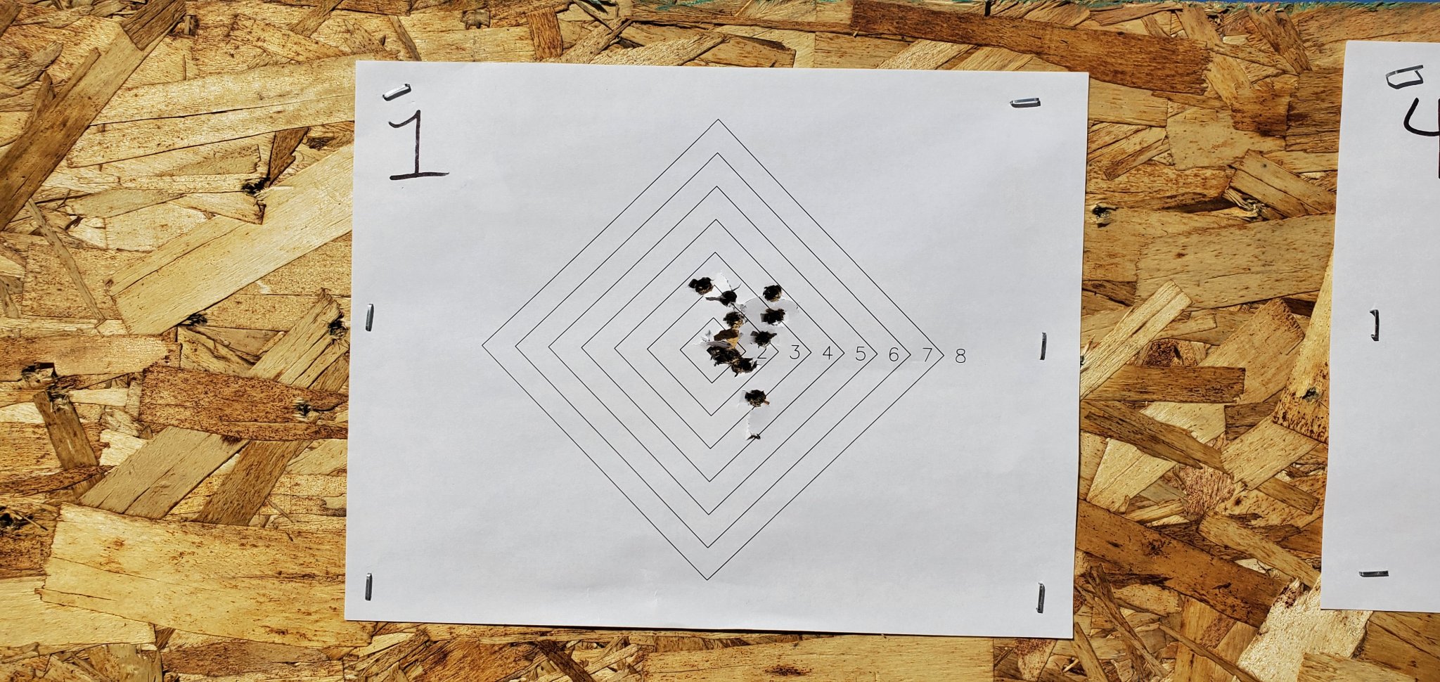

    Shot these about 3/4 speed

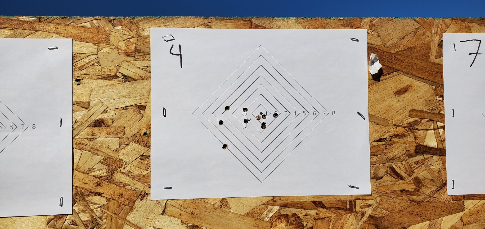

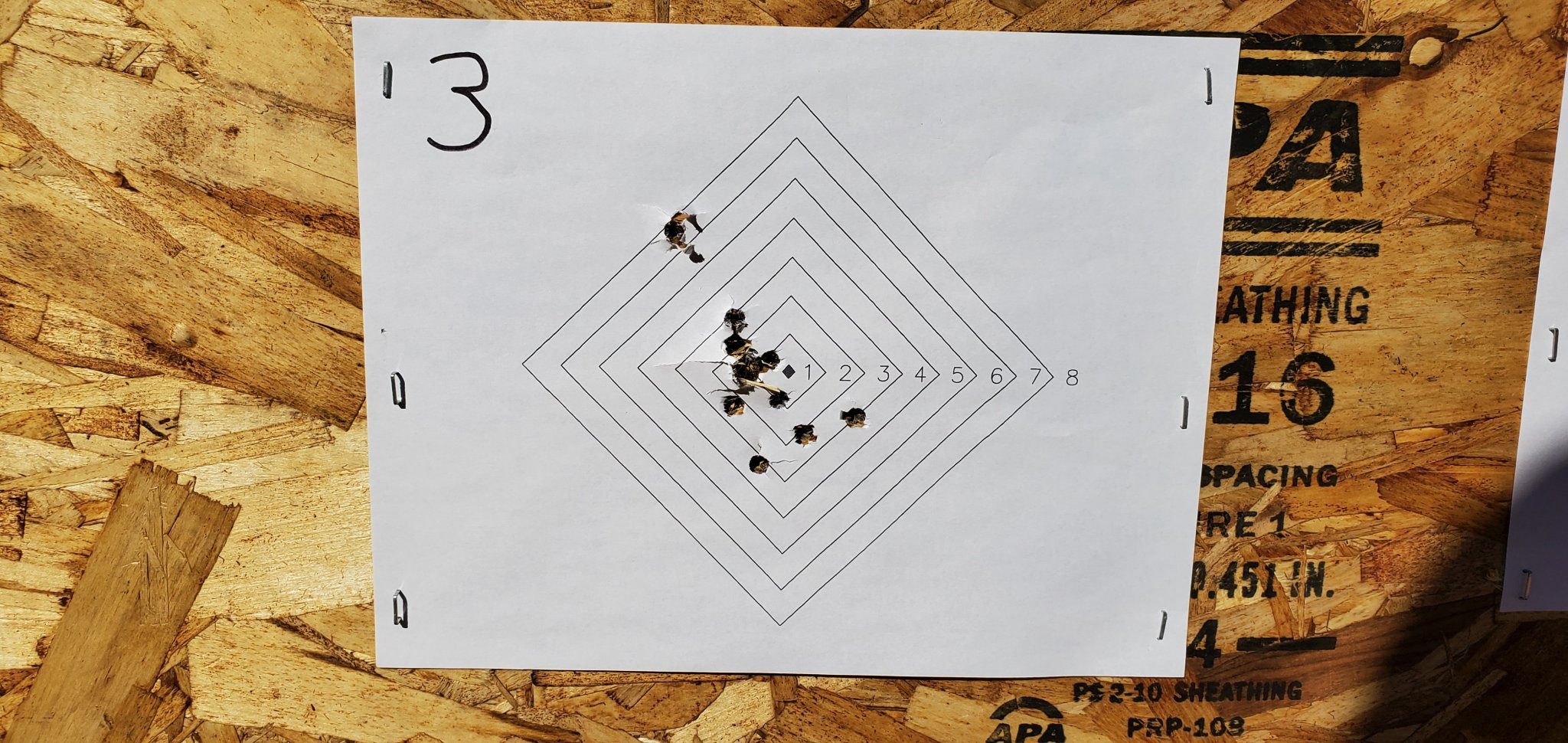

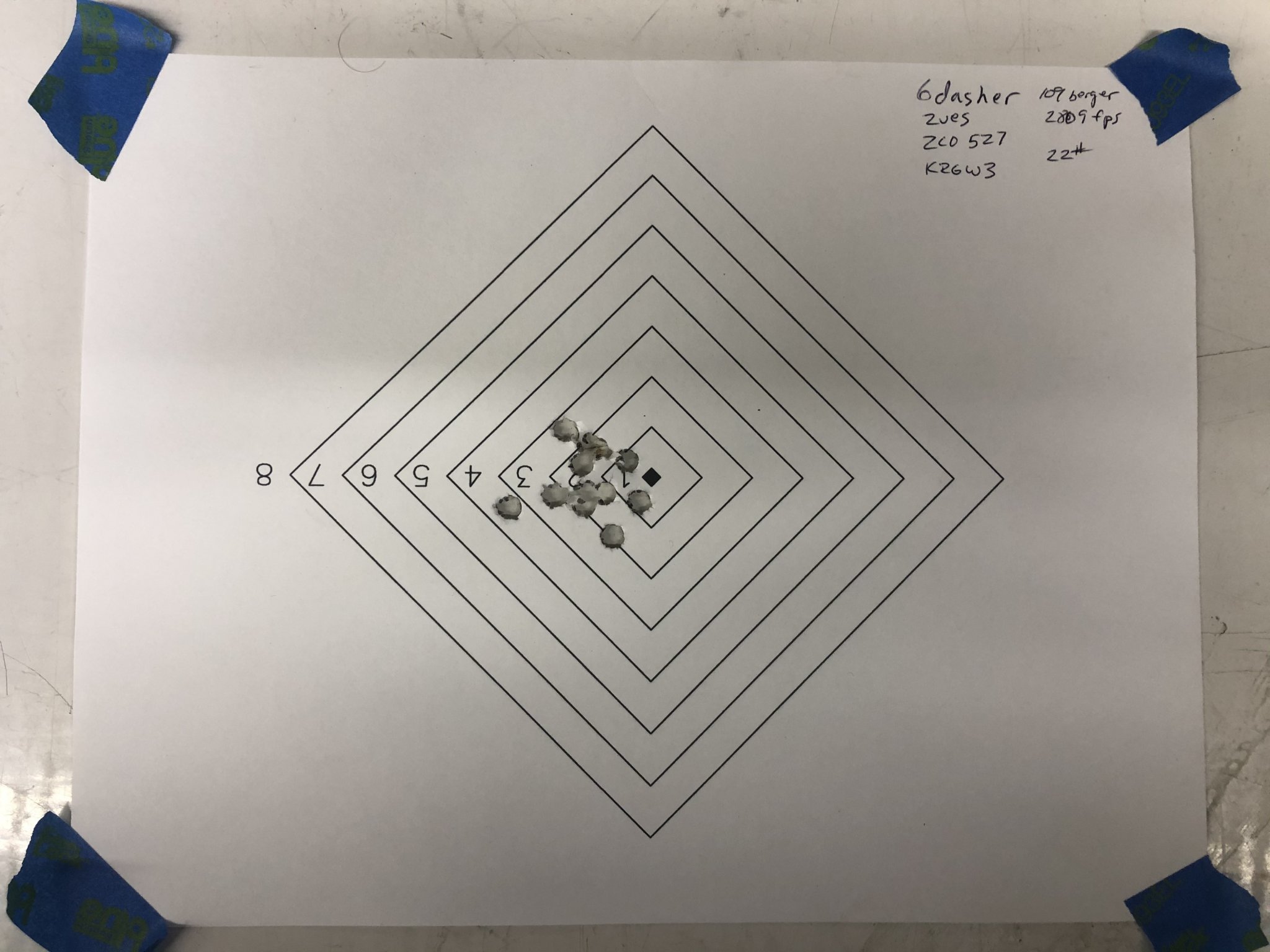

    Chris,
    I made this a side stage at our practice match today. Everyone enjoyed it.

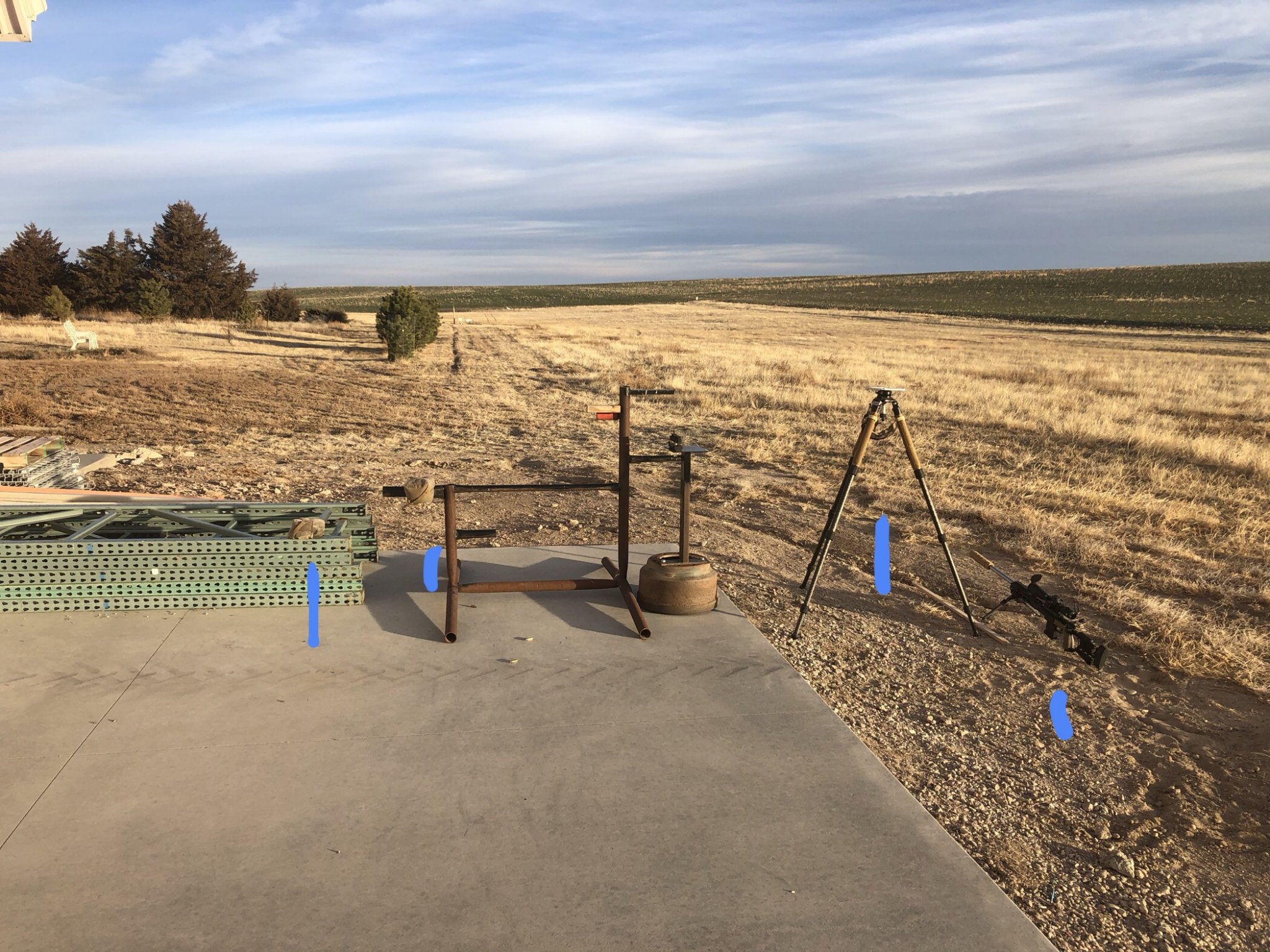

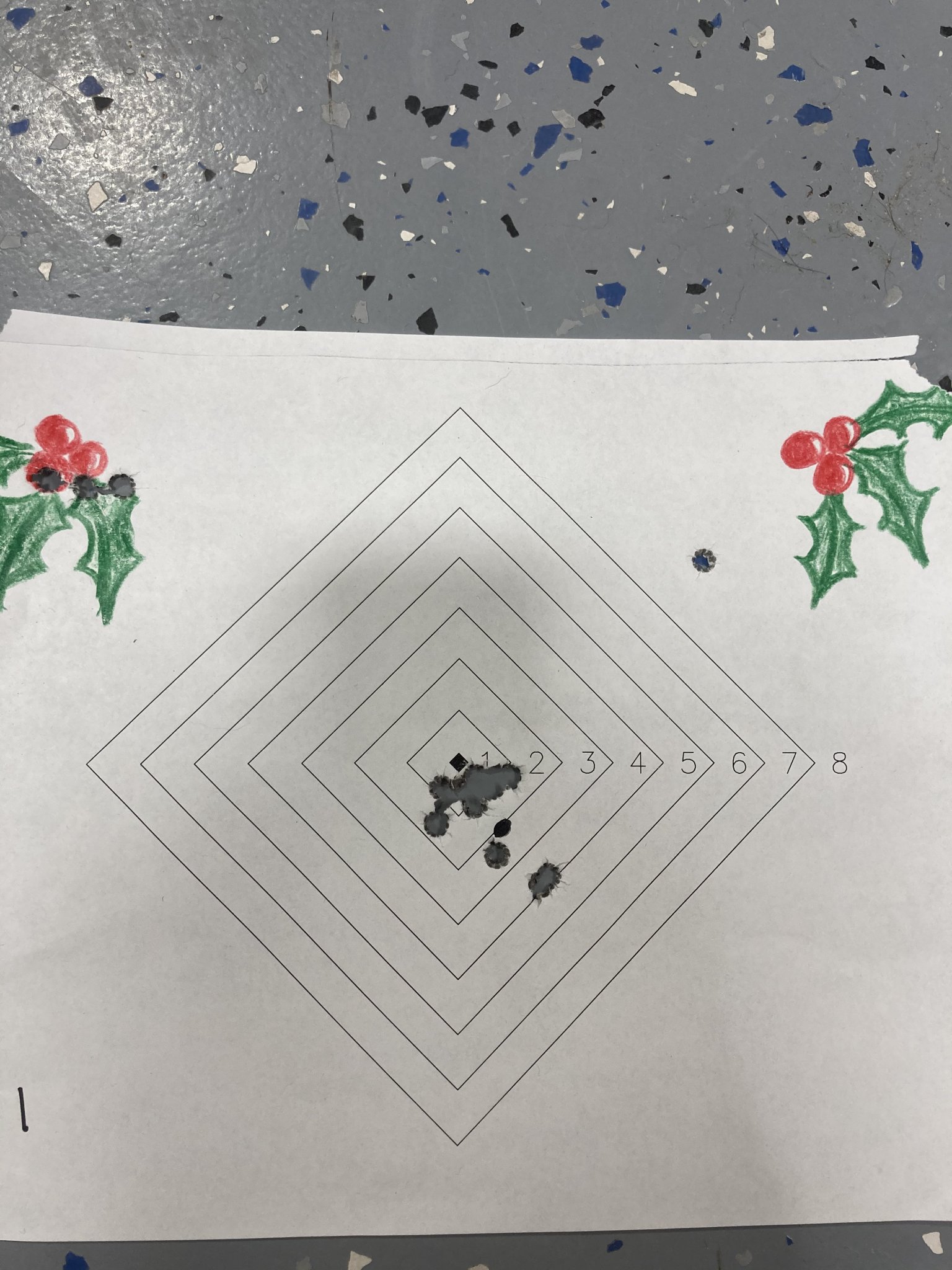

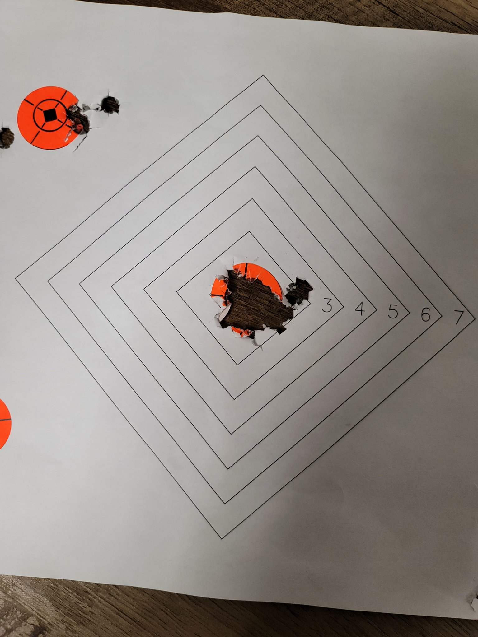

    Im seeing the value in an acual tripod. I was using one of those cheap bog tripods i had. Adding another thing to the list to get
    Couldn't find #12 on the target was thinking i missed. Checked the back of the box to find it
    Thought i did ok for my 3rd time using it but i need to practice more. I wonder how big of a difference there will be with a good tripod and practice

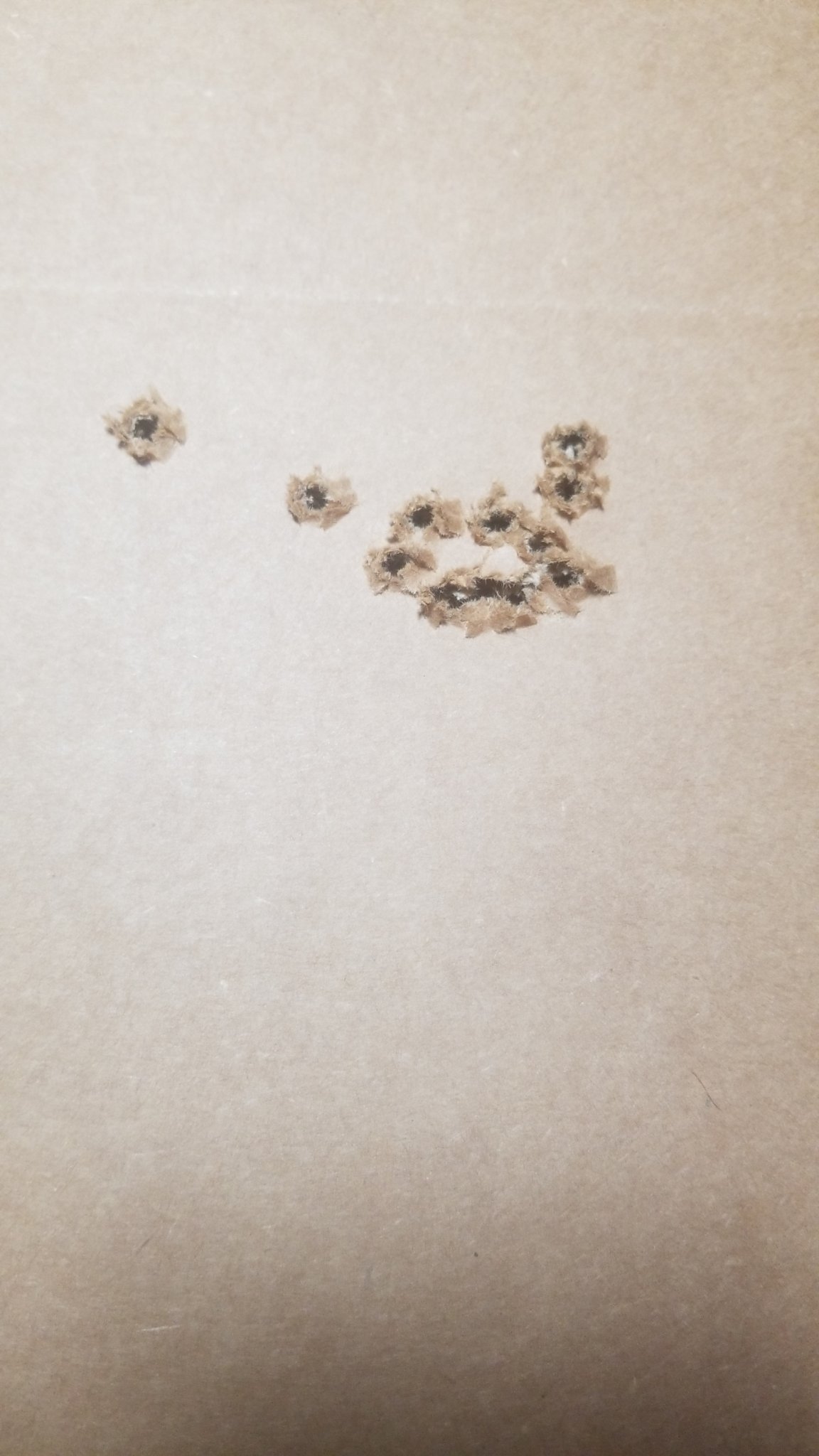

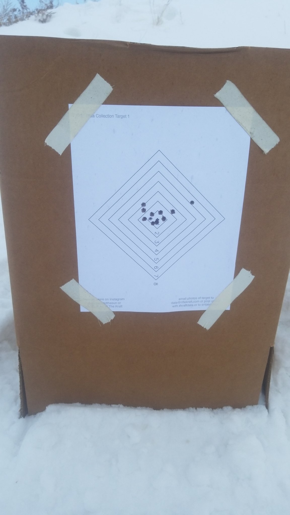

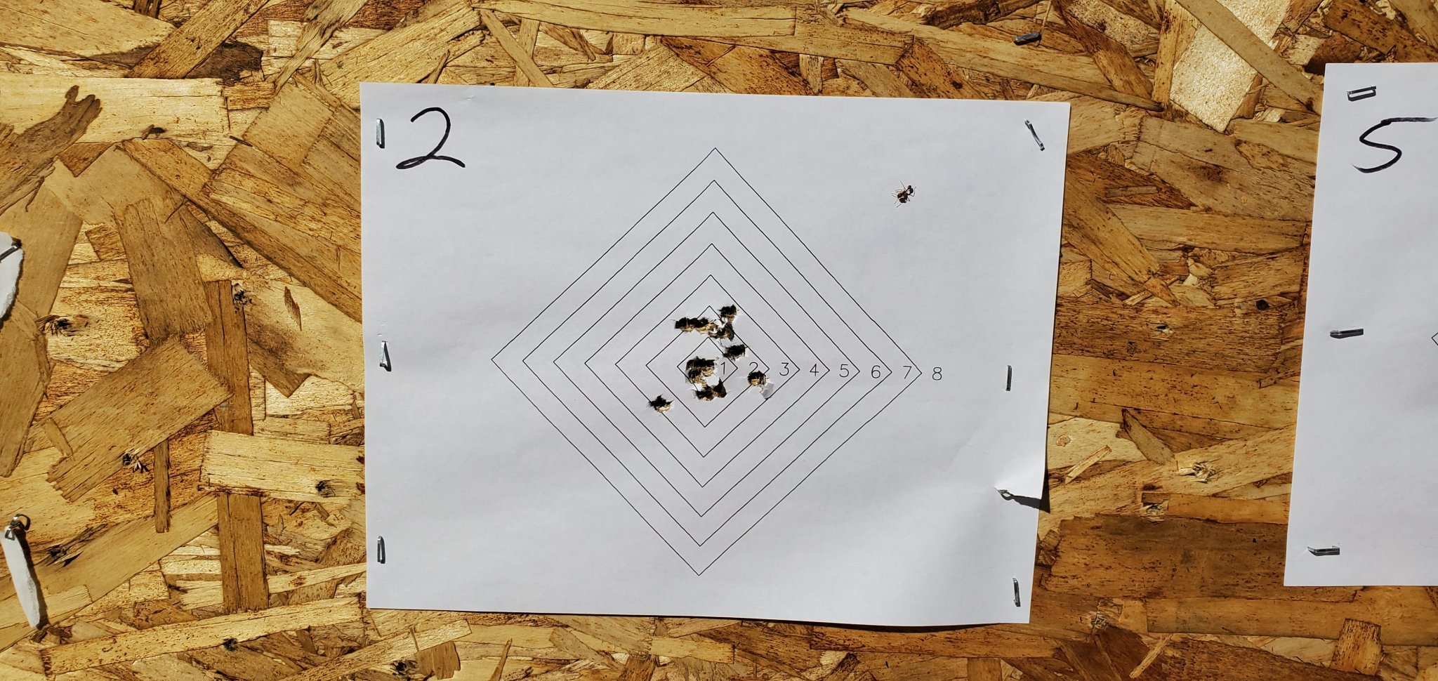

    Shot this twice this weekend. 308 suppressed trainer both times. First go around, I forgot my tripod so I improvised a mediocre low standing position. The target definitely shows it. There are a few things I noticed when shooting.
    1. I realized lately I was starting to move the rifle towards my should instead of keeping it tighter to my body centerline. I addressed this the 2nd time and recoil management was much better.
    2. I need better target backers.
    3. The target and lines were hard to see in the bright sun and snow. Kind of washed out at 12-15x. Second time I added an orange 1" sticker to the center for an aiming point. Maybe shade in each moa diamond with a different color or something for better contrast?

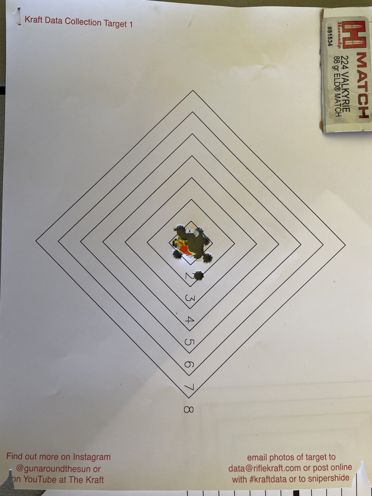

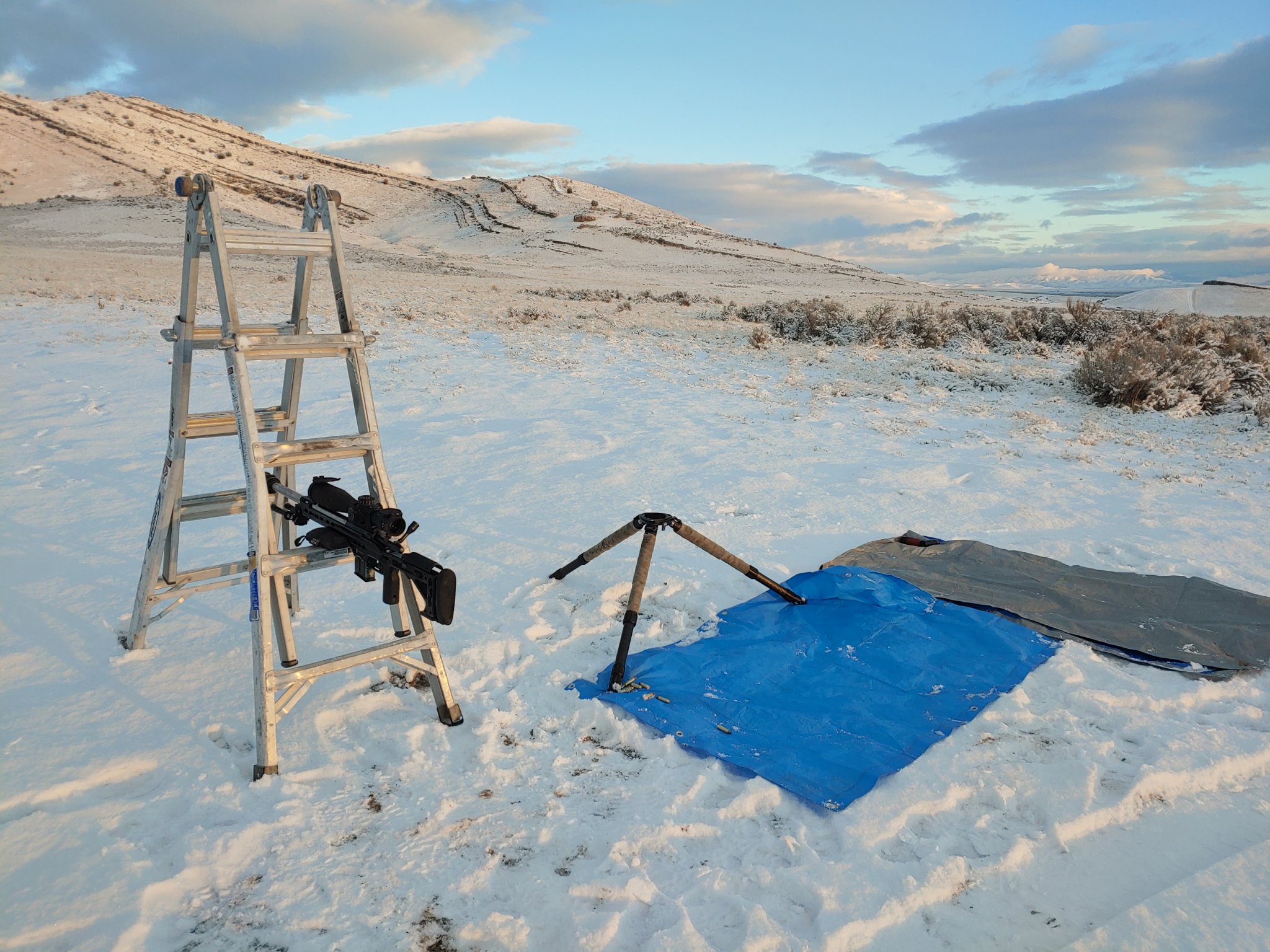

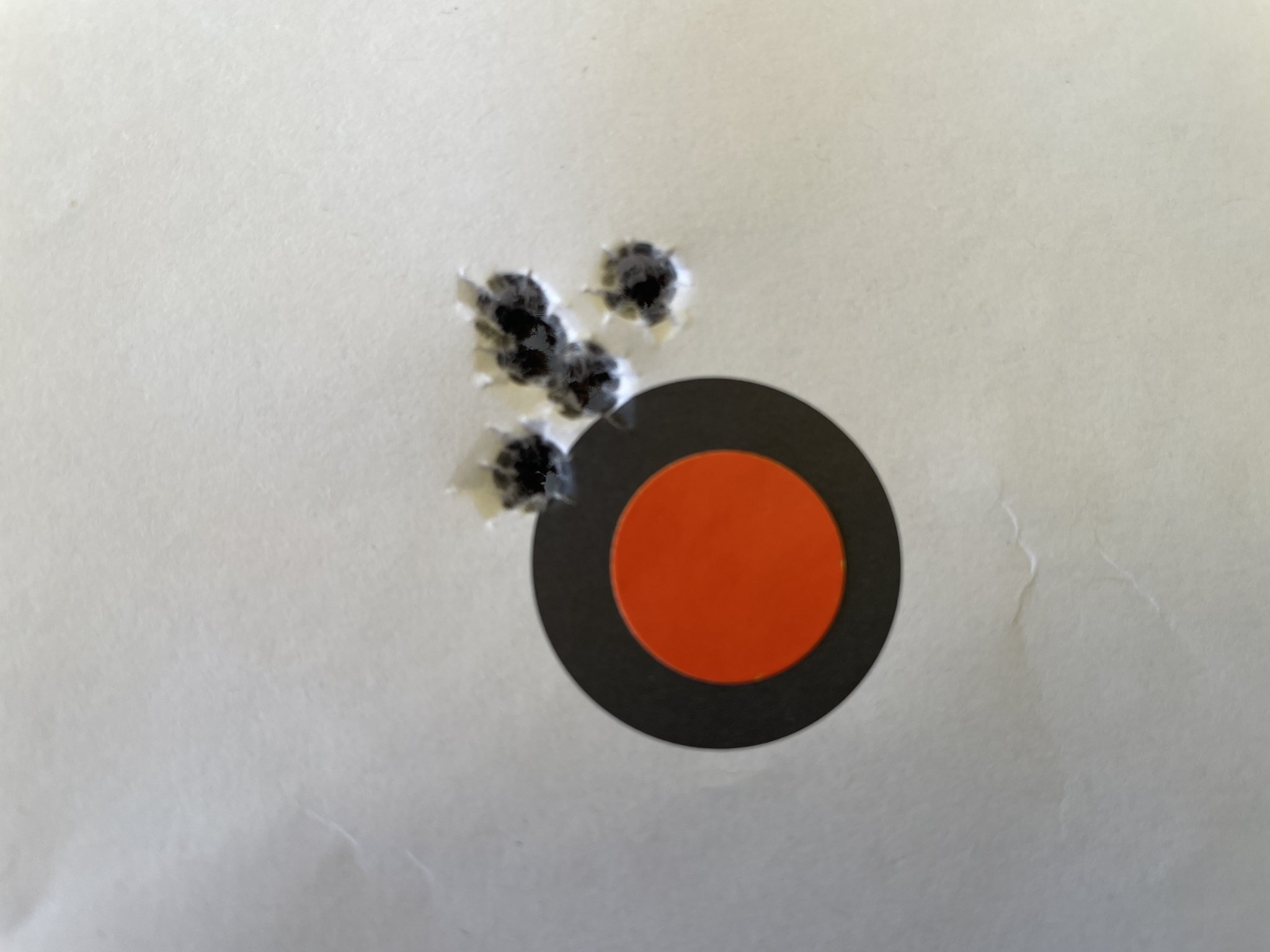

    I have a video, although one card was acting funky I hope I have all of it, when I went to review in the camera is showing an issue, not playing. I just got home I have to check it, but I have footage.
    But I didn't "run" it like a stage, I set up at each position and shot it, of course moving from one to the other as I finished, but I took my time, which was like a minute per stage if that, it was only 3 rounds. I did not rush, I built my position and shot, then moved to the next. Like I said I might have spent a minute per position.
    I have a bigger thread/article to make because I noticed something doing this, and I changed my entire zeroing and set up beforehand.
    I bought the Valkyrie with me, it was a practical rifle, AX Chassis, not a lot of extras, just a Bighorn with a LH GT Bartlein, when I first addressed the rifle I didn't like the position of the scope, it needed to come one pic back to feel really comfortable in all positions. So I moved the scope and rezeroed it with 75s. I didn't like what saw with those so I switched to 88s, and was much happier with my set up going into it.
    So from the beginning, I rezeroed the rifle with 88s at 100 yards, then I did a practice run on paper (dots, different target) and checked my zero. This is where it gets tricky:
    So in the prone, you have one zero, in the other positions you will see an offset, so I checked it. (Nobody said there was no practice) I wanted to find my balance of zero between the positions. Which I did, it's about .2 in variation is what I saw.

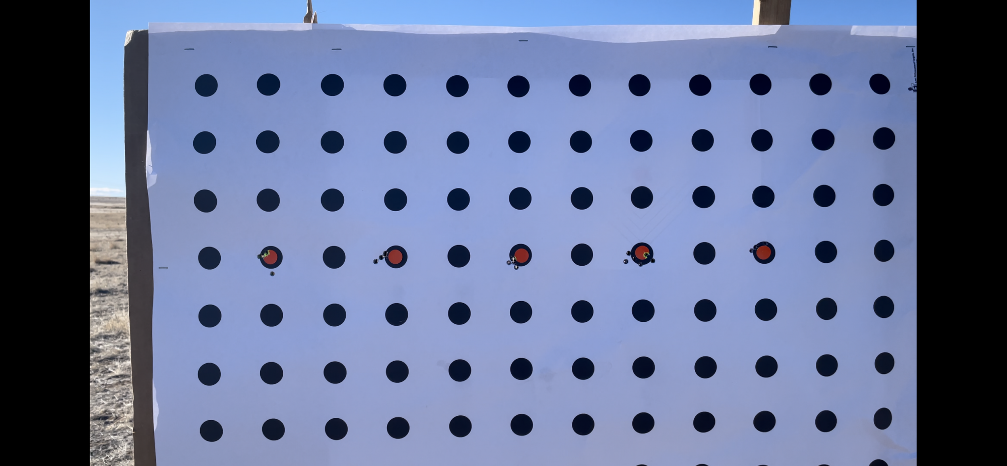

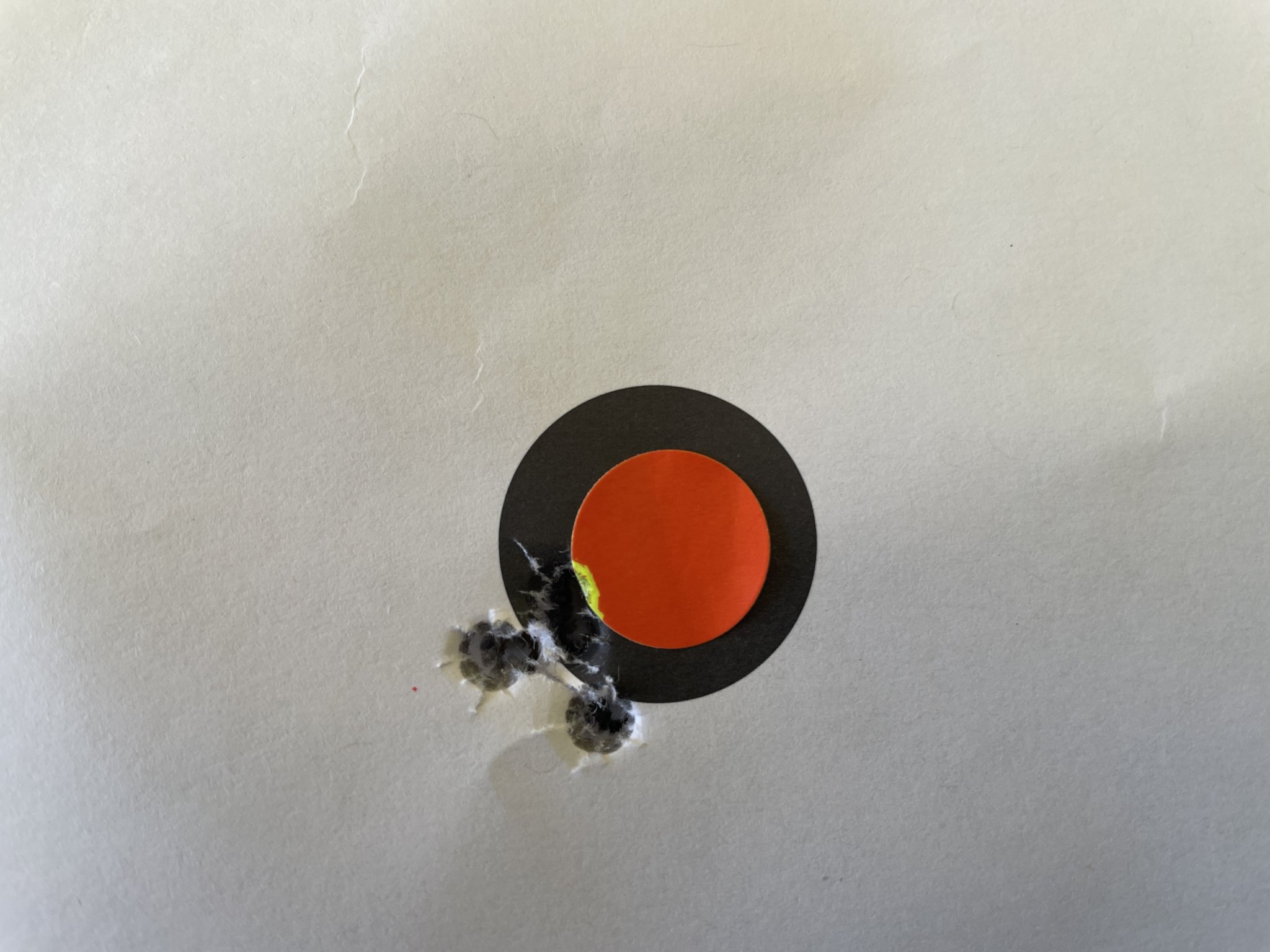

    I used this target to practice:
    if you look at the second target from the right, that had my final elevation on it. Just that little guy in the orange. I shot it for zero in the standing after this run. So the rifle was zeroed, I balanced that zero dialing up .1 from the center and it kept my shots tighter. More Precise on target. But I did take the time to establish all this, no rules against it. :)
    So you had one about .1 Low and then another about .1 High
    These are 3/4" dots with 3/8" orange pasty I stuck on it to see, (I added the same pasty to the Kraft target the aiming point was not comfortable for me, so I changed it. I needed a better aiming point, so once the floating dot hit the orange I was good. I actually did better shooting faster, breaking the instant the dot was centered.
    If you check out my target above you see one stringing right, I found my leveling base was slipping so when I shot it for the score, I had to overtighten the tripod to keep it from tossing a round which I still did. I think my 2MOA right side flyer was the Leveling base slipping there too. As a side note, when I was all finished putting everything away I noticed my suppressor was loose too, 224 probably didn't care because it was a 30 cal can on it, but it was definitely loose.
    A couple of observations:
    NPA Matters, I had to make sure I broke the center of the target with my vertical reticle. Then my horizontal was set up .5 Low as my head weights .5 Mils. So that means when I address the rifle, I rise into my target, I then back off the pressure, check the reticle position, if it does not drift left or right, I was good to start.
    I run about 75% of Full pressure behind the rifle in the alternate positions.
    So my thinking was, zero .1 Mil high of center in the prone then my positional shots will be more in line with my prone zero. I fine-tuned it by doing a single practice run then I went live the whole thing took me maybe 4 minutes. I set up the rifle up ahead of time for this.
    Basically, I settled on my zero needing to be .1 Mil high of center and .1 Mil left of center. In order to group dead center on the target as often as possible. But for sure the tripod matter, the NPA of that.
