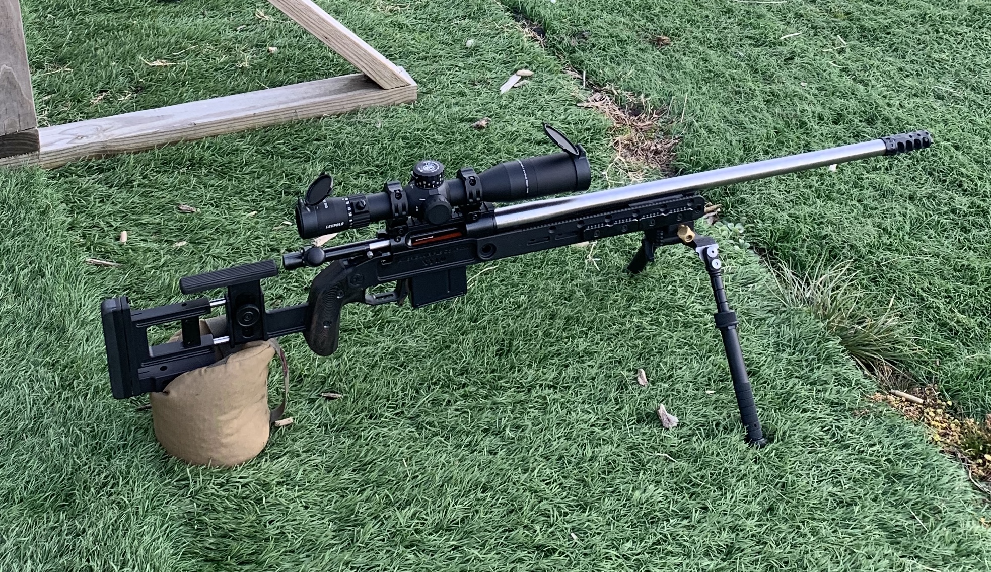

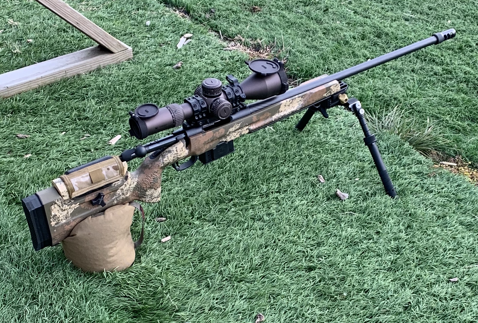

I bought the Valkyrie with me, it was a practical rifle, AX Chassis, not a lot of extras, just a Bighorn with a LH GT Bartlein, when I first addressed the rifle I didn't like the position of the scope, it needed to come one pic back to feel really comfortable in all positions. So I moved the scope and rezeroed it with 75s. I didn't like what saw with those so I switched to 88s, and was much happier with my set up going into it.

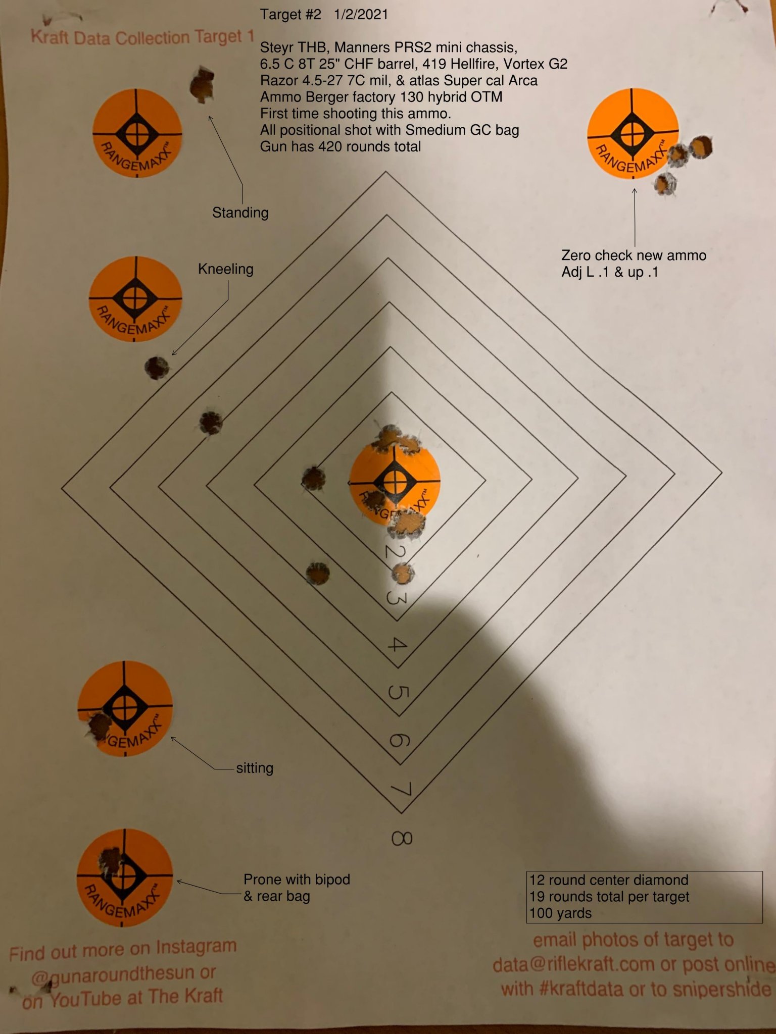

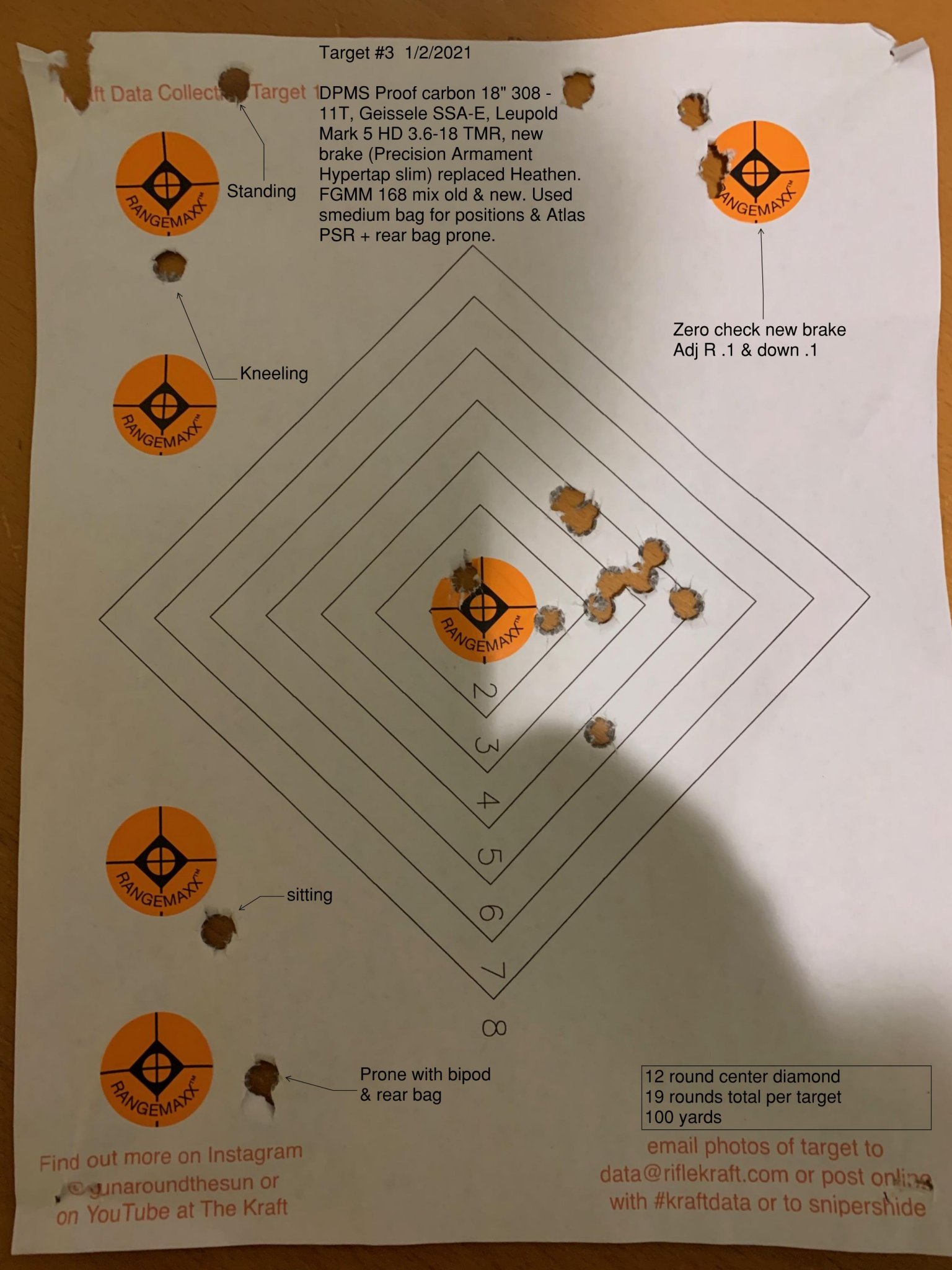

So from the beginning, I rezeroed the rifle with 88s at 100 yards, then I did a practice run on paper (dots, different target) and checked my zero. This is where it gets tricky:
So in the prone, you have one zero, in the other positions you will see an offset, so I checked it. (Nobody said there was no practice) I wanted to find my balance of zero between the positions. Which I did, it's about .2 in variation is what I saw.

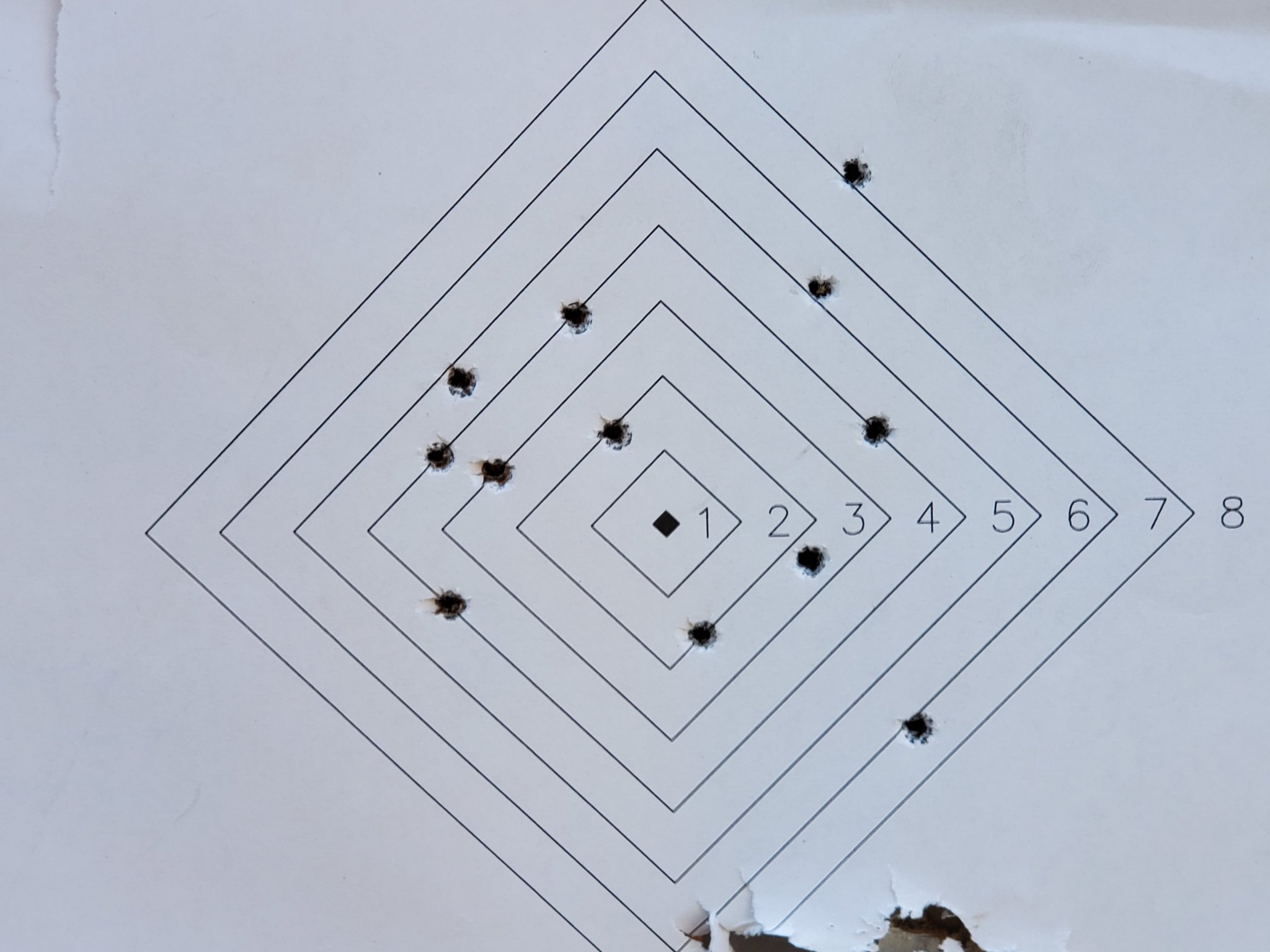

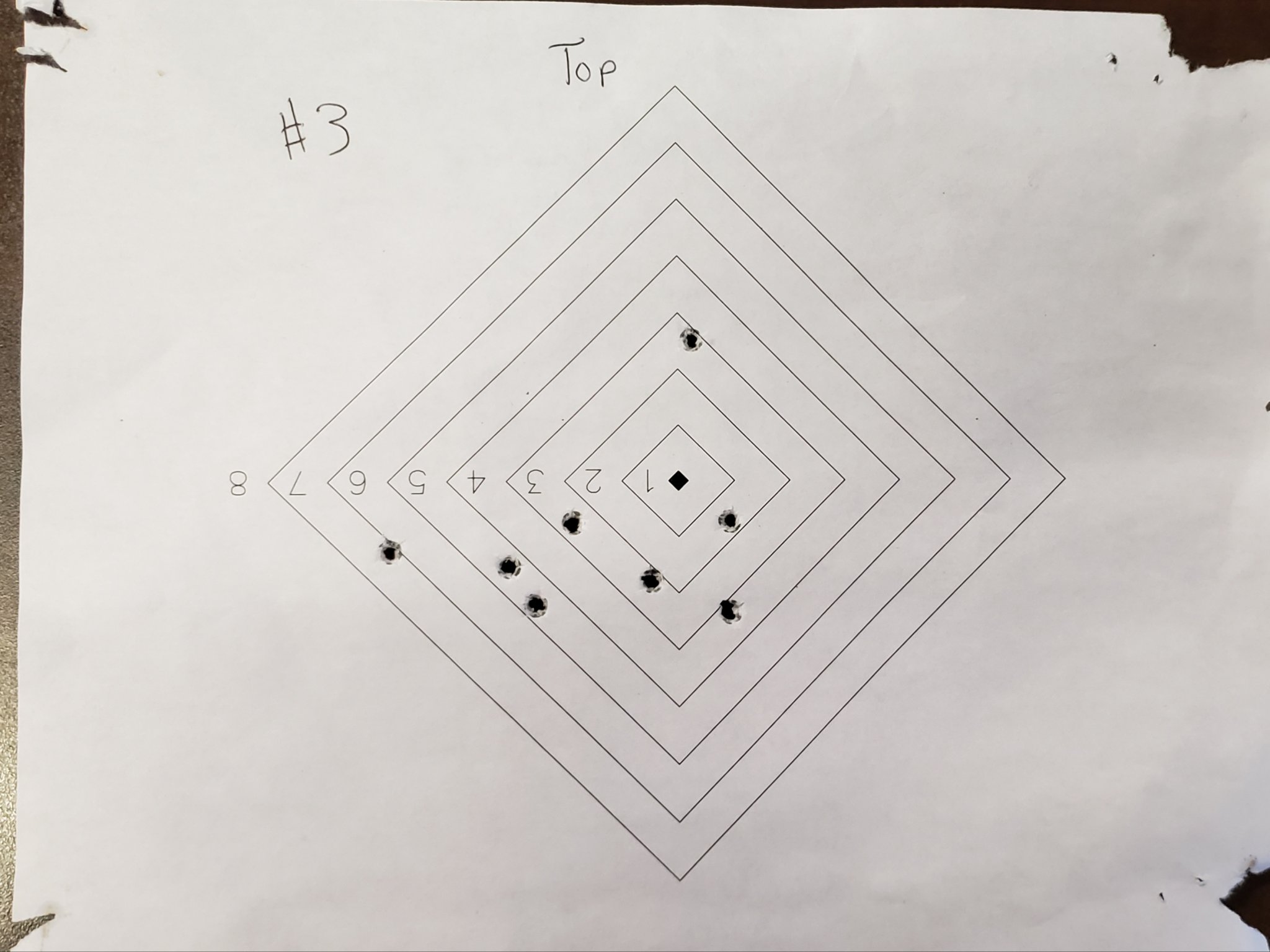

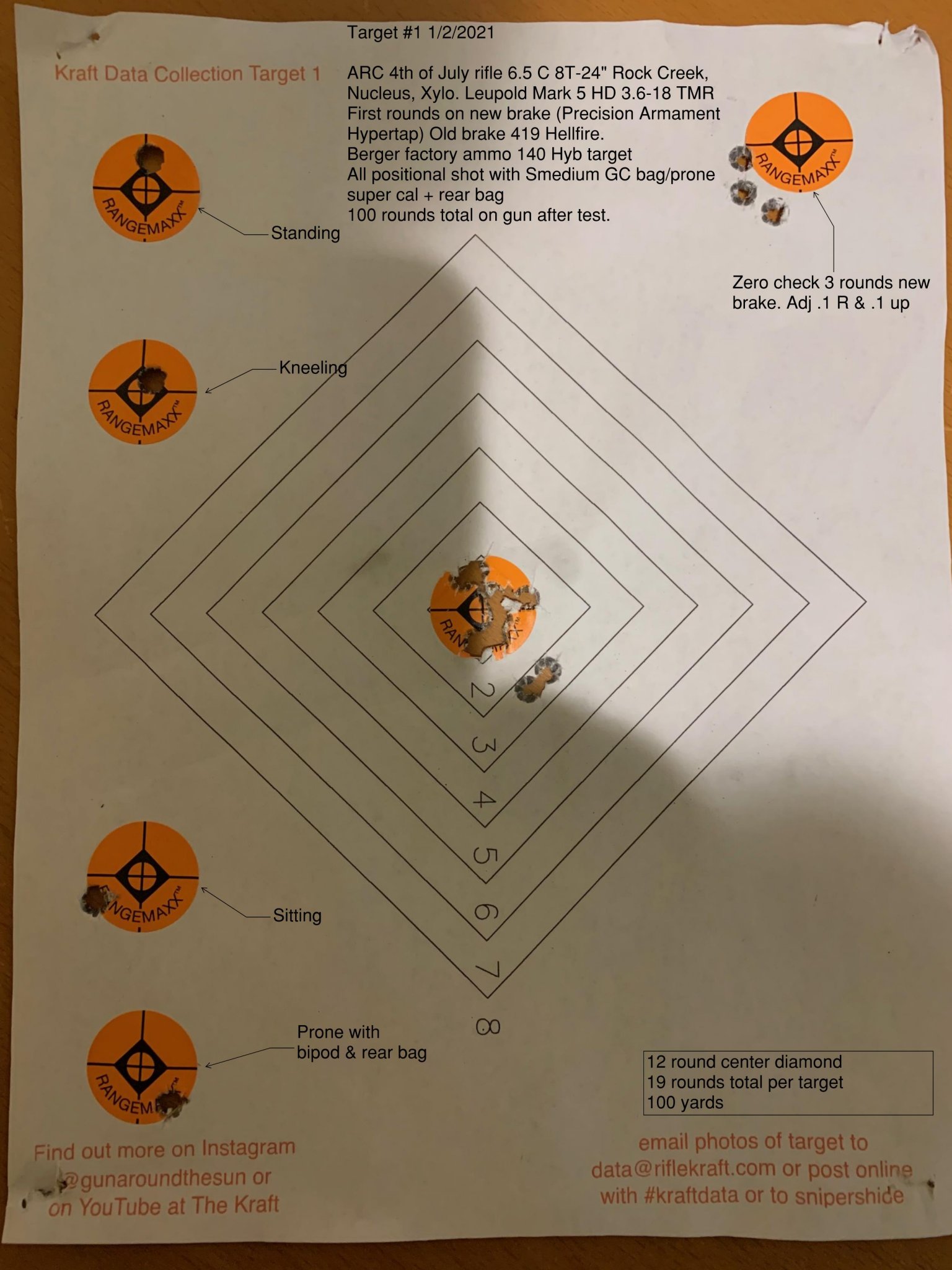

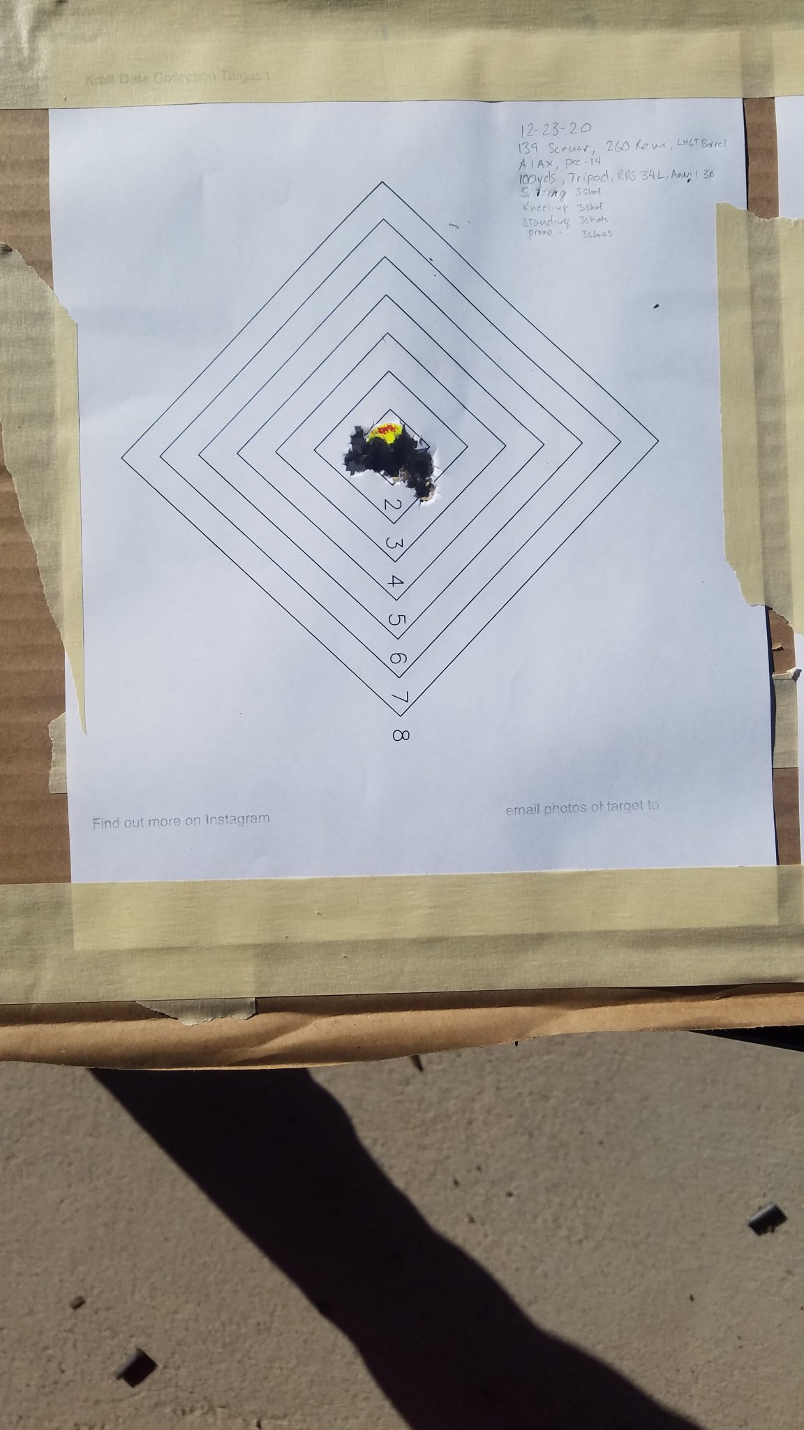

I used this target to practice:
if you look at the second target from the right, that had my final elevation on it. Just that little guy in the orange. I shot it for zero in the standing after this run. So the rifle was zeroed, I balanced that zero dialing up .1 from the center and it kept my shots tighter. More Precise on target. But I did take the time to establish all this, no rules against it. :)
So you had one about .1 Low and then another about .1 High
These are 3/4" dots with 3/8" orange pasty I stuck on it to see, (I added the same pasty to the Kraft target the aiming point was not comfortable for me, so I changed it. I needed a better aiming point, so once the floating dot hit the orange I was good. I actually did better shooting faster, breaking the instant the dot was centered.
If you check out my target above you see one stringing right, I found my leveling base was slipping so when I shot it for the score, I had to overtighten the tripod to keep it from tossing a round which I still did. I think my 2MOA right side flyer was the Leveling base slipping there too. As a side note, when I was all finished putting everything away I noticed my suppressor was loose too, 224 probably didn't care because it was a 30 cal can on it, but it was definitely loose.
A couple of observations:
NPA Matters, I had to make sure I broke the center of the target with my vertical reticle. Then my horizontal was set up .5 Low as my head weights .5 Mils. So that means when I address the rifle, I rise into my target, I then back off the pressure, check the reticle position, if it does not drift left or right, I was good to start.
I run about 75% of Full pressure behind the rifle in the alternate positions.
So my thinking was, zero .1 Mil high of center in the prone then my positional shots will be more in line with my prone zero. I fine-tuned it by doing a single practice run then I went live the whole thing took me maybe 4 minutes. I set up the rifle up ahead of time for this.
Basically, I settled on my zero needing to be .1 Mil high of center and .1 Mil left of center. In order to group dead center on the target as often as possible. But for sure the tripod matter, the NPA of that.

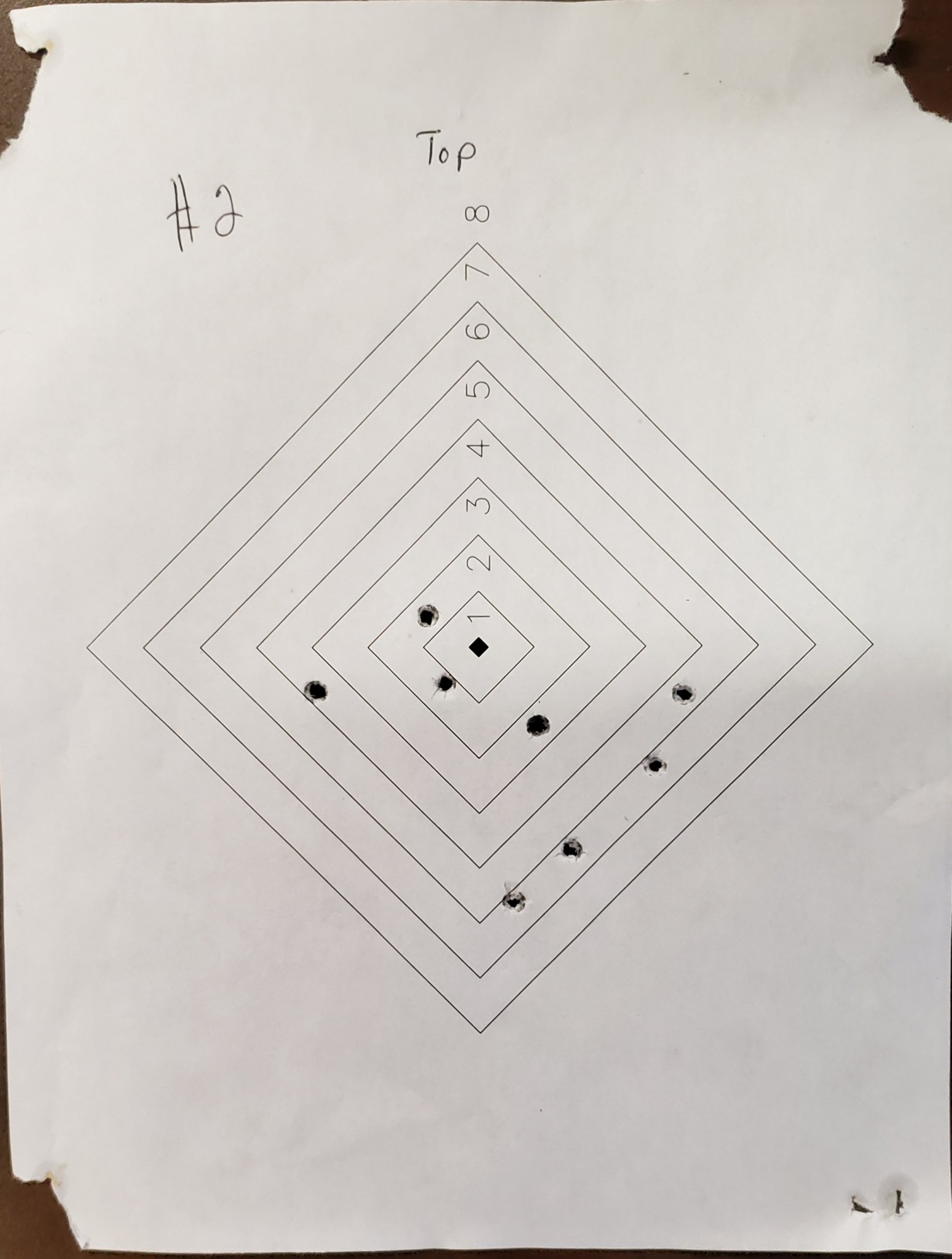

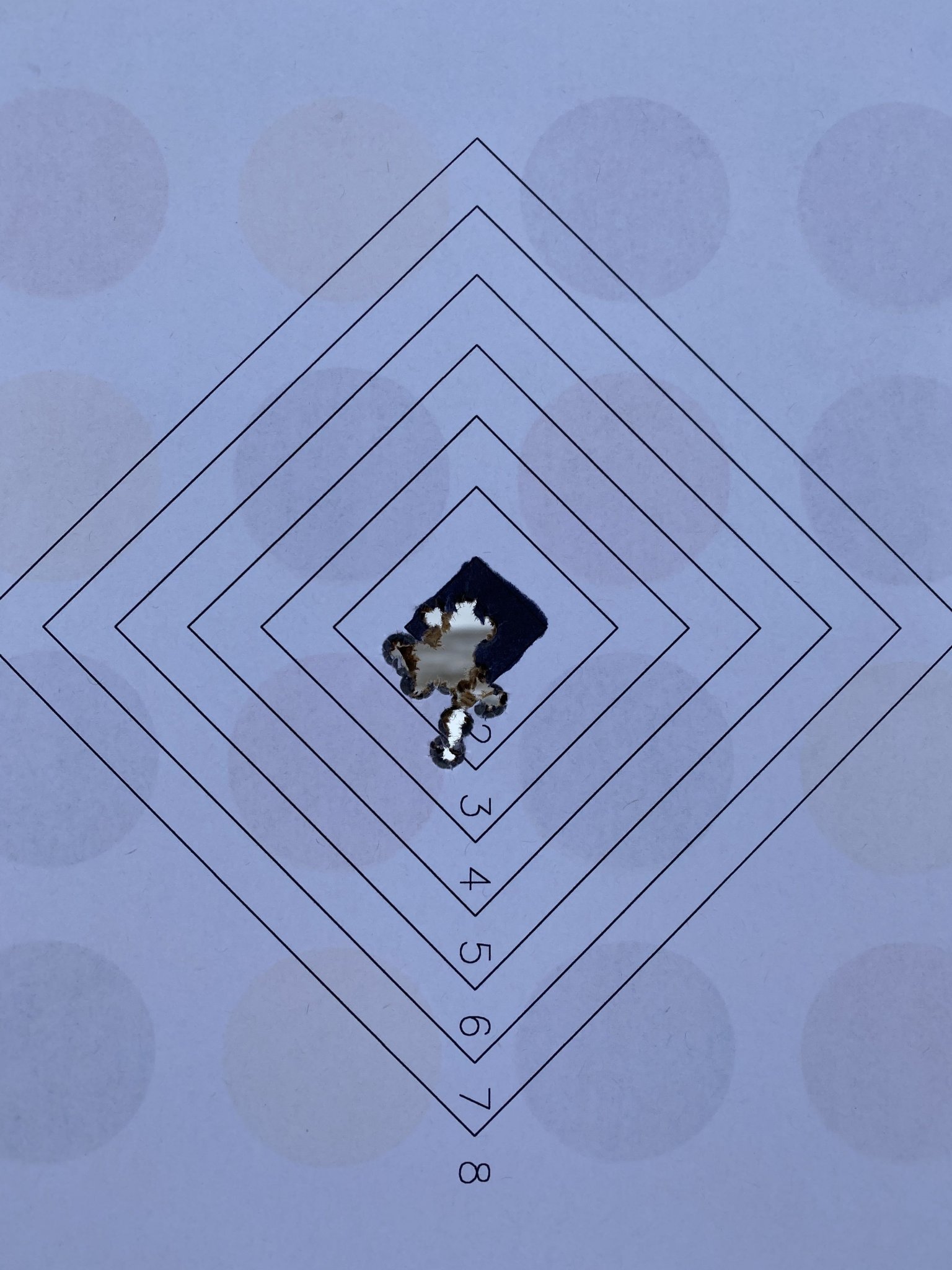

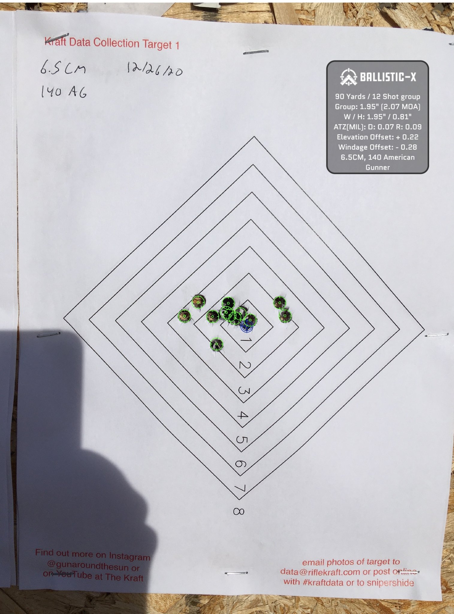

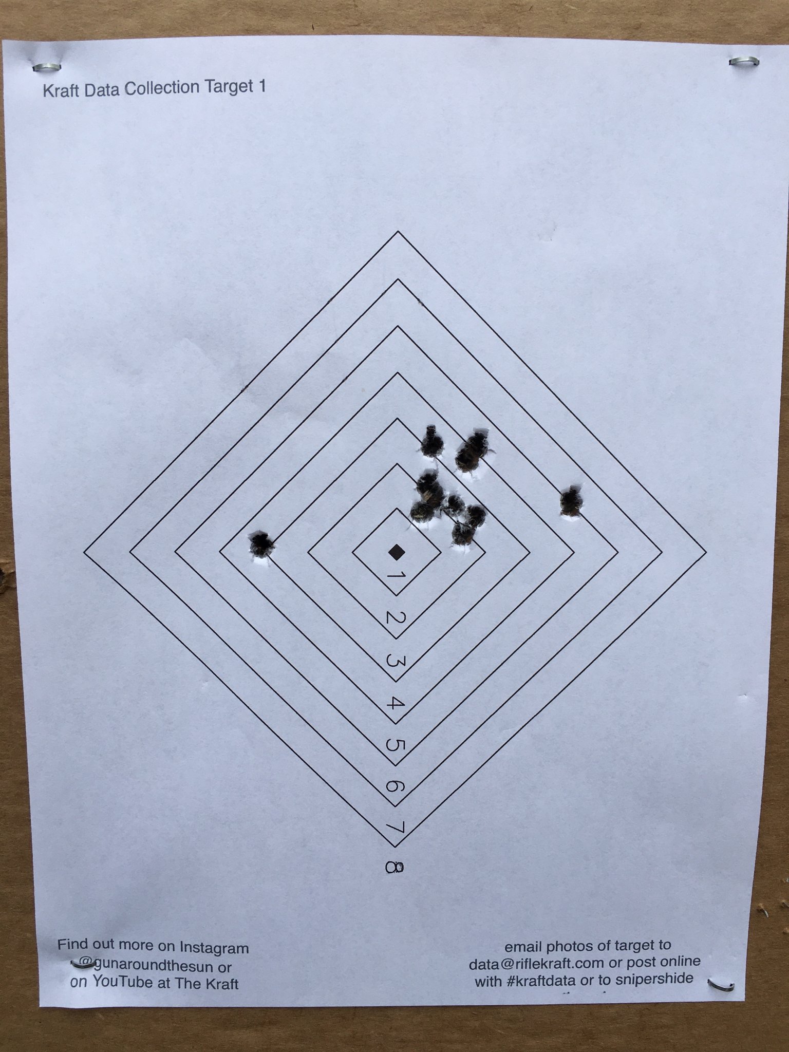

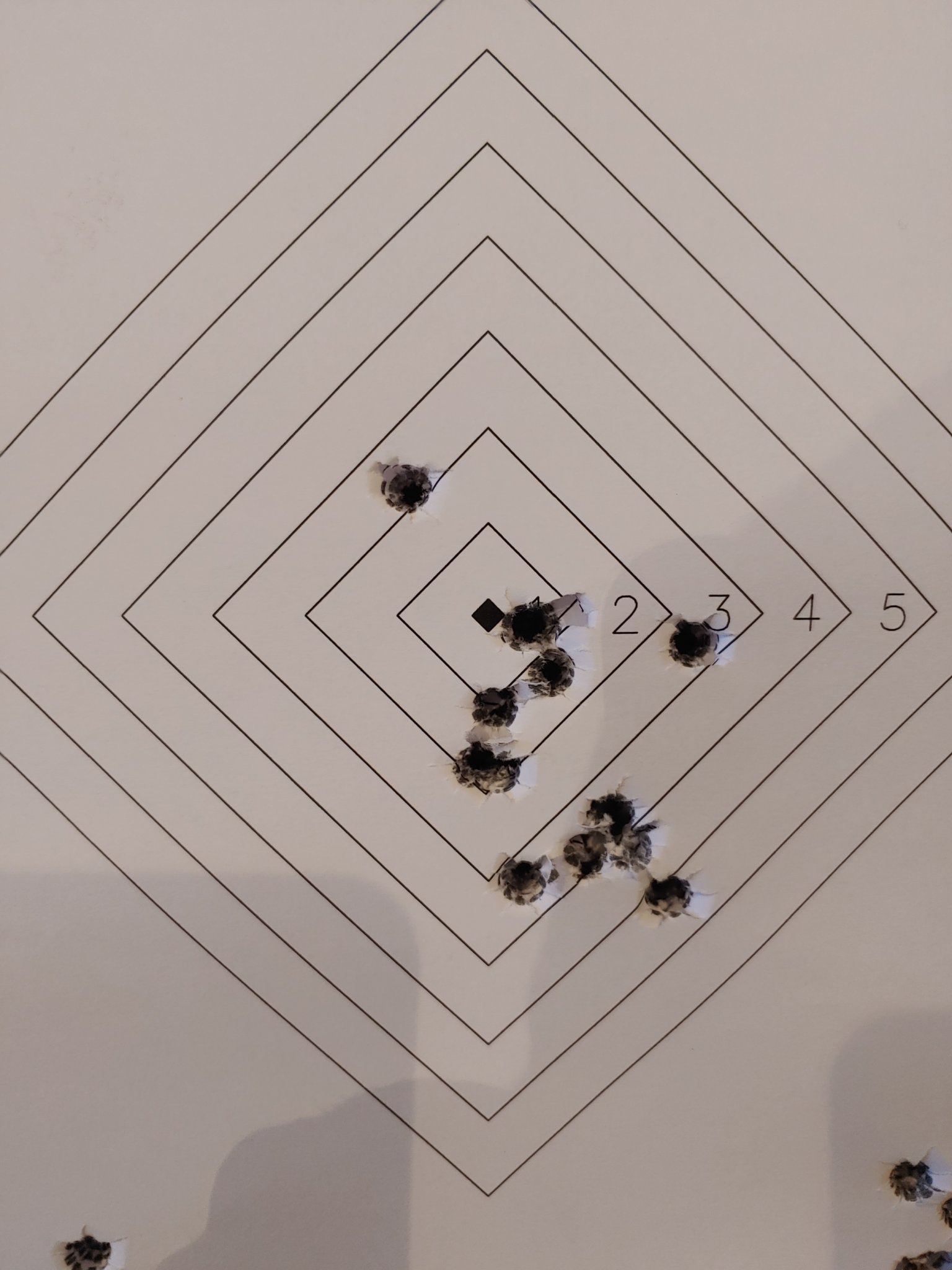

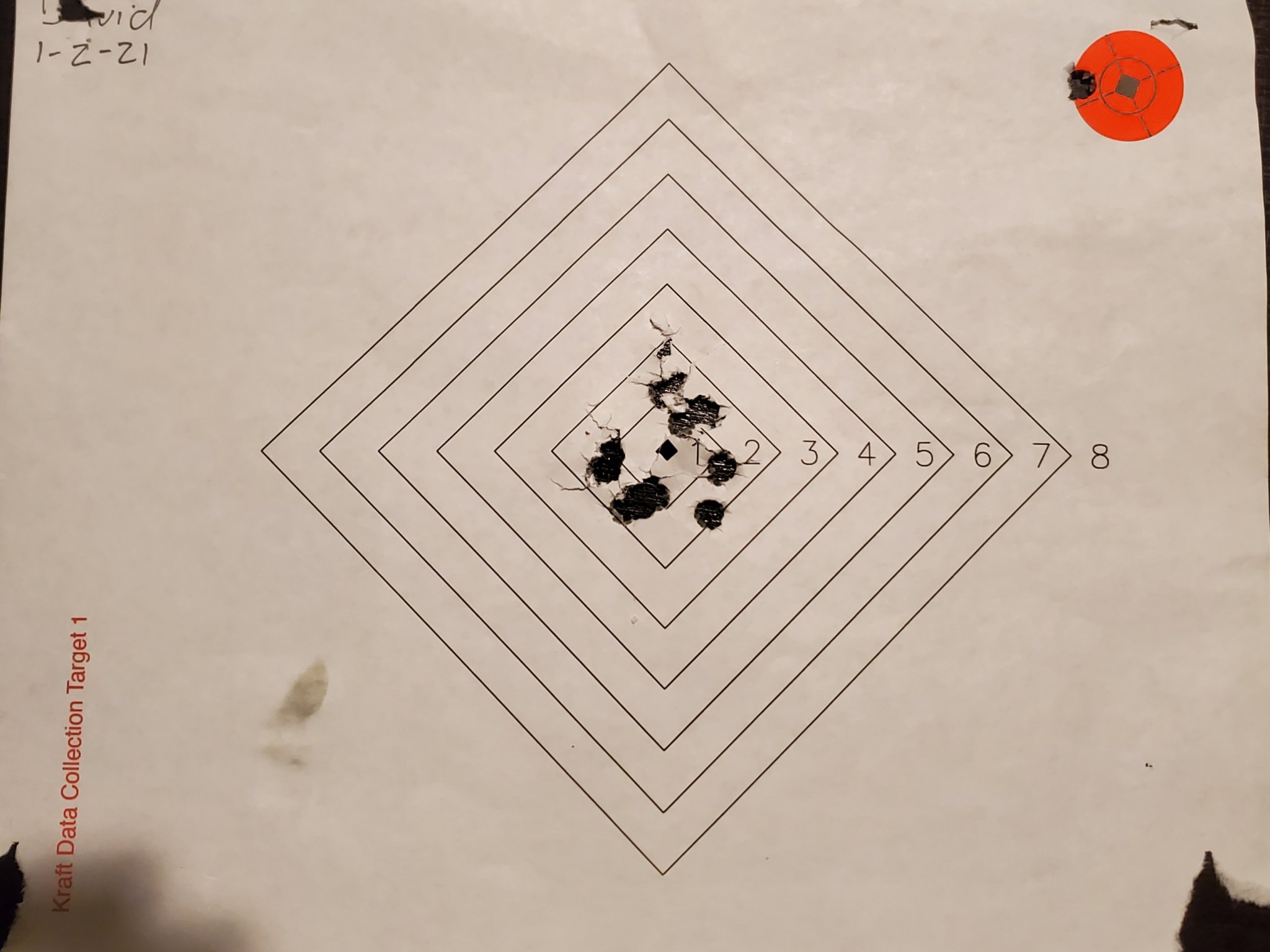

Took some of Frank's advice and re-zeroed rifle to impact high by .2 since I tend to track low and left shooting in positional and checked zero in a sitting position on a tripod ( right group). Left group is prone, 3-shots each16087569373078801894728951246669.jpg
Then went and shot the diamond and took my time. Definitely better than I was expecting and will have to try it again with a time stressors
Edited; Noticed that I will have to move scope back some when shooting on 25× while i was shooting this drill.

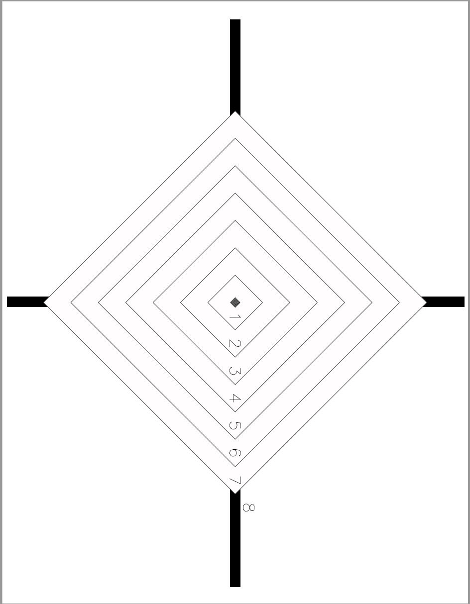

  • TestGroup Diamond Target Bars.pdf

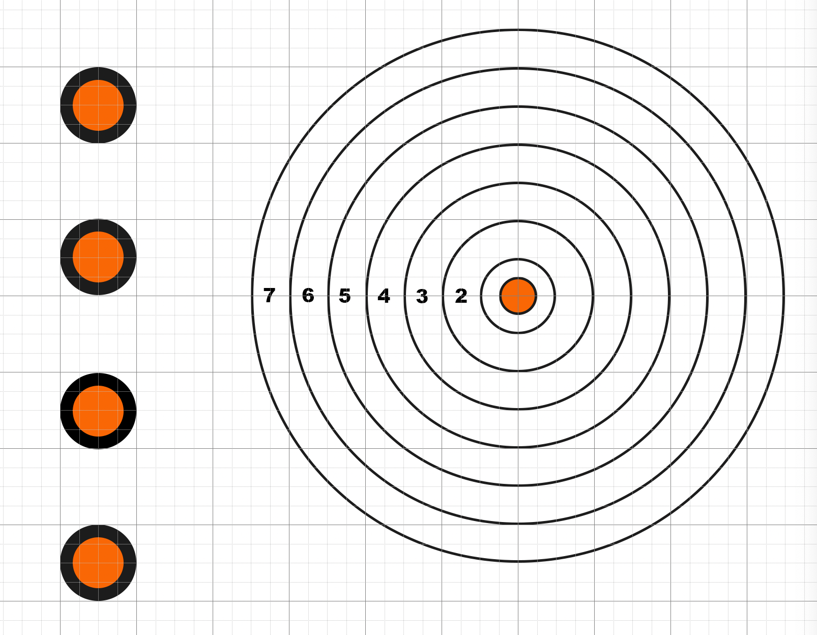

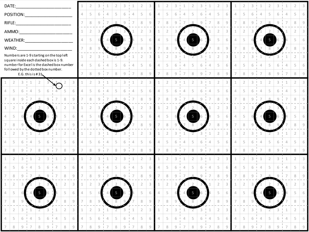

Started playing with this tonight, my line tool is not working, fucking Adobe, but anyway
It's easier for me to do circles vs the Diamonds but I was just playing around with this ... I was gonna add reference lines but photoshop has an issue with this version, so no lines for you.
Nice, do you have Adobe Illustrator? It all way easier in ai

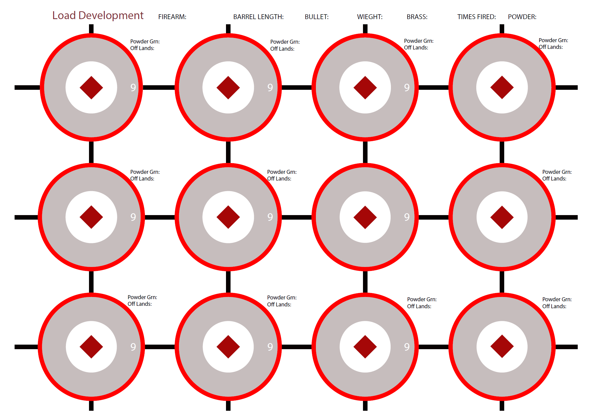

Here is what I use for load dev and paper practice at 100. If I am shooting positional, I don't use every target, I give myself some space.
I get this is not the same thing, just a way to practice a lot of groups/positions with one piece of printed paper. White is 1MOA gray is 2MOA

I have shot paper drills to look for weaknesses for some time now but I have always done it for a here and now test with no way to look at combined data or data over time.
This whole thread really got me thinking about what is possible if you have a way to store the data. So I created a excel workbook for myself to track POI. I did it as a simple one so it works on a phone but on a computer you could really break the data down.... I'm all ears.
I just put in random numbers to show how it works. Hope this weekend to put it to real use.

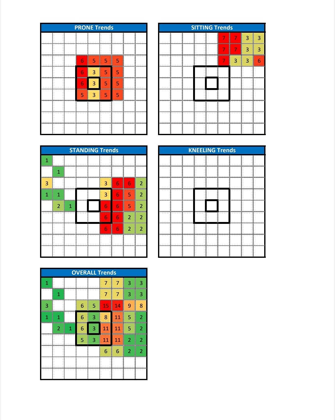

View attachment 7510227 View attachment 7510226
This has a lot of potential!
I like that a lot using the grid to plot them down to the 1/4” square

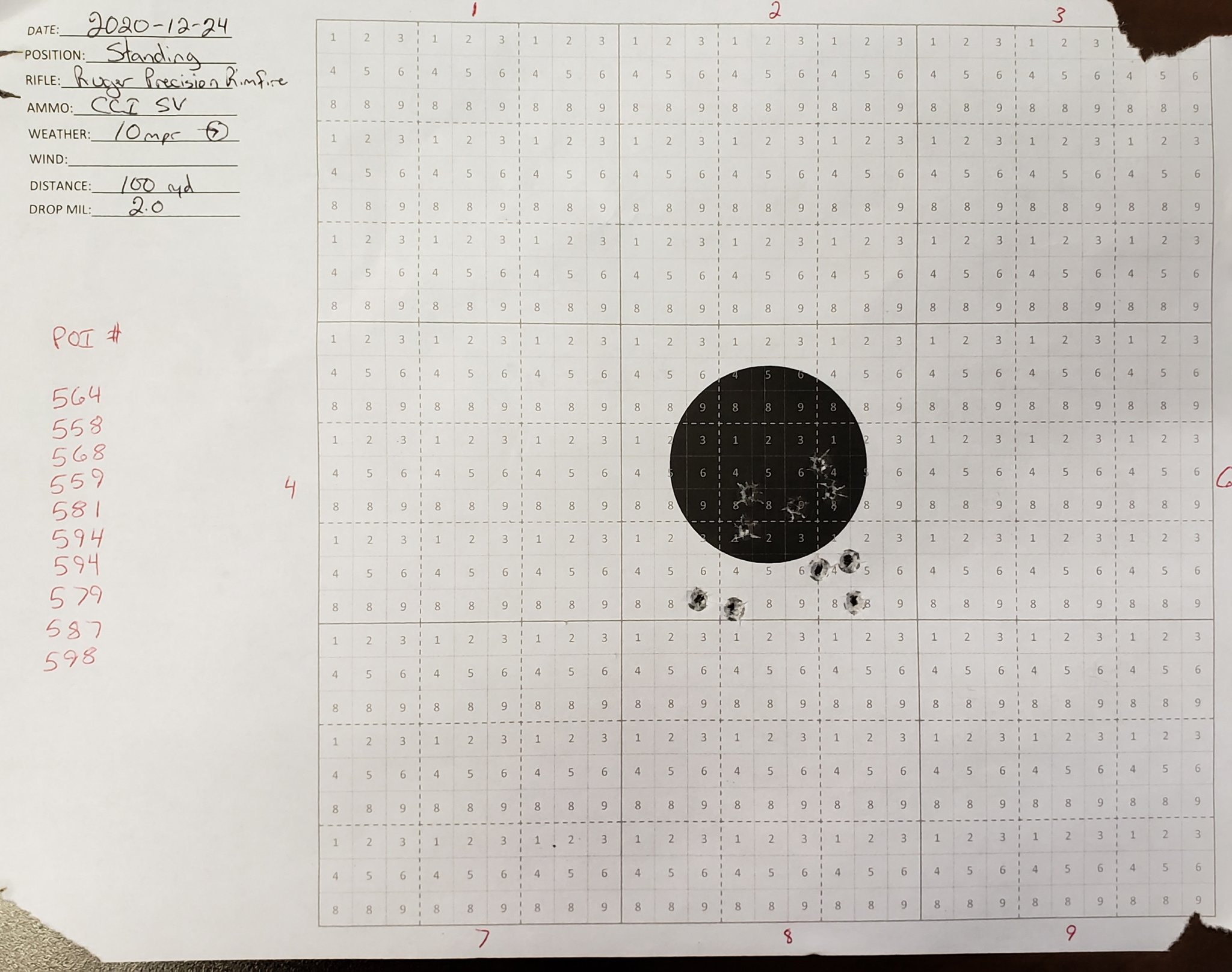

I created this for rimfire at 50 yards. One question i have is if you do 100 yard how fine of grid would be useful? If doing a 8" target with 0.3" grid it can be done with a 3 digit number. Otherwise have to go to a 4 digit.
Don’t forget you need to clearly and easily lock up and index on the targets even with 10-12x to be super valuable. As hunting scopes or the guy that shoots those powers when positional.
We use pattern recognition all the time, we can identify if you string vertically or horizontally what you are doing, this might be a nice visual diagnostic.

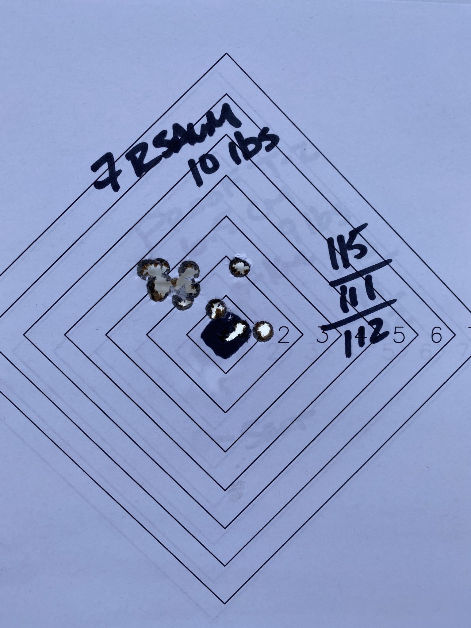

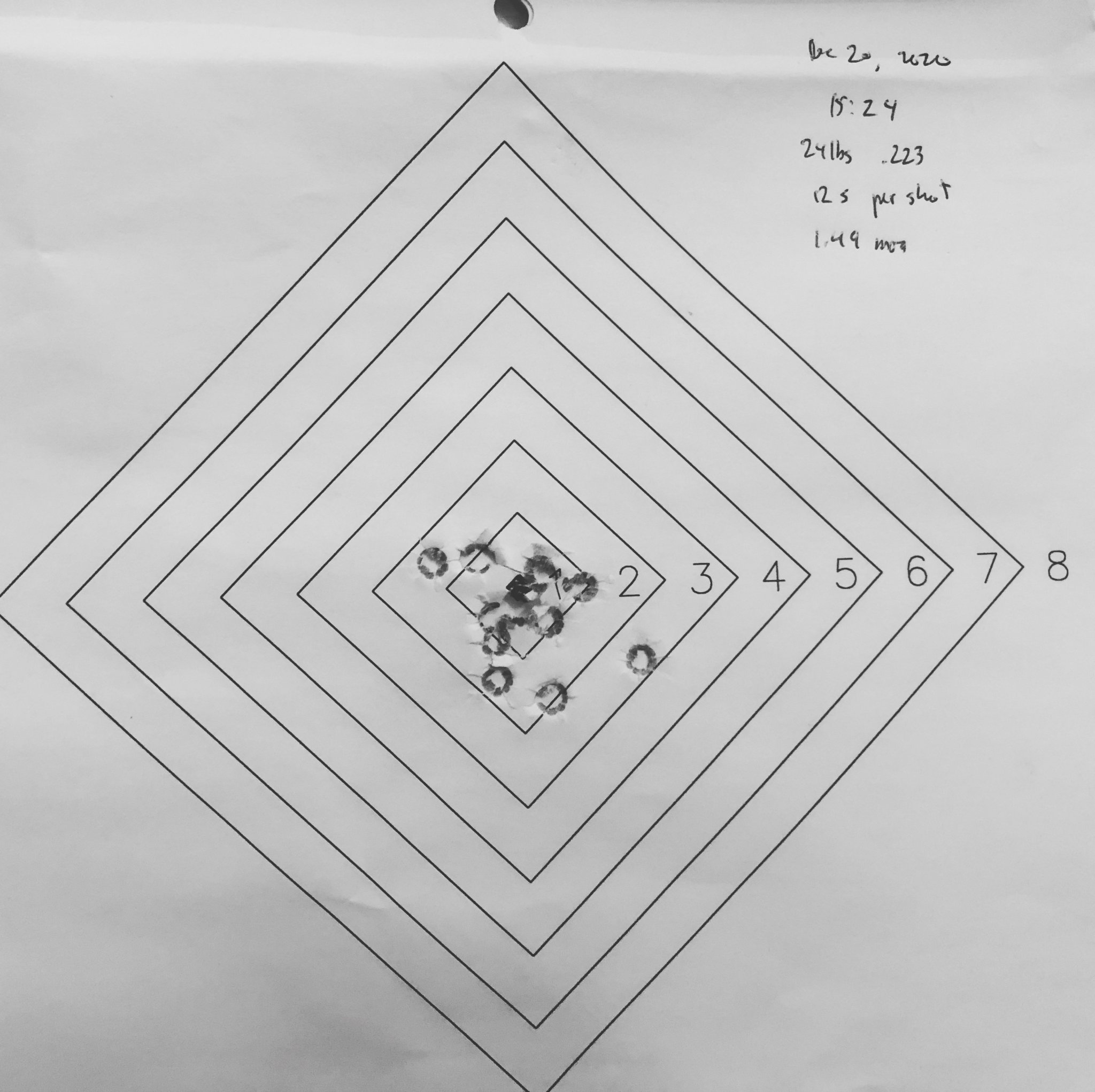

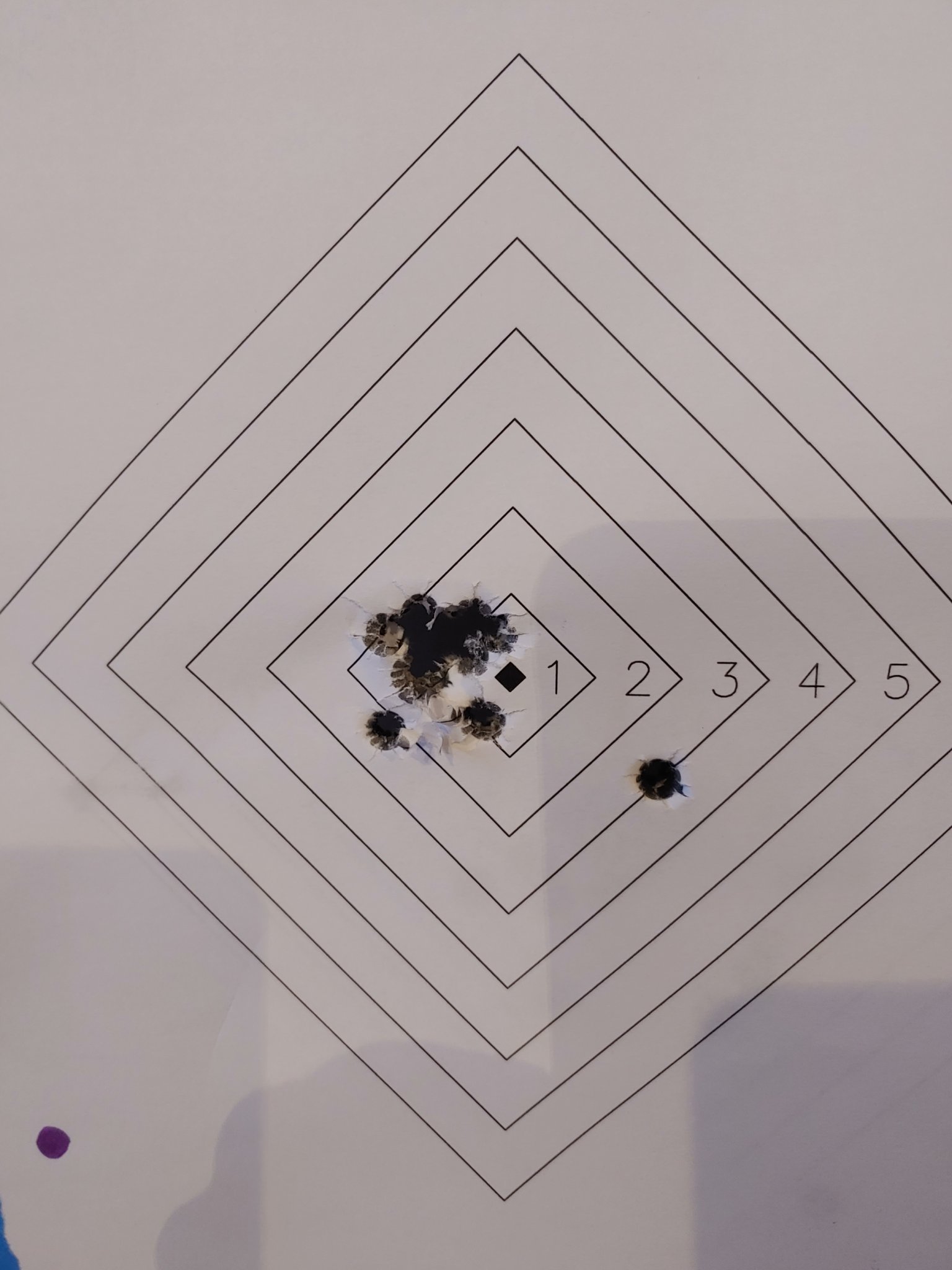

I shot this as a drill, 12s per position, using only a heavy fill pint size Gamechanger, standing, kneeling, seated, prone then repeat x3. The one shot in the "3" ring was the 1st shot standing, which was the first shot of positional shooting in over a month so that's my excuse, haha. I shoulda used a pasty in the middle as Frank did since I found the target quite hard to resolve (was late in the afternoon and. bit of fog didn't help) and ended up shooting it at 25X (whereas I usually shoot around 13X) but I thought that was part of the challenge. In all honesty I ended up using my 2nd bullet hole as my point of aim as it was more evident than the centre diamond.

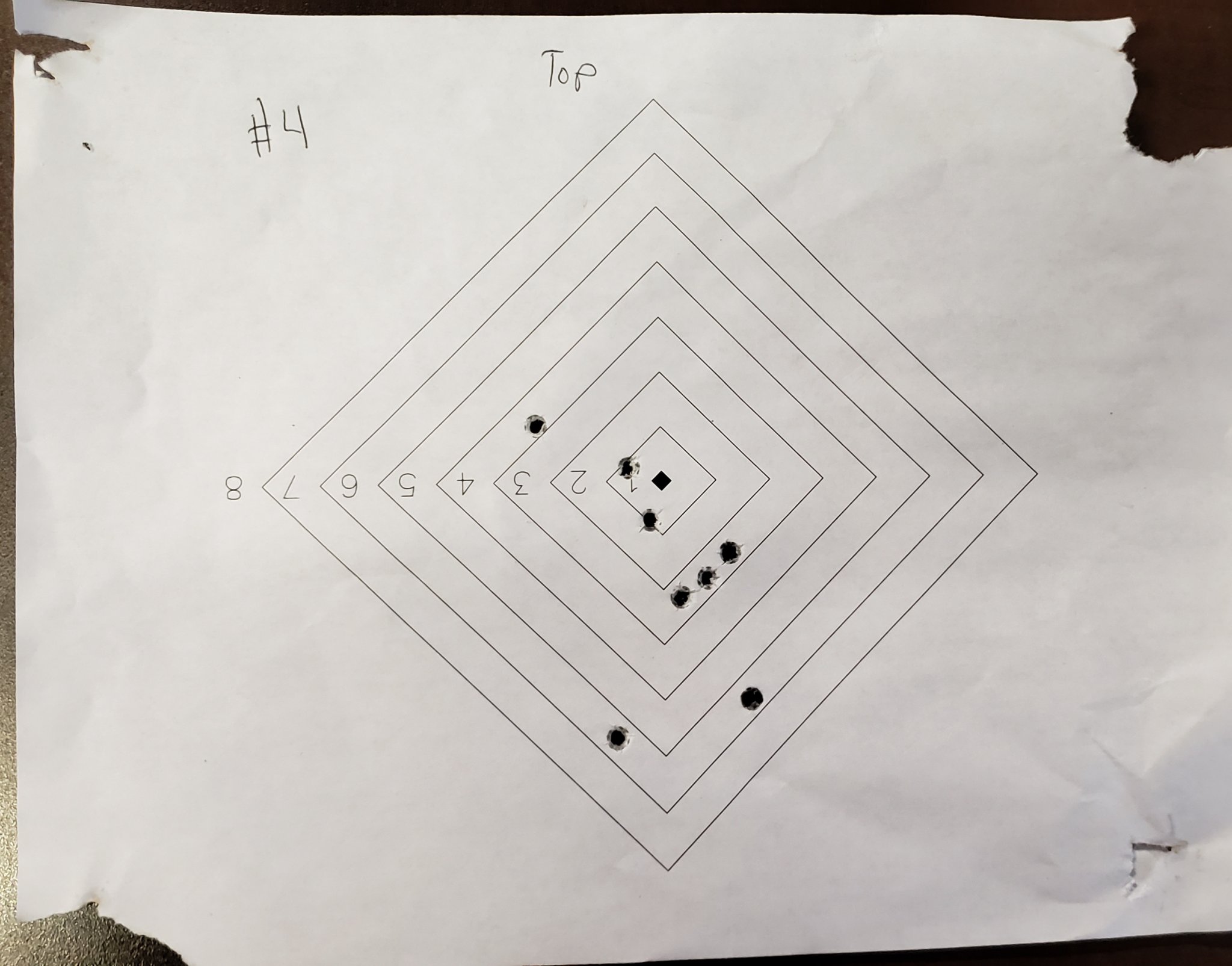

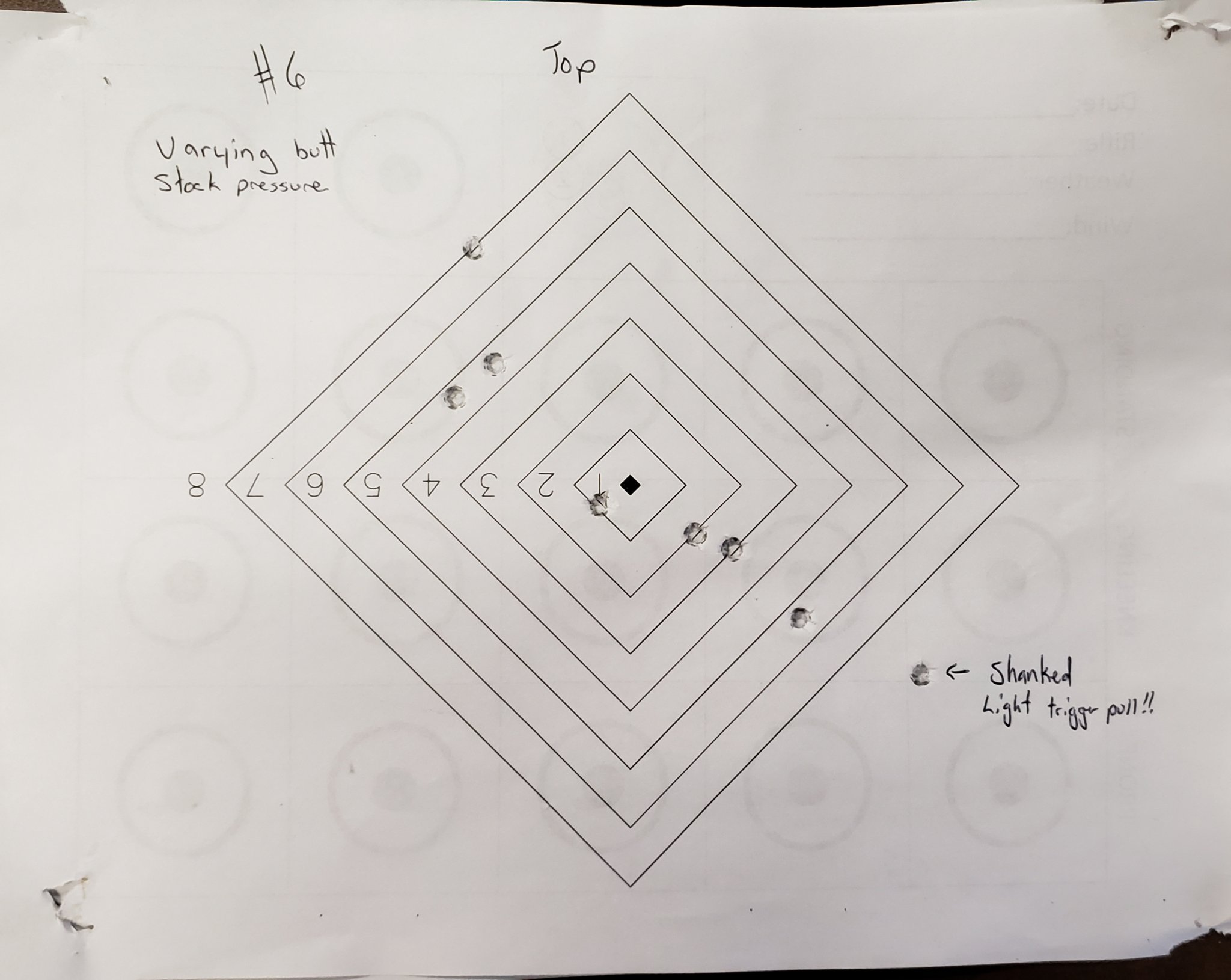

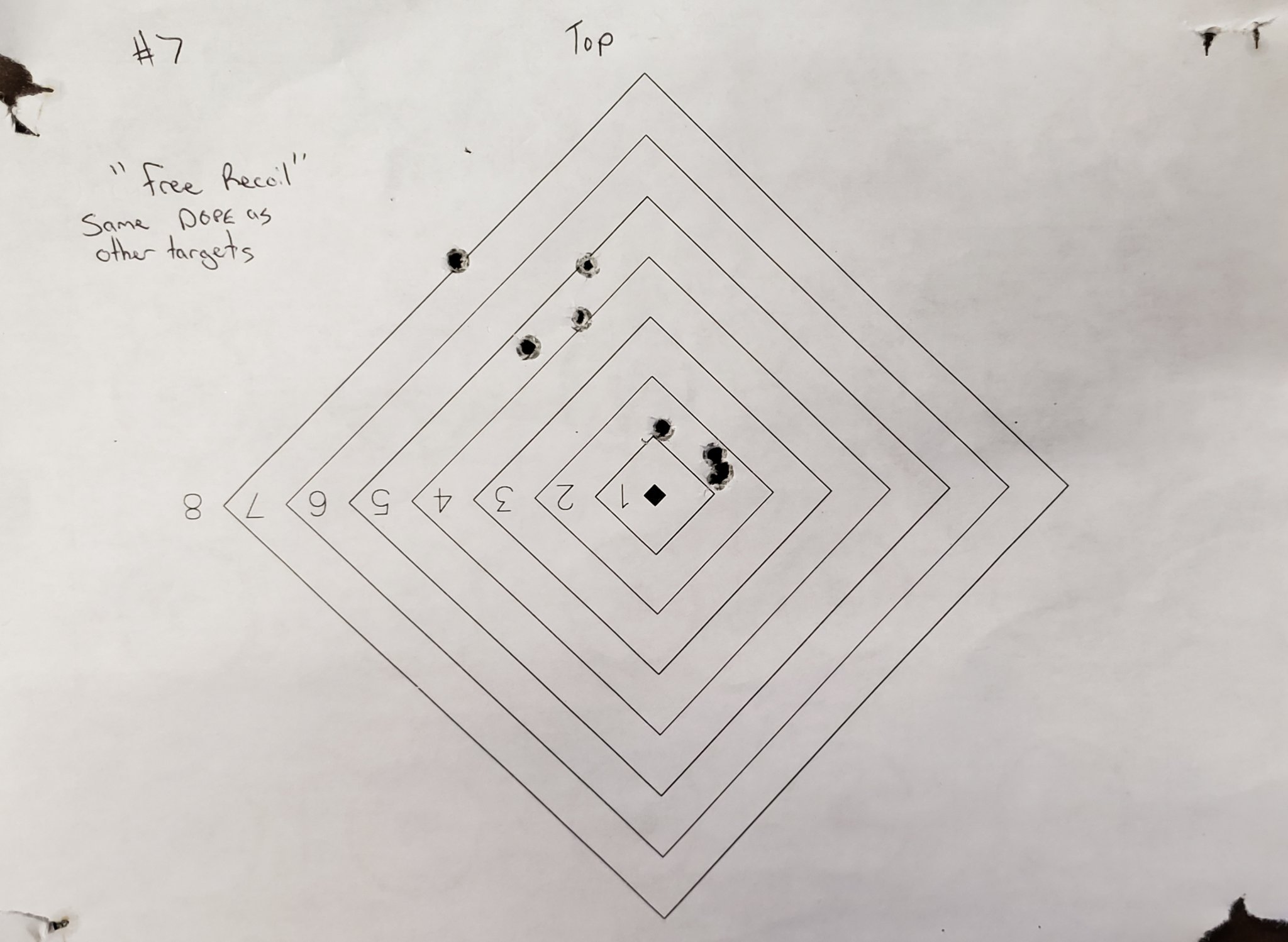

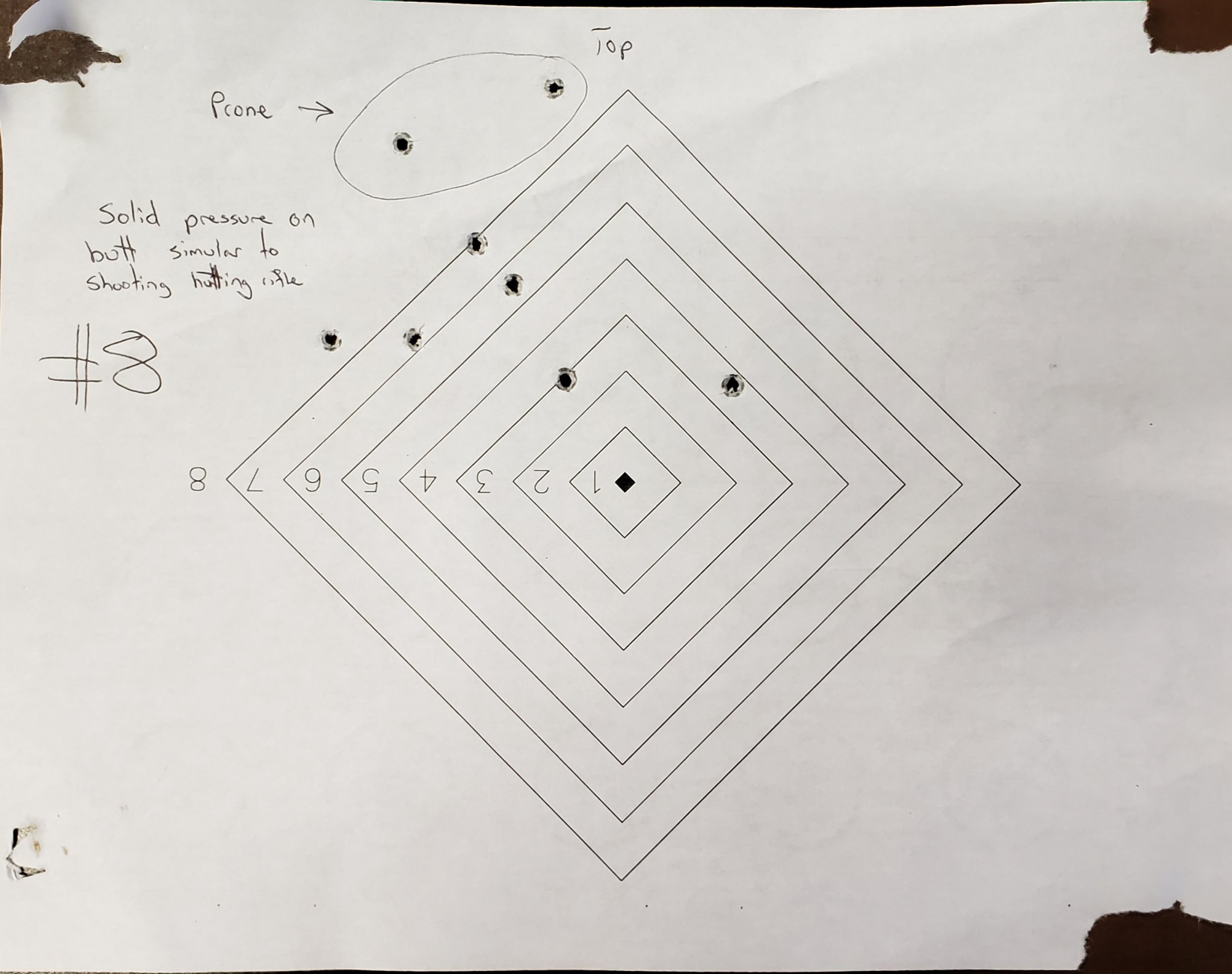

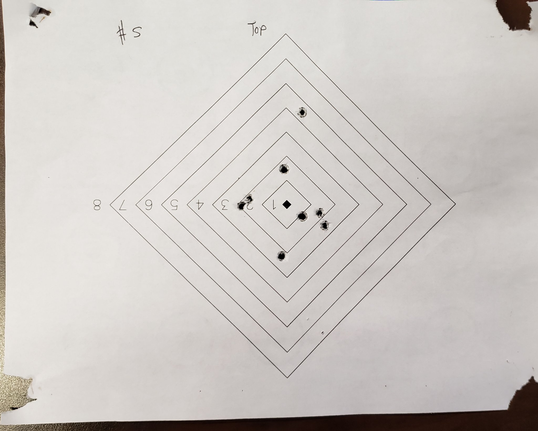

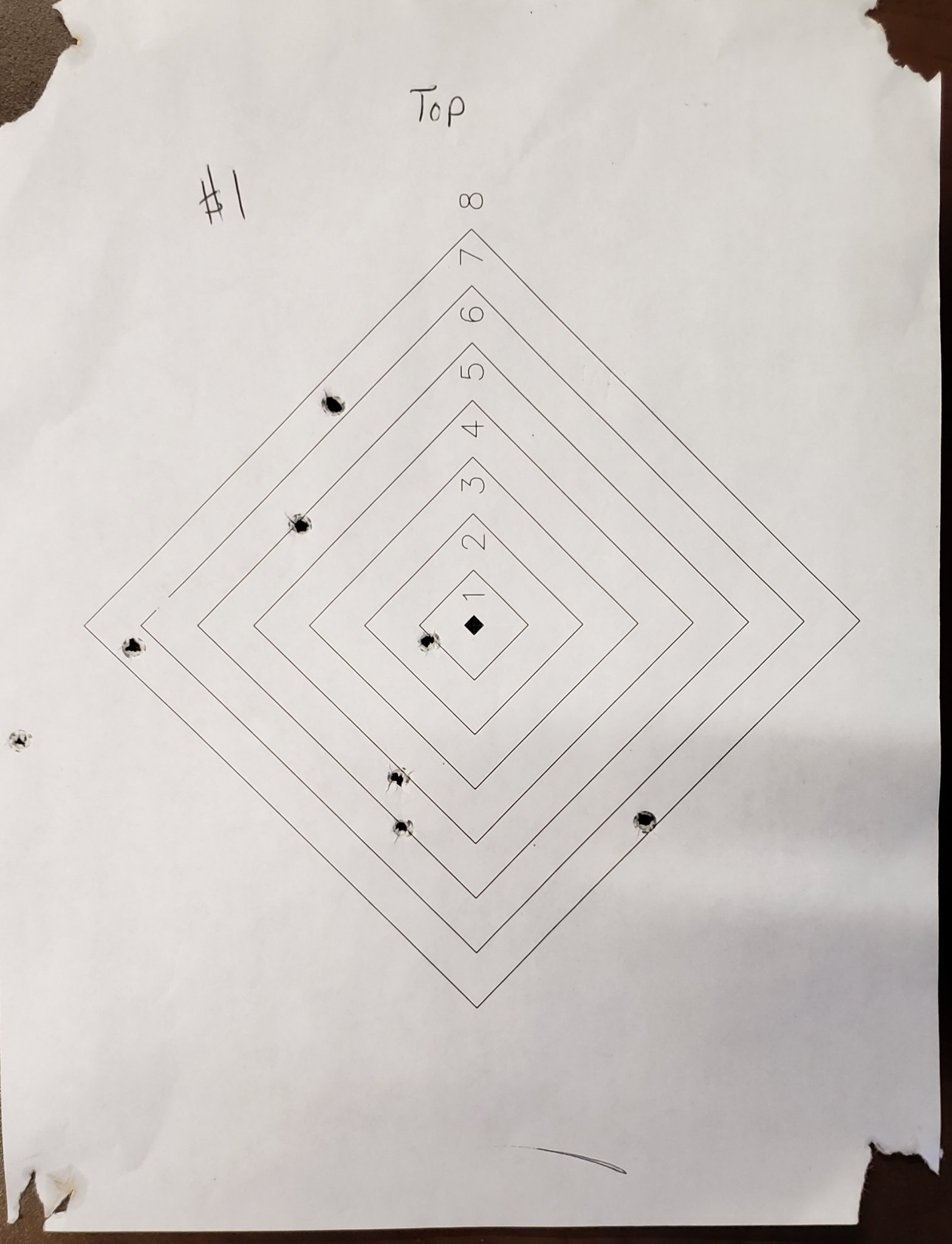

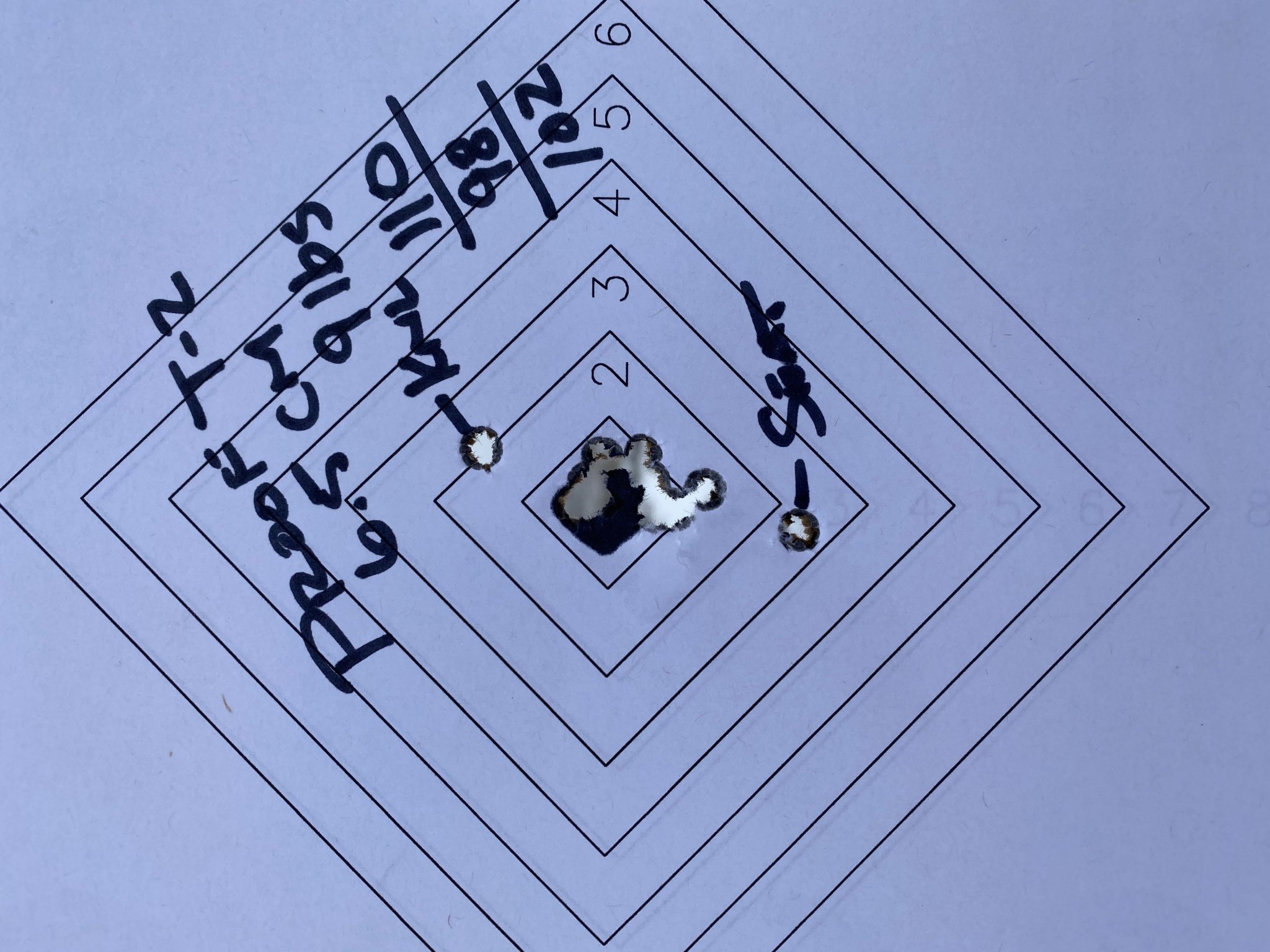

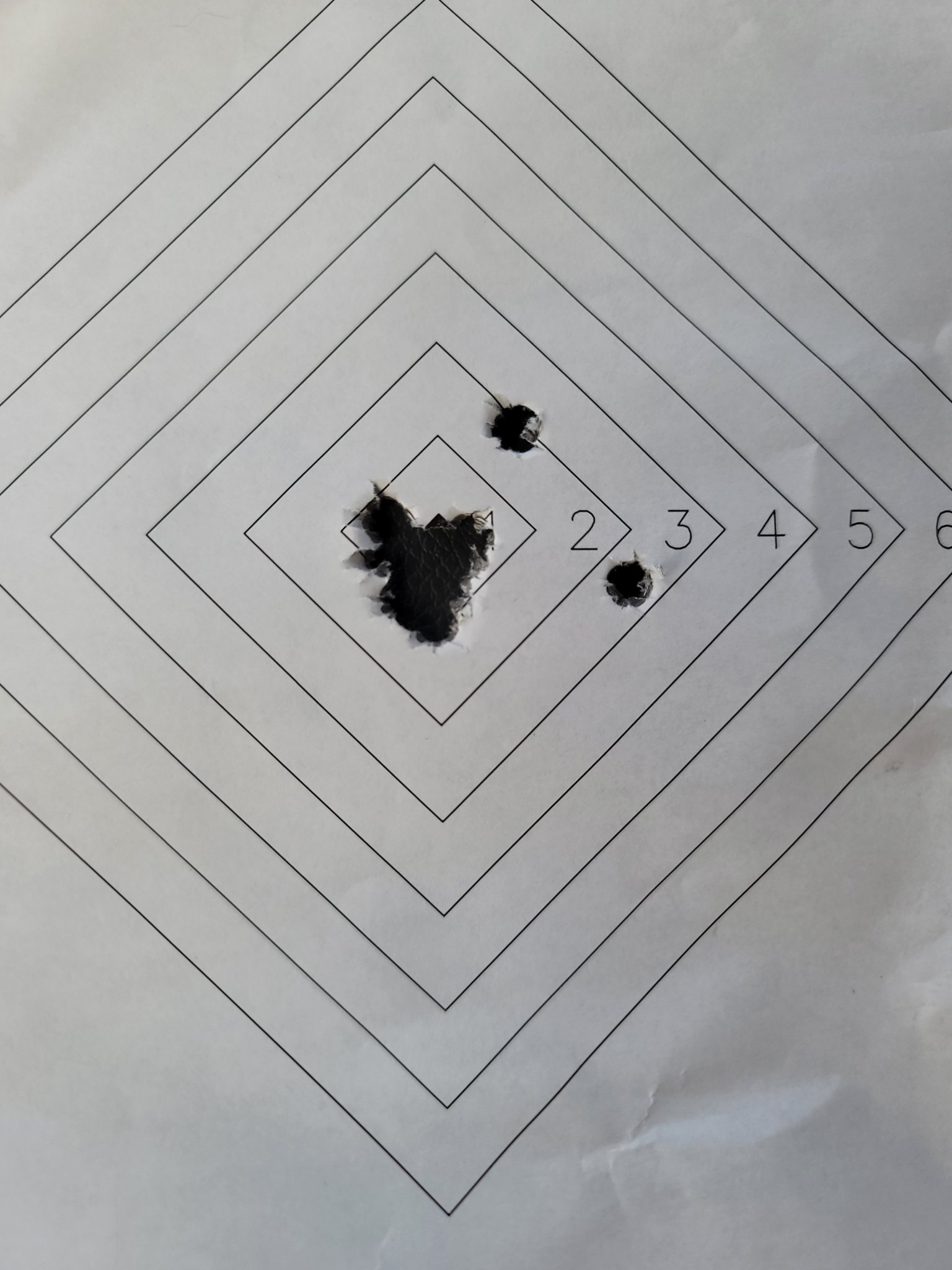

I have had the past month off from shooting. Doing a mental reset. So I took my Ruger precision rimfire out with CCI sv. It was -3⁰c (26⁰f) full value 9 o'clock wind 8-12 mph.
These are in the order I shot them no warm up this is my first 92 shots of the day. I shot a group of 10 prone first then did 5 Kraft targets. The last 3 Kraft targets I messed around a little so not sure its fair data but its interesting.
The first target was telling of the rusty me. The very last target was a 10 shot group standing at a barricade. It was 1-5/8".
I have always done tests like this by shooting groups from one position. As we can see I can shoot a group simular to prone but this breaking position between shots.... it is a very good idea.

Rifle setup can help. I shot my Kraft with a Ruger "precision" Rim Fire so with the plastic so called chassis it exaggerates fundamental errors and positional changes. You can also see my first target is embarrassingly shotgun like. I have had a month reset and now will start from scratch and redo my fundamentals over the next couple of months. The higher recoil rifles will exploit this more then a 6mm pea shooter. Now this all points to practicing your positions so you are more consistent with your fundamentals and this is very true that is why I do a restart after every season. BUT it is impossible to recreate a prone shot when standing... Telling some you just need more practice is not the entire story just 90% of it.
This is only true in so much as the person behind the rifle is in a different positions so it’s different.
You can absolutely recreate the same POI. Take a look at @lowlight’s submissions. That is repeated and consistent recoils management that allows the rifle to recoil very close to the same way every time.
I read his post a few times. I think that proves the point that it happens but can be accounted for. A group from each position would show more the shift from position to position. The part that stood out to me is that he seen some horizontal as well. I have never considered the horizontal component before. At 100 with a 22 its pointless so it will have to be with something else. My testing in the past is 0.2 mil difference vertical for me.

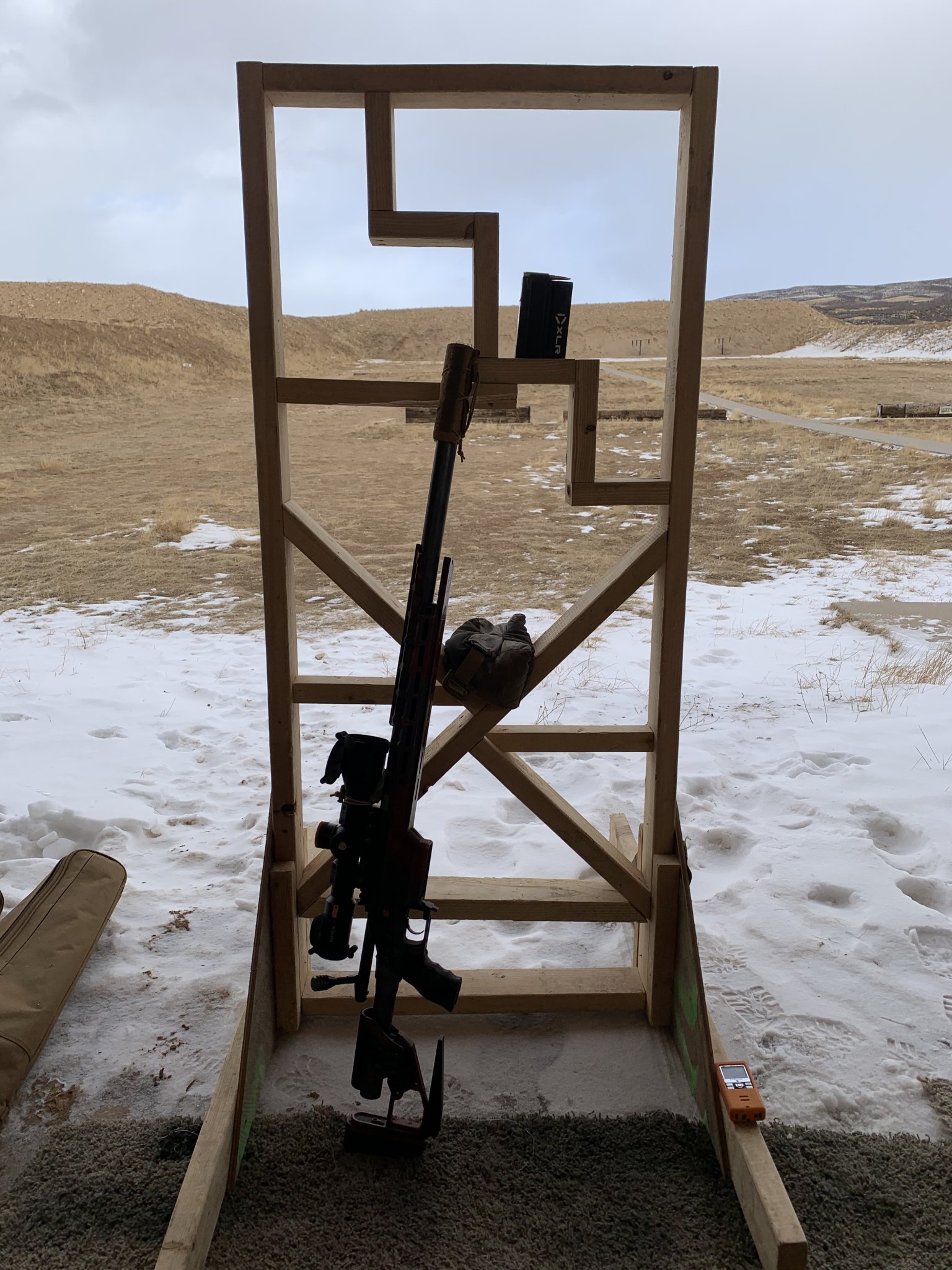

Ran this again today with some time to challenge myself. Set a 144second par assuming average of 12 seconds per shot. Knowing the targets are 3" tip to tip for the number 3 diamond I am keeping everything inside a 3moa group under stress (program calculates 2.1 moa but that would have only had 10 rounds on a 2" square plate). This is pretty consistent with what I see during matches and right in line with what I have found myself to shoot (12sec per shot breaking and making a new position each time). I shot on 15x zoom and added a 3/4" paster to the center for an easier aiming point.

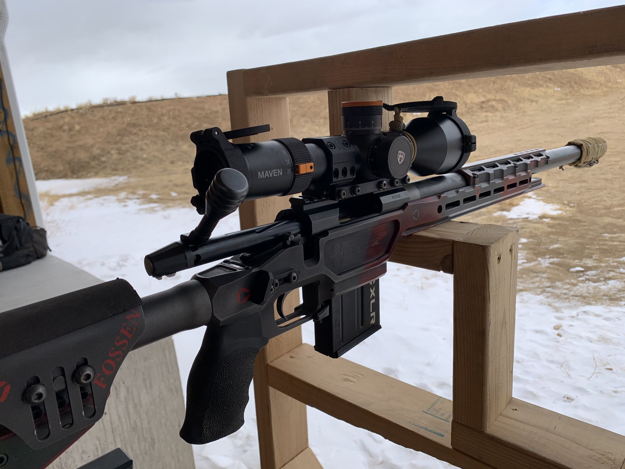

25 Creedmoor in XLR envy Pro team chassis with Maven RS.4 scope. Single pint size GC and used the bottom bar of the barricade from prone so I didn't have to deal with a bipod.
It was about 28* outside and had minimal wind sub 5mph from 8 o'clock ish.
This was a real eye opening experience at the range today. I have heard "paper doesn't lie" many times it reveals weakness very quickly!

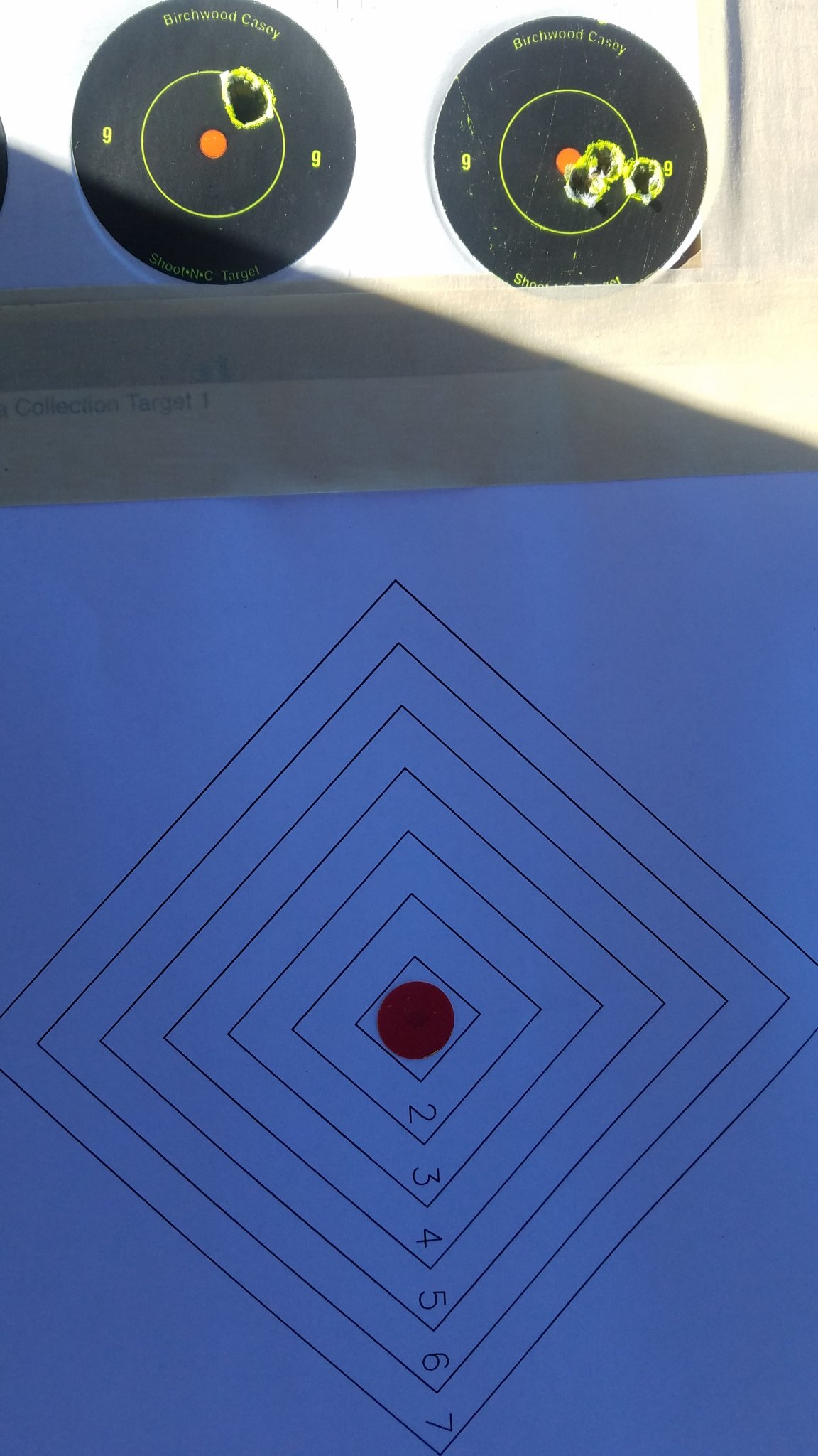

Shot the drill again today with my hunting rifles. Interesting results with the heavier recoiling 7 RSAUM.
The Proof 6.5 CM is the Tac-II and it weighs about 9lbs in this configuration. Mellow recoil, but it's definitely more sensitive to followthrough than a 18lb comp rig is. My high and low misses are all me; I called them both. I got lazy and loose on the rifle and it bit me.
The ONE Rifles 7 SAUM was not zeroed; the rat hole is where the zero is, and I fired a confirmation group after the drill to make sure it wasn't me. I adjusted afterwards. This rifle is about 11lbs in this configuration and it's readily apparent that followthrough is a very important task while shooting a light weight hunting rig with some stout recoil in positions other than prone.
Loved shooting this drill. Gives me a really positive baseline for improvement over 2021. I was happy that I didn't have any poi shift from position to position but am far from satisfied with the 2 moa result. Im ready for the timed iteration of this drill @ChrisWay

Finally made it to the range today & I really like this drill.
The results were very revealing for me. Chris I hope you get some useful info from it, I know I damn sure learned a lot.
My background is that I'm pretty Green at this. Never had any training & have never competed with a bolt gun.
I only tried the barricade @ my range twice prior to this & only standing. I did shoot my first match in Oct. Geissele gas gun challenge and it had positional, but not this (roof top, tires, swinging platform etc).

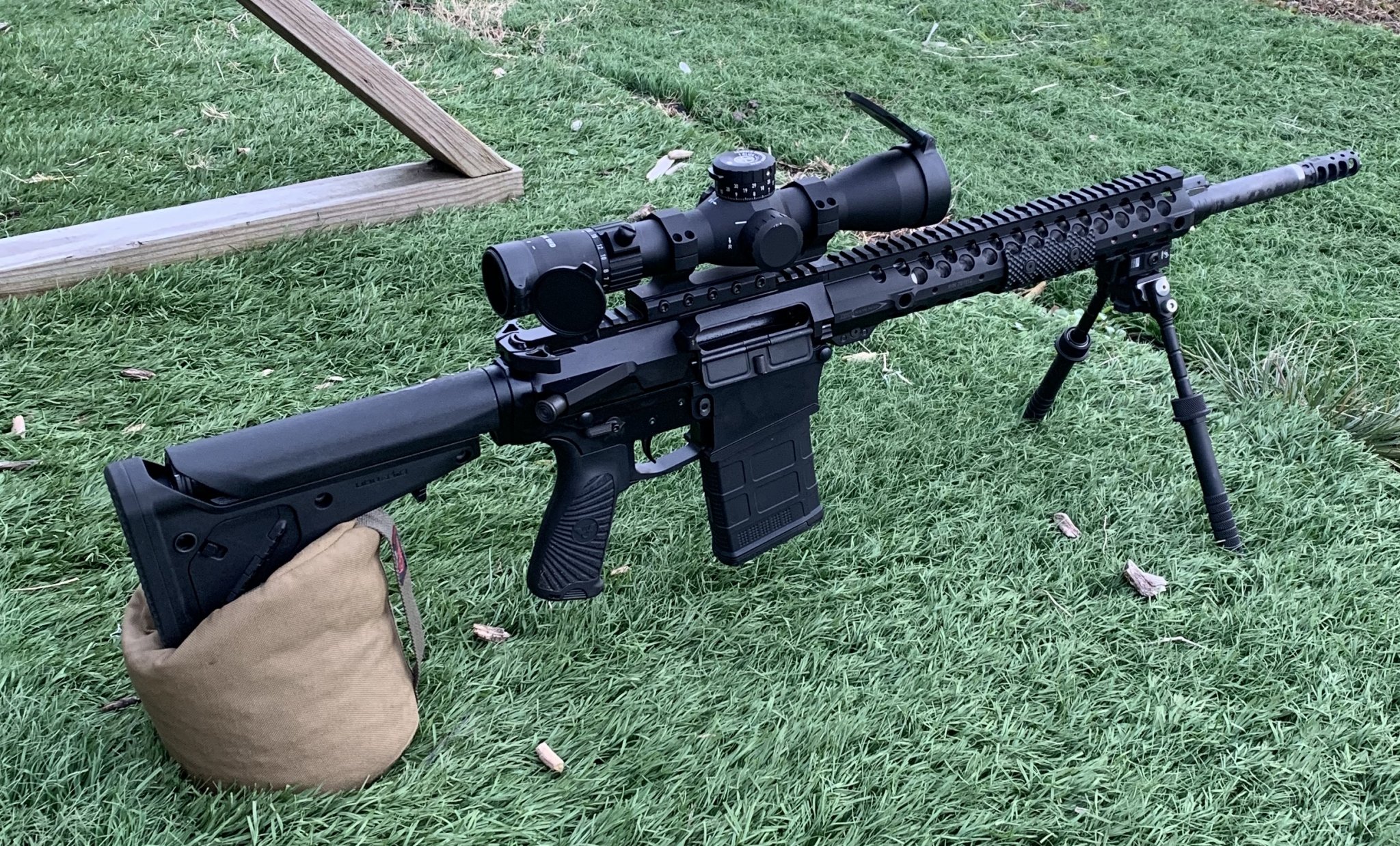

I shot 3 targets with 3 different guns & I'll post in the order I shot.
All 3 were shot using the same smedium GC bag on barricade & Colorado precision rifle rear bag for prone.
All were shot on 18 X magnification.
Atlas Super Cal Arca was used on the 2 bolt gun 6.5C's
Atlas PSR pic mount for the DPMS 308
1st up was the 4th of July special ARC rifle.
This gun previously did not like Berger factory 140 Hybrid loads. I thought I'd give them another try since I just put a new Brake on it & it likes them now go figure.

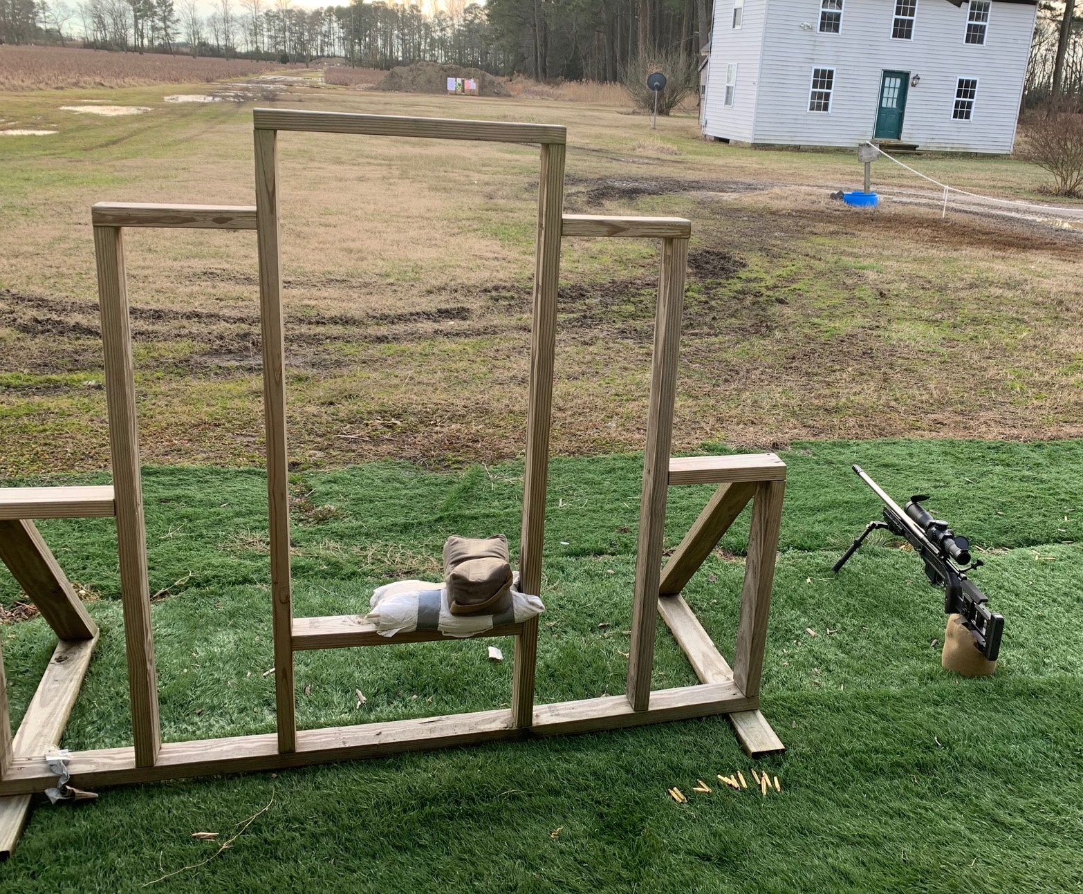

Set up for all.
ARC 6.5C Weight is 16lbs 5 oz
I did tweak it by adding a 3 round zero check + 1 shot each position prior to shooting the 12.
So 19 rounds total per target.
Steyr 6.5 C Weight is 14lbs 14 oz
DPMS 308 Weight is 11lbs 11 oz
Well first off I learned that Balance really makes a difference.
Also I prefer 2 stage triggers, but I shot the single stage trigger tech on the ARC best:unsure:
The Xylo is a really an awesome platform. The thing was obviously built to do this. Very comfortable & since I did add a few weights to the front of the rail it balances great. I'd bet with a 26-28" barrel the balance would be right without added weights.
This was the only rifle that would balance on the barricade unsupported. Trigger is set about 1.5 - 2lbs
Hard to believe the brake change had such a big affect on the Berger 140's, but I'll take it. I'm surprised the large PA Hypertap 4 port brake doesn't get much praise on here. It is very effective & back blast isn't any worse then a hellfire. The machining is perfect & ion bond/PVD is (y)
As it sits it actually qualifies for production & I plan to shoot it in the Mason Dixon PRS this year.
I love the Steyr/Manners & it will group with the ARC, but it is way butt heavy due to the lightish barrel profile. The new 10 round mags are tits. It has a nice adjustable 2 stage trigger & it's set @ 1.5 - 2lbs
I was able to adjust to the balance and settle in on the last 8, but it took more effort.
From this test I learned that I need to shorten my length of pull. Really had to crane my head over sitting to get full sight picture.
Might also add a steel 419 Arca with the internal weights to improve balance.
DPMS 308 also suffers the back heavy imbalance. The 3.5lb trigger was pretty noticeable coming from the lighter bolt gun triggers.
I have more time behind this gun & it proves how important practice is. It's clearly the most disadvantaged, but I did pretty well anyways.
I don't know what the hell happened to the zero. Everything went right after a .1 tweak. It was first shots with a new break so I obviously need to zero again next time out. Excuses: Just 1, the barrel was squeaky clean when I shot this.
Changes I might make to this after just one run on the Craft would be to put a trigger tech 2.5lb 1911 style (closer to single stage) in it.
I'll probably put the short Defy Arca I got BF on there so I can run the Atlas S cal or cal & put a little more weight up front.
Also might drop to 150 class bullets for matches limited to 600-700 yards.
Last, but most important I'll be running this drill and adding time pressure!
Thanks to Chris Way & Frank for pushing this out to us.

Hey guys. This week we will start posting the analysis and big picture data on RifleKraft. In order to clarify a few data points I came up with an additional drill I’m calling the stress number drill. It’s an additional run through the drill with a specific time element extracted from your baseline.
here’s a video explaining it. If you want to do it, awesome. I think it’s a perfect compliment as it shows a few things well when added to the data.
the Data is best interpreted with all shots on the same target.
**if you have trouble with the aim point.. use a marker to color it a little!
