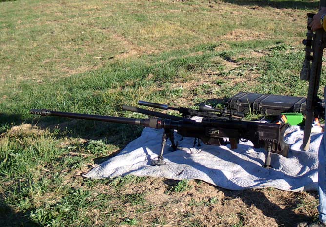

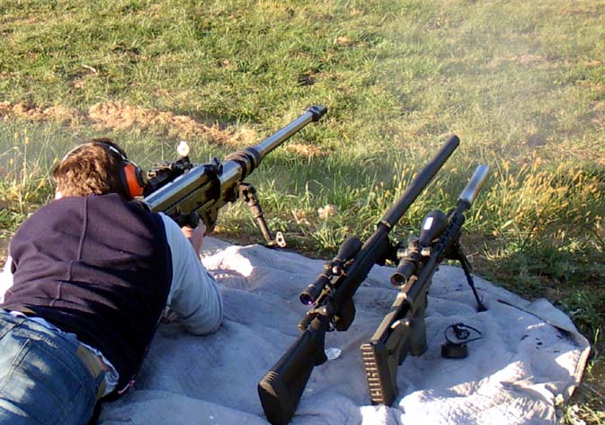

No space helmet needed....just a good set of earmuffs. With the brake on the Boys rifle I was still inside the "cone of silence" a bit because the angle most of the gas follows is more forward. There were some cute girls at the demo too so that made it worth sitting through all that blasting. The ammo was all yugo surplus and I got to keep all the brass. My days of firing 300rds myself were all shooting ammo I loaded so the ammo bill wasn't that high. I bought a lot of powder, projos and primers years back so the cost was low. A lot of labor went into it though....
In any case its all relative. I have people shoot 9mm submachineguns who whine because the recoil is bad. I have others who fire the 338Lapua without the brake or suppressor and don't seem to notice. If you shoot a lot then recoil and blast get to the point where they don't bother you. You quit flinching when someone fires next to you and as long as the next big rifle with a brake is a few feet down the line from you you're fine. It just takes practice.....
On the other hand.....the 20mm is a bit expensive to shoot so I've never fired more than 50rds in a weekend. I didn't have enough brass....

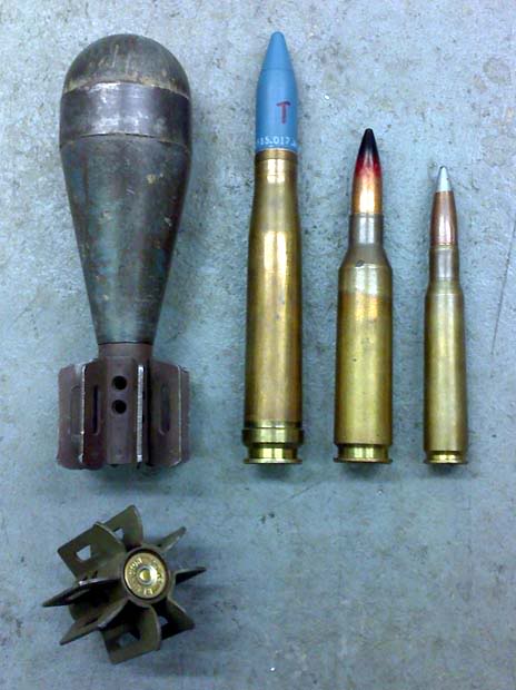

One pic is of the Solothurn being fired. another view of the rifle from the side and one of the ammo. 60mm mortar practice bomb, 20X138B Solothurn, 14.5mm Russian and 50 bmg. We have never shoulder fired the mortar and don't plan to do so but the others are all manageable.

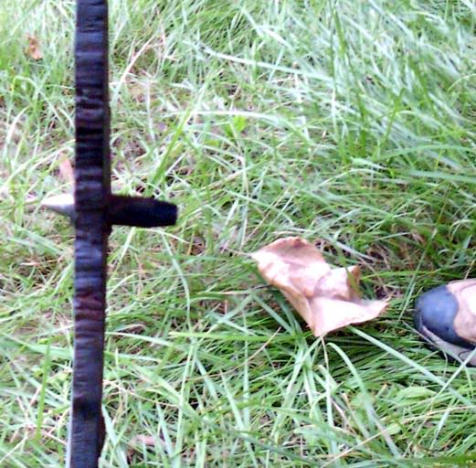

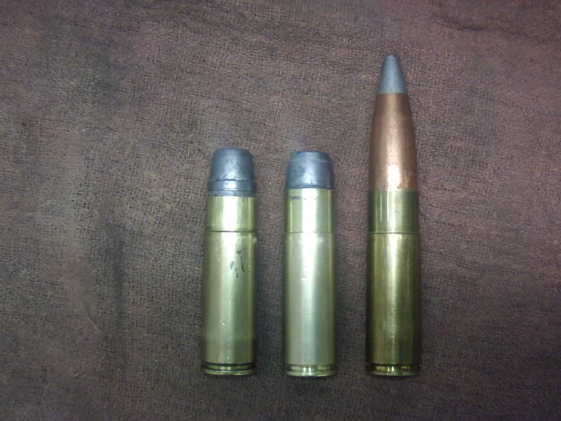

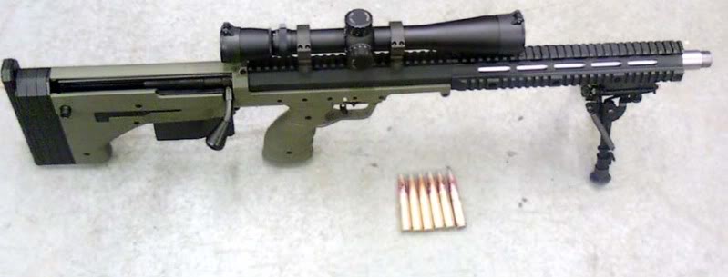

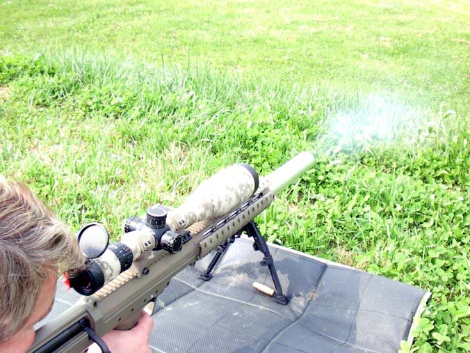

I shoot mine in 4 different cals. 6.5X47 Lapua with a 26" barrel, 338BR with a 17" barrel, .338 Lapua mag with a 26" barrel and 12.7X48 (510 whisper) with a 22" barrel. I use one suppressor for the first three barrels and a dedicated can for the 510. If you want a short 50 for tossing subsonic BMG bullets or supersonics with lighter bullets this is the one to have. It suppresses very well, has no concussion to wear you out, recoil is low and you can choose to shoot subsonic heavies like the 650gr BMG types or 750-800 gr AMAX etc as well as the ability to spit out a 650gr BMG type at 1300-1400fps or a 300gr hunting slug at 2300fps. My rifle with a Nightforce 5.5X22-56 and the 510 suppressor weighs in around 17lb. In the pictures below, the flat dark earth rifle belongs to a friend. I did his 510 barrel and suppressor so its just like the one I have. The pic of the green rifle is mine with some loaded APIT ammo, the shot of the plate with a penetrator stuck in it is from an APIT that we shot at a piece of 5/16 plate at 260yds. It made it most of the way through as you can see. The incendiary charge goes off as well when hard targets are hit.
The last shot is a couple early development loads with cast bullets of 450gr compared to the APIT bullet load.
Not too far off topic but it is a 50 with a 22" barrel....
