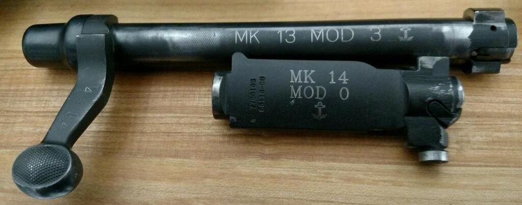

so having handled a handful of different mk13-0 bolts, i have seen many variations. I have seen both electro-pen and stamped last 4x of serial on Remington stock extractor, Stamped last 4x of serial with Tubb/sako extractor w/ no lasering, and laser marked bolts with stamped last 4x and tubb/sako.
If you are keeping a stock rem extractor, i personally would stick to stamping or electro pen if you want it more correct. I cant speak for every rifle, but all o the lasered bolts i have seen have had tubb / sako.

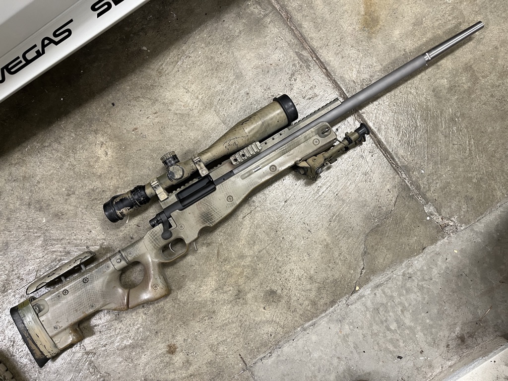

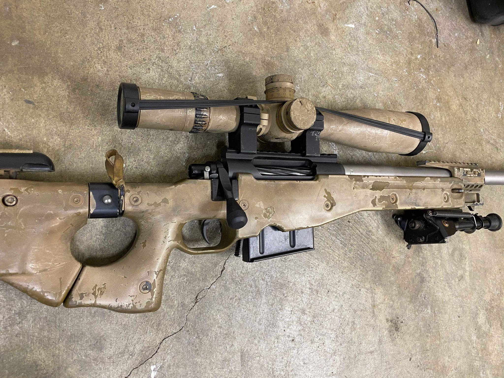

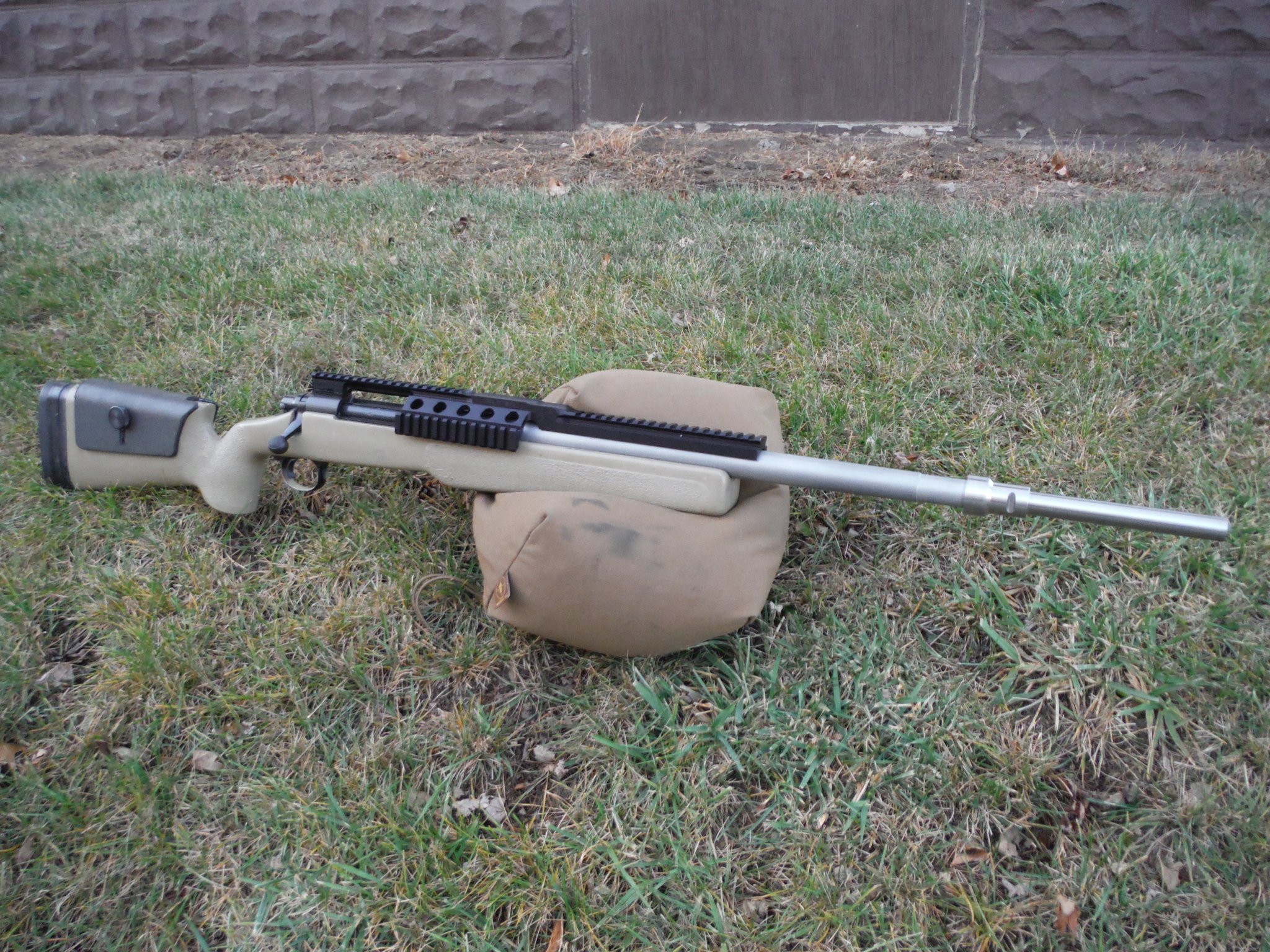

Got this one back from Chris Higgins at Red Bull Armory today. Outstanding work as always and it was an amazing feeling reuniting my matching scope and chassis.

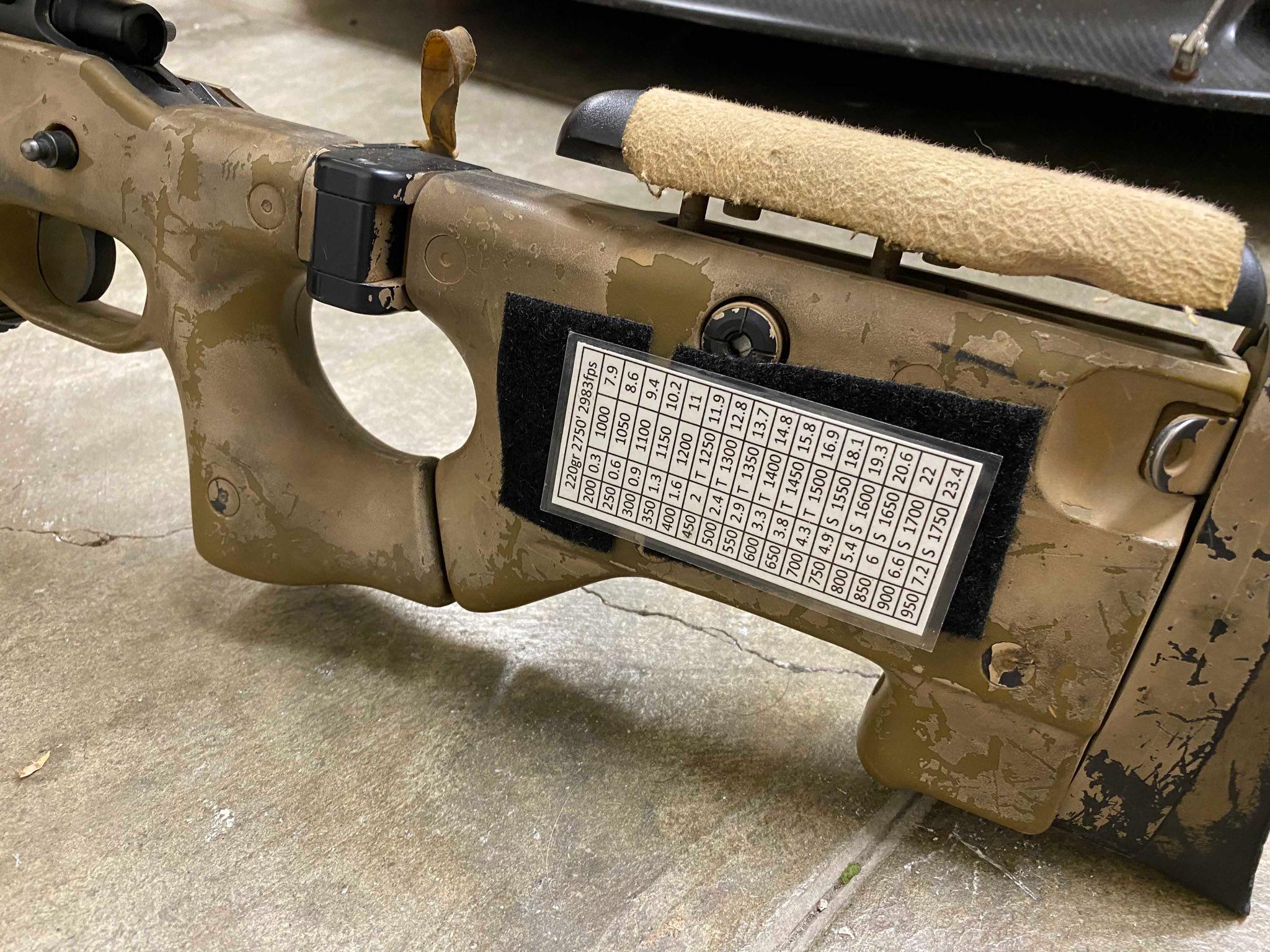

used to hold the bolt back. pretty common oj mod 5/7View attachment 7694195

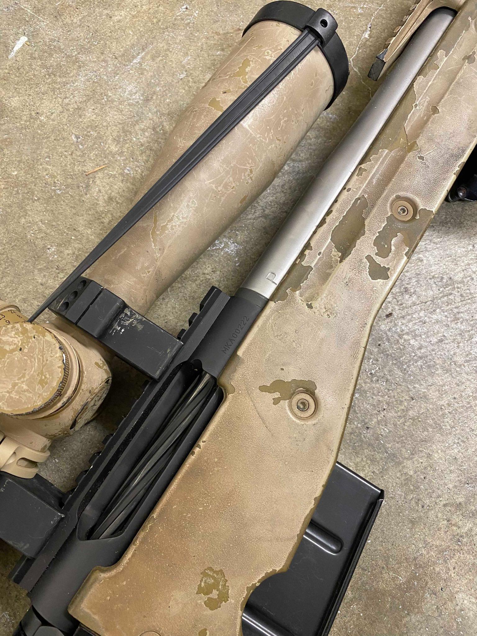

Some of the Mk13 Mod 0 stocks had them as well, the SEALs have been doing that for quite a while. If the stock is painted, sometimes there will be an unpainted loop around the stock where that rubber band was removed or rotted away. Check your Mod 0 stocks, you guys might have a rubber band or a tracing of one!

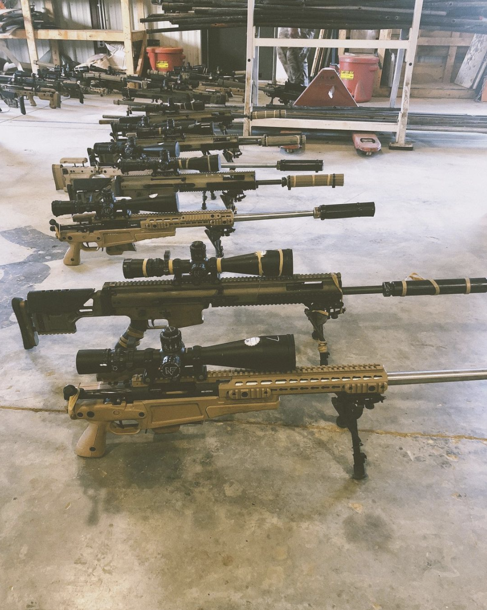

Anyone have any reviews for rifles made by RWS? Looked at his site and his stuff is impressive. Any group data? Is his stuff shooting sub-moa? I take my rifles out past a grand regularly. Just would like some of y'all's feedback
First group on paper with a Mod 0 he built for me was in the .4s with factory Sig 191 contract ammo. I am very picky about my rifles (and builders) - I have no issue recommending him to others as he will definitely be getting more of my business.
I would recommend RWS HIGHLY. Built my Mod 0/1. It shoots like a laser. Shoots sub 1/2 MOA with 230gr Berger and 190gr Black Hills.
Anyone have any reviews for rifles made by RWS? Looked at his site and his stuff is impressive. Any group data? Is his stuff shooting sub-moa? I take my rifles out past a grand regularly. Just would like some of y'all's feedbacK
RWS has done 3x of my mod 0's. Ill admit i only shoot one of them, but its a straight hammer, and i expect the same from the others.

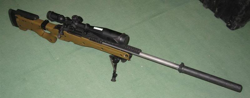

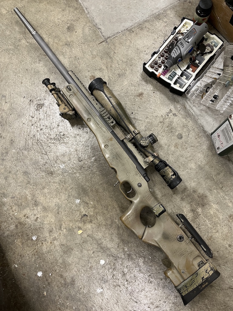

I'm really excited to have the .300 Win Mag (pre-Mk13 Mod 0) complete. Some of the cool features it's got are a C655XXXX action (which is the lowest observed serial number block for Mk13s), beautiful takeoff grey McMillan, takeoff Crane recoil lug, takeoff one piece scope mount, 1998 dated Turner sling, early non swivel Harris with the flat head screw, and an issued Kalispel case with a barcode sticker for a Leupold M1 10x scope.
It's a shame that very few photos and very little documentation exist for these early Navy Win Mags.
Thanks for the kind words, I passed them along to my father, he's very happy to hear the positive feedback. He's going to photograph a few more Mk13 stocks later this month, he'll probably shoot photos of the Tal Afar stock next.
The UM swivel appears to be one of the early US made swivels, I also have this type of UM swivel on my Mk12 clones. It's strange that the front swivel is KAC, so it's probably a replacement. I've seen broken UM and KAC swivels on a few of these stocks, so they were definitely consumable items.
The Pod-Loc has to be early, since these rifle's were replaced by the Mod 5 in the mid 2000's. I'll have to compare it to the current production ones on my M40A3/5/6 rifles, IIRC their design changed at some point.

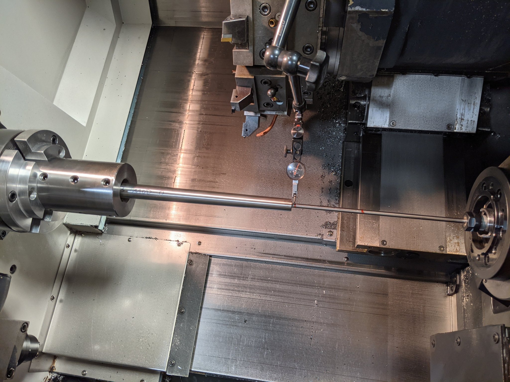

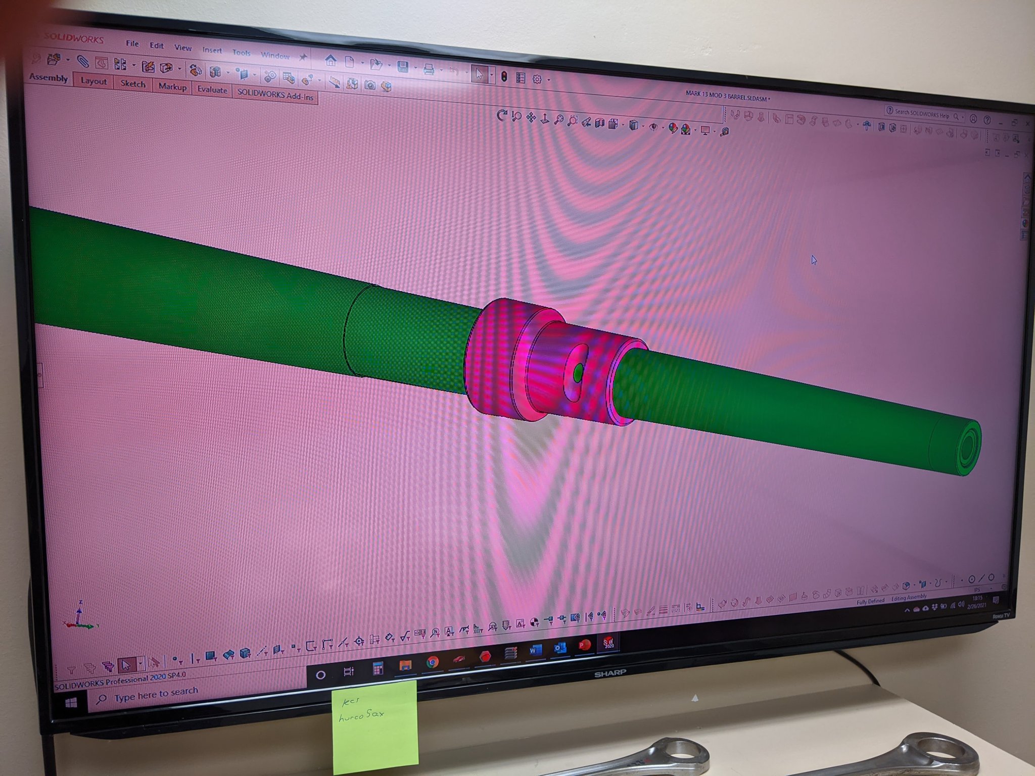

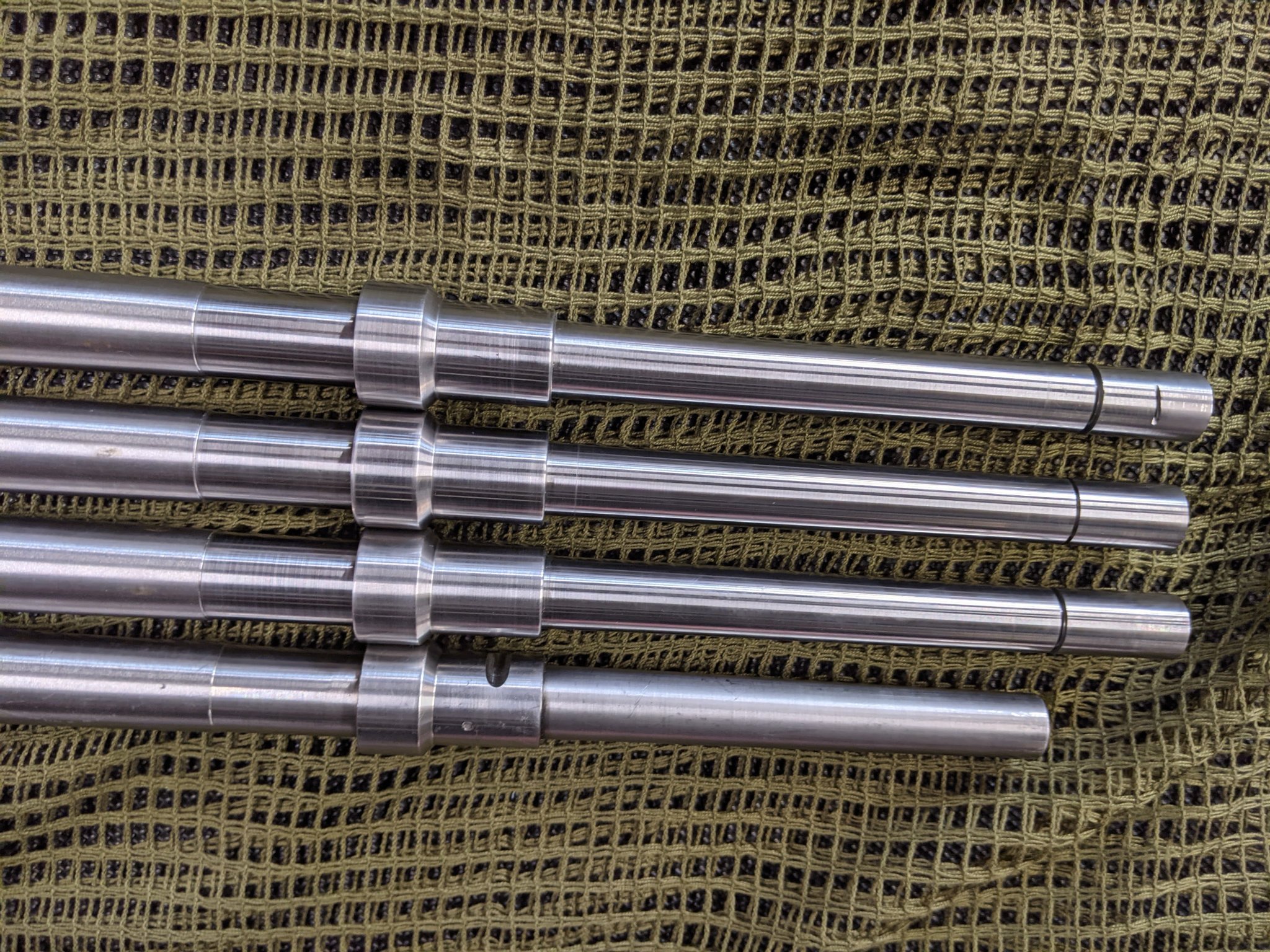

I think I may just get some bar steel at this point and make a few once my suppressor gets in. I can match the collar portion diameter with the test piece and then work my way to both ends to get the correct profile/ length. Sucks this print is so hard to find.

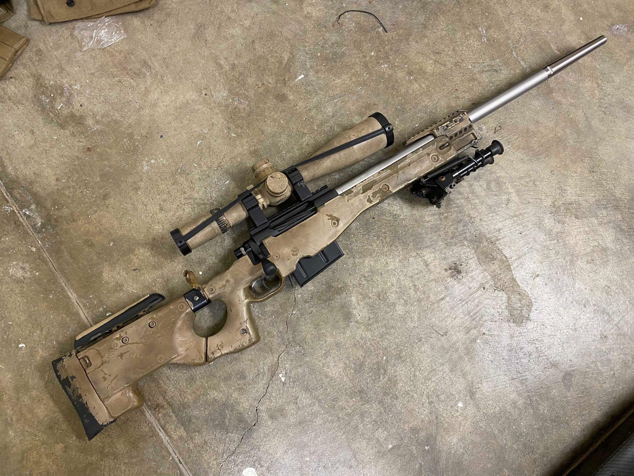

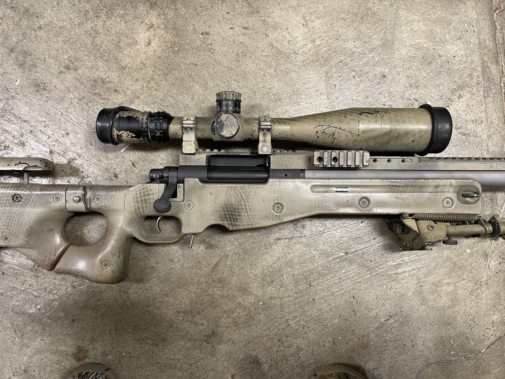

Reminds me, haven't shared some updates to one of my army mod 5s. Got a painted army-spec that pairs well with the chassis and mars.
The initial army scopes, also seen on later mk13 mod 2's had 1 moa elevation turrets and A191 BDC dials and a USASFC reticle. Later army specs kept the same elevation turrets and BDC, but changed to MLR Reticle - essentially getting rid of the ranging element of the USASFC.

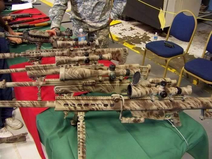

A few ITW pics -
Mike Glover - of fieldcraft survival
On some Ranger guns - note that mod 5 and mod 2's pictured
