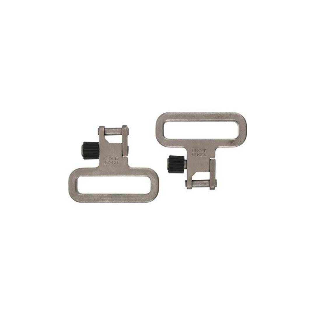

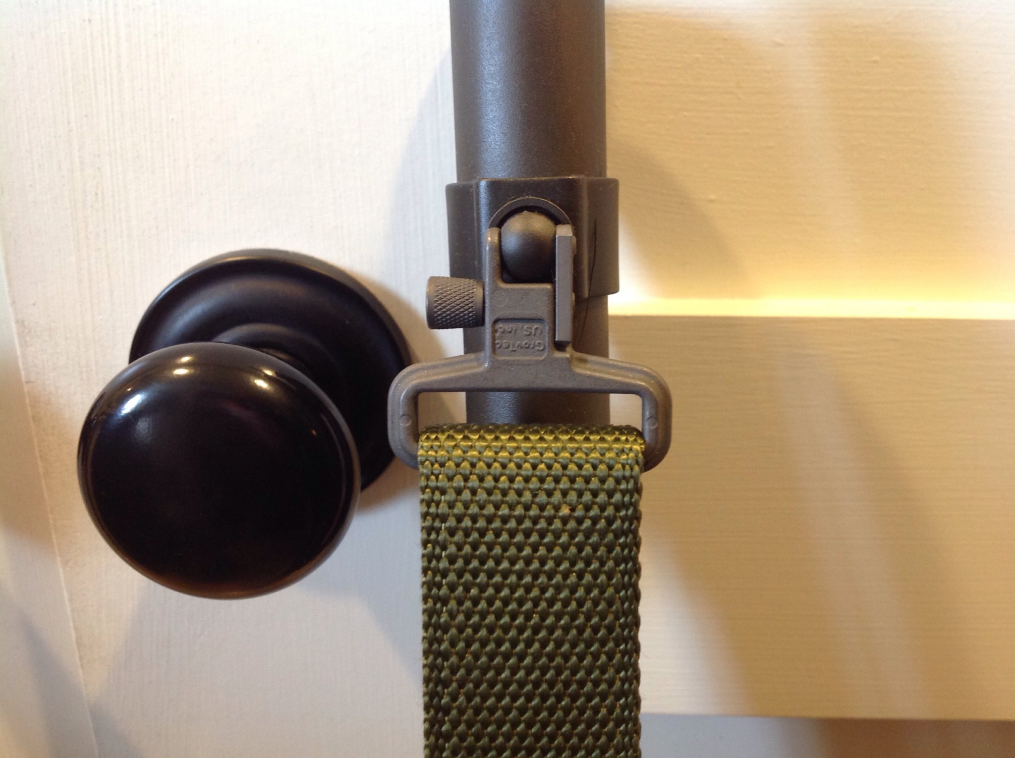

Anyone know what are good QD sling swivels to use with the thicker Turner national match slings for these builds? The Uncle Mike’s I currently have with the normal thickness M1907 sling barely fits. Thanks.
Reactions: Mk13ModW
Maybe the "mil-spec" ones.
I think I have one of these down stairs.
If a Ron Brown sling will fit these any Turner will.
Stand by.
Quick check on my shotty says even with the nylon GI sling attached I can slide a Ron Brown strap through one.
Actually I think these are the ones I bought because they were US made.....
Mine appear to say Grovetec though....

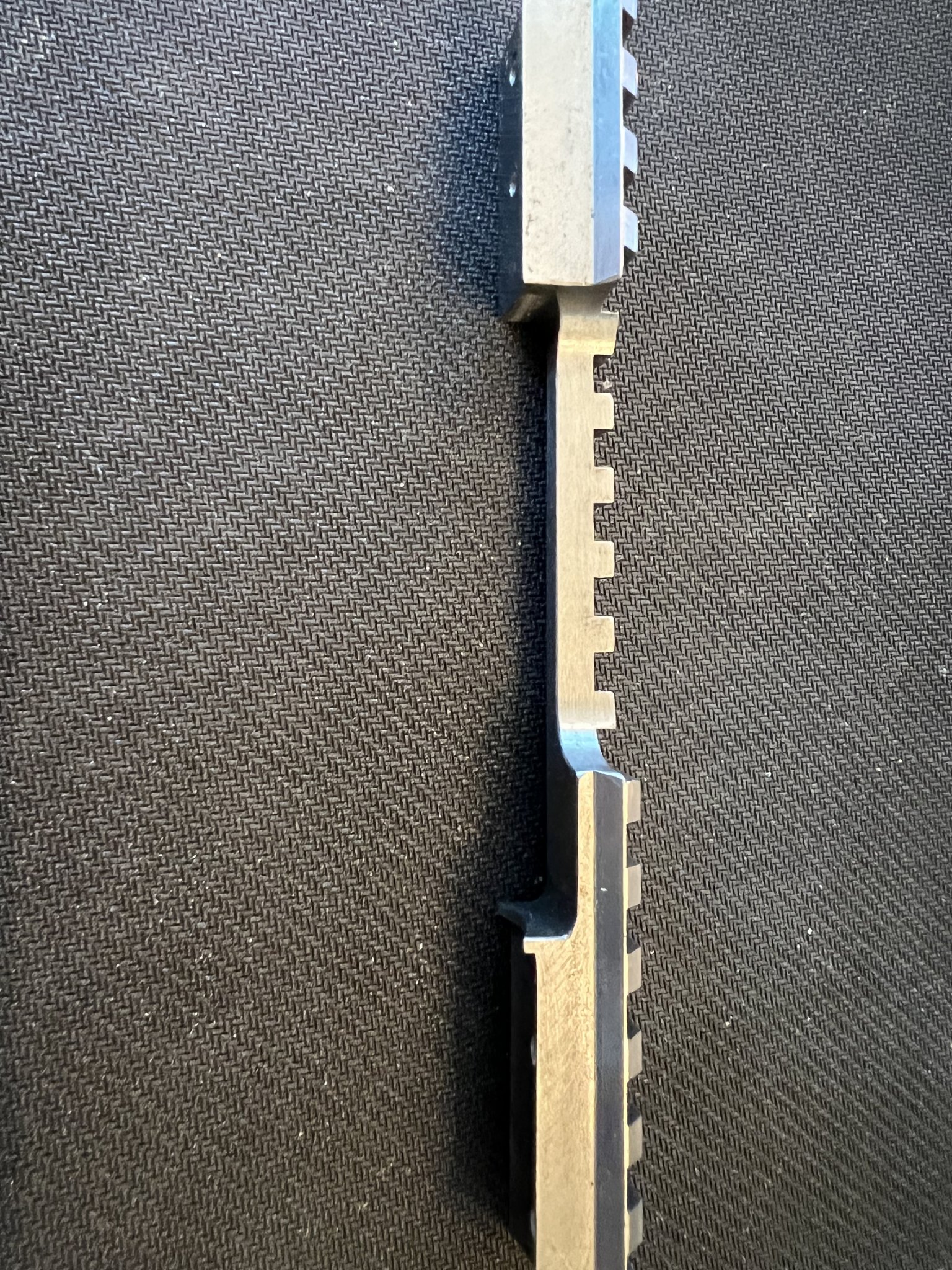

Has anyone seen a scope built by these guys before?

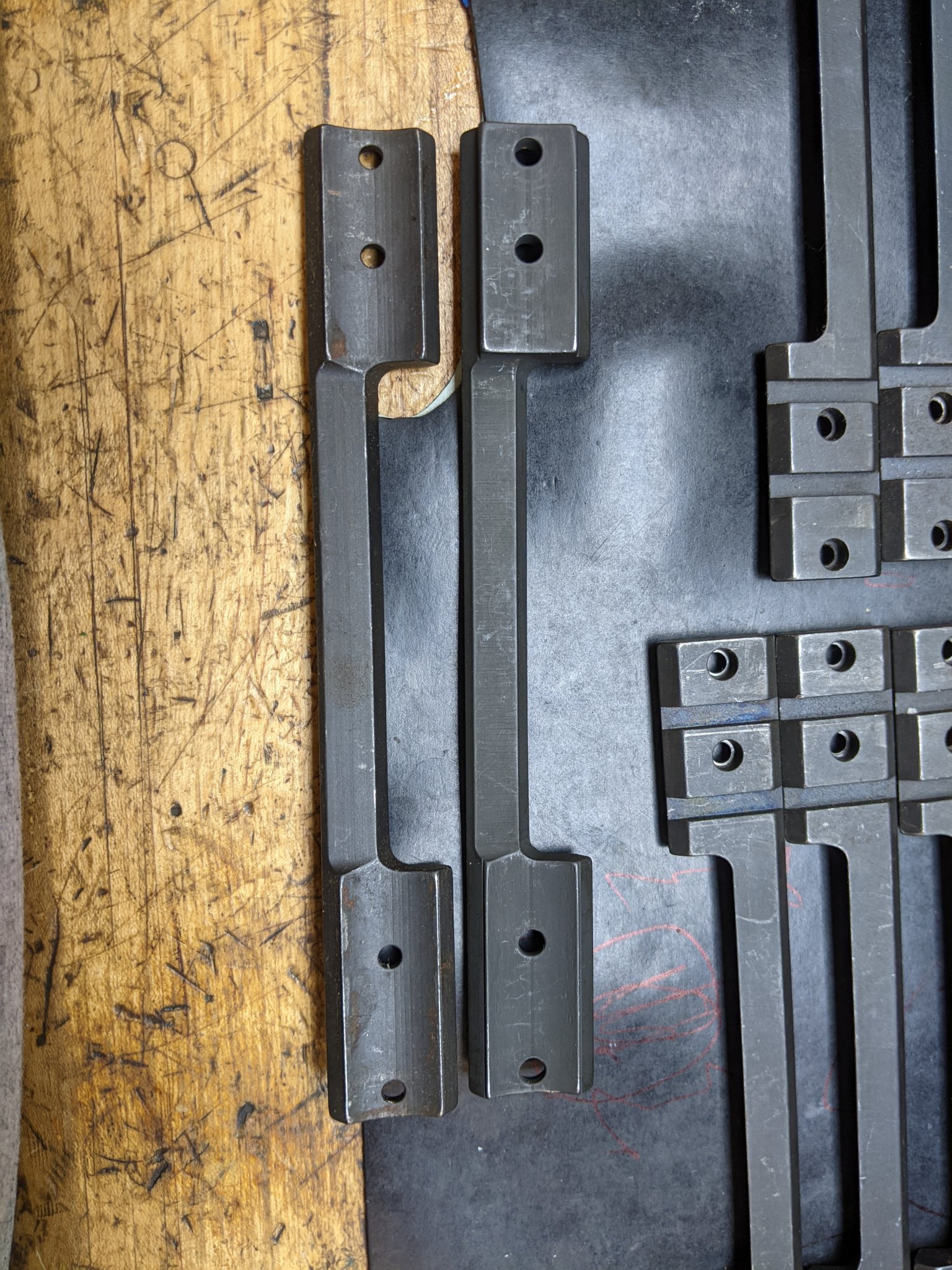

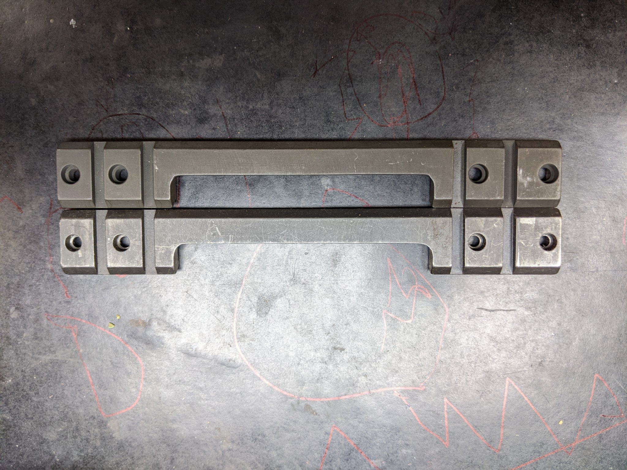

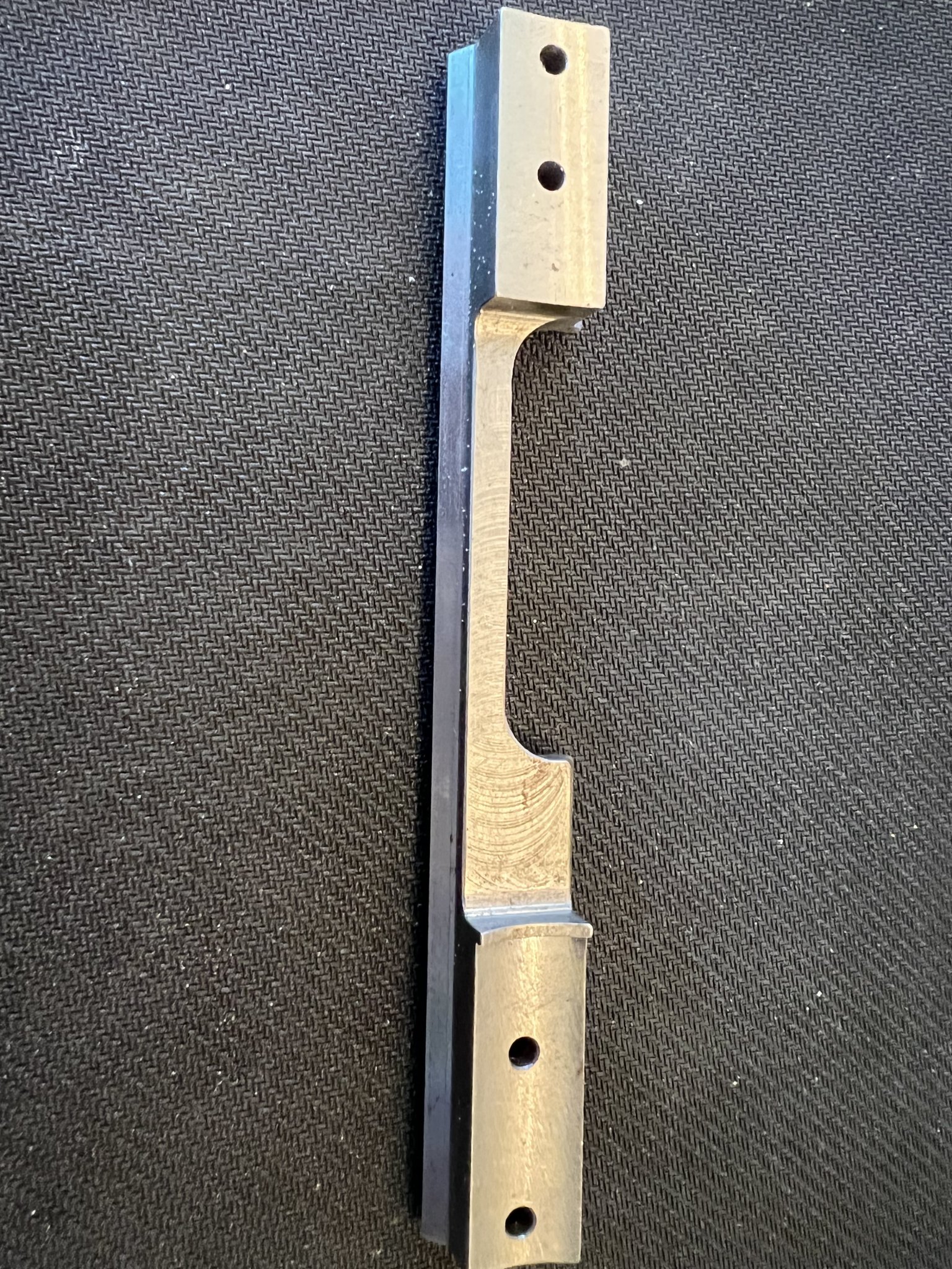

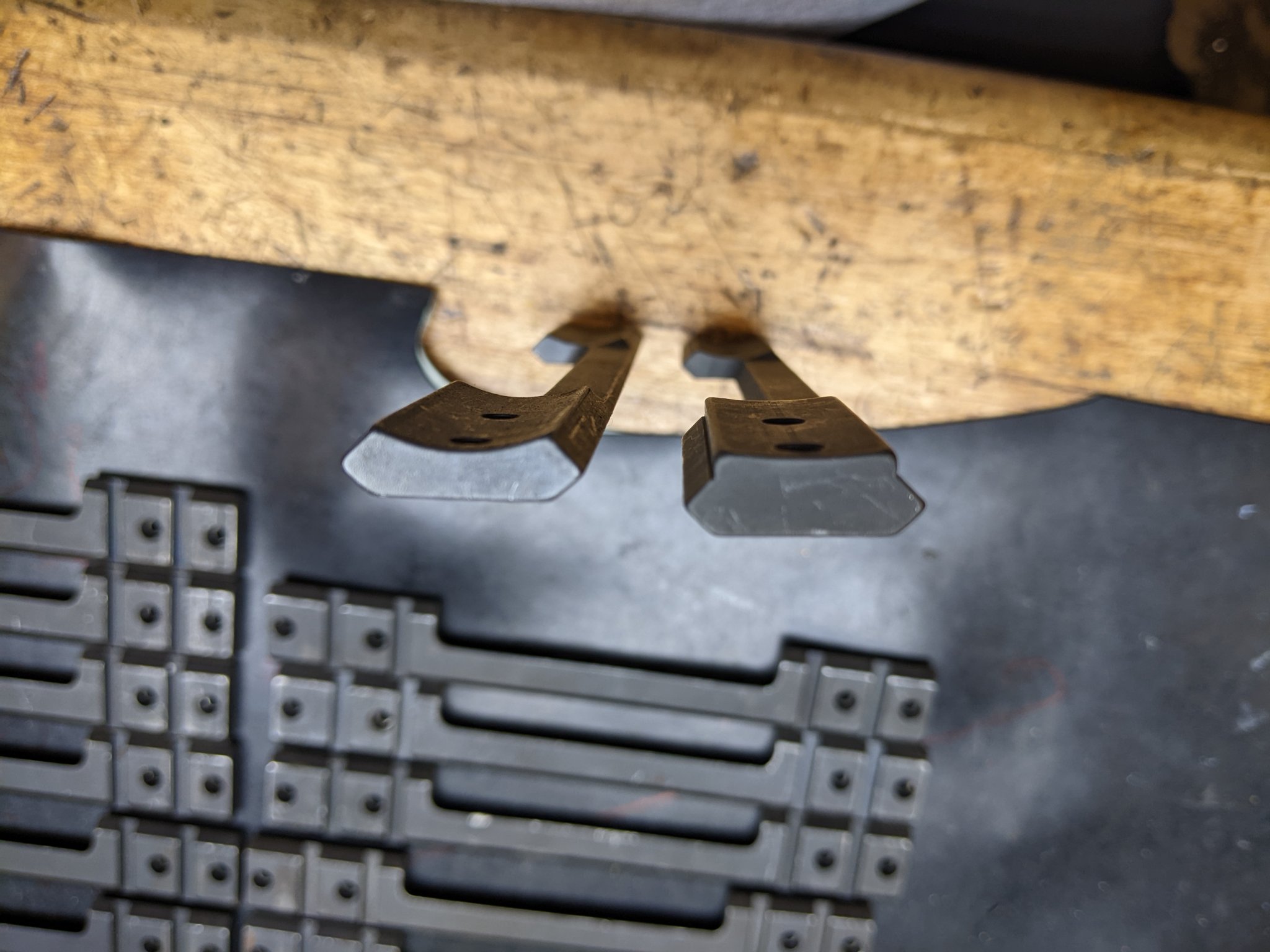

Here are a bunch of bases I believe we're used on the m86 long action or m91 or whatever had a early mcmillan type full round receiver, the base in front of the pack is an original m24 / m91?? Regular Remington style base for comparison.
I thought the RAD had a long action M700 with an M24 base?
Edit: I think that’s what you’re saying, yes? So where did these bases go to?
I have been trying to find out definitively what actions the early crane long action rifles used, I believe these bases came from m86 long action rifles, which I believe used mcmillan 700 type receivers ??
Reactions: Mk13ModW
The M86 receiver profile is a bit of an enigma. Maybe some of those mounts were for them, assuming they had a round profile.
As for the M91 long action receivers, those are early 1990s Remington M700, and I would expect "C" prefix receivers for that era. (some of the old Navy Mk 13 aluminum cases show a C prefix). I understand that in the mid-1990s many of Crane's 300 M91 rifles were re-built into 300 Win Mag rifles, and got the "L" shaped lug, etc. (Development of the Mk 248 Mod 0 ammo occurred in the 1993-94 era, and when the DoD allowed Sierra's 190 grain 'open tip match' bullet to be permissible for both competition and combat usage, legitimized Crane's 300 WinMag sniper rifles. At least that is my understanding).

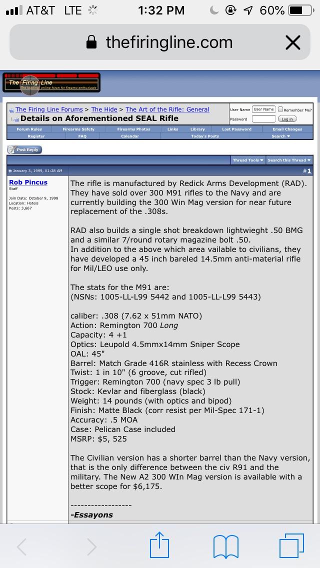

Here's a post from 1999. It doesn't mention the scope base for the M91, but based on the pics of those mounts, they look just like the M24 long action bases that the US Army used beginning in 1988. Made I think by Leupold.
M91 Sniper Rifle
Weapon Specifications NSN 1005-LL-L99-5443 (LH) 1005-LL-L99-5442 (RH) Model M91 Manufacturer NSWC Crane Caliber .308 Cal Mechanism type Bolt-action Magazine type Ammo capacity Rate of fire N/A Weight (empty) 14 lbs 8 oz Overall length 44.5 inches Barrel length 24.0 inches
Ammunition: ball (M59, M80 & M80E1), match special ball (M118), match (M852), match short-range (A169), and match longrange (A170 & AA11). Logistics: In-service Date 1975 Life expectancy 6,000 rounds Technical Manual # NA Operator Manual # SW370-BF-OPI-010
Discussion: The M91 is a Remington model 700 modified for use at sniper schools. It has a Remington trigger, a 1 in 11.2” twist chrome moly barrel, a HS Precision fiberglass stock, a Leupold 10X scope, a Harris bipod, a cleaning rod and guide, and an aluminum case. The rifle has a 1.0 MOA accuracy with M852 ammunition.
Accessories: None
.300 WinMag Sniper Rifle
Weapon Specifications NSN 1005-LL-L99-5364 (RH) 1005-LL-L99-5477 (LH) Model 700 Remington Manufacturer NSWC Crane Caliber .300 WinMag Mechanism type Bolt-action Magazine type Fixed box Ammo capacity 3+1 rounds Rate of fire N/A Weight (empty) 16 lbs 4 oz Overall length 47.5 inches Barrel length 26.5 inches
Ammunition: Mk 248 Mod 0 (A191).
Logistics: In-service Date 1975 Life expectancy 6,000 rounds Technical Manual # NA Operator Manual # SW370-BE-OPI-010
Discussion: The .300 WinMag is a modified Remington model 700 with a Remington trigger, a 1 in 10” twist chrome moly barrel, a McMillan fiberglass stock, a Leupold 10X scope, a Harris bipod, a cleaning rod and guide, and an aluminum case. The rifle is capable of 0.5 MOA accuracy with Mk 248 ammo. Accessories: None
...as for the early 1990s RAD scope bases and rings, those are sort-of an enigma as well. At some point in the 1990s Crane started using Leupold parts.
PS: A guy at Crane once told me that 'M91A2' was never an official Navy nomenclature. The M91s that were re-built into 300 WInMas in the mid-1990s were re-designated as "M700/300 sniper rifle" or "300 WinMag Sniper rifle." I got the impression that 'M91A2' was basically a RAD-based marketing model number (as noted in that old 1999 post), but not an official gov't designation per se. Just a random fyi that I was told.

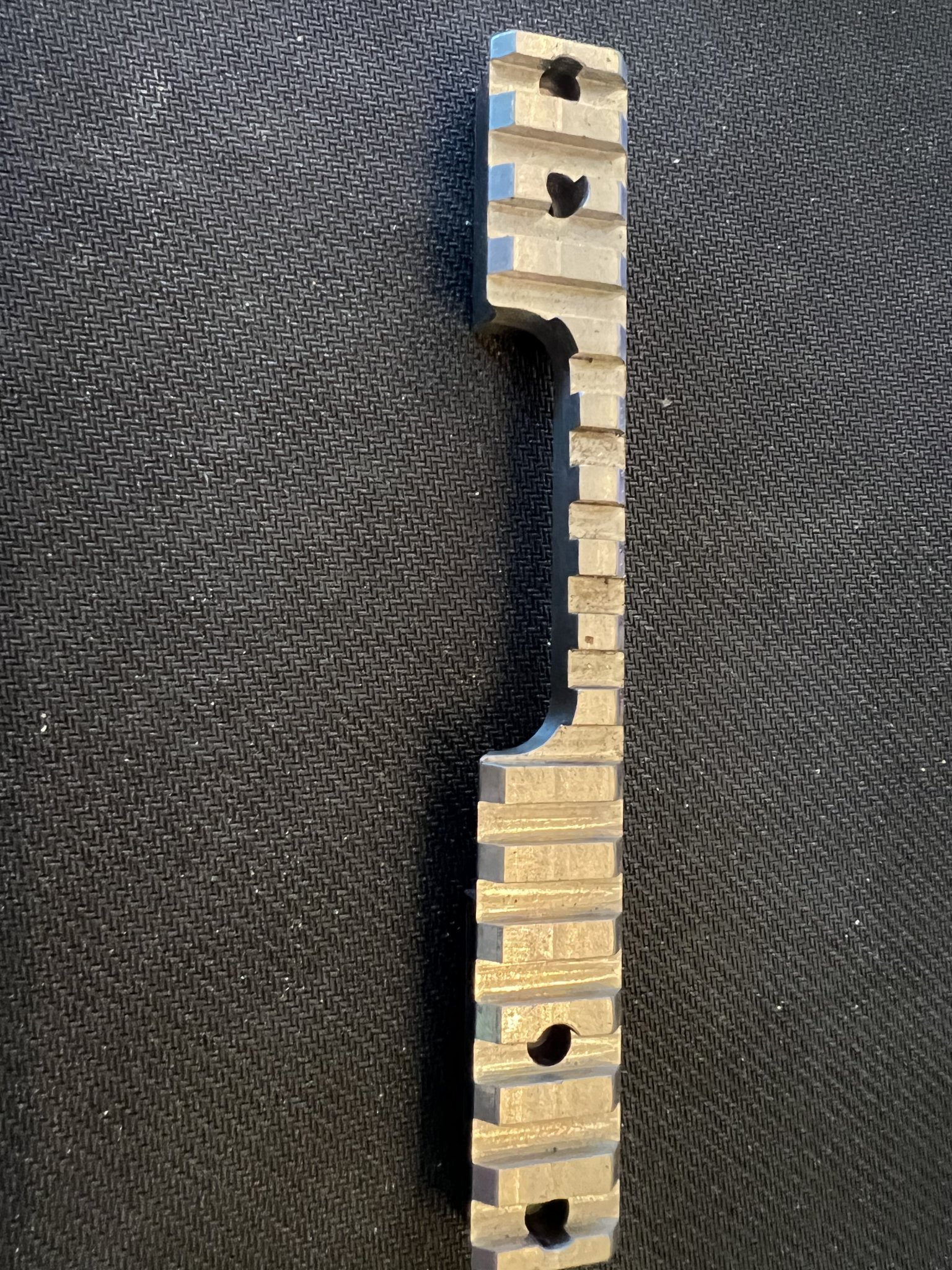

Sirhr
Don’t believe the lead times on any of the parts he sells. Absolute bullshit estimates on times.

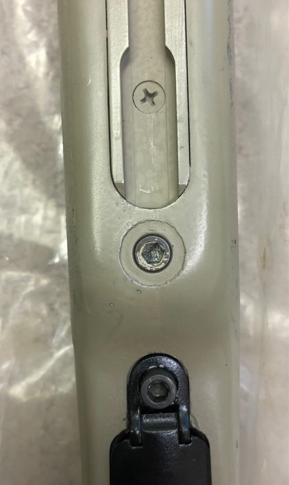

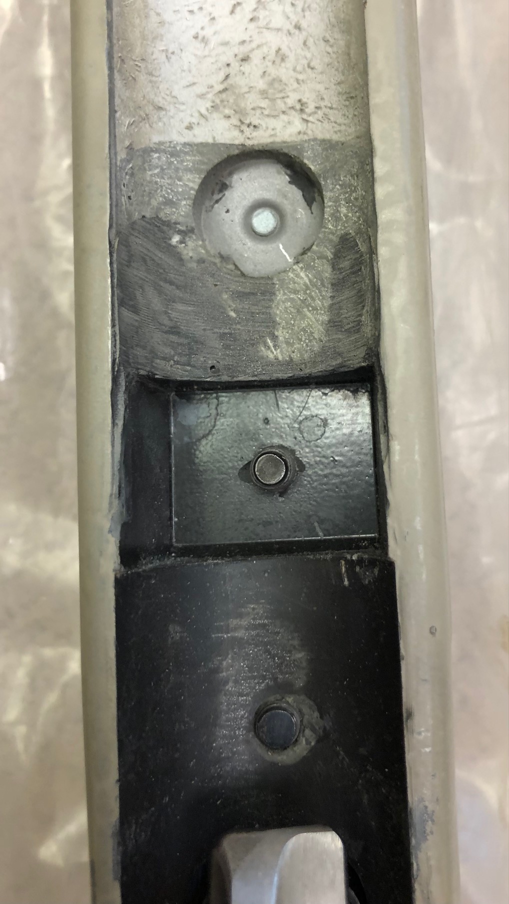

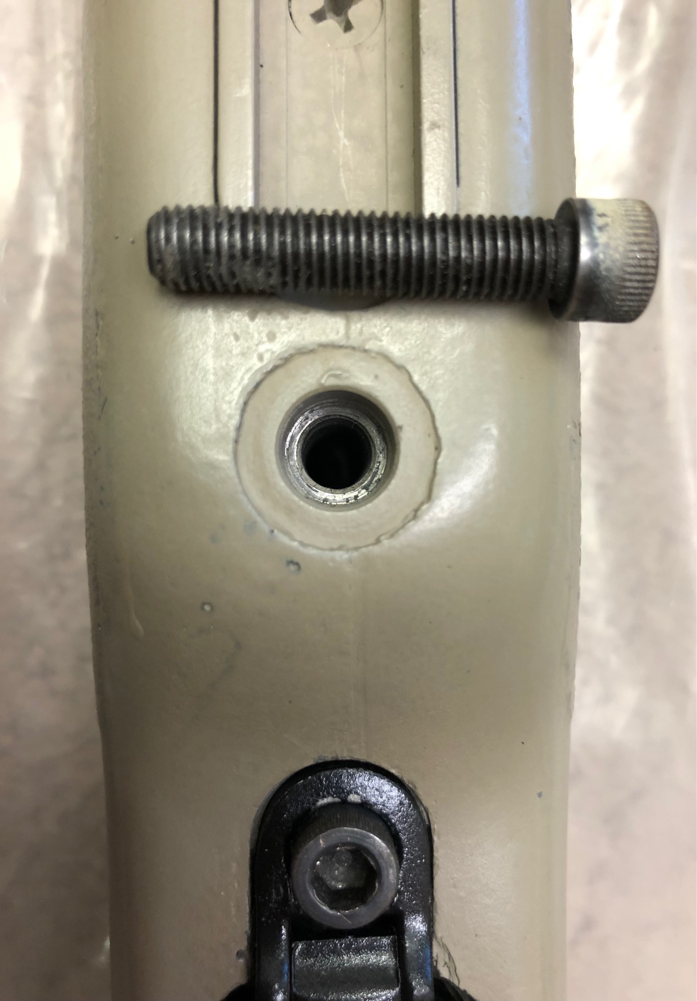

I have a question that I’m hoping someone may be able to lend an assist with.
I’ve been working with a long time employee of McMillan (who recently left to start his own operation) to retrofit two “run of the mill” A2 stocks to match the mk13 mod 0 spec. McMillan isn’t interested in making new, or modify existing, A2’s so this is likely the new reality we’re dealing with when it comes to mod 0 or mod 3 clones.
The one nuance we’re not clear on is the third action screw metal insert / pillar. If someone with a return stock is willing to take approximate measurements with a caliper (outside diameter of the metal inset / pillar, inside diameter) and/or provide a couple of detailed pictures of that section of the stock I’d really appreciate it.
Not able to see details of the insert, as it's obscured from the top with MarineTex bedding, and from the bottom it is below flush with the bottom of the stock. The bolt is about 1.487" long, with the threaded part about 1.220" or so in length. The bolt head is very slightly below flush with the stock. The bottom face of the metal bushing is about 0.280" below the surface of the A2 stock (3rd picture). I can't see anything else. Good luck with your project.

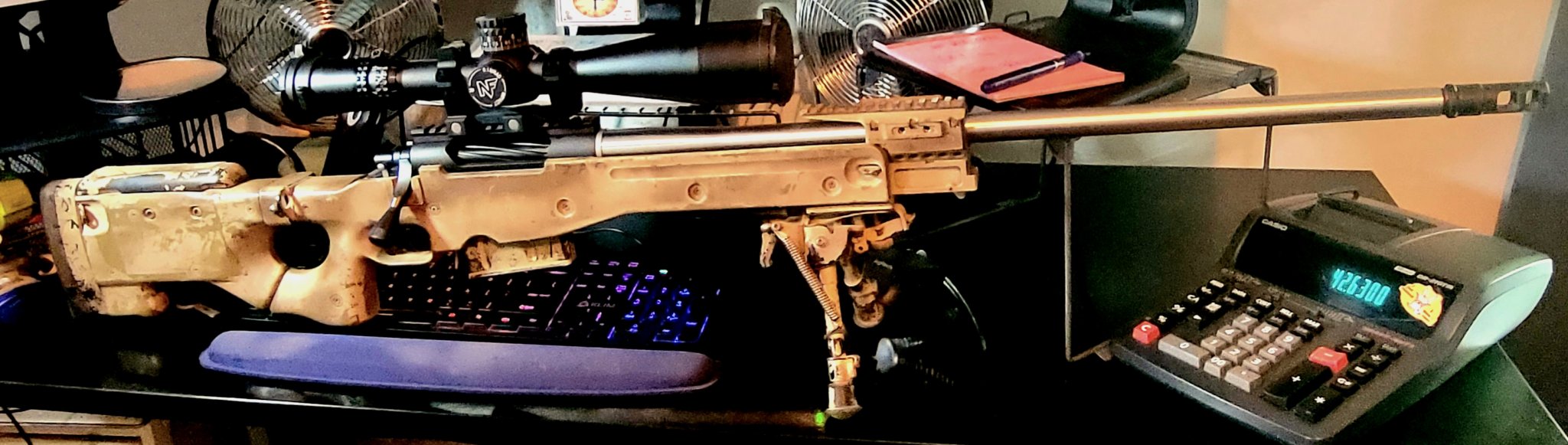

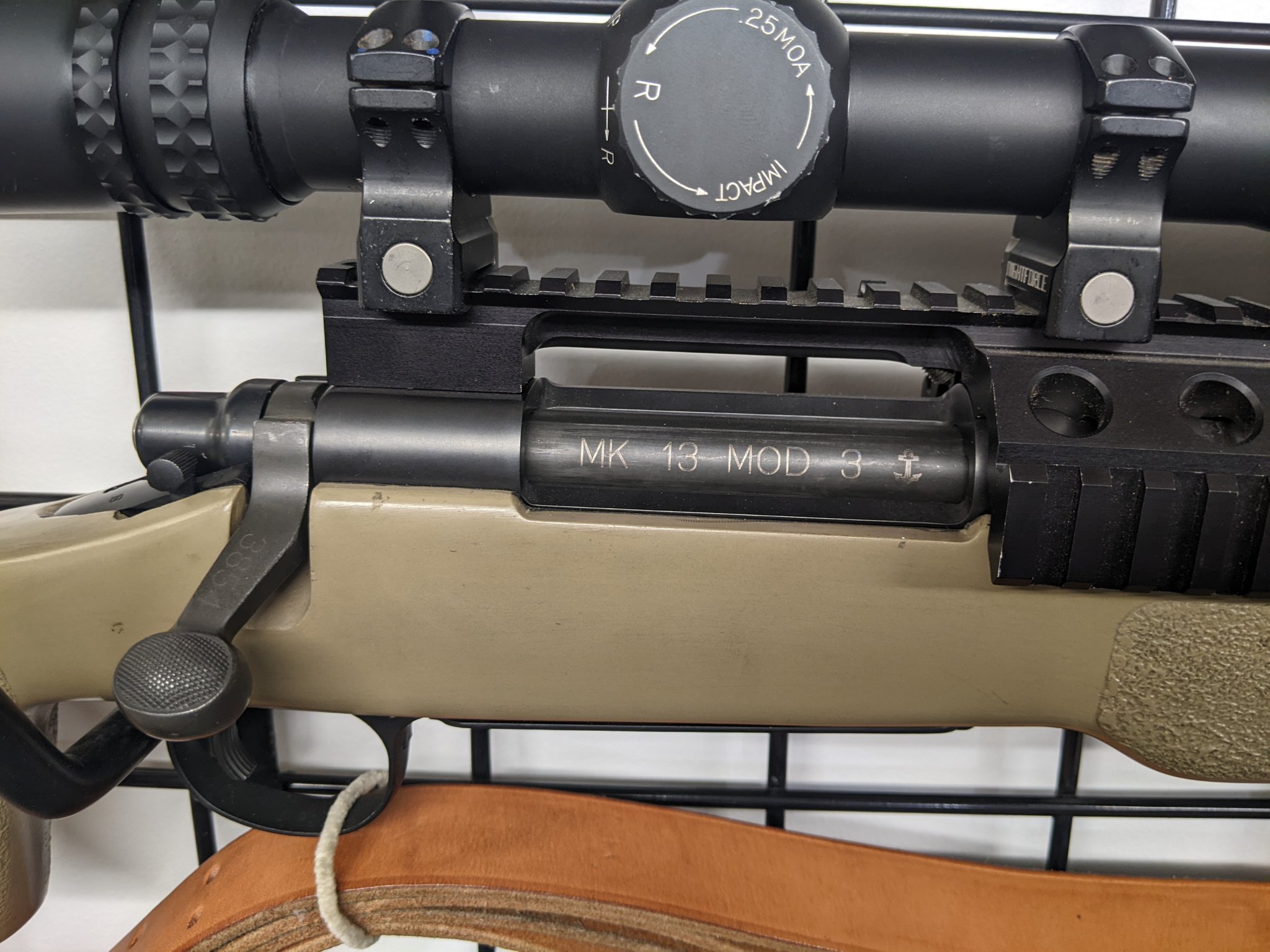

Looks like a Mod 0 to me not a Mod 3 that ran a suppressor?Although the bolt is marked mod 3?
Here is the other thread about the cmp auction stock.

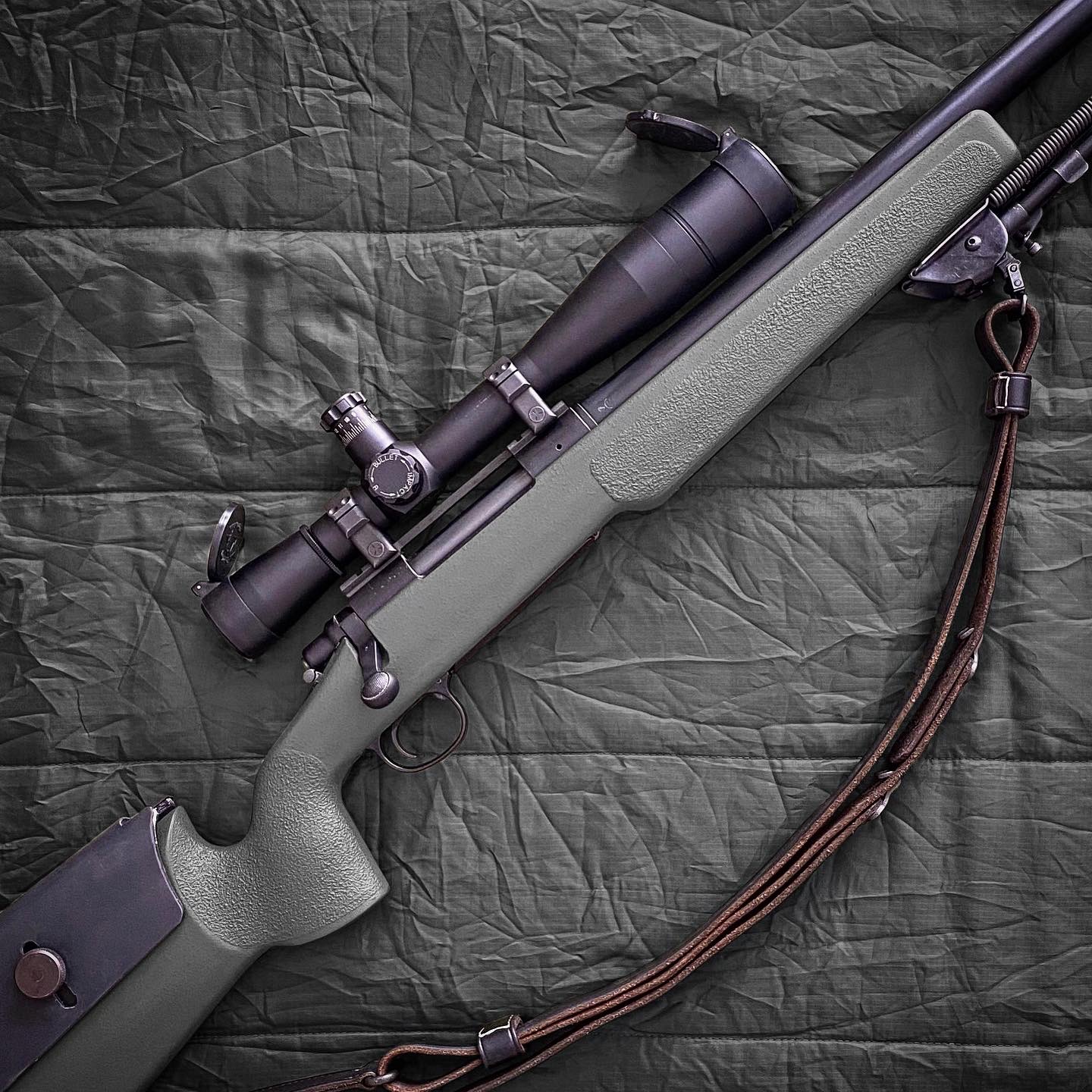

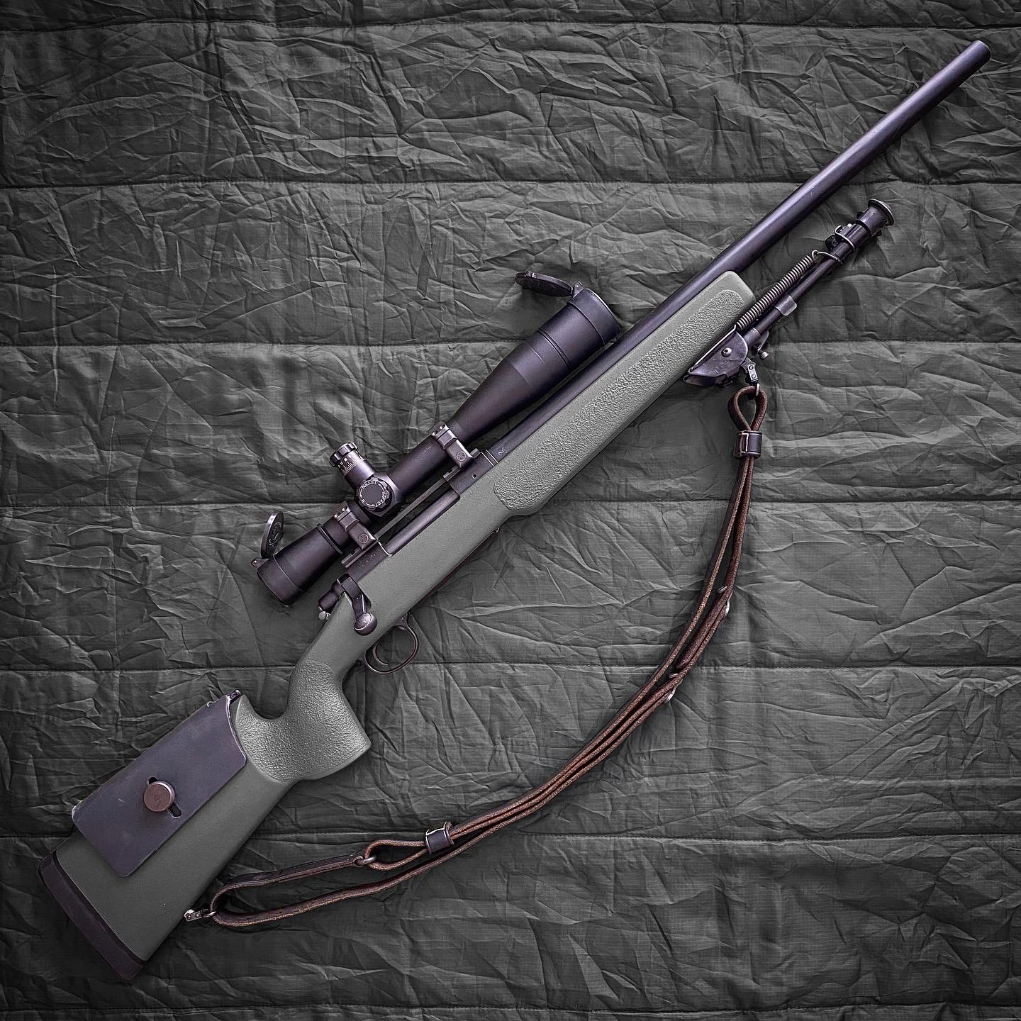

At the price this currently going for and what it will probably end up going for $$$$ it makes me want to consider selling my rifle. At least my rifle has a real mod 3 surplus barrel, matching stock/ mod 3 bolt, and the correct 8-32 mil-spec scope.

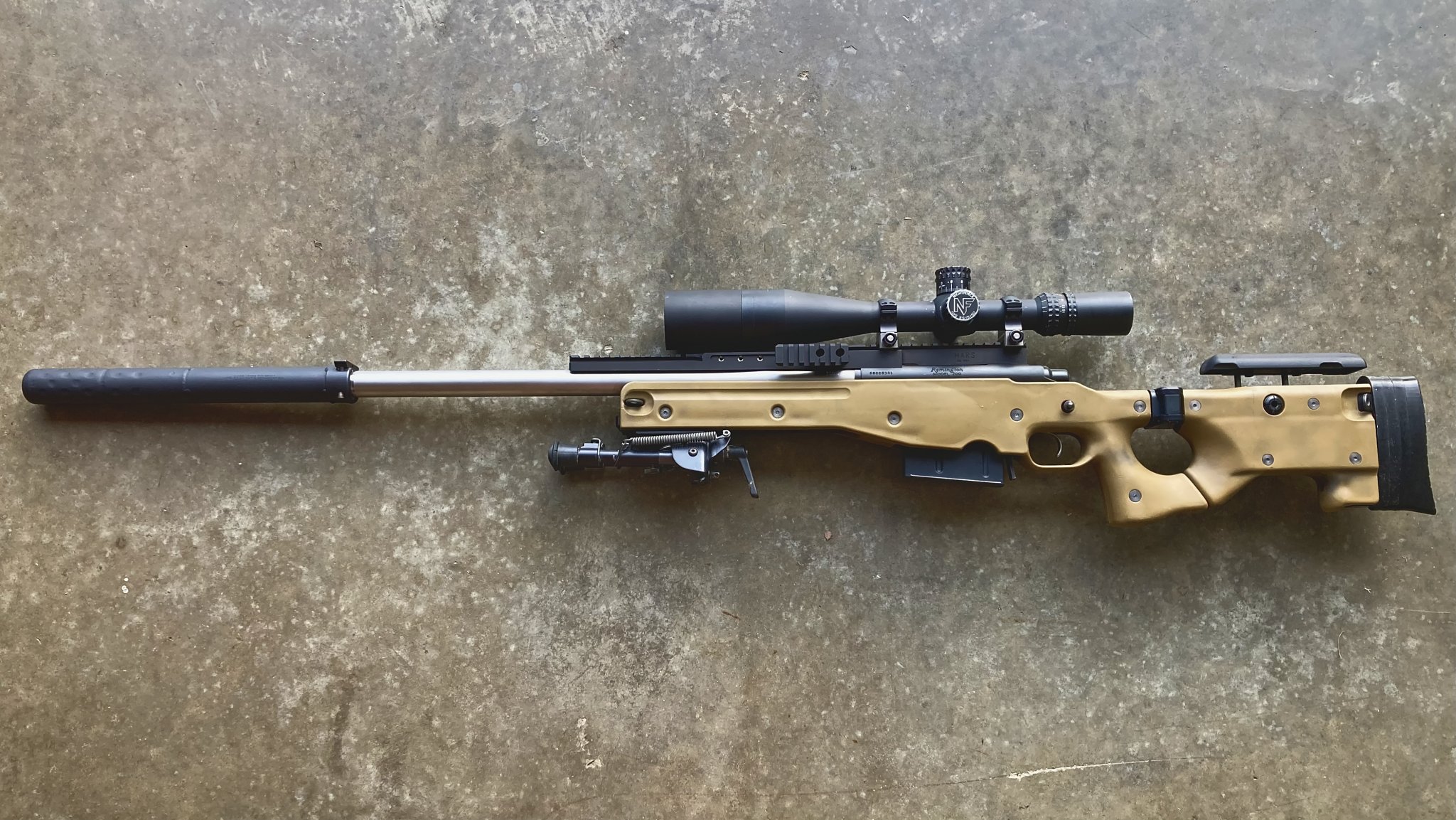

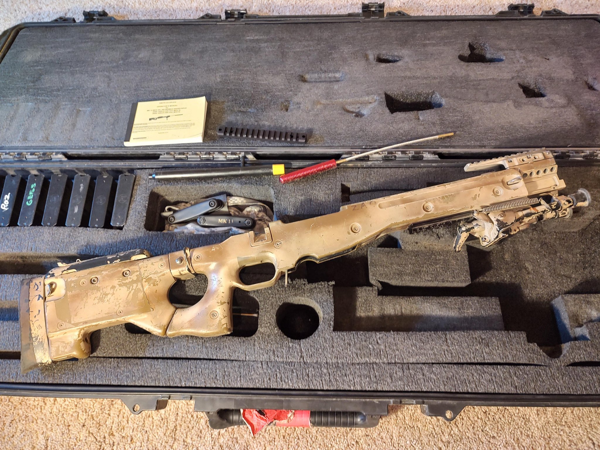

I have a Mod 5'ish "inspired" build with:
Tac 300 (non Mk13)
FDE AICS that was milled by LRI for the stiller
MARS that was fit by LRI to fit the Stiller action
Mk13 X-treme Mod22 trigger
Lija barrel but doesn't have the correct Aardvark contour
Incorrect SureFire SFMB-762-5/8-24 brake
The ATACR and NF mount are not correct either
However, I received a very nice example of the issued kits yesterday. I'd like to get my build updated with better parts. The chassis was most likely assigned to Team 5 (picture below). I'd like to get a S&B MK13 Special Edition ($$$ though), or an older issued painted (well worn) NXS and the correct NF issued rings. I have Mil-Spec NXS 5-25 on my Mod0 return build that I could move to the Mod5, but that would be 100% "correct" either. My mil-spec has odd ZS HS 1/4 click turrets, so I am not sure what it is really for lol. I also have a S&B 5-25 that I could paint and distress but that would be a bad move as well.
I'm hopeful that @ilikebmxbikes, @0812guns , and other MK13 Guru's in this thread will chime in as to what they think would help elivate this Mod5 to the parts that the kit deserves. I'd be fine with an Army or Navy build, but rather have a Navy spec'd rifle. I may just prepare my bank account to copy the rifle as picture below with the fella in the blue jacket and ask for help to trackdown the correct parts.
