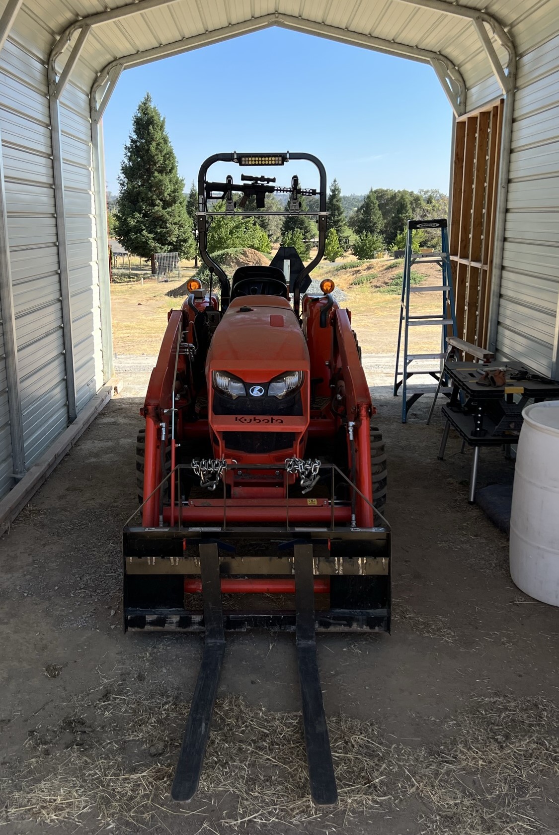

I spend a decent about of time on my tractor (mowing, dirt work, etc.) and have been thinking about something similar. Missed a few opportunities to smoke coyotes while working in the evening. Here are a couple products I have been considering:
https://www.artillian.com/products/rops-mount-bar-attachments/
https://www.thegungrabber.com/310vt-vehicle-transport-gun-rack/
Also considering fabricating something myself.
I have mounted other stuff to ROPS (lights, toolboxes, etc.) and U bolts work well. There is a lot of vibration though on a tractor (and probably a ZT too), so they can come loose if you don't take steps to mitigate it. I put a piece of heat shrink tubing (the same stuff used for electrical wires) around the "U" portion and locktite the nuts. I use 2 nuts on each side (1 regular, 1 nylock). Depending on what you are mounting, it may be worth also putting a rubber backer on the mounting bracket to reduce vibration transferred from the ROPS to the bracket/load.
