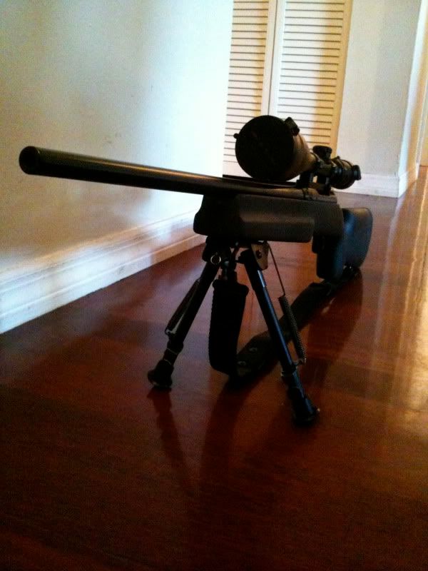

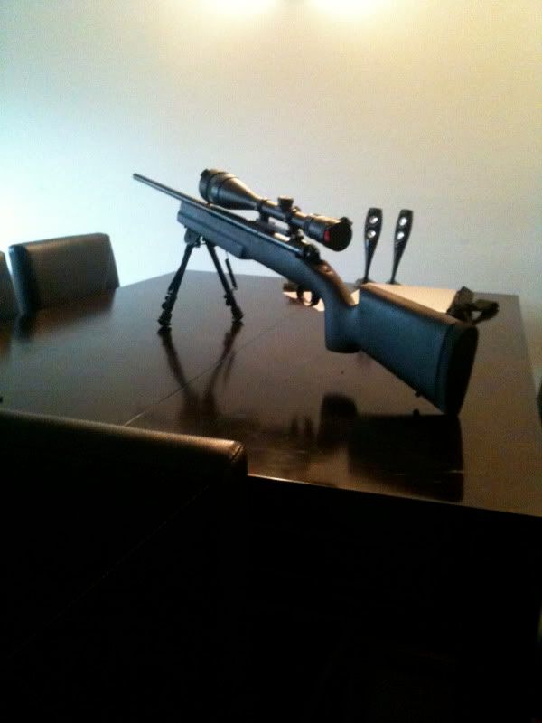

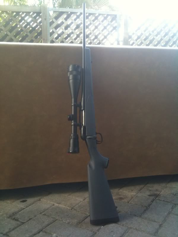

Started with simple platform the stevens 200 in cal 308.
threw on a bi pod and the gun shot great. the only issue i found with the 200 was the god awful stock. The stock on a gamo gun feels better in comparison. It was extremely flimsy, the stock can easily be warped with a minor adj of your hand, especially when shooting with a bi pod.
I was just able to install my new stock today. my first impressions were great i have not been able to take it to range yet but the rifle feels great. Installation was simple, everything fit flush. i ordered the stock online from stockystocks, the service was incredible, i shipped ground and it was here the next day. (may have something to do with the fact that they are 35 miles away)
i look forward to trying it out at the range,im hoping for less recoil with this stock. the recoil was not friendly with the factory stock.
any suggestions as to what the next possible mod can be? a better scope is on the list (im using a bushnell 6x18x50mm) its not bad but id prefer a tac scope over a hunting scope for this rifle. I do not plan on buying a new trigger, a minor adj and the trigger pull is smooth.
