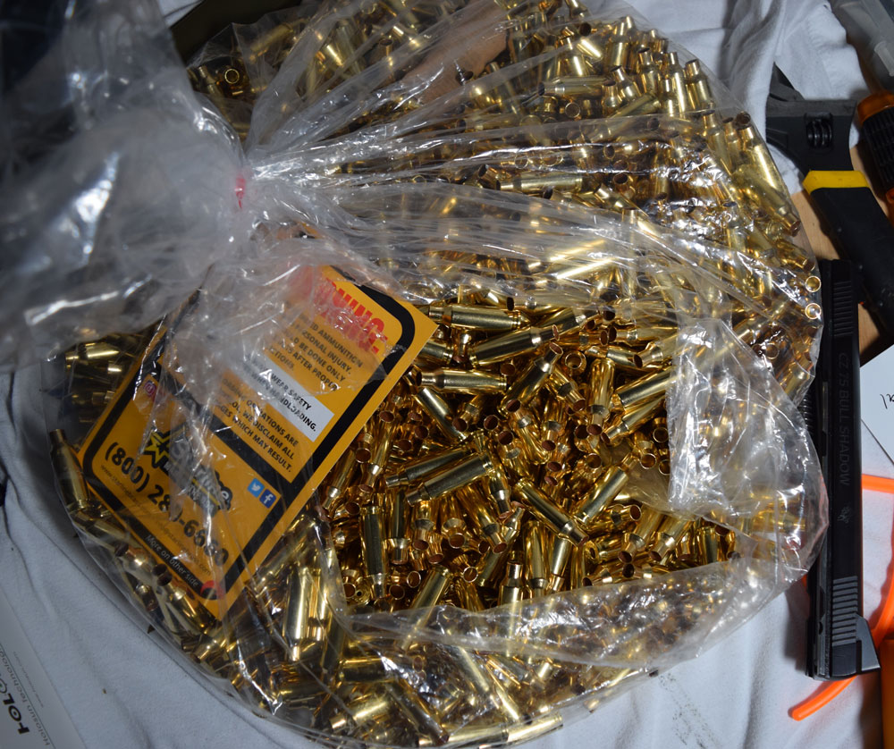

My brass shipped arrived a few days ago, it looks great!
No more conversions!
They will be loaded with 105 VLDs.
Have a great week - spew the pew...

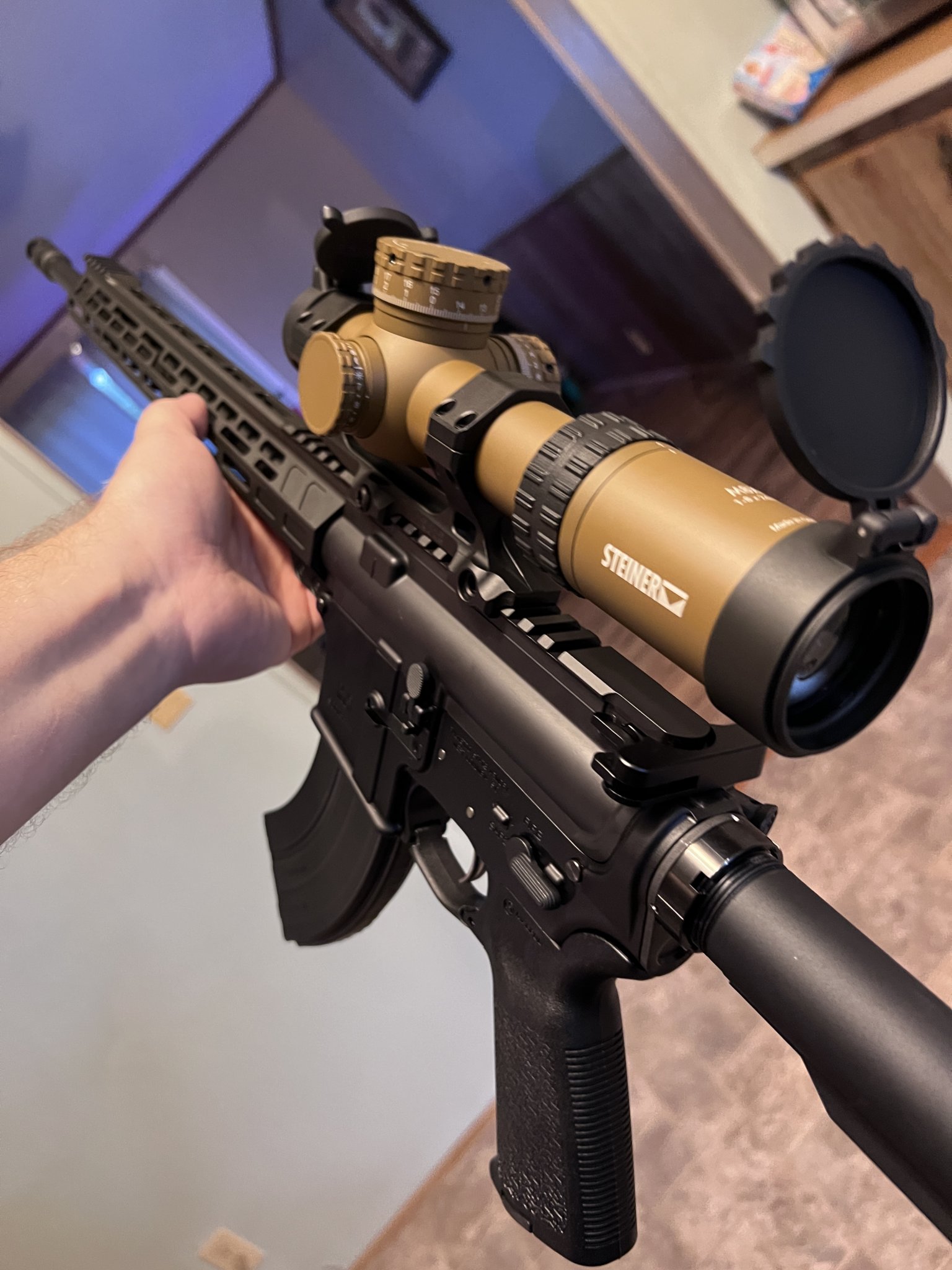

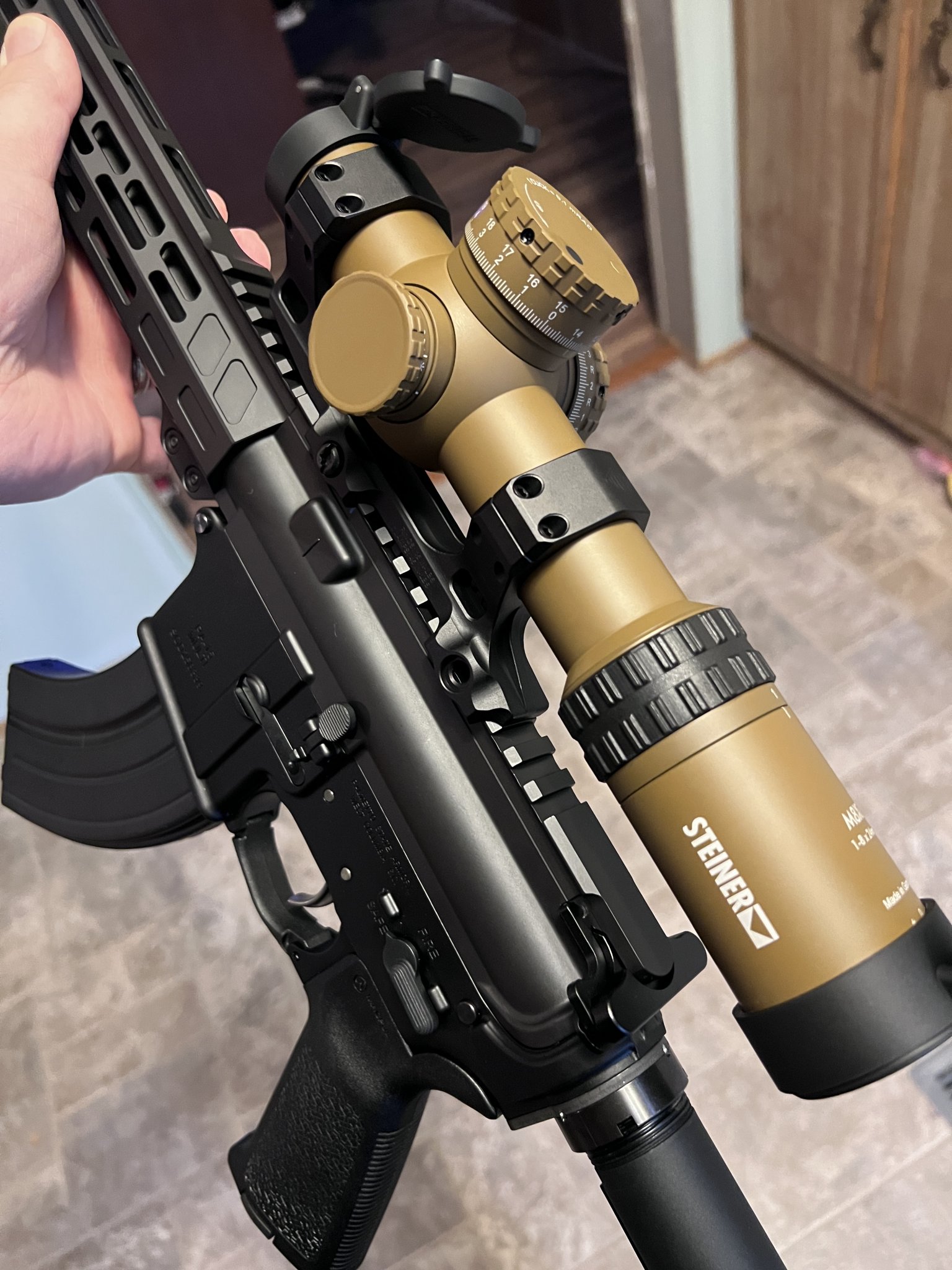

This is my first AR15!! 🙃 I did a lot of research on uppers/lowers/glass etc. And I ended up with these parts. I’m a pistol guy normally, so I’m just getting in to the rifle world.
I went after the best AR15 caliber available today without going with AR10 size and weight (Seems the 6 arc is easily the most ballistically capable bullet in this smaller package) and second thing I wanted was the clearest German glass on a LPVO I could afford.
CMMG 6MM ARC upper 20” $426
Palmetto Stealth lower with polished trigger $191
Steiner M8Xi 1-8 optic $1,709
Reptilia 34MM mount black $243
(2) Duramag’s 6.5G (26rd) $48
Prices include tax. Ready to zero it in!

Nice. You may find that you are “under-glassed” with just 8x on the top end, depending on what you want to do with it. If that’s the case, I’d suggest buy a 5.56 upper (or whole rifle) and putting it on there, and then getting a higher mag scope for the 6ARC upper.
Reactions: rpoL98
tps344,
Congrats on the new rifle.
Also, congrats on having the wisdom to buy good glass right from the start. I’ve seen folks buy an expensive rifle and put junk glass on it.
Hey yes this is my first time ever buying a scope for a rifle. I do admit, I loved researching high end glass and reading about them from time to time. So the idea of budgeting more on my scope than the actual gun has been in my mind for a little bit now.

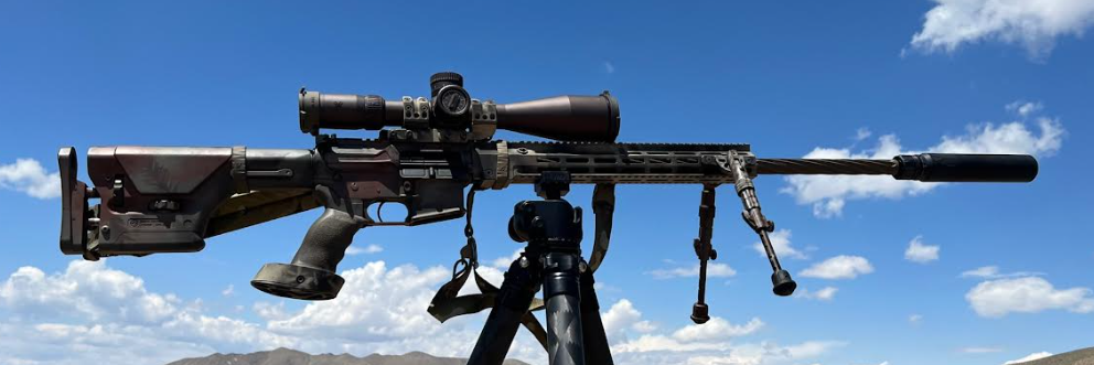

6ARC has turned out to be a really interesting intermediate option for precision. Some would say it nicely bridges the gap between 5.56mm & 7.62mm while staying within a small frame rifle. But from what I've experienced so far it's exceeding what I've traditionally done with a 7.62mm gas gun. With 110 A-Tips at 2725fps I'm supersonic to 1500 yards still, which is quite a bit more than my best 7.62mm load.
Granted, I went overboard with mine by using a 26" barrel...
I went to the range and zero’d my gun in for 100 yards, then started ringing steel quickly and easily. Not a single malfunction observed!! I was anticipating some sort of stoppages, but it never came. This was my first time ever shooting the rifle being a CMMG 6 arc upper and Palmetto lower. I’m using 6.5 Grendel mags (Duramag’s) 26rd. And it was butter smooth the entire trip. One of my bullets had a red polymer tip taken off. But that was the only bullet this happen to, but the weapon kept on chugging without any malfunctions, I had ejected that one round a few times making the weapon safe, which I think is what caused the red tip to fall off. I was extremely surprised how reliable the gun was.
Anyways, it’s dead on at 100 yards, and reliable so far. Being reliable is a pretty big deal. I had some serious concerns over it being reliable, but now my mind can rest a little.

It's incredibly soft shooting - feels like a 5.56mm, shoots like a 6mm Creedmoor that rides the short bus. I have no idea how long the barrel will last, but when it's time to replace it, I'm going with 20" instead.

Its been a while since I've shot the 6ARC. I saved it for last. This day was a long time coming. I had just got my Edlebrock Double Pumper tuned for the '78 Bronco so I loaded up (most) everything and went to the local range. It was HOT, but that meant no waiting. I skipped taking the pokemon mile rifle and the 6.5CM because it was only 200yds. More on those later/diff threads. anyway...
FF to the end and watch how this 6ARC setup shoots. It barely moves, you can spot hits at 16x. The last mag was using the new Starline cases that shot great.
tps344 that is an amazing first build. You will love reloading! I can't believe you got a Stiener glass for a first scope, that is a steep hill to keep up with! Congrats and I've enjoyed catching up on this thread. Will post more when I get to a longer range. Until then Spew the Pew and Press or cry like the rest!

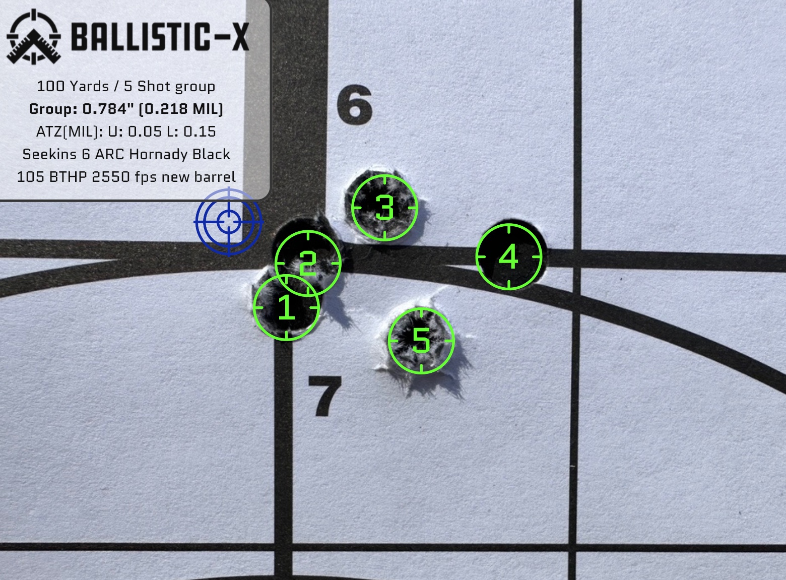

Not trying to be a one upper just showing what Hornady Black is capable of. Some barrels prefer different ammo as mentioned. Reloading helps for this reason.
Also, the more you shoot the better you’ll get obviously.
Ballistic-X-Export-2023-03-21 15:55:19.677738.jpg
Reactions: x248716x
