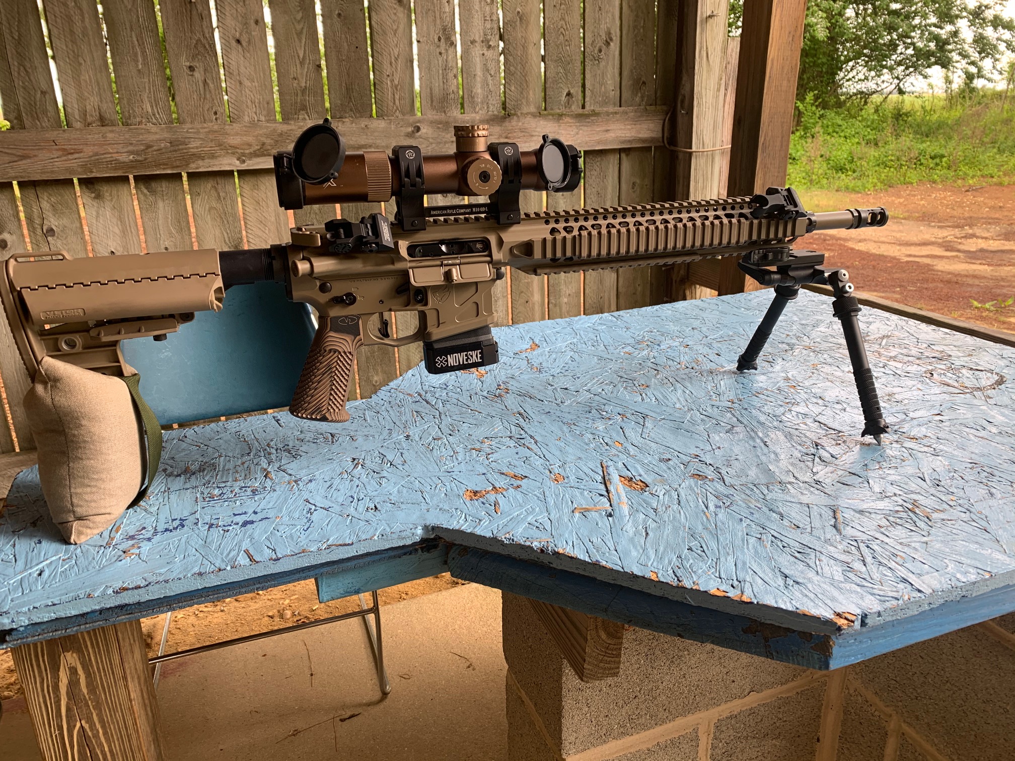

Yes a good bi-pod will make a difference. Skip wasting money on a mag pull bi-pod & just get an Atlas cal.
It's often overlooked for AR's, but It's a good idea to use a stock designed to give good support for a rear bag.
This is a Vltor Imod Clubfoot stock & Atlas cal for visual.
Yup. The VLTOR Clubfoot, Daniel Defense, and LaRue stocks are good for bag-riding. For fixed, the Magpul PRS is nice for riding the bag.
DD actually gives you some stock lift with recoil since it acts like a wedge/ramp countering muzzle rise.
iu
LaRue RAT has just enough of a flat toe to stick in the bag and not slide off like most carbine stocks, and it’s made of very substantial polymer with a cool adjustment and removal system that doesn’t require any real effort. I have 2 of the old school VLTOR Clubfoot stocks that are lighter weight, not as strong as the IMOD:
iu
For bipods, I use a lot of Harris and the new TBAC bipod. The TBAC bipod is pretty sick, has a wide cradle, and is one-hand friendly for making adjustments on the fly.

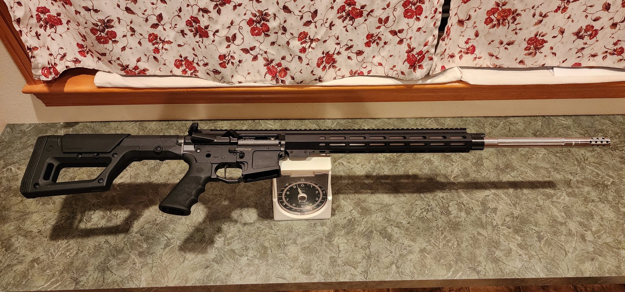

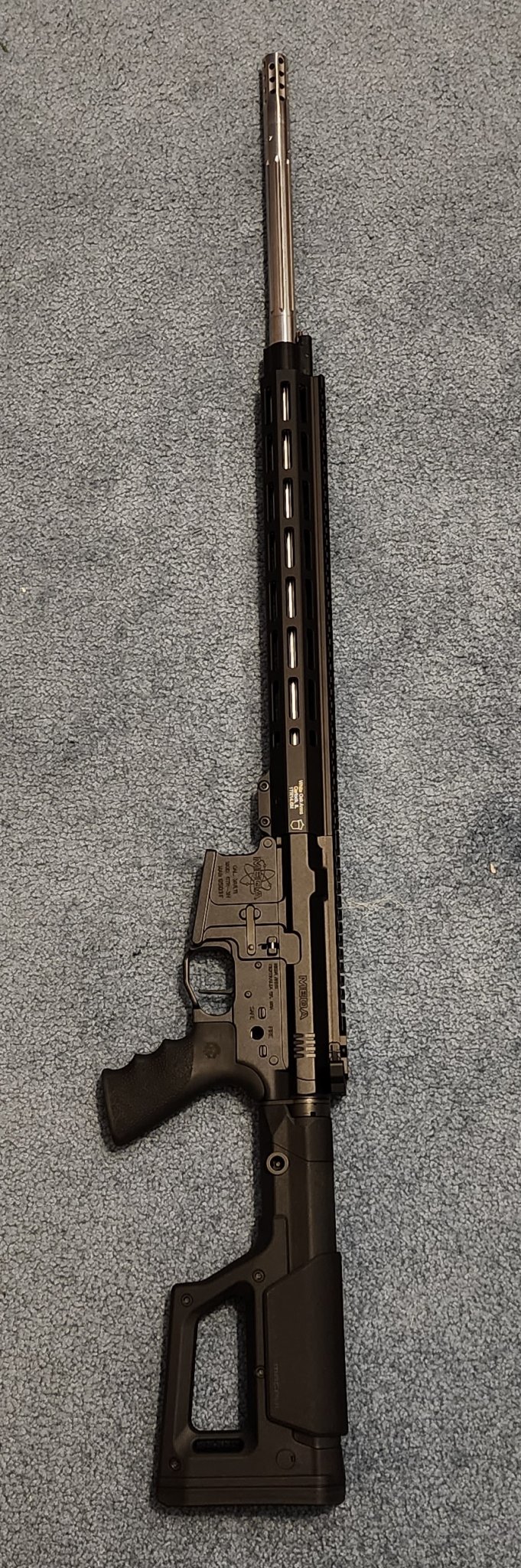

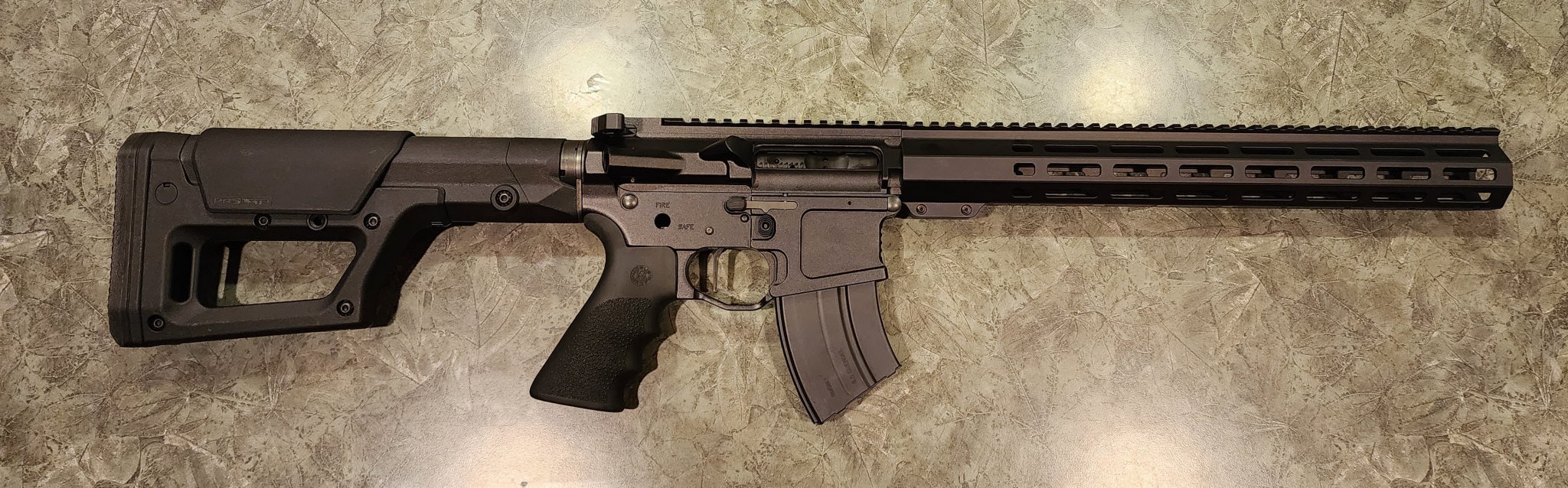

Well I've been kicking around this build long enough.... I ordered up a x-caliber barrel on halloween with their 30% off sale. Sounds like it should/could possibly show up the 1st week of january.
Specs are:
416R Stainless Steel
Length: 24"
Contours: AR15 Heavy .980, .875GB, 850
Straight 8 Flute
Twist Rate:1:7" Twist 5R Groove
Gas System: Rifle + 2"
Gas Block Journal (Length): 1.92"
Gas Port Options: Will Use Adjustable Gas Block (Slightly Oversized Port)
Muzzle / Crown: 3/4"x24 Threads
I'll be interested to see what it weighs...
Specs are:
Length: 24"
Straight 8 Flute
Awesome! I ordered a 6.5 creedmoor barrel from X-Caliber on their Labor Day sale and it came the first week of October. About half the estimated lead time.
That would amazing, I'd end up with it before christmas! I've got my receiver set, LPK, trigger, pistol grip, and buffer assembly. I still need the adjustable gas block, gas tube, hand guard, stock, and scope....
Specs are:
Length: 24"
Straight 8 Flute

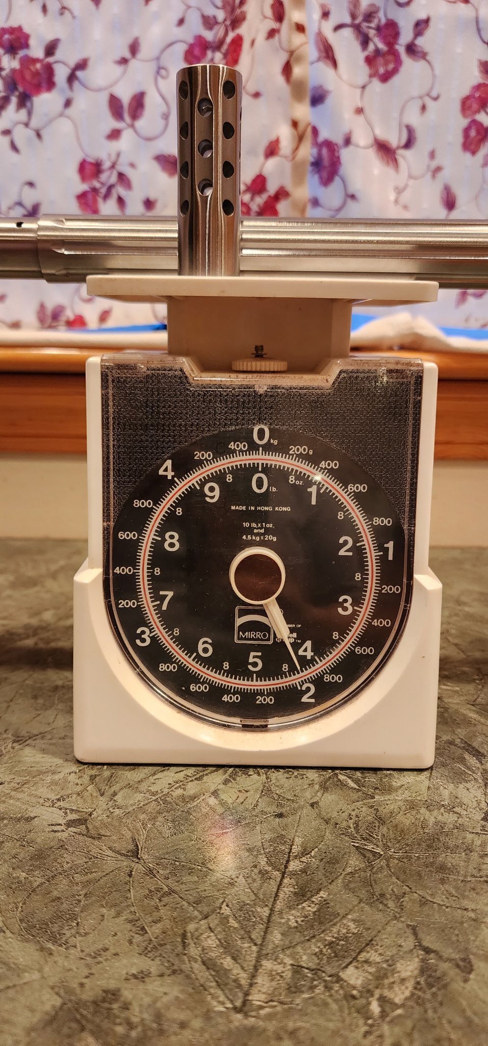

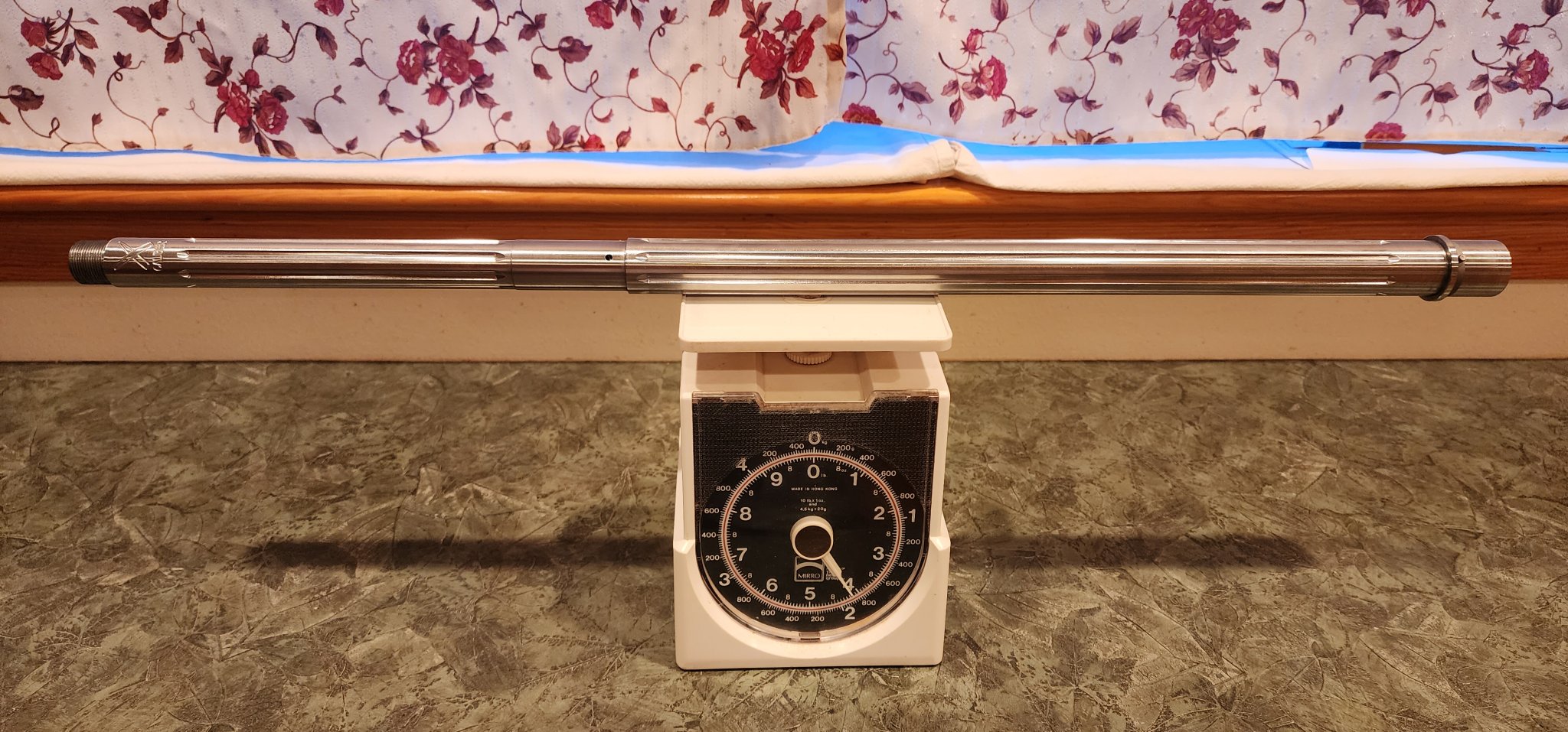

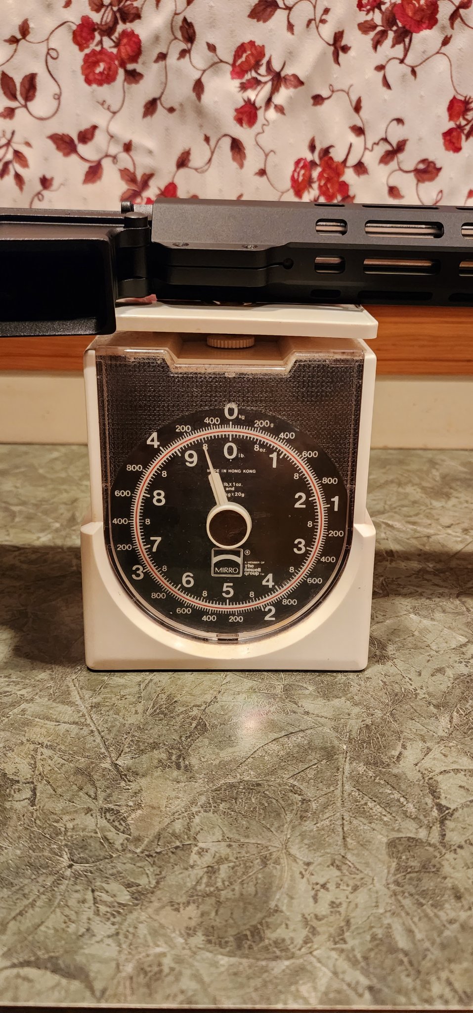

The mail man brought the xcaliber barrel and BCG for the 6mm ARC today. My curiosity couldn't wait so I grabbed the scale and the barrel with the break comes in at ruffly 4lbs 5oz. Ah hell might as well mock up the whole gun minus some small parts and the buffer weight/spring...... and survey says.... 9.5lbs. So it will definitely be a 10lb rifle before the scope.
that's a hefty-looking barrel, what's the gas-block journal? .875" or .936"? probably the main factor for weight. and the not-so-light PRS-Lite.
but still lighter than a comparable large-frame AR in 6.5CM with similar specs.
It's .875" at the gas block. Xcaliber calls it his AR15 Heavy profile at .980, .875GB, 850. I thought about going with his SPR profile at .980, .850, .750 gas block, ending .730 but I felt it would whip around to much if I ever get a suppressor. The other thing that is hurting me for weight is the receiver set being heavier billet. I do have a aero precision receiver set I can weigh to see just what kind of difference there is. But I will say that right now it balances really nice in the hand. The point seams to be just foward of the mag well, which I'm sure will shift toward the stock once the buffer and Spring goes in

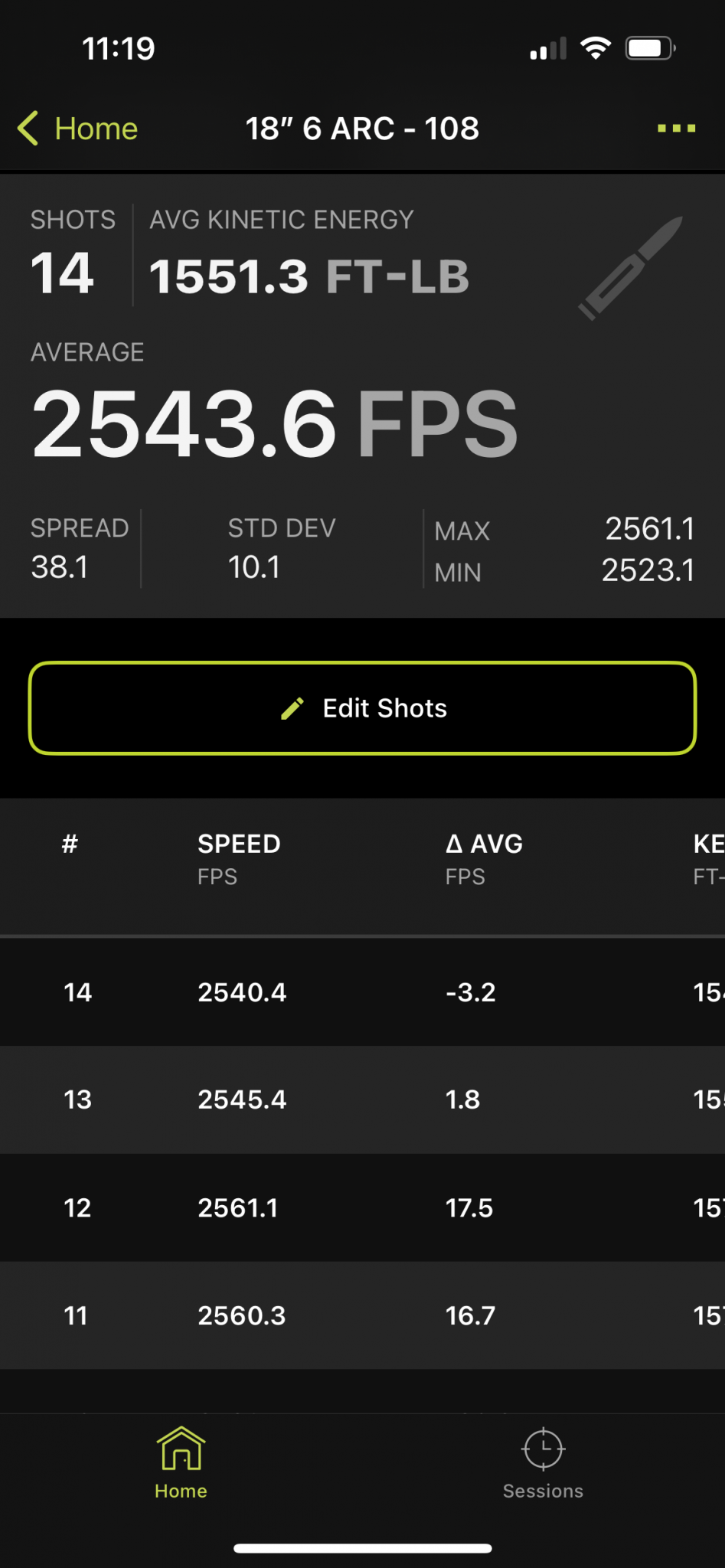

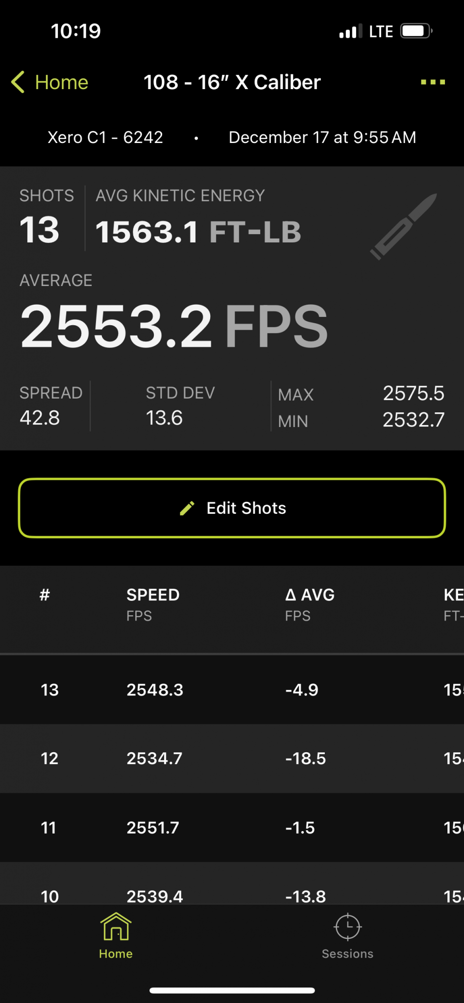

Picked up a 16” X-Caliber barrel in their Halloween sale to replace my 18” BA. Also got a Xero so was excited to see how the two compared with velocity.
Both shooting the same lot of factory 108 ELD Match.
Both shooting suppressed with OCL POLONIUM
This was the first 13 shots from the 16” - average 2553
The 18” had about 300rds down it - average 2543
So I gained 10fps, lost 2” of barrel length and lost 15.1oz of weight. Seems like a win-win-win to me.
