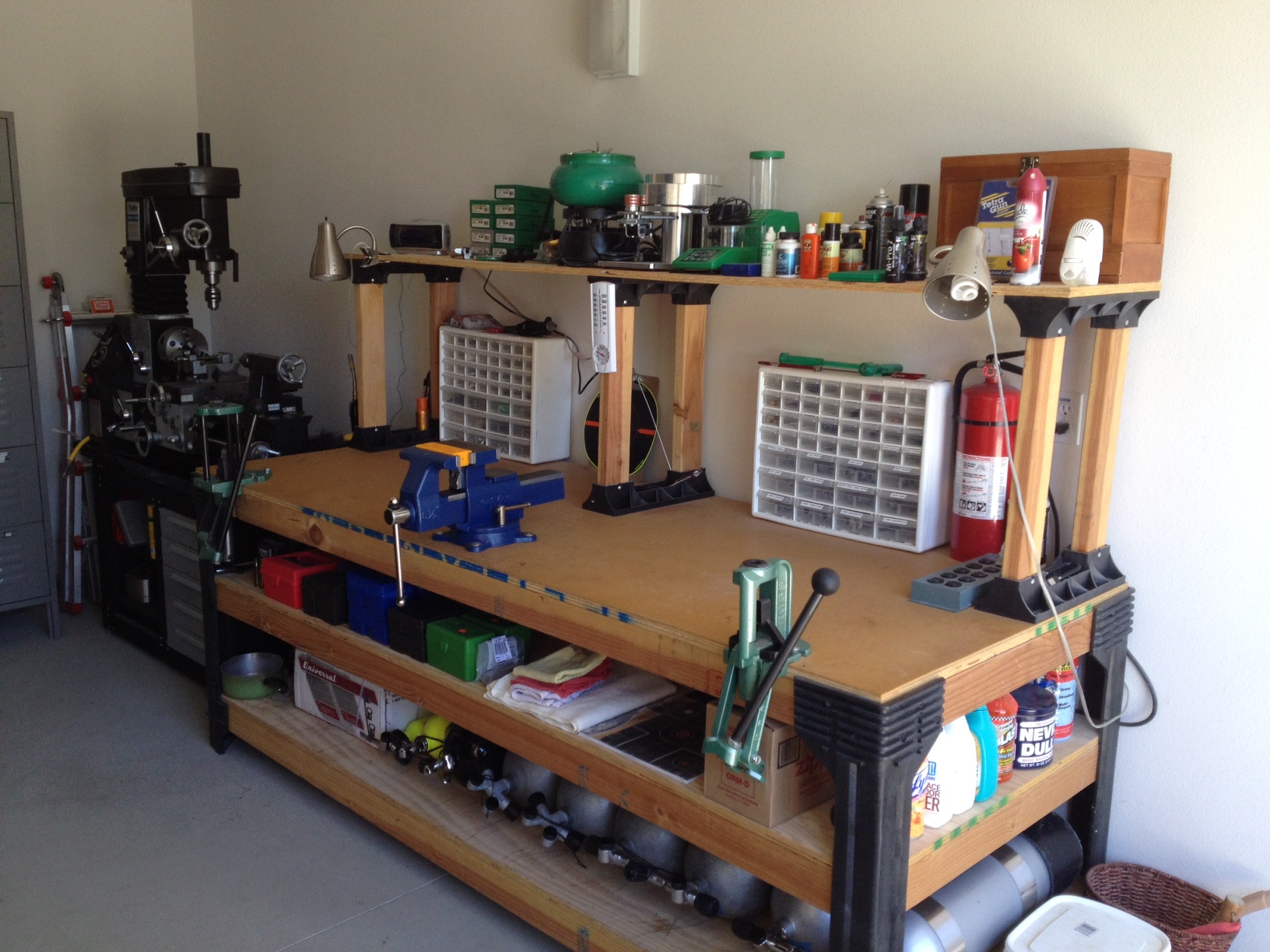

Finished the upper cabinet. Need to assemble the 550 and I can finally get back to loading and shooting.
I just went with a basic leg kit like this...
2 x 4 Basics
added some plywood and 2x4's and came up with this, if you don't have the ability to cut the wood, any local store (lowes, home depot) will make the cuts for you. All you need is a bag of screws and a screwdriver/drill.
