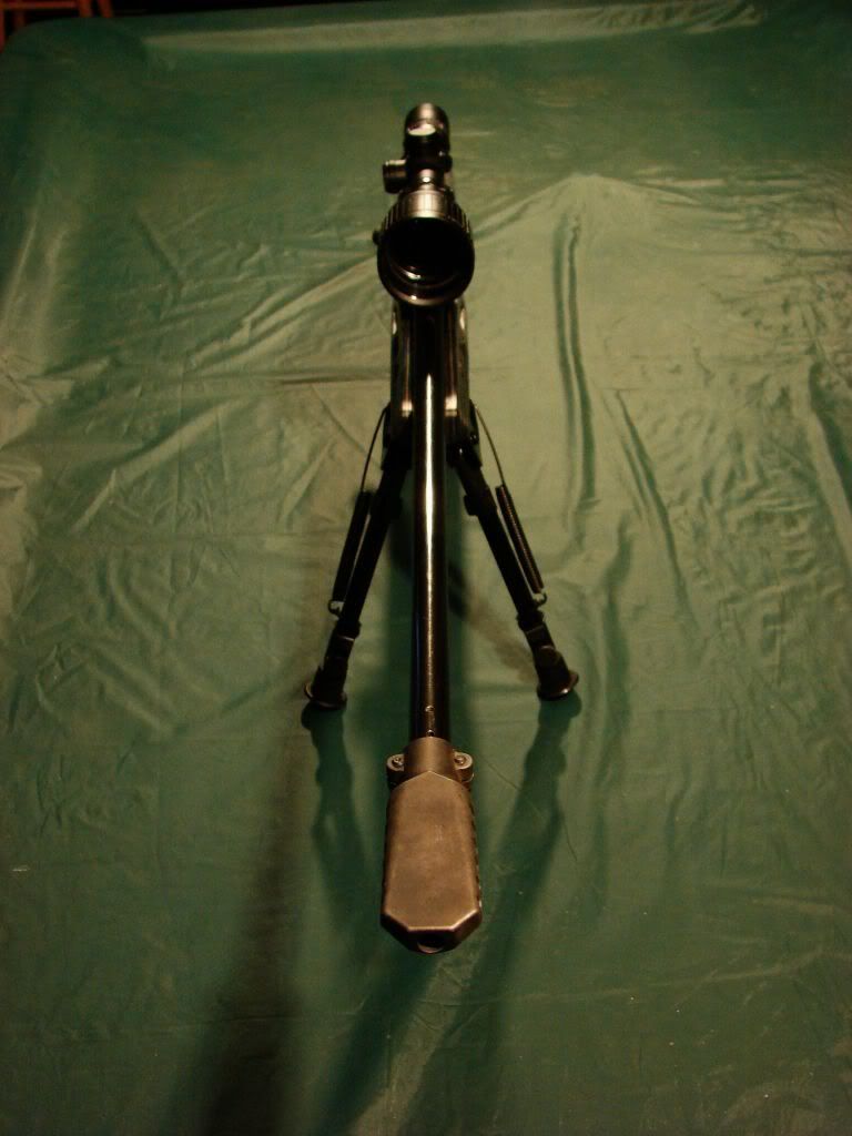

Here is a pic of my custom 7mm with Delta Brake.
Re: New TITANIUM MUZZLE BRAKE
<div class="ubbcode-block"><div class="ubbcode-header">Originally Posted By: Deadly0311</div><div class="ubbcode-body">maybe it does tame the recoil but that thing is ugly as hell....</div></div>
LOL, ive seen worse! (Jp)
Its easily removable for hunting or if you decide to just take it off. Loosen the two set screws and unscrew it. Can be tuned by the same method. I thought it looked pretty cool on the right weapon.

Not to harsh your groove -
While I understand that the vid is trying to convey that the brake is so good that even little kids and non shooters can shoot an LA weapon with (presumably) factory ammo - no one here cares.
What people here are interested in is muzzle rise / dust signature / weight / how it stacks up to brakes that are in common usage for folks with similar interest.
Also tell us more about the attachment - compression fit from 2 bolts? Does it come loose? How many rounds have you shot to say it doesn't? Do you need to loktite the bolts? Does it mar the finish on the muzzle?
And the biggy - what if any impact does it have on accuracy?
Good luck

<div class="ubbcode-block"><div class="ubbcode-header">Originally Posted By: VjjR</div><div class="ubbcode-body">Cast??? probably would be more effective if it was more caliber specific. </div></div>
Yes, it is titanium cast and then the ports are machined. Does not need to be caliber specific as the bullet never touches the brake at any point.

are you sure it is machined? you can clearly see casting marks in the ports themselves.

I like the idea of a cast titanium brake. I have a couple questions.
1. Is it meant for a threaded barrel and the clamp is just to keep it "timed"?
2. You mentioned that the maker has done years of research, however, DOD has basically universally found that any well designed brake over 3 ports is just adding weight, and even 3 is pushing it really. Was his research done through his own experimentation or does he have some literature I don't have and would he be willing to share it (literature) with a student of small arms design like myself?
3. DOD studies and some fairly recent experimentation by an avid shooter (article posted on 6mmbr.com) shows that there is an optimum position and size for the baffles for both accuracy and efficiency of the brake, this position is caliber dependent. How does his brake perform being a caliber universal brake, i.e. is it's accuracy fine for fieldwork or was there really zero increase in shot dispersion with the brake installed (firing from a fixture or equivalent)?
Thanks,
Justin

Justin, These are questions that a little over my head. Give me a day or two to address these with Cornell and get his response.
The question of the clamp, I can answer. The brake mounts very snug and the clamp is used for tuning and added security against loosening. I dont think its very likely the brake would loosen over any amount of shooting though.

The owner told me he did additional machining after receiving it back from the foundary. I will confirm that. Its possible he just cleaned the ports and machined the clamp and threads. Im not the designer, just trying to help him out as he isnt very computer forum savvy.

Rob01, The brakes are available in 5/8-24 also. As long as its 5/8, Cornell said any thread size is available. He was comfortable with 5/8-18 on his rifle as they were not quite as fine as the 24. That was a good point to make on thread size.
Massoud (Justin),
As for your questions earlier on design. "When I first started to plan the design of the Delta Brake, I wanted something noone else had. I believe in thinking outside the box. My original design worked so well with 5 ports that i decided to add one more. This effectively reduced muzzle flash even further. As the brake is made primarily for .280 to .300 caliber, this is the caliber range that performs best. I found zero increase in shot dispersion and was actually able to achieve a 3 shot 1/2 MOA group at 100yds with my 300 WBY Mag and hand loads.This was better than I could achieve prior to adding the brake."-Cornell Drajan
Total weight is as follows.
Titanium Delta Brake-116 grams
Steel Delta Brake-200 grams
I will post the type of Titanium Alloy as soon as I find out for sure.
