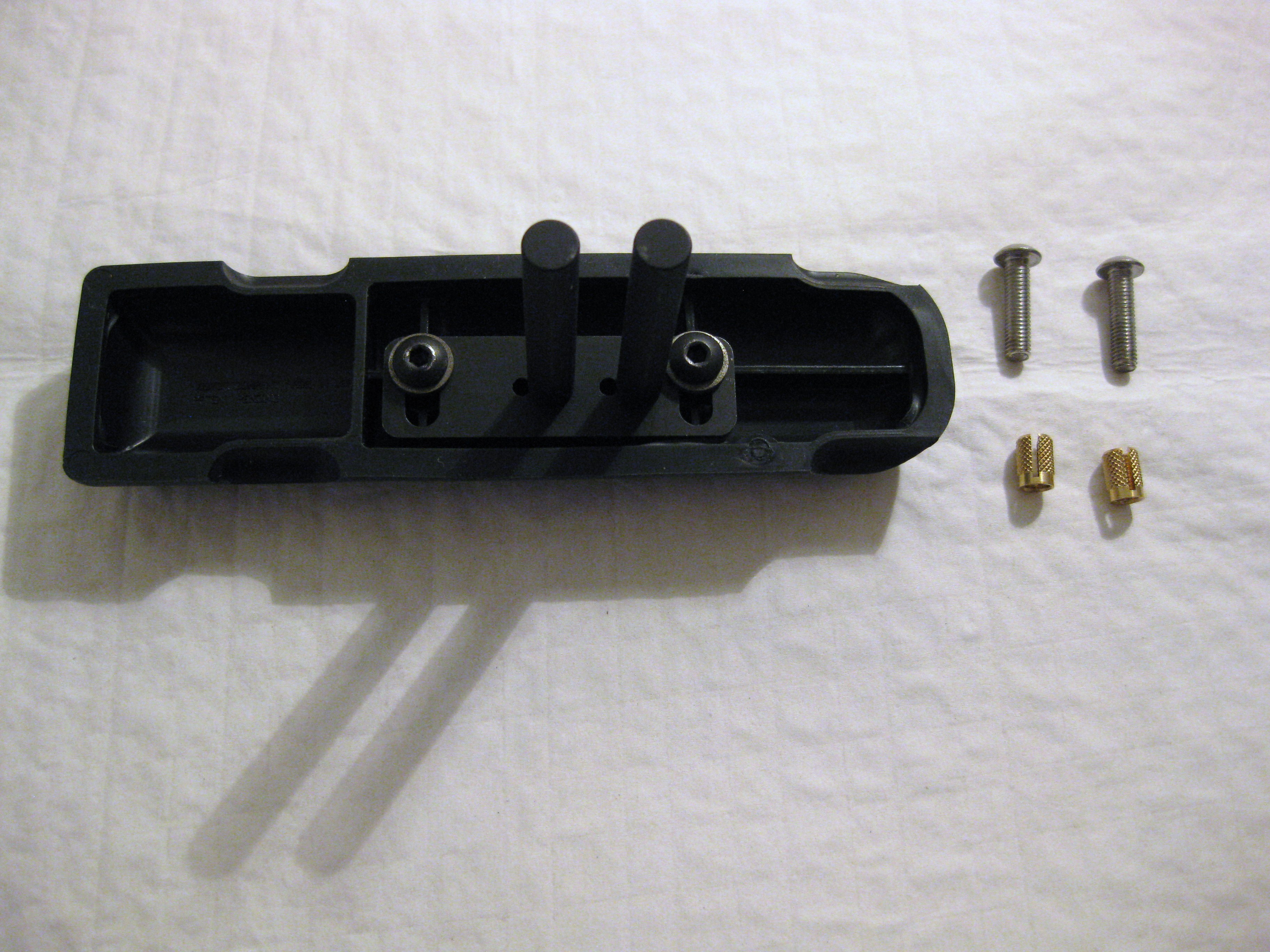

Adjustable cheek mount with victor grippy cheek piece, the long screws and brass nuts I did not use with the victor grippy. I did have to use washers with the screws provided because the screws were bottoming out before they where tight.

eravelo the mount comes with instructions. If yours are missing we can email them over if you send me your email.

will do, but i figure that I need to use the long screws and brass nuts with your overmolded cheekpiece. The OP used it with a Victor Grippy.

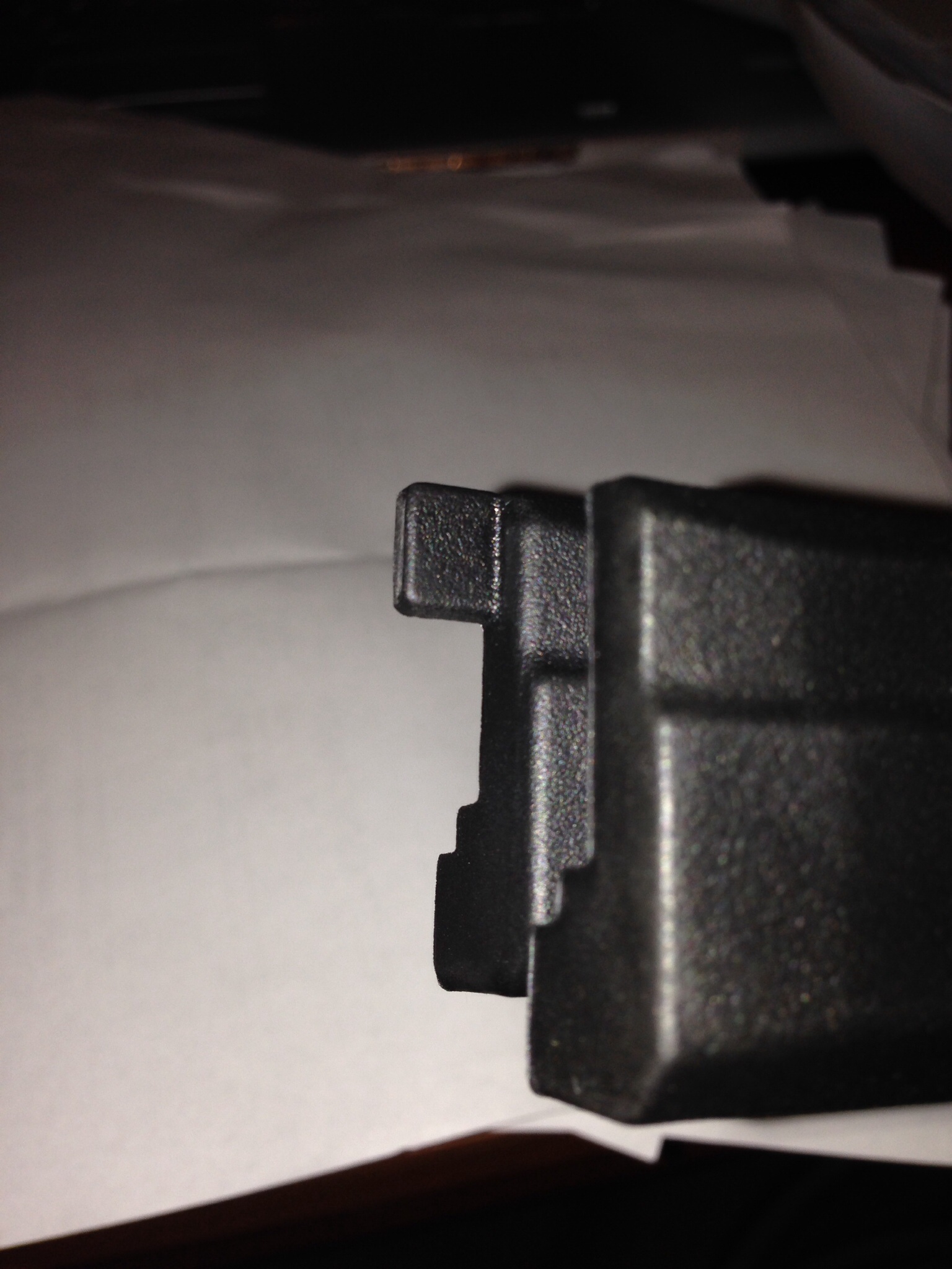

Another question, I purchased the larger grip panels for the X ray, but there is a tab on the forward portion of the moulding that interferes with the X-ray fore end. Are these large grips correct for the X-ray? In hindsight their description on the web site doesn't say so, but the detailed description of the stock says they fit. Should I just whack the tabs off with an X-acto knife?

That doesn't look like leftover flashing from the mold to me. I'd assume an X-acto knife is the ideal cure, but Justin will probably have some input.

Yep. A piece of very fine grit sandpaper can help, too.

My large grips had those tabs as well. I just trimmed them off and now they fit just like the small grips.

-The tabs on the large grips do need to be broken/trimmed off as noted. They fit into the W3 but not the X-ray.
