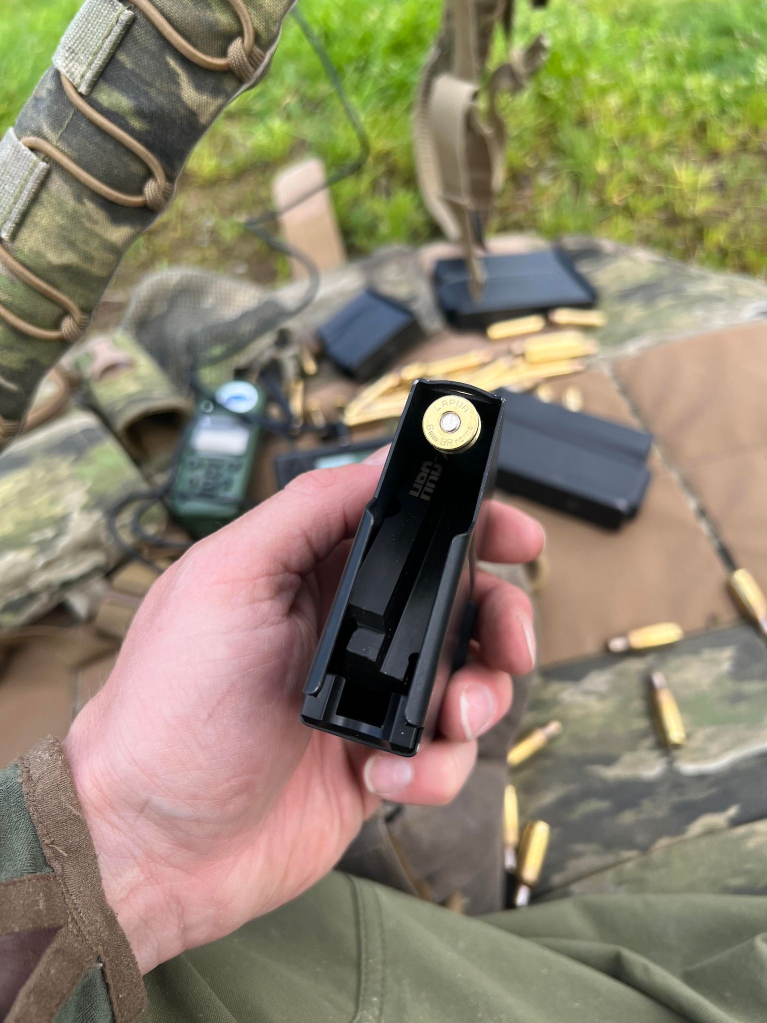

Lads,
What magazines / followers are you running for 6BR in the AT-X?
And, did you need to make any tweaks?
I've had a couple of nose dives in my AW + HRD mags on the last 1 or 2 rounds.
Haven't tweaked any springs or feed lips yet.
108gr ELDM in Lapua brass.
It shoots amazingly well, have only had 200 rounds through the new barrel and maybe 5 stoppages, so something I'd like to get on top of.

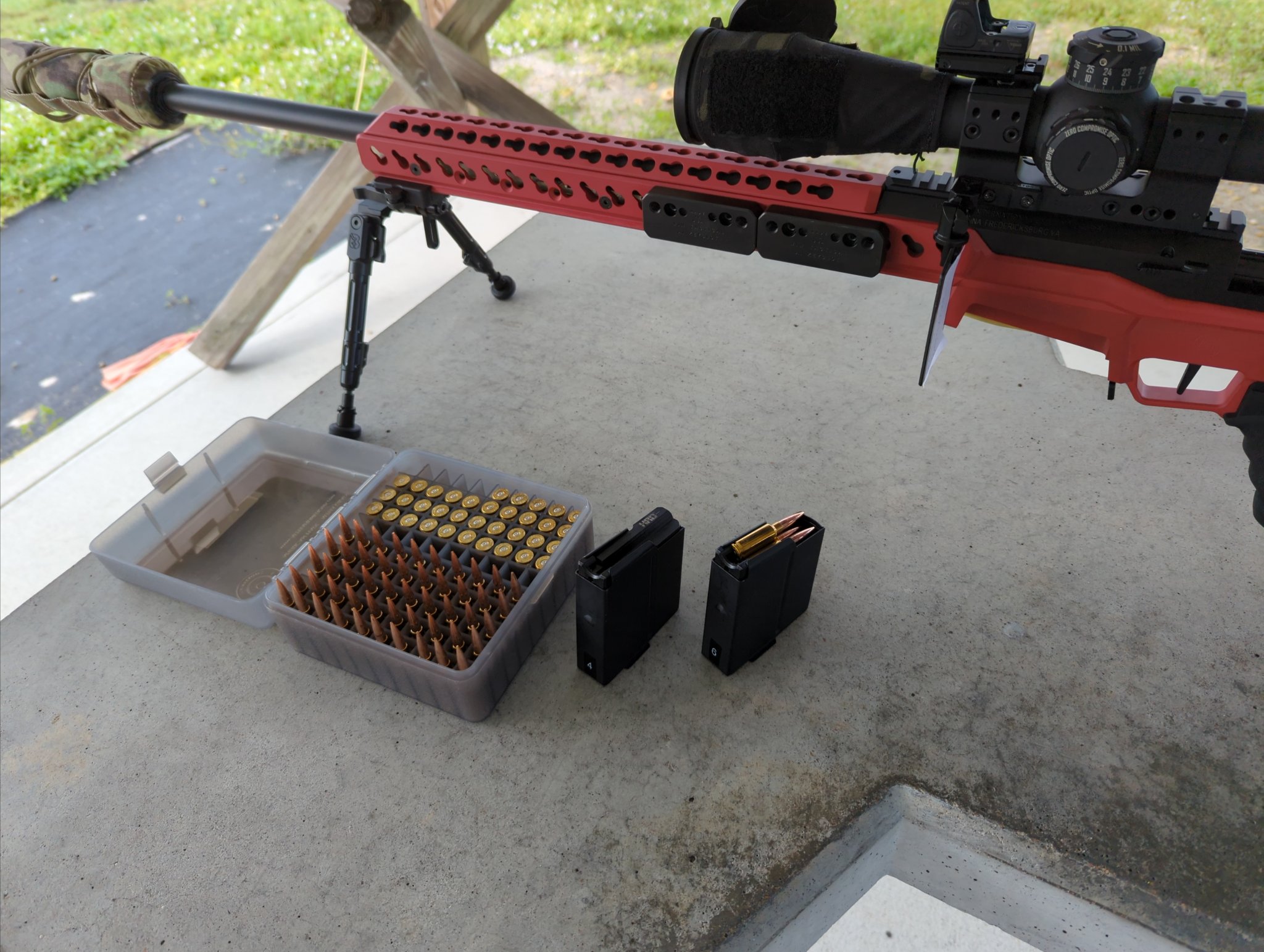

I'm running AX mags with HRD spacers with 6 Dasher. I have 3 mags setup with spacers and they all work the same. As long as I close the bolt with some speed they feed reliably. If I run the bolt forward slowly the last round can nosedive like your image.

Hi mate, I’ve been running HRD kits in my AT-X chambered with 6BR. Put 280 rounds through it without a single feeding issue. Had a comp last weekend and didn’t miss a beat. Besides the kit itself, all I did to fix feeding with 6.5CM & the BR (which I’m sure you know) is open up the top of the mag to match the bottom right near the rib in the middle. Cheers And same AW mags

Also running the HRD kit in my AX and aw mags. No issues with the AX mag. The AW mag did have issues before in my AX/AO set up but so far in the ATX no issues. I can measure the feed lips and let you know what mine are at for reference.

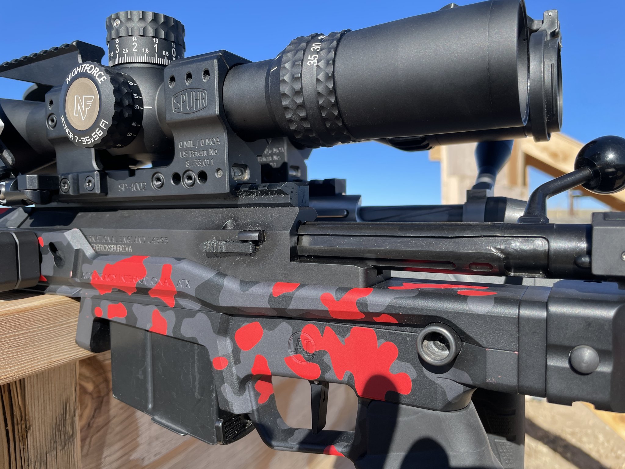

The key one was 46 mm or 1.835” from top of barrel to the Arca rail flat on the bottom. I think that could be a little higher as you see from the photos. Dale said he'd keep the measurements on file for the next AT-X customer.
