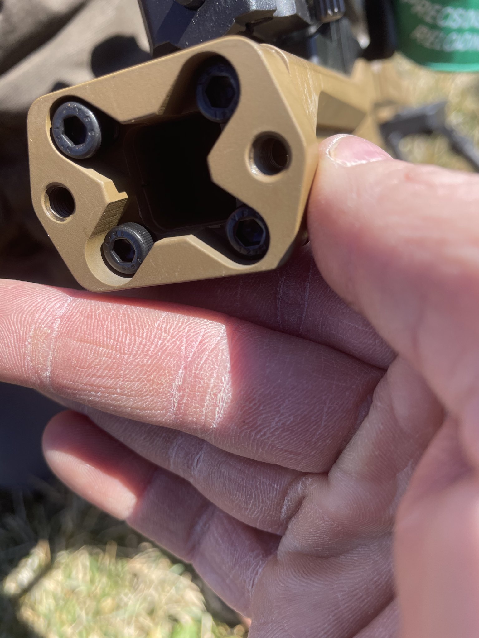

1)take off the rear assembly and make sure (where the hinge would go) has all bolts torqued down correctly....this happened to me and a few others I know of, being loose.

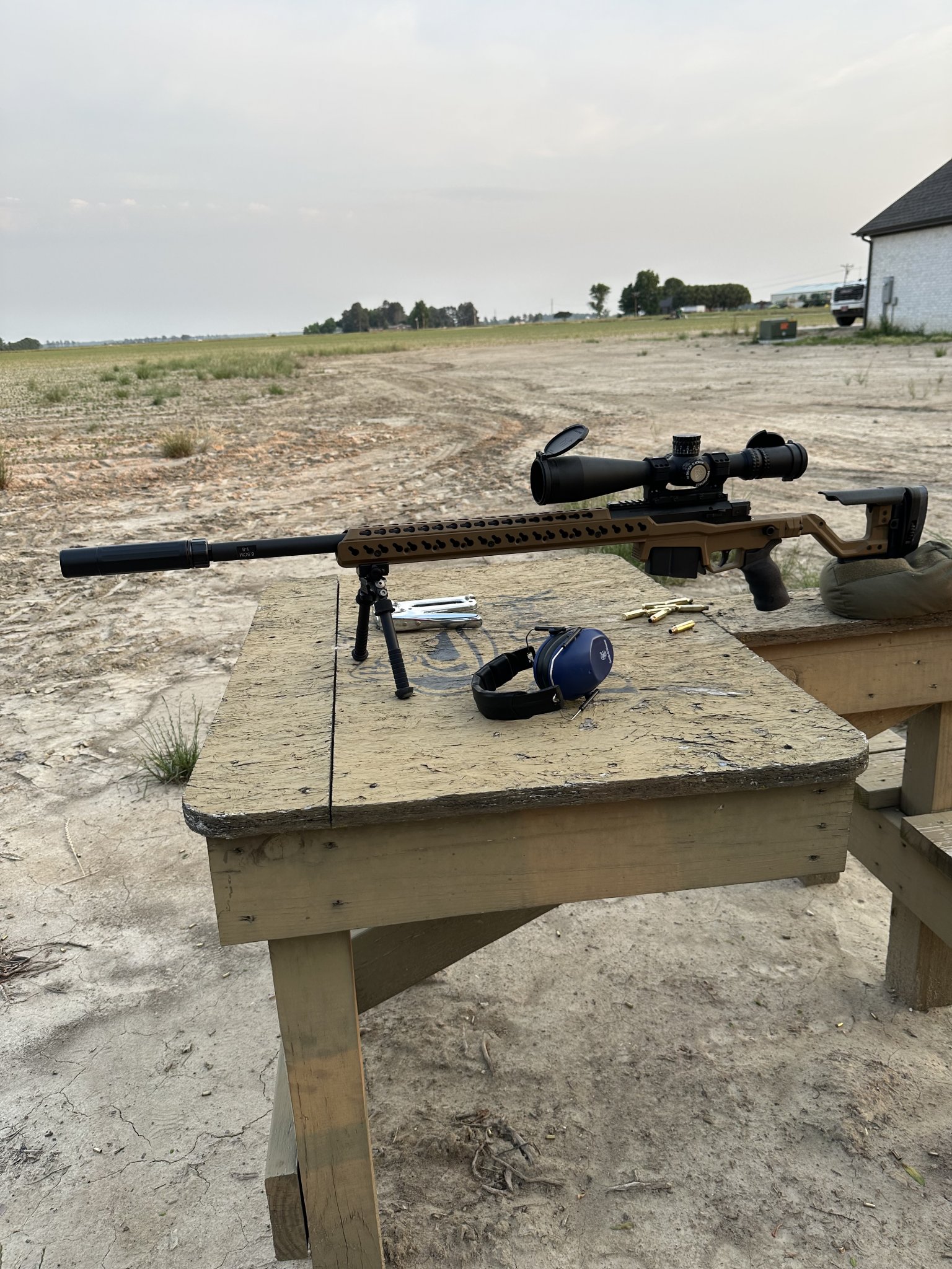

Shoot 3 groups of 5 (baseline rifle as is now, 1&3 done, 2 done) and post results maybe theres a shooting issue others can spot? from prone with bipod and rear bag. and a pic of gun perhaps just cuz!
Scope is a vortex PST Gen 2, with Vortex mounts.

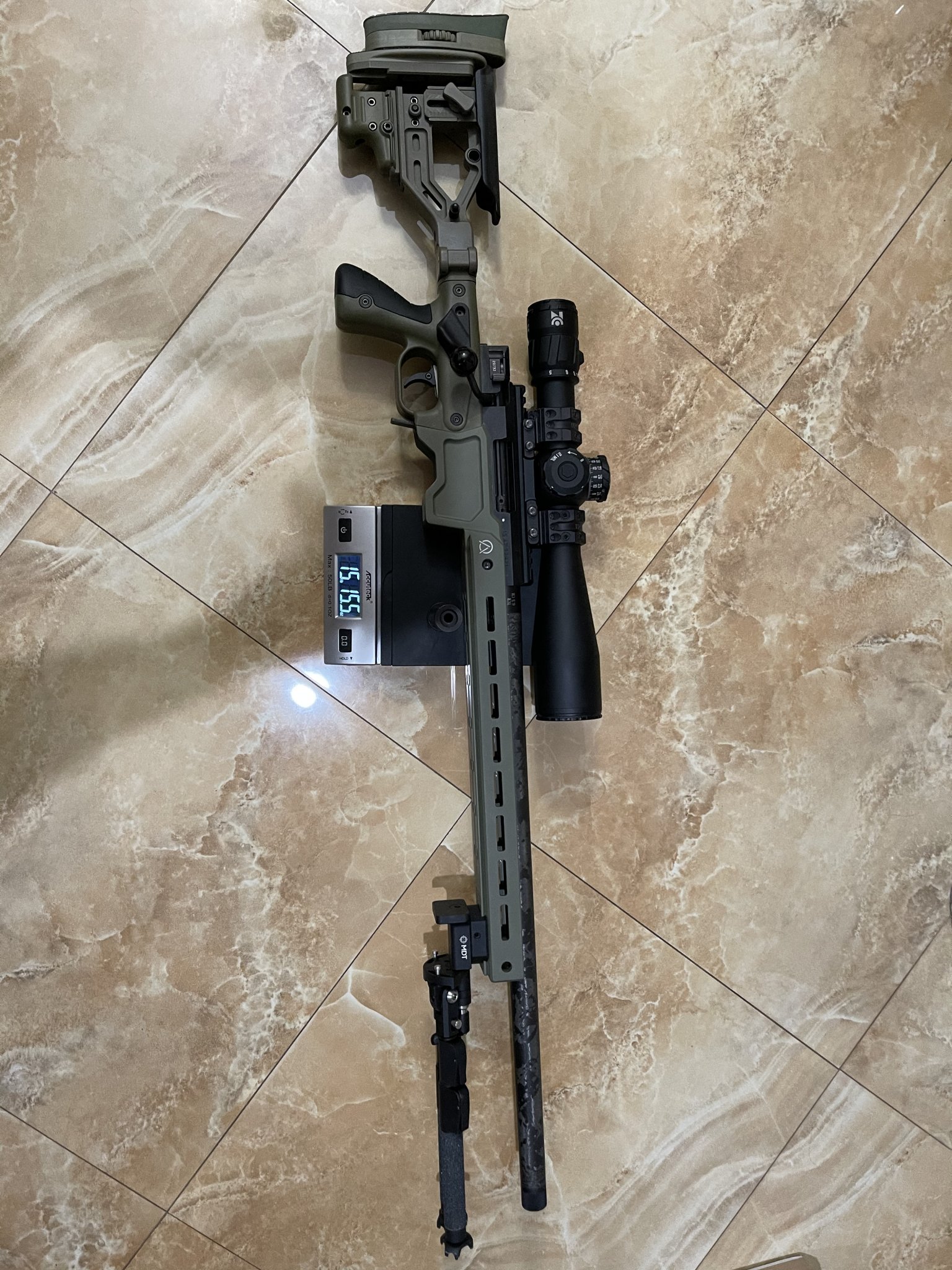

I’ve looked and can’t seem to find the info…..with the right scope and carbon fiber barrel has anyone used the AT-X in NRL Hunter?
In other words can you get it sub 16 pounds with carbon fiber barrel, bipod, scope and brake/can?

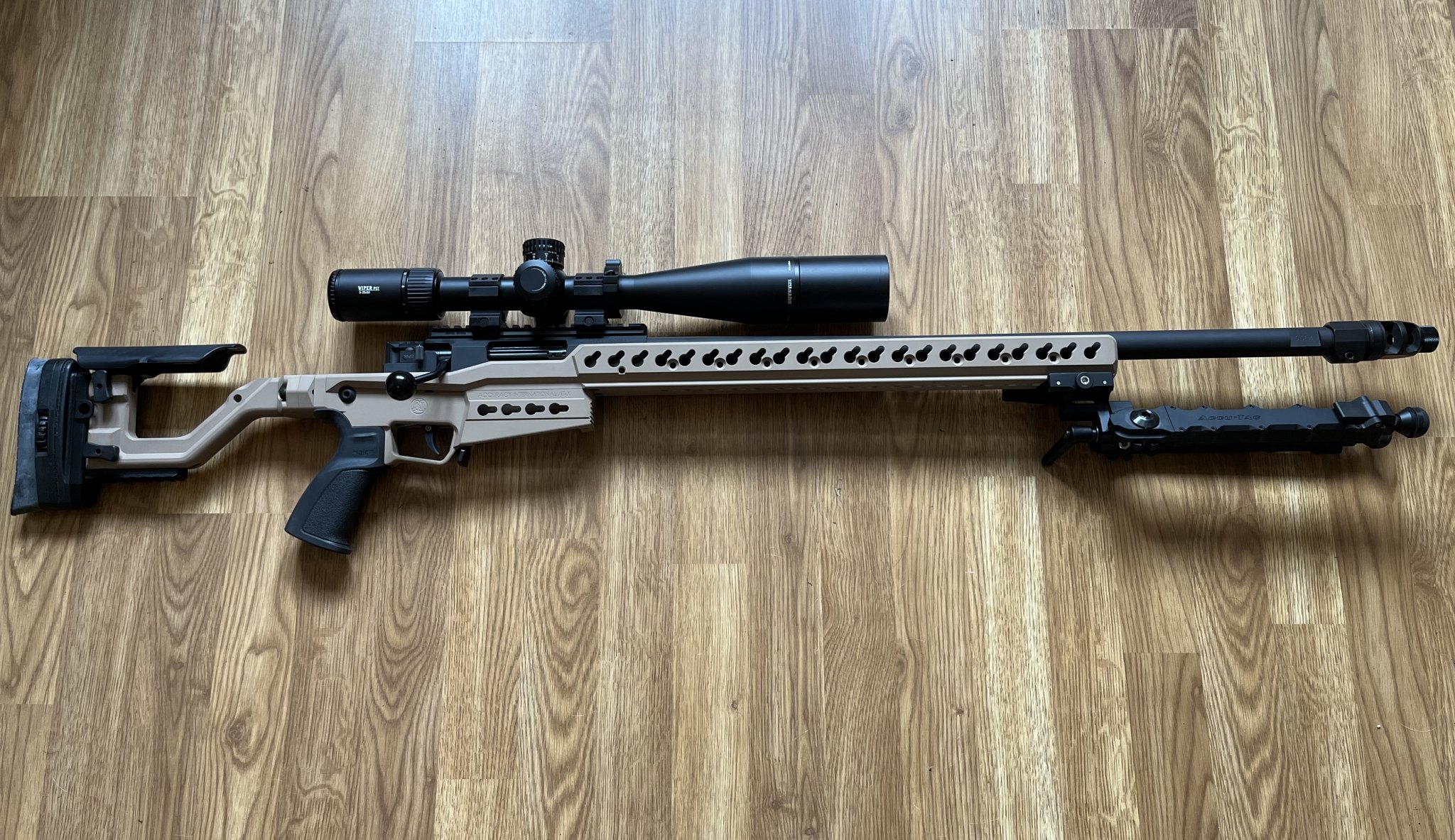

@PlinkIt @Huskydriver not that I want to derail the thread too much but the ATX and AI AO (action and chassis only) are about the same weight. Smidge over 8lbs.
This is what I might end up running in the NRL Hunter match this month. And I’ve hunted with a fully kitted AXMC at 19-20lbs a few times. My regular hunting rifles at usually between 13-16lbs.
In regards to balance point, it’s all jacked up in this configuration, way too rear heavy. Realistically it balances right at 19-20lbs. My medium Palma barrel is too light.

Hey thanks I appreciate that! Plus that’s a heavy scope and bipod. Should be plenty of room to make sub 16 with the ATX buttstock I would think.
I’ve got two custom rifles, one which I rarely shoot that is my “lightweight” setup. I’m considering selling both for an ATX to have one do all setup with quick change for barrel changes etc.

12.9 lbs - Naked AT-X
3.0 lbs - Optics and mount
-5.8 lbs - Subtract barrel
__________________________
10.1 lbs. " . . . glass with no barrel"
So if you add back in a CF Proof around 3 lbs, you have almost 3 pounds to play with for bipod and can, right?
Reactions: K80/6.5
yeah I’d say that’s right. I weighed my 26” proof the other day at 3.1 pounds and my Leupold MK5 in spuhr is only around 40 ounces total, so maybe more than 3 pounds to play with.

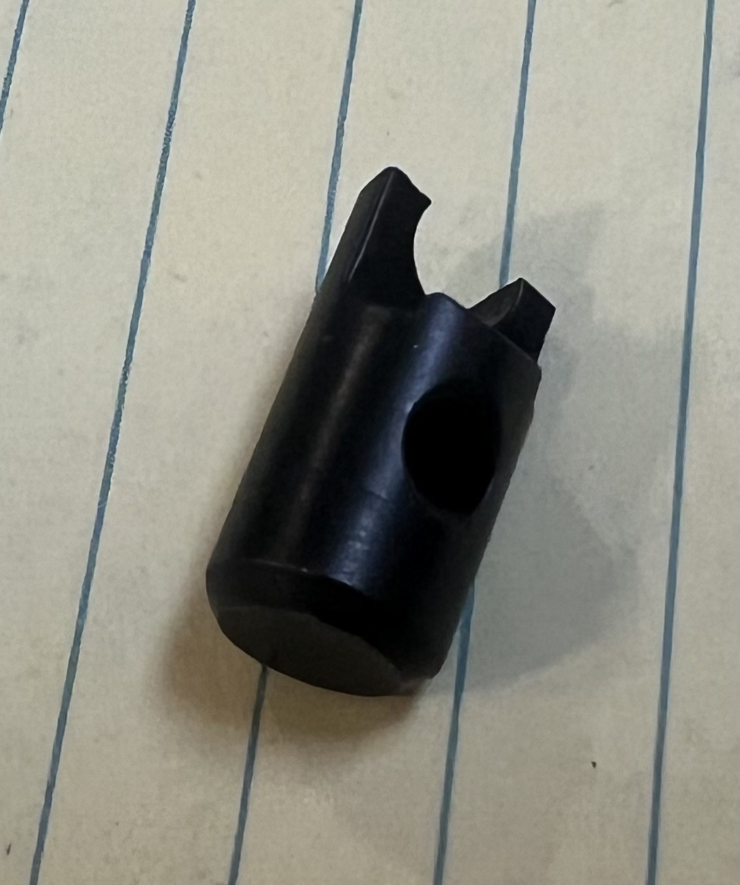

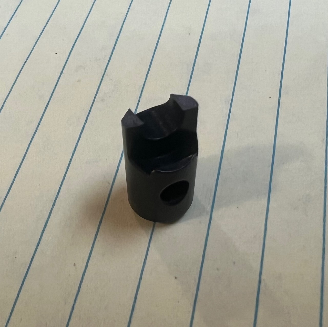

Does anyone have an exploded view of the cheek riser mechanism? This is a part of my rifle that fell out at the range. It's a broken piece from the mechanism that grips the cheek riser post as the thumb screw is tightened.
I'd like to see the part diagram so I can describe it to Mile High tomorrow.
