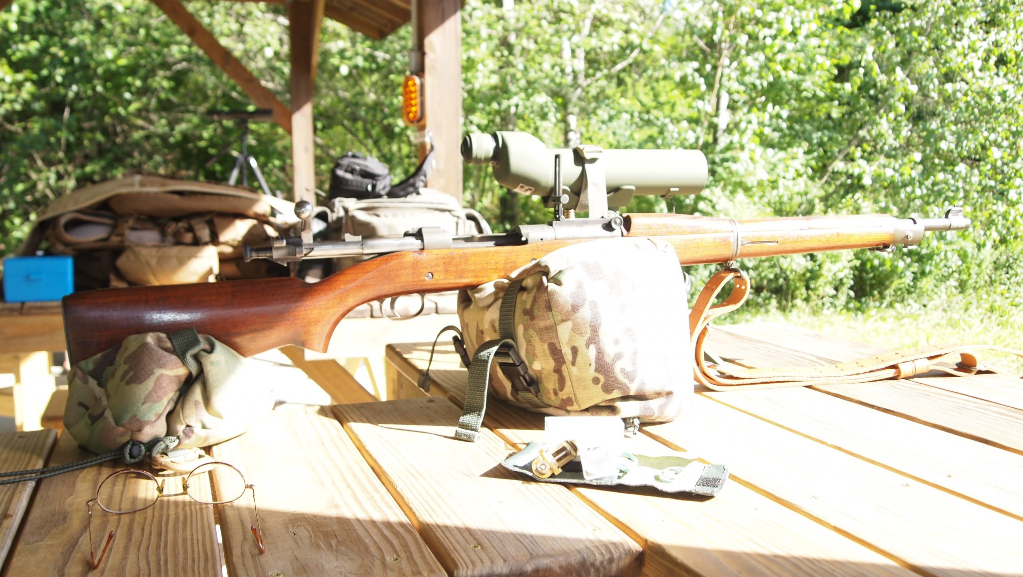

Barricade, Rig, Deep Creep, or Kroil will work fine.
Treat it as a tool than coat it with sweat, tears, blood and cosmoline.

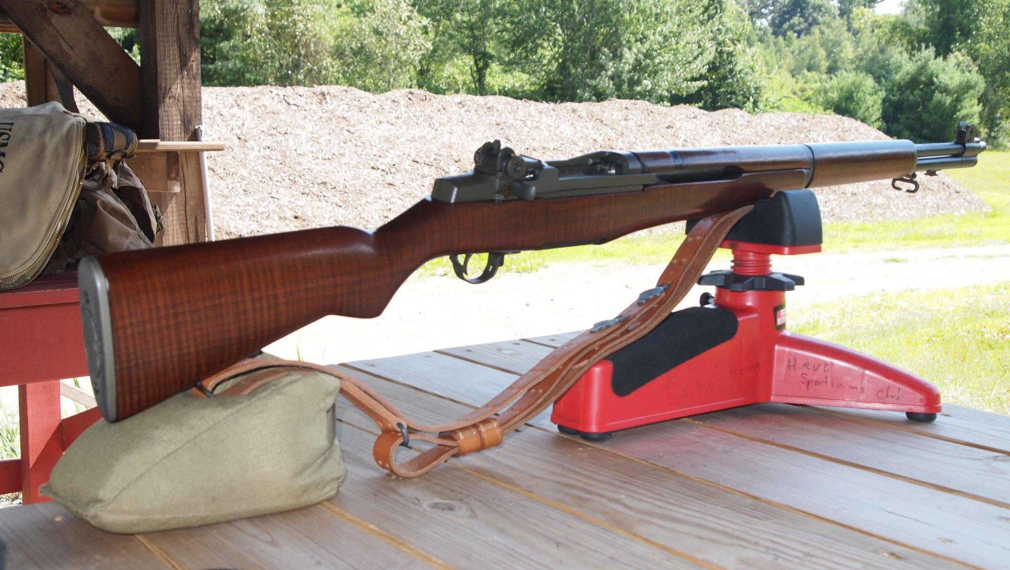

In 60 years it will turn a fantastic olive green that lets you know this is a rifle well used and has earned its respect.
If his barrel makes it 60 yrs, it wasn't well used.
You have a point....
Had my own rifles in mind....they are well used in the sensefor intended task, not abused....
Reactions: JMGlasgow
Really like that stock on the first one.....
