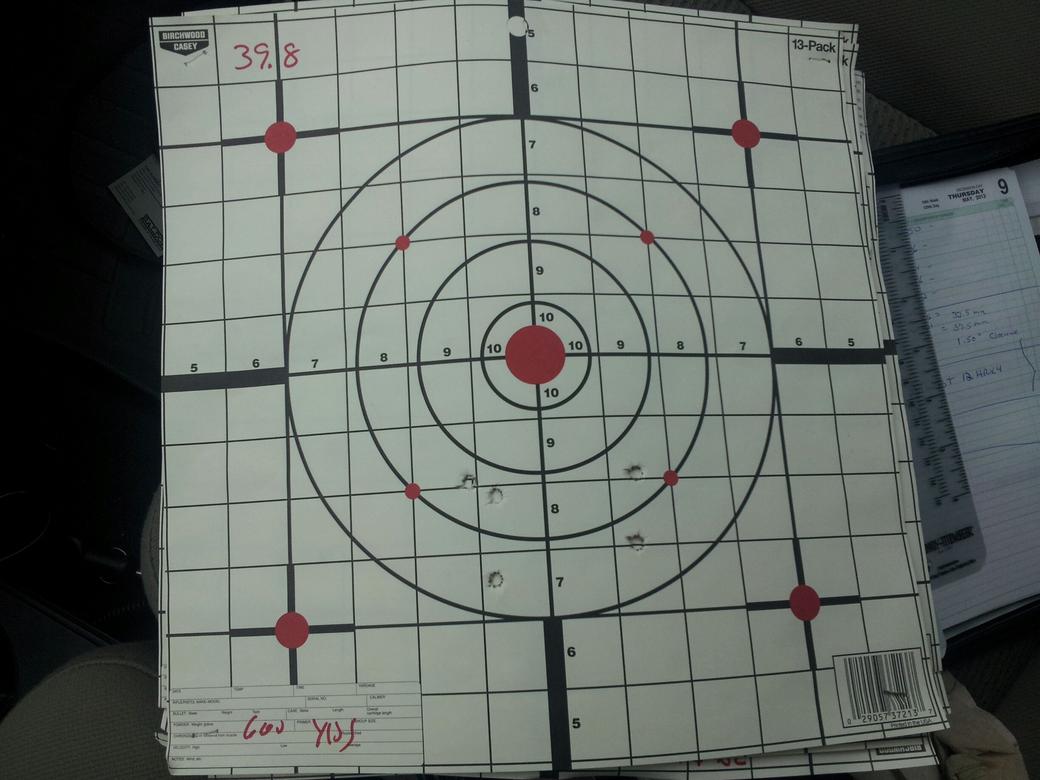

My LRP in .260 shot 5rd bug holes with 44.5gr of H4350 and 142gr SMKs
You don't need the recoil lug. The target actions come with precision recoil lugs. The lesser actions don't and might benefit from the precision lug.
Don't know the scoop on the precision nut. I have a 12LRP in 6.5 CM, and I'm not changing the nut on mine. I'm not touching anything on it for fear I will screw it up. Unbelievable rifle straight out of the box. I don't know if they are all like this one or not.
600 Yds with 140 Amax. Approx 1.5" vertical and 2.5" horizontal. Not a calm wind day.

Since don't have a scope I went into going into round 1 of my pressure tests...
CCI large rifle primers, non BR, lapua brass
first test was going by Lapua's recommendation for the 123gr scenars of 2.795 COAL, tomorrow will be .010" off lands which seems to be 2.835"
Varget at 36 37 38 39gr with no pressure signs, 39.5 showing slight cratering, cases inside were the most dirty of the 3 different loads but exhaust wasn't bad.
Superperformance at 45 46 47 48 49 gr, all 5 loads showed no pressure signs, cases were the cleanest of the 3, looking forward to how this shoots.
H4831SC at 44 45 46 47 48gr, except for the 44, all the others had varying degrees of compression, showing slight cratering on the 48, very thick exhaust... almost like not all the powder was burning... probably will save this for heavier bullets
