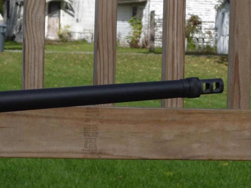

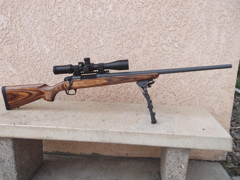

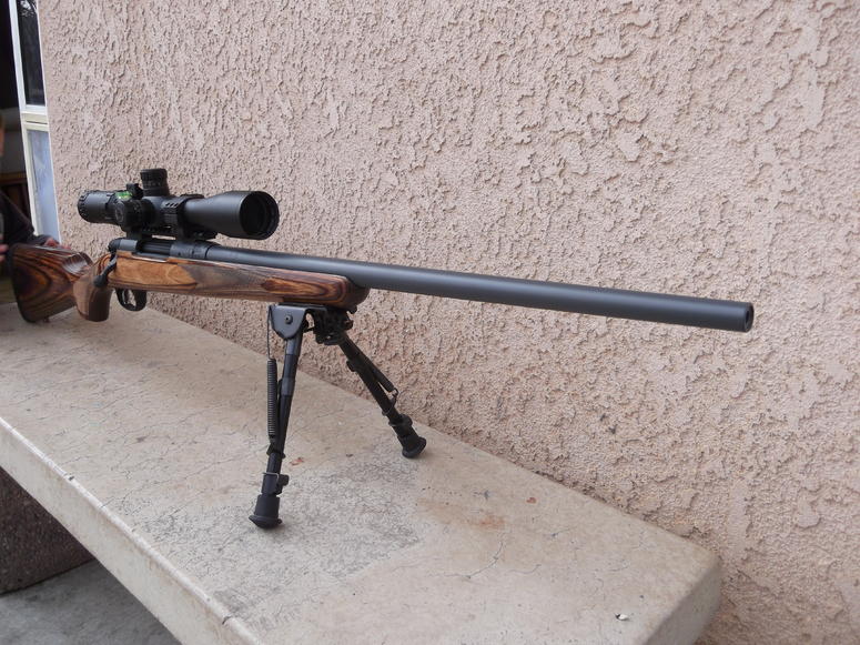

R700 blue printed by Ray Saltzman
22.5 inch Rock M24/M40 1/10 twist
Saltzman 2 port break threaded for my SAS can
AICS 1.5
Vortex PST 6-24 MOA in Leupold rings
Weaver 20 MOA rail
B.O. copy bolt knob
She is a 1/2 moa rifle in m hands. I shot a five shot group yesterday at 360 yards and it measured 1.49 inches. I use the 190 grn. CC over 60.0 grns. of RL22. they clock at 2850 at 65 degrees with no signs of pressure.

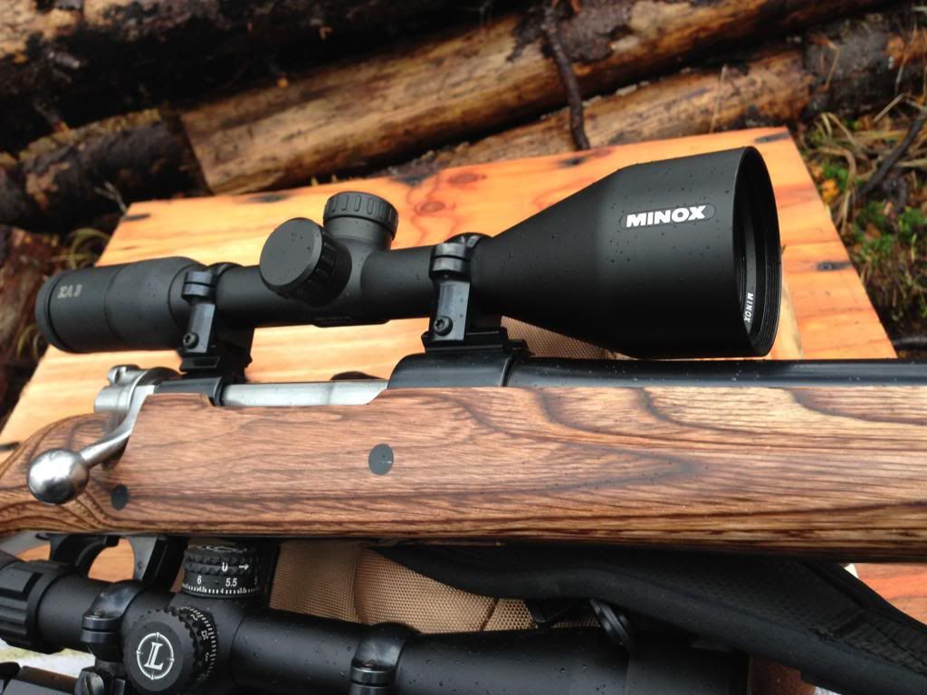

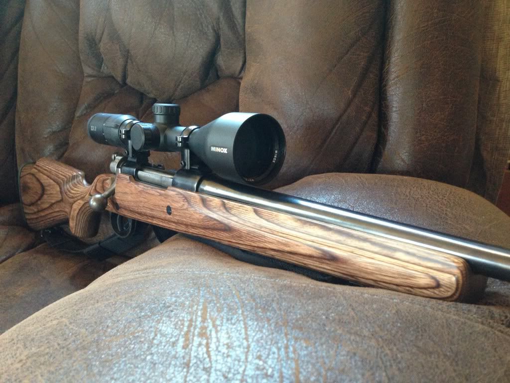

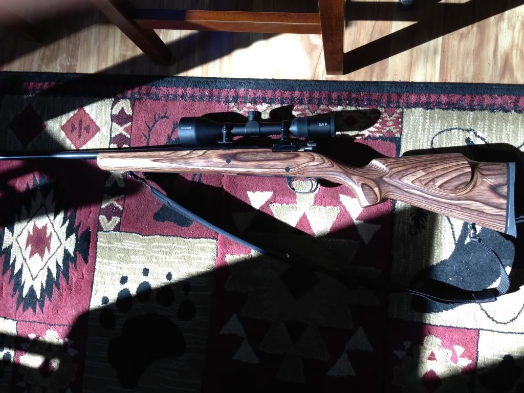

Here is my Mauser 98 sporter circa 1951. Golden State Arms Santa Fe Deluxe. This summer I breathed new life into her with a new Boyd's laminate stock in Nutmeg, a Boyd's optima trigger (which is utterly amazing for $38), and a Minox ZA3 3-9x50 in Burris rings. She shoots a respectable 1.75 to 1.25 moa with most loads and Hornady 180 SSTs around an inch. Its a pleasure to shoot. It's not state of the art, but has had an interesting life! Loves me some 30-06.

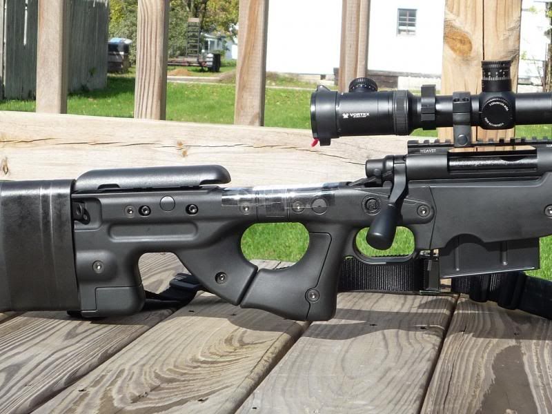

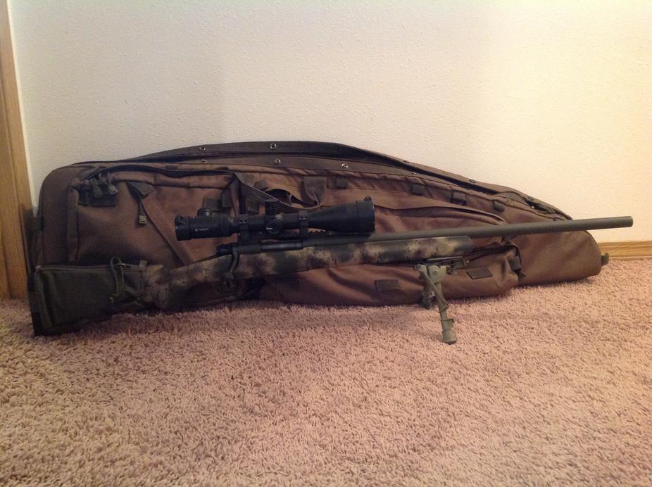

Tac Ops Zulu 63
Savage 110 action in .30-06
McMillian Win Marksman stock with heavy texture by Tac Ops
24" Kreiger chrome moly barrel 1:10 twist
Ken Farrel one piece 20 MOA base
SharpShooterSupply Tactical bolt handle with TacOps bolt knob installed
All metal finished in Birdsong's Black T
Harris 9-13" swivel bipod
Timney trigger set to 2 lbs
Storm case

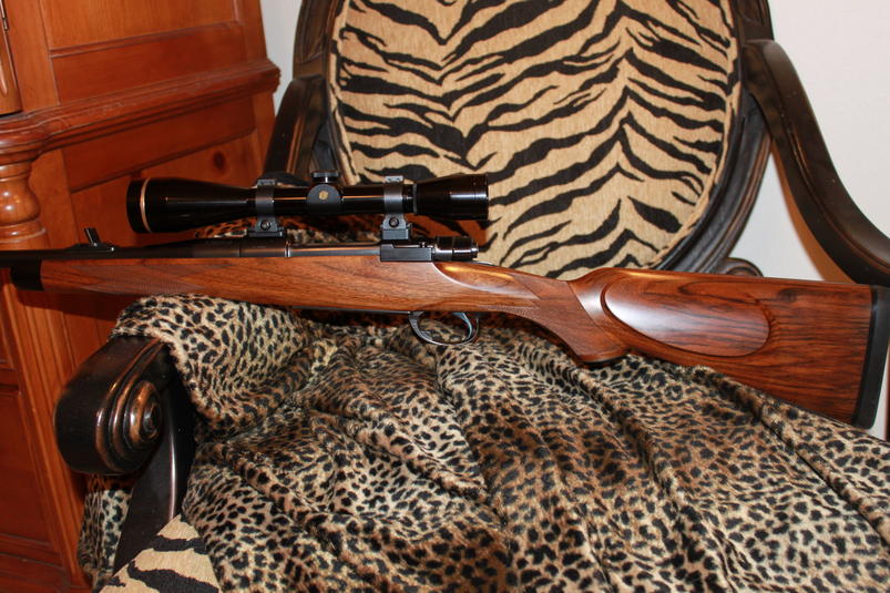

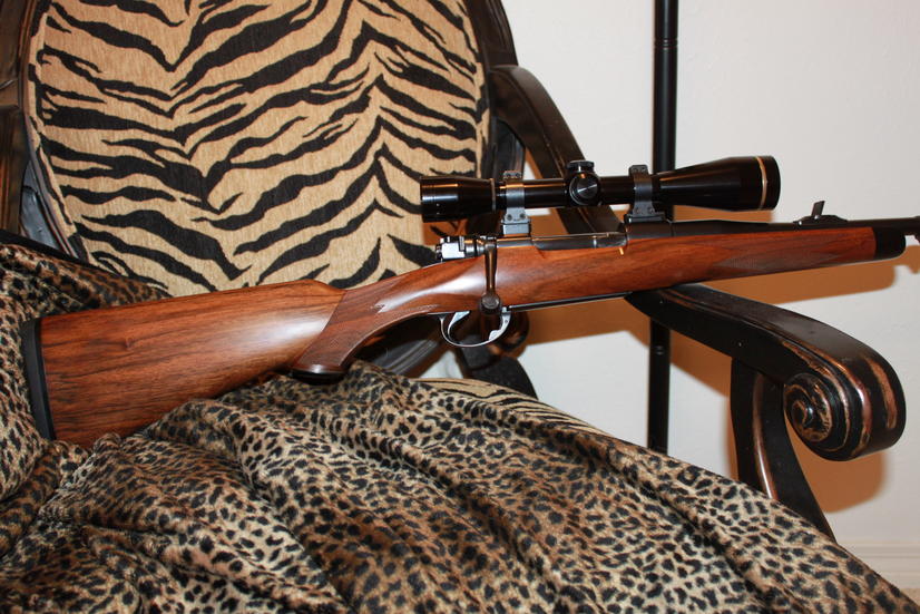

Custom Dave Norin 30-06
Post-War Commercial FN Mauser Action
Krieger Barrel
Blackburn bottom metal and trigger
EAW sights
Shoots 1/2" groups with Federal 150gr Power Shocks
