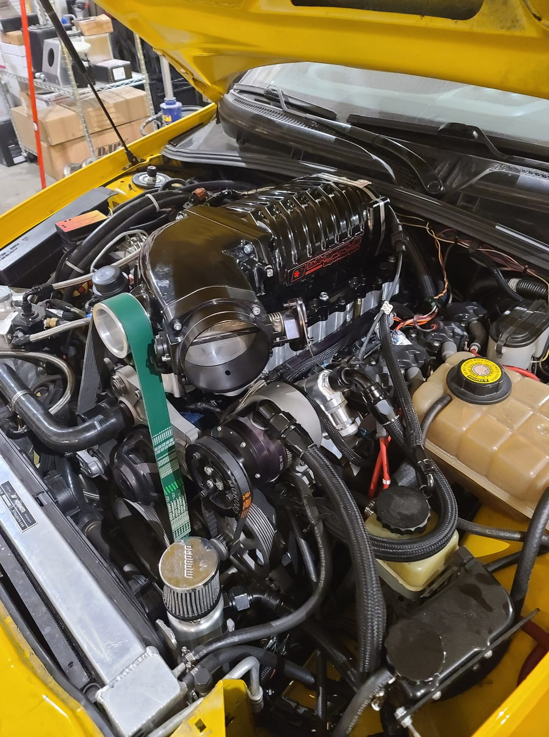

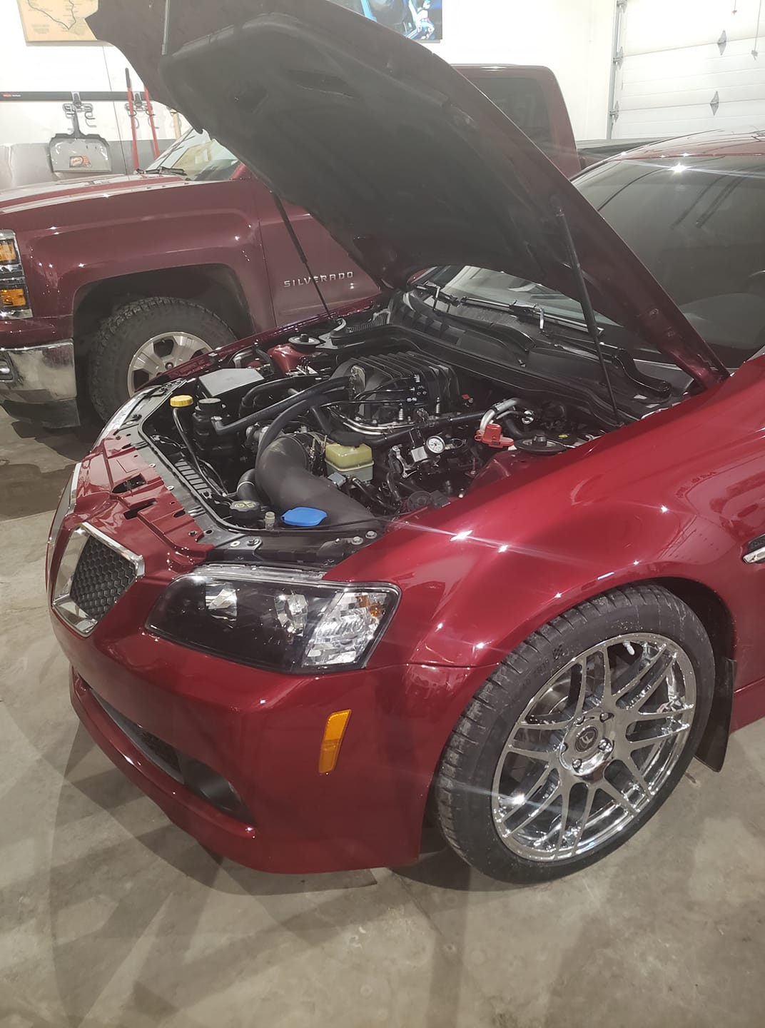

Kalli's G8. 650 to the tire. You should see her Mini Cooper S. That thing is baller!

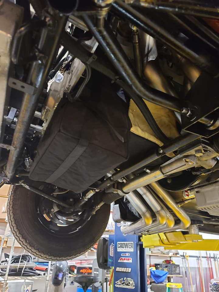

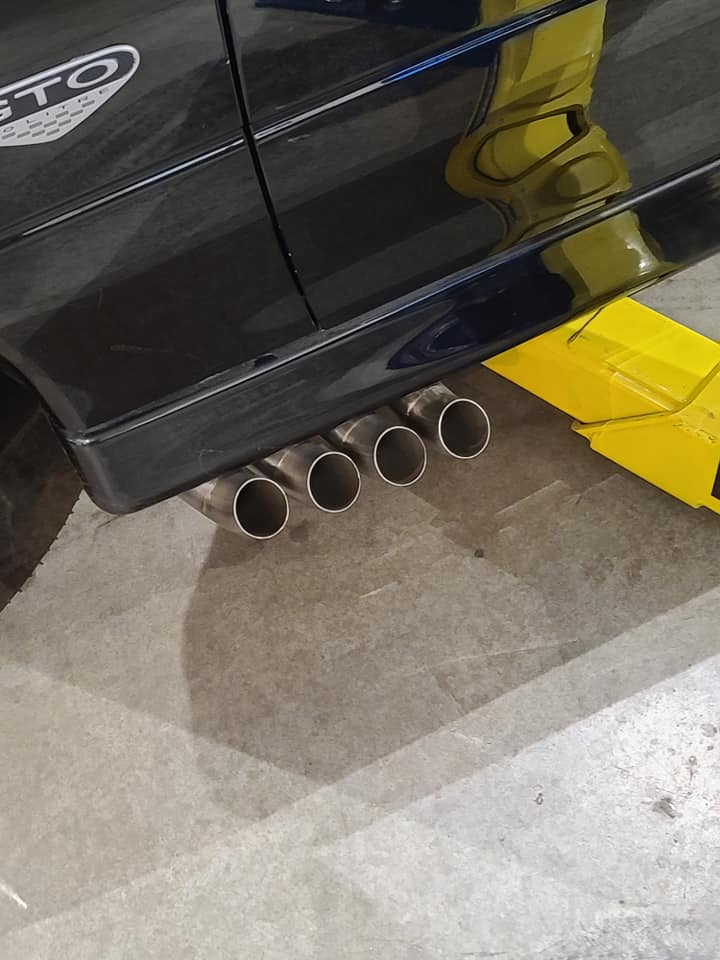

My GTO street car. E85'd and Whippled 421 LSX I built. Just put a newer Whipple 3 liter on it. Were hoping for 1300's to the tire on this one.

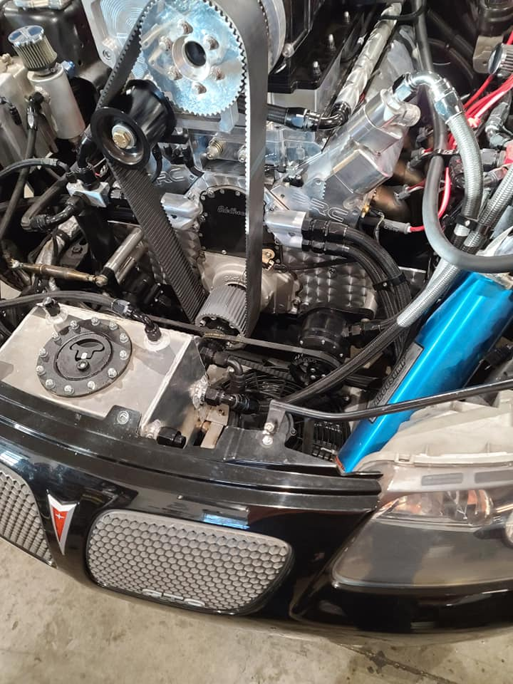

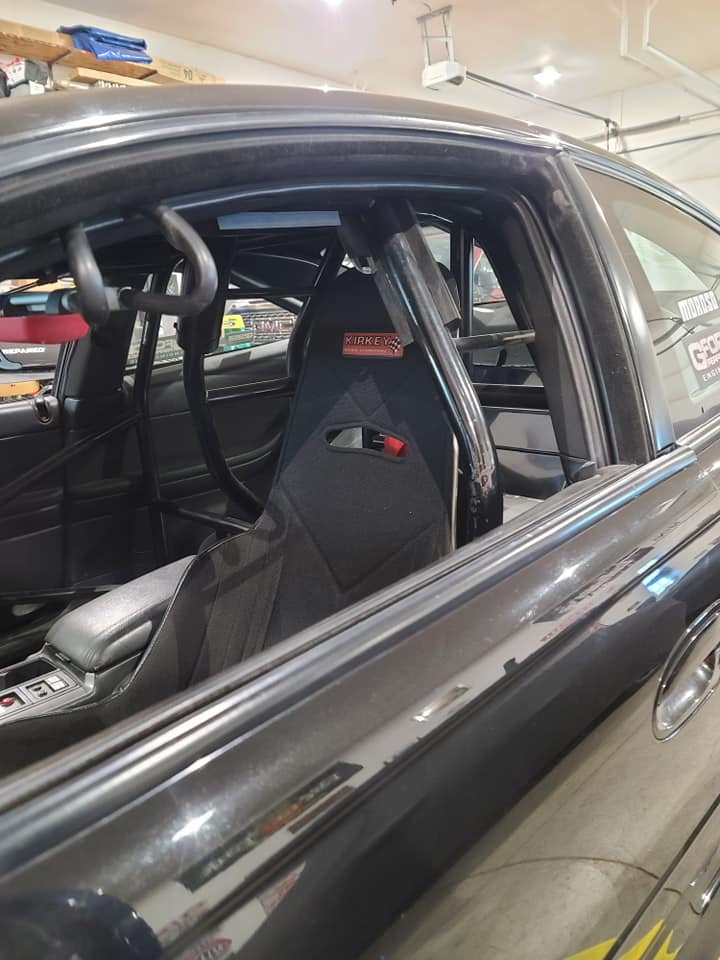

Aaaaaannnddd, HoOdRaT. The track car. An 8.3L Whipple on methanol plopped on top of a 5.3LS. Its a freakshow. Just got the zoomies done last week. Heads back to the dyno here in a couple of weeks.

Not only do you have super hot cars, but they are Pontiacs besides! Meaty, Beaty, big and bouncy!

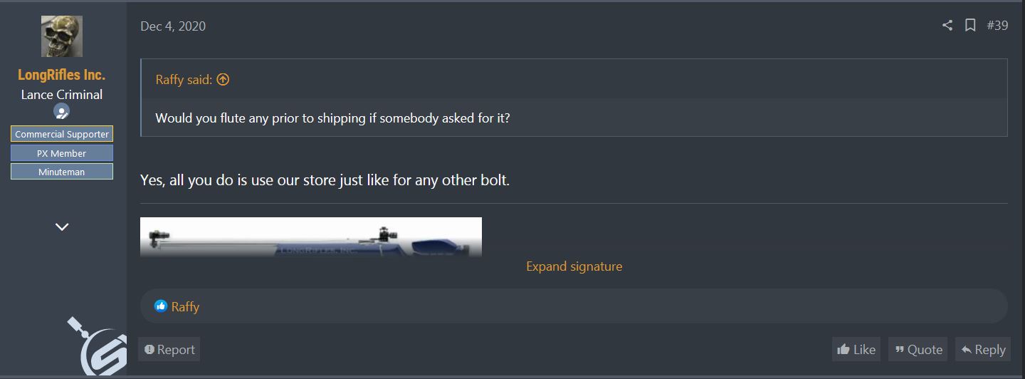

Are you going to offer fluted options? Would be nice to get a fluted one and keep the OEM for back up.
He said he was in an earlier post.
