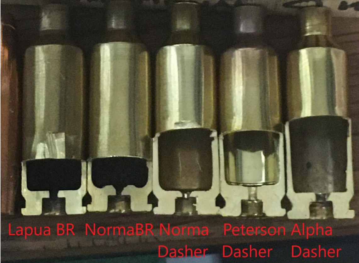

Sounds like a shell holder issue rather than a problem with the cases. :rolleyes: Shell holders should be able to accommodate all brass variations.
Reactions: General RE LEE
