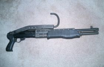

OK, allow me to re phrase my statement. I never used one in 19 years of military service, or shooting since 1967. I have not seen one in use by anyone that I can remember. I did have a SPAS shotgun that had one in the 80's. I took it off the day I bought it. I just breezed the entire GAP webpage and did not see a rifle with a stock hook or offered as an option. Maybe I am missing something here?

OK, allow me to re phrase my statement. I never used on in 19 years of military service, or shooting since 1967. I have not seen one in use by anyone that I can remember. I did have a SPAS shotgun that had one in the 80's. I took it off the day I bought it. I just breezed the entire GAP webpage and did not see a rifle with a stock hook or offered as an option. Maybe I am missing something here?
99.99% sure that the OP is asking about rifle stocks with a hook design and not an outdated shotgun. Check out the Crusader, HRT rifle, and the Hospitaller as a reference point. Custom Rifles - GA Precision
