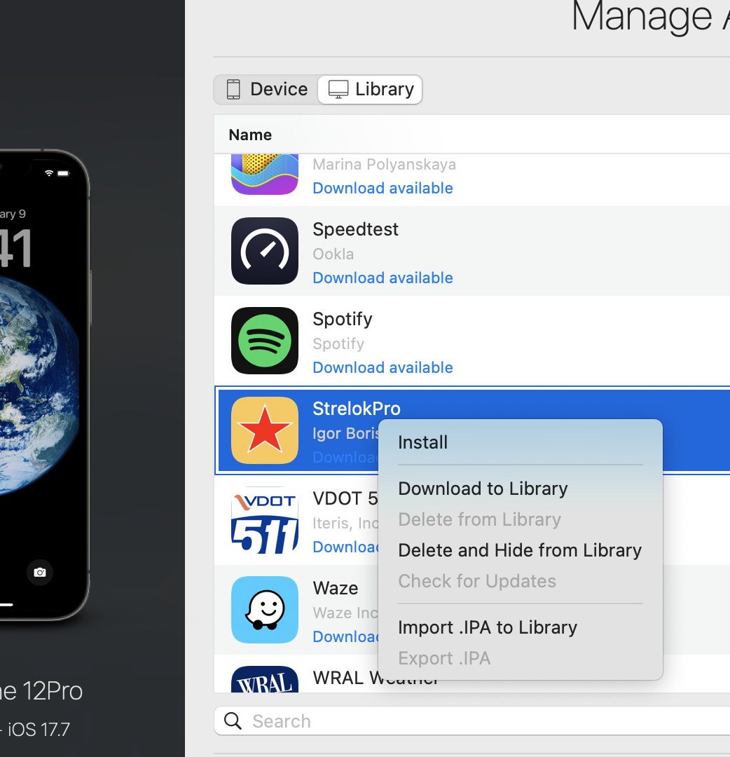

Imazing v2.18.. is NOT working for me with iPhone 12 Pro/IOS 17.7. Details:
  1. Dowloaded/installed Imazing per post #101. Note that current version is v3.x. The version in #101 was v2.x.

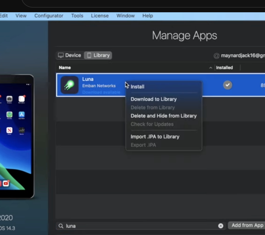

  2. I was able to follow the video's steps until the 8:37 mark. At that point, the video shows right-clicking the app and selecting
    "Download to Library" as seen in this screen capture.
  3. In Imazing v3, the selection choices are different. Note that "Export .IPA" is greyed out. I assume the export function is now a paid feature, because choosing "Download to Library" results in the app going off to the app store. No bueno.
  4. So I discovered I could download v2.18.1. Went back and deleted v3 cache, deleted the app, and installed v2.18. And guess what? The damned thing still throws the v3 selection choices with "Export .IPA" greyed out and "Download to Library" still going off to app store.
Crap. If anyone still has the computer "fiddle with s#!t ad nauseam" gene still active - I retired as a principal software engineer quite a few years ago and now the really fiddly stuff is delegated to my senior network engineer offspring - and wants to poke at this, I'd love to learn that I overlooked something.
