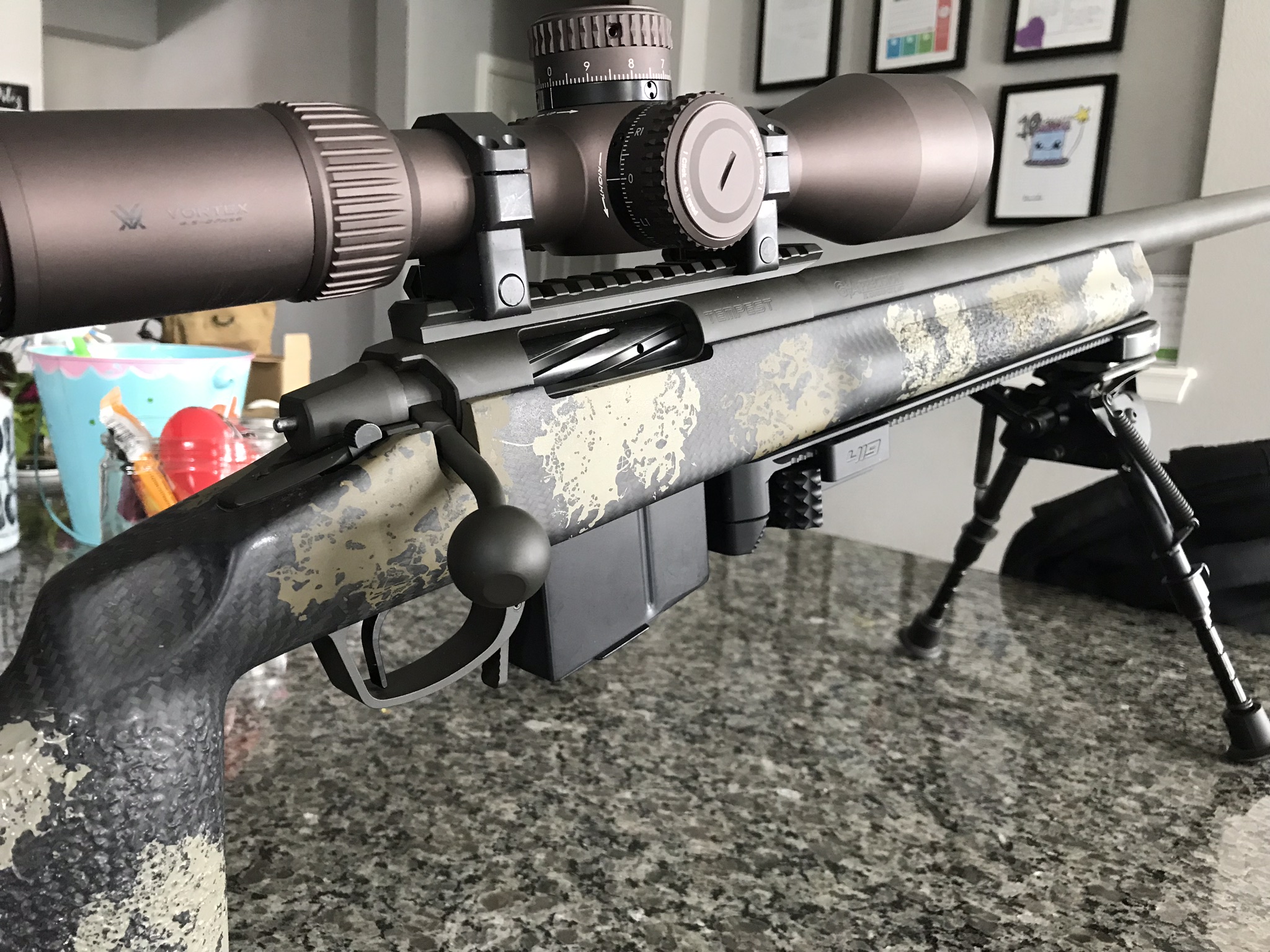

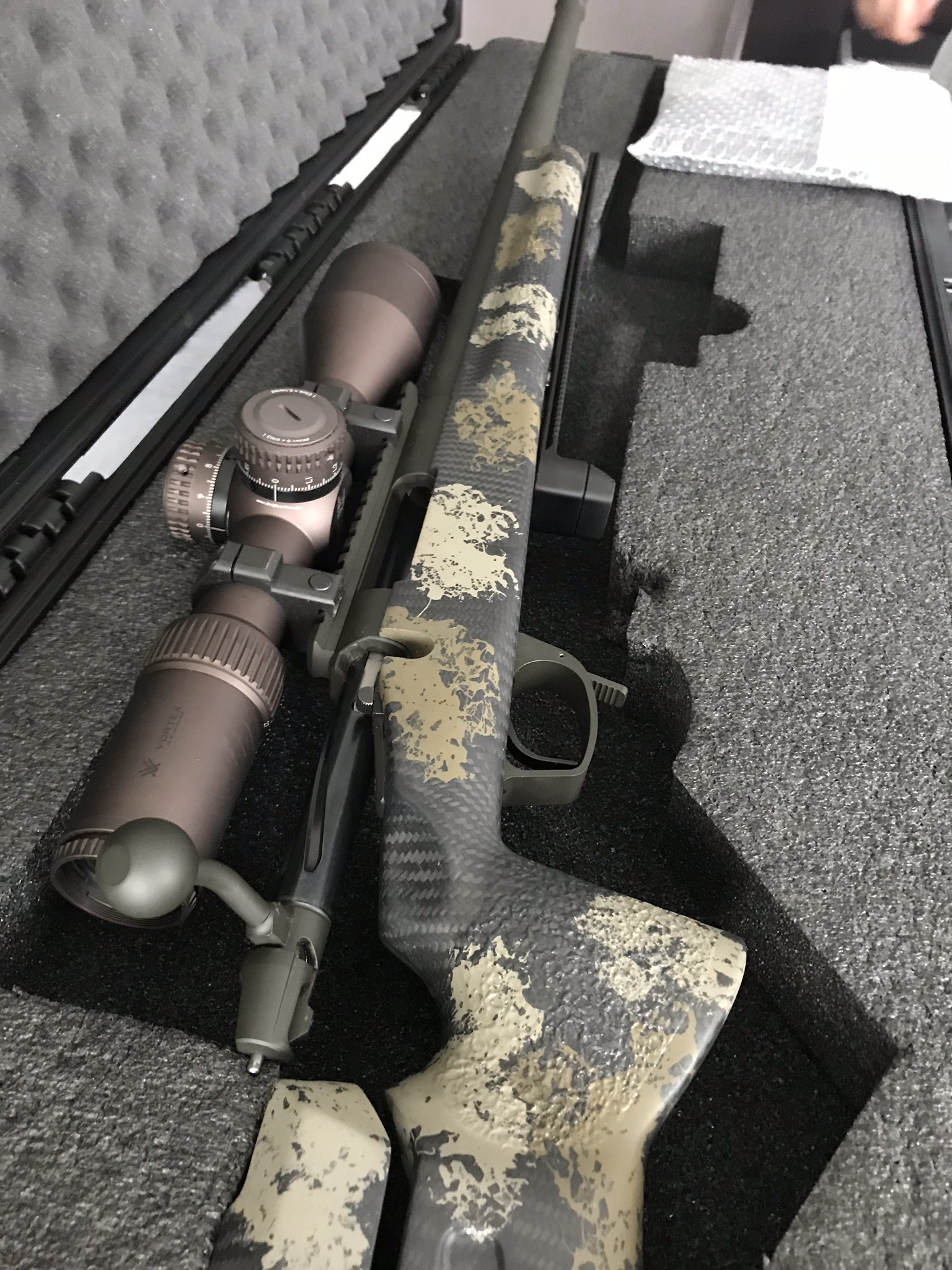

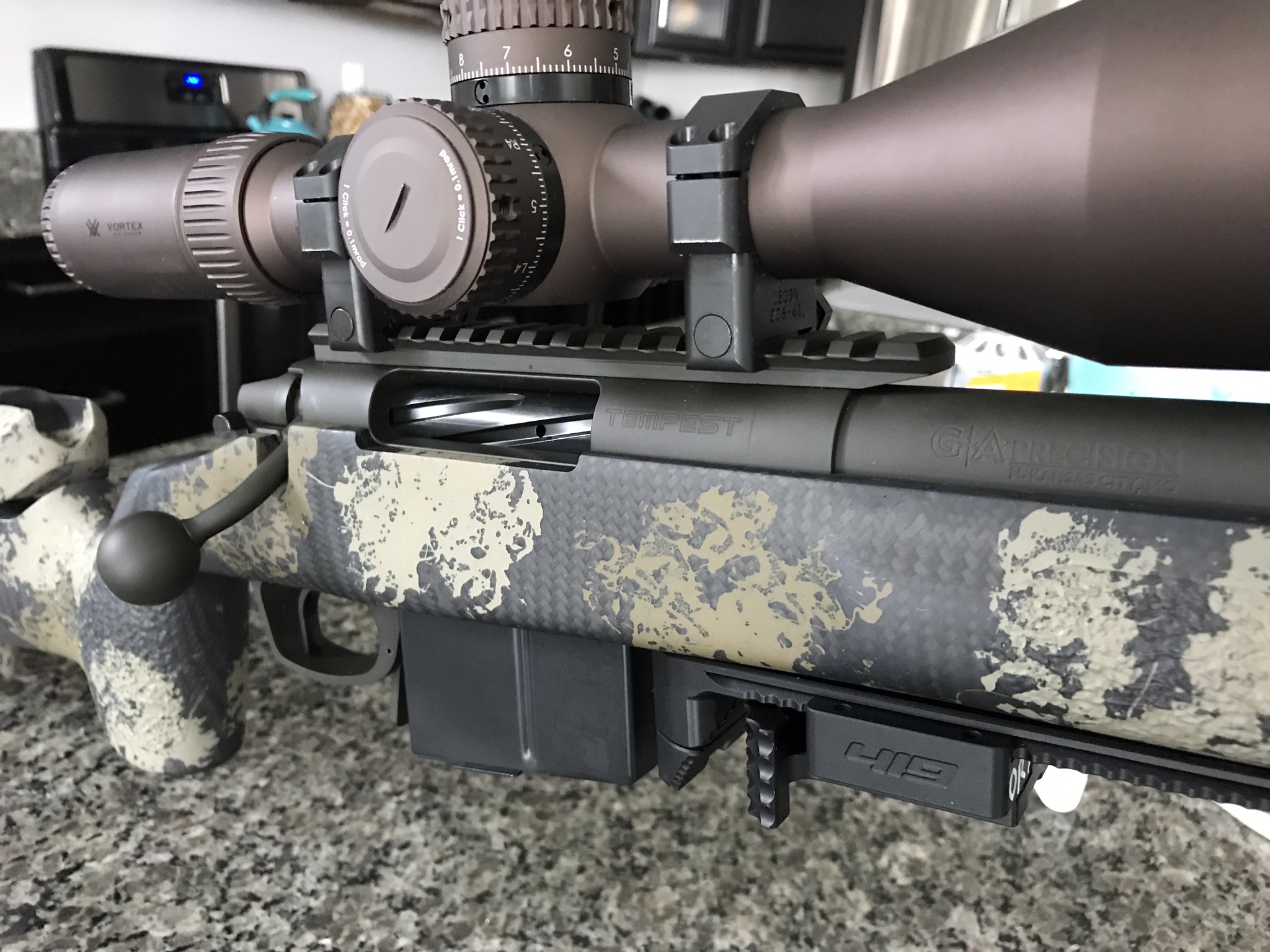

In 6mm Creedmoor
MTU
Timney Calvin Elite
Manners
GAP Build
