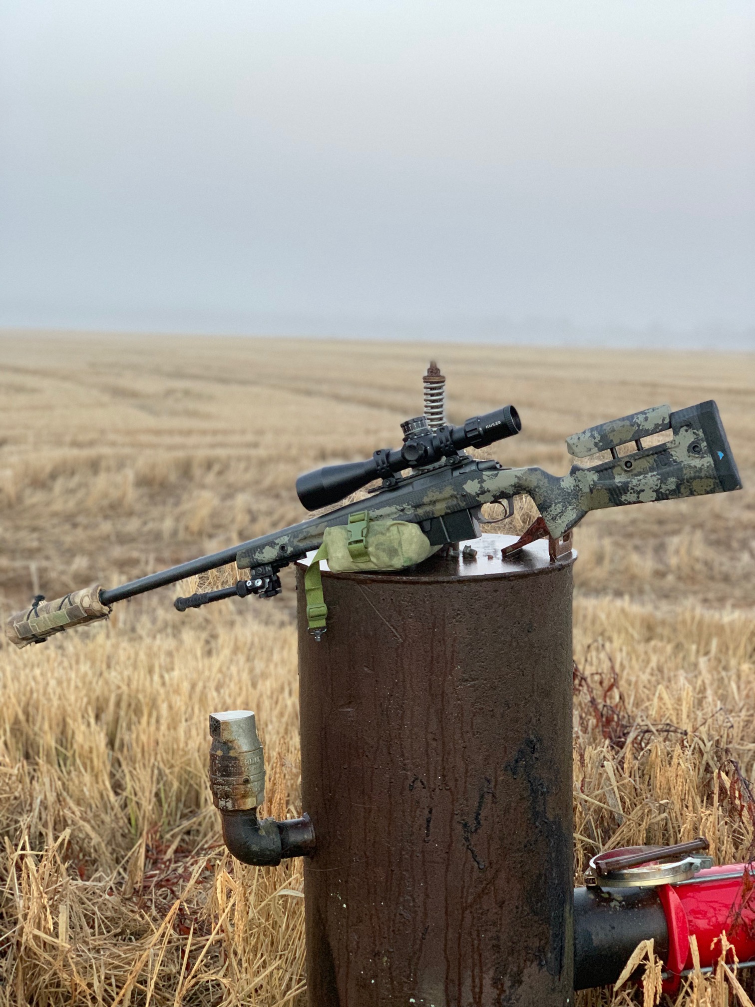

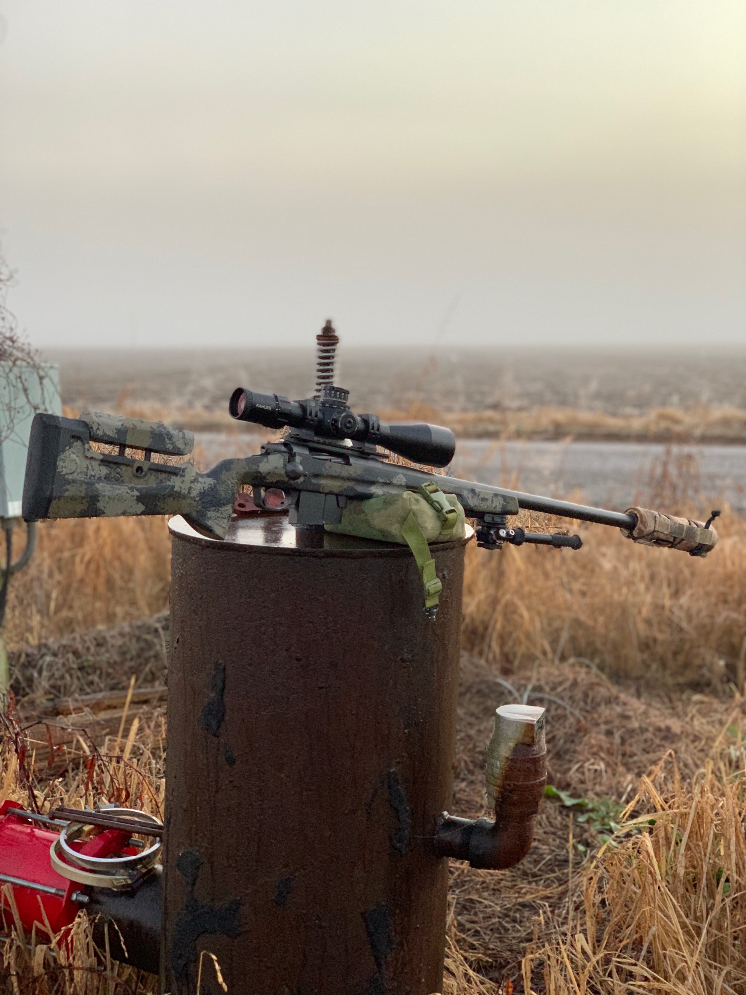

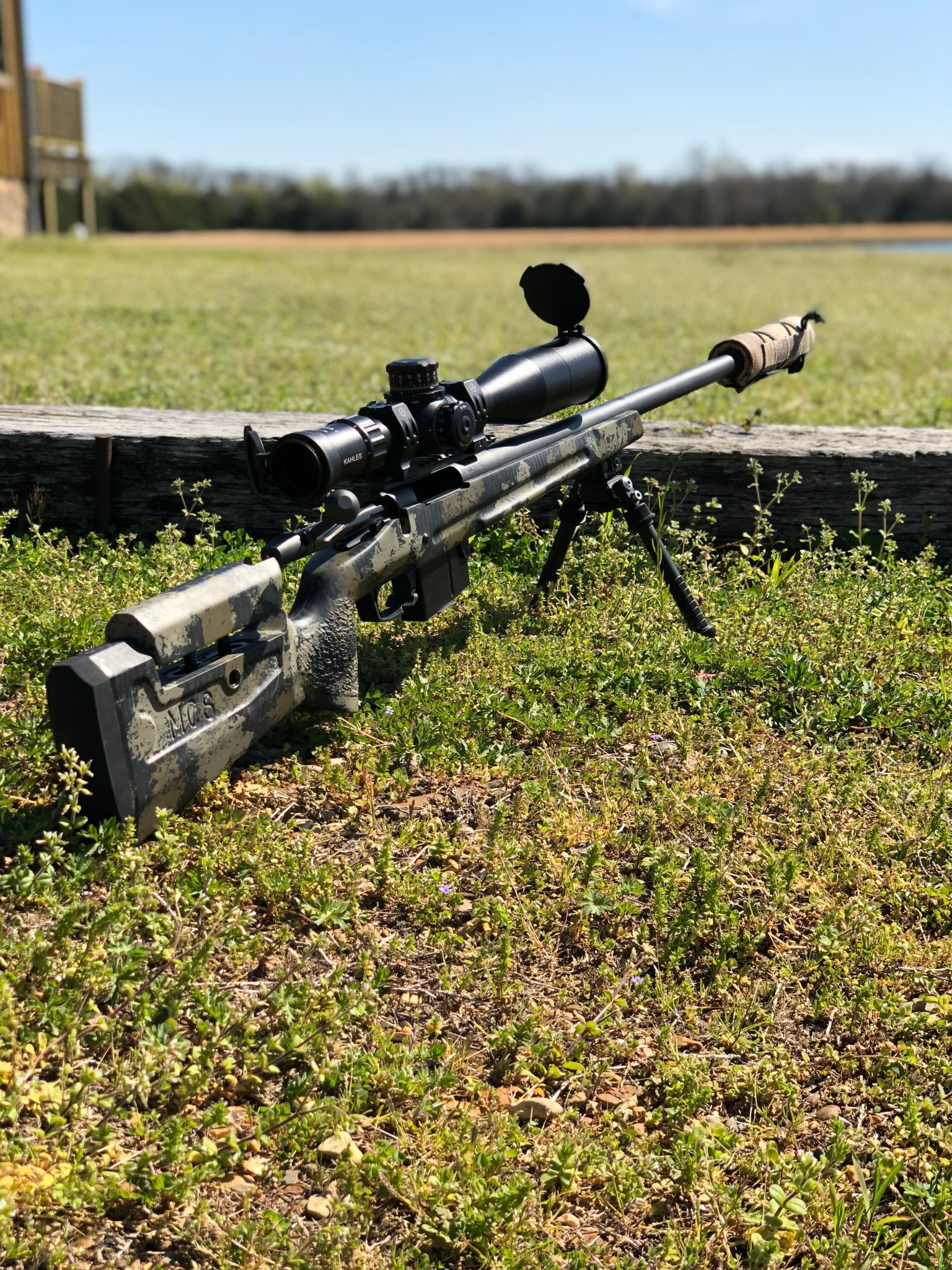

Up and running. Ran some of my hunting rounds from the other gun in it. 2818fps with 130gr ELD-M and an SD of 7.5 which will work. Pic heavy but i couldn't resist..

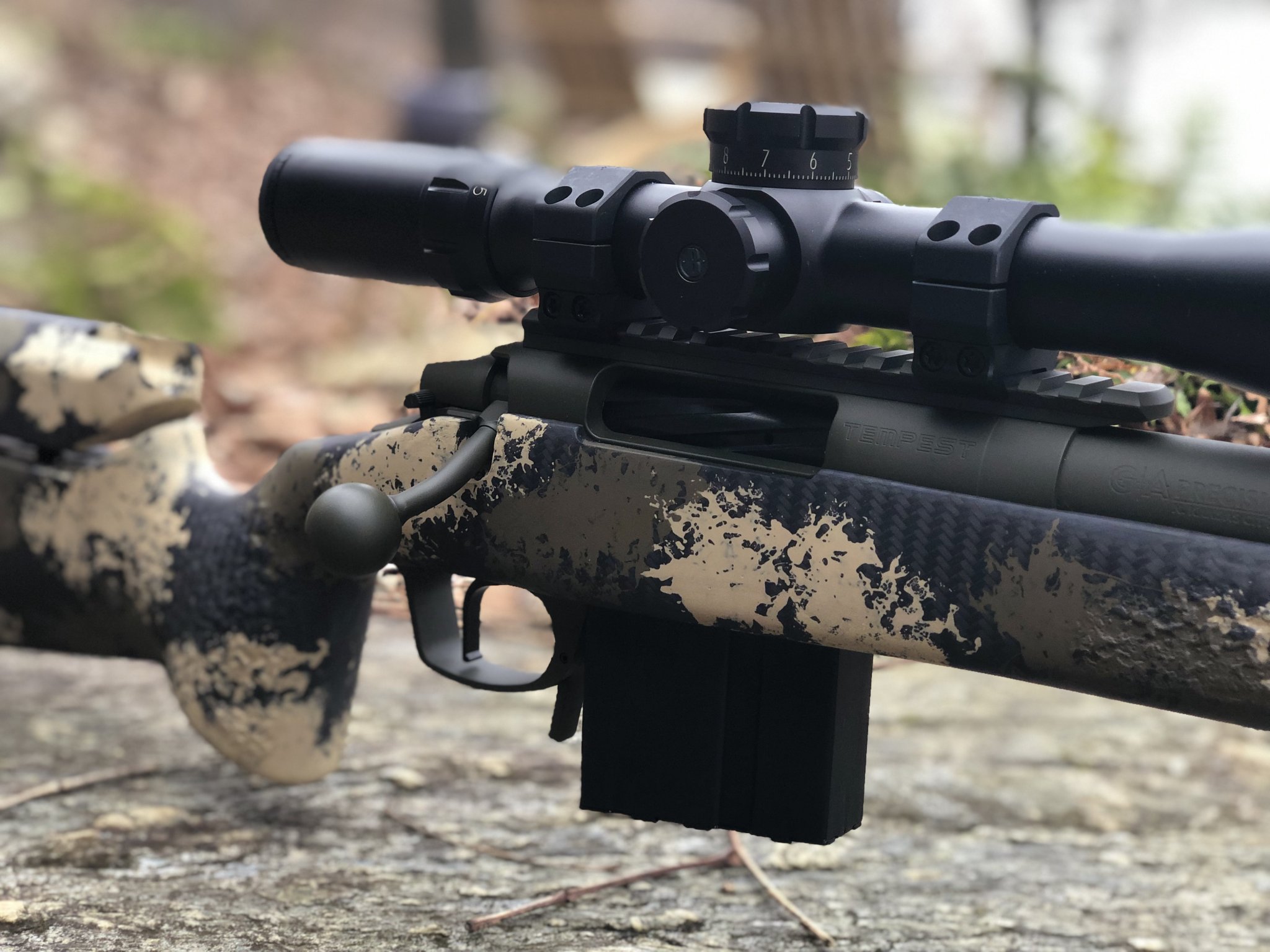

Yup i think it’s just the nature of those lugs locking in the recesses. Forward pressure alleviates it though. I run it pretty forcefully. But currently my impact has a bit of a hitch like that when closing the bolt.

It could be that i don't have a stock to mount it so it's more noticeable as well. But my cousin noticed it when handling it as well. This is with the correct trigger hanger and a TT diamond.

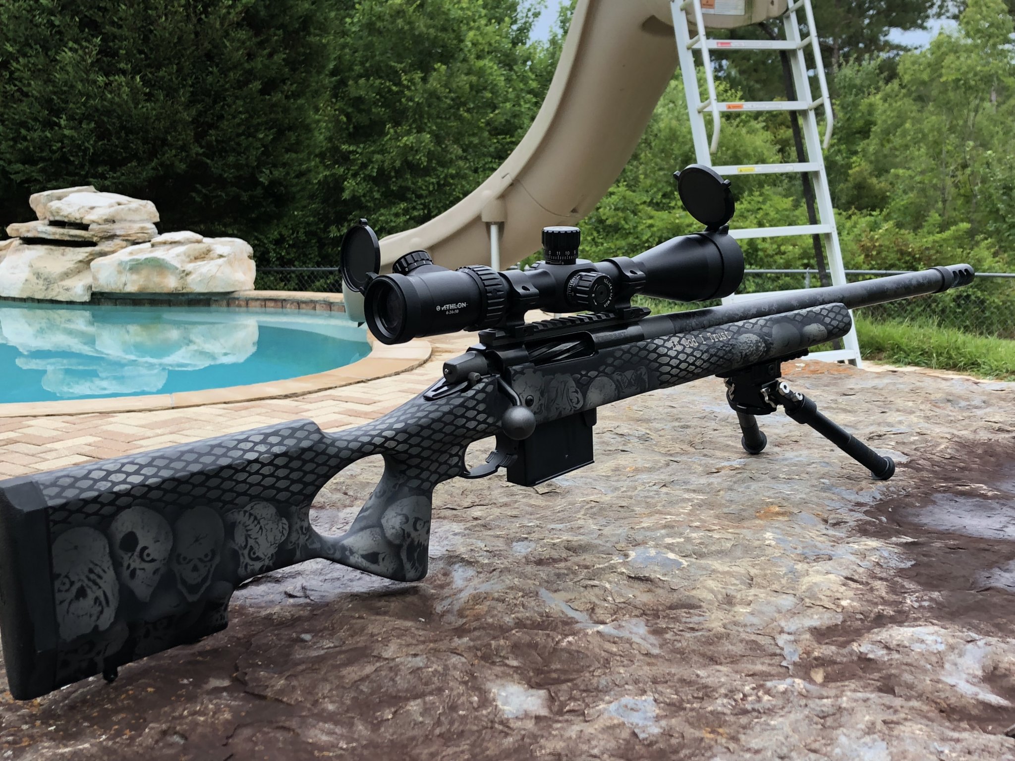

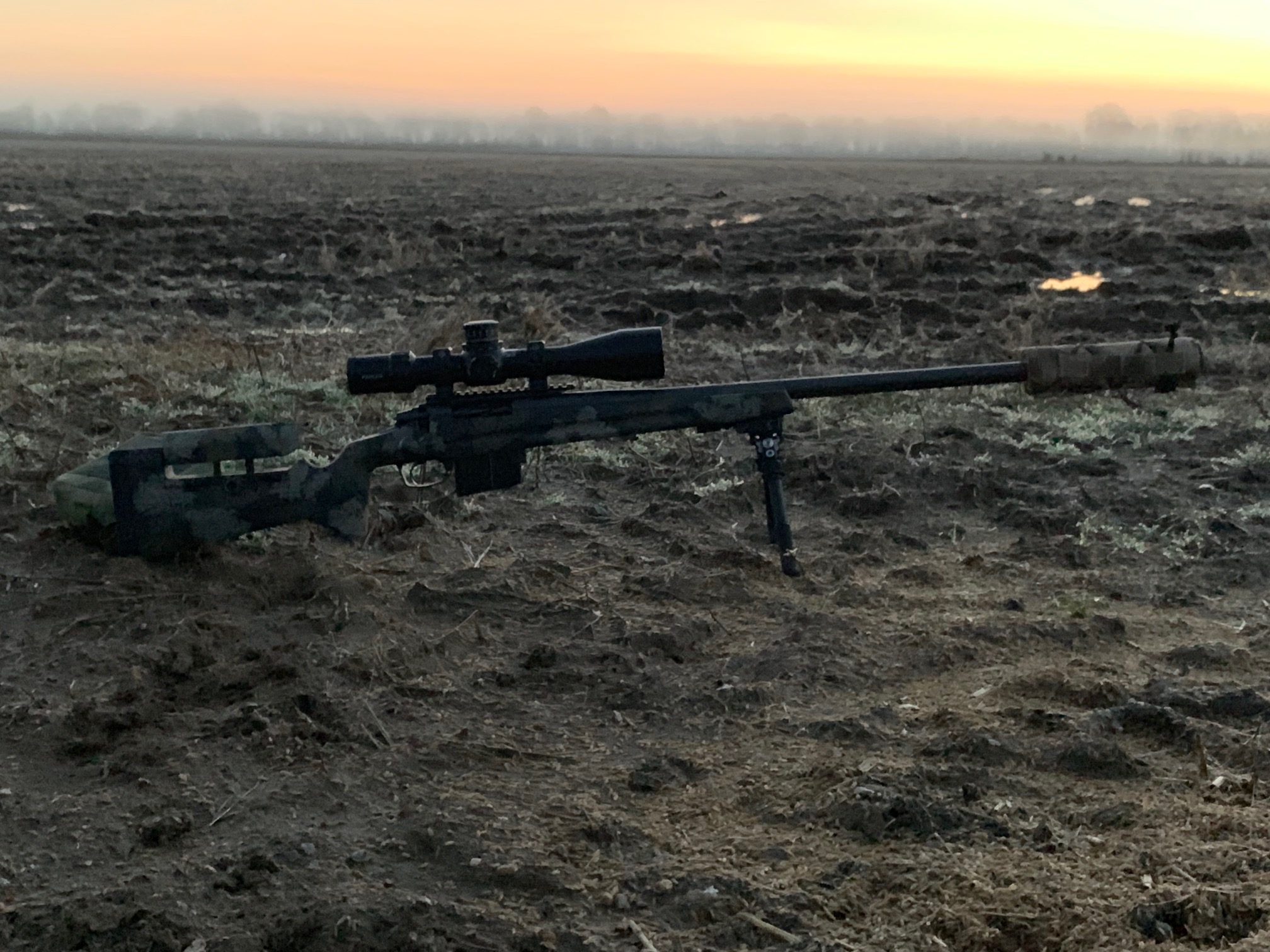

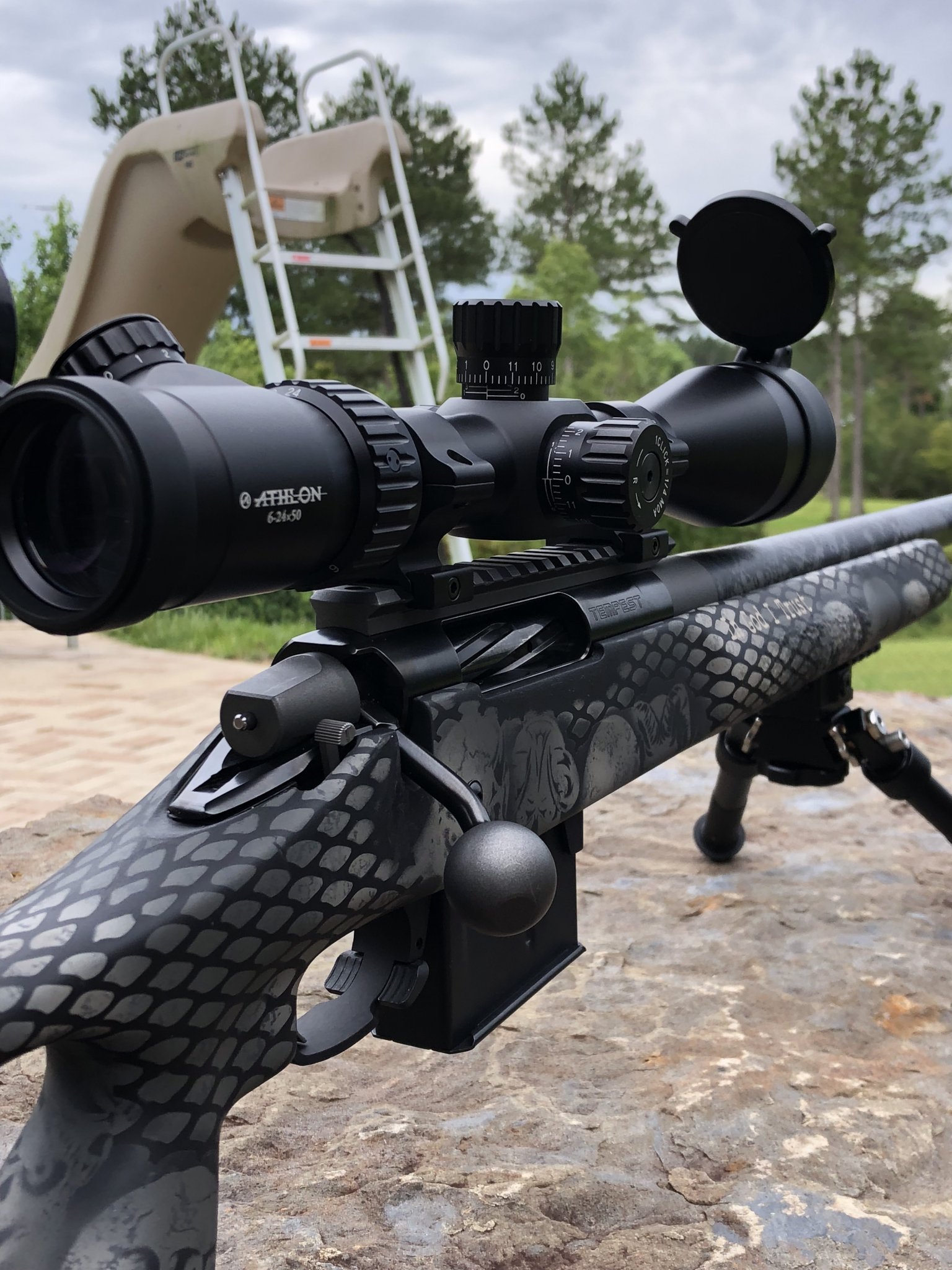

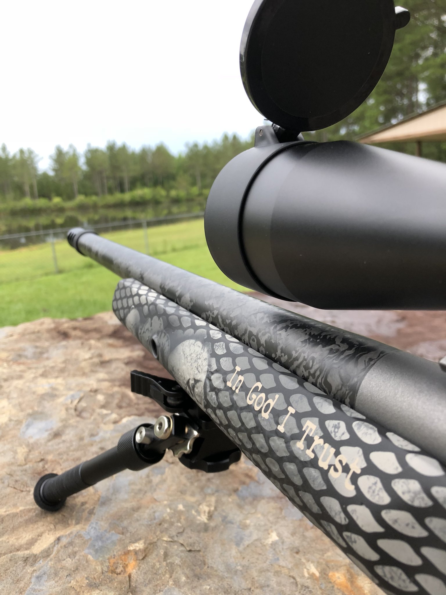

Just ran across this thread.Ive been enjoying my first Tempest a lot!
Tempest Action
Proof 20” Carbon barrel
Area 419 Hellfire Muzzle Brake
Manners T5 with Gen2 Mini Chasis
I was using an Argos I robbed from one of my trainers when I took the pic,since then I’m using an Ares ETR.
Tempest Action
What profile barrel is that mate?

Yeah i thought about it but despite my love for the swept bolt handle i didn’t think it belonged on a hunting rifle. So my second custom which is kind of a hybrid hunting/backup rig i went 90 degree 2-lug. Figured that swept handle would get caught packing in or out on an elk hunt.

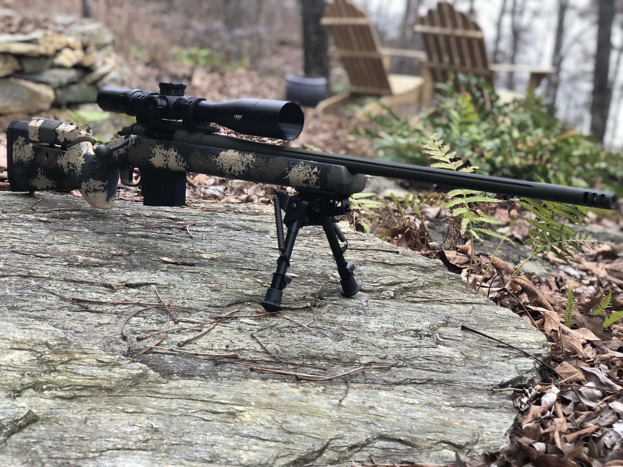

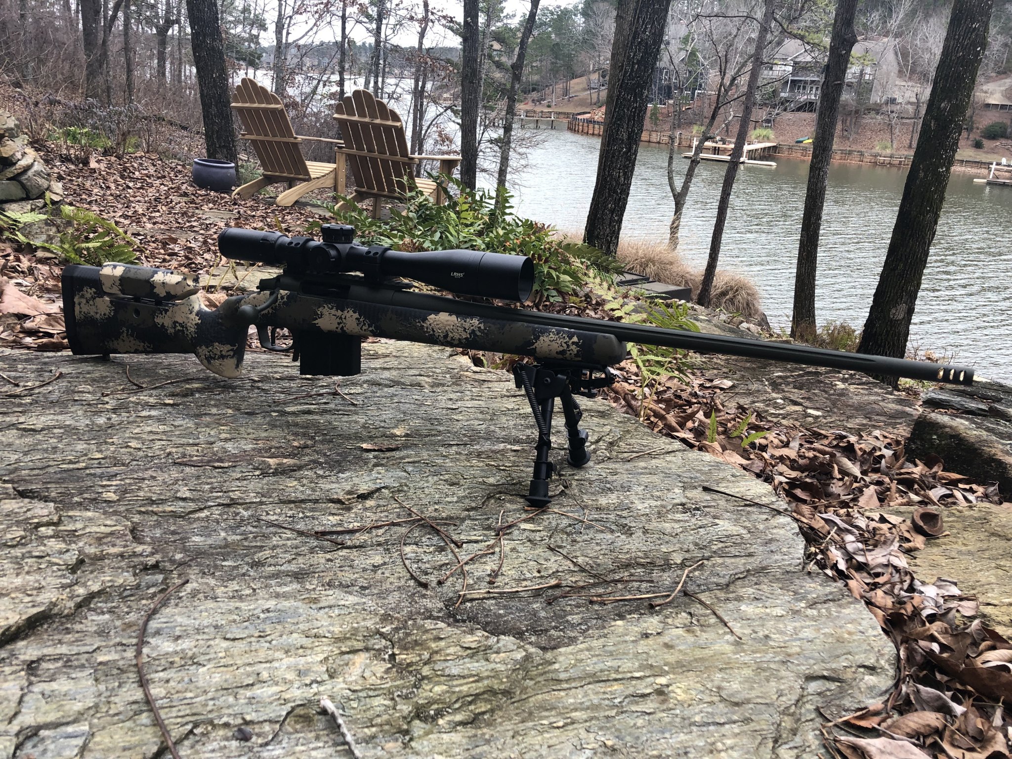

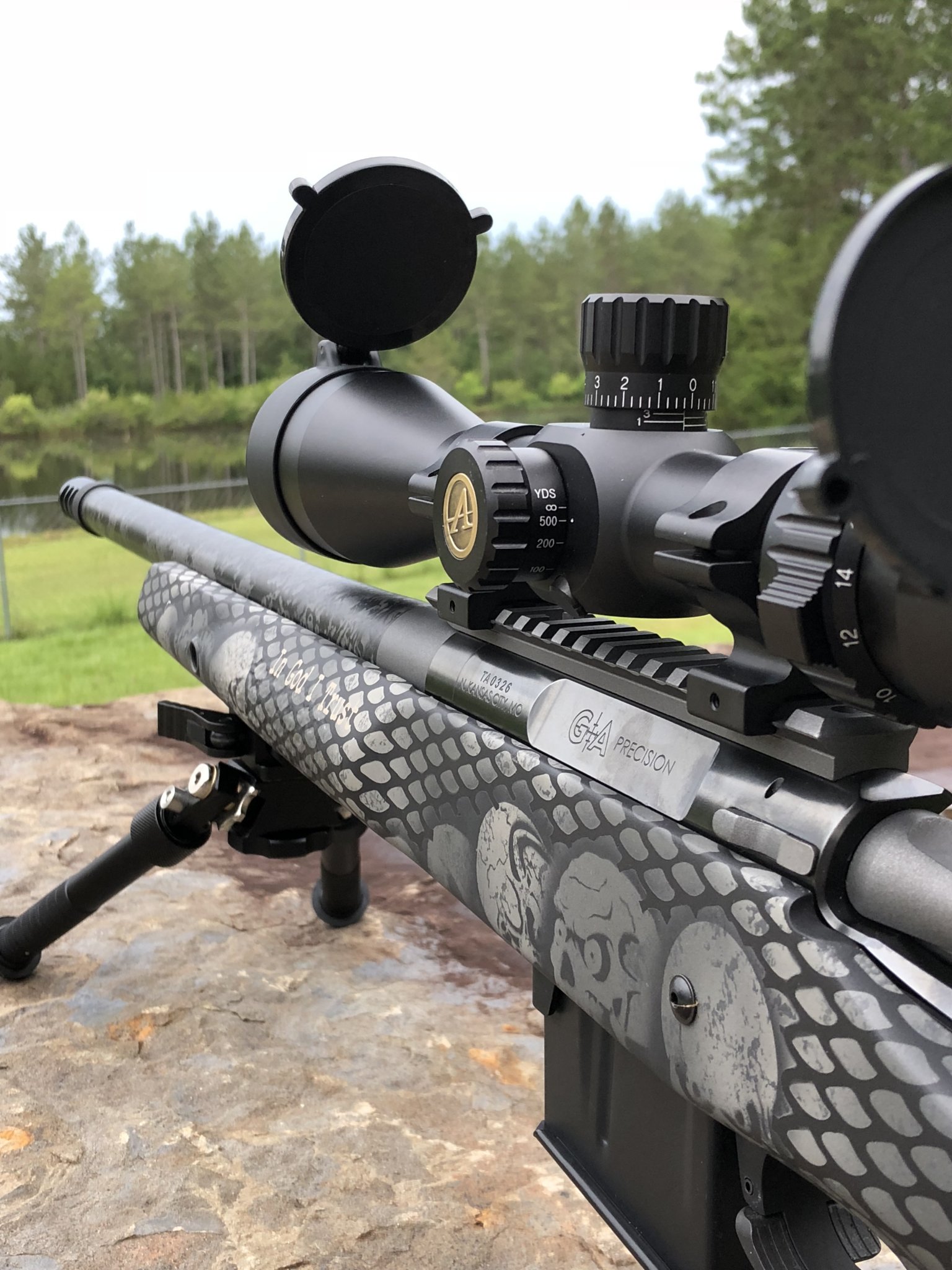

Been enjoying mine for about a year now. Only 620 rounds through it this year but she's a stout performer just started a copper creek load development with 140 berger hybrids, first time doing that so we'll see how it goes. I barely have time to shoot the thing let alone reload for it so hopefully I'll find something it likes. Seems to really like factory hornady 140 eldm's but the sd is 37 from a 20 shot string according to my labradar so that needs to tighten up. A Little heavy for hunting at 14.5 lbs but I've done it because it just shoots so good. Here's the specs:
Gap built Tempest
Bartlein 1-8 GAP #6 contour 6.5 creedmoor
APA little bastard in pics but have since gone to Area 419 hellfire system for use with an omega
Manners PRS-2 swamp (MPA-mini Chassis)
Timney CE 1.25 lbs
sphur rings in some pics but now has badger rings and accuracy 1st level
Schmidt Bender 5-25 Gen II XR

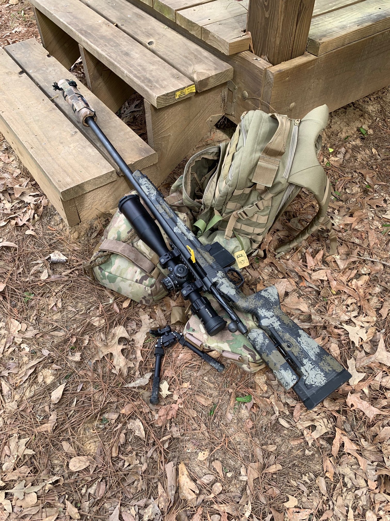

I pulled old faithful out of the safe and swapped her onto this rig. Managed to get 170 rounds through it and fire form enough brass for now. This rifle likes the 162 eld-ms. Next step is to run a velocity ladder and possibly get the freebore lengthened.
Reading old comments and reviews regarding the tempest and I can’t disagree more with a lot of them. There’s no issues holding a sight picture on a target whilst cycling the bolt aggressively, no heavy bolt lift, and the action is the smoothest I’ve felt. Wish I’d gone down this pathway long ago instead of wasting time and cash on other builds.
