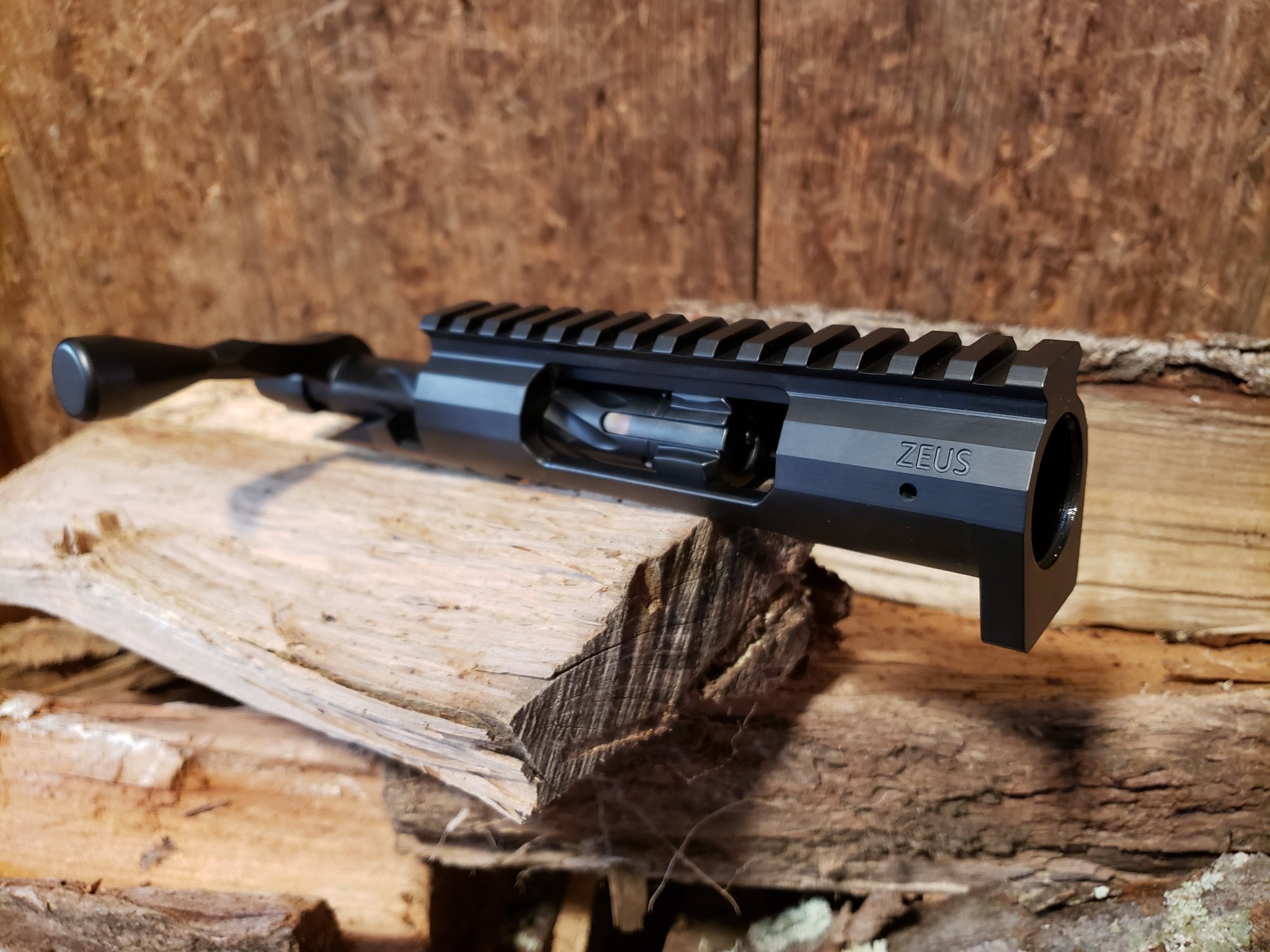

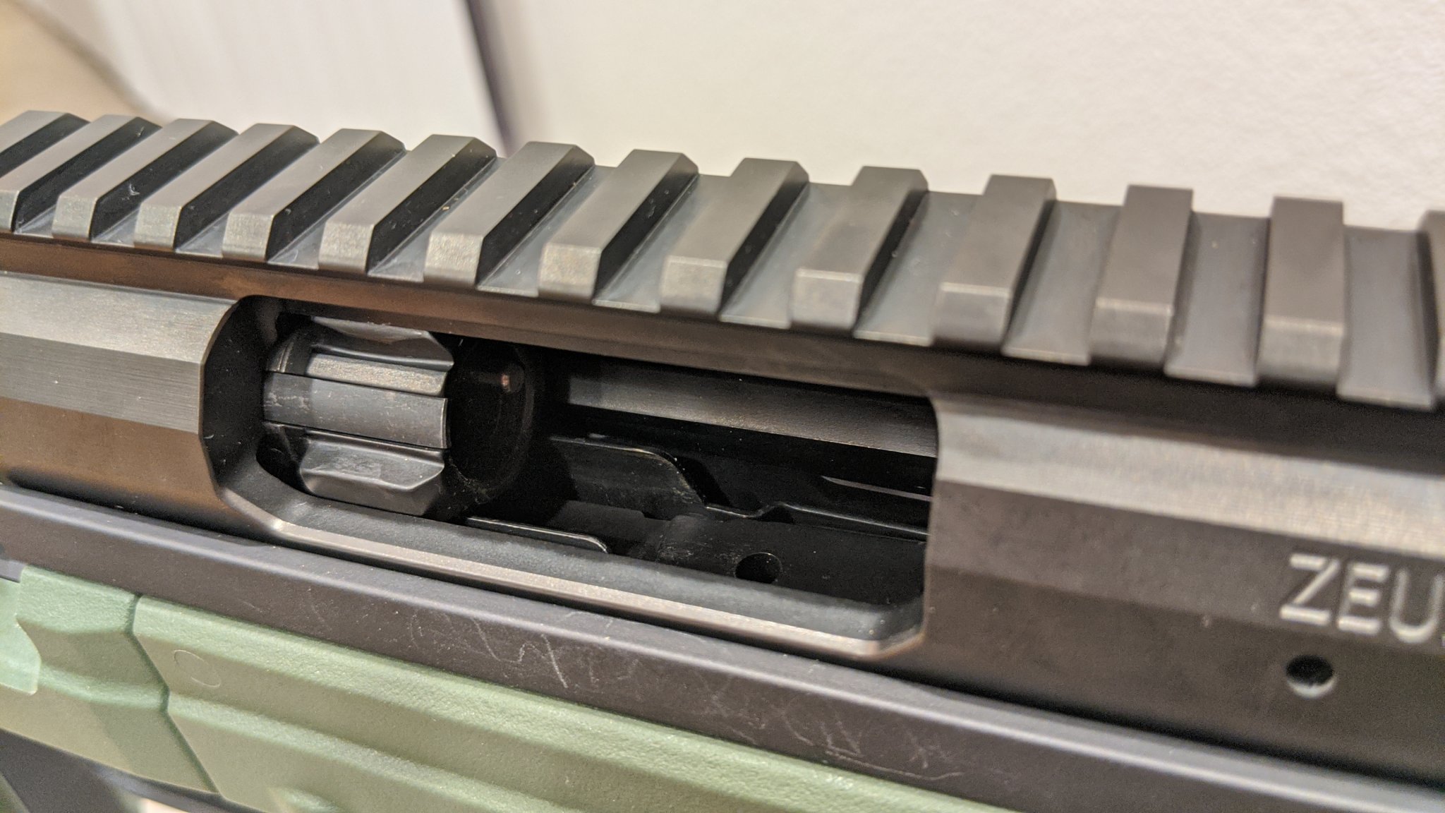

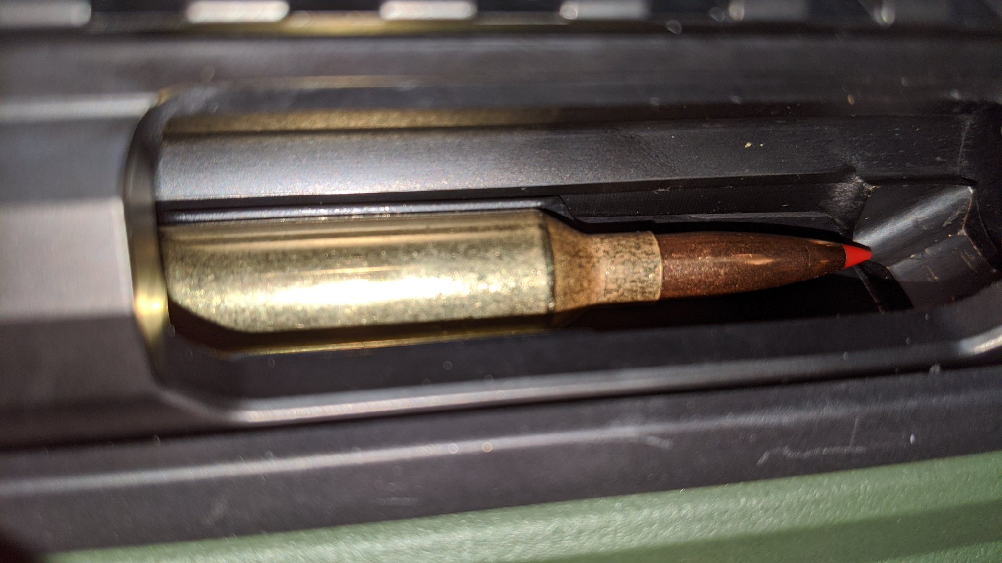

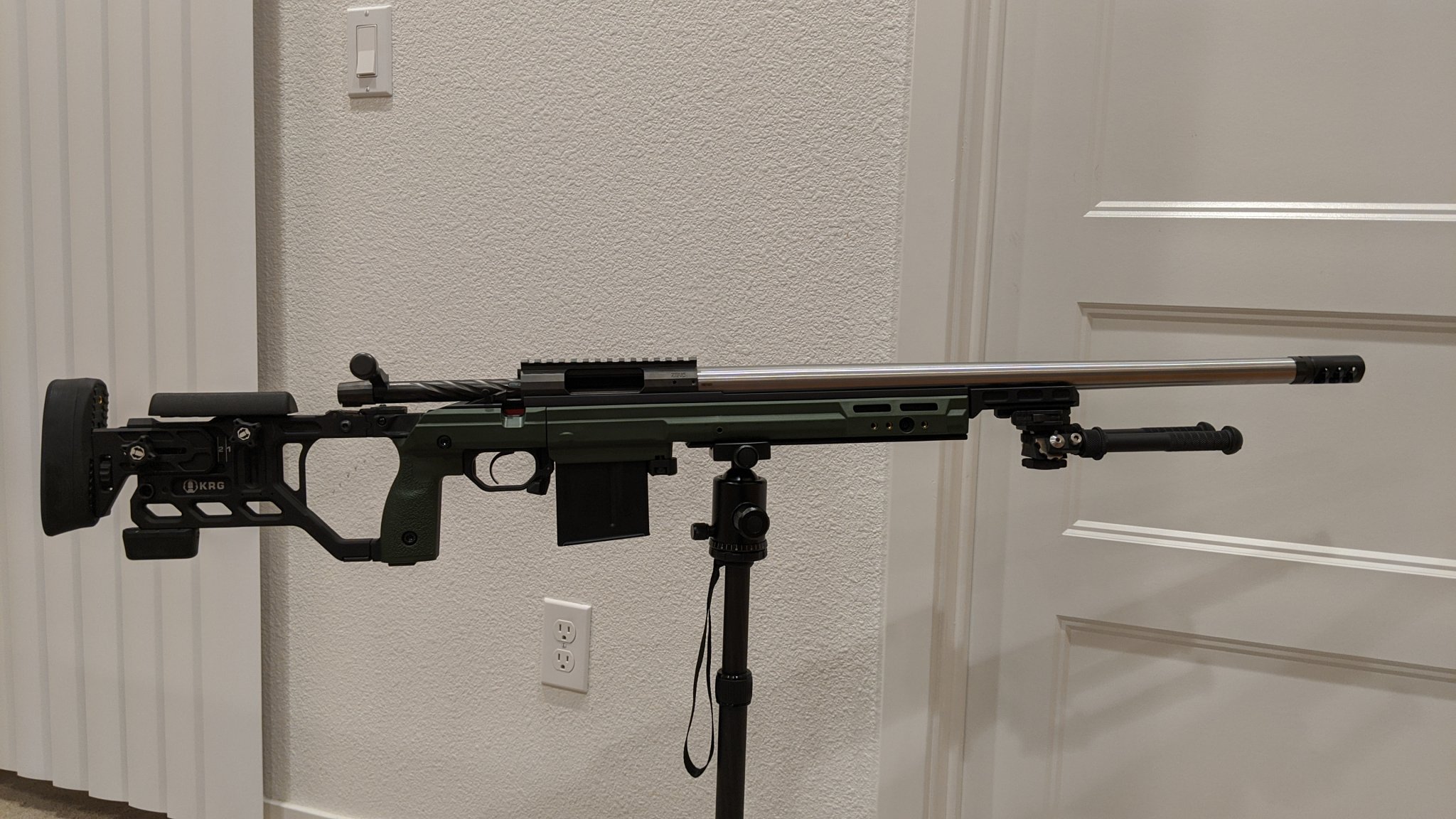

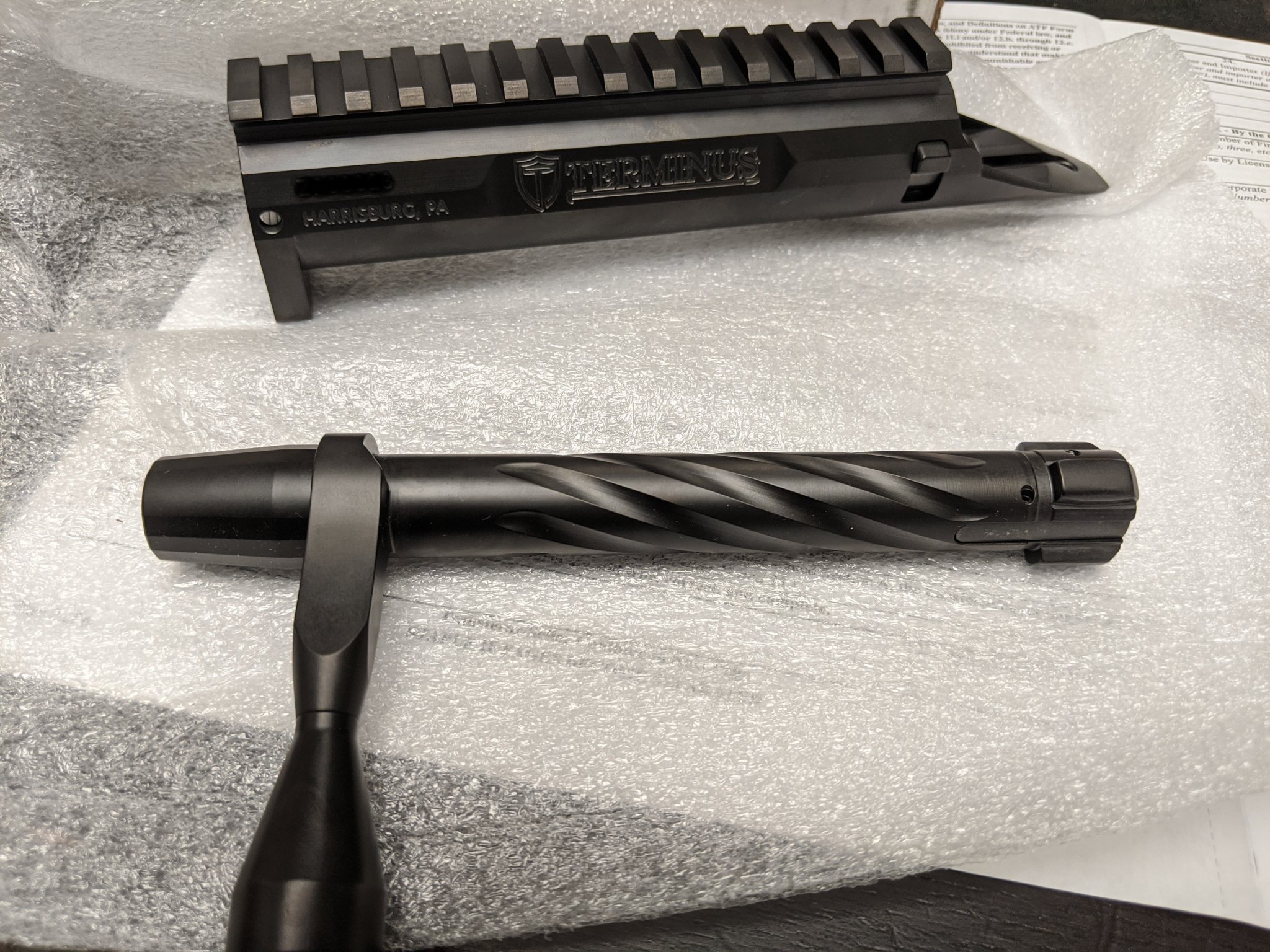

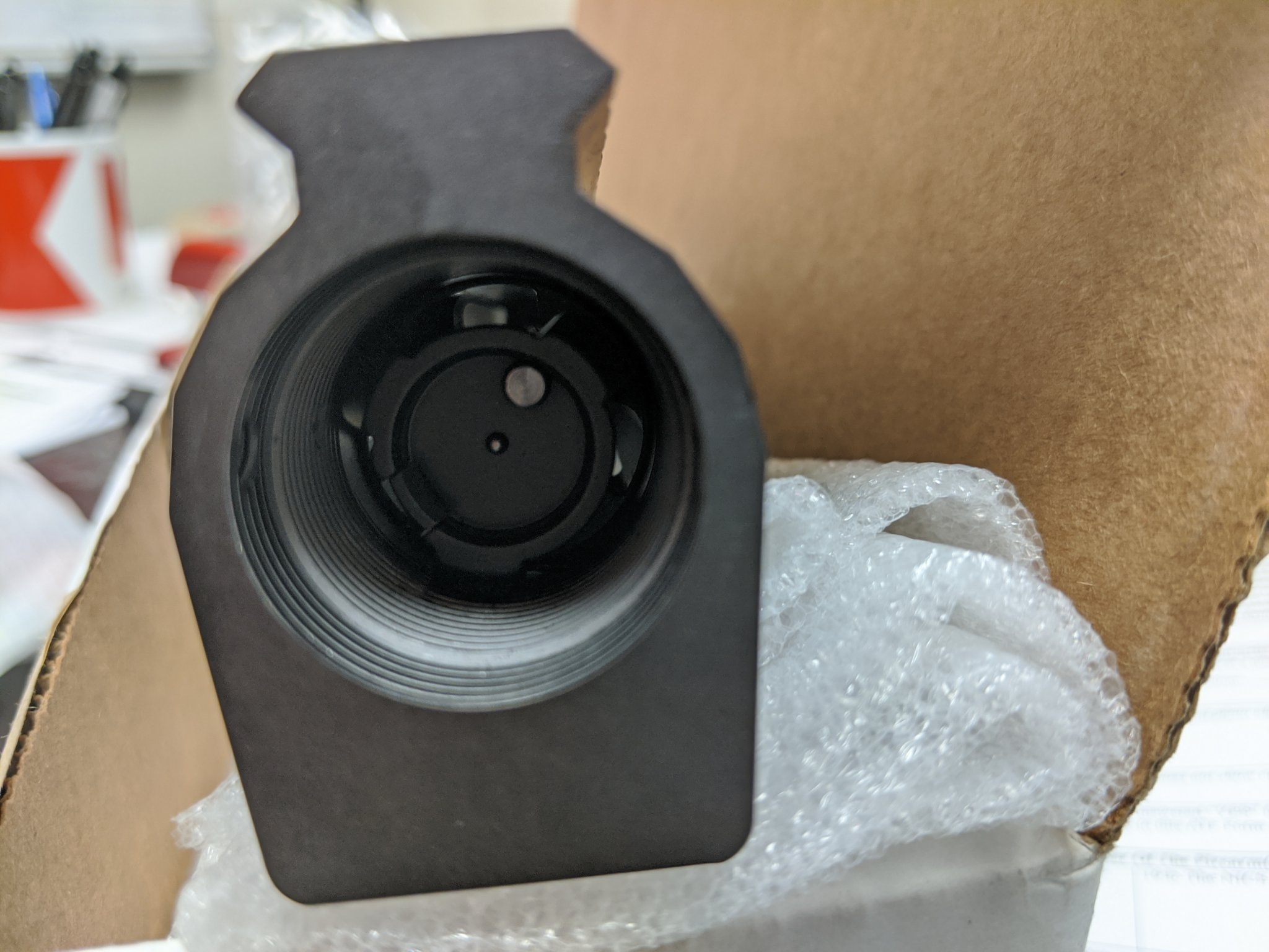

Zeus with switch bbl and 0.725" bolt.
Watch out for the bolt knob...mine came loose...need to add some loctite and torque it down by hand.

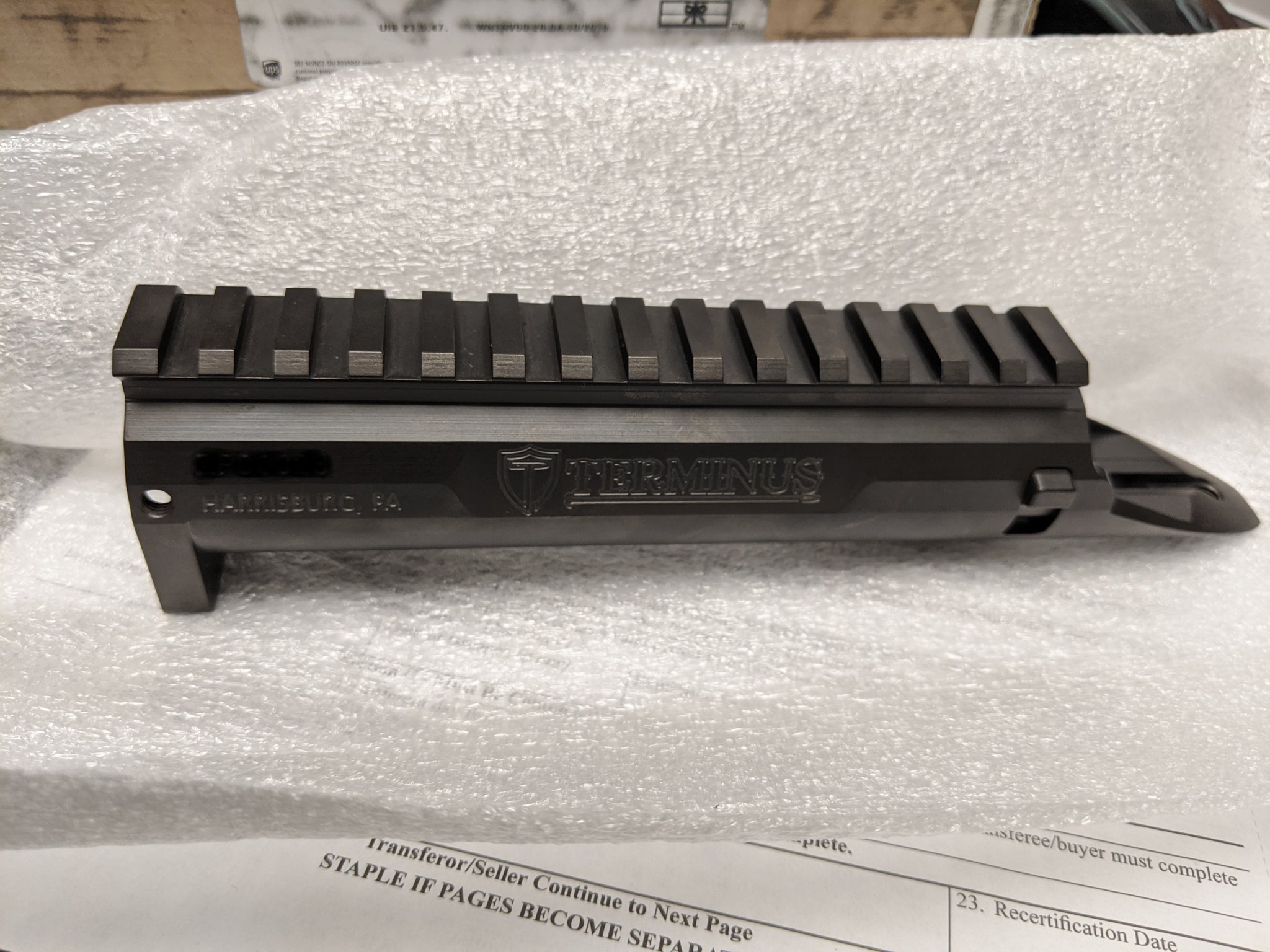

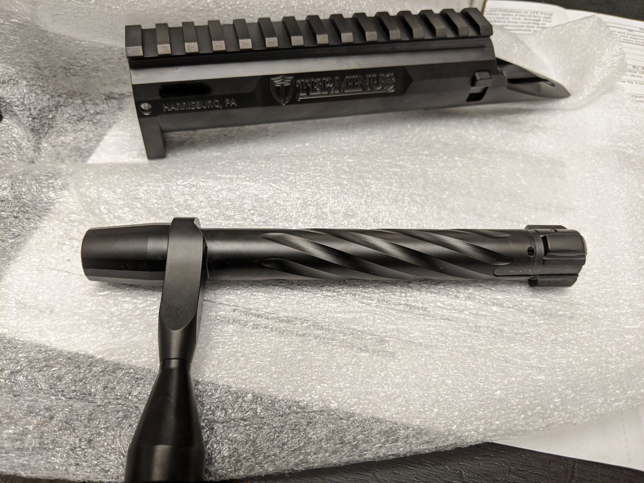

nice looking product I would suggest if you are not doing so already a few videos showing off your actions as there is nothing on you tube except a few on set screws for the trigger and barrel nothing showing what is different about your product from any other action out there . Good luck and best wishes .

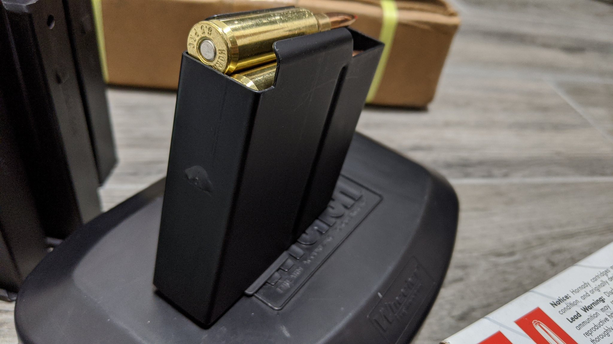

Out of curiosity I mounted the Zeus on a KRG Whiskey chassis and tried a few magazines to see how it would feed (No bbl attached), using 6.5 PRC. And also to see if there were any bolt binding on the feed lips and overall fitment.
Mags I tried:
Accurate Mag 308 (no binder)
Accurate Mag 300 WSM (no binder)
AI AW 308
AW308:
Obviously the AW fit the best in the mag well and perfectly lined up with the bottom of the action. Nice and tight fit none to very little wiggle. Also surprised it clicked in. I had thought I would need to file down the mag-catch (Maybe that's on the Bravo only?). Feeding 6.5 PRC went really smooth! However because of the larger diameter, any jarring or bumping of the AW+6.5PRC combo and cartridges will pop out loose, possibly cause double feed.
Accurate 300WSM:
At its lowest position the bolt will slightly ride the lips. Push on the mag at the rear and the bolt will be blocked. The Whiskey 3 SA doesn't have a Mag stop like the LA version. Feeding works fine but not as smooth as with AW.
Accurate 308:
These actually fit slightly better than the 300WSM. Doesn't taper as much. Pushing up on rear of the mag will block the bolt.
I also picked up some ARC mags to try out.
This was done without the bbl installed so results may differ.
Photos are AW mag

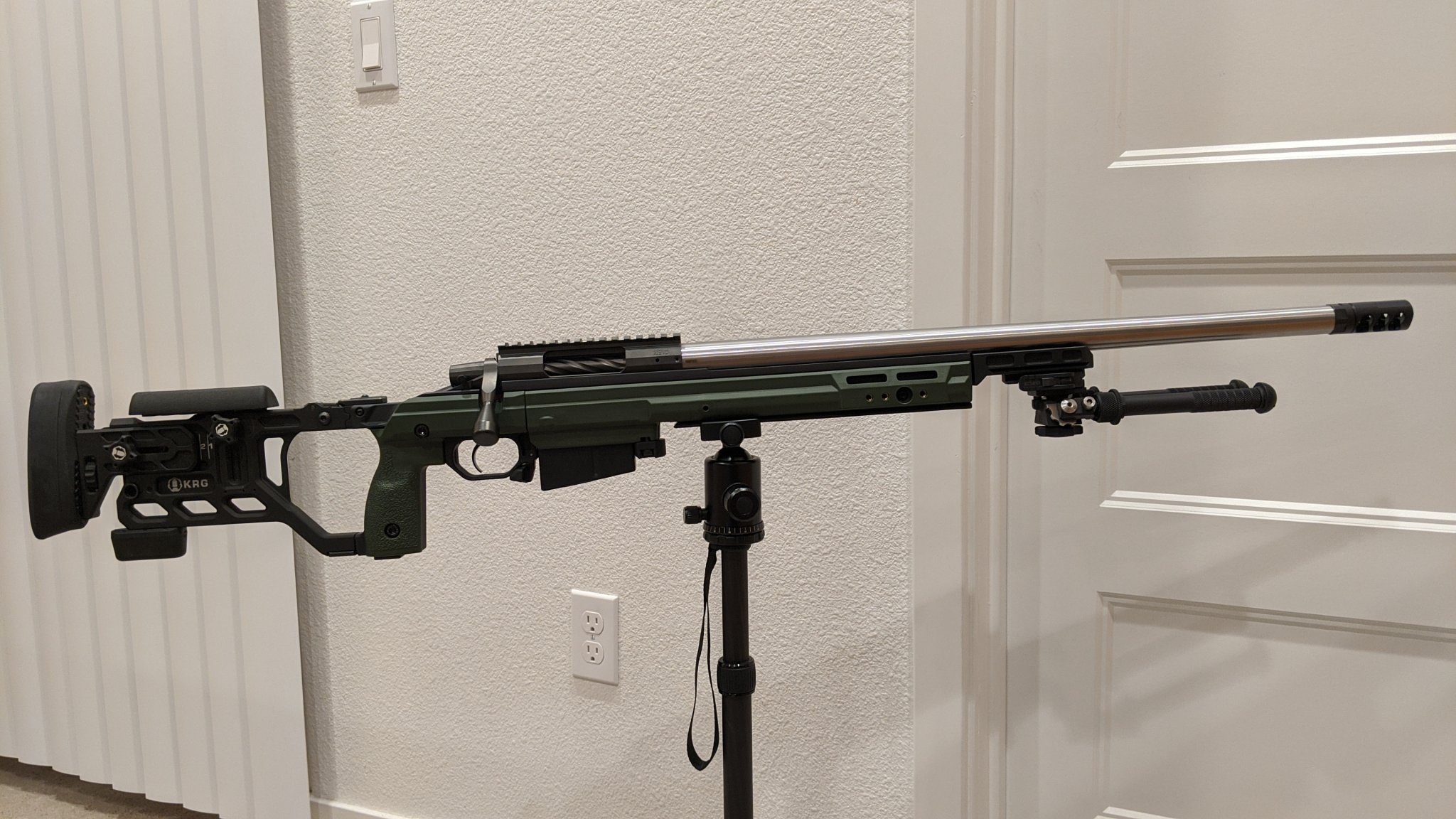

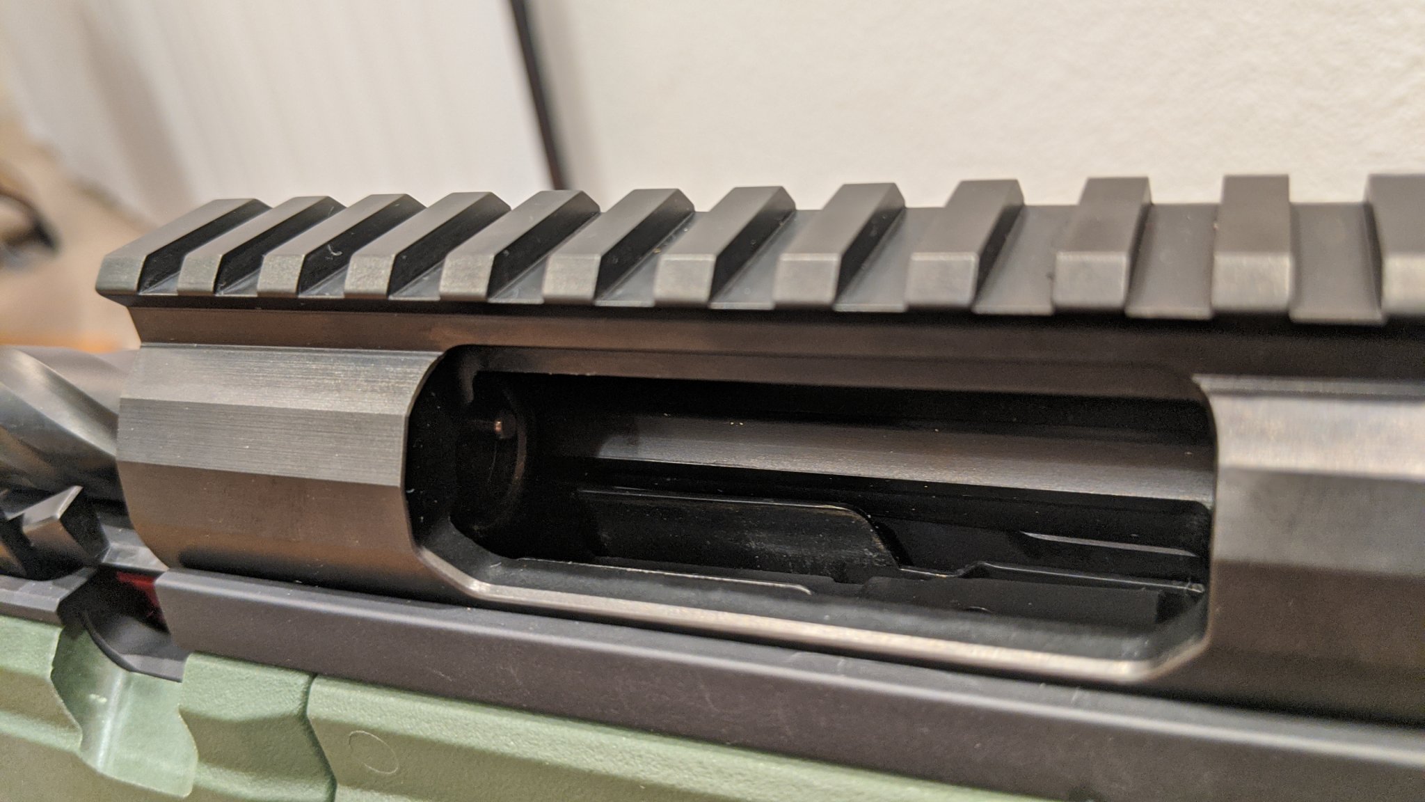

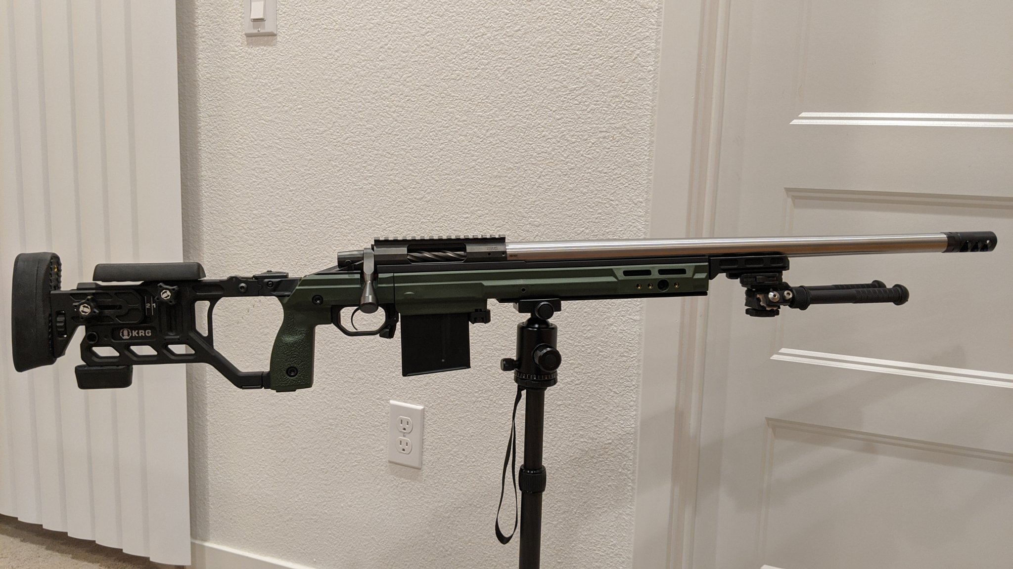

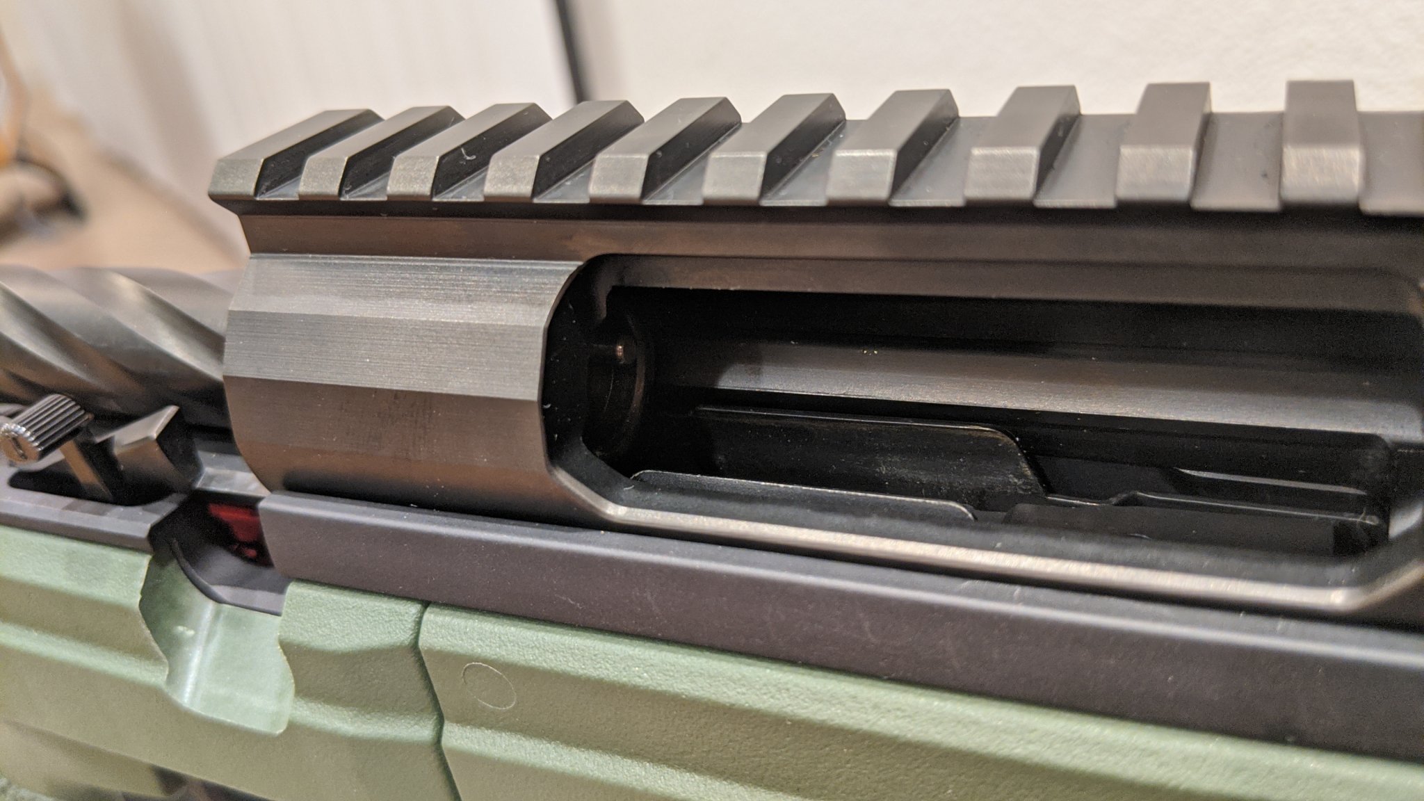

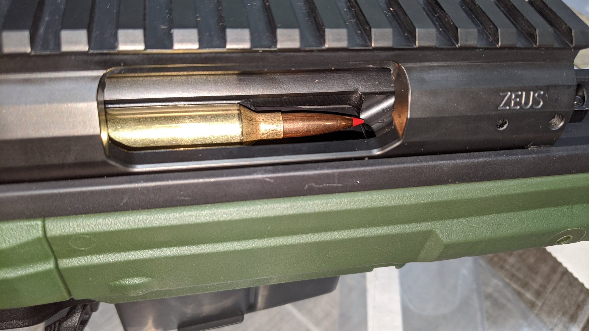

Zeus on a Whiskey 3. Pics of AICS 300WSM (Accurate-Mag). Feeds fine. If you're worried about binding due to pushing on rear of mag...quick fix some duct tape on the mag body to stop it from riding up further. Same thing happens on my Origin with Magpul mags.
AW mags feed the smoothest. AX308 mags won't fit, looks like the front of the mag extends a bit.
I'm planning to use both mag types..and possibly others too.
