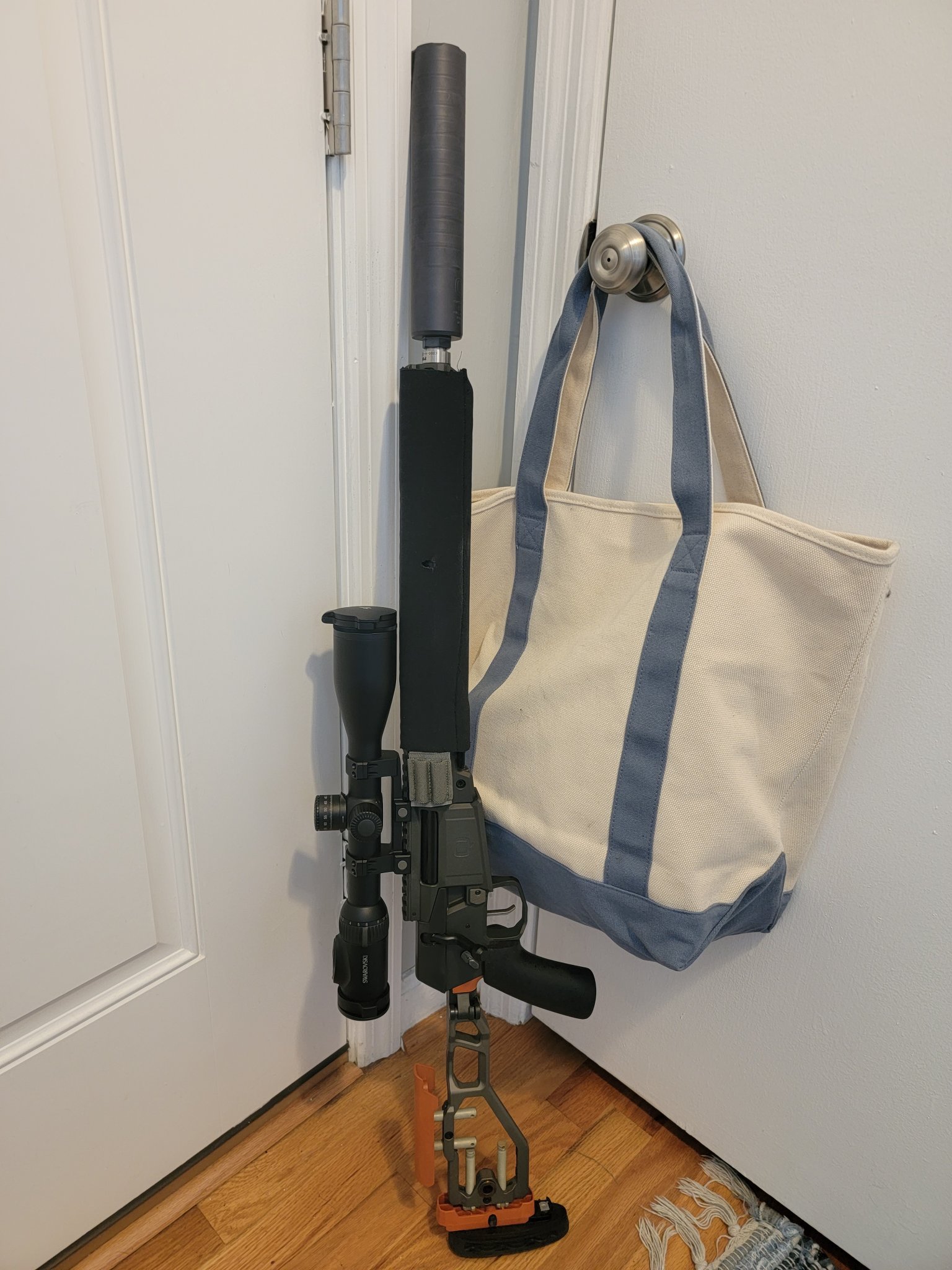

One more suggested tweak for the V2 (other than straight pull boltšŸ˜).....some accommodation for thermal scopes with a PVS14 eyepiece and limited eye relief.....think Trijicon and N-vision. My Trijicon Reap is very functional, but if I could gain 1/2-1ā€ of eye relief it would be perfect. Not sure if this is possible given the bolt travel back to the adjustable comb does not give any variance. An extended picatinny rail over the bolt shroud would probably require a higher rail height. Not sure the solution but it would sure make this platform a desirable choice amongst night hunters using dedicated US made thermal scopes and not clip ons on a bolt rifle.
You need a company to produce a mount that fits the scope to the rifle rather the rifle to the scope.
itā€™s a shame the scope isnā€™t popular in Europe. There are several companies producing mounts for Pard NV008 scopes which suffer the same issues.
Bobro makes one. But it really is not a big enough issue for me to spend the money to swap it out. Plus they are a little scarce these days. In the field when I am hunting I donā€™t really notice it. Mainly at the range when plinking. But may swap it out next season if they become readily available again.

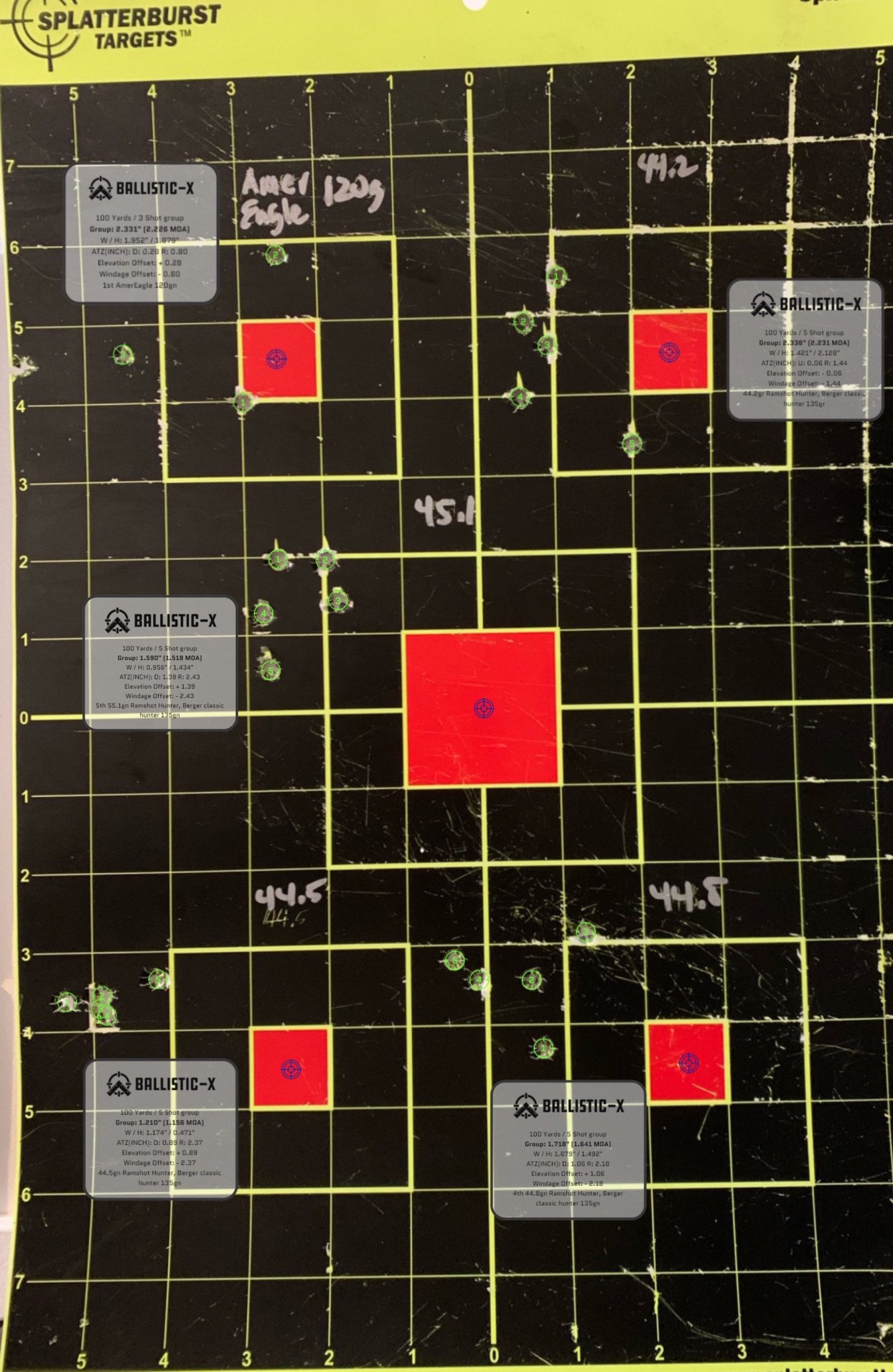

I finally found everything I needed to start reloading (complete newb here, but have done a ton of reading!) and so went through the process of figuring out my COAL and length to Ogive for the Fix (16ā€ 6.5cm with a Thunder Chicken) before figuring out that the stock SR25 PMAG it comes with seems WAY too short to fit what would be 20-40 thou off the lands, which is what I see recommended by Hornady, Berger, and others. I measured 2.868 with a split case and Berger Classic Hunter 135gn, and 2.9305 with the Hornady gauge, and the PMAG looks to be around 2.832. Are people running different mags in the Fix? Does it make a big enough difference to be worth it? My particular fix shooting
from bags seems to hate Factory American Eagle 120gn (huge groups) but I was able to get a decent group with 44.5gn of Ramshot Hunter, the 135gn Bergers, Lapua brass, and CCI 400s, but nowhere near as accurate as what Iā€™ve seen other people post. Just wondering how much I should pursue longer COAL mags (Knightā€™s for example) versus trying to locate other powders to try. Itā€™s so hard to find components now and I was starting from zero, so as much fun as Iā€™m having trying different loads, I should probably focus where the most potential gains might come from.... This afternoon I did cook up a set of 5 rounds with 44.5gn RamShot Hunter @ 2.830 for the stock PMAG and then another 5 with 44.5gn but at 2.860 that I will chamber by hand to see if the longer OAL made them group tighter. I feel like that may not be a valid comparison, because maybe with more room in the case, more charge might be needed to maintain the same pressure, so the longer OAL may actually make for worse groups with 44.5gn but could be tighter with a higher charge. Or something... I havenā€™t shot them yet, so I guess Iā€™ll see what happens.
I also have some Winchester ā€œ6.5ā€ that I havenā€™t even looked up the load data for yet...

I finally found everything I needed to start reloading (complete newb here, but have done a ton of reading!) and so went through the process of figuring out my COAL and length to Ogive for the Fix (16ā€ 6.5cm with a Thunder Chicken) before figuring out that the stock SR25 PMAG it comes with seems WAY too short to fit what would be 20-40 thou off the lands, which is what I see recommended by Hornady, Berger, and others. I measured 2.868 with a split case and Berger Classic Hunter 135gn, and 2.9305 with the Hornady gauge, and the PMAG looks to be around 2.832. Are people running different mags in the Fix? Does it make a big enough difference to be worth it? My particular fix shootingView attachment 7617045 from bags seems to hate Factory American Eagle 120gn (huge groups) but I was able to get a decent group with 44.5gn of Ramshot Hunter, the 135gn Bergers, Lapua brass, and CCI 400s, but nowhere near as accurate as what Iā€™ve seen other people post. Just wondering how much I should pursue longer COAL mags (Knightā€™s for example) versus trying to locate other powders to try. Itā€™s so hard to find components now and I was starting from zero, so as much fun as Iā€™m having trying different loads, I should probably focus where the most potential gains might come from.... This afternoon I did cook up a set of 44.5gn Ramshots @ 2.830 for the stock PMAG and then another 5 with 44.5gn but at 2.860 that I will hand-load to see if the longer OAL made them group tighter. I feel like that may not be a valid comparison, because maybe with more room in the case, more charge might be needed to maintain the same pressure, so the longer OAL may actually make for worse groups with 44.5gn but could be tighter with a higher charge. Or something... I havenā€™t shot them yet, so I guess Iā€™ll see what happens.

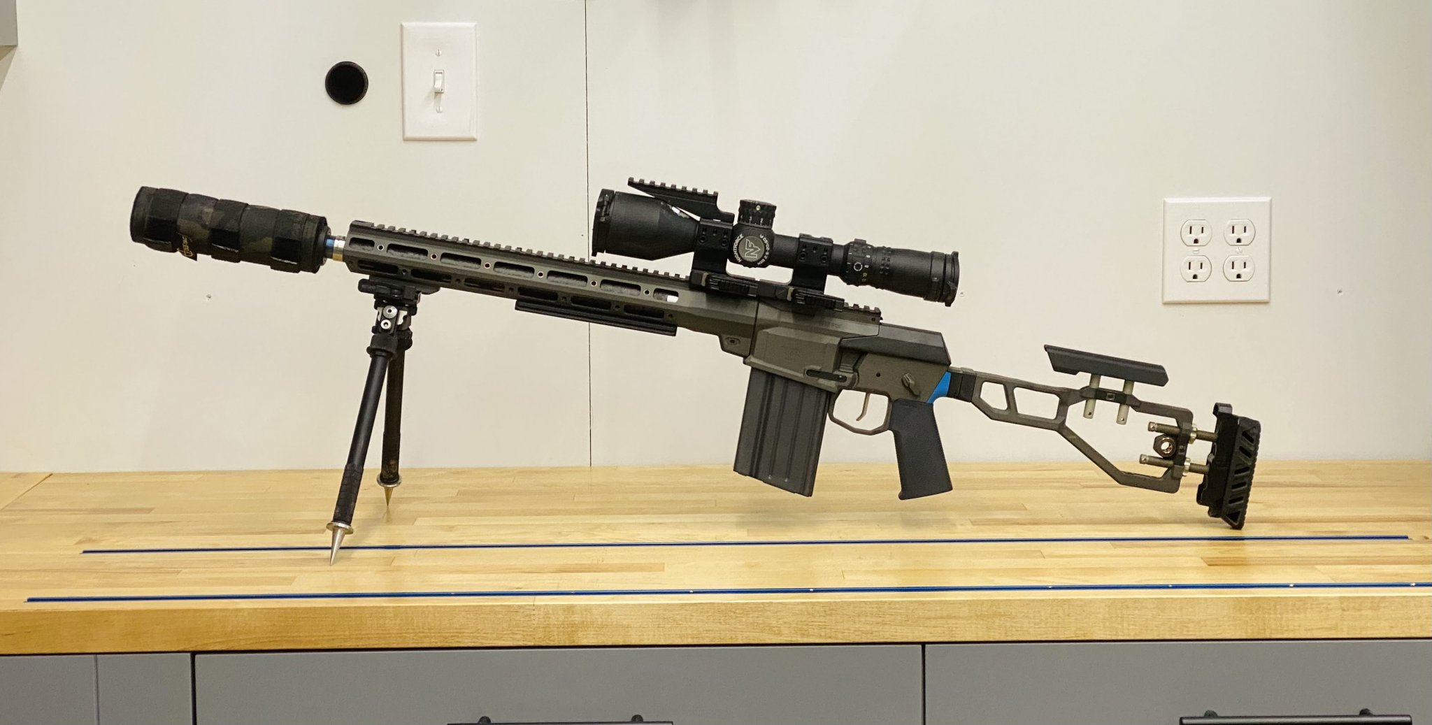

You got me all jazzed up. I want one. Do you have a pic of one of your barrels and the full length rail?
Is that like a beer coozy, but for a rifle? That would be the bees knees for when I snuggle my Fix.
Yes. Sort of.
There is a full length arca rail mounted on the bottom of the handguard. Then that neoprene sleeve over it. Was a cover for a crappy aluminum tube ar handguard. Someones wife made them an extra and I got it.
Its purpose is to keep the window sill on my Lexus from getting dicked up. Or my hand from freezing when its cold as balls.
The flat arca and gey cover is perfect for what I use that Fix for...
