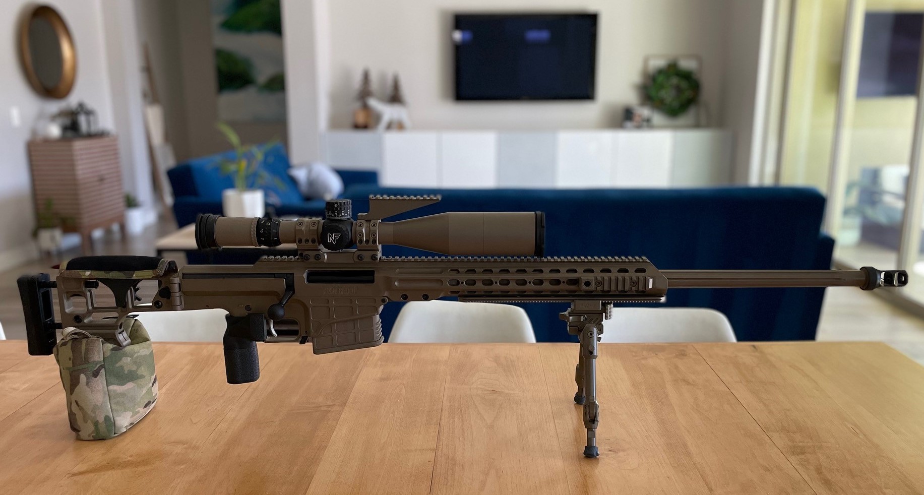

Or just Cerakote your barrel, mags, Niightforce Scope, ARCA Rail, Bipod and Bagrider. :LOL:

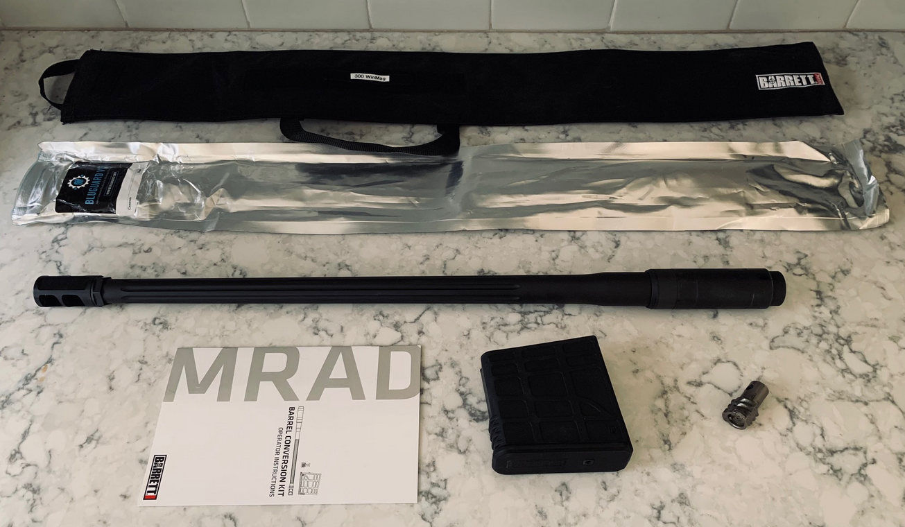

Got my 300 PRC Proof Barrel in today, wasn't a terrible wait ordered it back in Oct. Need to find a solution for the shoulder being wider than the brake I have.
Reactions: Dooby
Proof Research does the full build still need to order a B magazine.
Yeah the brake is by Rearden and works with all my suppressors. I rarely shoot unsuppressed now and days. My 6.5CM has the same brake so it works for the dedicated can for the MRAD.
As fair as weight I havent been able to find what the steel Barrett version is in weight. Proof says the 26" is 5lbs 3oz. But my 6.5CM 24" barrel is 6lbs 10oz

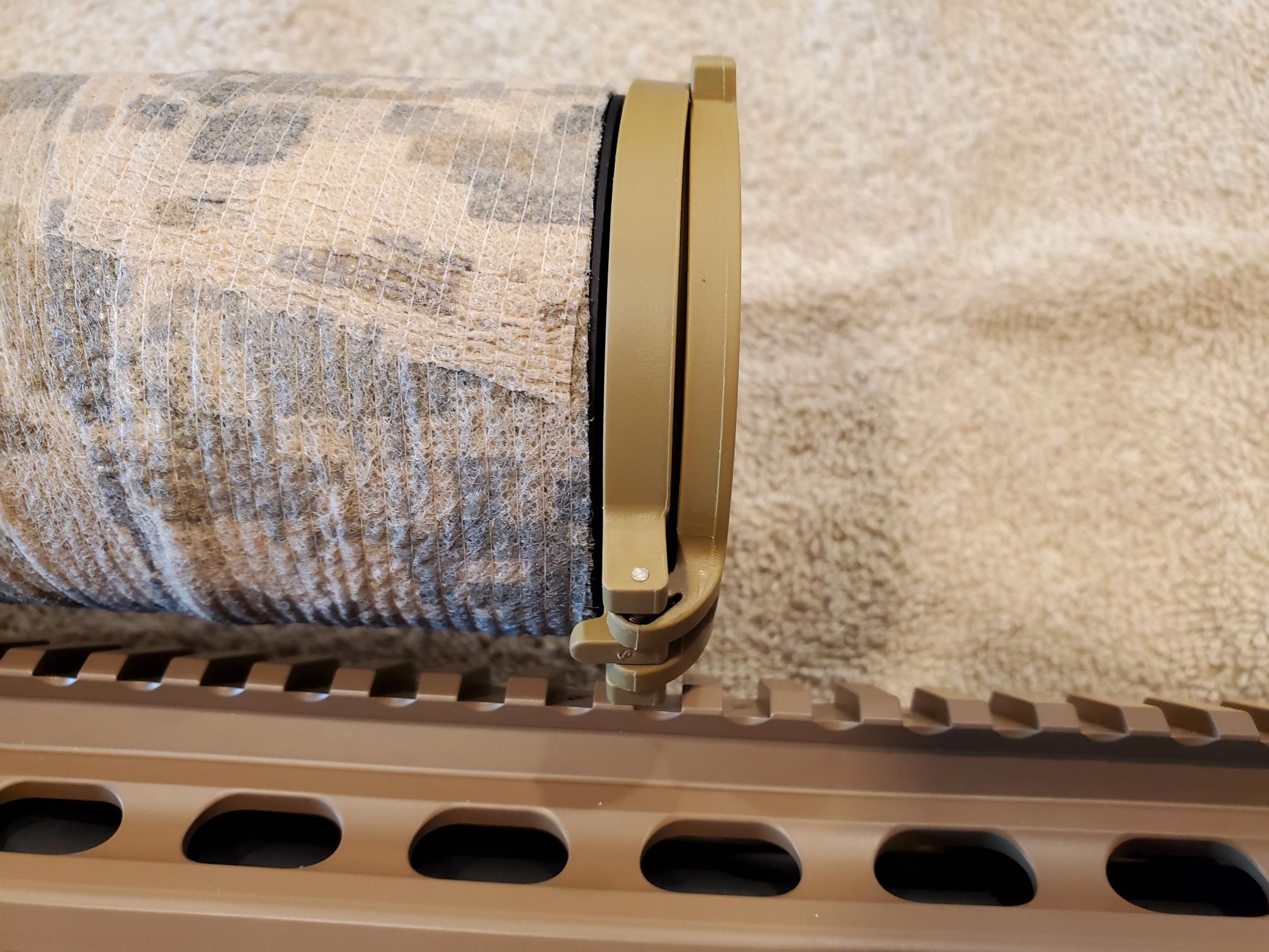

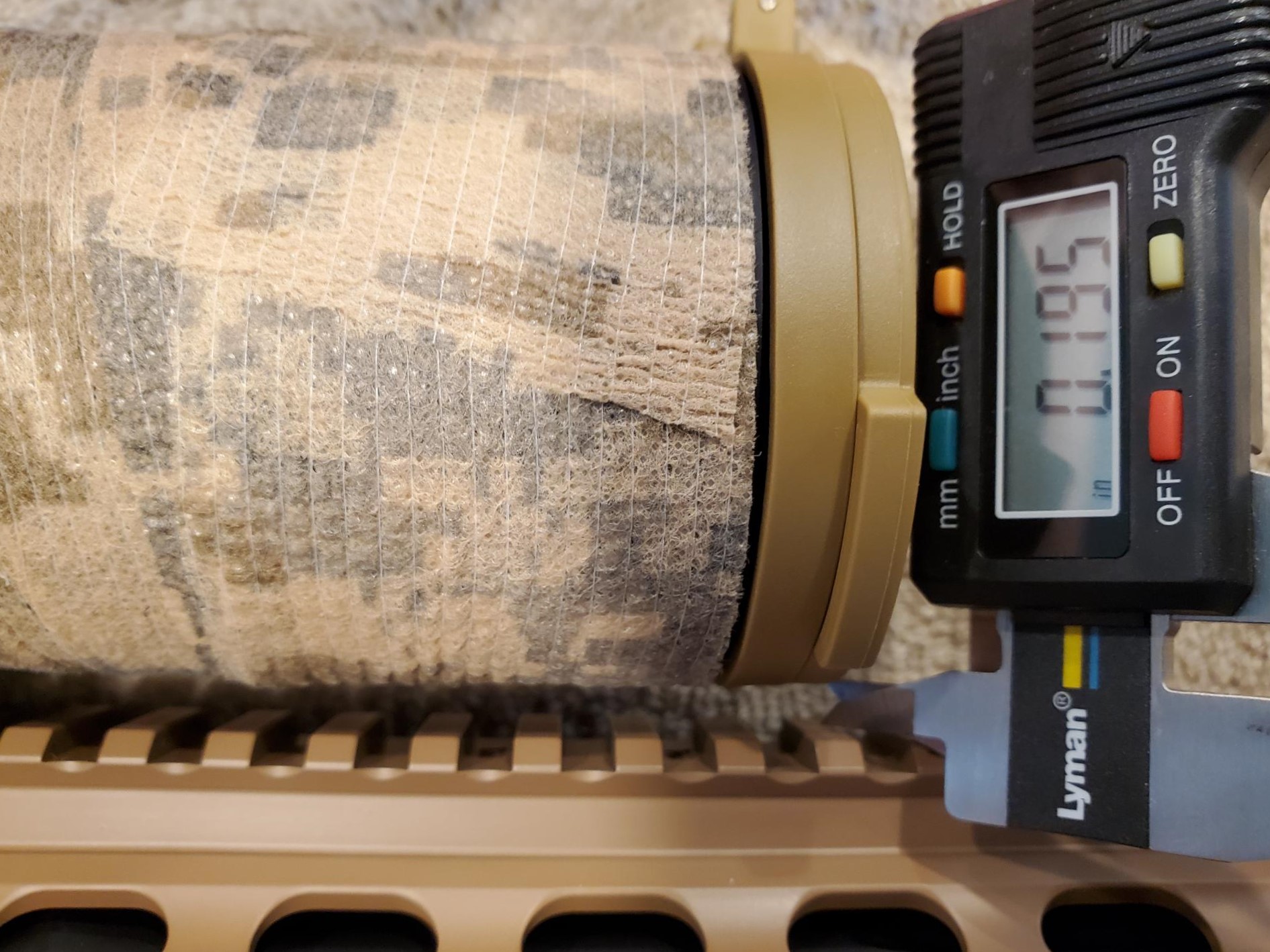

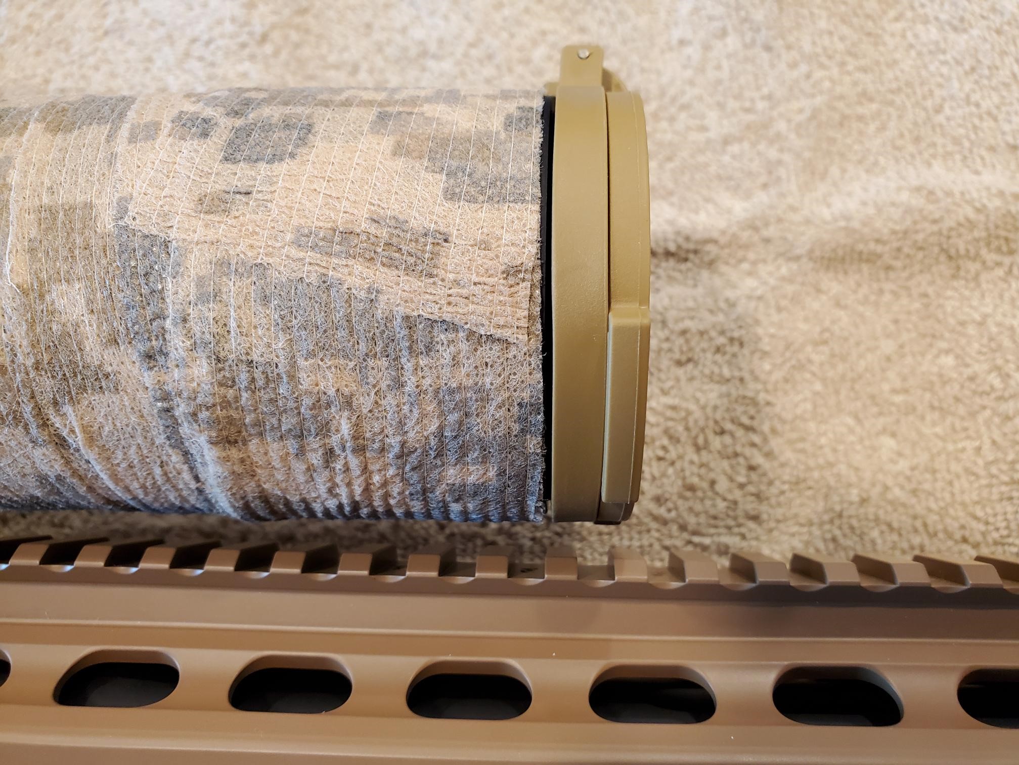

How much room underneath cap to top of rail, waiting on MRAD but already order same scope but ordered 34mm Spuhr mount?
I ordered this and it sits perfect on the MRAD with just a hair clearance for the cap: Spuhr SP-4602: 34mm Picatinny Mount 6MIL/20.6MOA - 1.50"-FDE. If you plan on using this for ELR, the additional 6mils will be desirable.
Reactions: JOEREZ
Here are some more pics. You will see that the scope cap will not fit if the cap is flipped down. If you want to flip your objective lens cap down, you will need a higher mount, such as the SP-4004 (48mm) or the SP-4008 (44mm).

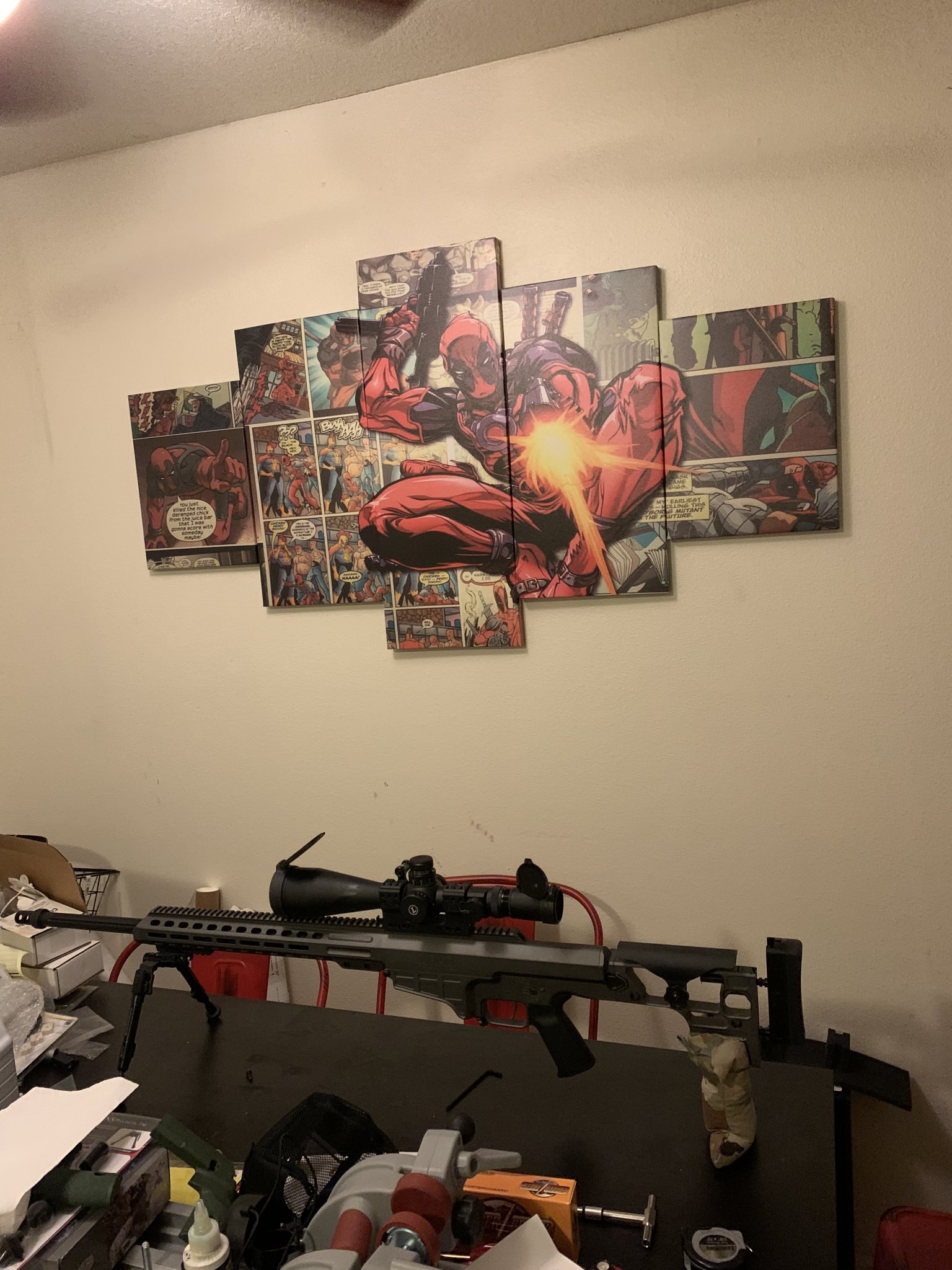

View attachment 7778426Just picked up my first MRAD. Looking for any/ all advice from folks with experience. Will be firing first rounds tomorrow. Anyone have good DOPE cards for 175 FGMM or .300 NM 215 BERGER? What do you usually feed it? (I am unable to do my own reloads currently) Located in OR for anyone who’s down to send rounds. I’m always open to network/ meet new folks with the same passions.

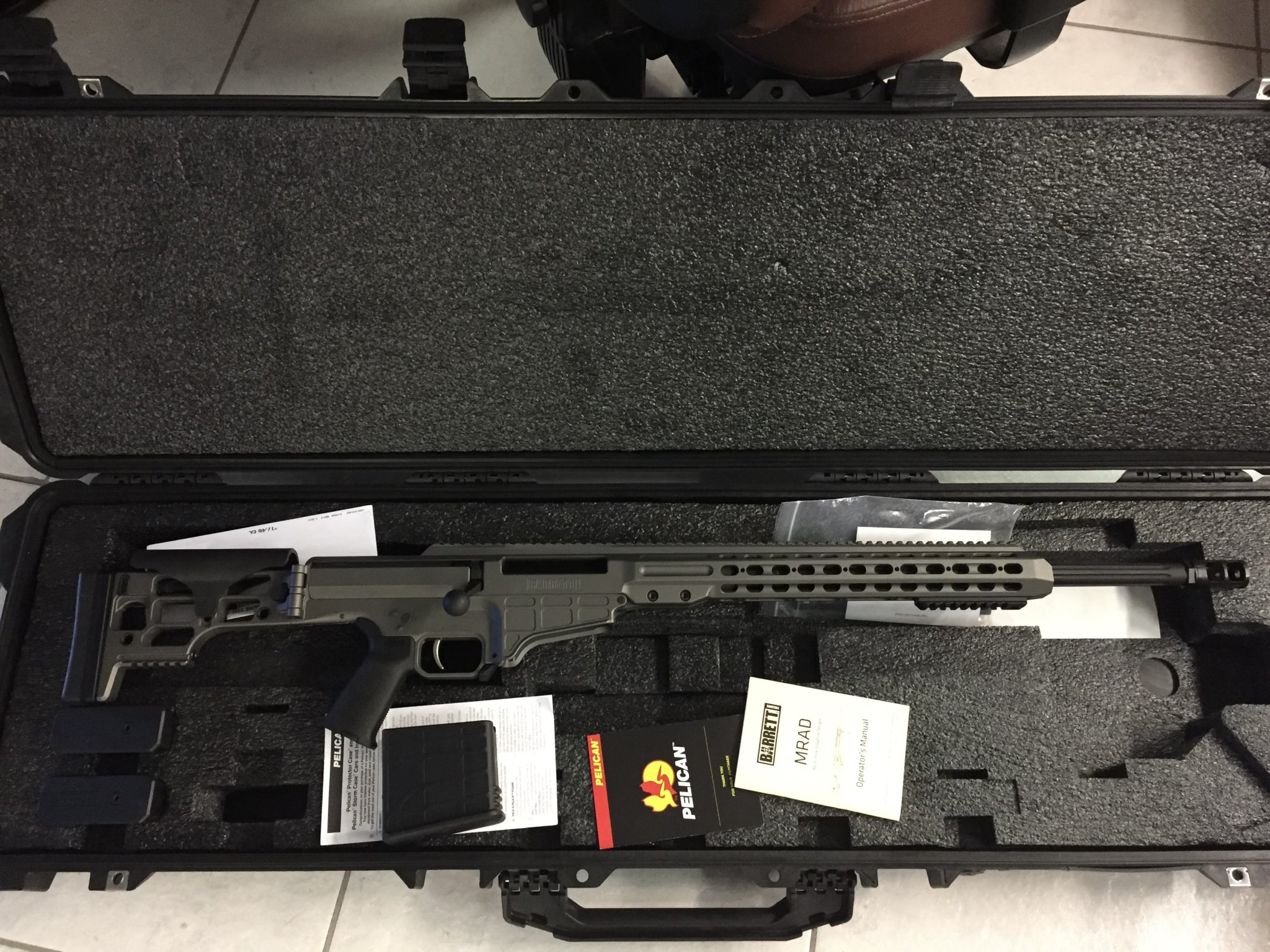

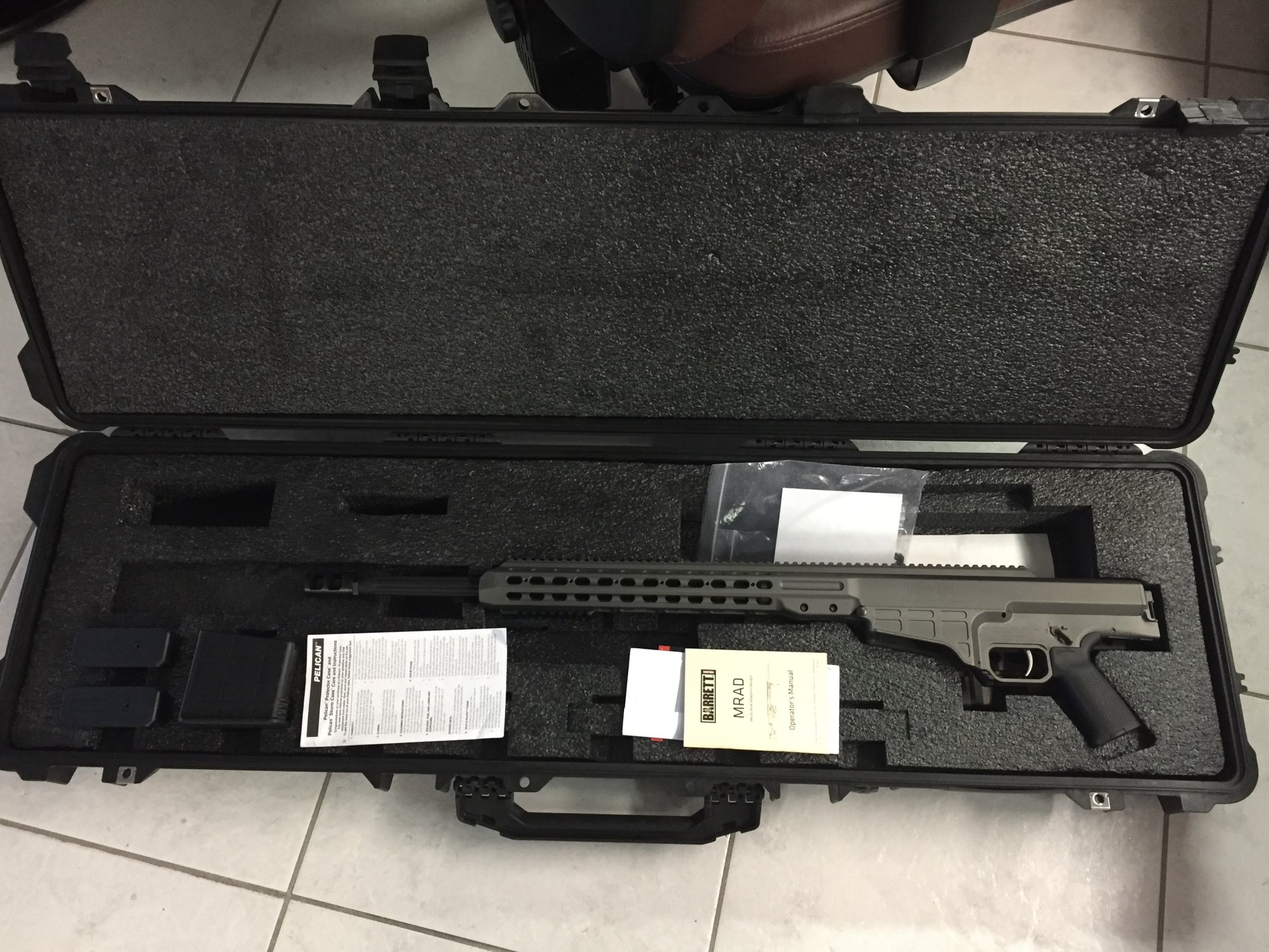

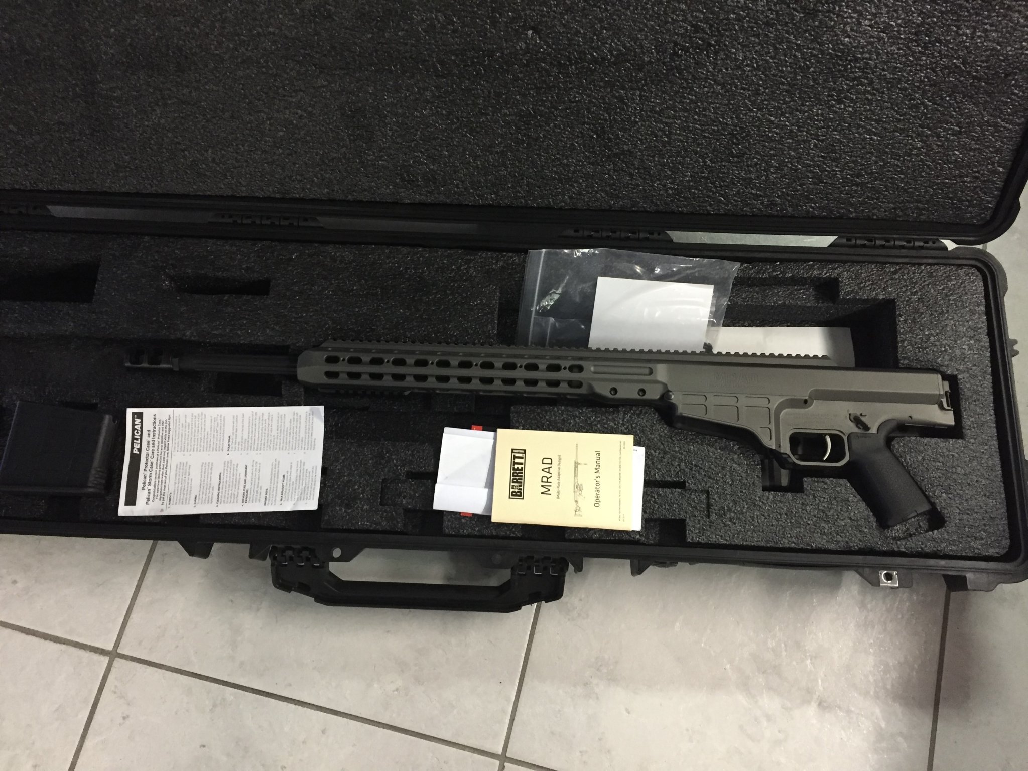

Well I picked up a NIB MRAD in 308 in a trade. Looking forward to it. I’m going to toss a ATACR 4-16x42 mil-XT on it. Really didn’t want a 308 but hell in today environment 308 bullets and brass are easy to come by. Glad I did not sell my brass dies and bullets.

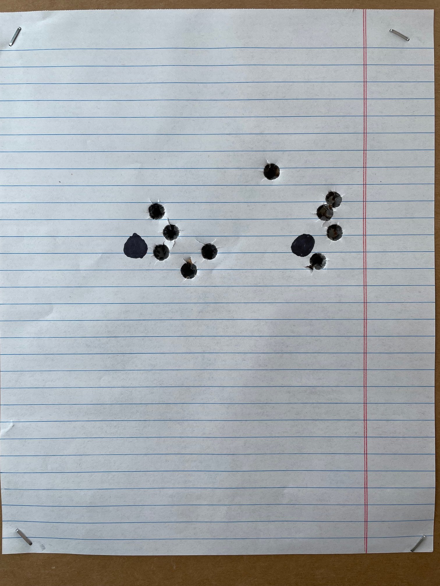

I've put 100 rounds of 300gr bergers through my 338LM and so far I am not seeing the accuracy I'd like to. Groups are pretty consistently 1.25" no matter what I do to tweak my load. Thinking of trying the 285 ELDM but wanted to see what others were doing first. I'd be happy if I could consistently get to 3/4 moa accuracy.

The only factory ammo I've been able to try was 40 rds of HSM 300gr SMK..... accuracy was poor (1.5 moa) with it as well.
Since then I've been trying to find a hand load I'm happy with.
300 gr berger hybrids- I've tried .030 (2 5rd groups shown below) , .050 & .075 off the lands
90.1 grs IMR 7977
Federal magnum primer
Lapua brass
Today across 10 rds I ran an average of 2739 fps with an ES of 19fps and an SD of 6.7..... very happy with velocity but you can see these 100 yd groups are brutal. the flyer on the right dot up by itself was my first round.
Really hope I can figure out what's up as right now I'm really scratching my head.

So 7977 isn't exactly an ideal powder. I remember seeing some old posts of guys that couldn't get that powder to work for them, nor H1000 but Retumbo turned his gun to a real performer.
Do you have any other powder to try and magnum primers as well?

If you can try a regular primer, non magnum. Also if you can try h1000 or reloader 33. Sometimes a different powder is key. I’ve never used im7977 so can’t comment on it.
Try a 250 grain scenar with that imr7977 and if you can’t get it too shoot I’d say it’s the powder. 🤷🏻‍♂️
I've got some H1000 so I'll give that a try. Appreciate the comments!

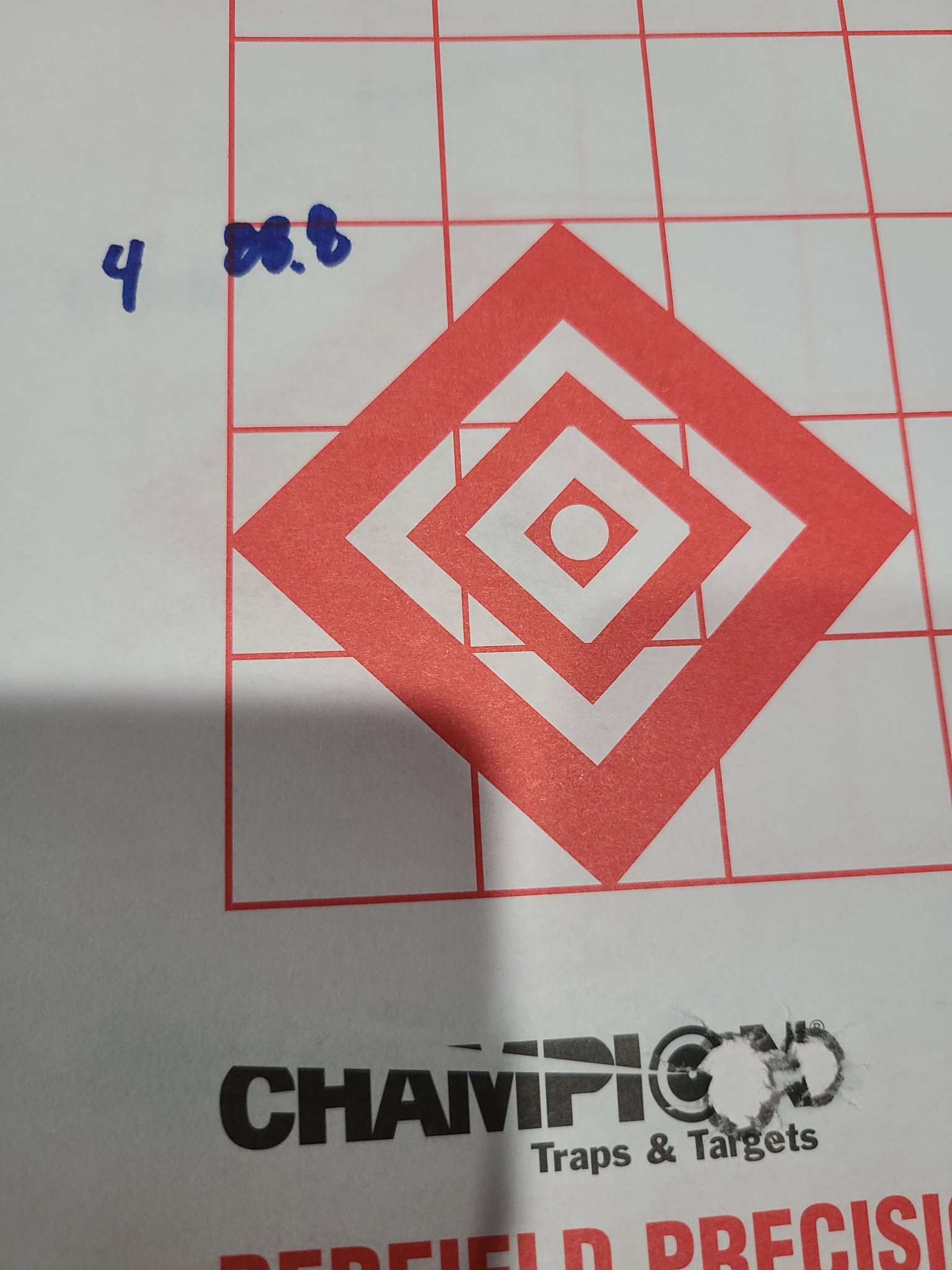

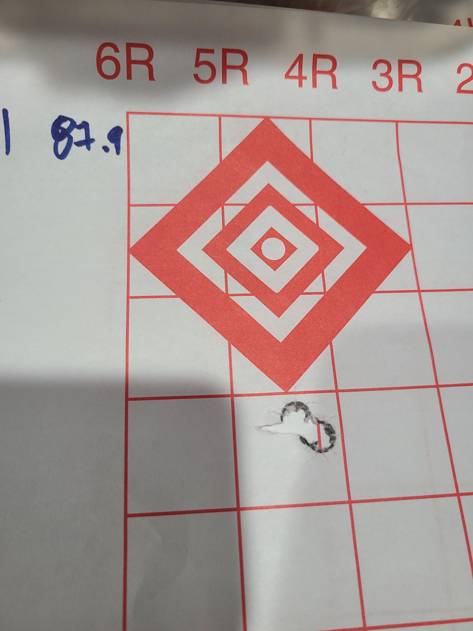

Took out my new 300 Norma barrel. I was impressed so far.
