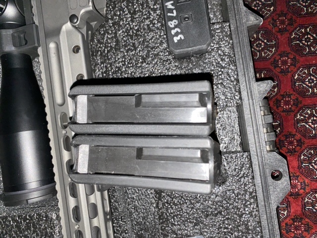

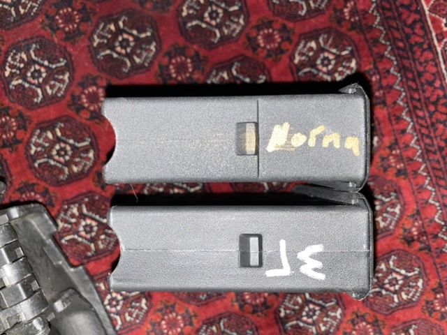

Has anyone made a bolt stop to allow users to shoot .308 or 6.5CM without the long action throw? I know the DT has ones for their system to take them from a long action to a short action. Thinking it would be easy to 3D print something to place in the rearmost sleeve to achieve this.
Honestly, I have never noticed, I don't use it in my DT so maybe muscle memory, run it and run it hard! 🤣

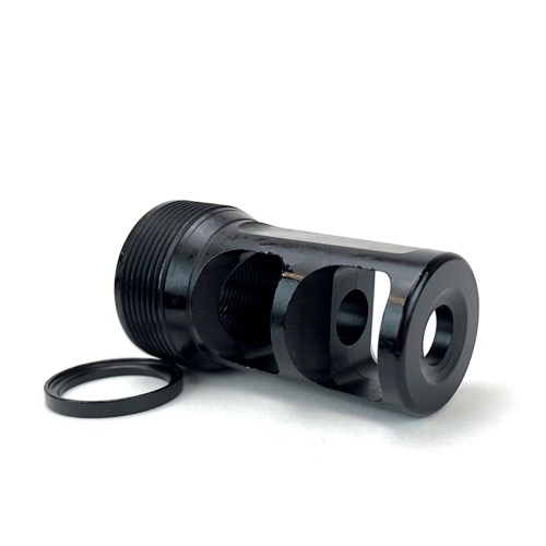

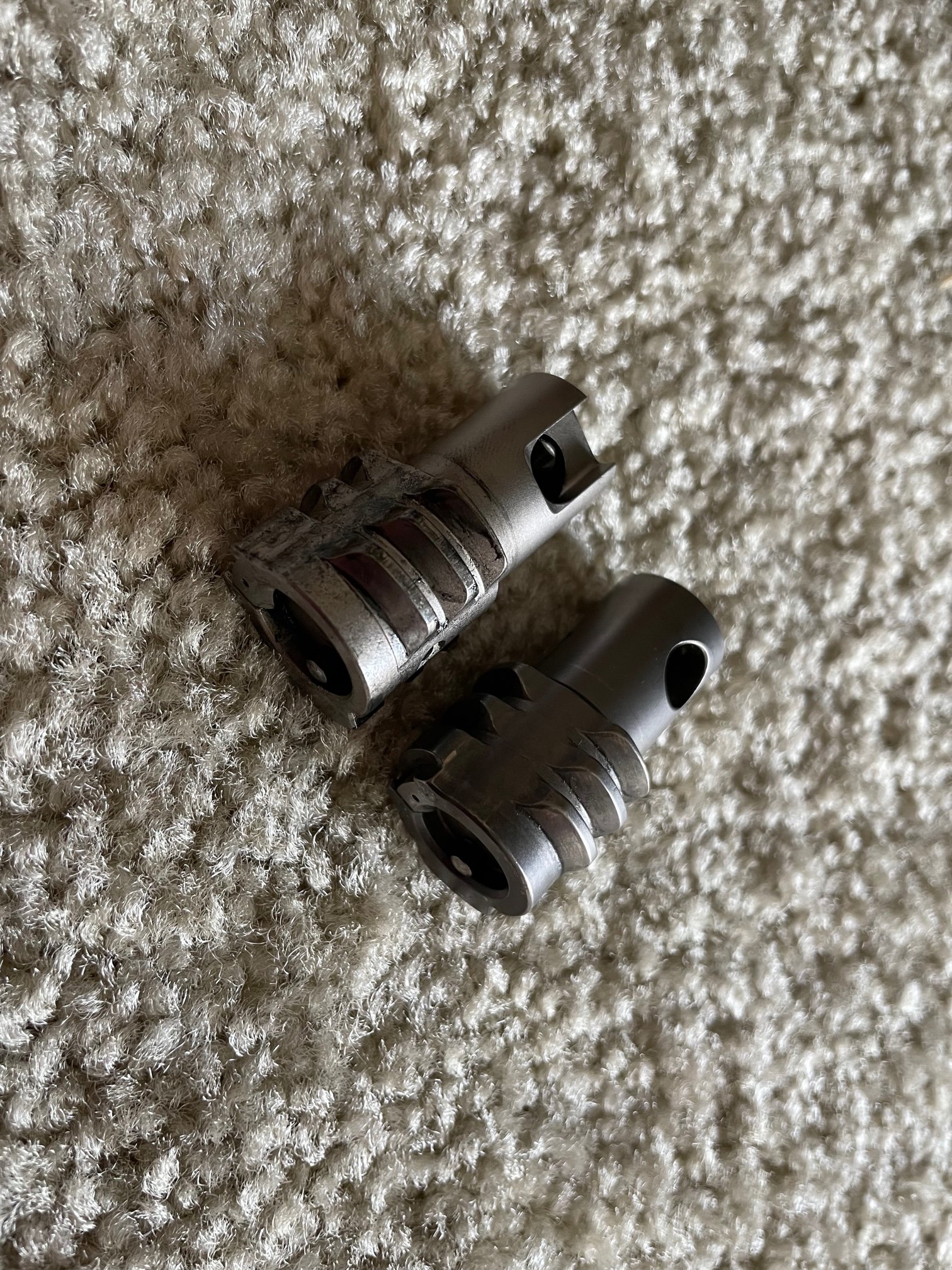

Yes/No. Barrett sells two different 30 cal muzzle brakes one for the AM30 and one for the AM338. Not sure which one ships on the 30 Cal Mrads or the conversion kits. I swapped all mine out for Rearden Devices, so I can run any of my Dead Air/Silencerco/Form 1 cans.
Barrett just got back to me the AM338 fits all barrels except the 308 and 6.5 those just need a AM338 muzzle brake with 5/8x24 threads

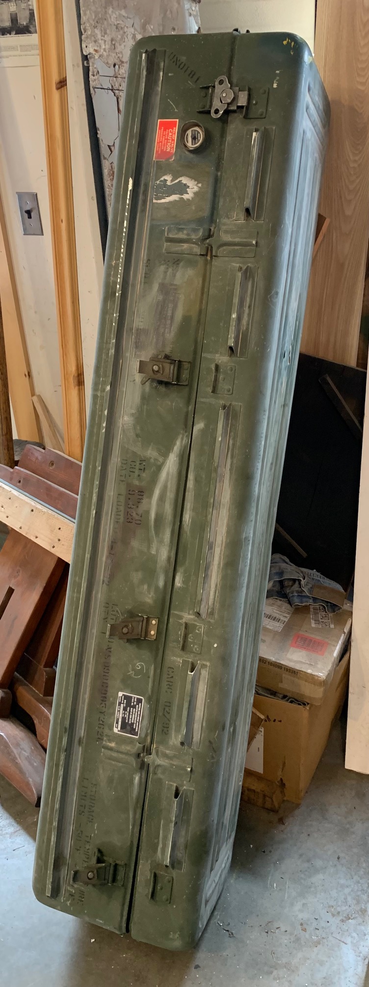

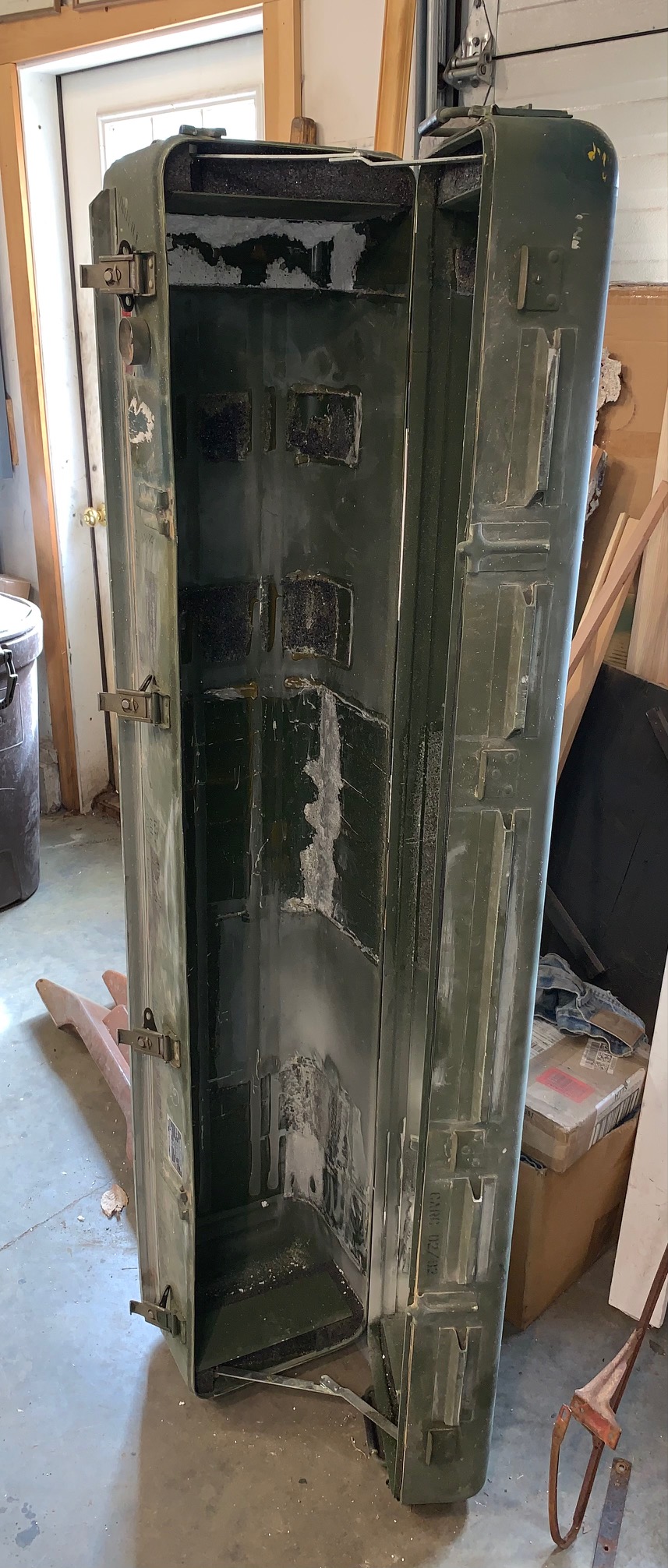

So earlier I asked about options for a case for an MRAD with a wide-bipod, big scope and... interesting grip. Turned out I had the solution around all the time.
Back about 15 years ago, I bought a couple of Stinger Cases when they were easy to get and cheap from Sportsmans Guide or something like that. I used them to transport crankshafts to and from grinding. But they got to be too bulky and unwieldy.
So... with some measuring, these are perfect not only to fit an MRAD, but a spare barrel, suppressor, magazines, ammo, tripod spotting scope...
First step (and all I have accomplished so far) is to remove the foam from the case. And holy hell on a ham hock... is that a job! It's massively strong foam (and some styrofoam) held in with, I guess, some kind of hot glue. Put together by people who were, apparently, paid by the gallon of glue that they used. Getting the foam out of one of these is a battle! I heard that these were sold to the gummint from the late '70s into the 1990's for $2300 a case. And I think most of that was glue.
Using a Geisswein vibrating saw, and 3 hours, I finally got the foam out. But there is still a bunch of glue and 'scraps' of foam that I can remove with an angle grinder and a sanding disk. But I started to do that inside and think I unleashed a toxic cloud that will have Al Gore writing me a nasty letter. So until I can do it outside... I'm going to hold off on the rest of the removal. Then I'll paint the inside again with CARC.
I have foam on order. For those big boys, an old surplus Stinger Case is going to be just the thing! More to follow!

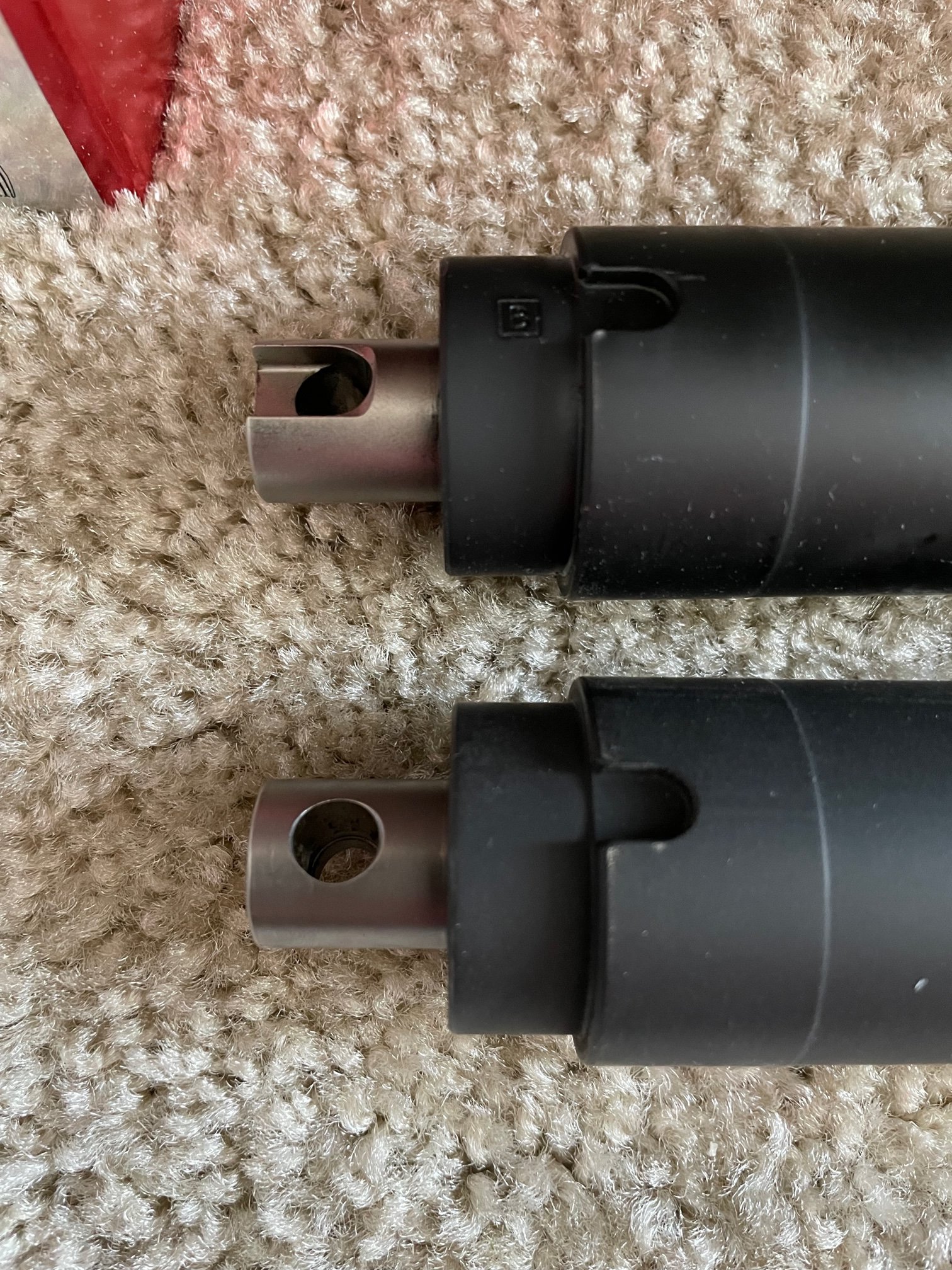

So I recently picked up a 6.5CM barrel for my MRAD however I ran into a snag last night when I tried to shoot the barrel...... Turns out the bolt for the 6.5 is not compatible with the bolt housing assembly for my rifle. The issue is the 6.5 bolt does not have a "notch" on the top side that my 338LM and 300PRC bolts have.
Am I missing something here around why this 6.5 bolt won't work with my bolt housing?
Pictures for reference. The bolt that works is the one with the "notch" cut, the 6.5 bolt does not have this notch.
Call tech support on monday. Can't say i've seen that.

The notch was a revision to "poka yoke" the bolt. I.e., you cannot put the bolt in the tube the wrong way.
Your 6.5 bolt should have a step in the cross-pin hole also.
Call Customer service and they will get you squared away.
Yes, there is a step in the cross pin hole. Thank you for the info, had no clue this was even a thing. I'll reach out to customer service tomorrow.

I do not own a MRAD and only held one a long time ago, but this is what I think is going on (pure speculation).
The bottom bolt head (6.5CM) was an earlier model where the bolt cross pin was able to be removed from the bolt body assembly. The cross pin was stepped to ensure that the user can only install the bolt head the correct way around.
Later models of the MRAD seems to have the cross pin permanently retained to the bolt body. My guess it was a requirement for a later government contract. In order for this to work, they had to cut the big notch you see in your 300PRC/338LM.
Your best option is to reach out to the people that supplied you the 6.5CM bolt head as there don't seem to be an easy fix for your problem.
Hope they can help you out and thus get you on the range to enjoy that rifle!
