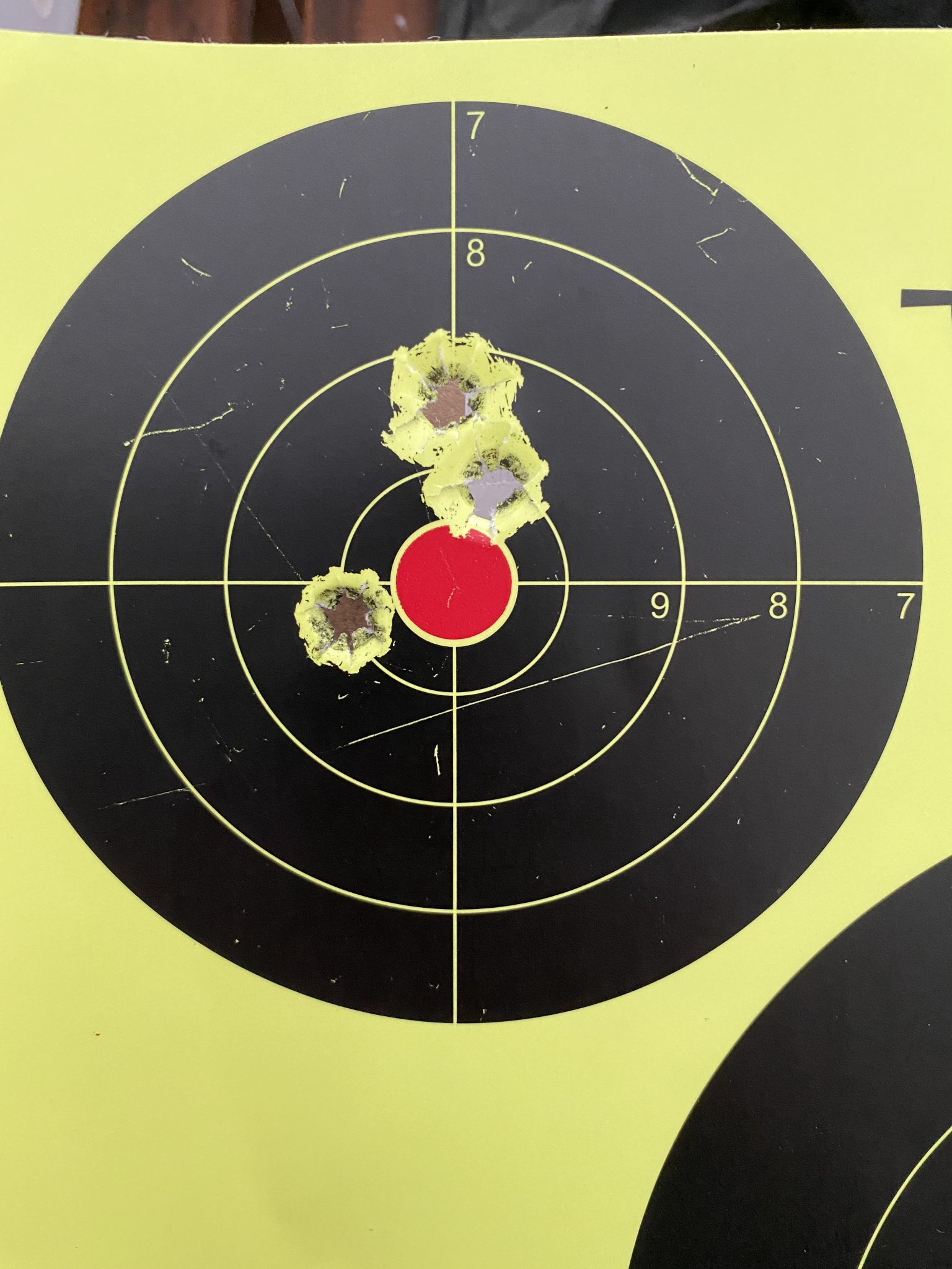

I ended up buying badger ordnance rings for my nightforce. I dialed the gun in from 3ft down and left at 25yds. Went to shoot it at 100 and it was shooting low and left again. Went back to 25yds to find it some how went back to the original place. Also the suppressor was a smidge loose than hand tight. I’ve had several people tell me it will cause that big of an issue. The suppressor is a CGS Hekate DT.
Nightforce says the scope was good. So my next step is to rethread the barrel and take out the thread adapter. My goal is to alleviate any possible problems with concentricity. Hopefully this solves it finally.
Any more suggestions would be greatly appreciated!
Insert barrel, close bolt. Tighten the two screws. I saw a youtube were the guy put in the barrel and just tightened the two screws then closed the bolt. Make sure you torque to spec.

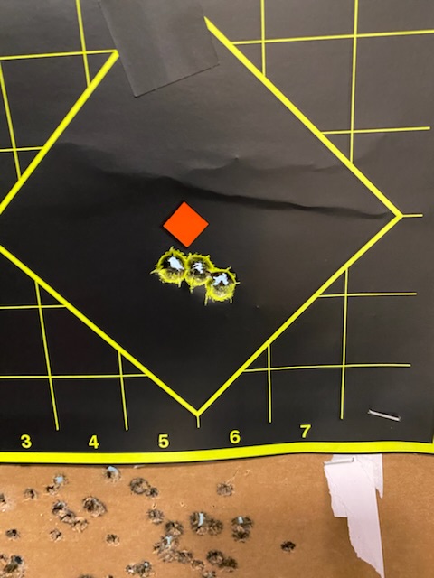

Glad to know I don’t suck. Lake City 762 loose bulk ammo 100 yards indoor 5 shots
But I did have 3 FTF. Pushed the bolt close but could not lock the bolt. Pulled the bolt back and noticed the marks on the bullet. Do any of you have really tight bolts that takes some extra force to lock down?

I saw no one replied to your comment. If you could not closethe bolt and you're seeing rifling marks on the bullet, you like have bullets seated too far forward and are jamming it into the lands. The bolt should close easily on proper ammo.

Yeah I think you are right. Only having issues with Lake City 762. Different lines of Hornady, Norma all worked fine.

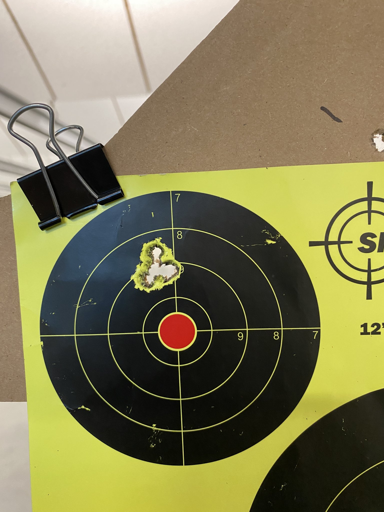

So I took my mrad out tonight for the first time with a new 37xc 32in barrel. Brand new brass, using a federal magnum primer, 390grn A-Tip. I started like the tubb white paper suggested at 116grains of H50bmg.
Here are my results, how high can I go? Velocity seemed low.
At each charge weight I had three rounds using my 120fx-I scale.
116- 2602, 2575, 2590
118- 2636, 2650, 2648
120- 2678, 2681, 2673
122- 2727, 2726, 2724
124- 2752, 2777, 2761
125- 2787, 2782, 2785
I had zero signs of pressure and last group looked like this.
I had zero signs of pressure and last group looked like this.View attachment 7970344
I'd check the 33XC thread for the velocity and reloading info.. looks promising
