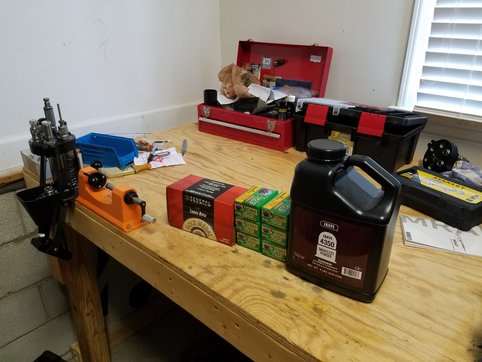

I am looking to upgrade my chronograph. Anyone have hands on experience with the LabRadar Ballistic Velocity Doppler Radar Chronograph? yes its a handful, I have seen and read mixed reviews online of both it works and its great to its overpriced and it sucks. Just attempting to gain more perspectives before I send $600 down range. [h=1][/h]
Nice set up by the way shooter. I now know how my dog feels when he is waiting for me to make his food. My MRAD delivery has been postponed until Tuesday. Hence a slight change of weekend plans :(
